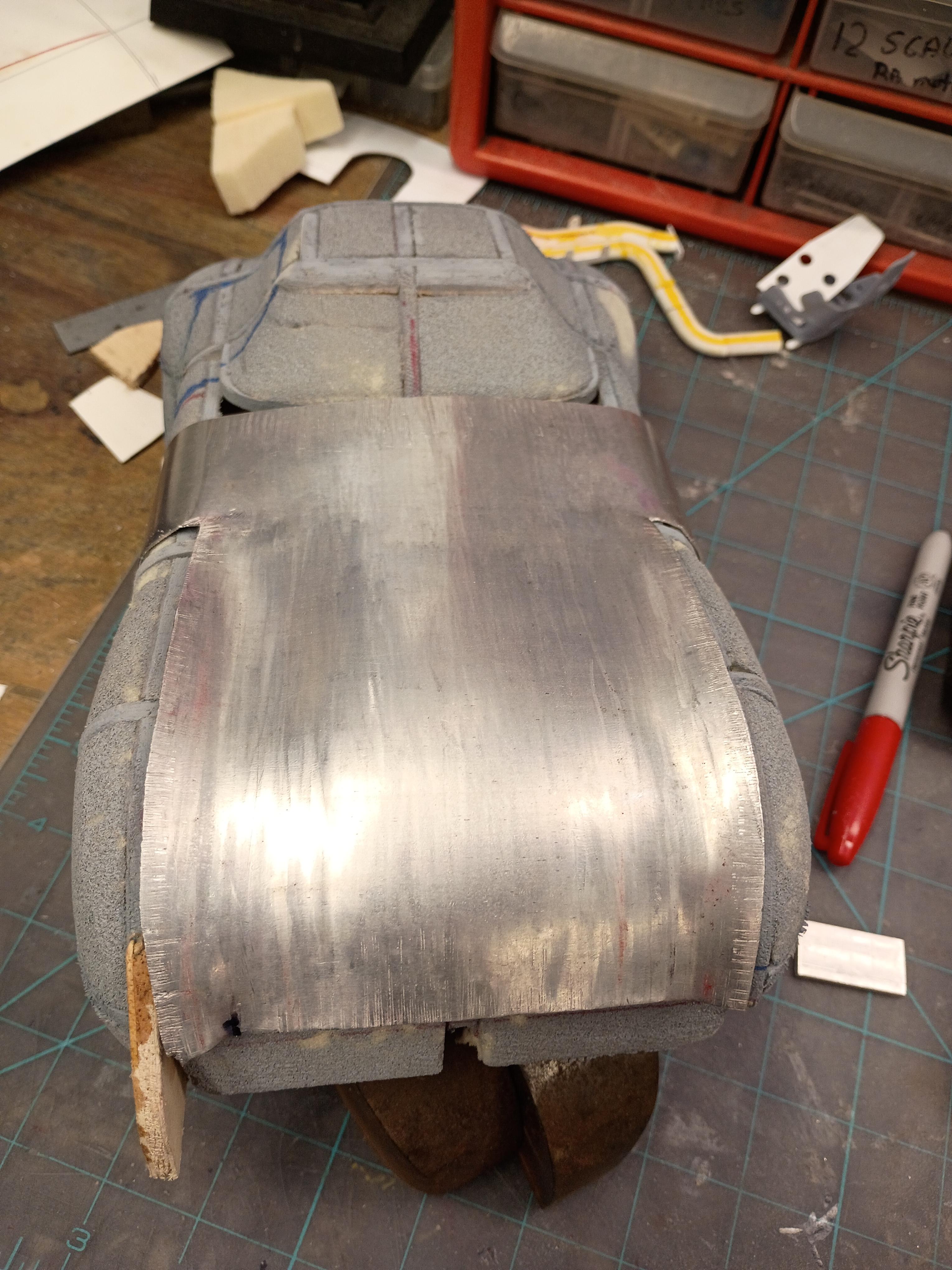

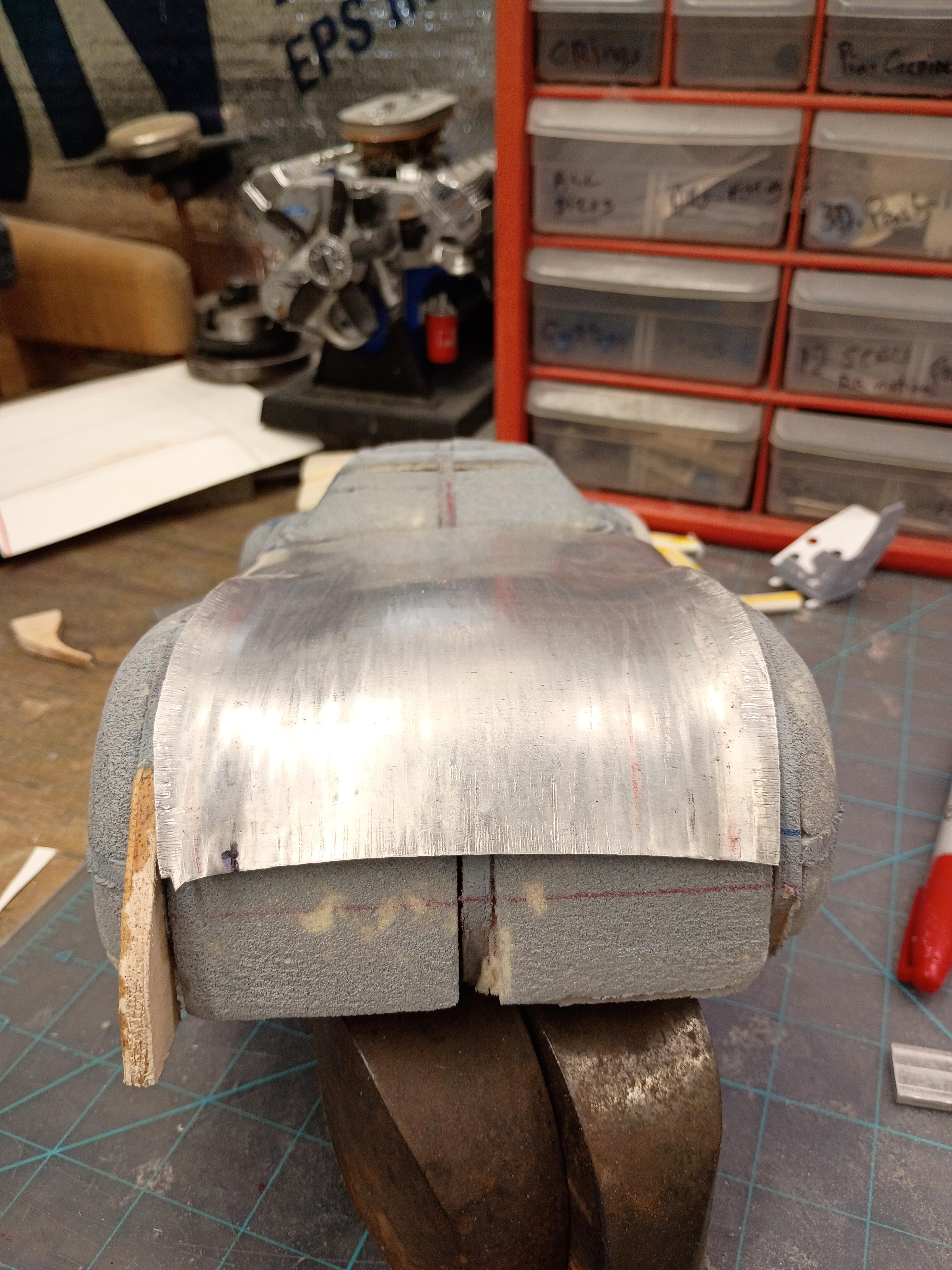

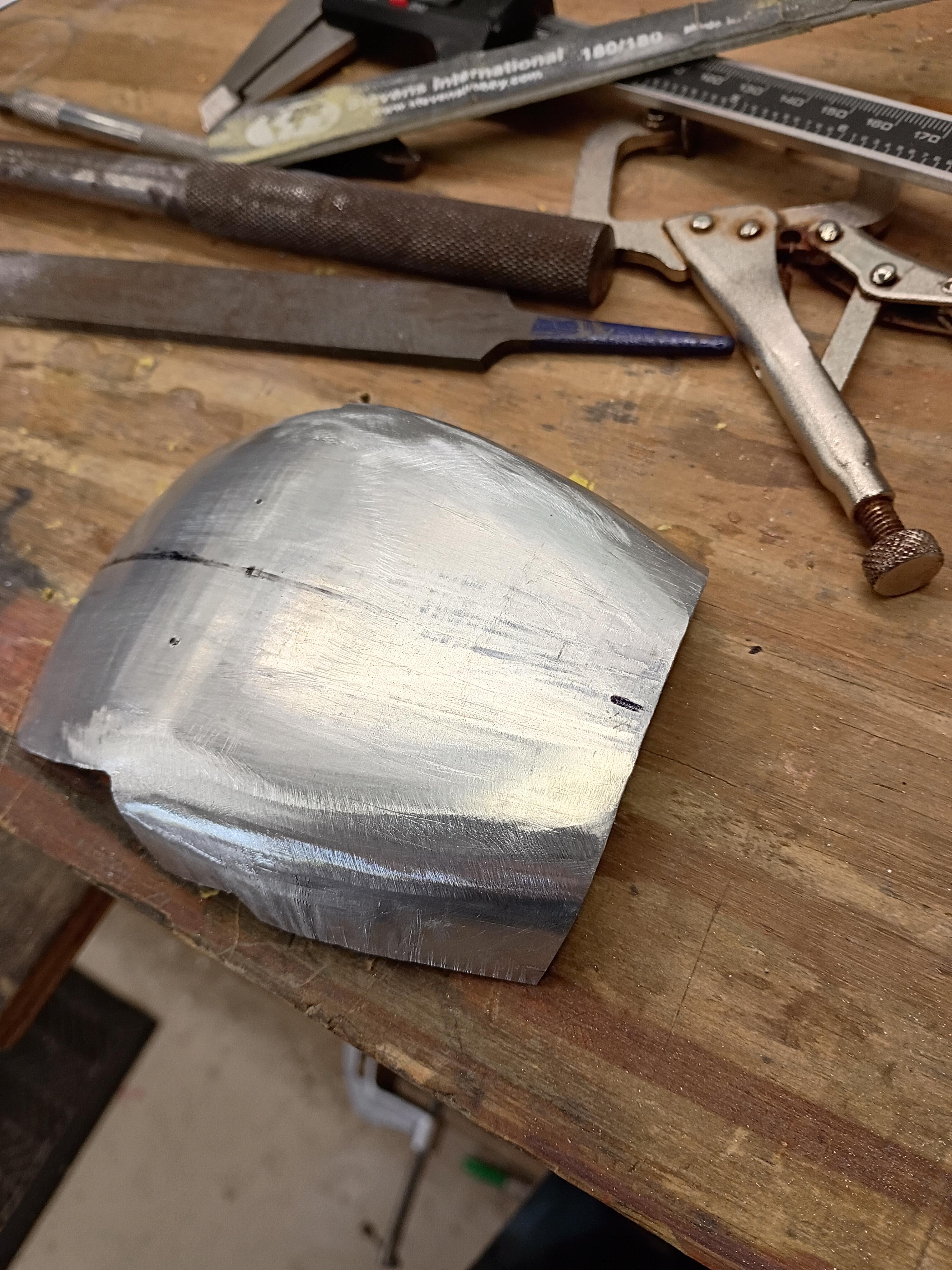

charlie libby Posted September 11 Author Posted September 11 back so soon.glad to hear fromm you .this will be another big project. got a little start on the body today ,this is 1/12 scale. in between working on the 55. outside half of the front fenders are next them soldering . i am going to practice a little first. 2

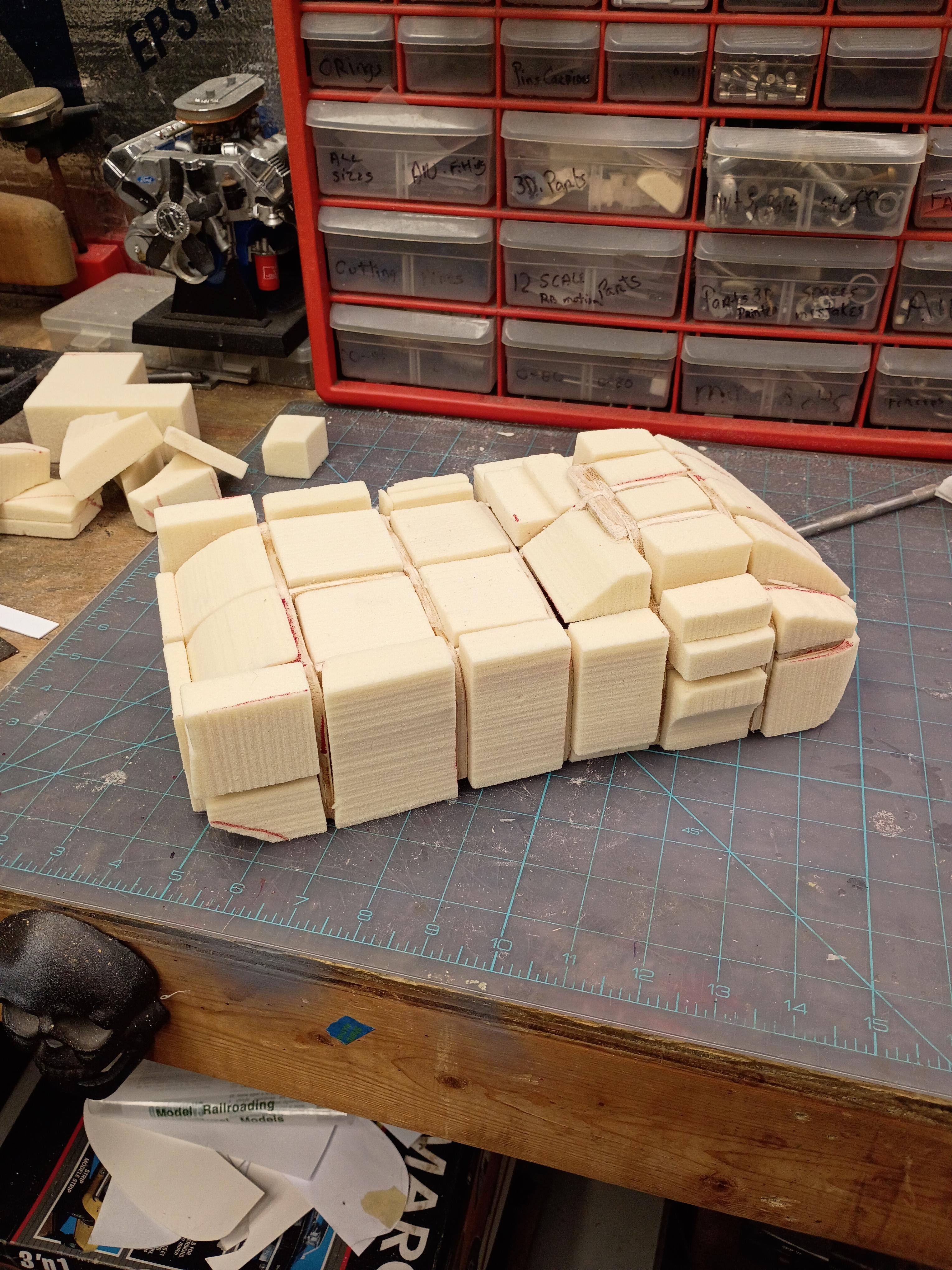

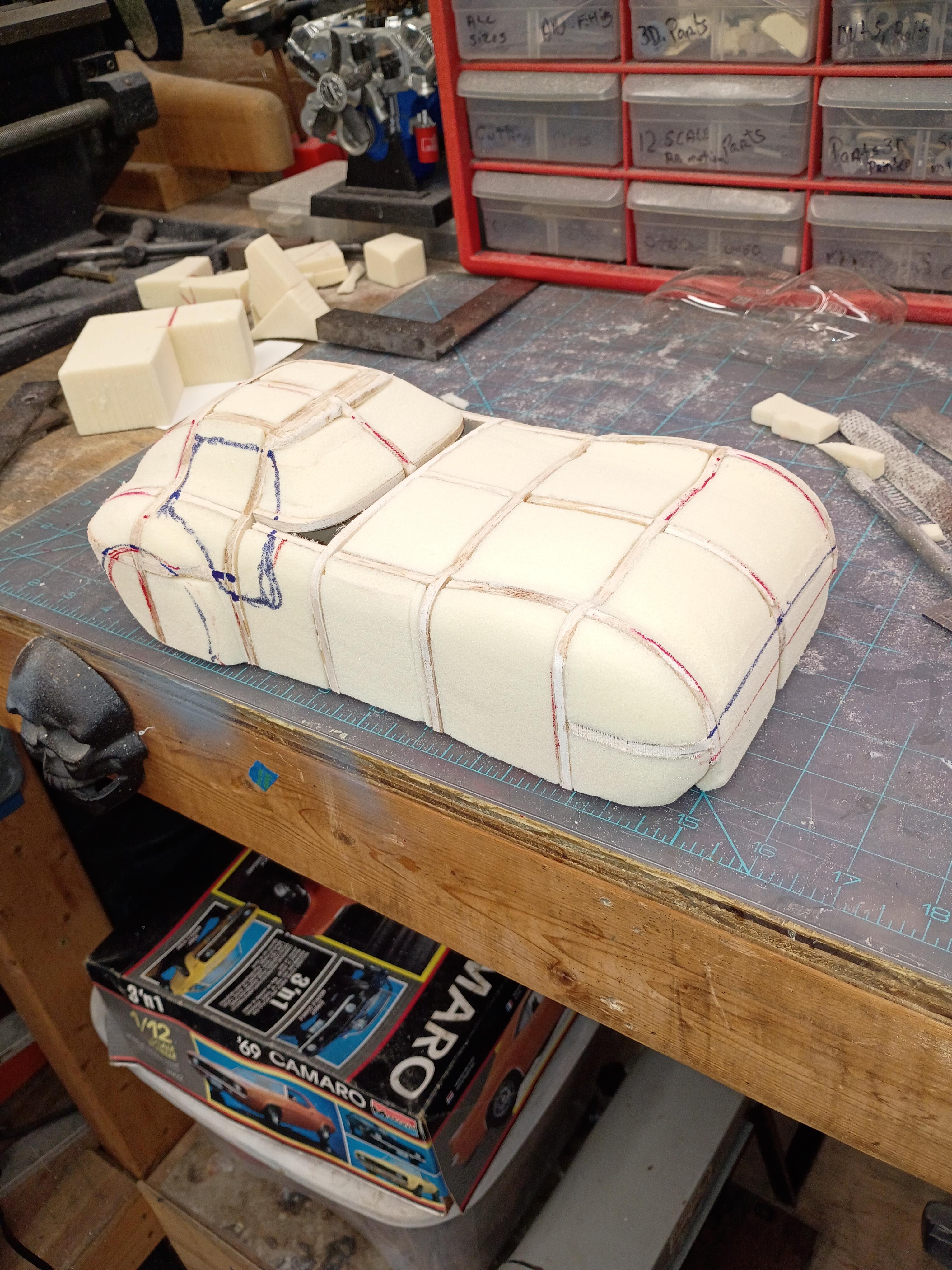

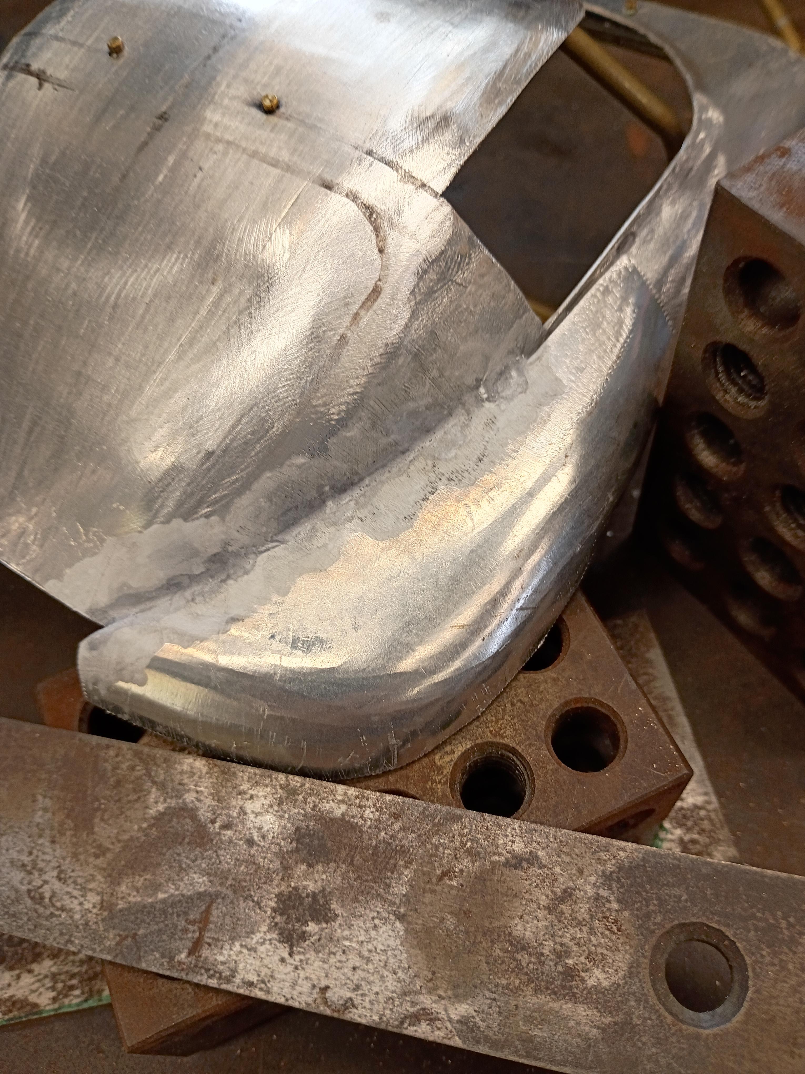

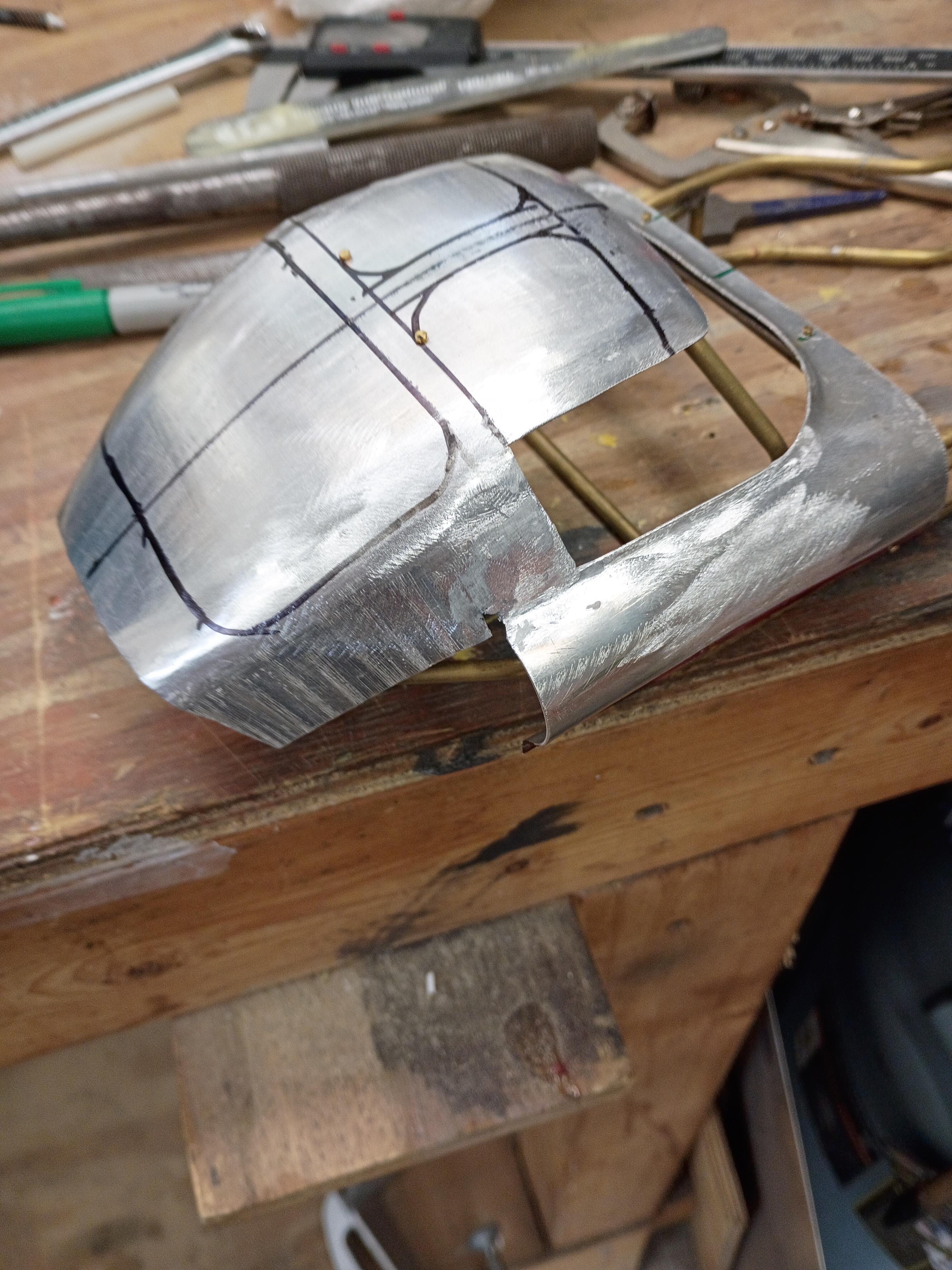

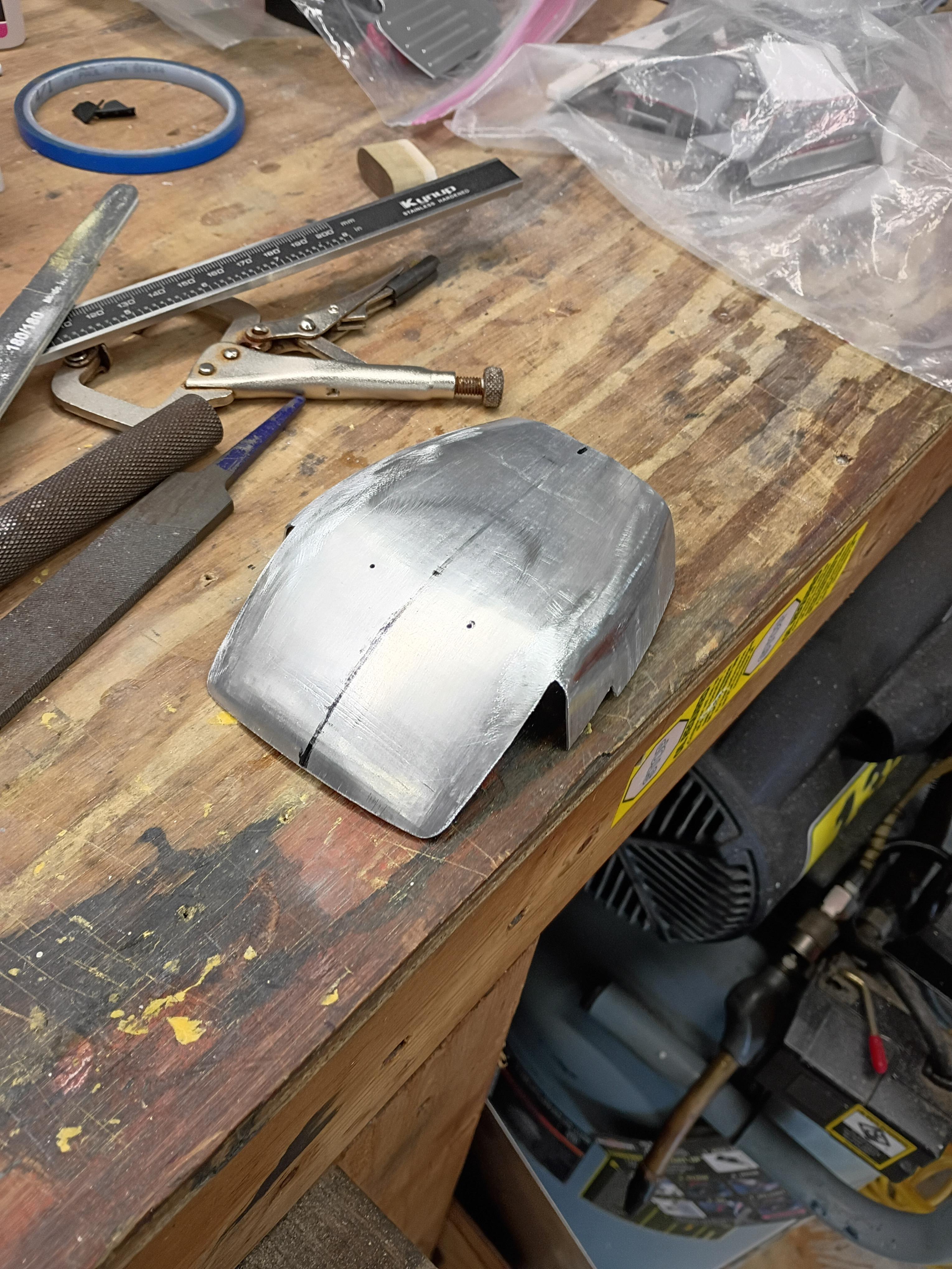

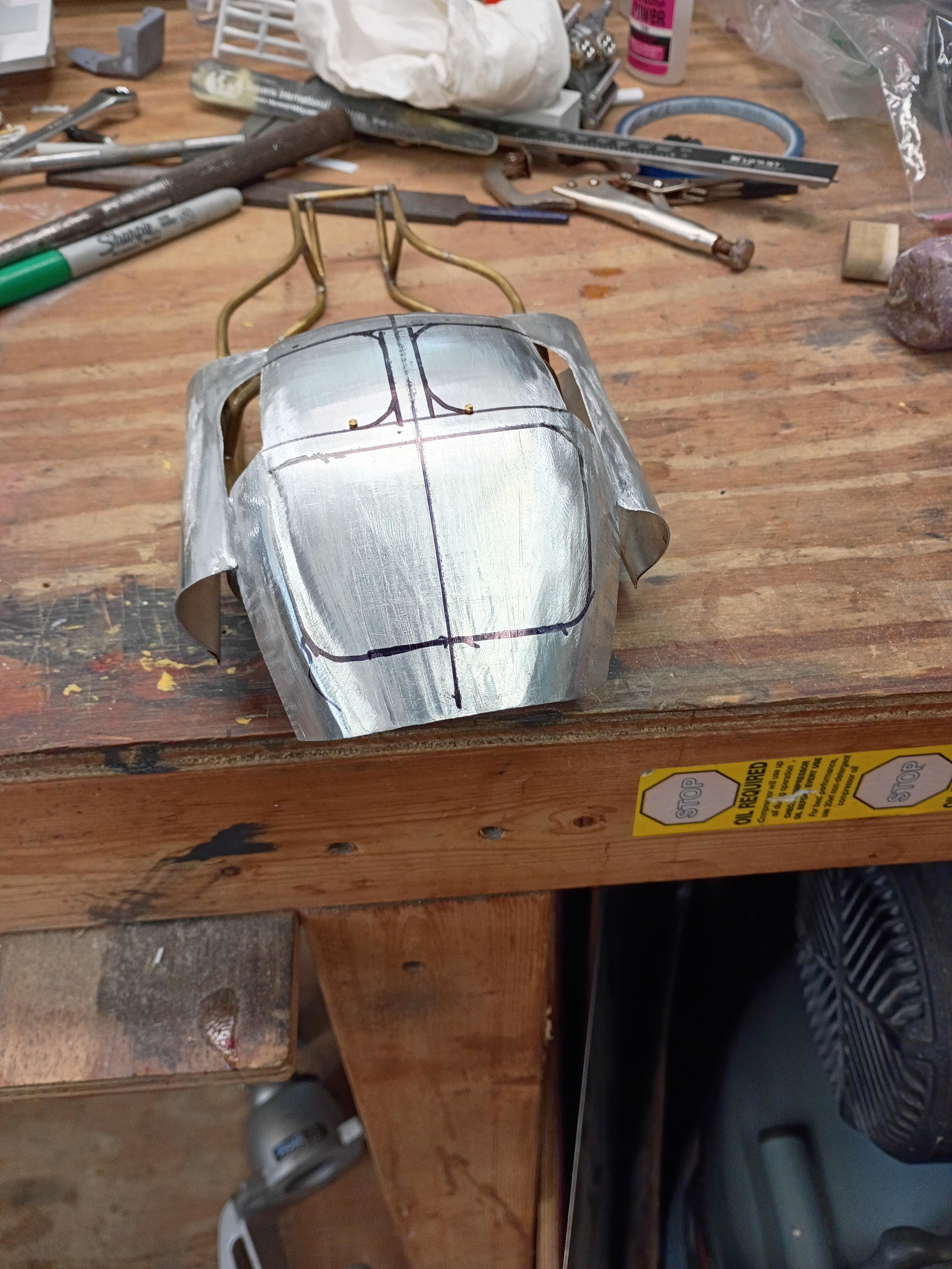

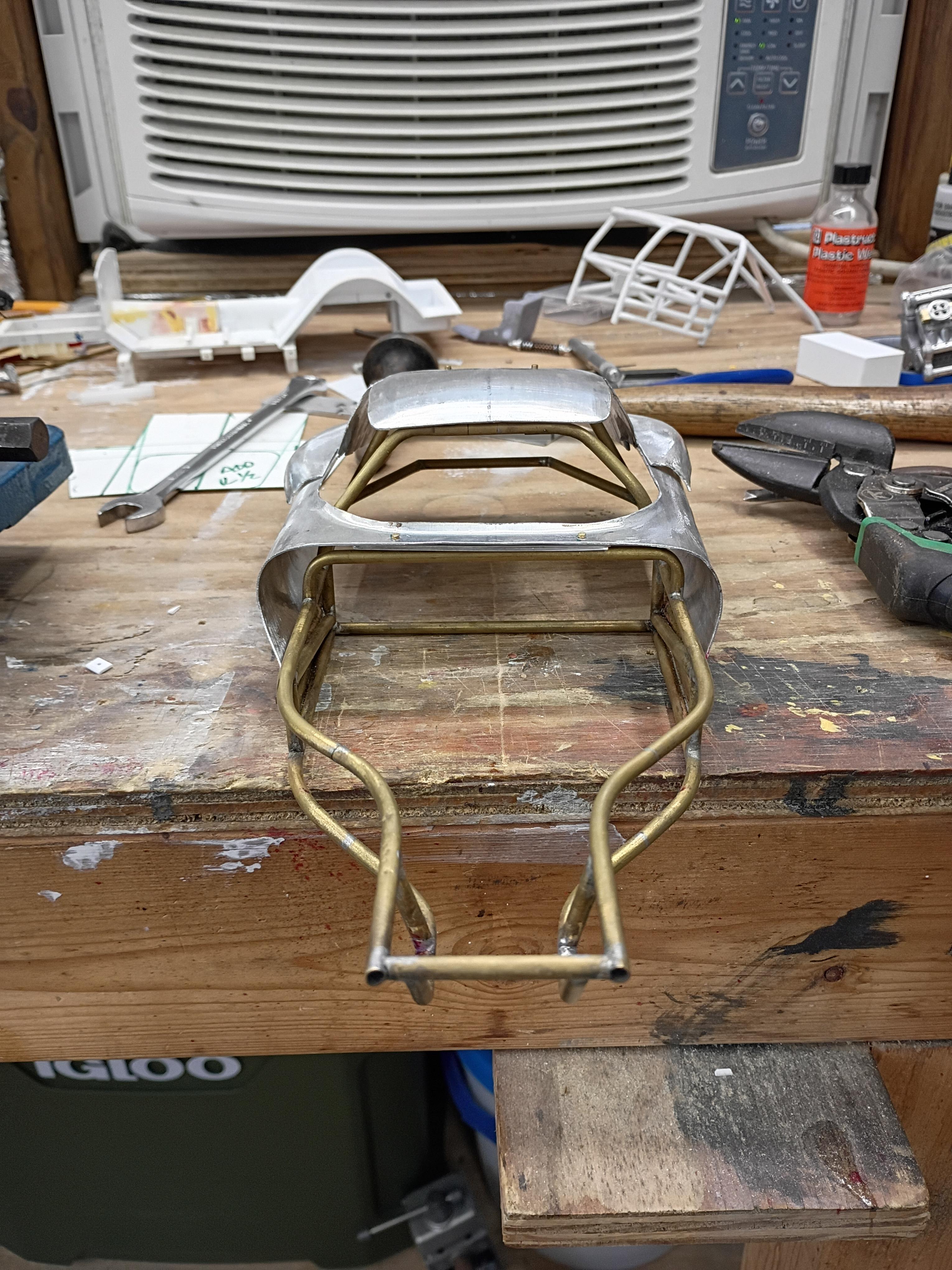

charlie libby Posted September 21 Author Posted September 21 cant keep up with you or Francis . hope you are doing well. nice to hear from you all. this is a big project. much thanks to David Bantoft for the chassis drawing. i got a good start on it. still building the 55 also. got to keep an old mind and hands busy. here is a few pictures. to make all the uprights the same and make sure the fish mouths were in line on both ends. i fished mouth one end and soldered them on a piece of tubing so i could clamp them in the vise to fish mouth the other end with a .150 ball endmill. this way all would be the same. i started on the front fascia with the grill opening. i am doing alot of research. found a lot of picture but no technical drawings. measurements are hard to come by as i am sure David knows. sorry noel,cheetah was always a favorite of mine . stay with me, it might grow on you. 5

Randy D Posted September 30 Posted September 30 Fabulous bodywork Charlie!!!!!! What are you using for soldering the aluminum? Great looking frame also !! Randy

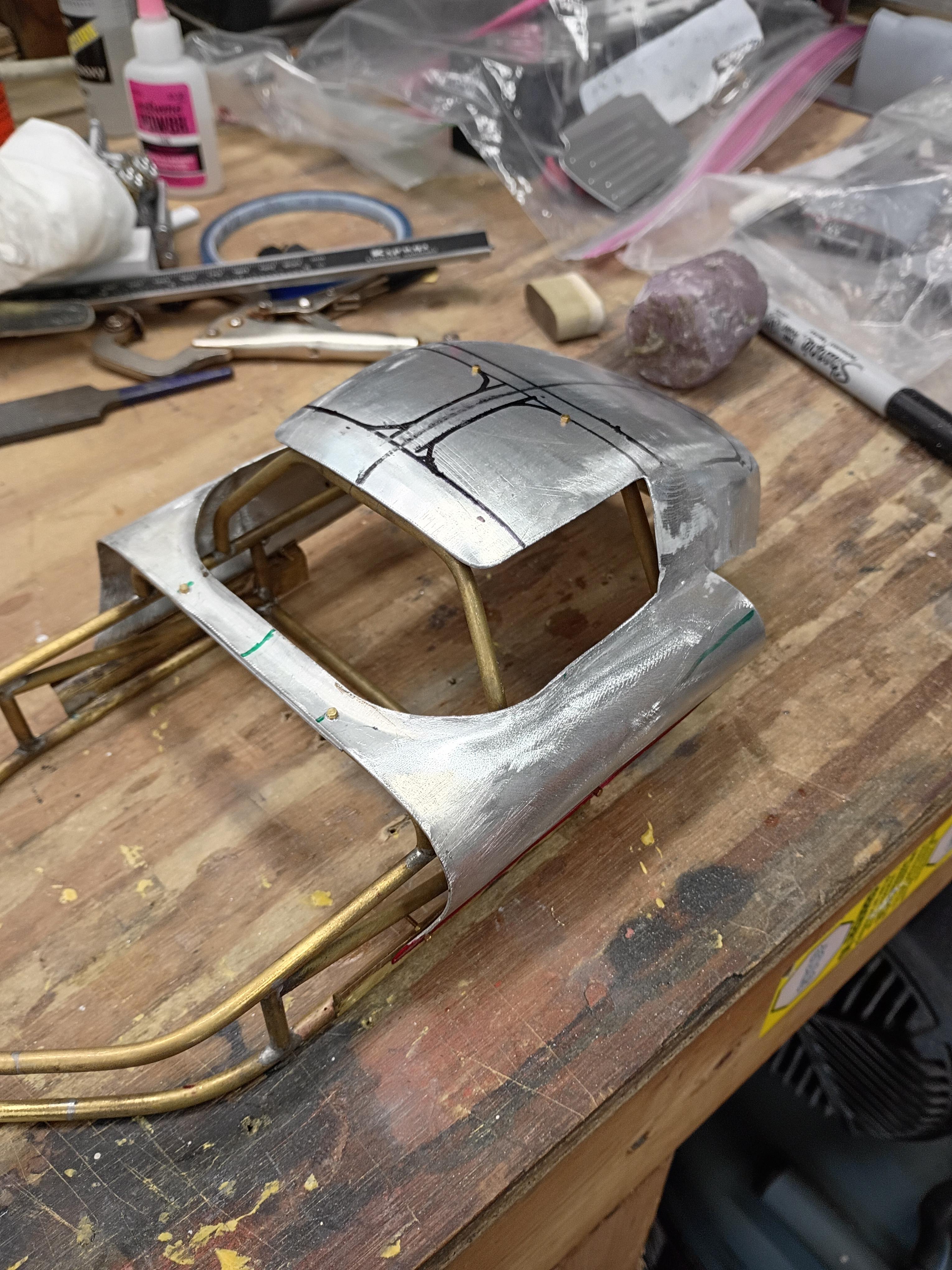

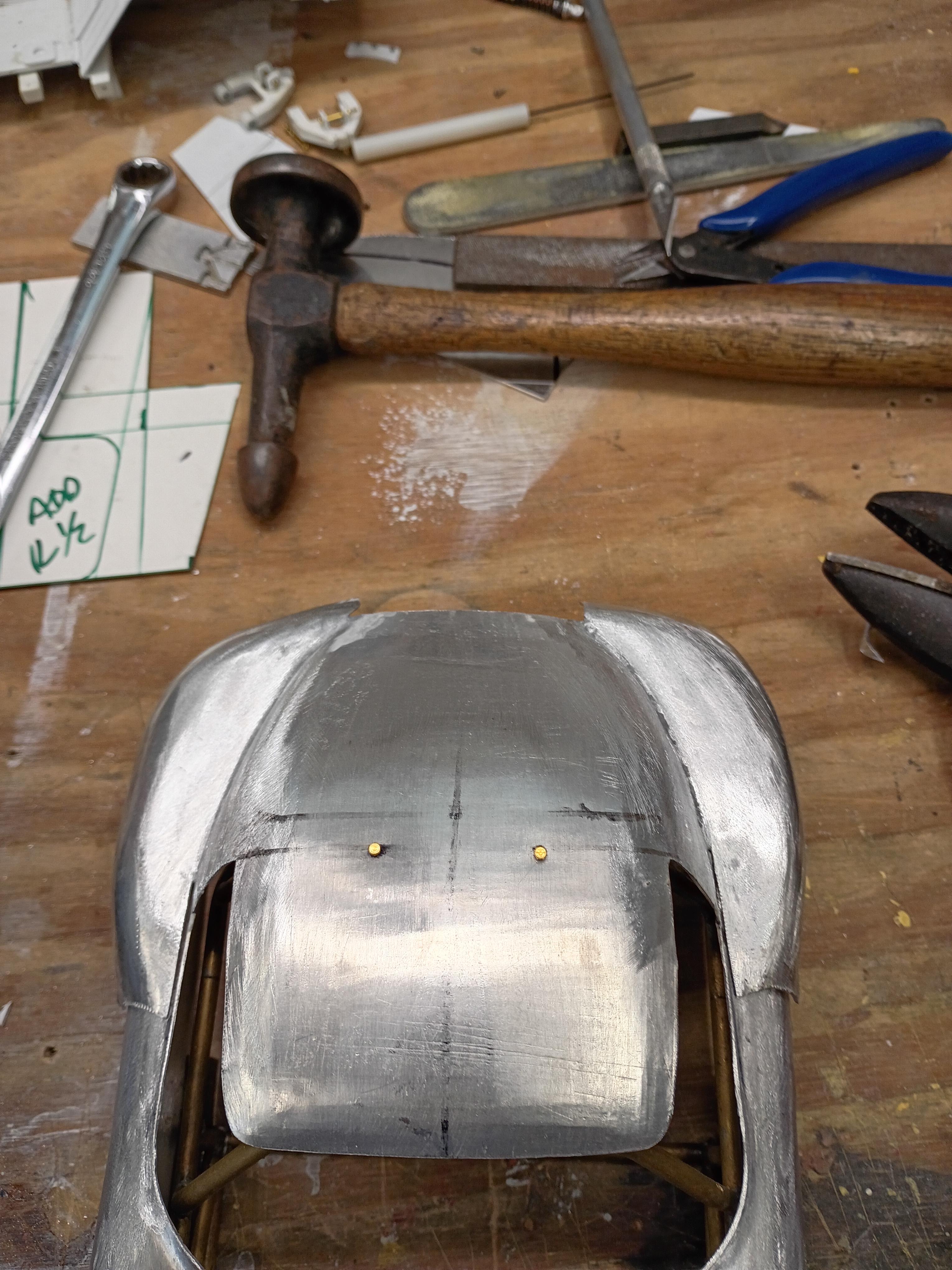

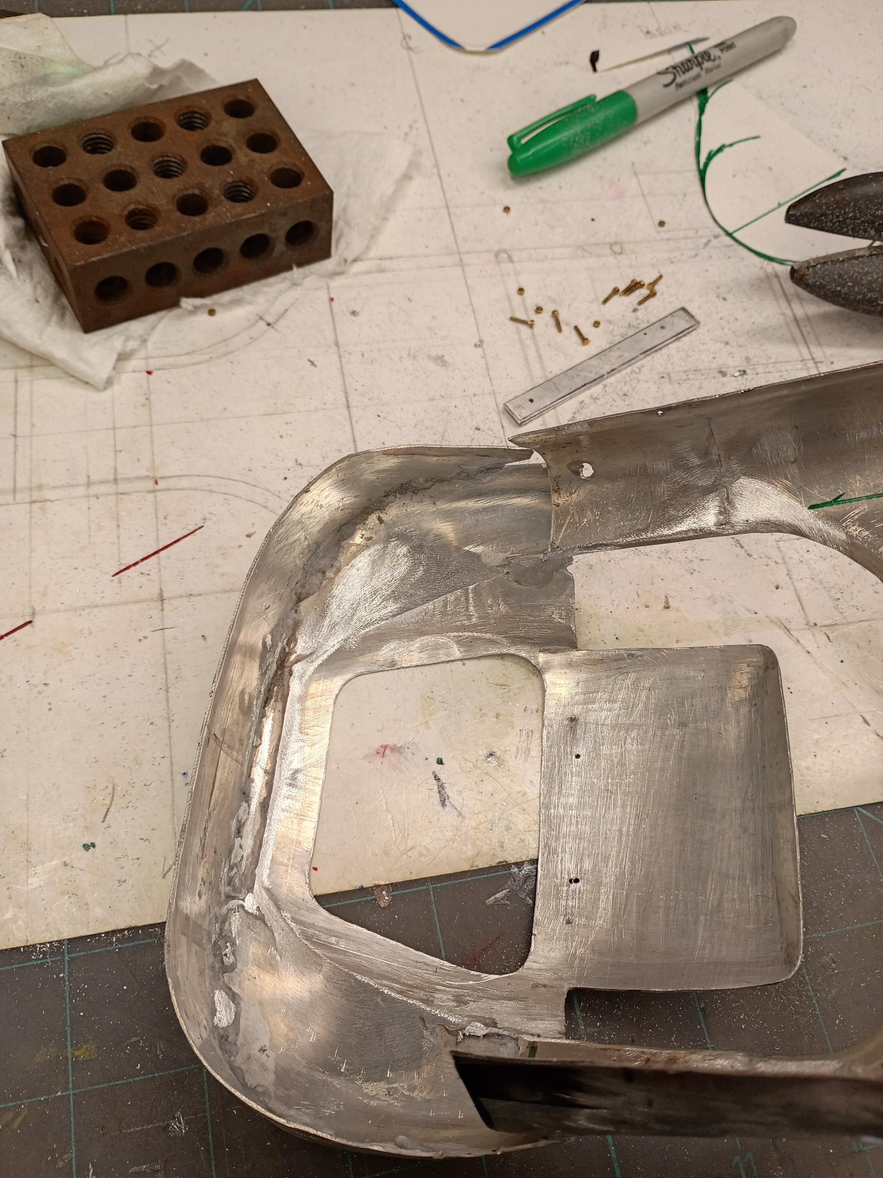

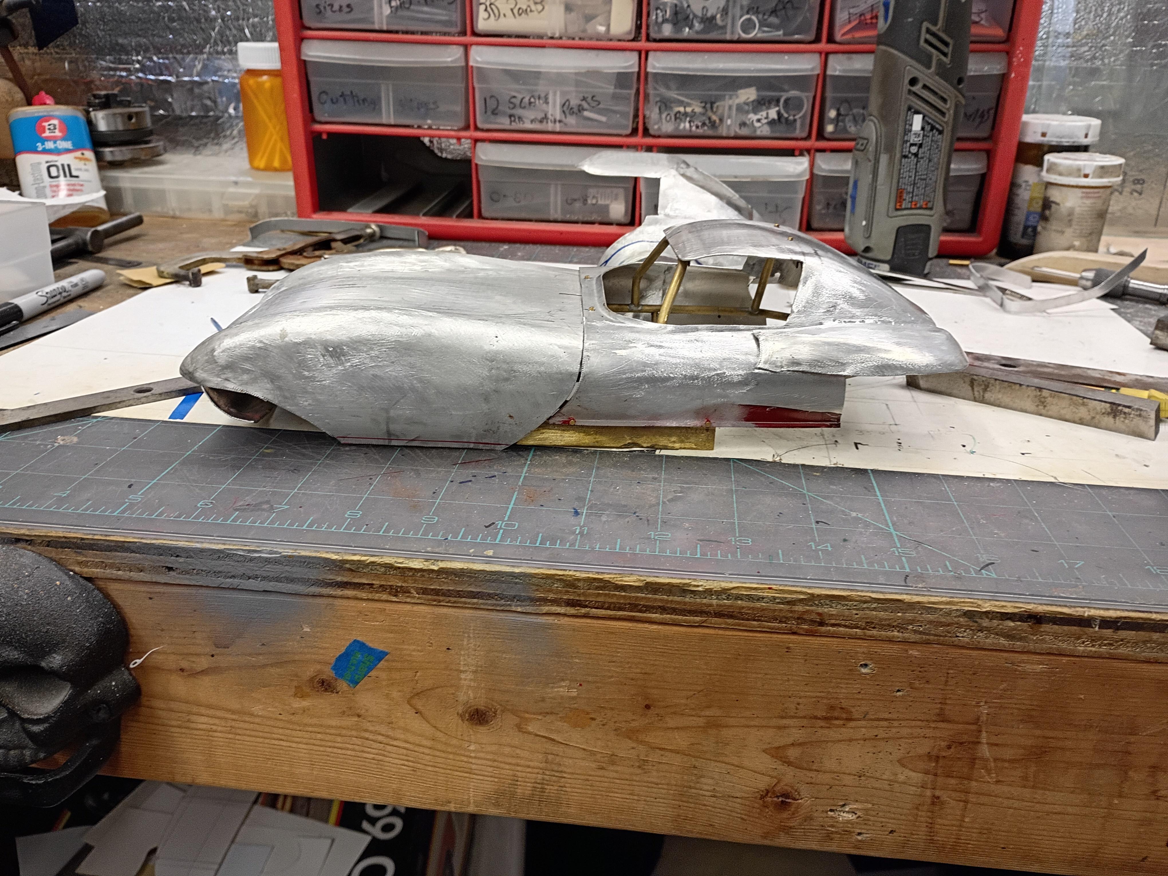

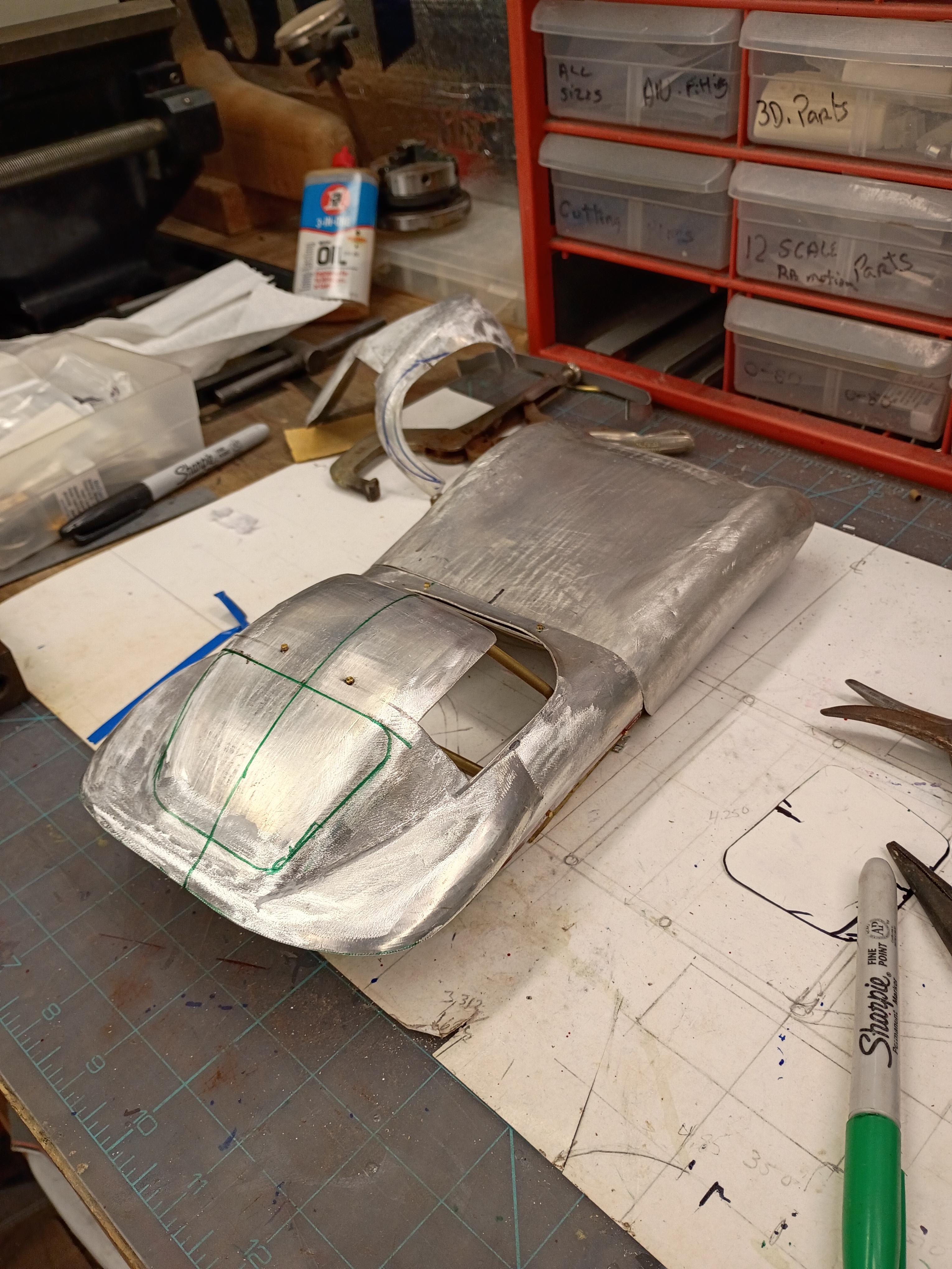

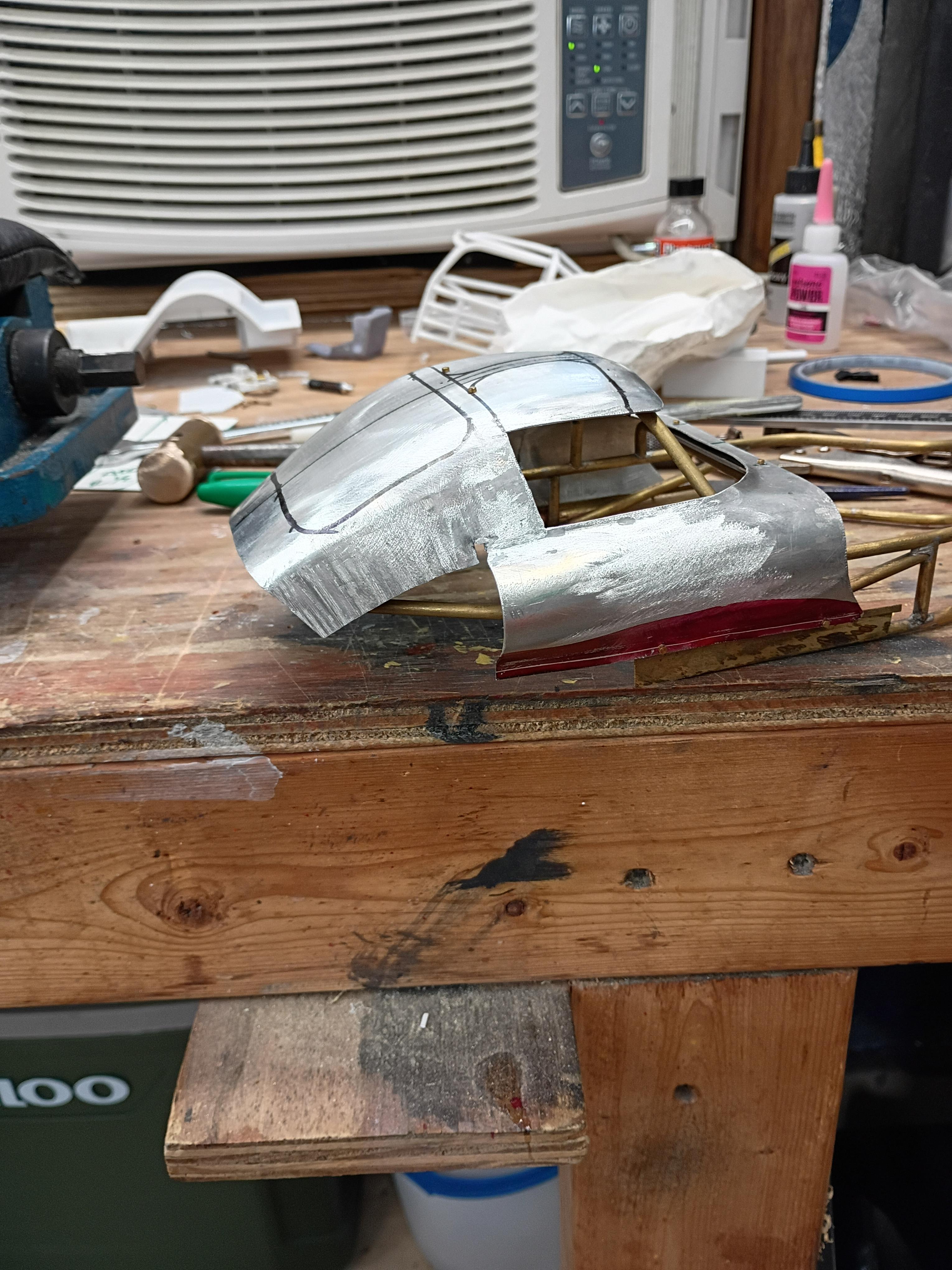

charlie libby Posted October 13 Author Posted October 13 hi everybody. just got out of the hospital a few days ago. i apparently had a small brain aneurism . i m not saying my brain is small but the aneurism was. back in the shop i decided i didn't like the way the rear section of the car came out so i remade it. i made the roof and rear window section from i piece of aluminum and made the top of the rear fenders one piece each .i like them better. the lower pan and the bottom half of the fenders are also one piece. my soldering is getting better. now the sides and ,the windshield cowl and the back half are soldered together. i just started to grind and clean up the inside. i will spend the rest of this week working on the 55. thanks for the compliment randy, mark ,nice to hear from you.thanks 2
