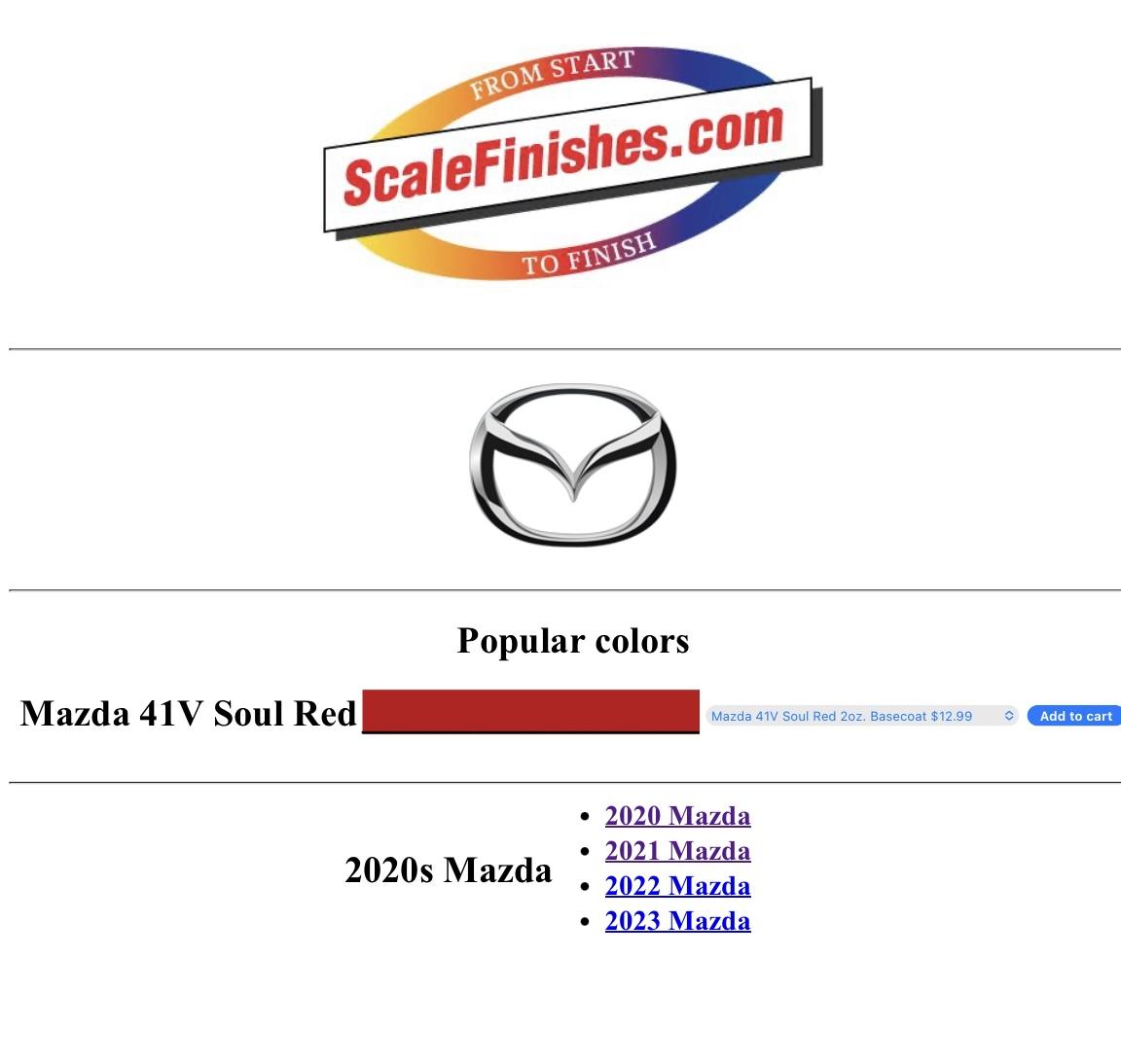

Rodent Posted 7 hours ago Posted 7 hours ago 13 minutes ago, StevenGuthmiller said: Steve That's actually not correct. The later Soul Red Crystal is 46V. 41V is the earlier Soul Red like my 2016 3. That said, any of the paint people can probably make the right color.
