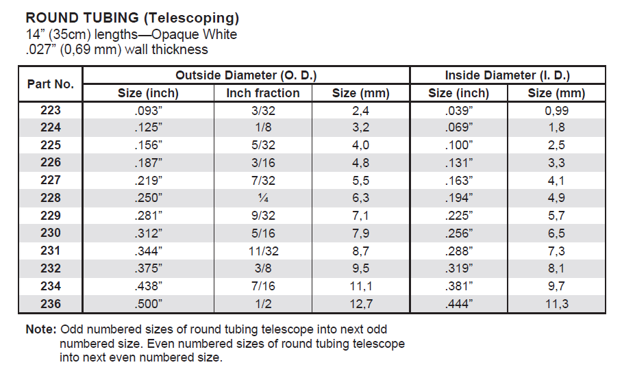

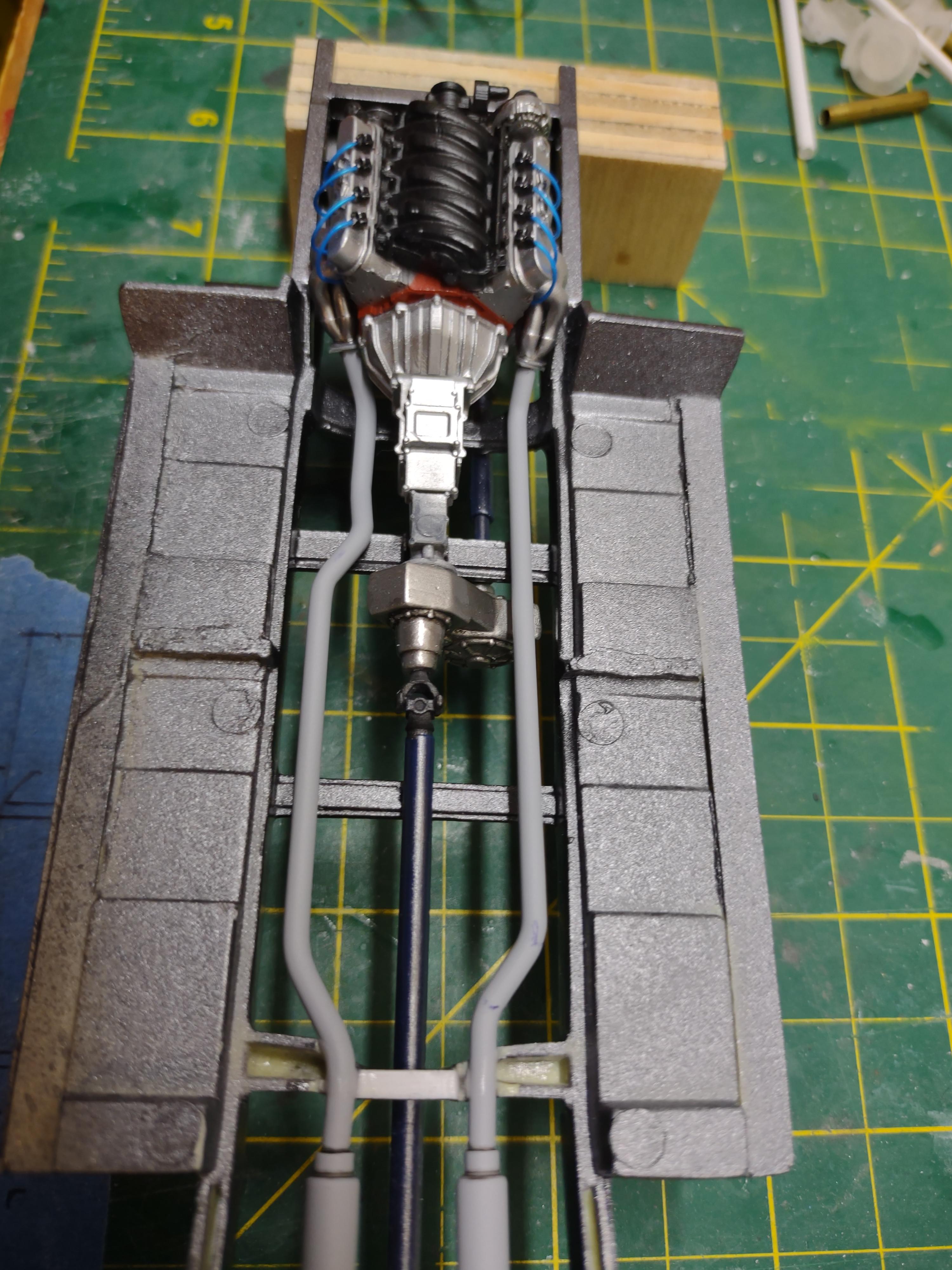

fiatboy Posted 16 hours ago Posted 16 hours ago I'm wondering if this method will work for A.scratch making exhaust systems, and B. scratch making a roll cage. It seems some table of data should exist for matching small alum. rod with the appropriate inside diameter of a styrene tube. Solder isn't the answer; it sags. Right now, I'm buying all the 'fine' alum. rod I can find. Thanks.
DJMar Posted 16 hours ago Posted 16 hours ago The short answer is yes, that method works. The catch is finding the right size aluminum rod to fit the tube you want to use. Personally, I use coated florist's wire, which I find much easier to work with, as it bends without kinking and holds its shape. Plastruct offers an array of butyrate tubing and fittings that can be used to build roll cages, but it can get pricey.

johnyrotten Posted 15 hours ago Posted 15 hours ago I've found SOME aluminum tube and rod will fit in certain sizes of styrene after a bit of clean out with a drill bit. Hobby styrene tube most likely doesn't have a consistent wall thickness like metals will. Most likely because the way its manufactured. I can't begin to image the cost of drawn-over-mandrel super small diameter plastic tube. The plastruct butyrate or floral wire mentioned above is probably your best bet. 1

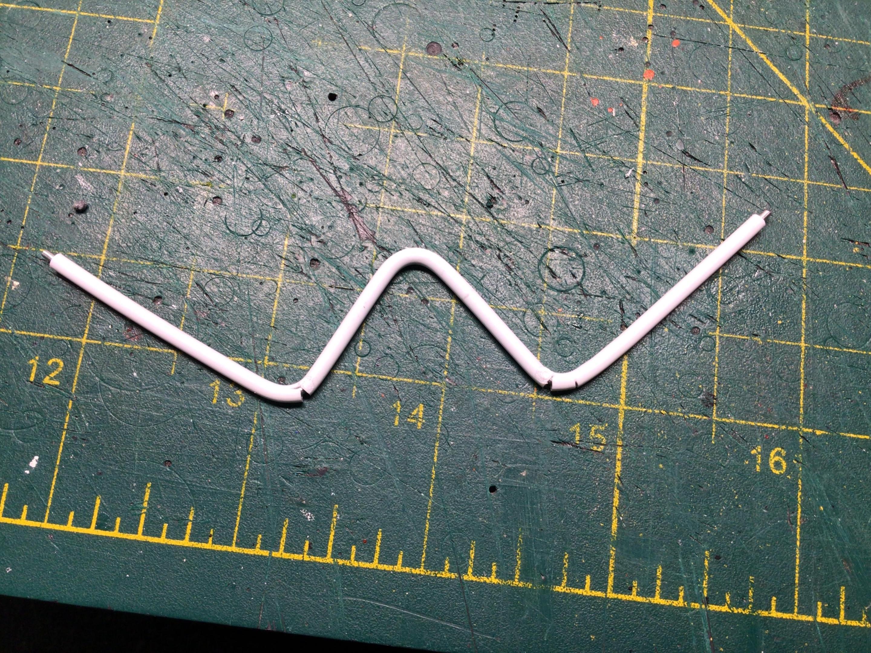

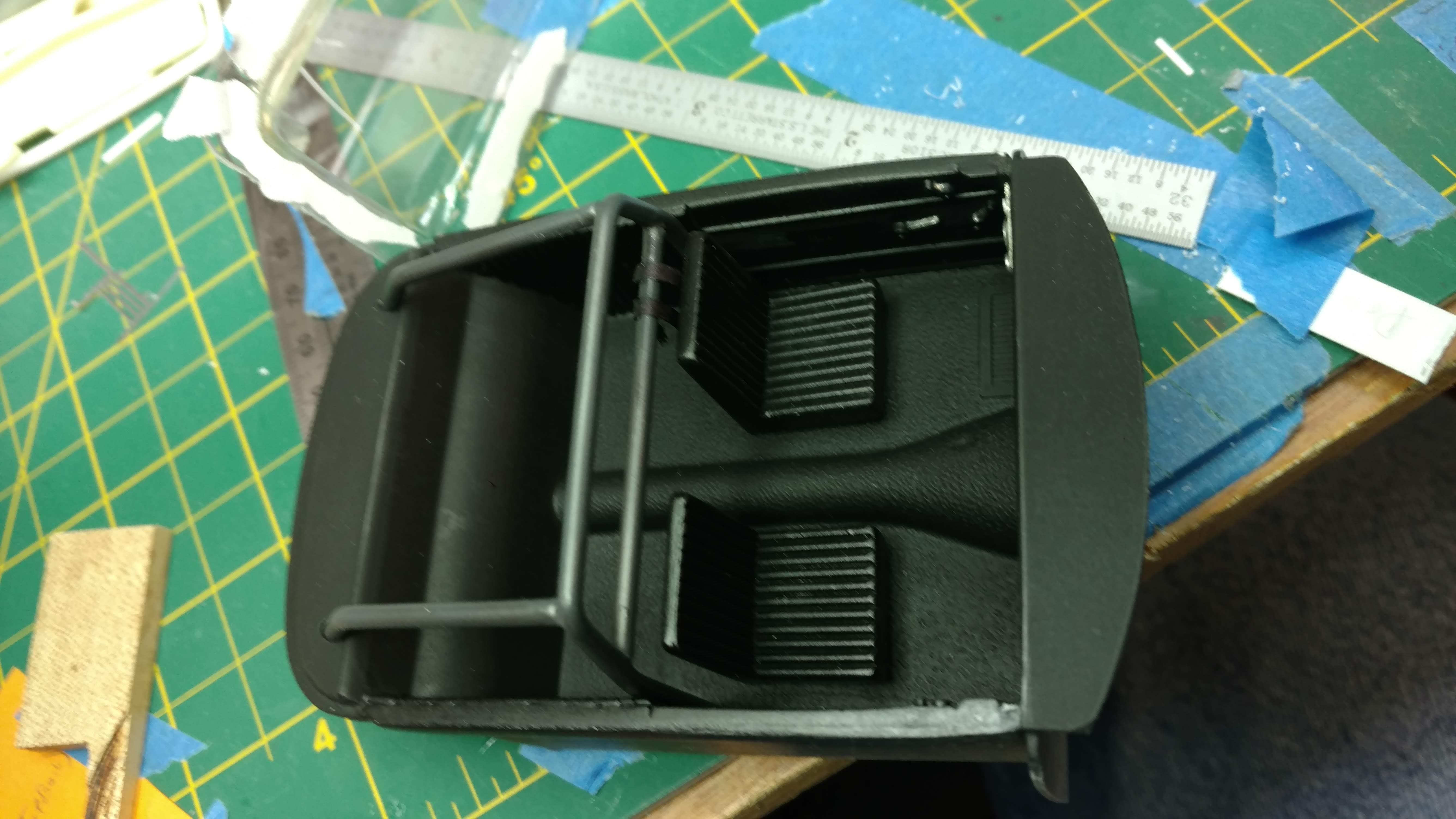

NOBLNG Posted 14 hours ago Posted 14 hours ago (edited) I bent up some 3/32” plastruct tubing for a roll cage with some soft wire shoved inside. It bends beautifully, but the moment I touched the bend with some Tamiya quick set, the styrene split. I eventually used CA for my cage which does not cause a problem. But then I tried another test. After bending I just quickly passed it over the flame of a butane lighter. The flame took all the tension out of the styrene. The middle bend has also had the quickset applied…but no cracking at all. I imagine it would work for solid rod also if it is prone to cracking. Edited 14 hours ago by NOBLNG 1
DJMar Posted 13 hours ago Posted 13 hours ago 37 minutes ago, NOBLNG said: I bent up some 3/32” plastruct tubing for a roll cage with some soft wire shoved inside. It bends beautifully, but the moment I touched the bend with some Tamiya quick set, the styrene split. I eventually used CA for my cage which does not cause a problem. But then I tried another test. After bending I just quickly passed it over the flame of a butane lighter. The flame took all the tension out of the styrene. The middle bend has also had the quickset applied…but no cracking at all. I imagine it would work for solid rod also if it is prone to cracking. One of the reasons I use CA in these situations, and I should have mentioned it. I've had some beautifully made bends crack apart with liquid glue, but I never thought to heat temper the plastic like that. Great tip, good to know!
Straightliner59 Posted 7 hours ago Posted 7 hours ago (edited) I would use brass rod, rather than aluminum, due to its rigidity. Also, Plastruct (non-styrene--ABS, maybe?) can be slowly bent, using the warmth of your fingers, and gentle pressure. That's how I do most of my cages, now. The rod I've been using was purchased in a lot, on Ebay. Edited 7 hours ago by Straightliner59 2

bobss396 Posted 2 hours ago Posted 2 hours ago I have a bunch of floral wire I use in Evergreen 3/32" tubing. The I.D. is 3/64" if it helps anyone. I pin sections and the cage to the floor using 3/64" brass rod for strength. I use plastic rod as well. I think it was Plastruct that had one with wire inside of it. I used that up a while ago. I should revisit their product line.

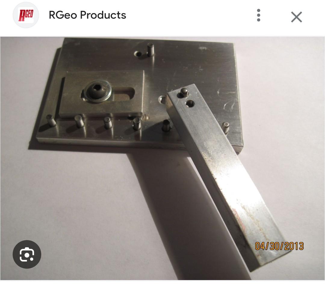

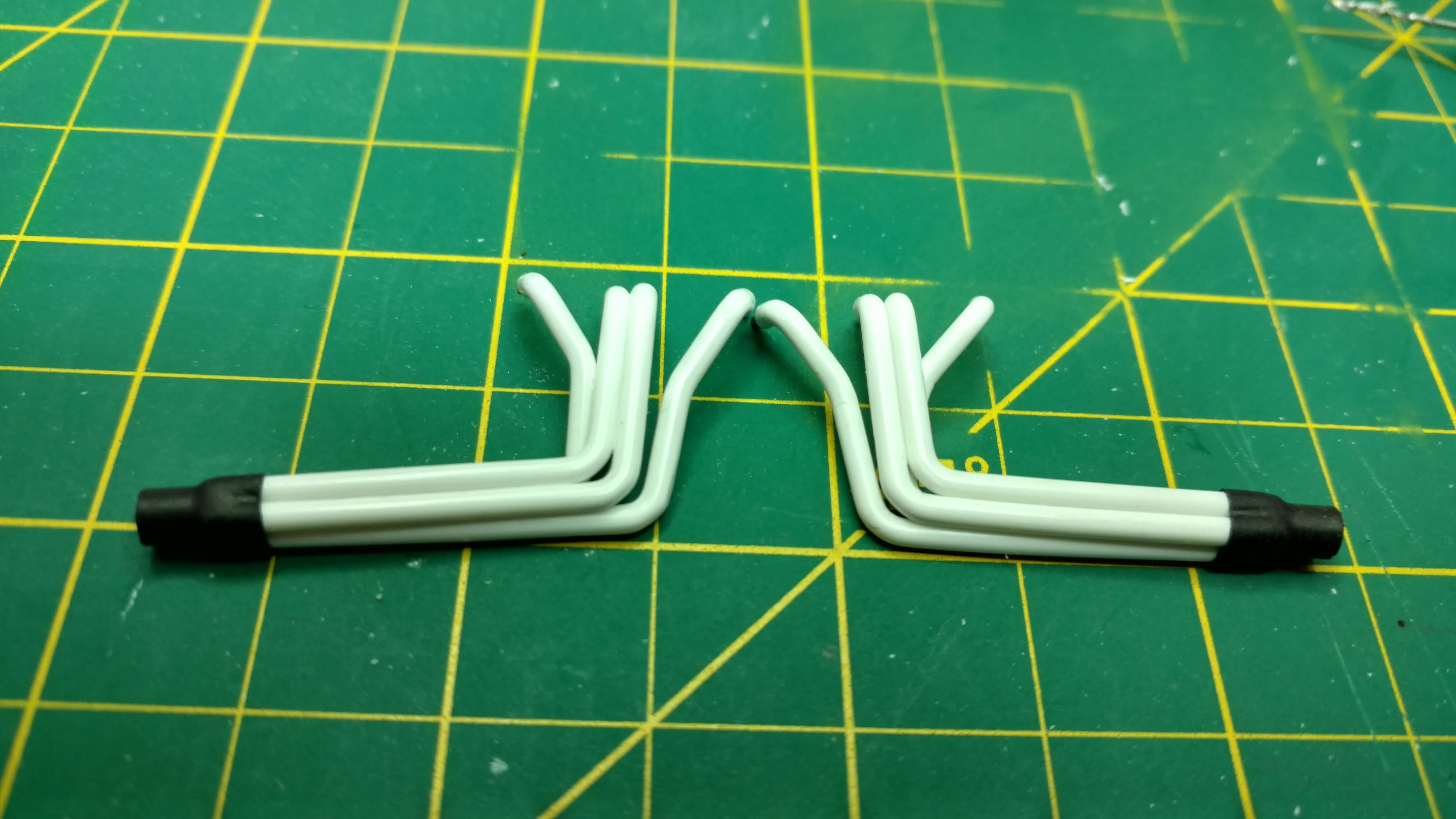

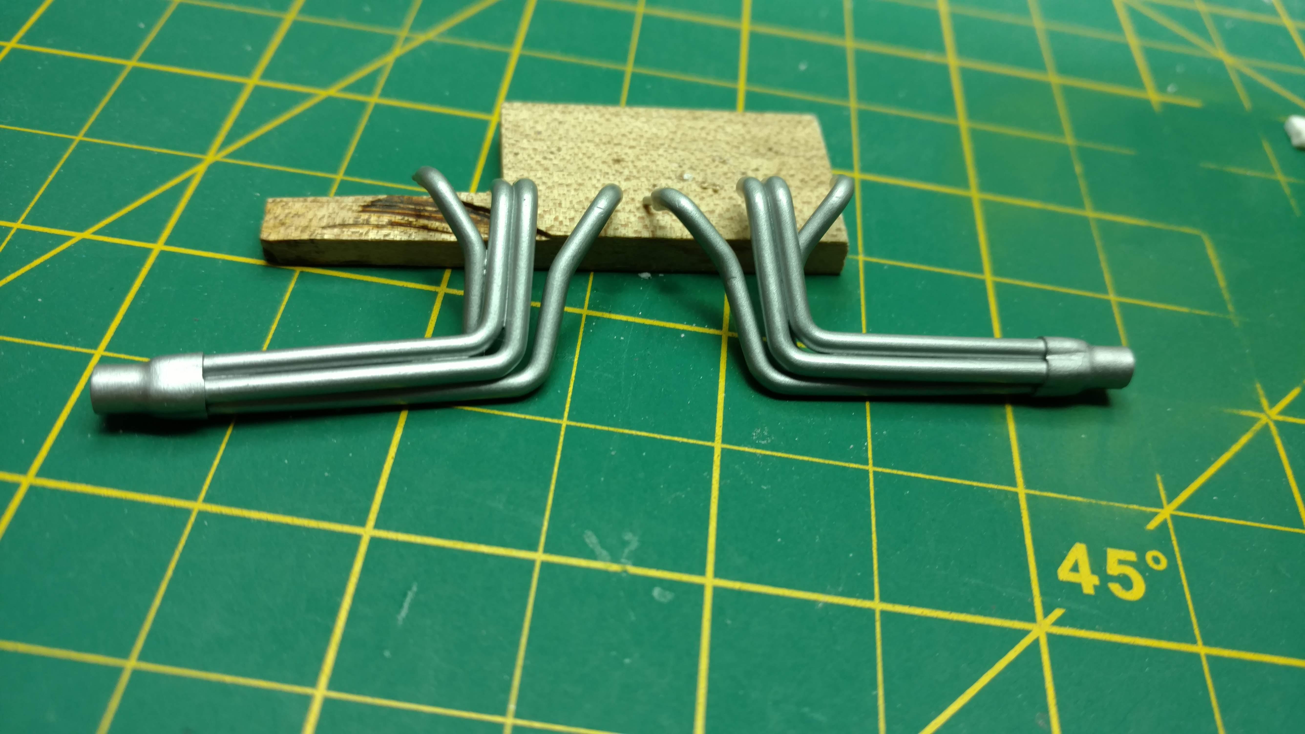

64SS350 Posted 2 hours ago Posted 2 hours ago (edited) As an alternative....I use solid styrene rod from a guy on eBay that sells it in lots. I have about a 97-98% positive outcome with his materials. I use a wire bender from my slot car days to do most of the work. Edited 2 hours ago by 64SS350 1
Beans Posted 1 hour ago Posted 1 hour ago 21 minutes ago, 64SS350 said: As an alternative....I use solid styrene rod from a guy on eBay that sells it in lots. I have about a 97-98% positive outcome with his materials. I use a wire bender from my slot car days to do most of the work. This right here ^^^^^^^^^^^ I tried tubing over and over and never got a good result. Then I read on forums that a lot were using the solid and it bent well and held and that has been working for me ever since. 1
NOBLNG Posted 1 hour ago Posted 1 hour ago 41 minutes ago, 64SS350 said: As an alternative....I use solid styrene rod from a guy on eBay that sells it in lots. I have about a 97-98% positive outcome with his materials. I use a wire bender from my slot car days to do most of the work. What wire bender are you using? Can you post a picture of it? Thanks.🙂
