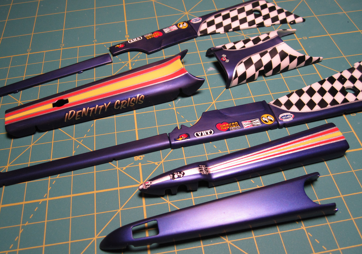

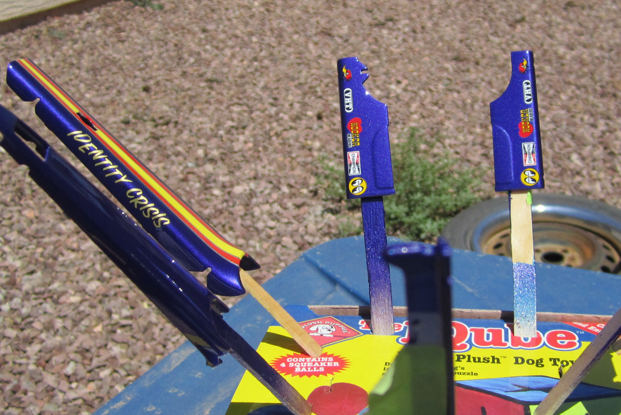

Mooneyzs Posted May 23, 2011 Author Posted May 23, 2011 (edited) Hello All, I haven't been able to work much on anything lately due to working 220 hours the past 3 weeks with work. I was finally able to take a little time tonight to work a little on my models and decided to get the decals on this project. Now I am ready for final clearing of the body and if I am lucky I will be clearing it next weekend.....keeping my fingers crossed. Thanks for looking. Edited July 13, 2017 by Mooneyzs
John Teresi Posted May 23, 2011 Posted May 23, 2011 Chris..........Beautiful.......absolutely stunning.
Mooneyzs Posted May 23, 2011 Author Posted May 23, 2011 On 5/23/2011 at 2:49 AM, John Teresi said: Chris..........Beautiful.......absolutely stunning. Thank you John! I didn't want to overdue it with decals but I needed just enough to bring it all together. I can't wait to get the last coats of clear and the final color sanding and rubbing it out. She will sure shine after that.
stump Posted May 23, 2011 Posted May 23, 2011 Chris, to say that looks stunning, would be a most under rated thing of all to say......................IT'S ABSOLUTELY JAW-DROPPING STUNNINGLY GORGEOUS !!.... Now, get in and finish it.... .......Please. Great work mate, and yes....very clean.
Mr Core Posted May 23, 2011 Posted May 23, 2011 Even without the clear it looks absolutely B E A Utifull. Can't wait to see this done. Big thumbs up
Mooneyzs Posted May 23, 2011 Author Posted May 23, 2011 Greg...Thanks for the kind words. It's much appreciated. I just hope that I don't have to work next weekend so I can get this bad boy cleared. You don't know how bad I want to get this build completed as well as work on my funny car. I have had that itch so bad lately of wanting to work on my models. It sucks I haven't been able to in the past month cause of work anyway hoping things will slow down and go back to normal. Mr. Core....Thanks, I had some dust in the clear where a few of the decals were going so I decided to try something different. I color sanded the whole model with 2000 grit paper to give a nice and smooth finish before apply the decals. Then I will go back and shoot another 3 or 4 coats of clear on it and it will get color sanded again and then polished out. This is the first time that I have laid decals down on clear that has been color sanded.

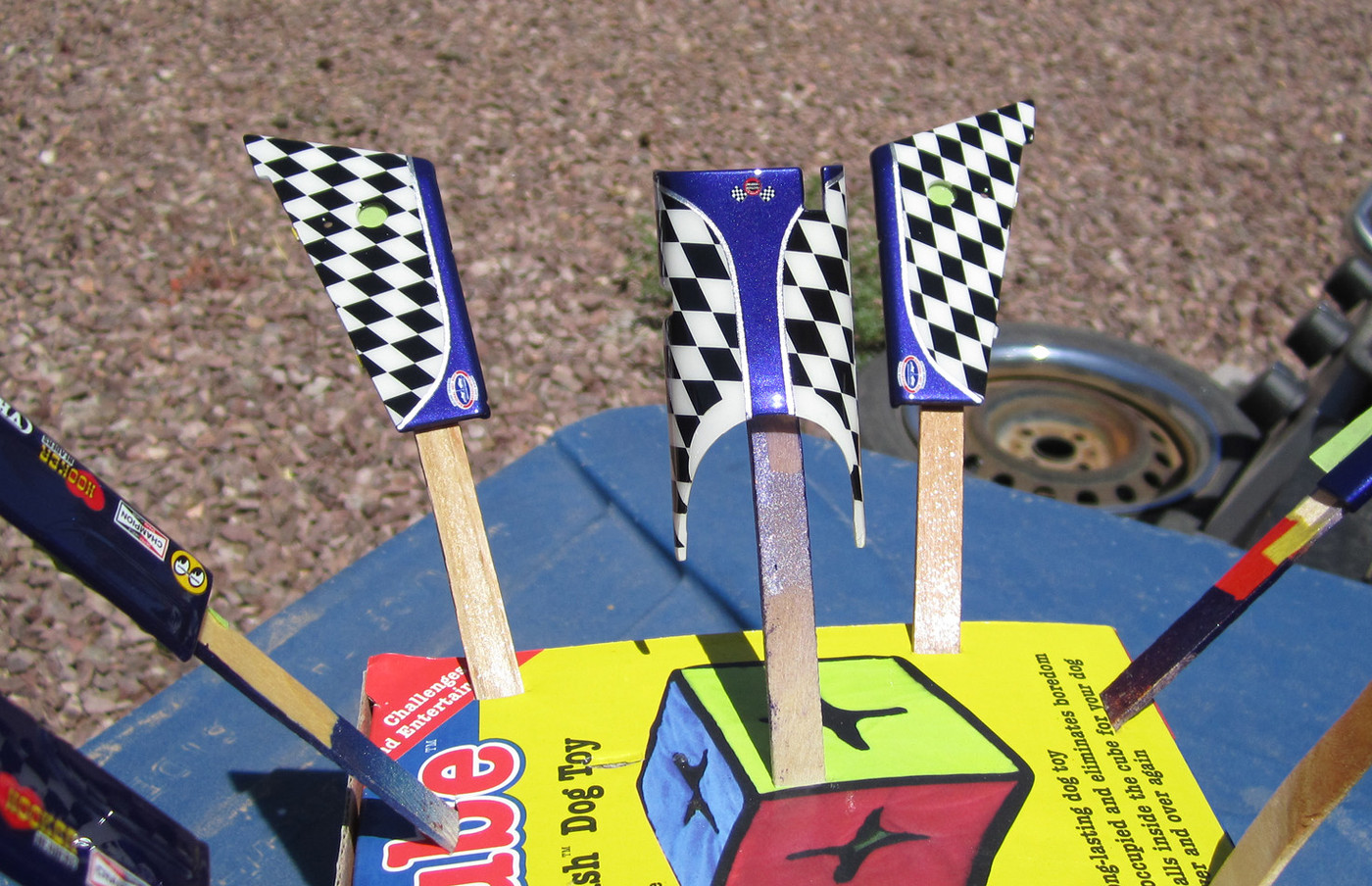

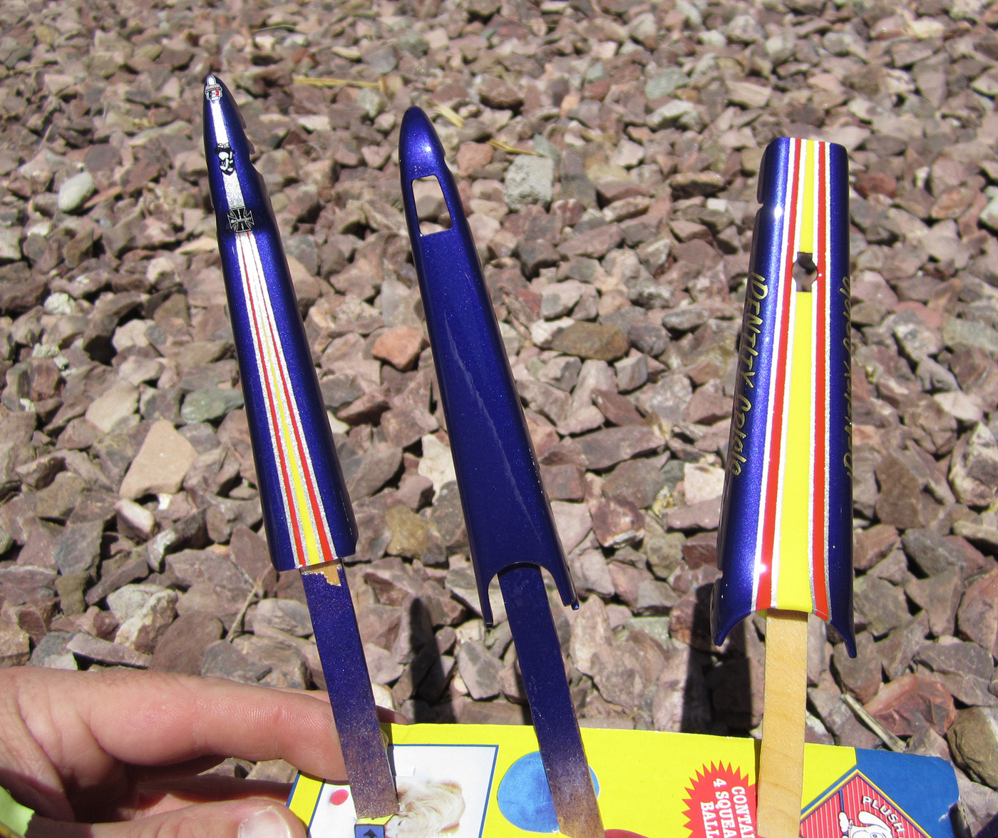

Mooneyzs Posted May 28, 2011 Author Posted May 28, 2011 (edited) After spending a couple hours this morning laying the final clear down on this build. I decided to go with 4 coats of clear since I will be color sanding and rubbing it out. Here are a couple of pics. Paint is still drying and probably be able to touch later tonight since I mixd it a little hot. Thanks for looking.... Edited July 13, 2017 by Mooneyzs
Len Woodruff Posted May 28, 2011 Posted May 28, 2011 Great job Chris. What color/paint is the blue/purple?
Mooneyzs Posted May 28, 2011 Author Posted May 28, 2011 On 5/28/2011 at 7:15 PM, Len Woodruff said: Great job Chris. What color/paint is the blue/purple? Thanks Len.... The color is a 1995 Ford color. It's called Ultra Violet Poly and the PPG brand code is 4979 and OEM code is M6717

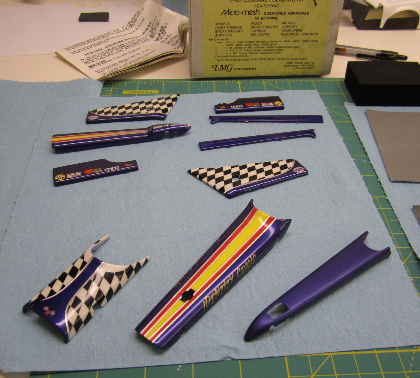

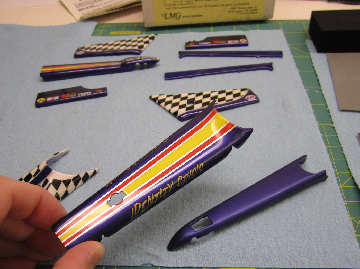

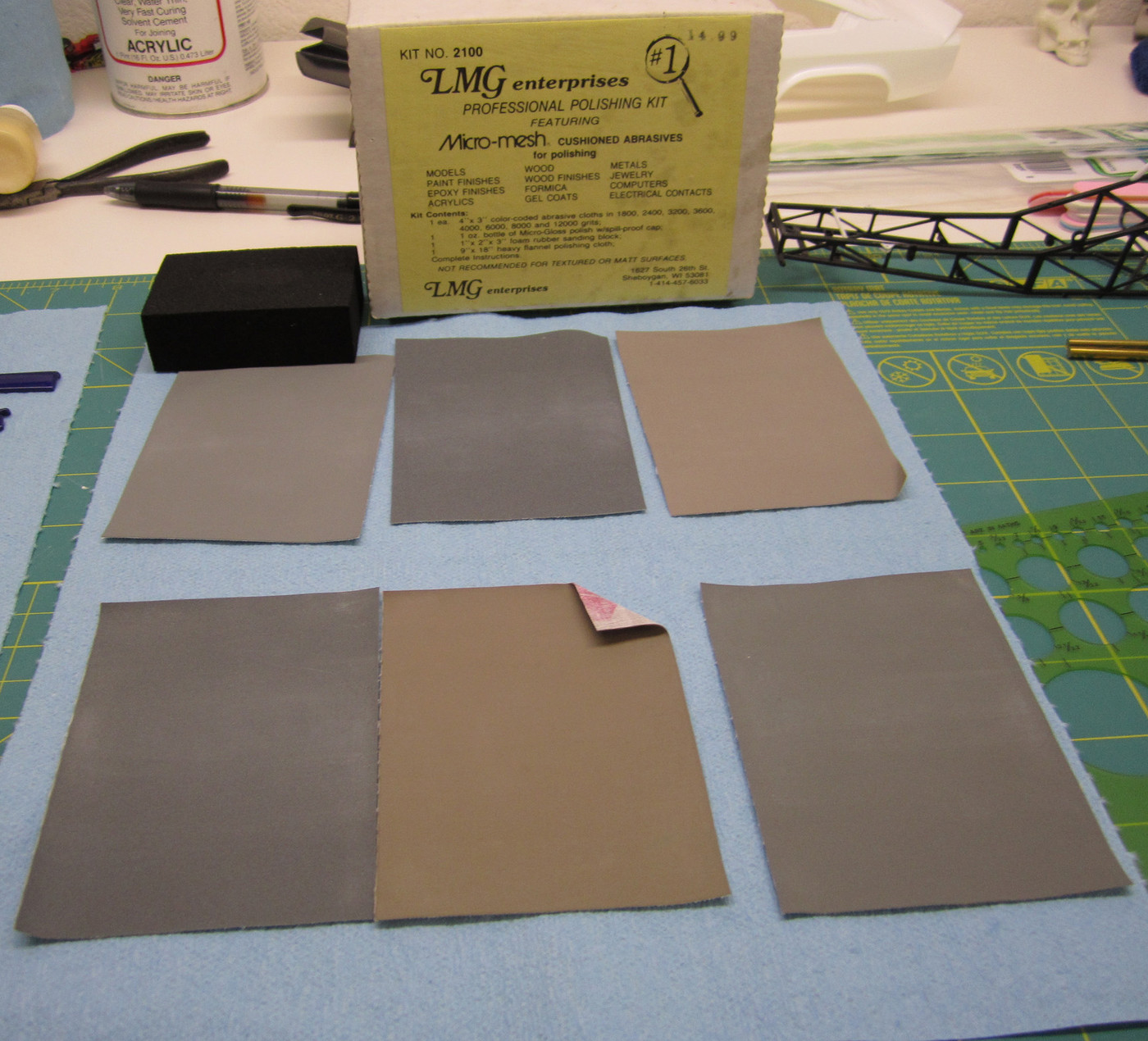

Mooneyzs Posted August 1, 2011 Author Posted August 1, 2011 (edited) Ok so in the mist of working on the Funny Car build I have taken a quick break to do a little work on this Front Engine Dragster. Yesterday I was able to start color sanding and polishing the body. I only got 3 pieces done so far and hoping to get the rest done possibly tonight so I can jump back to the funny car. Here are a few pics of this color sanded. Once I have all of the pieces color sanded I will then polish them out. Thanks for looking..... Here is the body again, the front 3 pieces have been color sanded. I started out with 3200 Grit paper and worked my way up to 12000 grit. Here is my LMG polishing kit that I am using on it. I will end up either using Mothers or Meguiars polish to finish them off. Here is kind of an up close view, this is with out any polish on the part that I am holding. The piece off to the right was only sanded with 3200 and 3600. will hit it with the rest of the grit of papers. Edited July 13, 2017 by Mooneyzs
