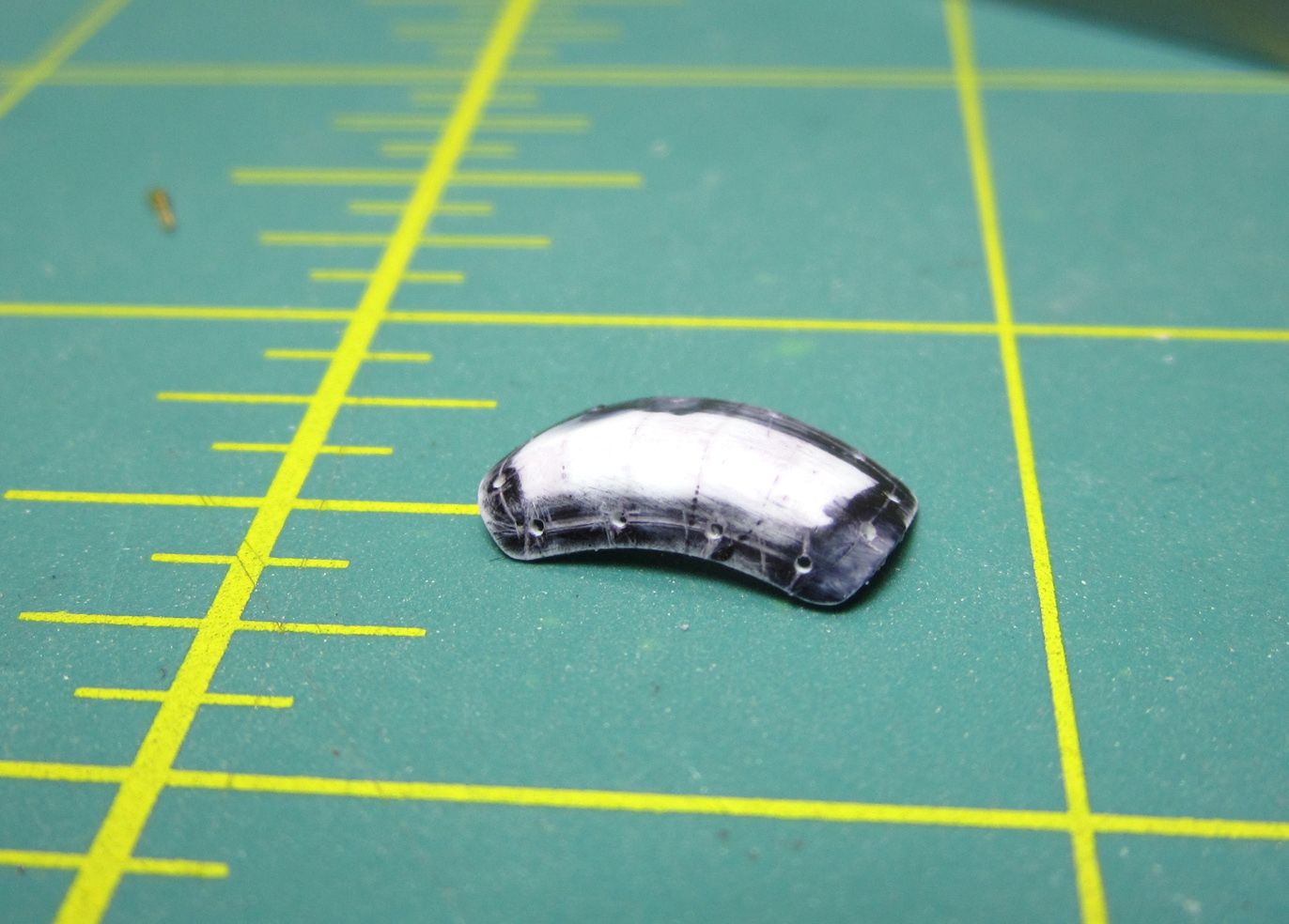

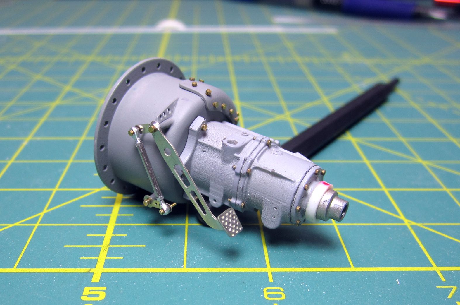

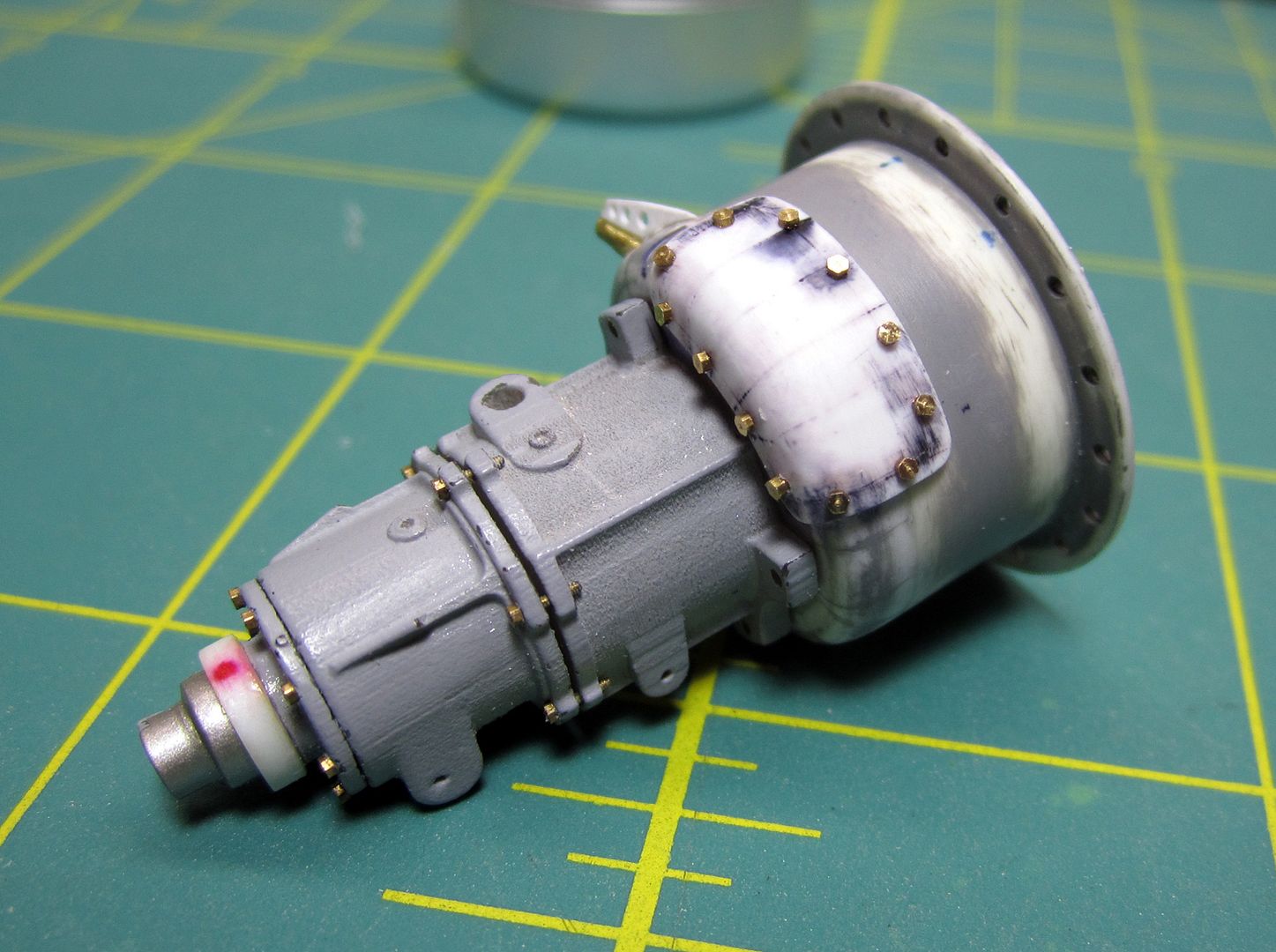

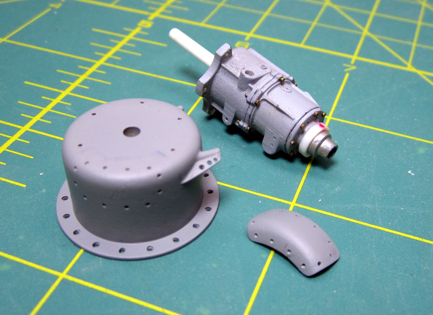

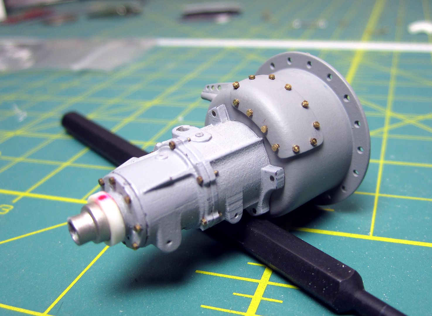

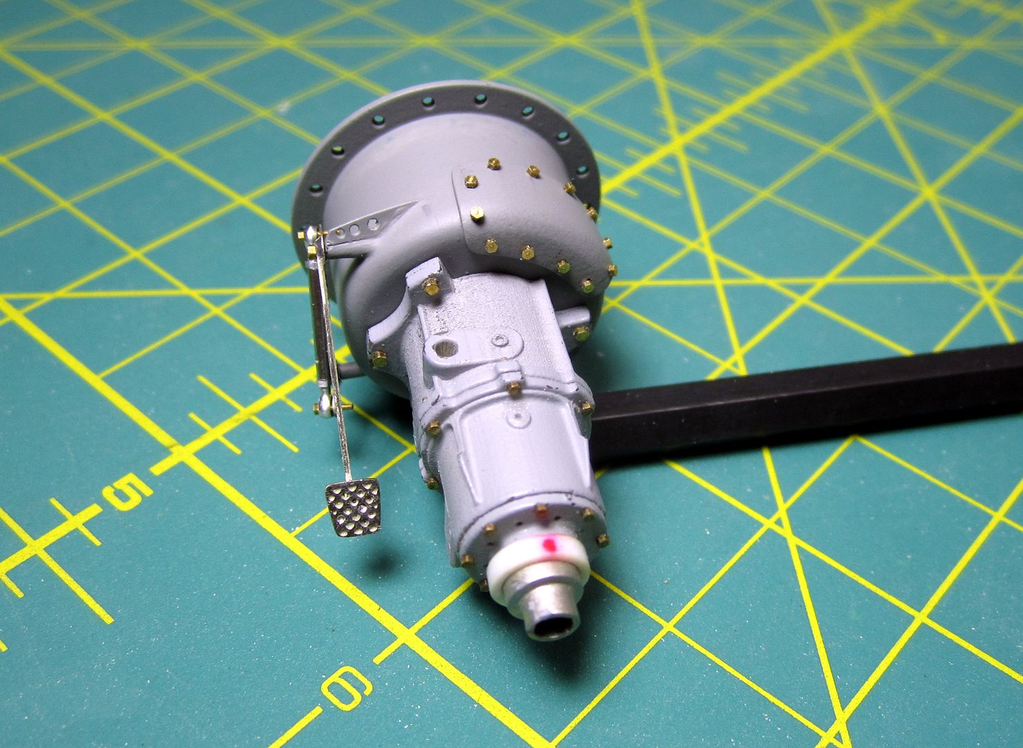

Mooneyzs Posted February 2, 2015 Author Posted February 2, 2015 Well I got just a little bit of work done. Not as much considering that I have been sick since Friday. Had a long week that had me wore out and run down to which I ended up getting sick. but I did get a little time in at the bench today working more on the Clutch inspection cover. Here are a few pics... Here is the final shape of the clutch inspection plate: Here it is test fitted on the bell housing with all the bolts in place: Here are the pieces primered once again. I was a little bummed my stupid can of primer took a dump and stopped working when I can tell there is still paint in it and it must of run out of the compressed air in it. seems my last two cans it has done this to me. not sure if it is because of the new nozzle plastikote has or what. so now I need to find some more of this primer. Although I do have some Tamiya and Napa brand primers I can use but I am a little leary mixing primers is all: Here is everything in place: I had to mock everything up again:
bobthehobbyguy Posted February 2, 2015 Posted February 2, 2015 Nice work. The clutch linkage looks great.
stump Posted February 2, 2015 Posted February 2, 2015 Simply............................A W E S O M E ! Chris, thanks a million for showing the best possible way to execute the fabrication for that compound curve on the inspection cover....Brilliant Sir! Now, go and take your meds as directed. Can you give us an expected completion date yet mate??? I just want to make sure I have an airfare booked so I can get over there and check this puppy out.....eyeball to eyeball........

Mooneyzs Posted February 2, 2015 Author Posted February 2, 2015 Bob.... Thank you Brayden... thank you, cheers! Greg... Thanks Mate!! I had to figurr a way out to make that compound curve and it seemed to work good by hearing the plastic up over a lighter, let the material get soft and then lay it over the part. Took a few trys to get what I wanted. I think you are right about me needing to go take some meds. I am hoping to have this done by oir desert scale classic here in april but no promises will be made. I Would rrallyblove to have it done in time for the GSL thought. Brad... thank you my friend. I realy appreciate it. Hey I need to give you a call this week. I think I want you to add a few other little decals in the mix. As I was looking at bell housings on line this weekend for details i was thinking I may need you have you make a few of the decals for trick titanium bell housing to go on the bell housing for added detail. that is if you don't mind and I was also thinking of the face for the oil pressure guage I need to make as well.

Petetrucker07 Posted February 3, 2015 Posted February 3, 2015 Outstanding work. That plate looks perfect. This is coming along nicely.

W-409 Posted February 3, 2015 Posted February 3, 2015 (edited) The most incredible build I've ever seen! What he said ! Fantastic work on that Clutch Inspection Plate. I would never had the idea of making it like that - and after looking at these pics, it must be the best, and probably the only possible, way to do it from sheet styrene. Very nice and clean work with that whole clutch / transmission assembly. When it's painted I bet it will be hard to tell if it's real or model. Edited February 3, 2015 by W-409

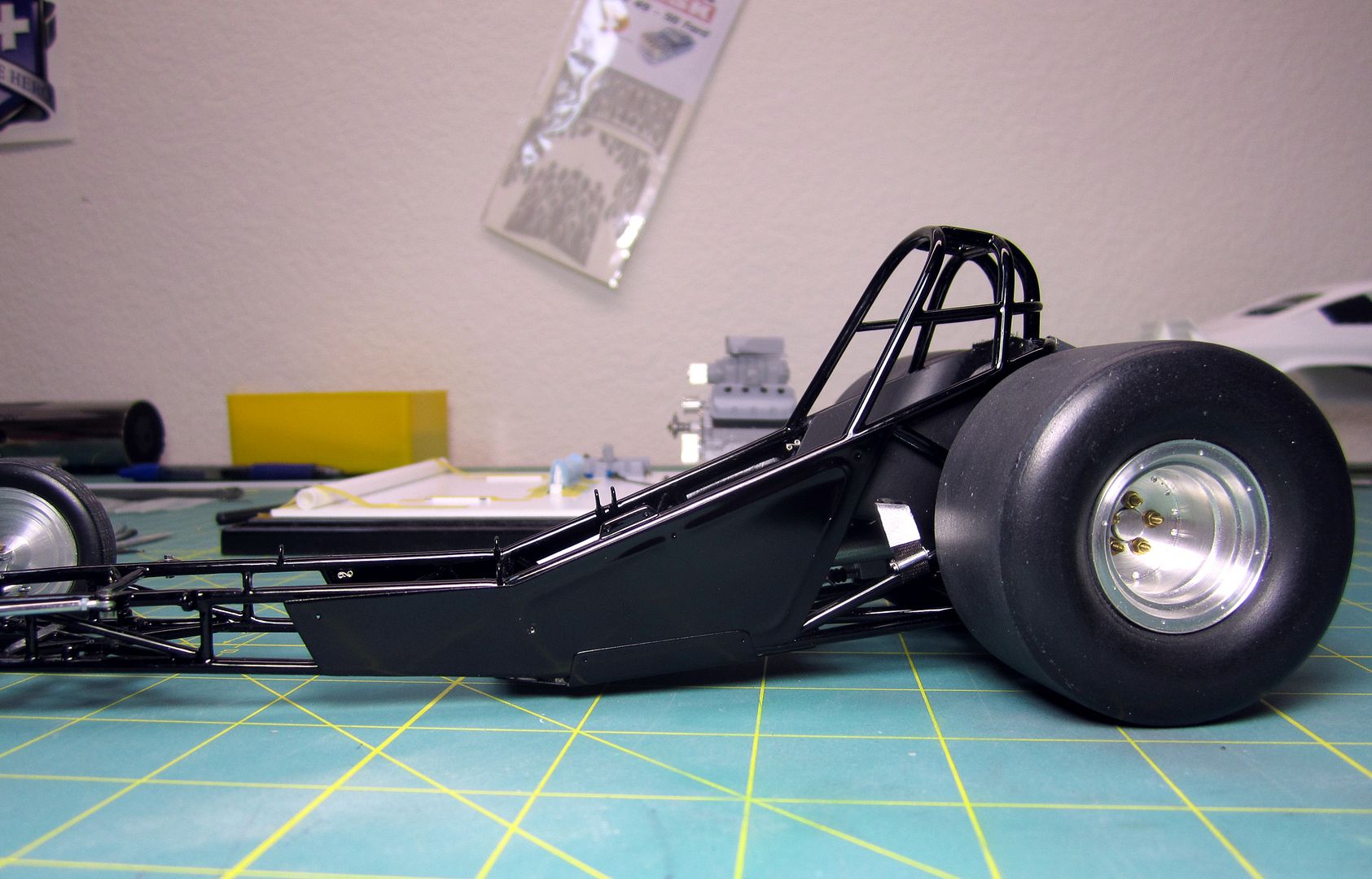

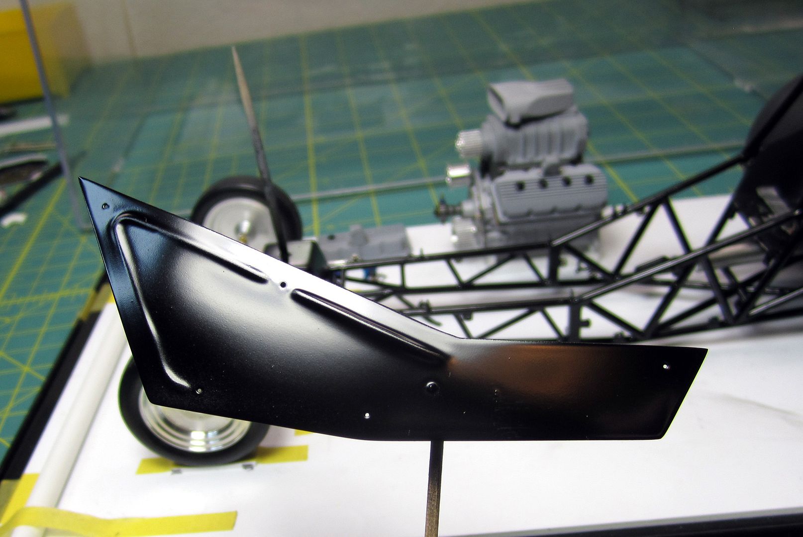

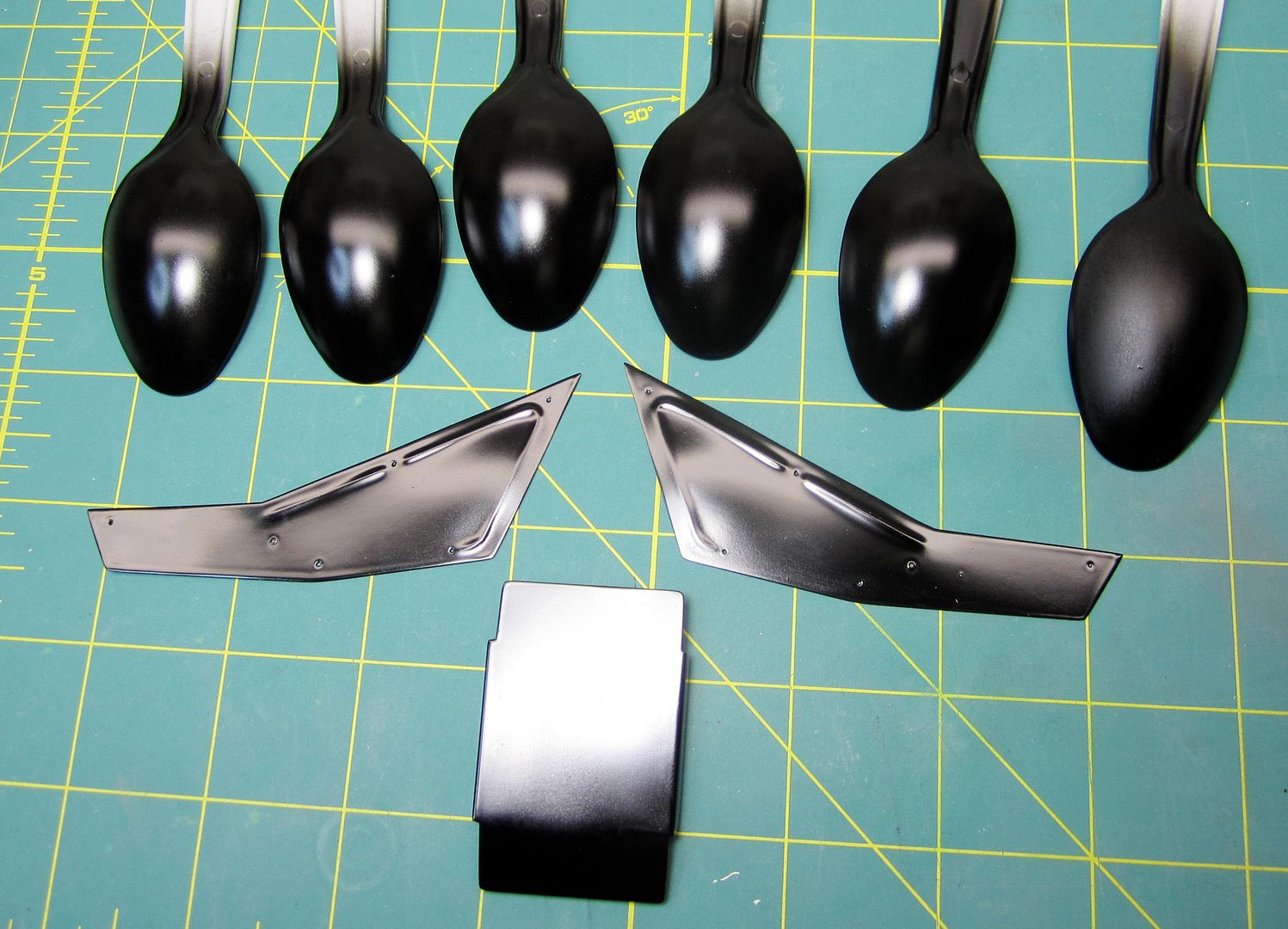

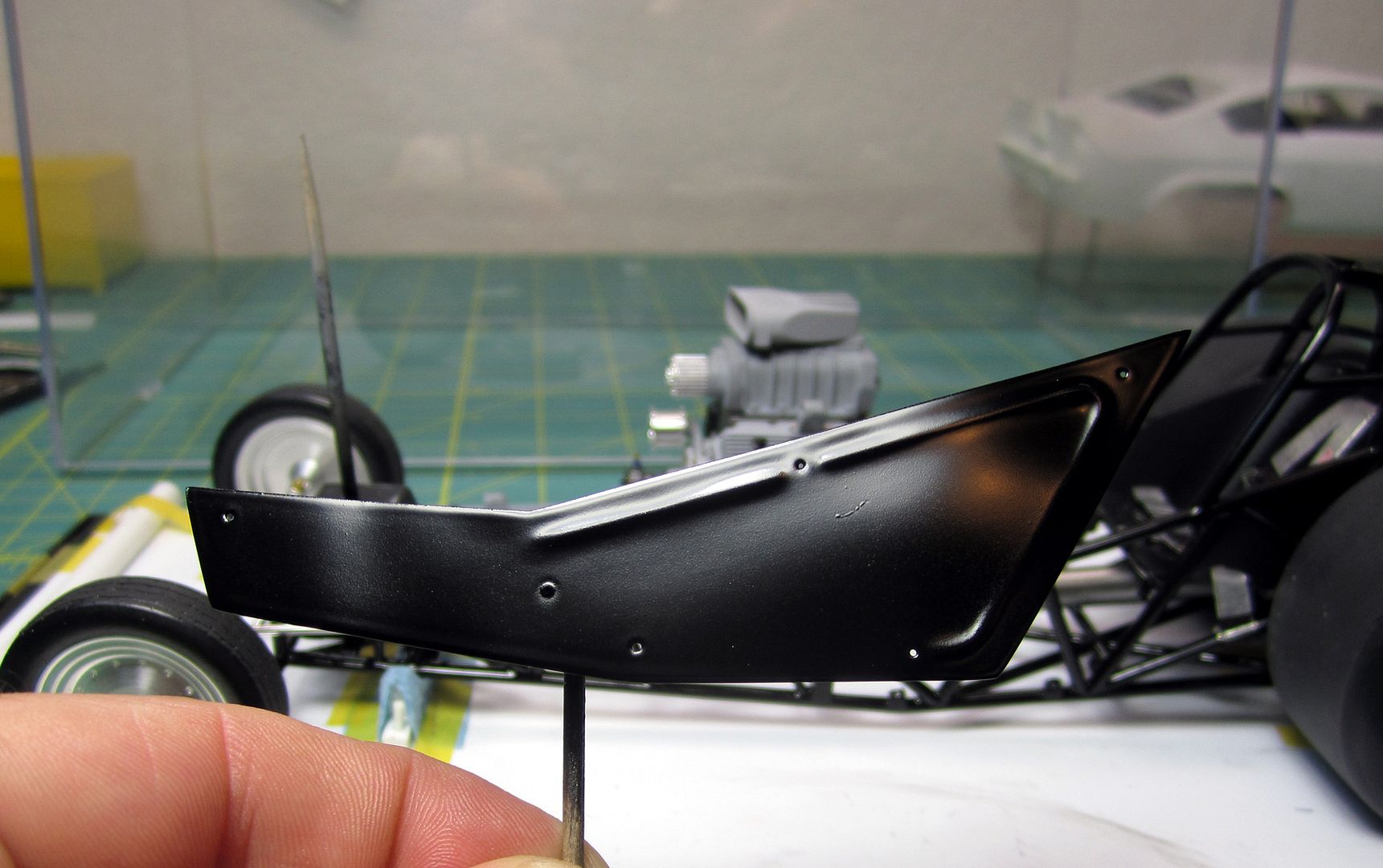

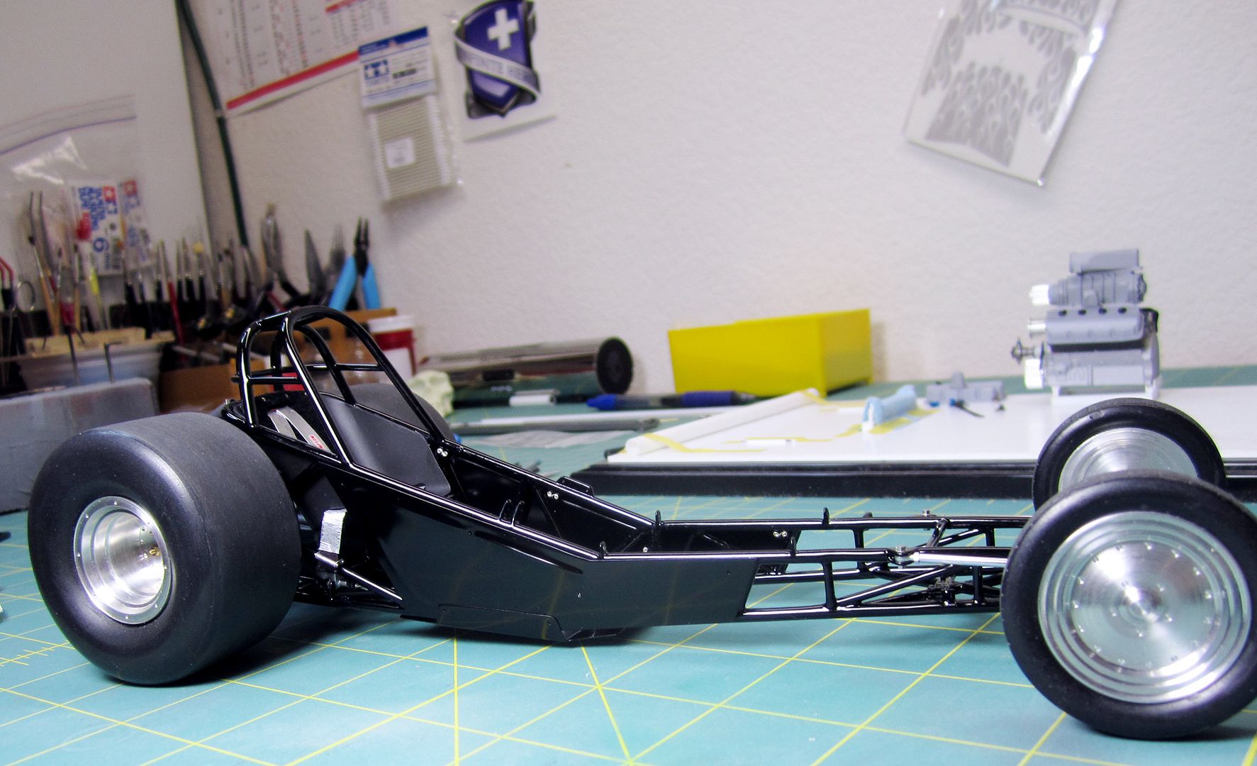

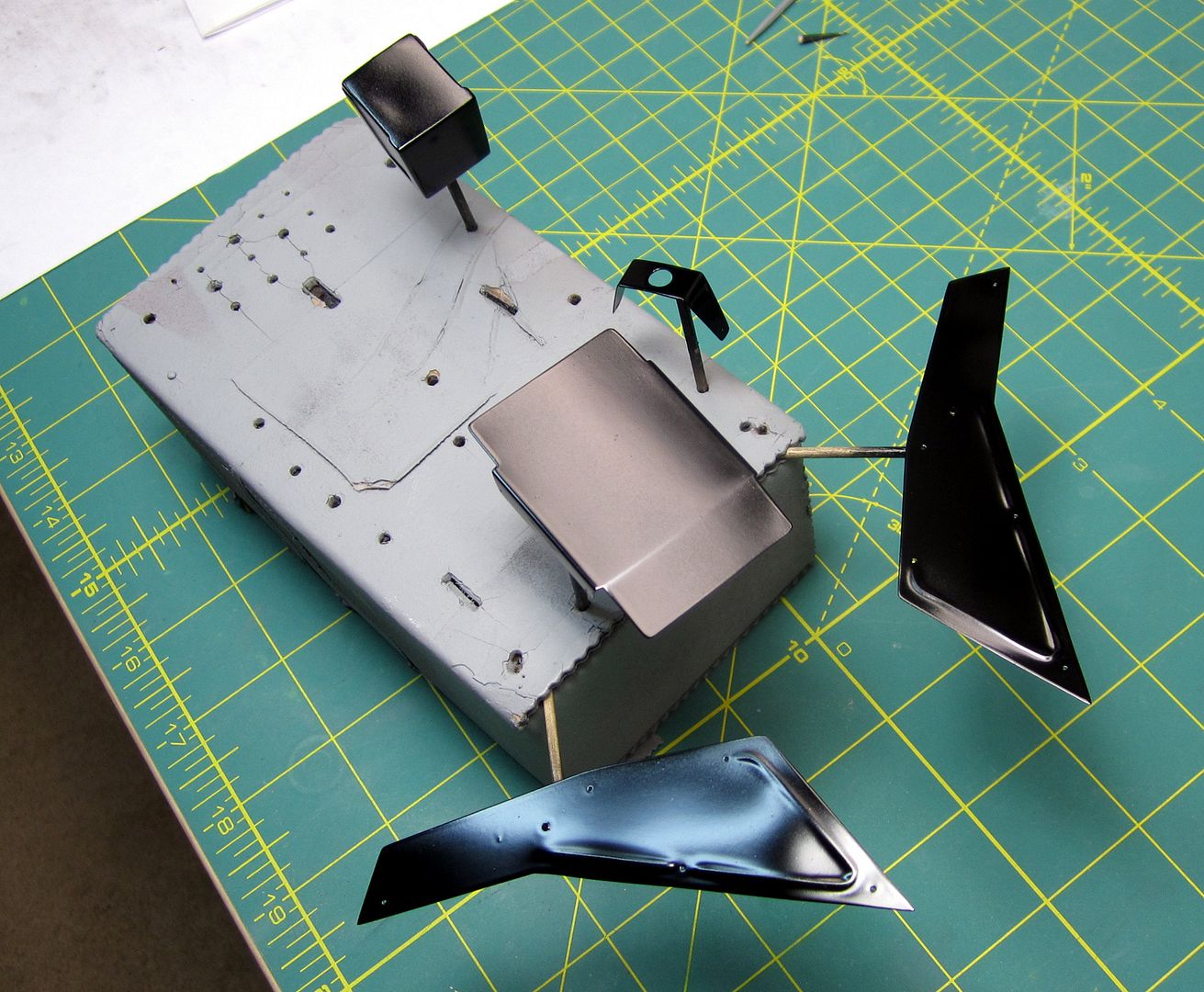

Mooneyzs Posted February 8, 2015 Author Posted February 8, 2015 Hello All... well I resprayed the chassis tins. They turned out somewhat ok but got some dust in them and I need to alter the sheen just a little bit more so yes I am going to do the inevitable and sand them down once again to redo them but here is how it turned out today.... Here are all of the parts painted: Right Side: Left Side, and you can see a mark on it. I was dumb and when I was moving things on the box holding the parts I hit it against another part to create that mark. Yeah I was mad at myself...lol: Another shot of it thrown on the chassis:

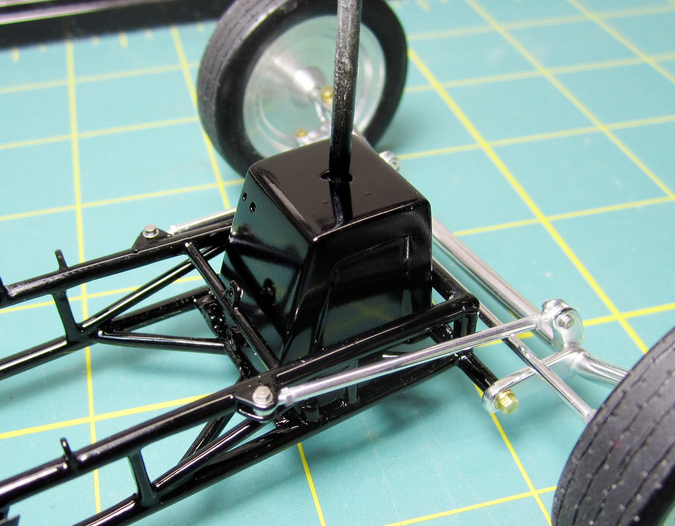

Mooneyzs Posted February 8, 2015 Author Posted February 8, 2015 (edited) Here is another view of the other side: Here is the fuel tank and as you can see I got a couple nice pieces of dust, why couldn't it of been on the bottom side...lol: So in this pic its really hard to tell but the chassis tins I sprayed with the Hot Rod Flatz Chassis Black which is 50% Gloss & 50% Flat.... After I sprayed the tins I decided to do a Spoon test and mix some of the Chassis Black with the Hot rod Black. The hot rod black is a mixture of 30% Gloss & 70% Flat. so I mixed a half an ounce of each (basically 50/50) to see how it would turn out it definetly wasn't as glossy as the chassis black which was what I was wanting. Its a little hard to tell in the picture but when I do repaint these I will mix it with a little more of the Hot Rod Black so its not as shinny. probably like 40% chassis black and 60% Hot Rod Black so it has less sheen in it: I am pretty sure you are all thinking that I am nuts for wanting to repaint these parts once again but I am looking for a certain sheen of these parts so it gives some contrast between them and the chassis. That is the reason behind it. Edited February 8, 2015 by Mooneyzs
