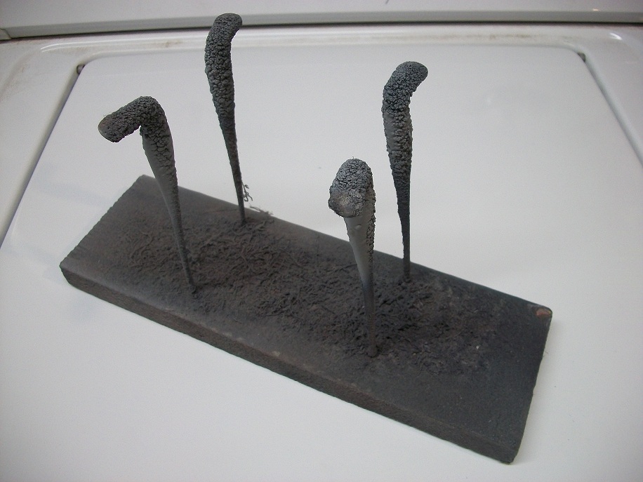

Guest Posted June 17, 2012 Posted June 17, 2012 I use this or old paint cans. Built this in 92. Looks like it's time to build another. Just a little paint buildup, lol.

SSNJim Posted June 18, 2012 Posted June 18, 2012 I use this or old paint cans. Built this in 92. Looks like it's time to build another. Just a little paint buildup, lol. That is almost identical to mine. We must have read the same article.... I finally chipped all the paint build up off mine, so it's down to the wire again. The wood base still has all the paint buildup.
