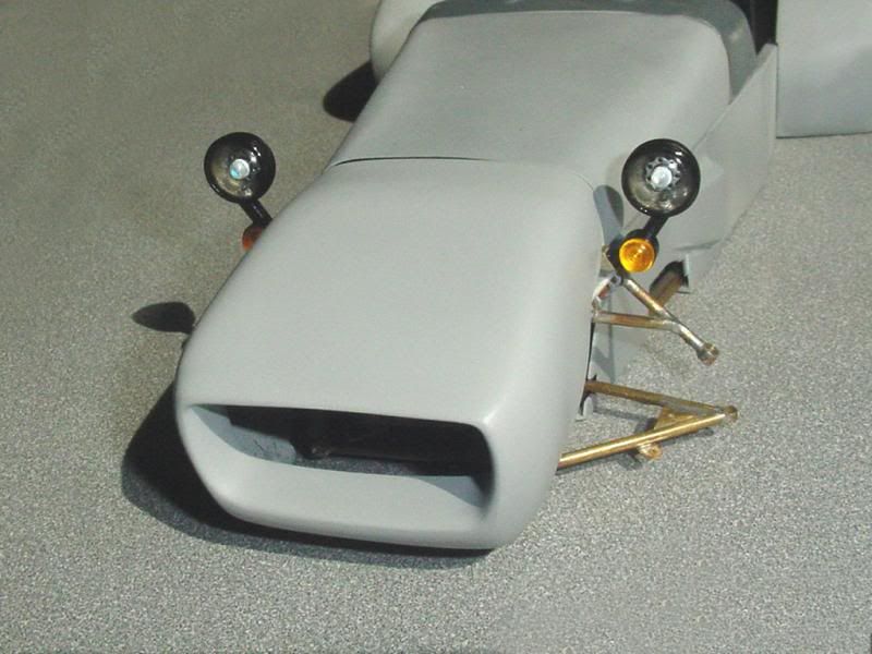

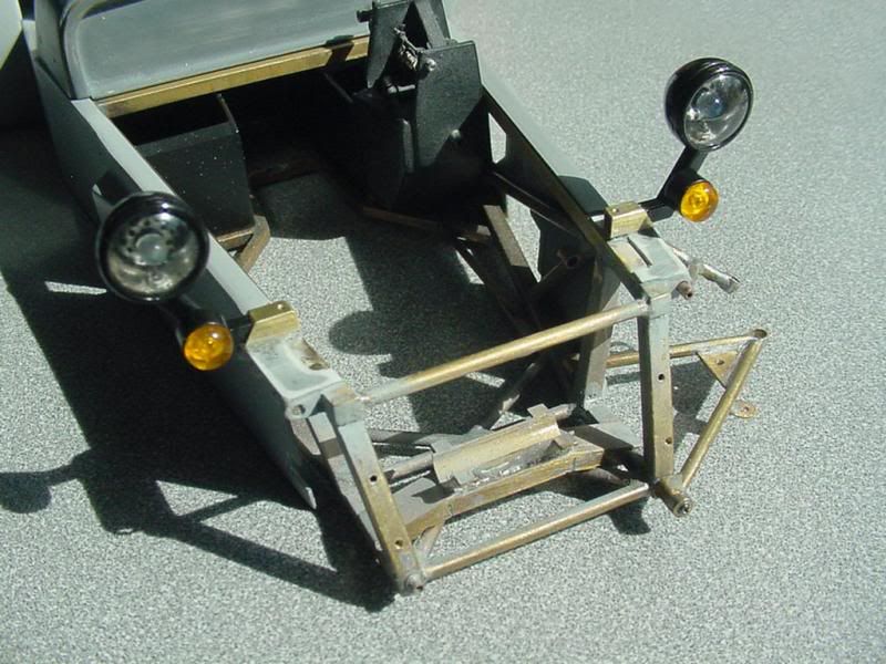

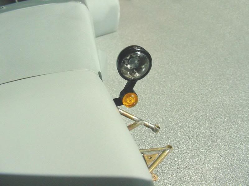

The headlight/turn signal assemblies are done (except for the wiring that will come out of the stems).
I changed the interior color of the housing from bright silver to a flat pewter/steel tone. The turn signals also have bulbs in them now.
The stems mount to brass receivers installed to the frame. On the real car they are removable by pulling out one bolt and unplugging them for track time.
The notches I cut into the nose piece for the mounting receivers make for a nice positive locking fit for the nose.
Mark... Awesome work on those headlights. they are out of this world. What was the physical bulb made from. Again Nice work on this one.
That thing looks great Mark, you ever thought of having the 7 scribed into the lens like Chip Foose did on Impression with the V8
Mark, you're pushing the envelope to the point she's gonna blow!
some beautiful examples of the level of modeling skills you've mastered.

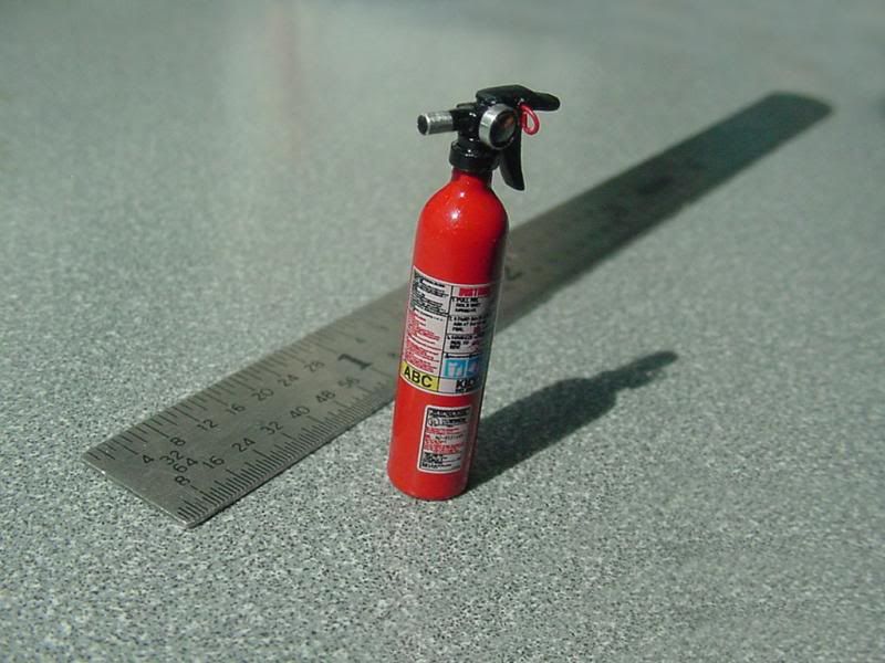

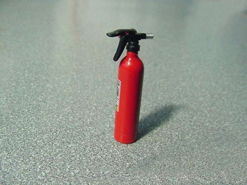

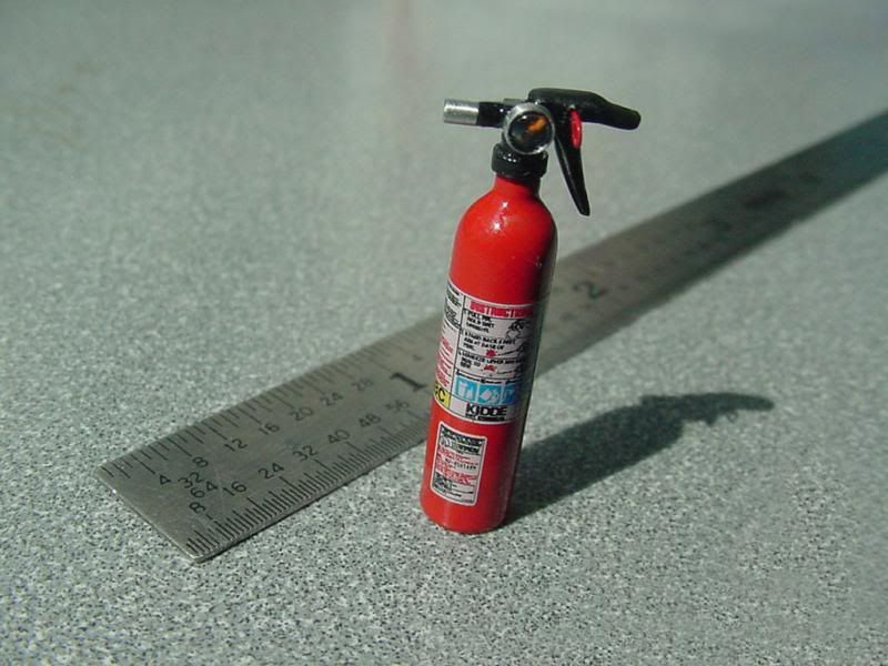

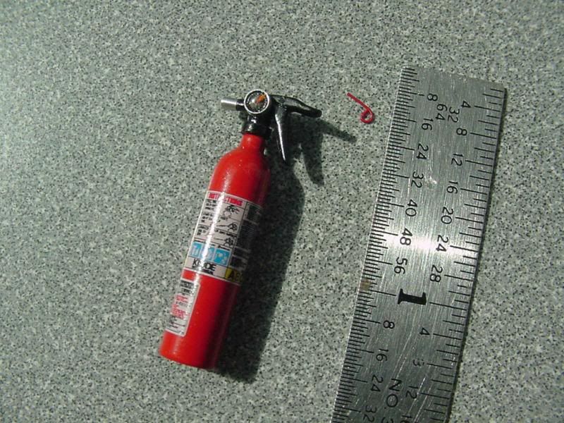

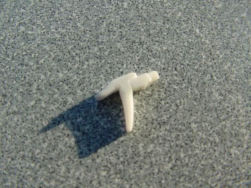

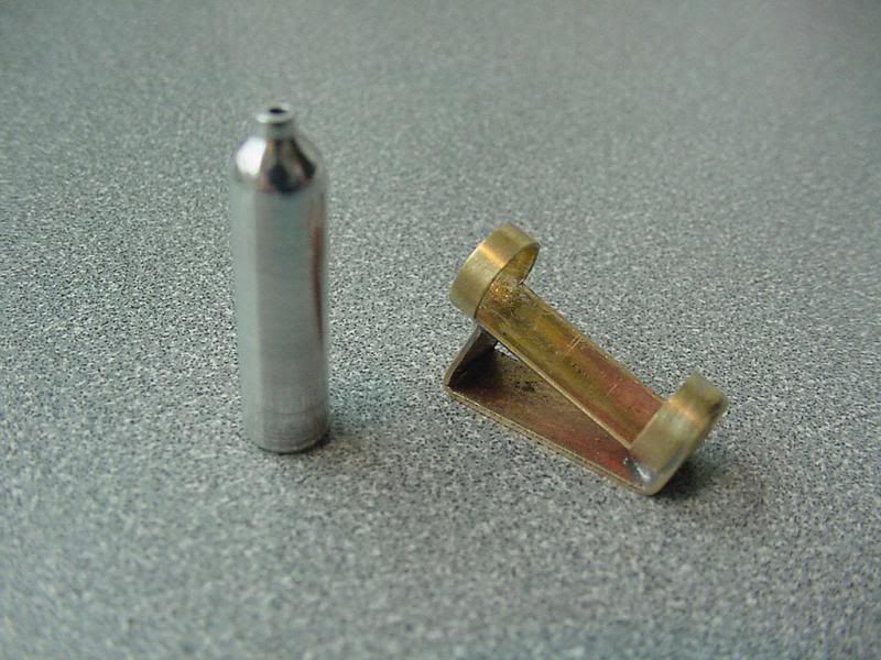

These are the four main sub-assemblies for the fire extinguisher. 15 individual pieces (counting the needle and lens for the gauge). Three custom made decals.
From the right, the nozzle, the bottle, the holder and the hold down strap.
Thanks guys!

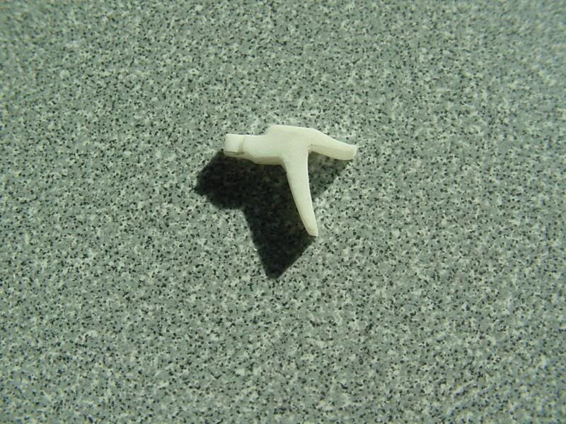

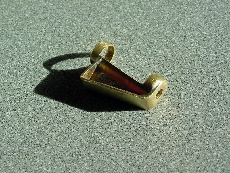

The last piece for the extinguisher is done, the safety pin…
…and it is assembled.

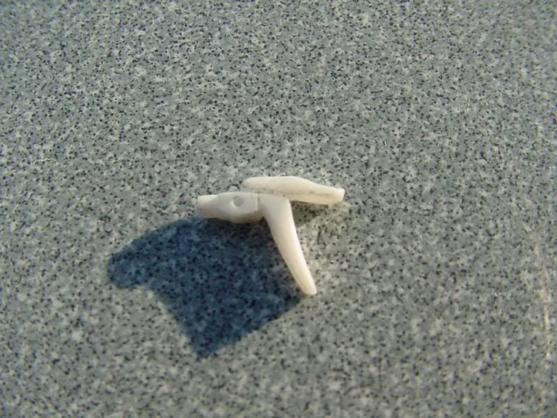

The pin does go all the way through to the back… The one I copied has a little barb on the pin, (no chains required).
Could u please show us how you made the decals. I can only rob them from other kits. Some times they are not even close. Just some random sponsor on a racecar. You evidently have broken the code. Your stuff is really real.

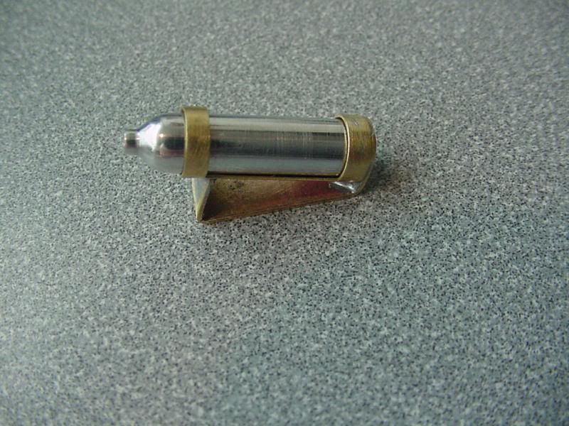

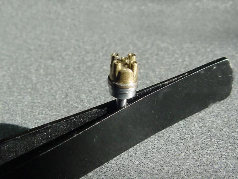

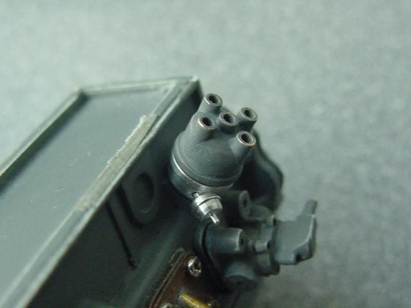

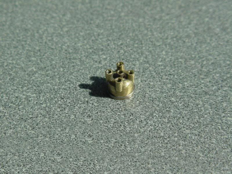

The distributor cap; I started making it from brass tubing, but ended up machining it after I soldered it together, it is still all brass and solder.
The distributor itself was machined from aluminum.
As was the vacuum advance canister.
Great job as usual I don't even know anything else to say about your work its just so incredible.

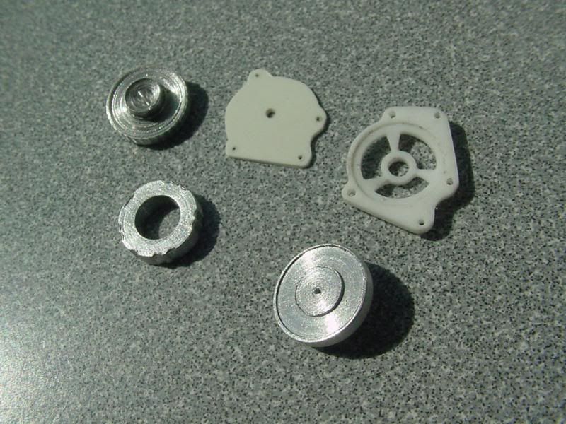

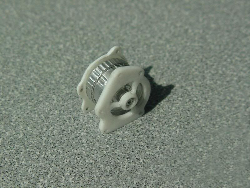

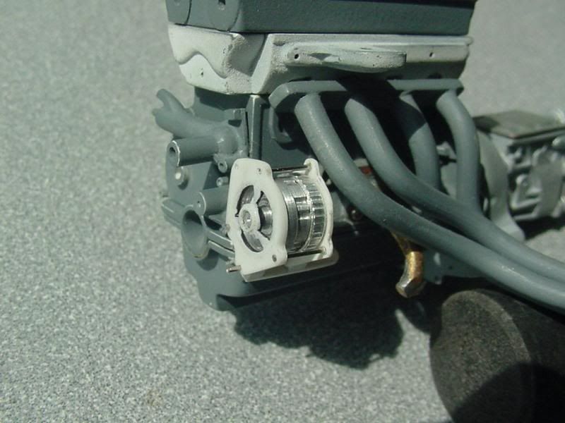

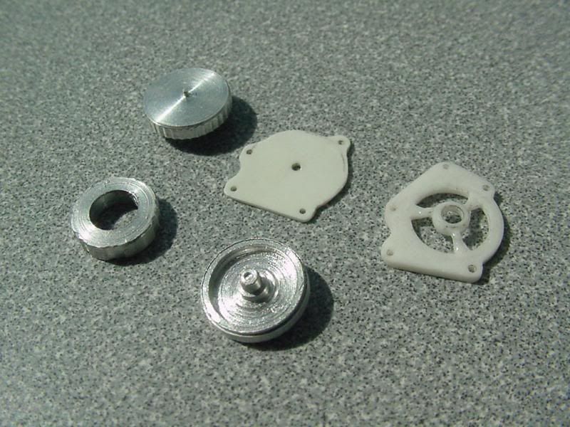

Beginning of the alternator. I freehand milled the front from resin. The main parts are aluminum. The back plate is styrene.
Three steel pins hold the assembly together.
Loose test fit pending other parts of the pulley system that need to be made.
Mark you are one of several people on the forum who are able to make individual pieces models in and of themselves. That is some incredible scratch building!!
