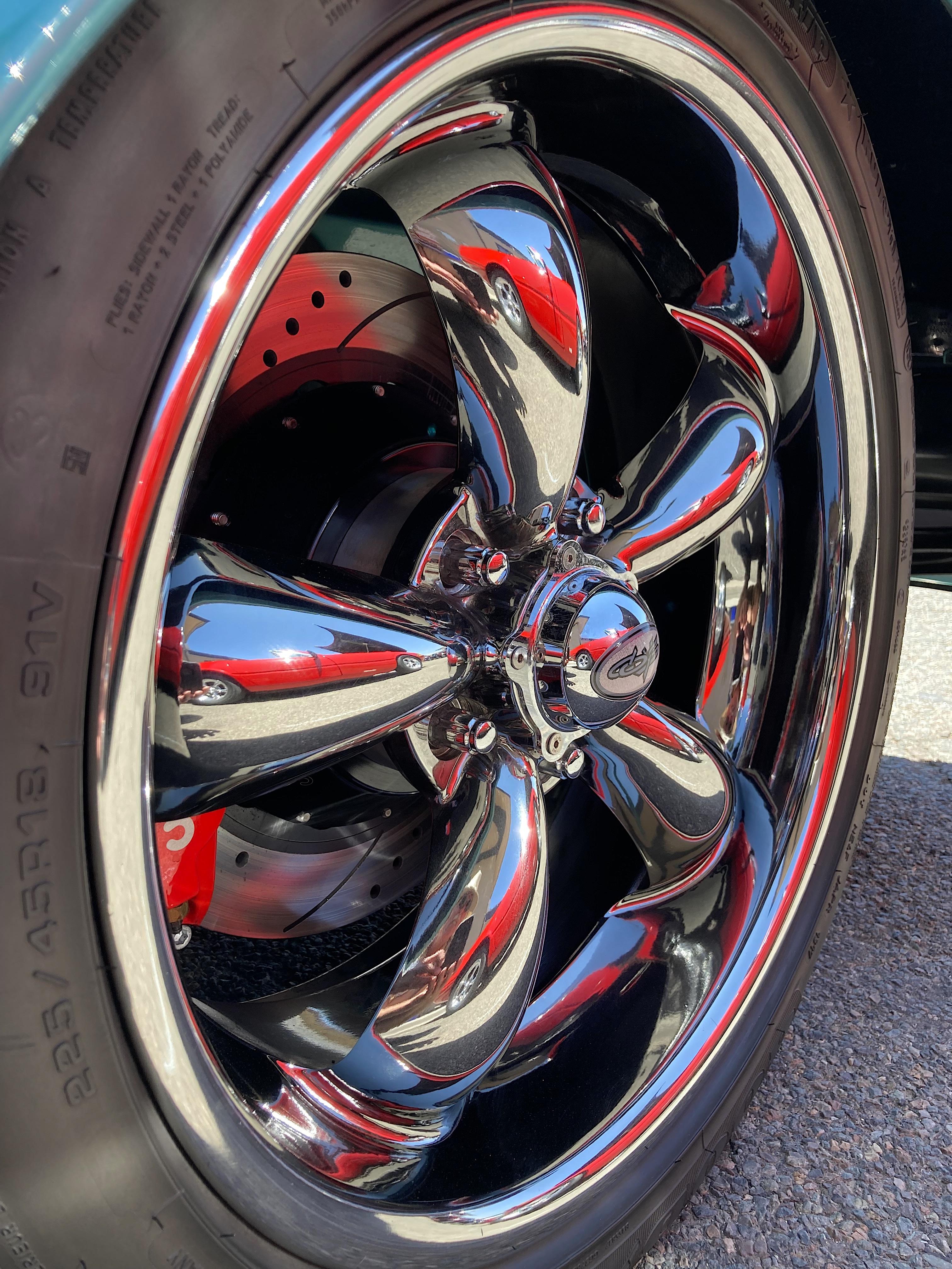

89AKurt Posted June 7 Posted June 7 On 6/5/2025 at 5:39 AM, Ace-Garageguy said: Here's something to be happy about: if it was a real Ferrari, the job would have probably set you back $4500...just because. I know right? Got this because it's a Chevy, little did I know... 🙄 I'm always amazed how perfect some guys can make their cars. I mean look how shiny these smoked chrome wheels are, it's disgusting. 3
meechum68 Posted June 7 Posted June 7 7 hours ago, 89AKurt said: I know right? Got this because it's a Chevy, little did I know... 🙄 I'm always amazed how perfect some guys can make their cars. I mean look how shiny these smoked chrome wheels are, it's disgusting. Yeah that is horrible! I mean you can even see the chrome in them... who does that! But great shot! I like odd shots and that is a great one! 1
