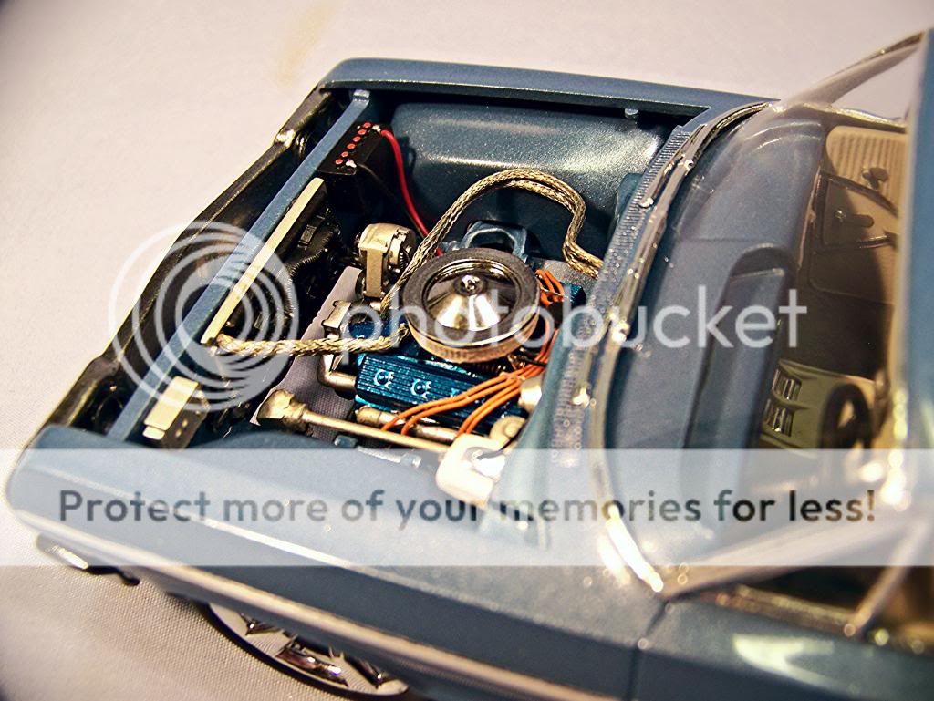

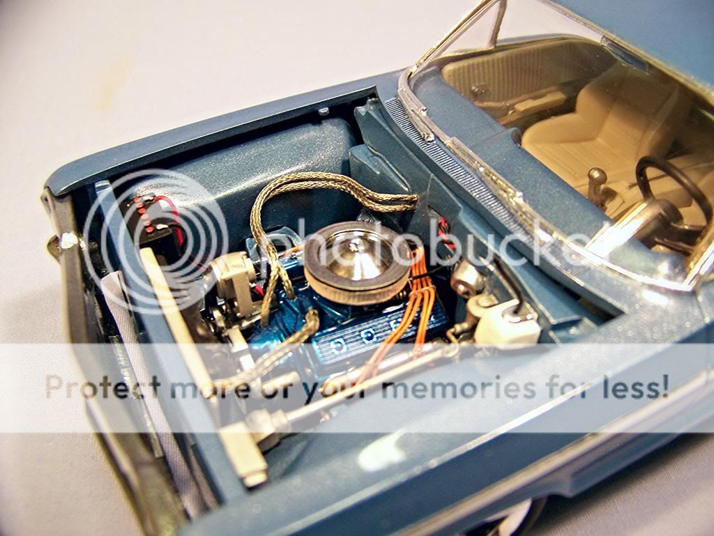

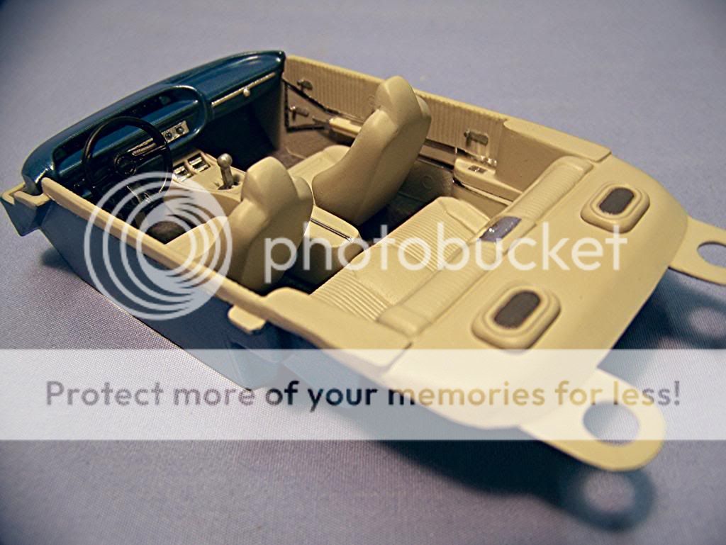

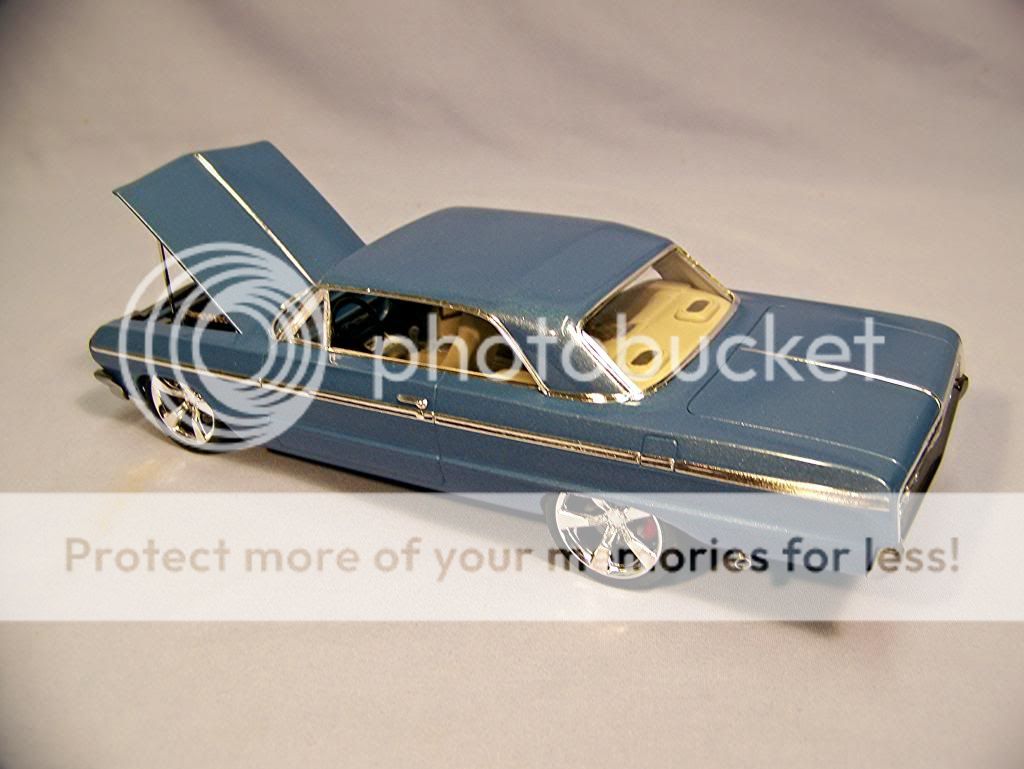

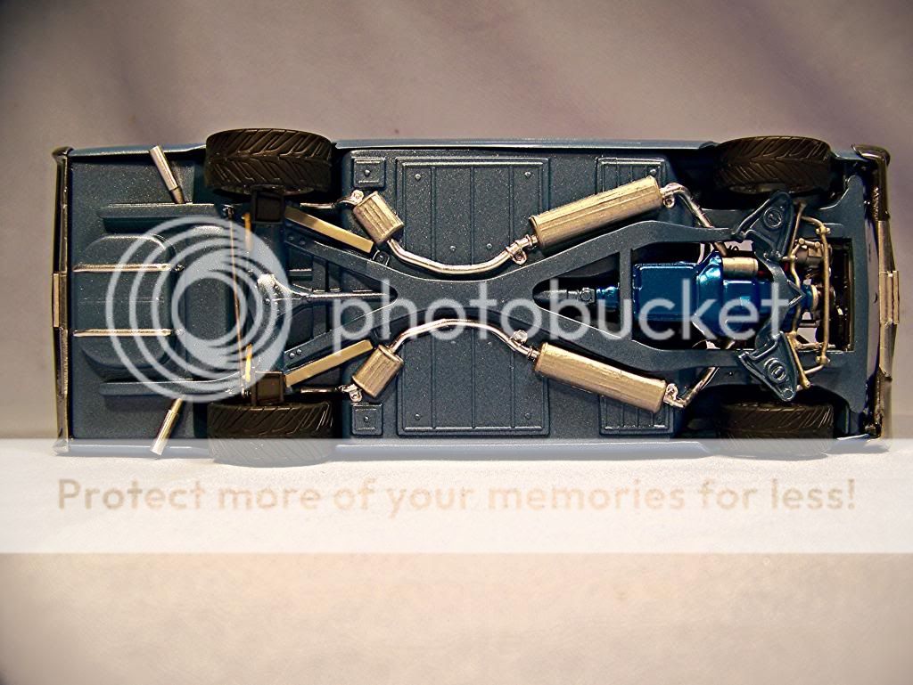

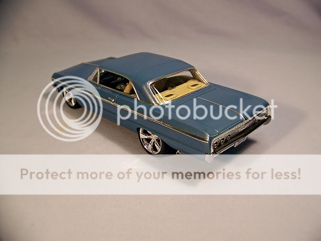

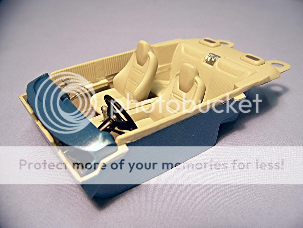

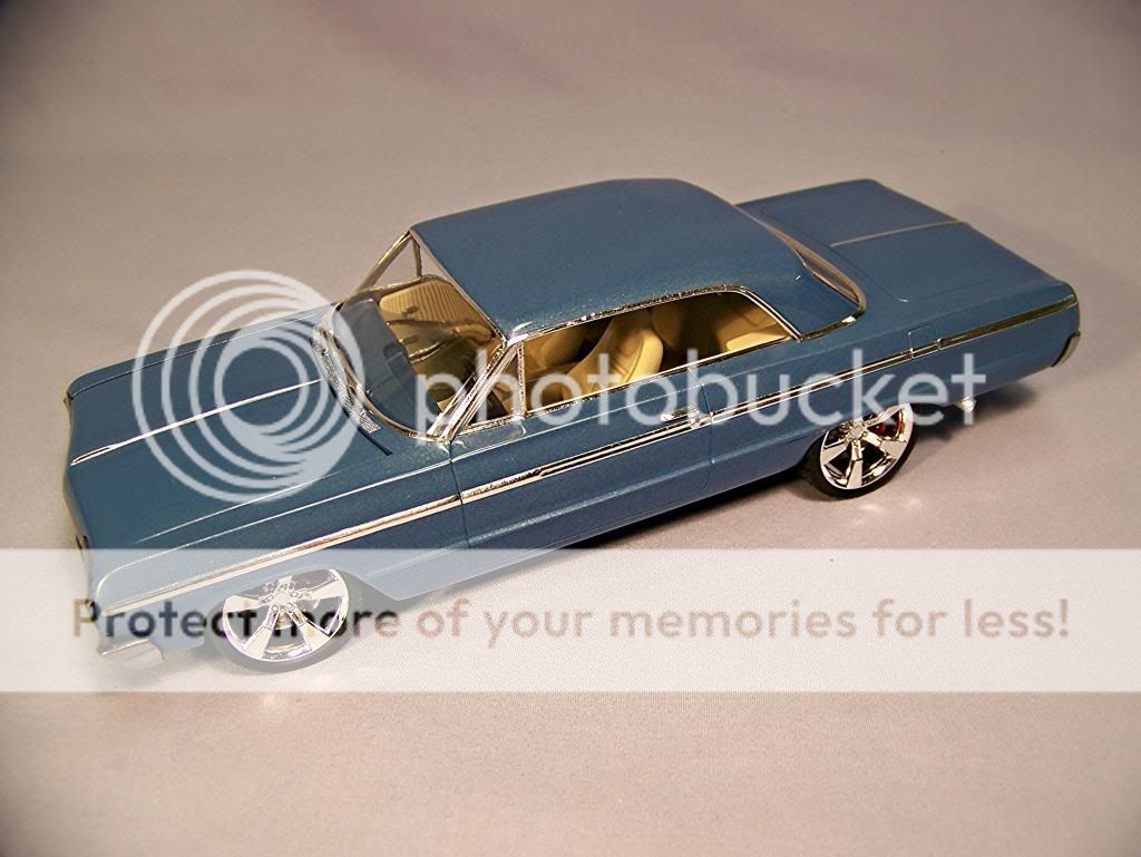

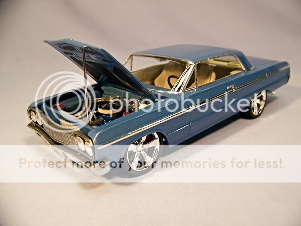

modelcarcrazy Posted December 2, 2013 Share Posted December 2, 2013 (edited) Hello, This is the AMT 1964 Impala SS. I named it "Jarhead" in memory of my Uncle, Coy Doty Harris (1947-1999). Coy was a husband, father, brother, football coach, and a former Marine. Coy loved hotrods and muscle cars and fueled my love for them as a young boy. He drove a '64 Impala for several years and loved every mile of it. This is my version of his dream ride, I know if he were still with us he would want one just like this. I chose the AMT kit because it needed some help and I tried to help it all I could. I went light on the body mods, I removed the emblems and script from the body sides, trunk lid, and grill shell. The paint is three coats of Dupli-Color GM LIght Blue Met. with six coats of Dupli-Color clear polished out with a Millennium 2000 polishing kit. The bumpers and grill were stripped and painted with Alclad chrome and the bumper inserts were covered with matte aluminum BMF. The wheels, tires, and brakes come from the Revell Concept Camaro snap kit. The tag frames come from the Revell 1967 Chevelle. I made the hood insulation out of black construction paper. The engine come from the Revell 1994 Impala SS snap kit. I made my own pre-wired distributor and wire loomes. I made the throttle linkage and return spring along with the radiator support and filled the hole in the firewall for the metal clip that represented a hood hinge. I also made the radiator and heater hoses. The radiator and electric fans came from a Revell 1998 Corvette. The upper control arms and steering box and steering rod came from the Revell 1967 Chevelle. The air cleaner, battery, and control module come from my parts box. I made the plumbing and wiring for the master cylinder and wiper motor out of some scrap bits of wire. Battery cables came from Scale Dreams. In the interior, I made the window cranks and door handles out of thin aluminum and plastic rod, I also made the gas and brake pedals out of thin aluminum. The modified console, shifter, steering wheel, steering column, and bucket seats come from the AMT Concept Camaro. The arm rest and rear view mirror came from the Revell 1967 Chevelle. The speaker grills came from the AMT 1967 Impala. The flocking is from Ken's Custom fuzzy fur. The underside, I cut away the molded in front suspension and boxed in the frame with sheet plastic and added a modified front suspension from a Revell 1967 Chevelle. In the rear area, I filled the indentions on the corners of the trunk floor pan, where the screw holes used to be, with sheet plastic and worked them down smooth. I made the shock and track bar brackets and added modified shocks and track bar from the parts box and I made the exhaust tips out of aluminum tubing. I used matte aluminum BMF on the molded in exhaust pipes. This turned out to be a pretty fun model to build, and I was pleased with the way it turned out. Check it out and tell me what you think of "Jarhead". Edited December 2, 2013 by modelcarcrazy Quote Link to comment Share on other sites More sharing options...

Skydime Posted December 2, 2013 Share Posted December 2, 2013 (edited) Nice clean build of this kit. In that engine bay alone, you've done away with the low detail factor and made it shine more like the Revell version. Edited December 2, 2013 by Skydime Quote Link to comment Share on other sites More sharing options...

Guest Posted December 2, 2013 Share Posted December 2, 2013 Very nice! Not a fan of the tires and wheels, but balance is sweet! Quote Link to comment Share on other sites More sharing options...

crazyjim Posted December 2, 2013 Share Posted December 2, 2013 Very nice and very SHINY :) . You might think about hitting the wiper blades with a black marker next time. Quote Link to comment Share on other sites More sharing options...

Chris White Posted December 3, 2013 Share Posted December 3, 2013 nice work, love the Camaro wheels Quote Link to comment Share on other sites More sharing options...

Custom Mike Posted December 3, 2013 Share Posted December 3, 2013 Tony, that is one of the nicest AMT '64 Impalas I have ever seen, I'm sure your Uncle would love it! Awesome work on that engine too! Quote Link to comment Share on other sites More sharing options...

sak Posted December 5, 2013 Share Posted December 5, 2013 Seats look confortable but don't suit a vintage car. But thats just the opinion of a person who can't wait for "pro touring" to die. Everything else is pretty badass. Quote Link to comment Share on other sites More sharing options...
Pullin Gears Posted December 5, 2013 Share Posted December 5, 2013 Great build! "Jarhead" is clean! Your Uncle would be very proud. I like the 5th gen elements, especially the wheels. Awesome job cleaning up the chassis and updating a classic! Quote Link to comment Share on other sites More sharing options...
Lunajammer Posted December 5, 2013 Share Posted December 5, 2013 Talk about breathing life into a tired and dated kit. It takes a special patience to make that chassis sing. Really nice work all the way around. Quote Link to comment Share on other sites More sharing options...

Davewilly Posted December 5, 2013 Share Posted December 5, 2013 Very nice..Really like the wheels on it nice choice Quote Link to comment Share on other sites More sharing options...
