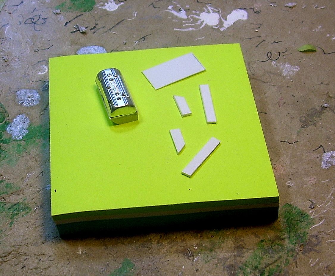

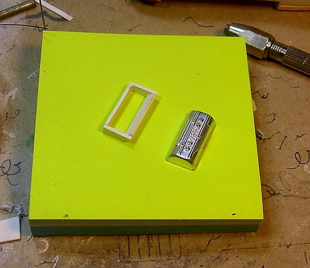

Ace-Garageguy Posted February 28, 2015 Author Posted February 28, 2015 (edited) Again, thanks to everyone who's commented for your interest and encouragement. Started to do the plug wires, as she's getting a Vertex mag and I need to see where the wires can run and clear all the pulleys, carbs, etc. These Revell heads are nice, but it's a bugger to drill them for wires. Careful careful. While I was looking at the heads, I decided I'd really like to have the heads themselves done in an as-cast aluminum finish and the rocker covers done in a polished finish. Problem: the heads and valve rocker covers are molded in one piece on these Revell units. I don't want to mask little fiddly stuff like that and get poor color separation. Hmmm. Solution: cut the rocker covers off, and make new separate heads. That will make it easy to relocate the water outlets to the center of the heads too, which I'd prefer as this car has a water tank in the tail. So, here's one rocker cover liberated from the rest of the head and squared-up on the bottom surface. New head getting there. Second one going together from styrene stock bits. This will also let me clean up a couple of things I don't like about these heads. Though they're really very nice, for this car, I want just a bit better (without buying the beautiful R&M parts). [/u The Revell heads don't fit the flathead block exactly right, and with the Vertex mag in front, plus the water pumps and pulleys, everything is a little tight. My new heads will fit more correctly. Edited February 28, 2015 by Ace-Garageguy
Dennis Lacy Posted February 28, 2015 Posted February 28, 2015 Bill, this project is ABSOLUTELY AWESOME!!!!!!!!!!!! One of the best looking and best proportioned lakes roadsters in scale I've ever seen. Years ago I did similar with the Revell ARDUN heads. I managed to separate the valve covers from the head portion by scribing with the back of a #11 blade just under the valve cover lip. Hosted on Fotki End result: Hosted on Fotki

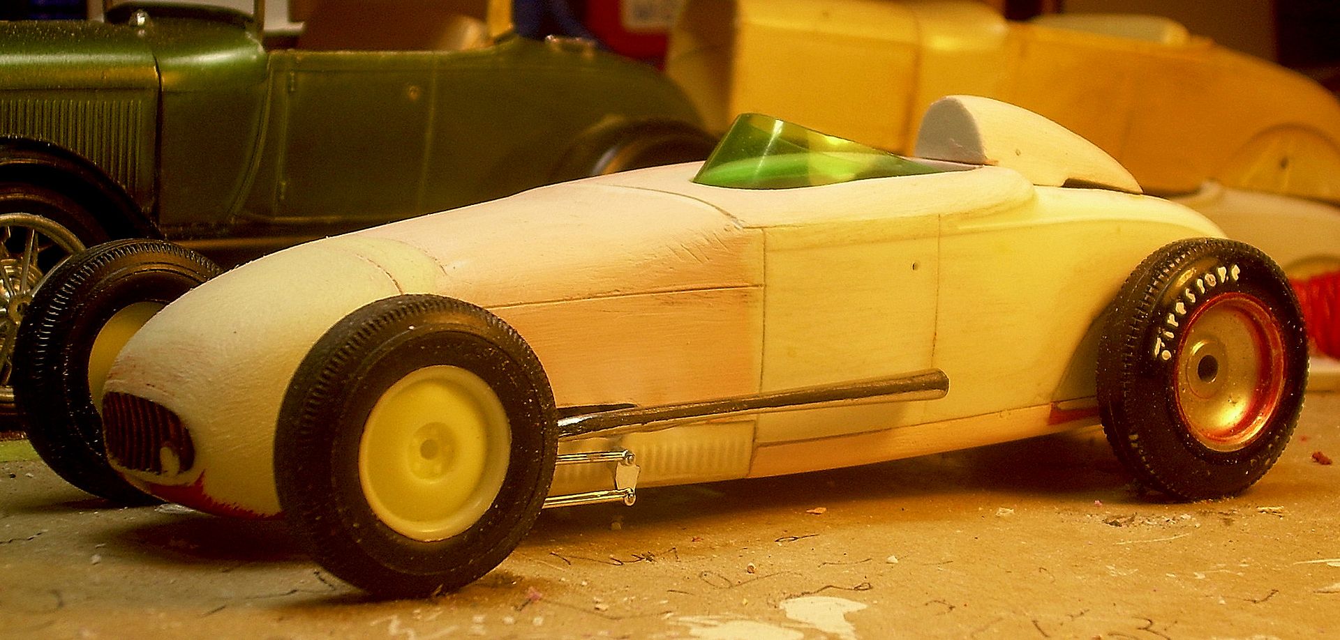

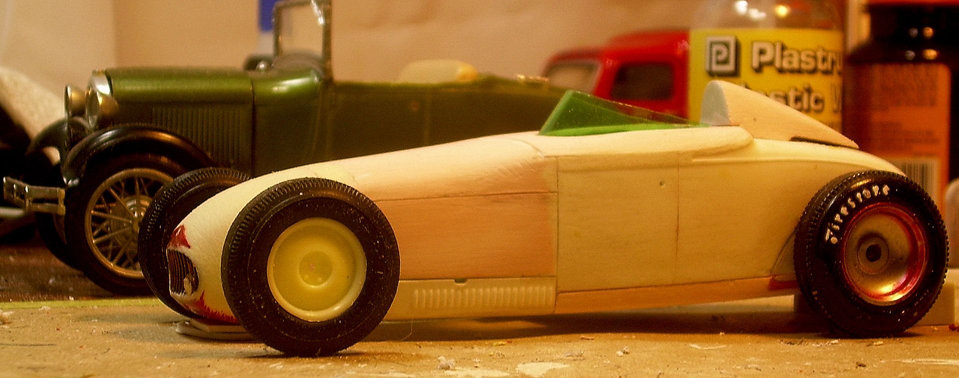

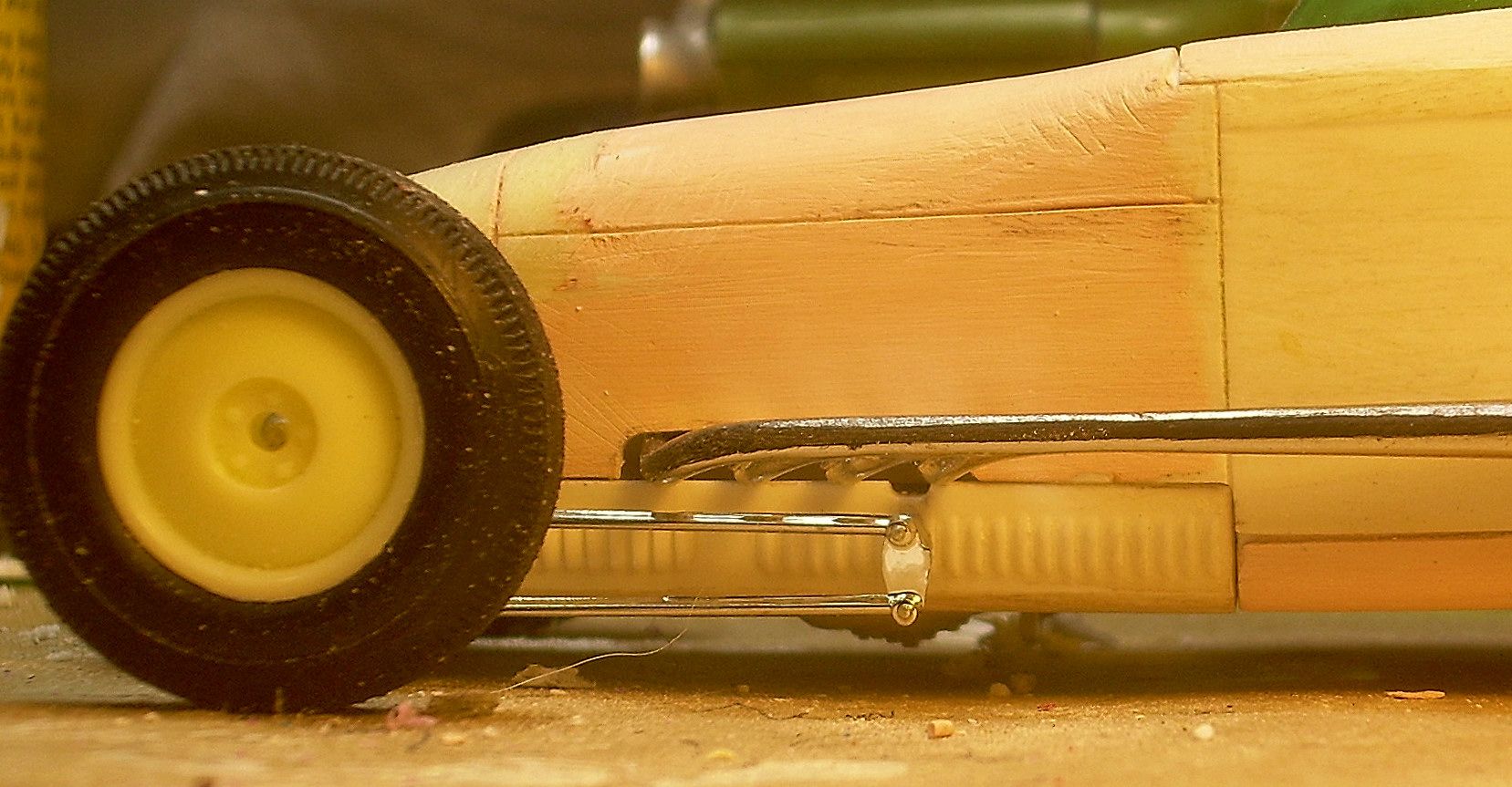

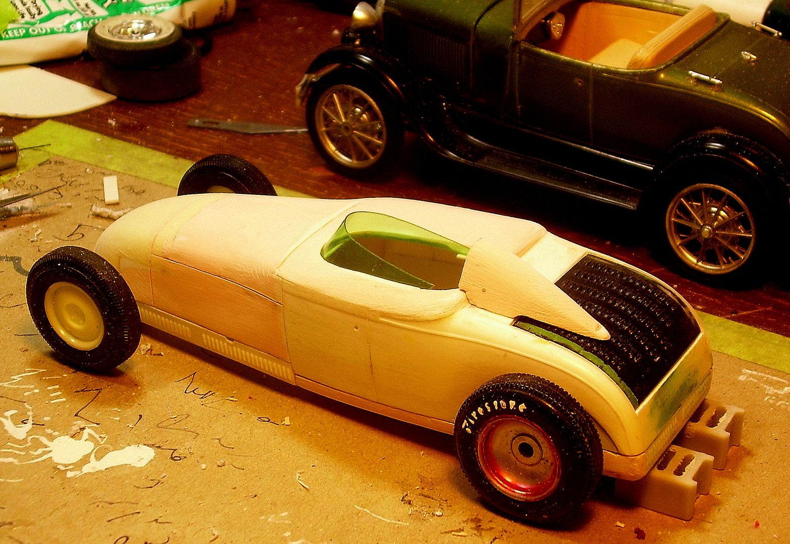

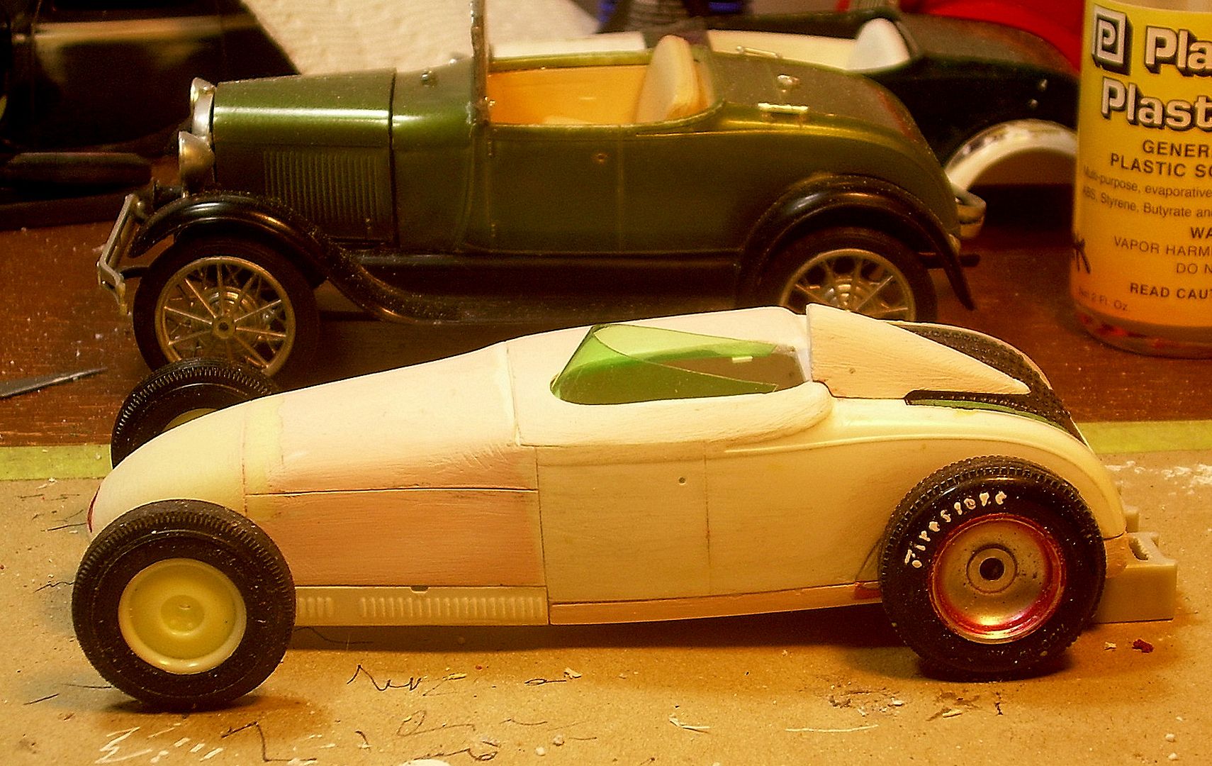

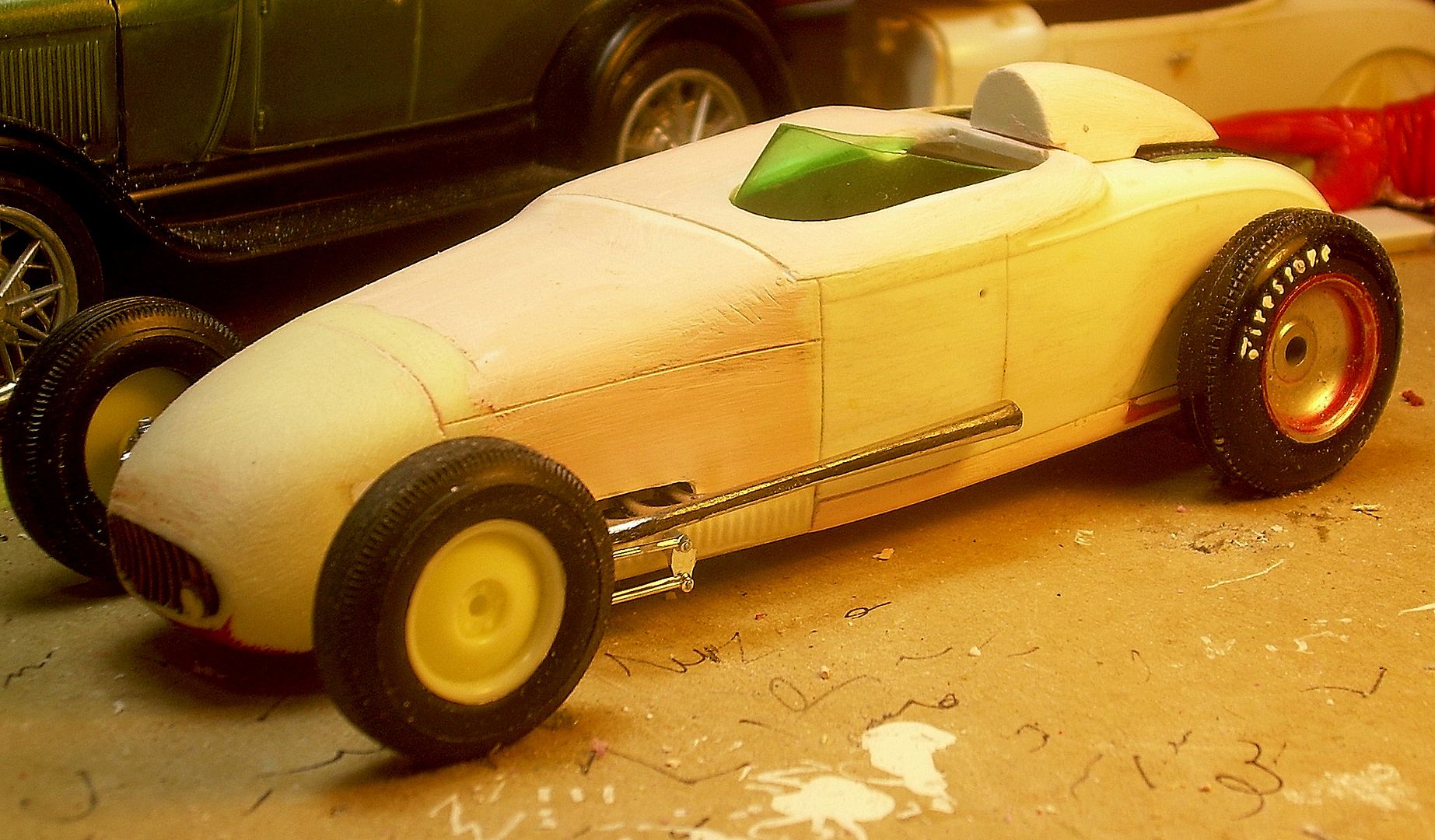

Ace-Garageguy Posted March 9, 2015 Author Posted March 9, 2015 First shot here shows the level forward section of the bellypan, and the raked rear portion. Idea is to generate a little downforce on the tail to improve traction at high speeds. To my knowledge, nothing like this was tried back then, but there's absolutely nothing that would have prevented someone thinking of it. Final shapes coming together, and the car closing on its final overall appearance. Stock AMT '29 roadster in the background is the basis. High rear 3/4 view shows helmet fairing and rear of tonneau very close to final shapes. Front 3/4 view also shows slightly reshaped nose for cleaner lines. First snap-in windshield experiment worked as planned, so final tweeking and a re-cut of the clear material will have that dialed in too.

Ace-Garageguy Posted March 26, 2015 Author Posted March 26, 2015 (edited) Reworked the helmet fairing, lower, more rounded in back. Also fitted the headers this side, cut the hood for them, and relocated the front 4-link to clear. Pretty tight up in front, but everything would clear enough to work. Reworked the nose profile and curvature as well. Maybe not much different to some eyes, but much, much better to mine. EDIT: But now I see a little bump in the curve that crept in due to the different hardnesses of the plastic and the bondo. Gotta fix that. Man, these big photos really show stuff it's easy to miss otherwise. Edited March 26, 2015 by Ace-Garageguy 1
