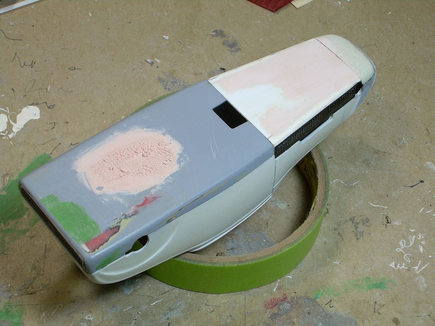

Ace-Garageguy Posted September 7, 2015 Author Posted September 7, 2015 One step forward, one back. Got the shaping and final fitting of the forward bellypan almost done, but the rear bellypan just wouldn't sit square. It's laminated from sheets of styrene and pieces of old gluebombs, and as the glue dried, it warped. Only solution was to twist it 'til it broke, dig out part of the old joint, re-glue it in the correct position with thickened CA (with the pan taped to the body-shell as a jig, to insure it dried square), then re-bondo the area.

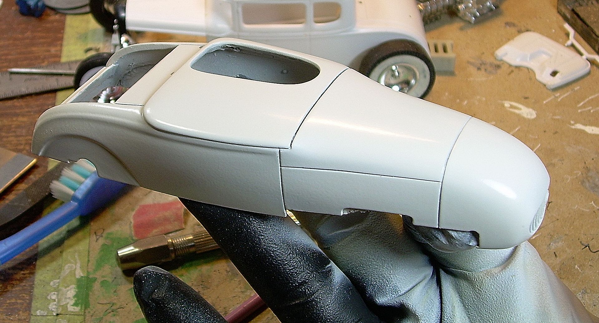

Ace-Garageguy Posted February 2, 2016 Author Posted February 2, 2016 (edited) Getting very close to paint. Had a little problem, though. The way I scratchbuilt the front of the thing was so fragile, it was beginning to crack during sanding. It was never intended to be permanent, but rather to last through paint and then be used as a plug for a set of molds. Only solution here was to coat the inside of the nose with a layer of fiberglass, which should impart enough strength to get me through paint, polishing, and mold-making. Edited February 2, 2016 by Ace-Garageguy

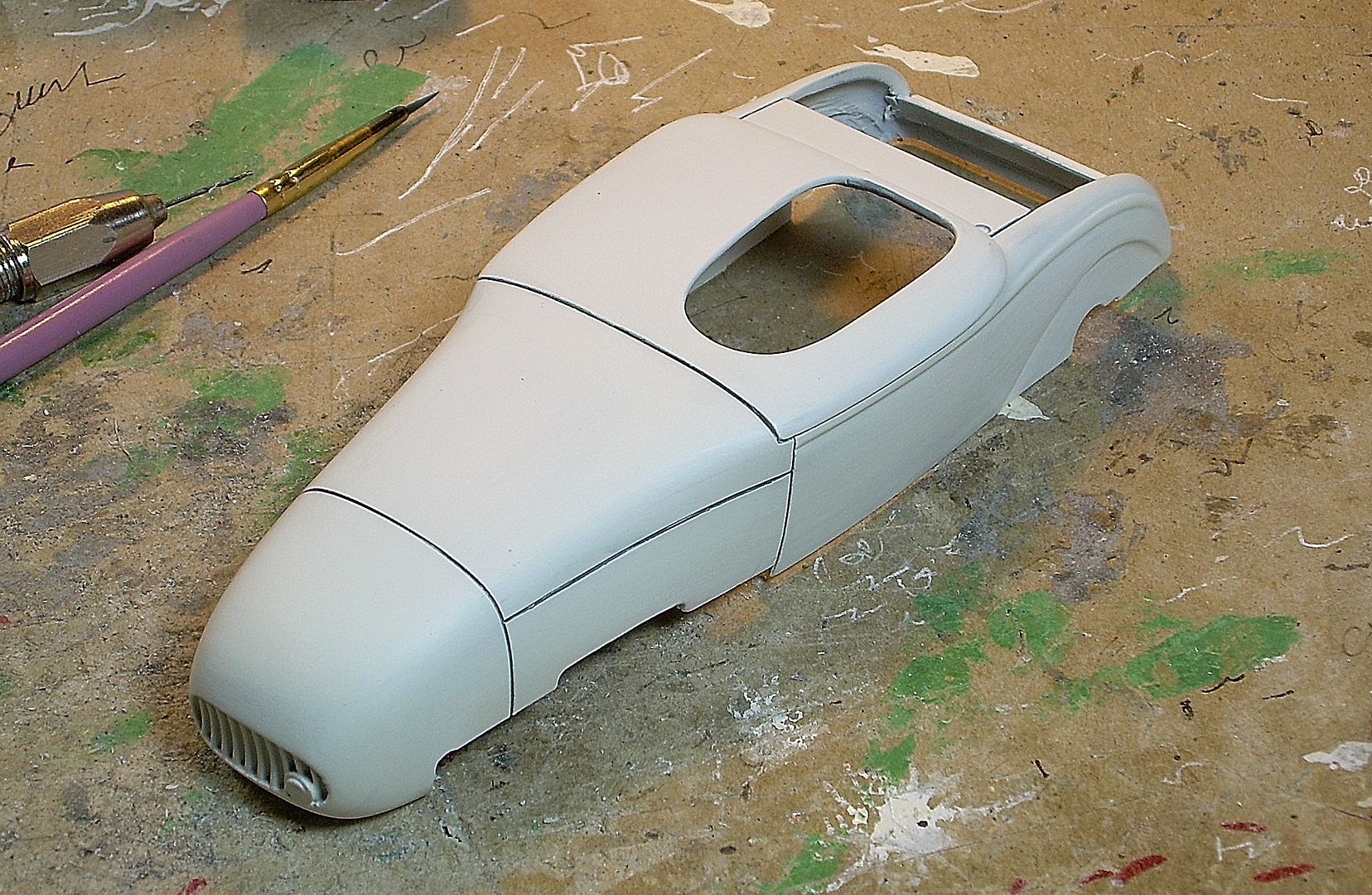

Ace-Garageguy Posted August 29, 2016 Author Posted August 29, 2016 Finally finished the bodywork and put a black wash in the body lines (more for an experiment, as this is still just the plug for a mold set). First three coats of Ace Hardware refrigerator white gloss lacquer. A little peel, but nothing difficult to deal with. A few days drying, wet-sanding with 800, and a couple more coats, then final wetsand and polish. The idea is to get a hard, slick surface to mold from. (I'm disappointed that the black wash doesn't show up better in the panel lines. I may not have scribed them deeply enough)
