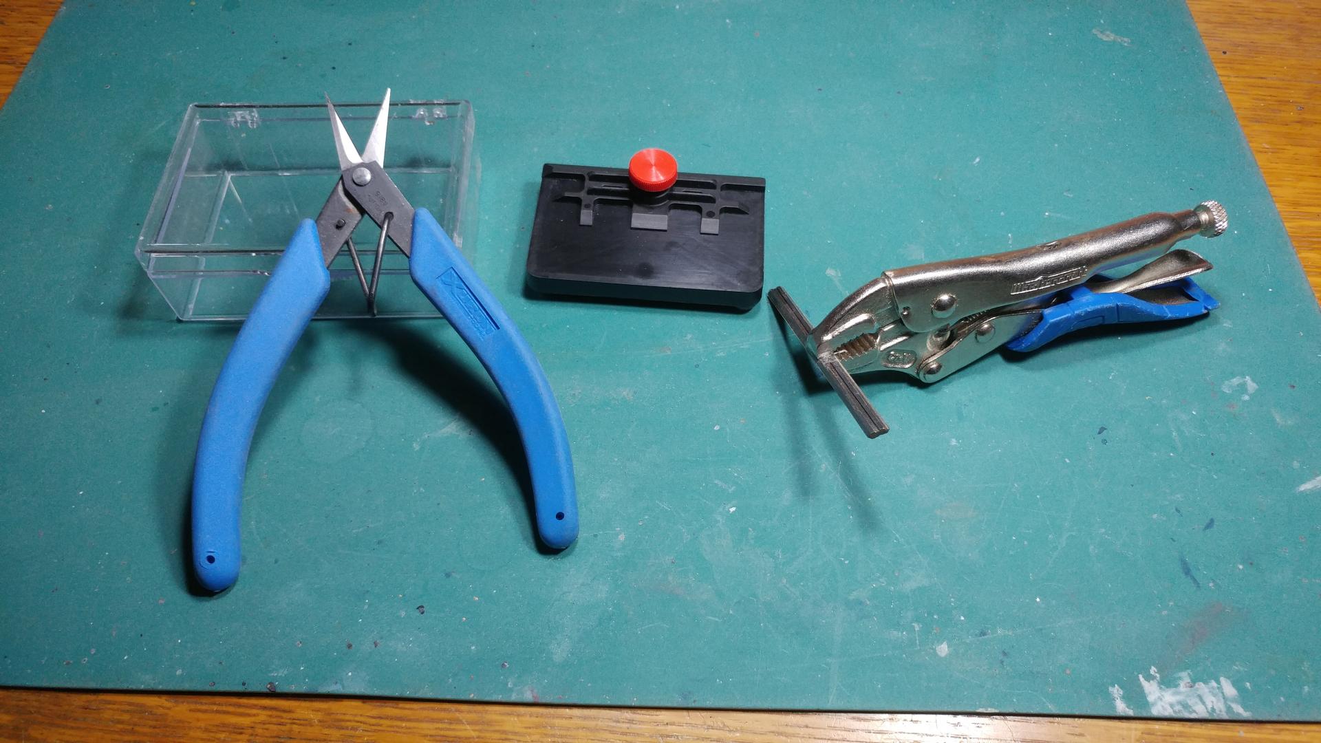

Belugawrx Posted January 18, 2019 Posted January 18, 2019 (edited) A good photo etch scissor, simple bending jig,..and my homemade 3 1/4" benders (electric planer blades epoxied into some vice grips)..works a treat! Oh and a good steel ruler or similar thin steel blade to get under the p/e to bend it up with the middle tool... Edited January 18, 2019 by Belugawrx forgot sumpin

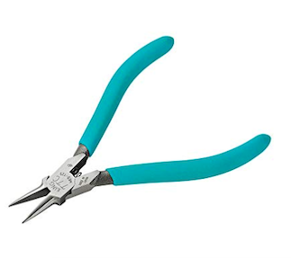

aurfalien Posted January 19, 2019 Posted January 19, 2019 (edited) I'm pretty much a tool minimalist at this point so my list; Xuron Photo Etch Scissors - 9180ET Tsunoda Photo Etch Pliers - MEB-135 Tamiya Photo Etch Diamond File - 74066 These AK Interactive bending pliers look intriguing as well. Edited January 19, 2019 by aurfalien
