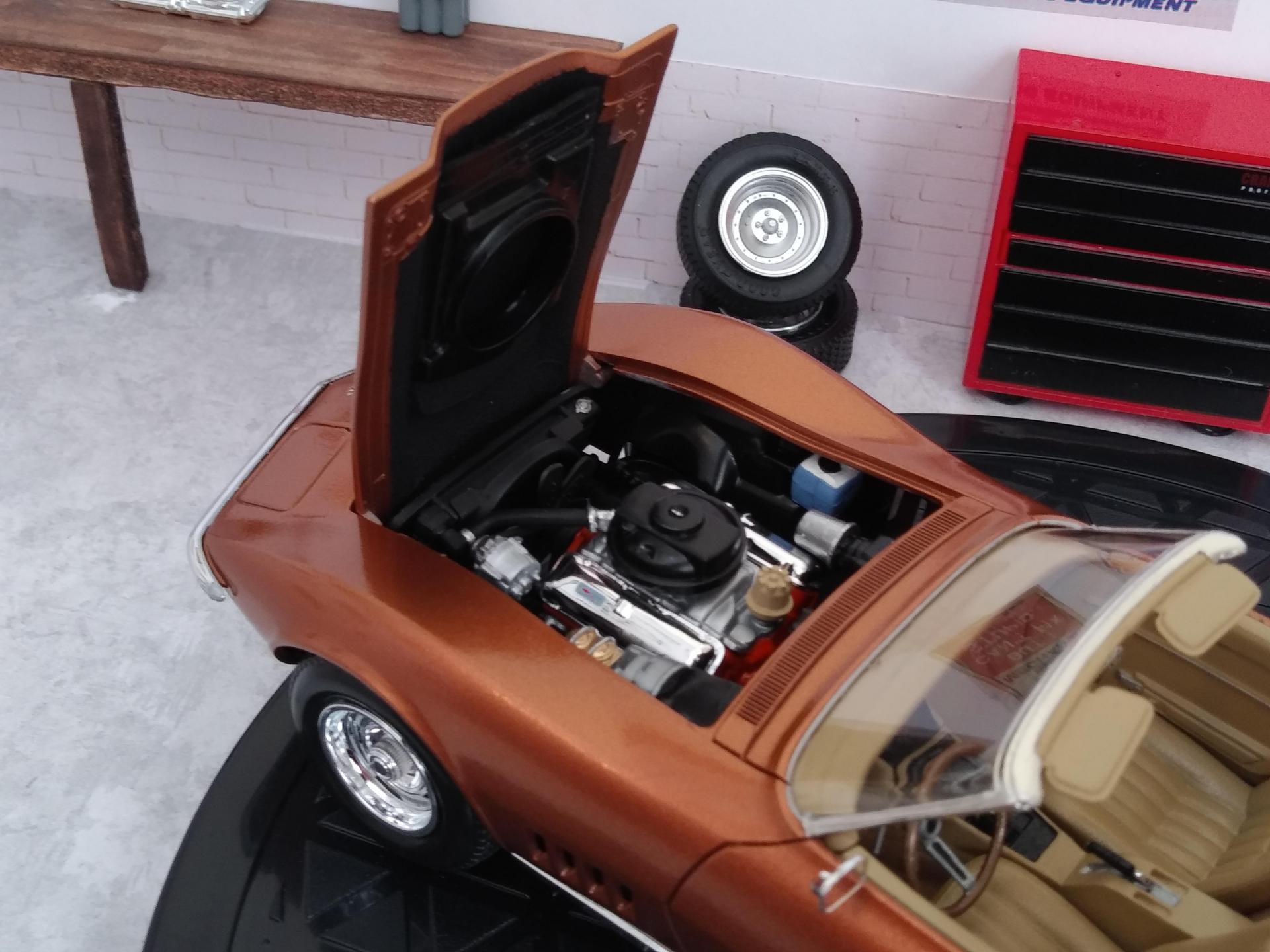

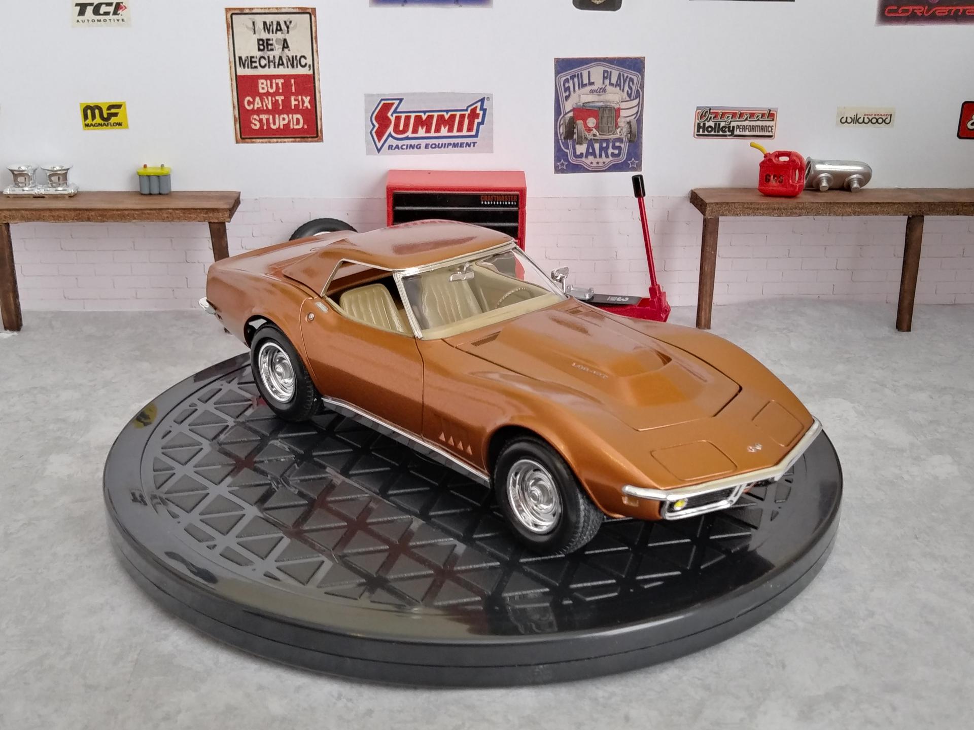

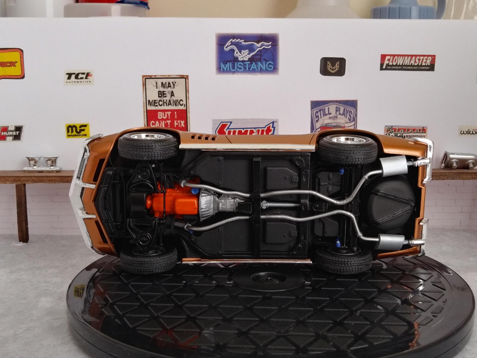

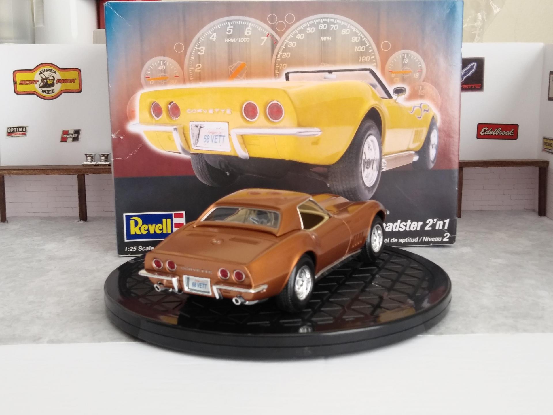

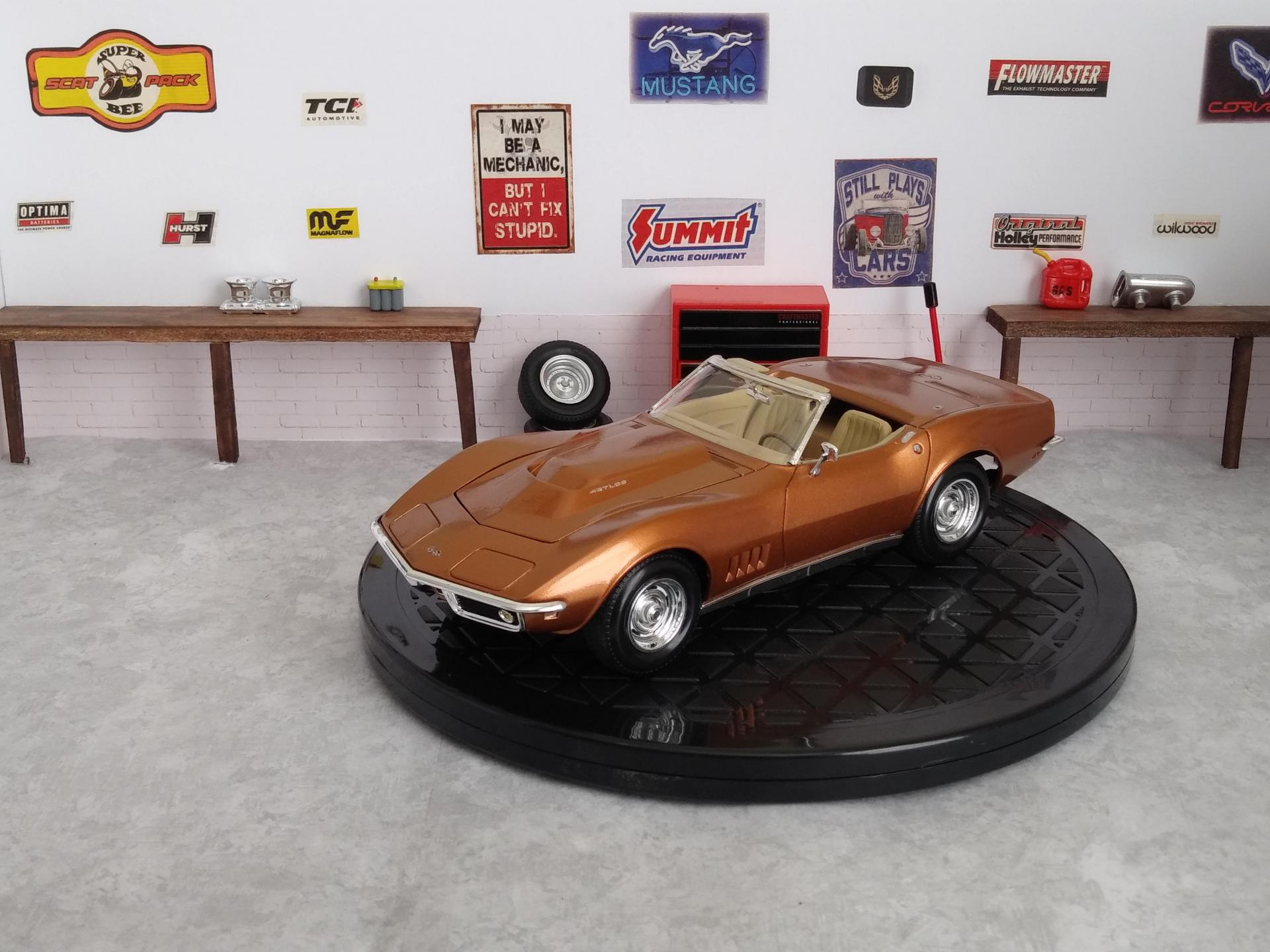

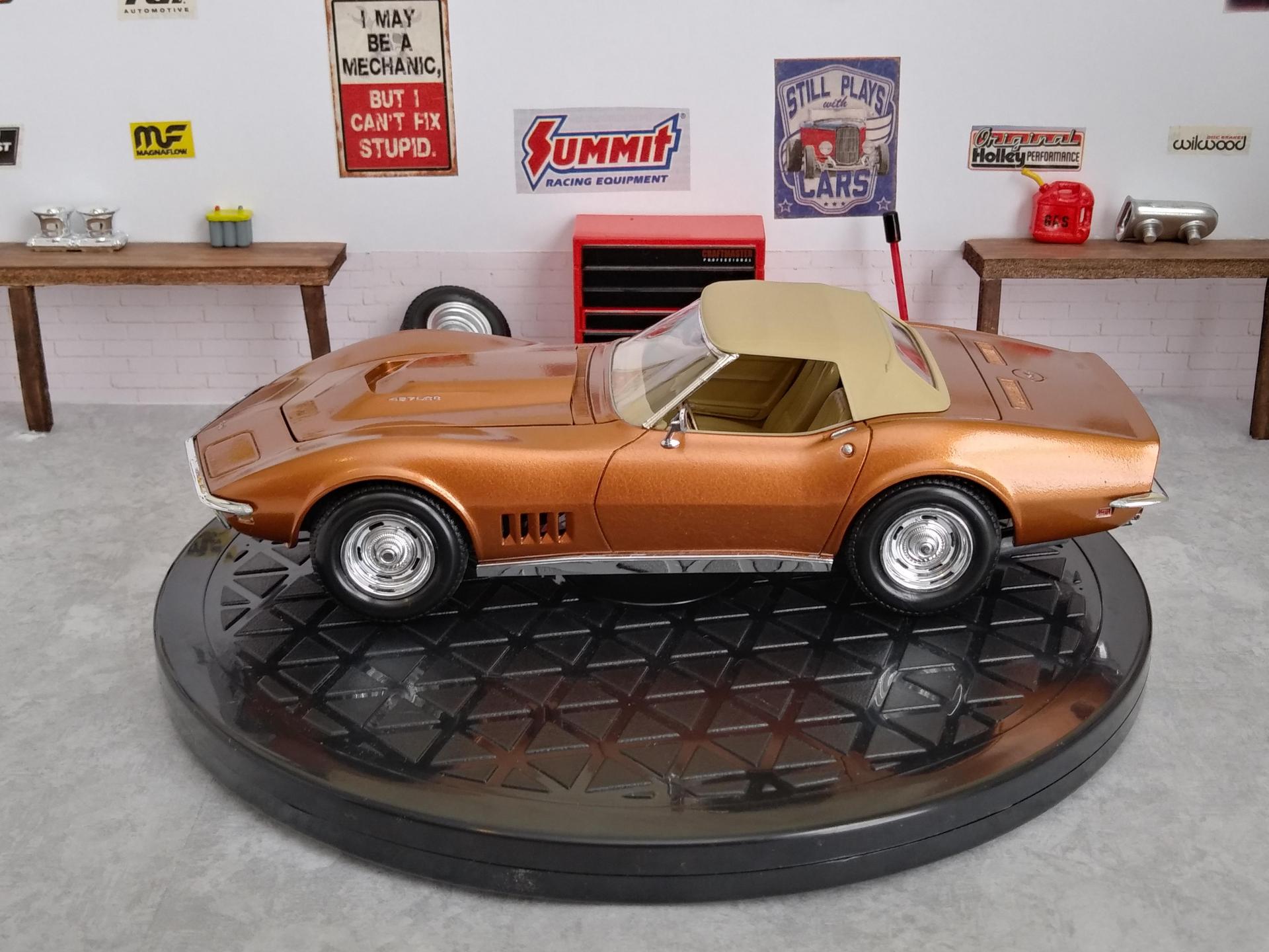

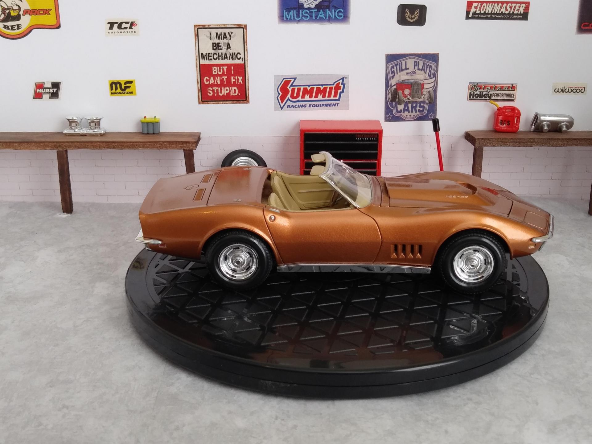

Dragonhawk1066 Posted December 1, 2019 Posted December 1, 2019 (edited) Finished this one up a couple of weeks ago, but I didn't post any pics until now since it was for a box stock build-off for one of my facebook groups that ended on Dec. 1. It's the Revell 1968 Corvette Roadster done box stock with the only addition being approved BMF for the trim. This is a really nice kit and I had a lot of fun building it. The kit was painted with Chroma Molten Metals Acrylic craft paint custom mixed by my wife which I then sprayed through my airbrush, making it my very first airbrush paint job. The interior was also craft paint through my airbrush, as was the chassis. In fact, everything except a few small parts and certain details was done with craft paints (about 95% of the car) and mostly sprayed through the airbrush. The toughest part of the whole thing , I think, was picking out which pics to use for the contest. I like the looks of each variation-- No top, Soft top and Hard top-- so I ended up using one pic of each for the three allotted body shot angles. I am still learning new things, but the biggest thing I still need to learn is to be more patient and not to rush. Thanks for looking! Edited December 1, 2019 by Dragonhawk1066 1

Snake45 Posted December 1, 2019 Posted December 1, 2019 Looks very, VERY good! One of the best acrylic craft paint jobs I've ever seen! (You could hit the backup lights with some white paint or something, though.) Well done and model on!
shoopdog Posted December 1, 2019 Posted December 1, 2019 Looks great! Not sure which variation I like the best but your paint inside and out turned out quite well.
Monty Posted December 1, 2019 Posted December 1, 2019 I love checking out well done C3 Corvette builds, and this one certainly qualifies. I'm particularly interested in the paint you used on the body. What did you use for primer, and does the paint require any special prep to use? What pressure did you shoot it at?
Slick Shifter Posted December 1, 2019 Posted December 1, 2019 Very nice work! The body paint seems to represent Corvette Bronze, which was also available on 1968 Camaros. BTW, the little rectangles below the rear bumpers are backup lamps. They have narrow shiny bezels.

Dragonhawk1066 Posted December 1, 2019 Author Posted December 1, 2019 4 hours ago, Snake45 said: Looks very, VERY good! One of the best acrylic craft paint jobs I've ever seen! (You could hit the backup lights with some white paint or something, though.) Well done and model on! 2 hours ago, Slick Shifter said: Very nice work! The body paint seems to represent Corvette Bronze, which was also available on 1968 Camaros. BTW, the little rectangles below the rear bumpers are backup lamps. They have narrow shiny bezels. Thanks guys, much appreciated! That's the one thing I did forget, I just noticed myself when looking at these pics after uploading them?, a good example of be patient and don't rush?. I was building my brown '69 Camaro alongside this one and just got scatterbrained.

Bills72sj Posted December 2, 2019 Posted December 2, 2019 Very nice build. I am kind of partial to the soft top.
