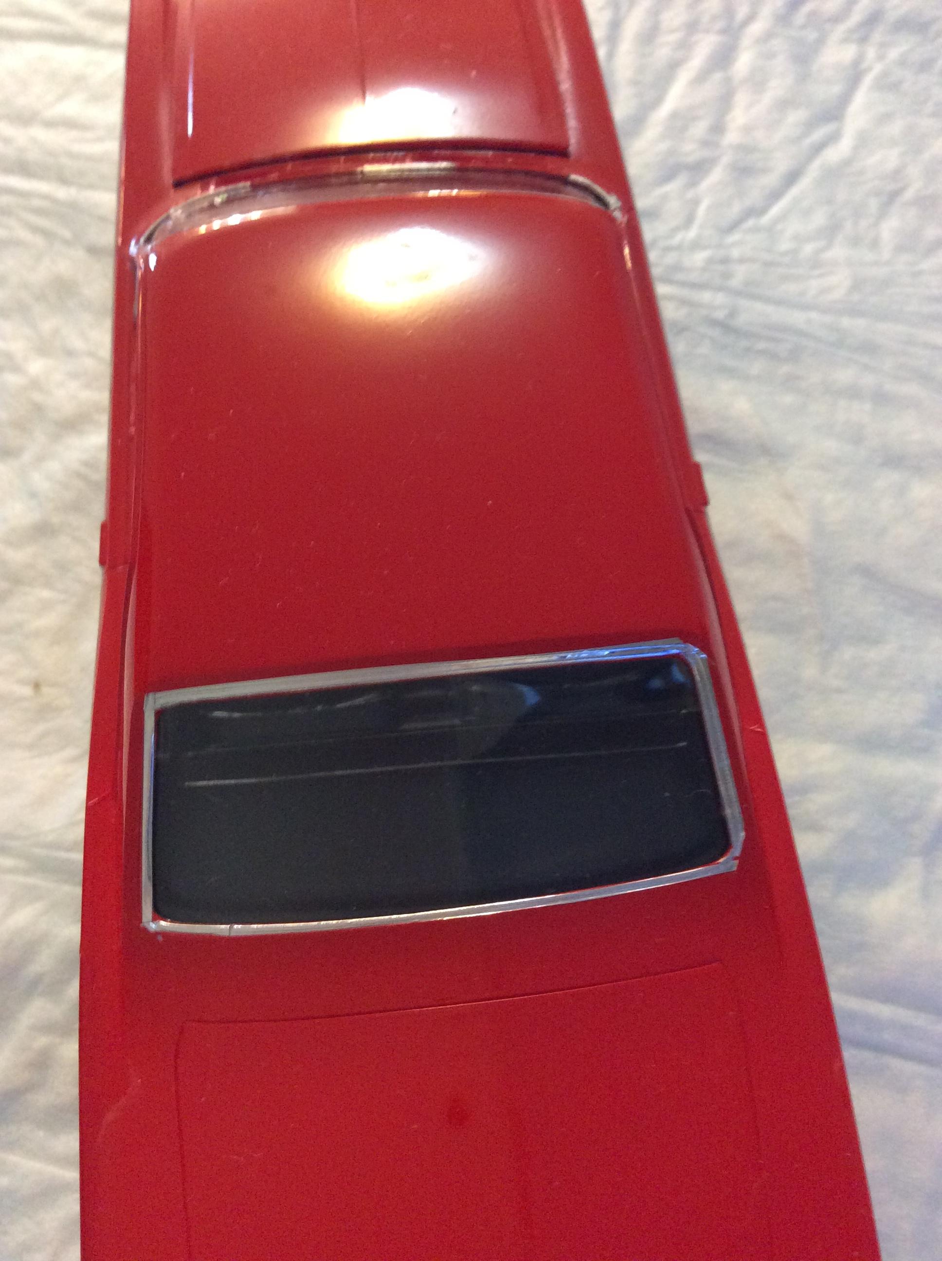

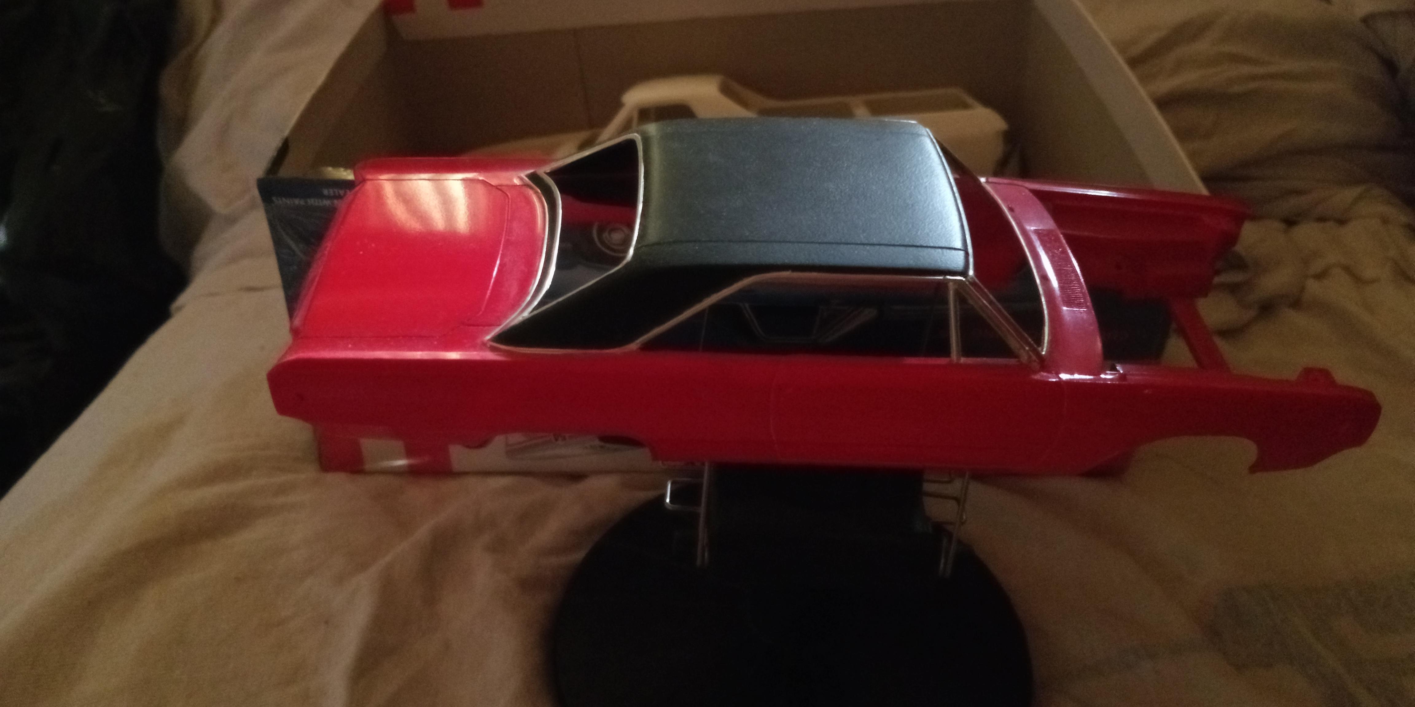

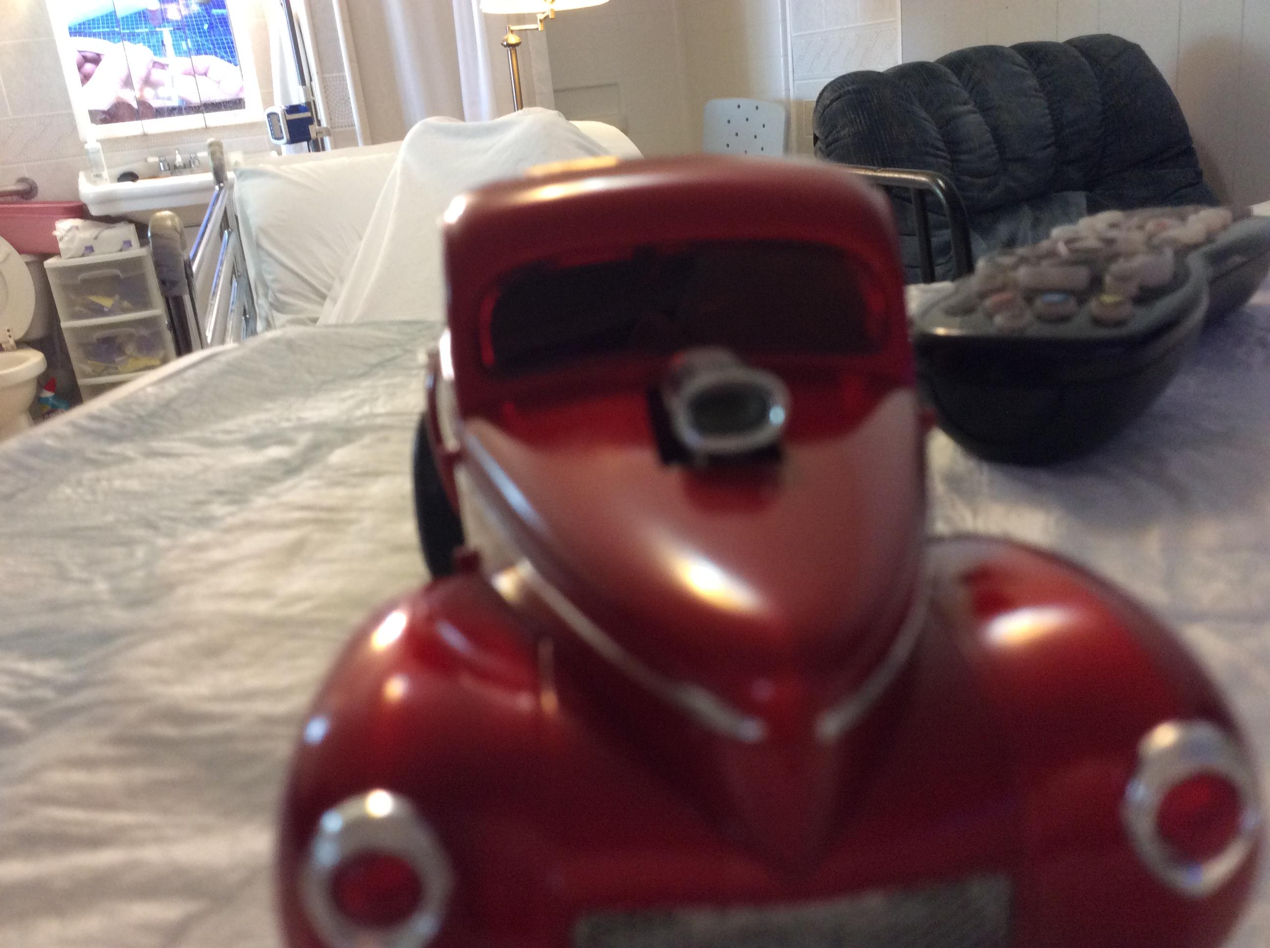

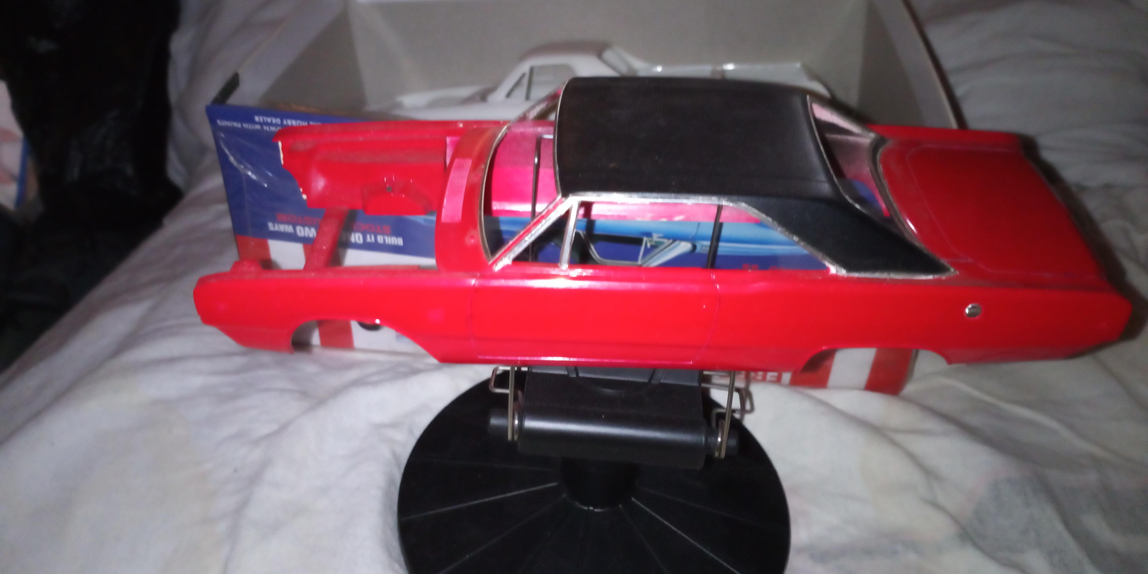

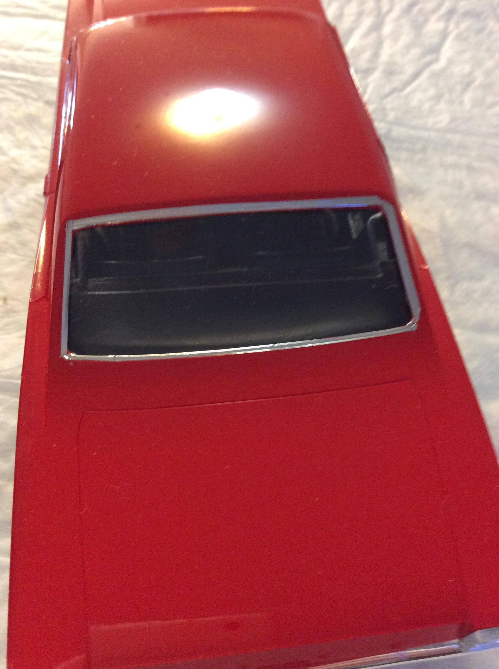

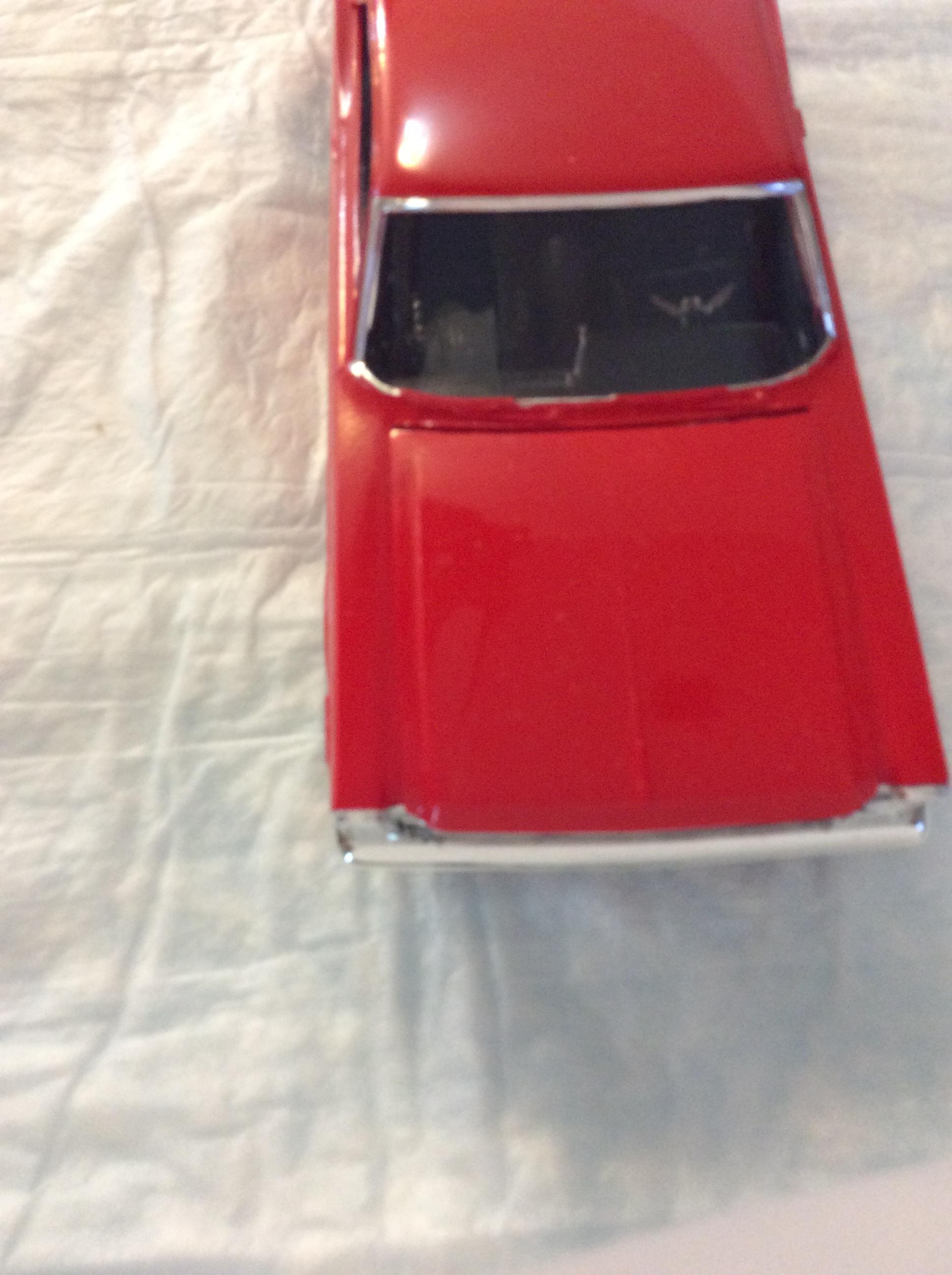

R. Thorne Posted July 27, 2020 Posted July 27, 2020 Saw this in last issue of scale auto and decided to give it a try. Here is my first trials. Jury is still out, but may work ok on certain applications. Apologize for picture quality.

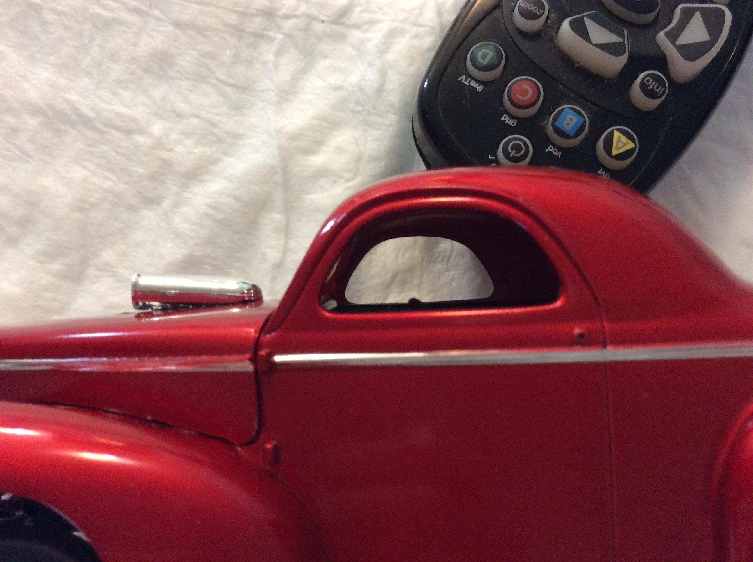

R. Thorne Posted July 27, 2020 Author Posted July 27, 2020 Sorry, picture didn’t turn out well, these were supplied by warbirddecals, part # 007 and 008. Ron.

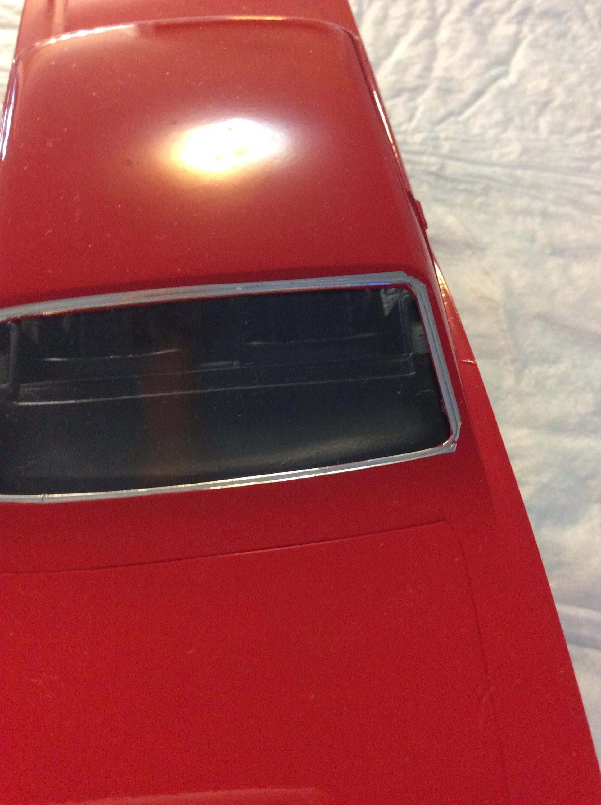

R. Thorne Posted July 27, 2020 Author Posted July 27, 2020 These are simply chrome decals of varying thicknesses that you cut out and apply like a long thin decal with setting solution. They don’t like curves, but they overlap similarly to bare metal foil. Apply decal solution, then decal, then more solution to help move decal into place. For windshields, it would take 2 long and 2 short pieces that would overlap. I did learn to cut the decals to the exact length before applying them (much easier than trimming the length after they were applied). Ron.
StevenGuthmiller Posted July 28, 2020 Posted July 28, 2020 They look like they might work okay for long straight pieces of body trim, but how often do you get something that straight. Otherwise, it seems to me that they would likely be much more hassle than just using foil. Just my observation at this point. Steve
R. Thorne Posted July 29, 2020 Author Posted July 29, 2020 The overlapping on the windshield is very similar to foil in that it is difficult to see. Personally, it was less frustrating for me than foil and the finish is less “wrinkly” and more shiny than foil with no buffing necessary and no removal of adhesive. Ron.

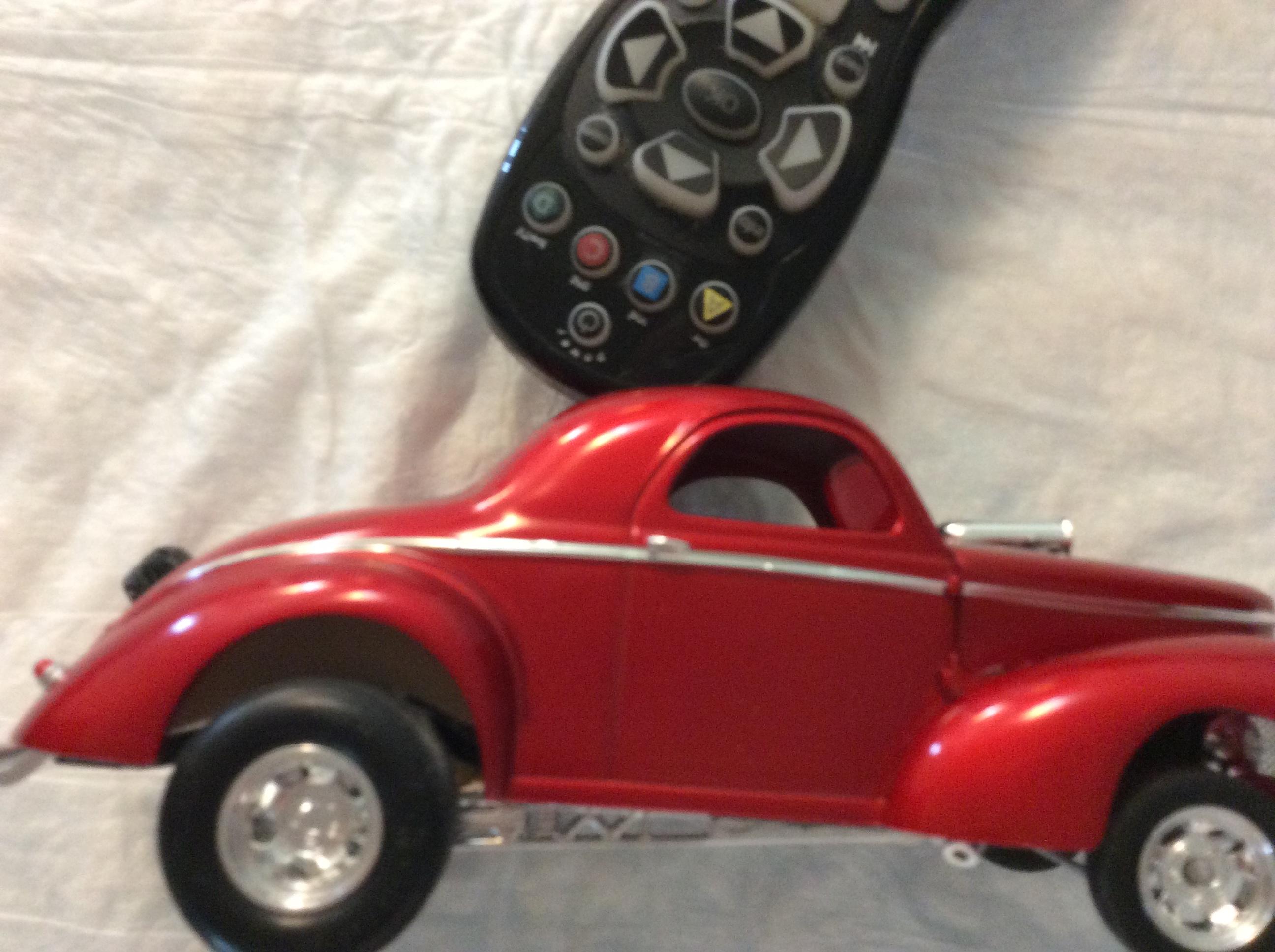

Deuces ll Posted July 29, 2020 Posted July 29, 2020 These pictures ain't that good..? But years ago I used Kit-Kat foil to do this Dart....
