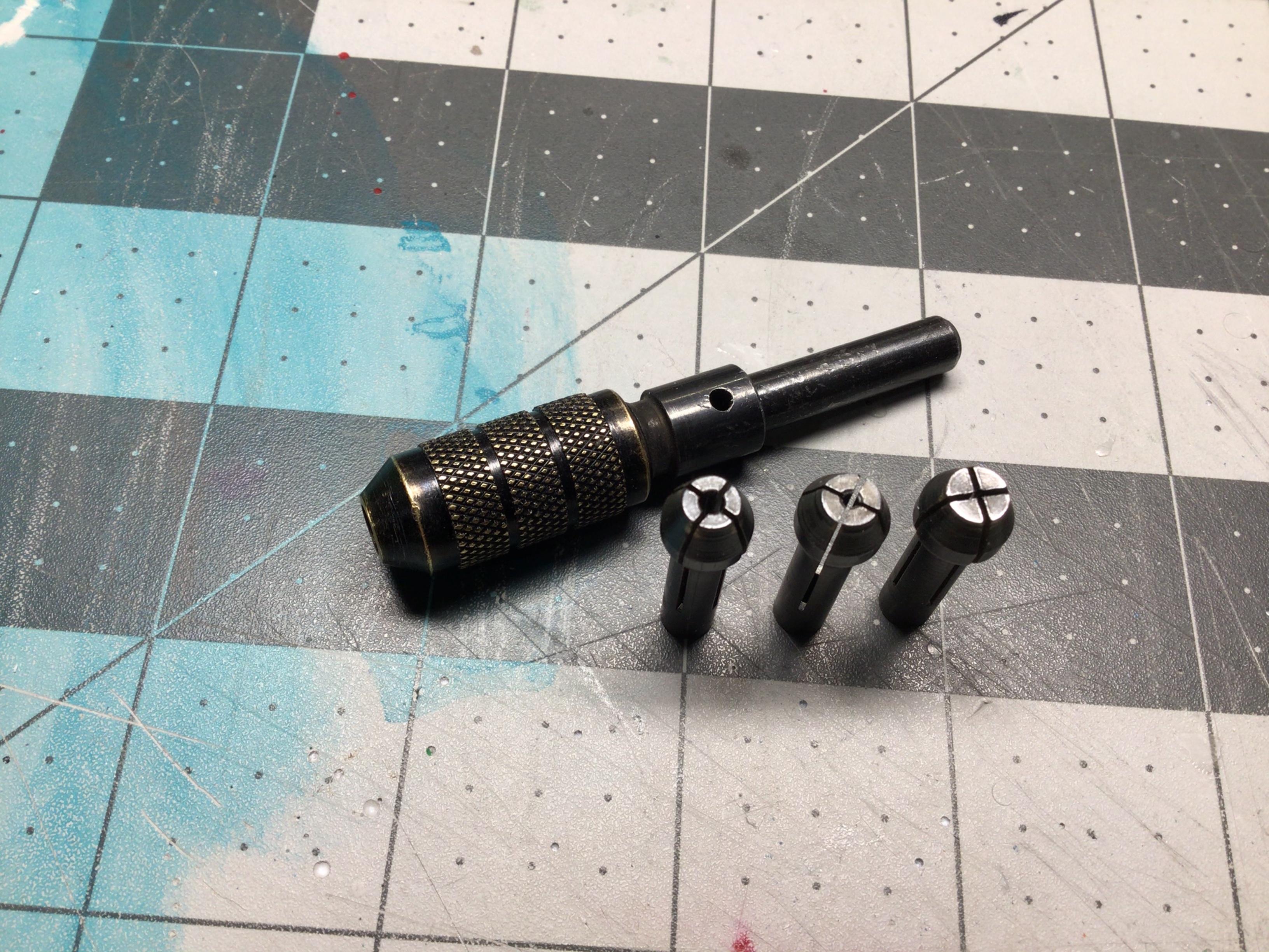

I don’t know where I got this? I found it one day in the garage with a bunch of drill bits. It has three collets that will take anything from a #80 up to 1/16”.  I use it by hand, in my cordless drill and in my drill press. It runs very true.😁

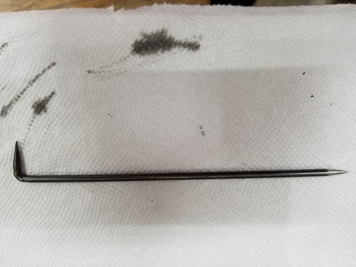

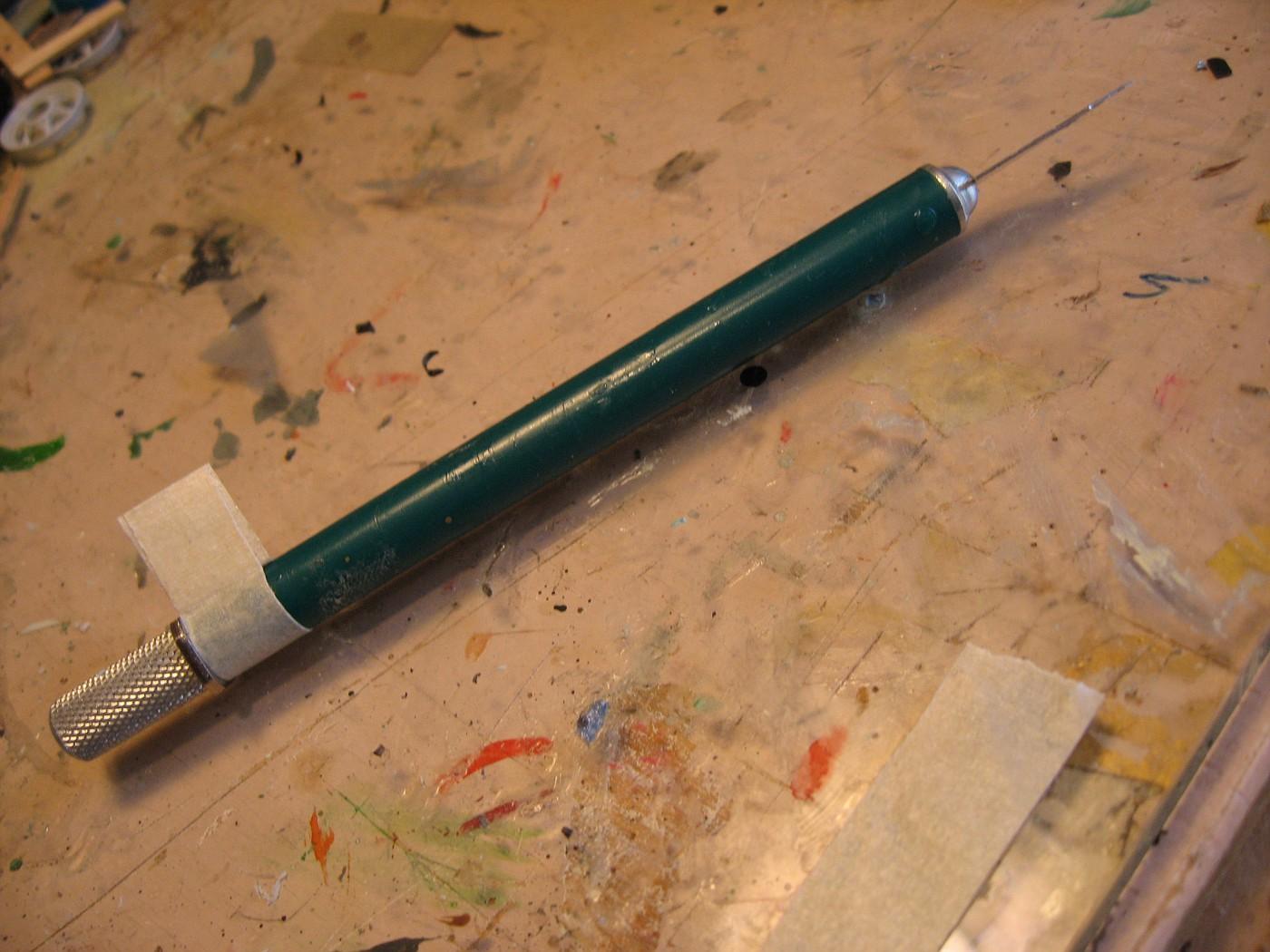

I brought this home with me from work after retiring last Fall and I use to use it to scribe plactic parts at work.  I was a CMM programmer in the Quality department for an Automotive company.  It now gets used to scribe panel lines.

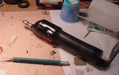

This thread has become more about tags than tools!  Lemme change that!
First up - A tool I wouldn’t be without.. my battery power drill!  I haven’t seen one like this in a long while, but you can buy the Tamiya assemble it yourself one!  Beats hand turning a drill bit every time!

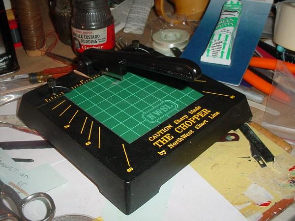

The Chopper - yes it’s a $40 plus tool, but it will serve you the rest of your modeling career. If you work with balsa or basswood or Evergreen strips on a regular basis, you need this. I set up stops on it so I can cut the same length over and over. It uses a single edge razor blade.
Soft handle eXacto knife! It’s much easier on your hand than the steel barrel.  Added bonus- the little wing is made from masking tape. It’s an old draftsman’s trick to keep mechanical pencils from rolling off the tilted drafting board.  In our case it will keep you from stabbing your Bobbit.

Does that chopper make a nice 90 degree cut on one or both ends on something like say .100 x .188 ? Or do the ends need to be sanded square?

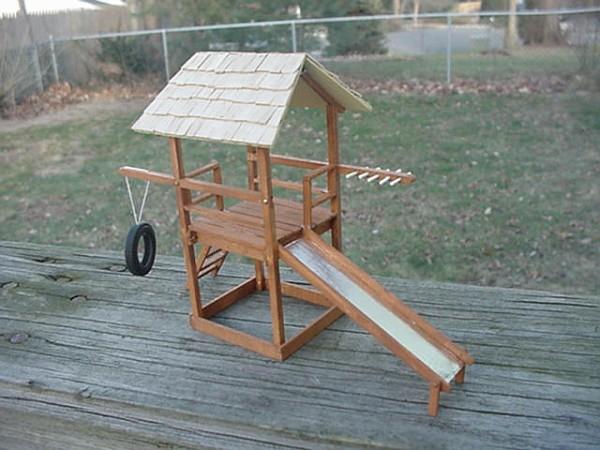

It cuts nice and straight. I bought it to do this project in basswood. If you are hard on it, it will go to crooked cuts, but mine was corrected by changing the blade.
It comes with attachments to do angles. You don’t get the dents in the wood like you do when cutting with an exacto.

I have that chopper and on thicker styrene, the blade will not cut square. It will curve one way so the end will need to be sanded to be truly square.  With wood (softer then styrene) it likely cuts nice and square.
That scriber comes with a mag base set..... I also have a couple of those....

I had the same issue, and boxed it up, and sent it to a friend. Figured that, if I was going to be sanding, anyway, I might as well save the space.

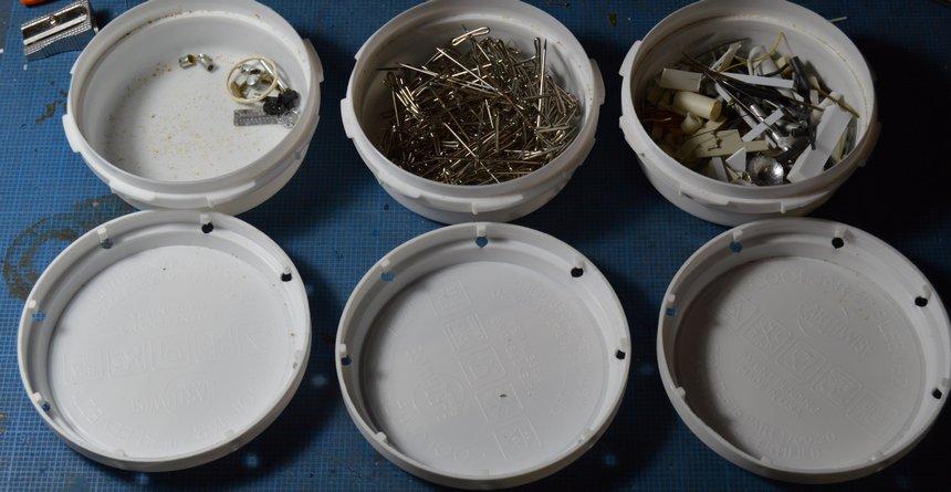

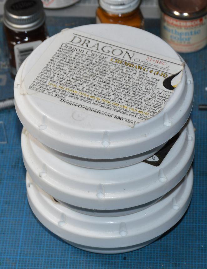

I found some of these plastic containers at one of the dispensaries (I probably should go back there, just to acquire more of these, they've proved so useful!). They work beautifully for  things like pins, small parts for a specific project, and leftover bits and pieces that are just too tiny to live amongst the general population of scratchbuilding materials! Their wide tops make them super-easily  accessible. And they stack nicely.

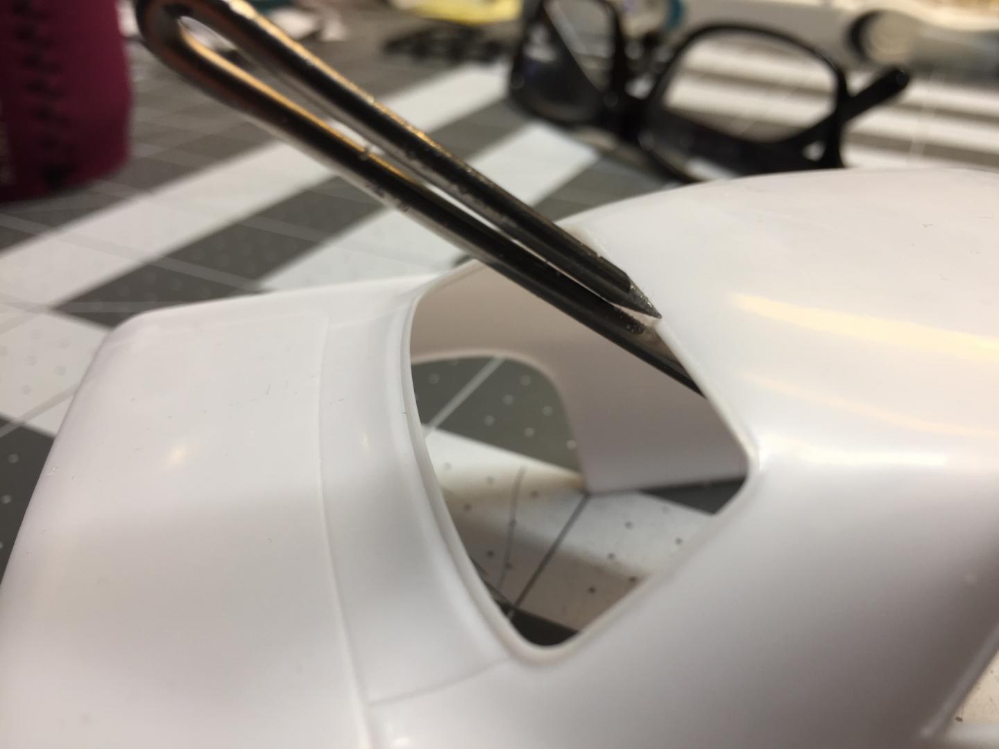

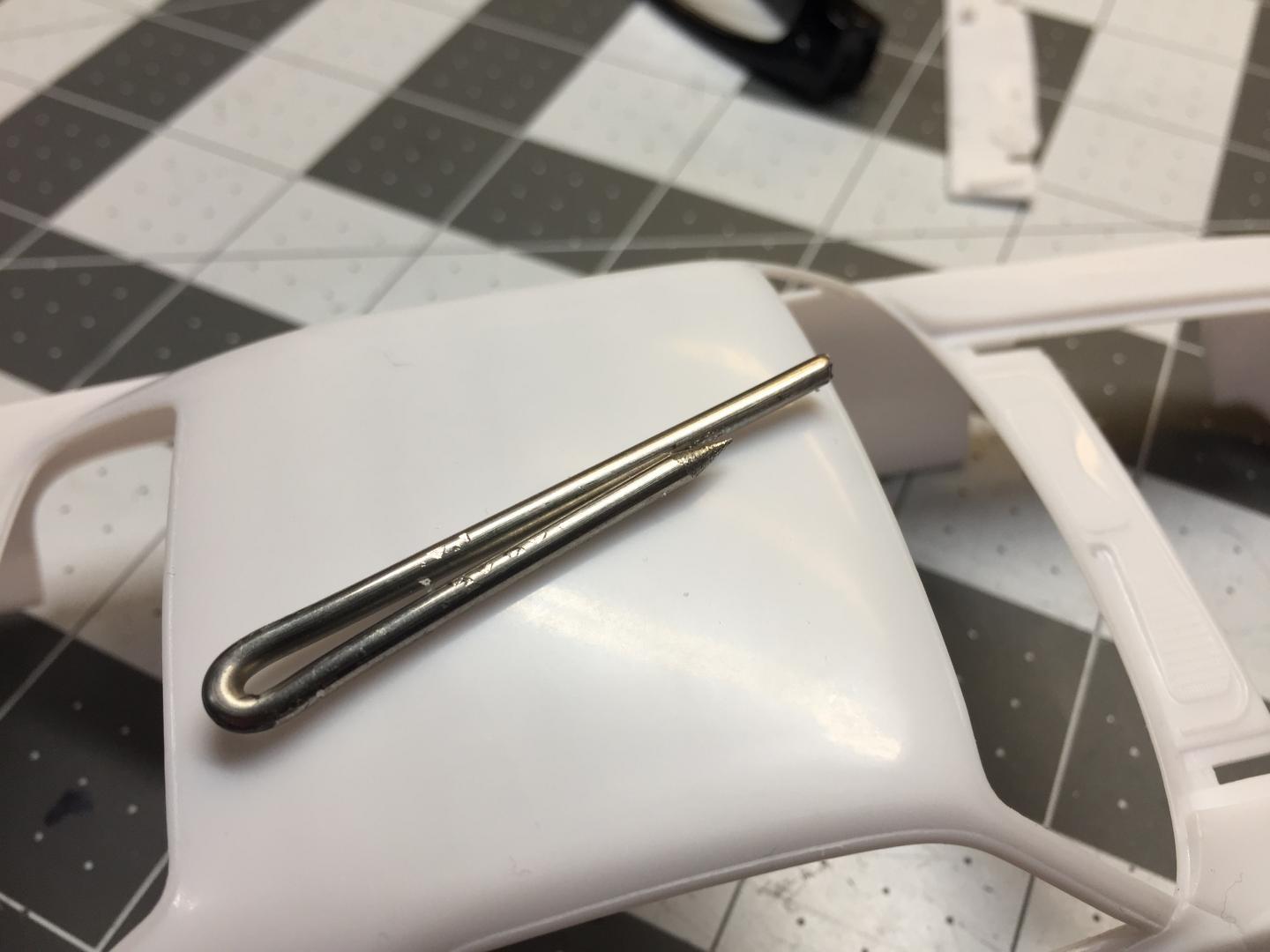

I’ve posted this previously, but this is an easy to make trim scriber. Any stiff wire would work. Chuck it in a drill and sharpen it before bending.You can vary the width by spreading it or rotating it off 90 degrees.  Sure beats free-handing it!

It’s a matter of the right tool for the right job. Thicker stuff needs to be cut with a saw in a miter. I learned that, I literally bent a blade misusing the Chopper.
The Chopper works well if used as intended.

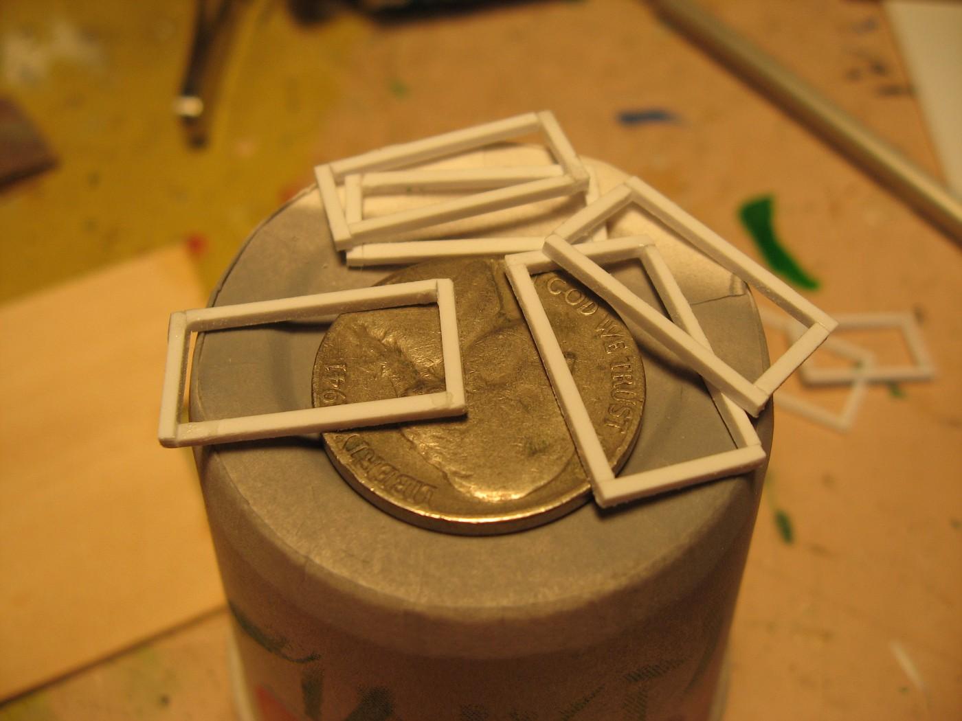

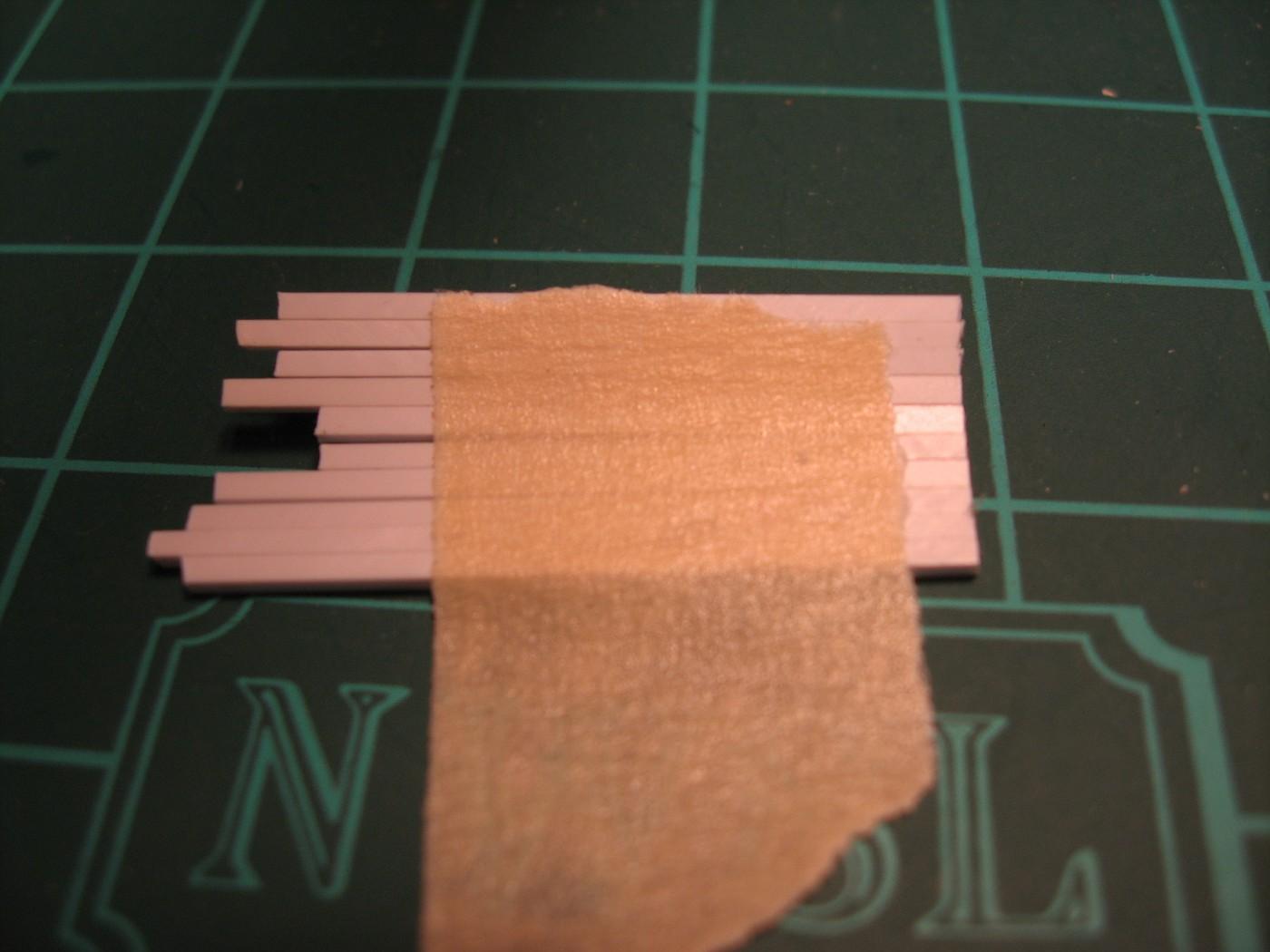

Proper use of The Chopper...  here are strips of Evergreen I wanted all the exact same length. I taped them together. Here they are sitting on the Chopper bed.

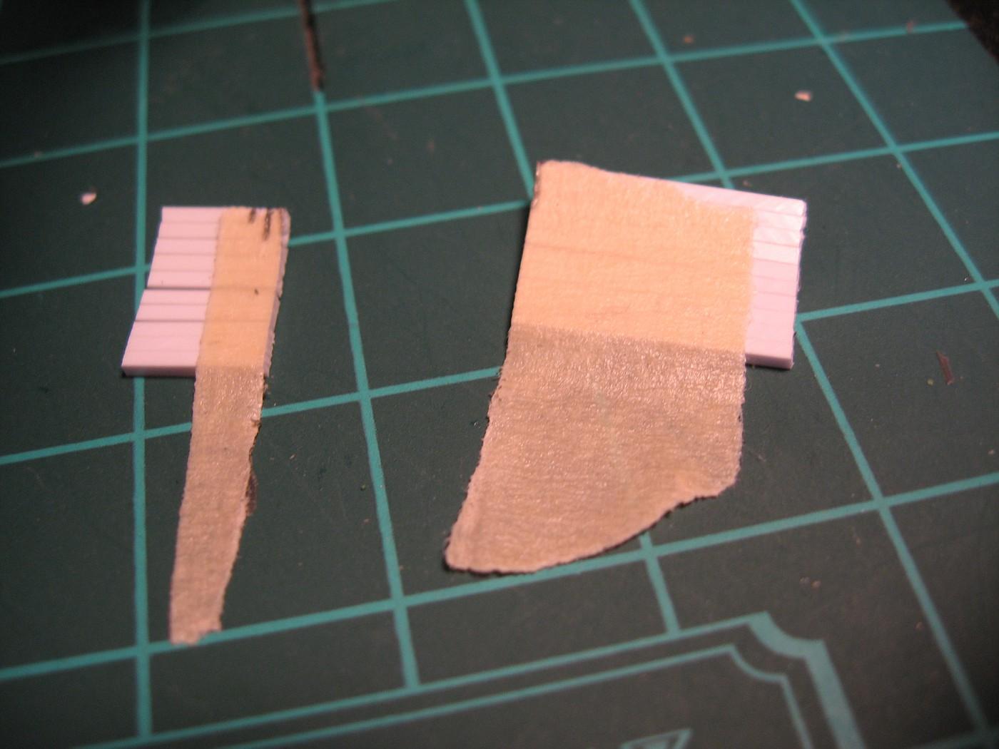

Here are the two sizes I wanted, cut nicely.

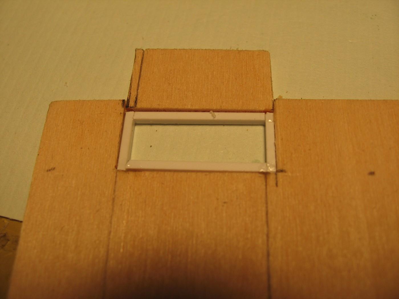

I made a square jig out of basswood..
And here’s a window frame!
The final result.. several window frames exactly the same!

I agree 100%.  But the question was about "something like say .100 x .188" (I assume styrene).  In my experience, at that thickness, the blade will likely deflect.
