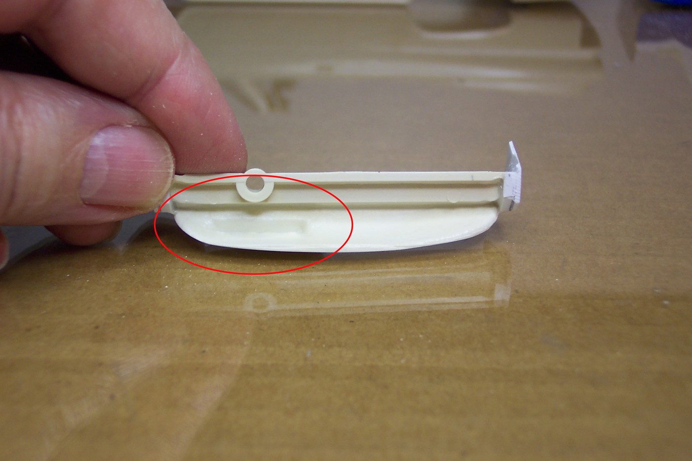

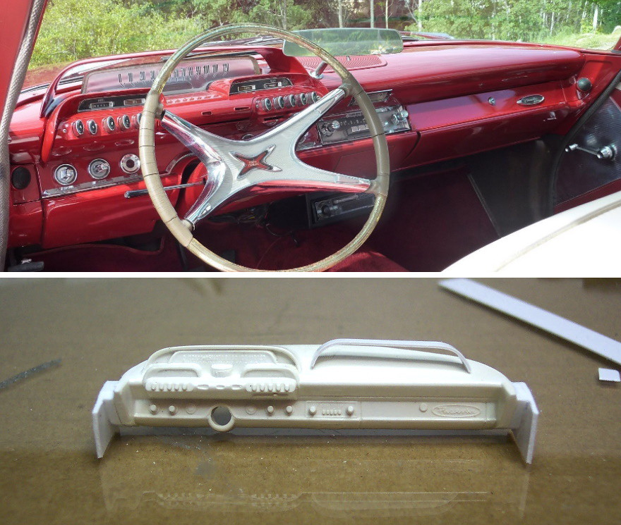

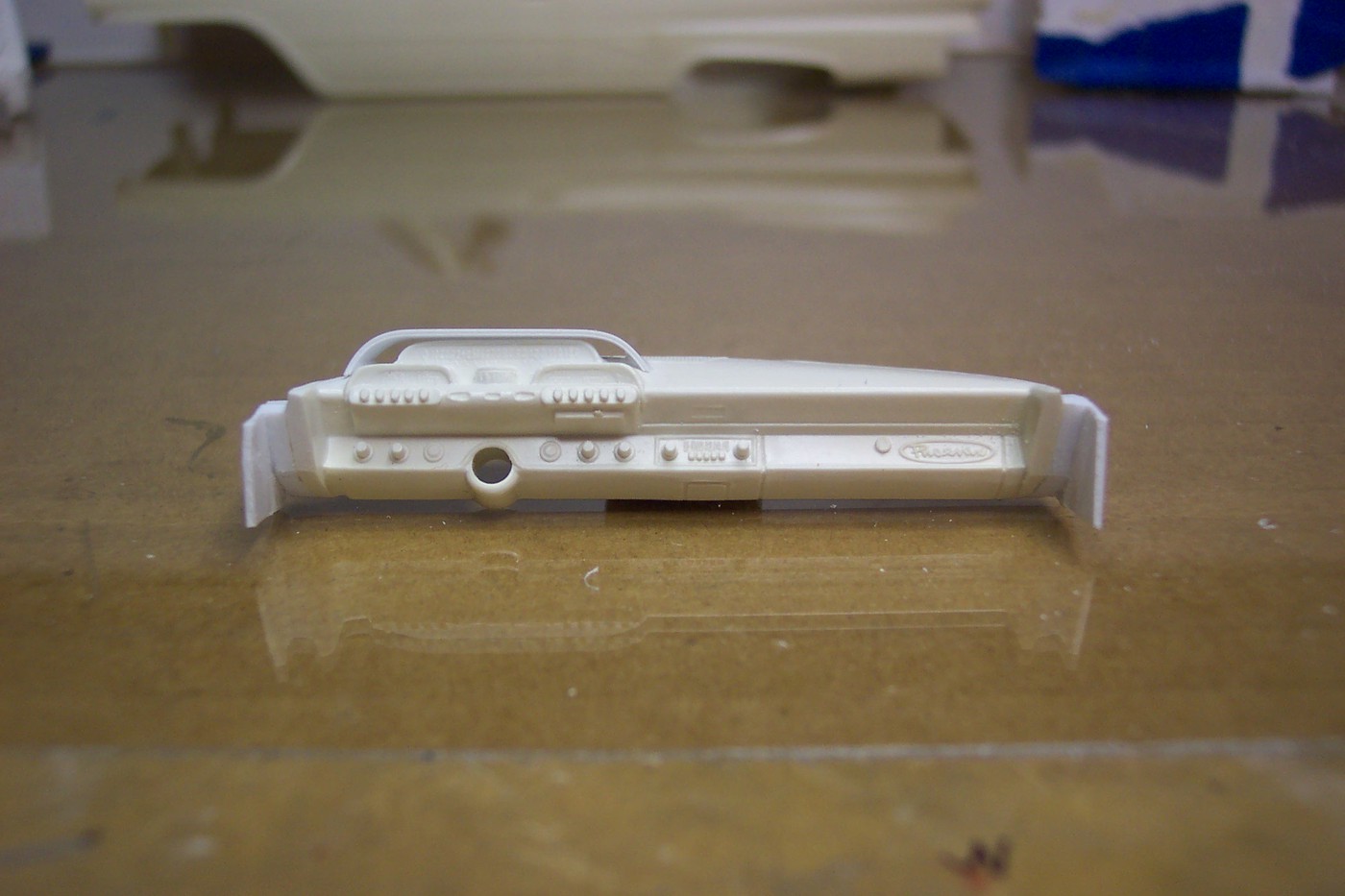

TooOld Posted July 11, 2021 Author Posted July 11, 2021 Thanks Steve ! I also tend to go back later and change things or add details I forgot or never thought of doing in the first place , that's why I never paint anything until it's ready for assembly . One feature of the dashboard I've always liked is the "See-Thru" speedometer , I remember as a kid sitting behind the steering wheel and just barely being able to see through it ! I've thought about this one a long time and decided to first see how a home made shroud might look . Satisfied that a home made shroud is possible I proceeded to modify the dash . First step was to fill the recess on the underside with some polyester putty . Once hardened I removed the molded-on shroud using a Dremel , a small pencil grinder , and some files . After a little trimming I set the new shroud in place with some Tacky Glue . It still needs some refining and the front edge needs to be tapered but it will definitely work ! Thanks for looking ! More to come . . .
David G. Posted July 11, 2021 Posted July 11, 2021 Impressive! Many times it's the smallest details that make the biggest difference. David G.
carbuilder1950 Posted July 11, 2021 Posted July 11, 2021 @TooOld I love how all the smallest details that we always overlook, are coming to life on this project, and your giving detailing an interior a whole new meaning, and a higher bar of standards to attain to. Can't wait to see what your imagination has for us next. Dave
Muncie Posted July 11, 2021 Posted July 11, 2021 Oh my, I learned to drive in a 1960 Dodge Seneca wagon, kind of the opposite end of the Dart line from the Polara convertible. I remember that dashboard and the see-thru speedometer with the mirror on the dash. Space age styling at its most unique. I've been following and enjoying your project. Excellent building and looking fantastic!
StevenGuthmiller Posted July 11, 2021 Posted July 11, 2021 I’ve got another idea for you to try Bob. If it doesn’t work, there’s no harm. Put a little mold putty over the speedo face and make a cast with some clear epoxy. If it works out, you could replace that as well. ? Steve

TooOld Posted July 12, 2021 Author Posted July 12, 2021 11 hours ago, StevenGuthmiller said: I’ve got another idea for you to try Bob. If it doesn’t work, there’s no harm. Put a little mold putty over the speedo face and make a cast with some clear epoxy. If it works out, you could replace that as well. ? Steve Good idea Steve . I'm already working on one idea to replace the speedo and will also give the casting idea a try , I have some clear casting resin that I can use . One of these ideas should work ,Thanks !
TooOld Posted July 24, 2021 Author Posted July 24, 2021 So I stepped away from this and spent some time thinking about my next step . I really wanted to replicate the see-thru speedometer of the Dodge but once I remove the speedometer from the JoHan dash I'm committed to it , not to mention that I've ruined a really beautifully molded dashboard and this model would never be displayed with the top down . I decided to proceed by making a mold and using some Clear Casting Resin make a copy of the speedometer . While the casting itself turned out great it didn't look like I wanted , but it could always be used to repair the JoHan dashboard if I screw up . My other option was to make speedometer face out of clear sheet and print a decal for the numerals , so I created some artwork using a photo of the Dodge speedometer as a guide . Here's the actual printed decals (I always print extras). They lost some resolution because of the inkjet printer but not nearly as bad as a photo would . The printed border will be removed when I cut out the decal . They're printed on clear decal paper which is clear on a painted surface but when applied to the clear plastic it should have a slight frosted appearance just like the real speedometer . Next I cut the clear face from some .030" sheet and after several attempts I settled on this one . If you've never cut clear sheet it's much more difficult than regular sheet styrene . I used some .010" x .040" strip for the top . Now I could remove the speedometer from the JoHan dashboard , I worked slowly taking several breaks to make sure I didn't remove too much material . Also removed the molded on compass , it was an option that my Dad's Dodge didn't have . With some finish sanding and some primer it looks pretty good ! And here's the new See-Thru Speedometer ! The shroud still needs to be lowered a bit to look correct but I'm very pleased with how it turned out . Now I can get back to work and hopefully finish this build soon !
