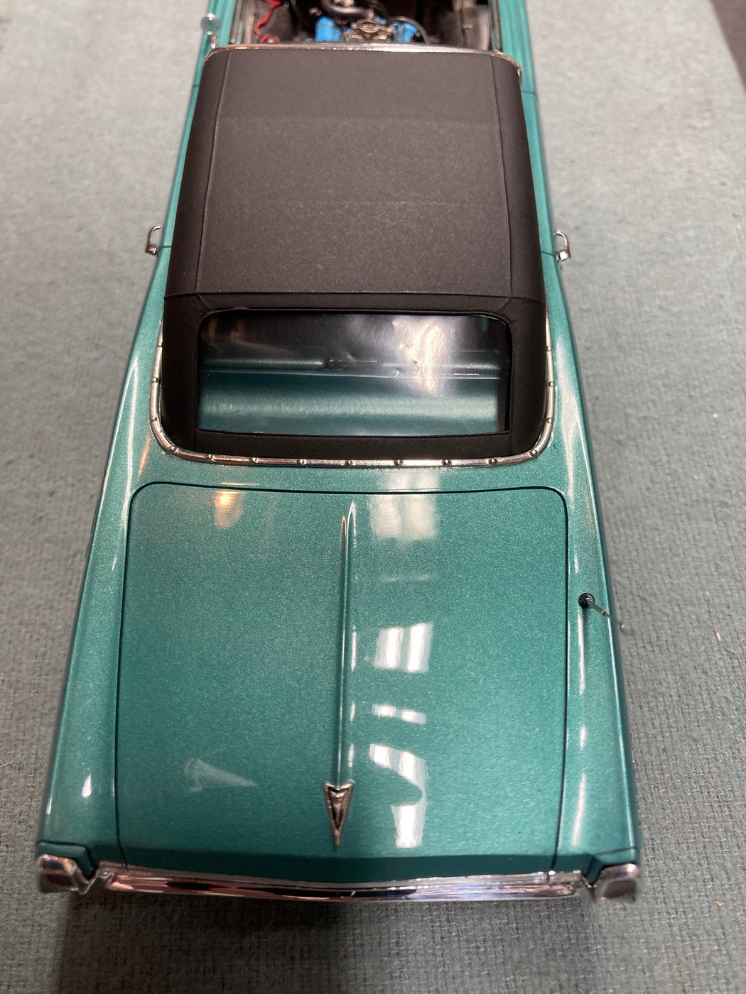

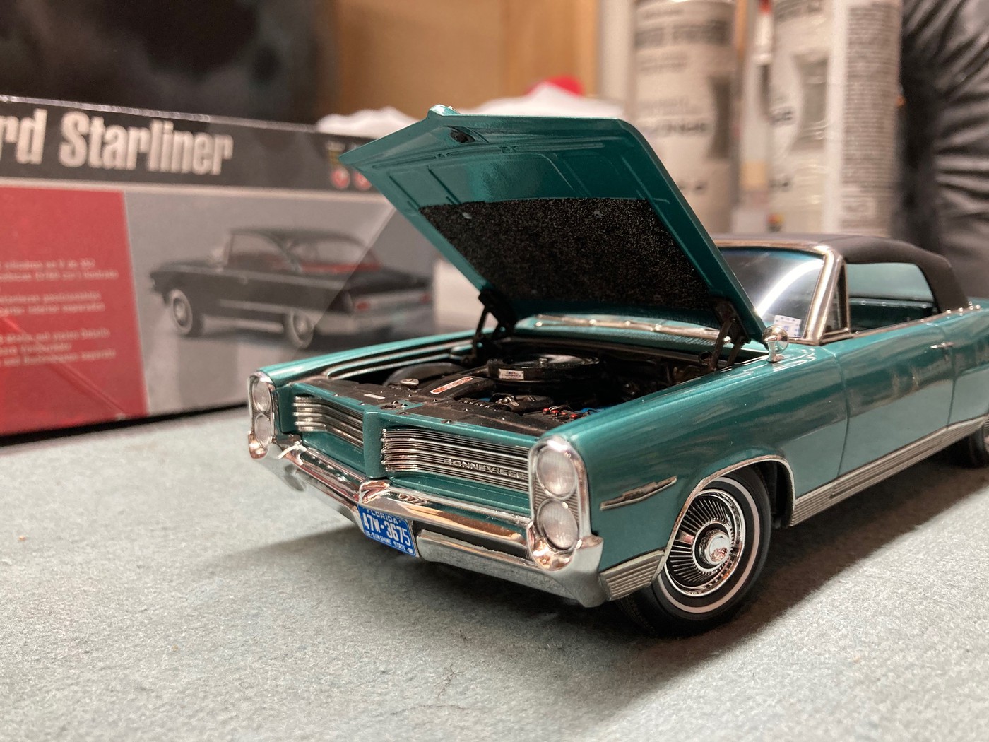

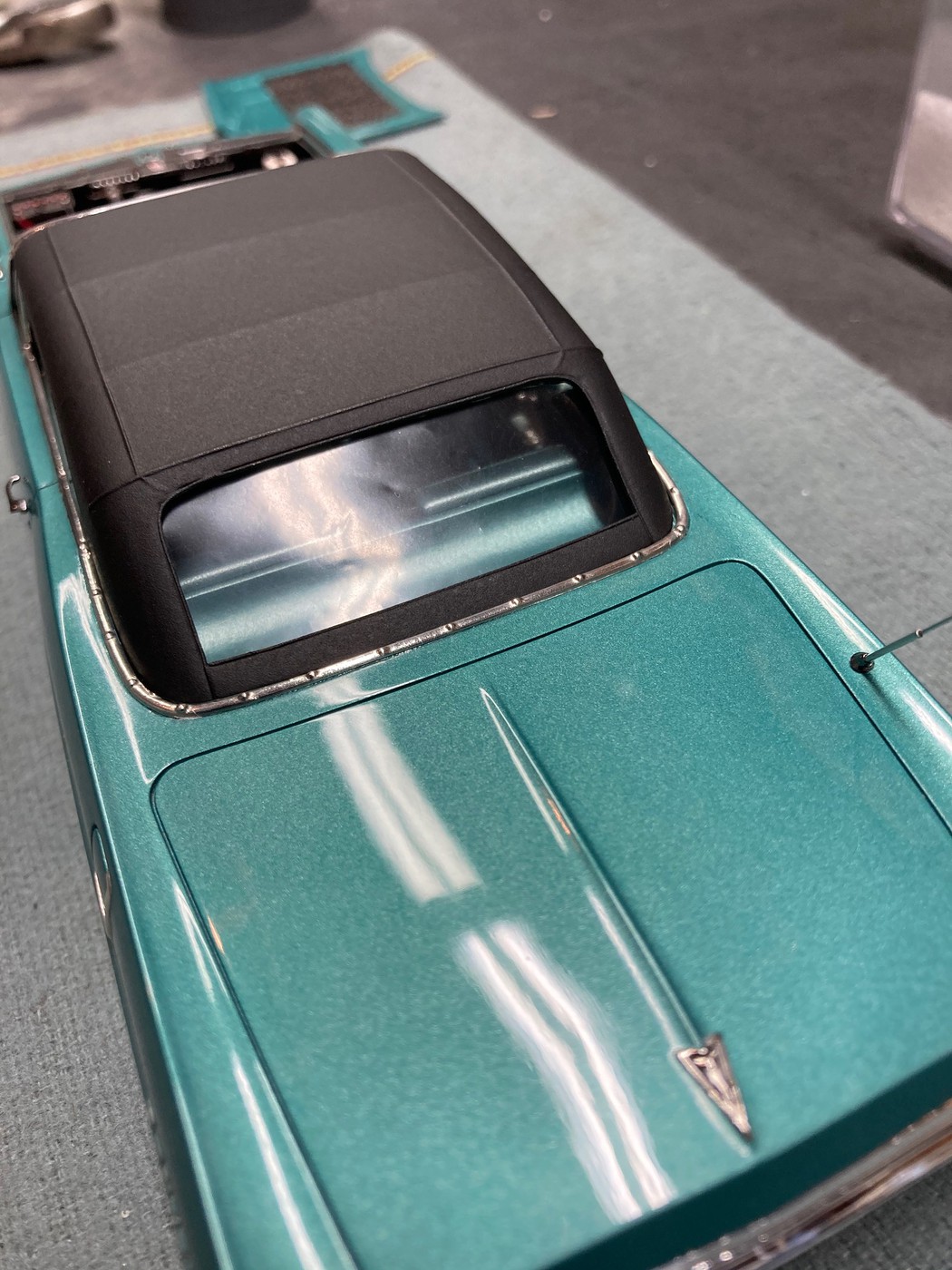

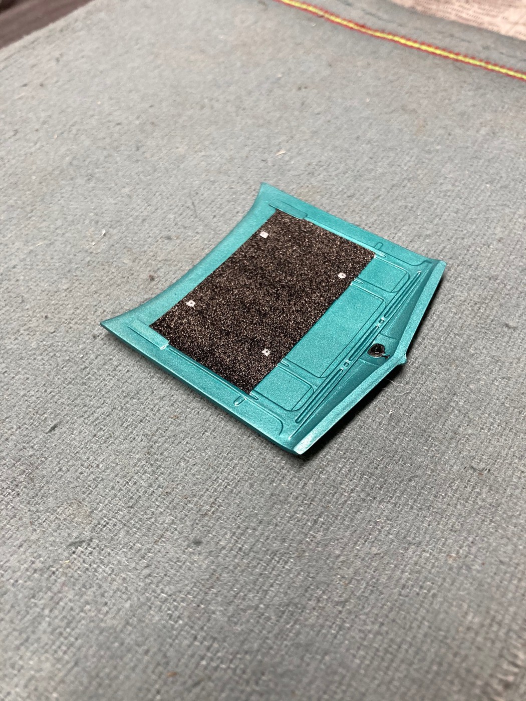

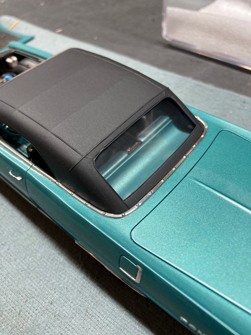

StevenGuthmiller Posted September 17, 2023 Author Share Posted September 17, 2023 So close now that I can taste it!!! Added the interior door lock buttons, exterior mirror and antenna a couple of days ago. Yesterday I polished the hood, and last night I painted the up-top and the hood insulation. This morning I added the rear window to the up-top and covered the hood insulation patch with embossing powder. I'm not certain, but I believe that all that I have left to do is dirty up the underside of the hood, and this one will be ready for the shelf! Steve 3 Quote Link to comment Share on other sites More sharing options...

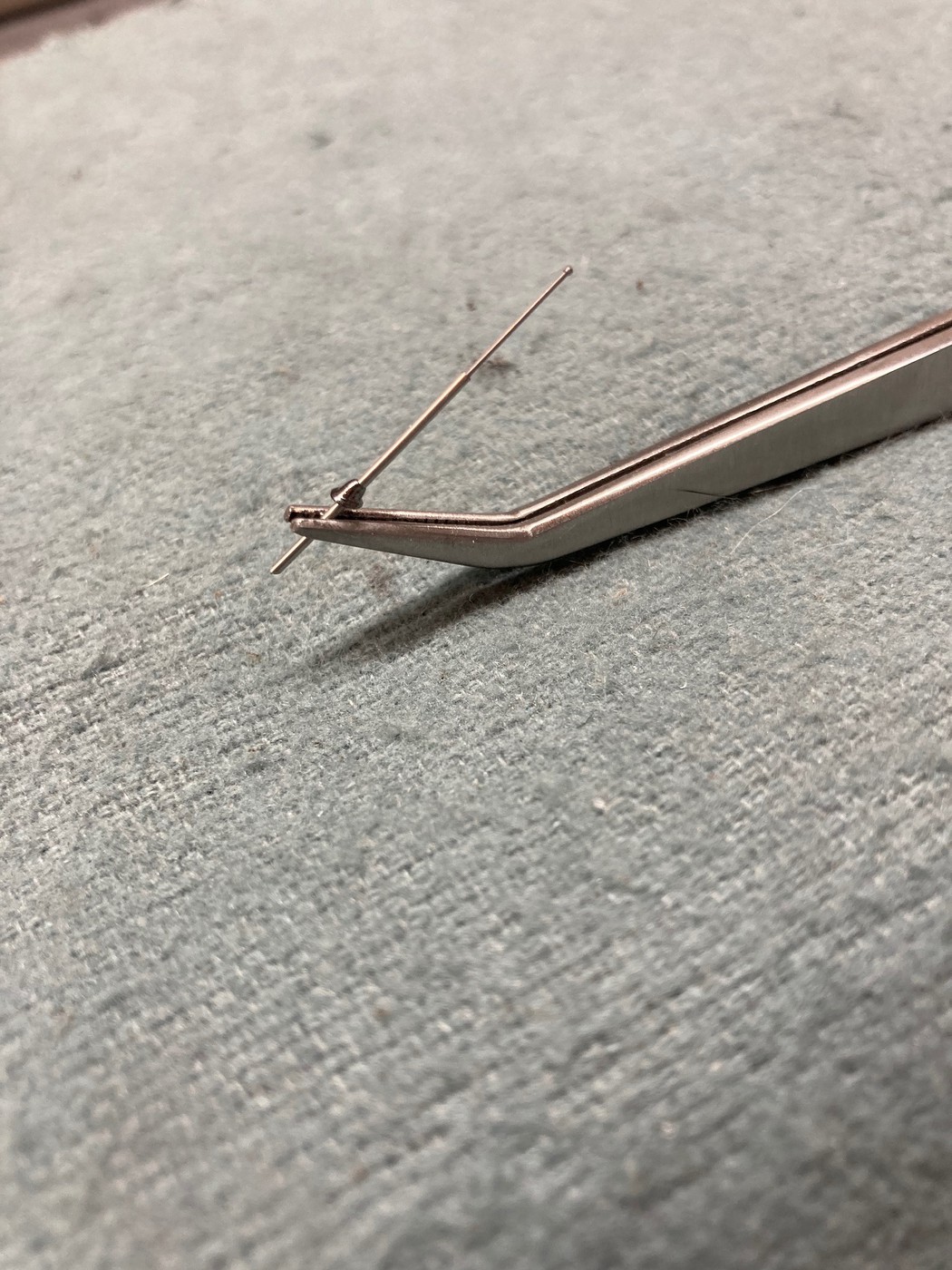

customline Posted September 22, 2023 Share Posted September 22, 2023 (edited) On 9/13/2023 at 3:04 PM, StevenGuthmiller said: Thanks fellas! Found a few minutes to get into the shop again today. Threw together an antenna, and slapped an inspection sticker on the windshield. May try to get the door handles and locks installed today, and begin polishing the hood if time allows. Steve Steve! I need 2 antennas for the back of my Impala! And I want them to look just like yours! What do I need to do to throw a couple of them together? Is it tubing and wire? (Or is it a secret? 🥴) Edited September 22, 2023 by customline Quote Link to comment Share on other sites More sharing options...

StevenGuthmiller Posted September 23, 2023 Author Share Posted September 23, 2023 (edited) On 9/21/2023 at 8:05 PM, customline said: Steve! I need 2 antennas for the back of my Impala! And I want them to look just like yours! What do I need to do to throw a couple of them together? Is it tubing and wire? (Or is it a secret? 🥴) Hi Jim. The antennas are by no means a secret. I can give you brief summary of the construction, but what I unfortunately cannot give you are the exact sizes of the materials used. The base is just made of plastic, and I didn't really record or pay attention to what sizes of rod that was used. It's my usual practice just to grab and eye ball the plastic stock until I find a size that seems about right. As for the tubing and wire used for the mast, I bought it a long time ago and don't recall the sizes. They came in 3 foot lengths, enough to last me the rest of my modeling career, so I don't believe that I saved any information on them. That said, here's a general description of how they were made. I started with the base by choosing a piece of rod that looked about right for the body of the base, and then sanded it to somewhat of a rounded taper. Once that looked about the right shape, I drilled a hole the same size as the mast tubing into the center of the cone shaped rod. Then I laid the rod on a flat surface on a piece of double sided tape to ensure it didn't end up on the other side of the room, and cut a short piece of the tapered end of the rod at an angle with a #11 blade. Then I selected a slightly larger piece of rod than the first, and cut as thin of a slice of it as I feasibly could, and then glued that slice to the bottom of the angle cut tapered rod. Using the drill bit itself as my holding tool, I inserted it back into the hole on the rod, and then sanded the bottom of the larger piece of rod as thin, flat and even as possible. Once it looked correct, I finished drilling the hole through the bottom of the base. Finally, the finished base was painted with Alclad chrome using the required method. This is of course the most difficult, or I should say, the most involved portion of the antenna, as it requires the most work. The rest is easy if you have the correct materials. The base of the mast is nothing more than a very small, thin walled, stainless steel hypodermic tubing. Yes, the same stuff that the make hypodermic needles with. You can buy it in lengths online, (I bought mine on eBay) but as I've already confessed, I don't remember the size. Likewise, the upper portion of the mast is just thin, stiff, steel wire, the correct size to fit fairly snugly into the center of the tubing. Once you have these materials in hand, it's just a matter of cutting lengths of the tubing and wire that you desire for the size of the antenna that you want. (I use a cutting wheel on a Dremel tool to cut the pieces and then grind the ends flat) A couple of turns with the tip of a sharp #11 blade in the end of the tubing to remove any burrs will ensure that the wire slips inside smoothly. For the ball on the tip of the mast, I just dip it in a little 2-part epoxy and then let it cure fully. Nothing else is really required, but if you desire, you could dip the epoxy ball in a little Molotow at the end. So, that's how I do antennas for basically all of my builds with varying methods for making the bases, depending on shape and size desired. I wish I could be more help with the sizes, but unfortunately......... Steve Edited September 23, 2023 by StevenGuthmiller 3 Quote Link to comment Share on other sites More sharing options...

customline Posted September 23, 2023 Share Posted September 23, 2023 (edited) Thanks, Steve, I really appreciate you taking time to explain. You are the go-to guy for details like this. It's amazing how much effort you put into your projects. There should be a Nobel prize for model building and you would be at the top of that list. 😉 I should have asked you "what did you use for the bottom tube?" It would have saved you a lot of time and I apologize for trying to be funny but your explanation will benefit every one of us. Edited September 23, 2023 by customline Quote Link to comment Share on other sites More sharing options...
customline Posted September 23, 2023 Share Posted September 23, 2023 (edited) For anyone besides me that was interested in the antenna thing, I found it on ebay and bought it for less than 8 bucks per 12" length. It's sold by Houston Pharma Supply. Free shipping! The 316 stainless is 0.028" OD, 0.0215 ID. An .020 wire should snuggle down inside it nicely. Thanks again, Steve, for putting on the right path. Hypodermic tubing! Who knew? (Can you tell how excited I am?) Edited September 23, 2023 by customline Added text Quote Link to comment Share on other sites More sharing options...

StevenGuthmiller Posted September 23, 2023 Author Share Posted September 23, 2023 1 hour ago, customline said: For anyone besides me that was interested in the antenna thing, I found it on ebay and bought it for less than 8 bucks per 12" length. It's sold by Houston Pharma Supply. Free shipping! The 316 stainless is 0.028" OD, 0.0215 ID. An .020 wire should snuggle down inside it nicely. Thanks again, Steve, for putting on the right path. Hypodermic tubing! Who knew? (Can you tell how excited I am?) Wonderful Jim! I'm glad that you were able to find what you needed. Finding a combination of tubing and wire that not only fit together properly, but the right size to look somewhat close to scale is the difficult part. Steve Quote Link to comment Share on other sites More sharing options...
