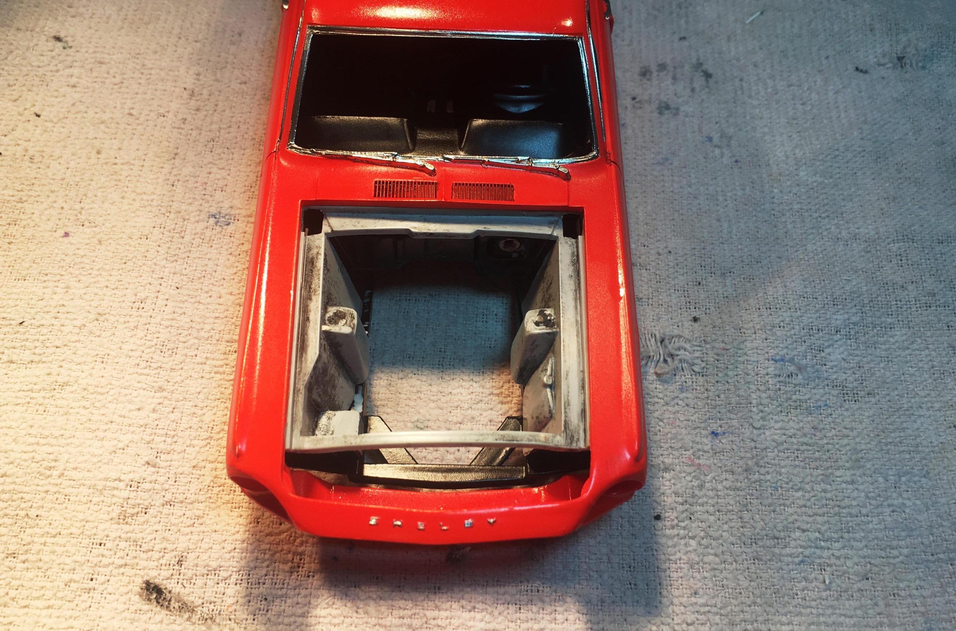

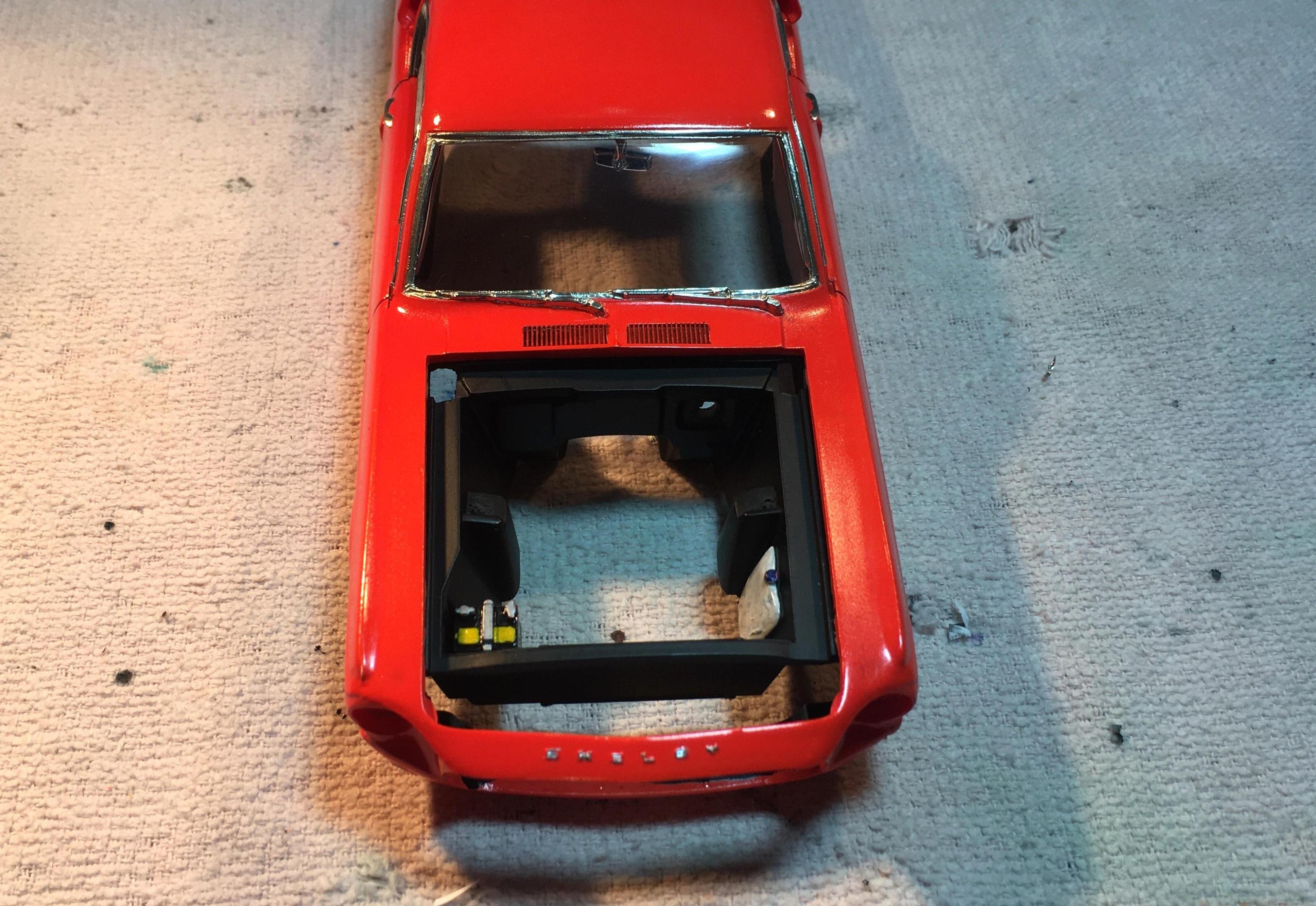

Bills72sj Posted September 3, 2022 Share Posted September 3, 2022 I recently built an AMT 68 Shelby. The engine compartment is totally lame. I grafted in the engine bay from an AMT 67 GT fastback. It worked out fairly well. Quote Link to comment Share on other sites More sharing options...
Andrew D the Jolly Roger Posted September 4, 2022 Author Share Posted September 4, 2022 Lovely work, looks great! You definitely tackled that one very nicely. 👍👍 Maybe the question I should ask is, since the target build appears to have had the grill removed and the headlights blanked over, would I be better off using a '67? Are there any other details I should take into account that would need changing? Quote Link to comment Share on other sites More sharing options...
