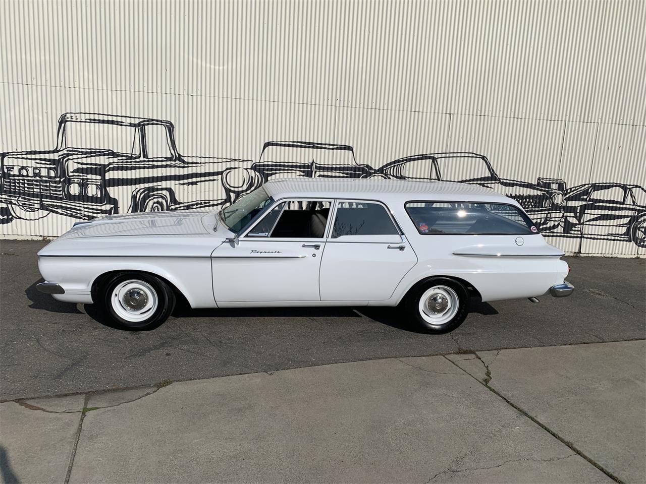

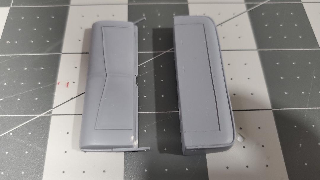

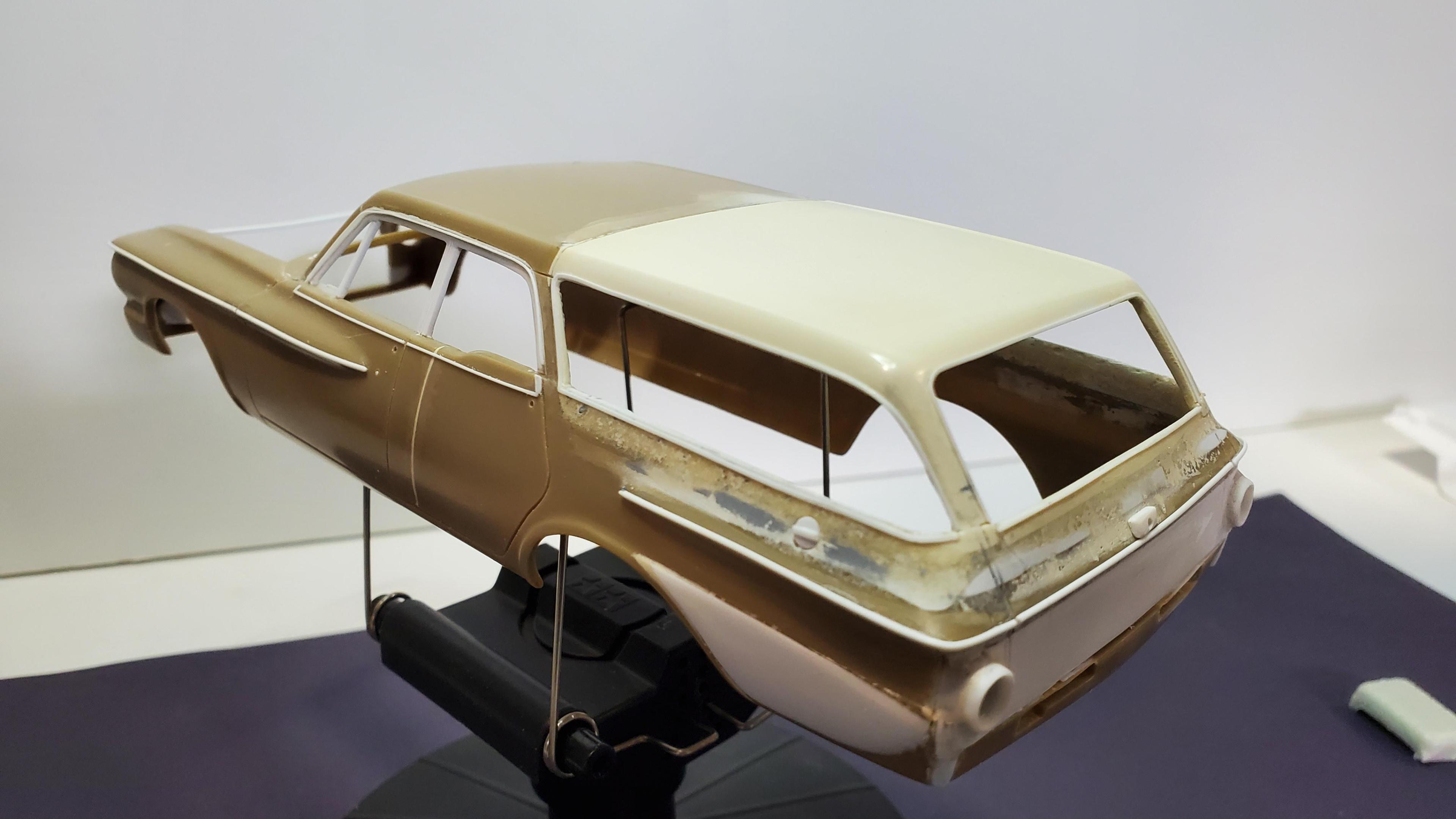

BobbyG Posted December 30, 2022 Share Posted December 30, 2022 Did some work on the 62 Johan Plymouth that I converted to a station wagon using the roof from a 60 Plymouth wagon. The body is getting closer to being done while I added molding and trim as well as shaping the 62 Plymouth rear bumper as close as I can get to the wagon version. I am using the Revell 67 Charger chassis and floor pan becuase the rear part of the chassis is close to a Mopar station wagon. The seats are modified from a Johan 63 Plymouth but cut up and detailed with piping to mimmic the 62 seat pattern. The rear interior quarter wheel houses were from the Plymouth wagon and modified and trimmed out. Still a lot more work needs to be done but progress has been made over the last week. Headlights have buckets for clear lens. I made the taillights using the 62 Ply bezel cut into a ring and carved the lens from clear red sprue. I look forward to your comments. 4 Quote Link to comment Share on other sites More sharing options...
Spex84 Posted December 30, 2022 Share Posted December 30, 2022 This is so cool! I've never been able to to decide if I find these Mopars ugly or beautiful. I'm gonna go with "handsome". Definitely worthy of an in-depth build, either way! Looks like you're on the home stretch as far as capturing the character of the 1:1 car; the carefully reworked trim around the windows should pay off nicely in the end. 1 Quote Link to comment Share on other sites More sharing options...

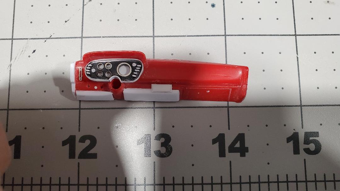

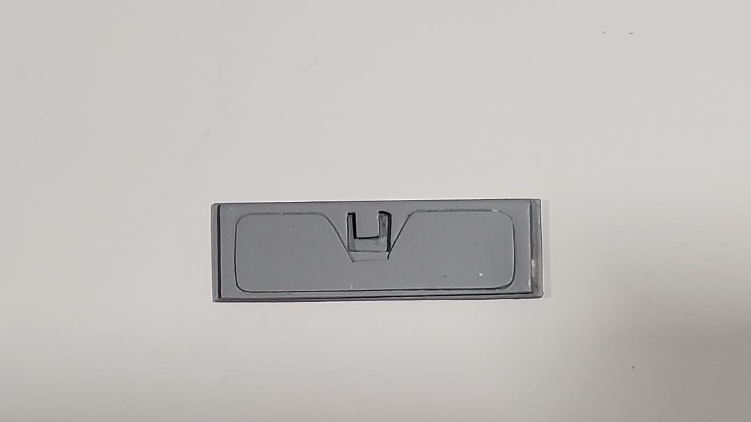

BobbyG Posted January 5 Author Share Posted January 5 Making progress on the interior and trim patterns. The gauge panel has the push botton details (ugh, what a nightmare!). Made the tail gate and primed parts. Coming closer to priming the body and making sure to clean up any imperfections. Thanks for your comments. 2 Quote Link to comment Share on other sites More sharing options...

espo Posted January 6 Share Posted January 6 The extra detailing on the interior panels looks great. What size plastic strips did you use on your seat design? Quote Link to comment Share on other sites More sharing options...
BobbyG Posted January 6 Author Share Posted January 6 5 hours ago, espo said: The extra detailing on the interior panels looks great. What size plastic strips did you use on your seat design? Thanks Espo. The piping is Plastruct .010/.03 square rod item # 90709. Quote Link to comment Share on other sites More sharing options...

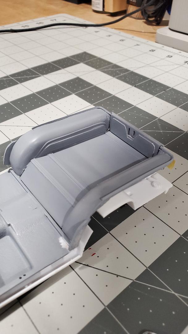

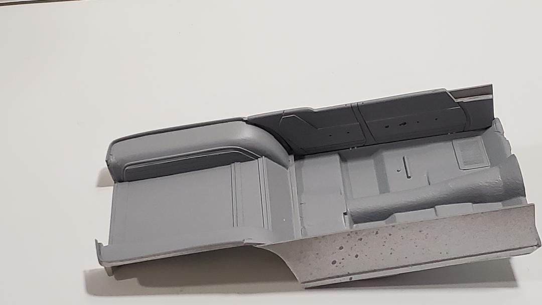

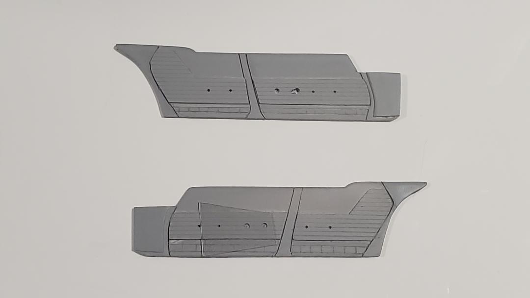

BobbyG Posted January 19 Author Share Posted January 19 (edited) Been working on the details of the body, interior and fitting. The interior floor is made from the Revell 67 Charger with scratch made rear quarters, tailgate and floor. Door panels are made of sheet plastic, scribed and ribbed door sections to emulate the 1:1. I've been playing with the scratch built gauge panel and getting it close to what I want it to be. Next is to work on the speaker grille (I'm going to see if there is anyone with 3D printer who wants to make one up). The body has all the trim pieces and polished along with the interior headliner ribs. Once I think the body is ready, I'll shoot a coat of primer so I can see any imperfections to correct. Thanks guys! Edited January 19 by BobbyG 2 Quote Link to comment Share on other sites More sharing options...

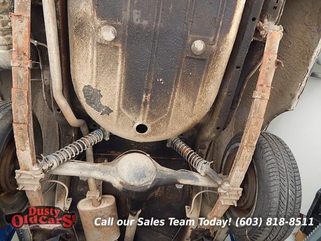

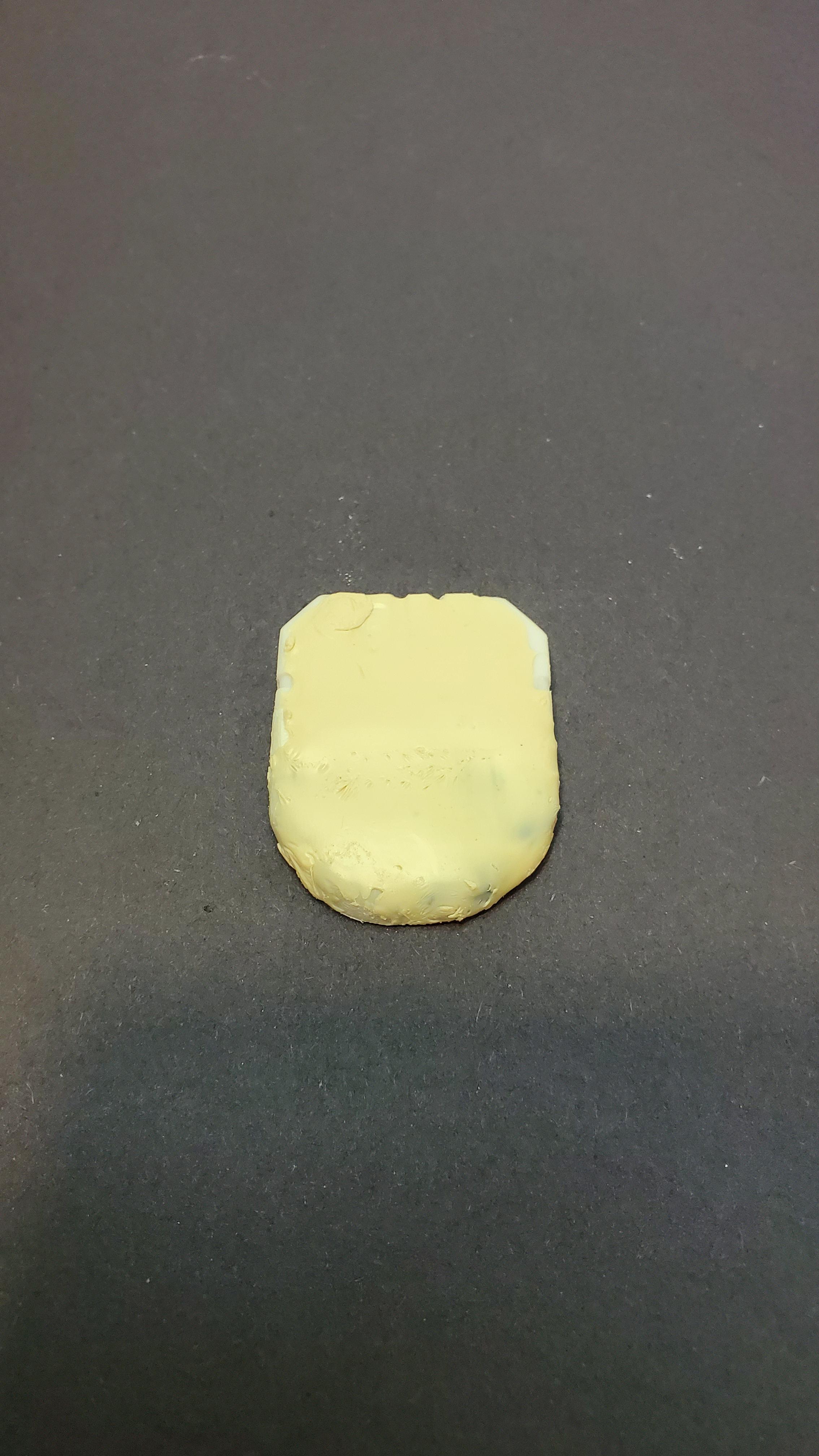

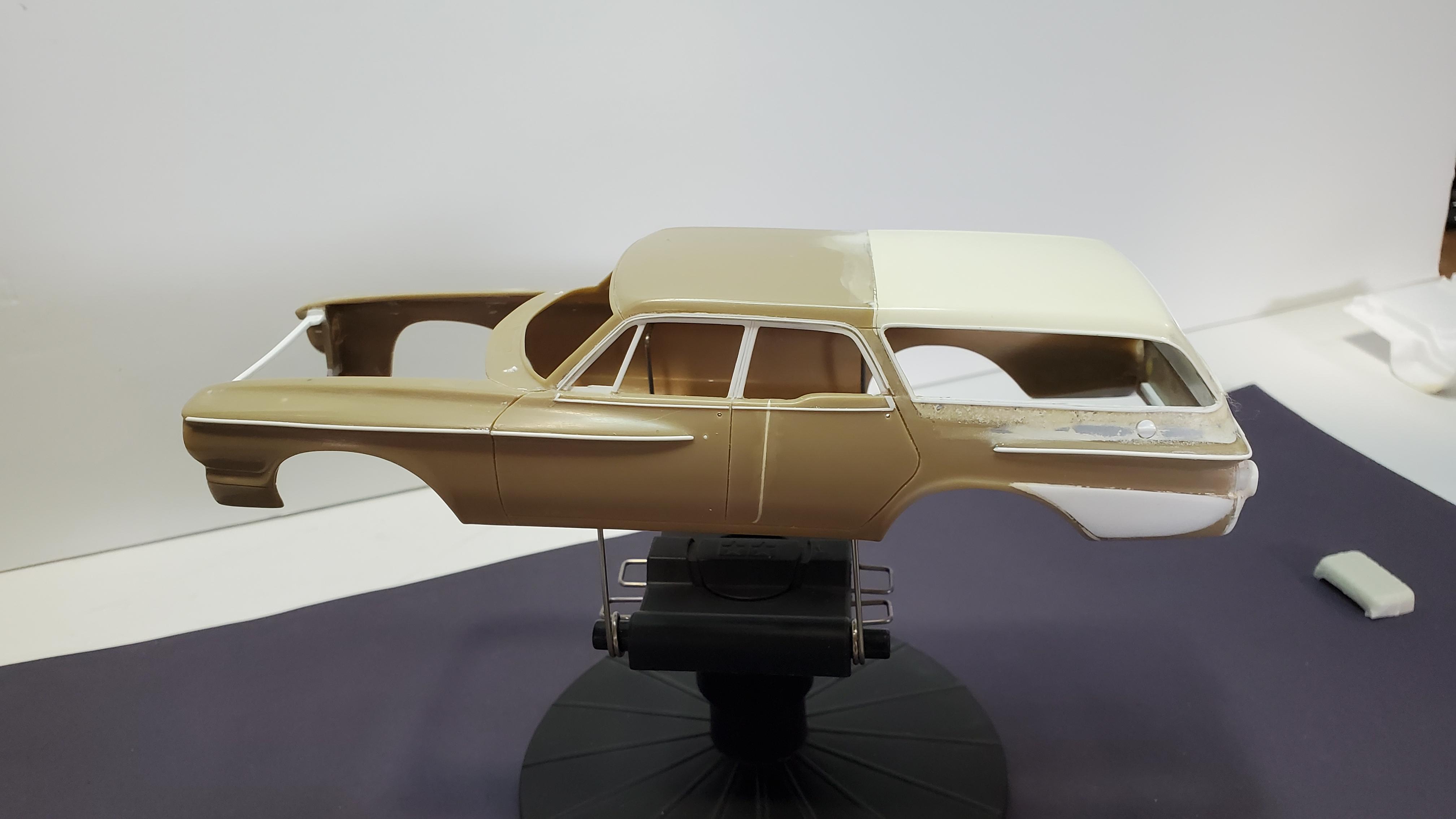

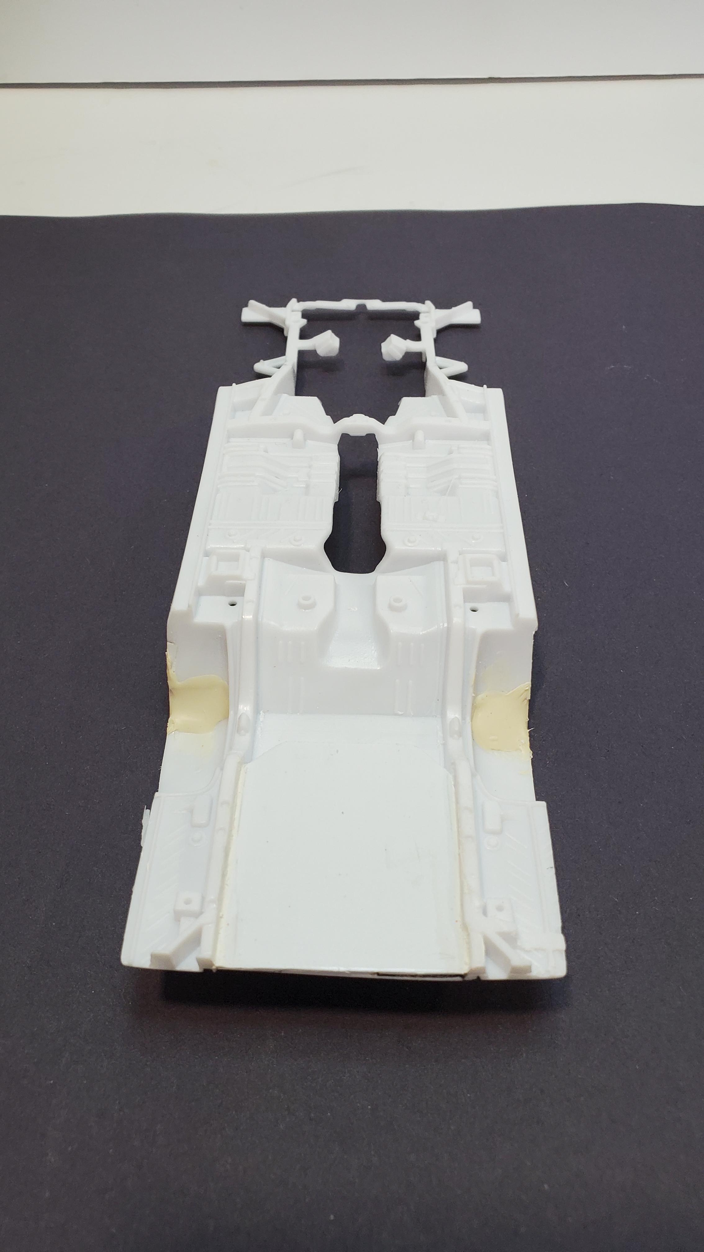

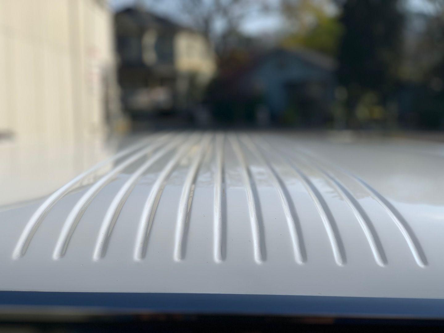

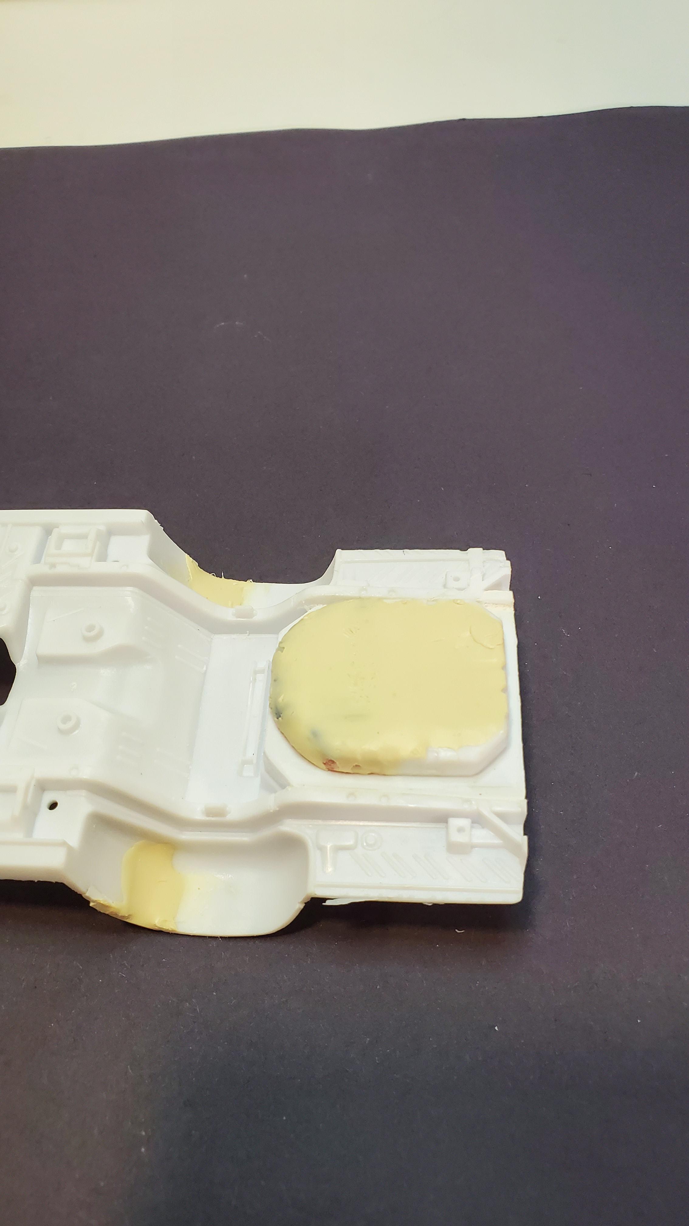

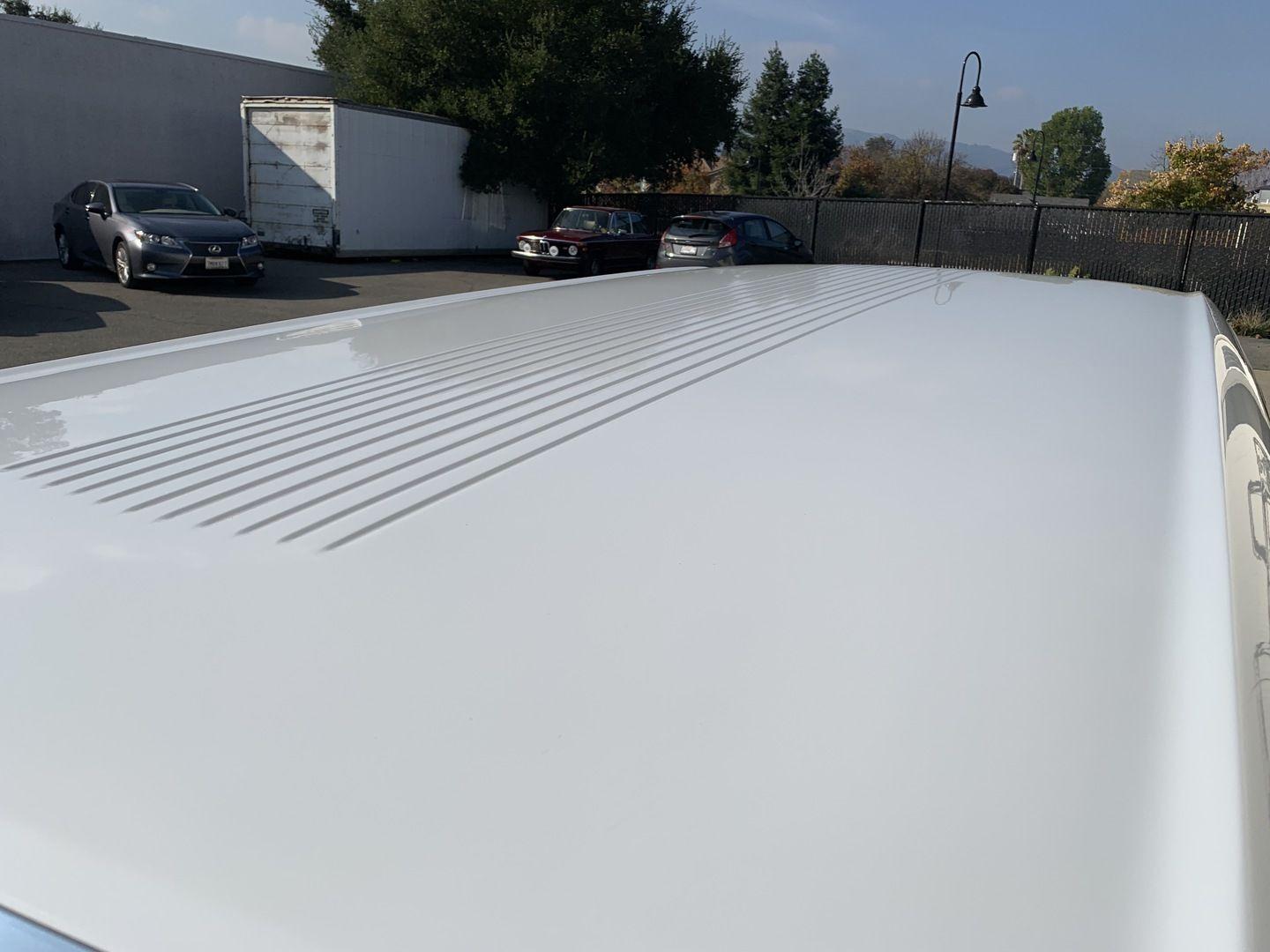

BobbyG Posted February 8 Author Share Posted February 8 (edited) Made all the appropriate trim on the body, all fit issues are corrected and working on getting the chassis details close to the prototype. I have the general shape for the tire compartment and will continue to shape and add details next. The inside fender mounted gas tank is next. The only question in mind is should I attempt to scribe the groves on the roof for total accuracy or just leave it alone and not risk destroying all my hard work. Edited February 8 by BobbyG 3 Quote Link to comment Share on other sites More sharing options...
Tcoat Posted February 8 Share Posted February 8 8 minutes ago, BobbyG said: Made all the appropriate trim on the body, all fit issues are corrected and working on getting the chassis details close to the prototype. I have the general shape for the tire compartment and will continue to shape and add details next. The inside fender mounted gas tank is next. The only question in mind is should I attempt to scribe the groves on the roof for total accuracy or just leave it alone and not risk destroying all my hard work. Those grooves are a bit too obvious to leave out. I would cut some Dyno tape as spacers to run a scriber down and go to town. Quote Link to comment Share on other sites More sharing options...
BobbyG Posted February 8 Author Share Posted February 8 4 minutes ago, Tcoat said: Those grooves are a bit too obvious to leave out. I would cut some Dyno tape as spacers to run a scriber down and go to town. 4 minutes ago, Tcoat said: Those grooves are a bit too obvious to leave out. I would cut some Dyno tape as spacers to run a scriber down and go to town. Actually, I have been thinking about using this template inorder to make the lines consistent. I found this on Hobbiest Heaven and it may work. It would be worth the $18 bucks if it works. 1 Quote Link to comment Share on other sites More sharing options...
Tcoat Posted February 8 Share Posted February 8 6 minutes ago, BobbyG said: Actually, I have been thinking about using this template inorder to make the lines consistent. I found this on Hobbiest Heaven and it may work. It would be worth the $18 bucks if it works. For sure! Nice even spacing. As long as it is well secured so it can't wiggle on you it would do the trick nicely. Be handy to have for many things actually. 1 Quote Link to comment Share on other sites More sharing options...
