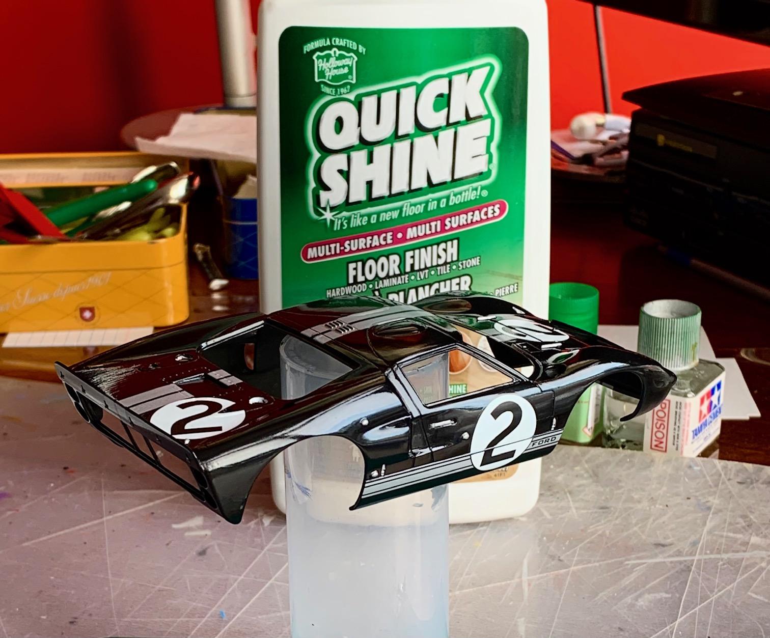

Pierre Rivard Posted March 22 Share Posted March 22 So now that Future is now a thing... of the past....and that my stock is running low, I decided to try Quick Shine Tried it on a discarded body that was painted a long time ago. I scuffed it with 4000-6000-8000 and brushed on the Quick Shine. Brushes on even easier than Future. I'll check in a few days to see if becomes reasonably resistant. Promising. 4 1 Quote Link to comment Share on other sites More sharing options...

Joe Nunes Posted March 23 Share Posted March 23 The Quick Shine looks good on your model. Did you brush the QS over the windows at the same time you applied it onto the car body? Did you use a soft bristled brush or a foam brush? Thanks. 🙂 Joe Quote Link to comment Share on other sites More sharing options...
Pierre Rivard Posted March 23 Author Share Posted March 23 Rich, I never tried Looks Like Glass. Thanks for the tip. For now my goal is to see if Quick Shine can replace Future. I clear my bodies with Tamiya X22 and polish it before decals. I future over decals as a seal coat only. It's gentle to decals and the gloss goes up if the surface below it is very smooth. It took time for me to refine my process so for now would like to stick to it. Joe, I brushed it on with a soft bristle brush just like I do for Future. It is easier than Future because less sensitive on overlapped areas because it settles a little slower. I did the fingernail test to the finish this morning (about 15 hours after brushing it on) and it passed the test. Appears to be a tougher finish than Future. I tried glass this morning. One piece came out ok, the other I goofed and try to redcoat without success. Surprise, Windex does not wash it like it does for Future so I'll probably have to buff that piece and re-coat. More testing needed but I think Future is still best for glass. 1 Quote Link to comment Share on other sites More sharing options...
