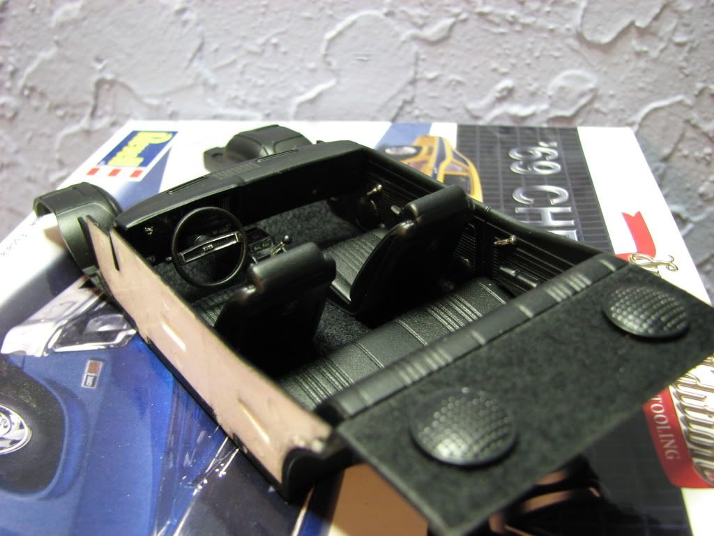

LOBBS Posted June 21, 2010 Share Posted June 21, 2010 You could also BMF the door locks and other trim just prior to your last color coat. Trim the BMF as close as you possibly can then lay down the final coat. When that coat is dry and before you clear take a Q-tip and some 91% isopropyl alcohol and/or some fine sandpaper and remove the color from the BMF. Trapping the edge of the BMF will help hold it down for the long term. Almost all the chrome trim on my Nova interior was done this way. Quote Link to comment Share on other sites More sharing options...
