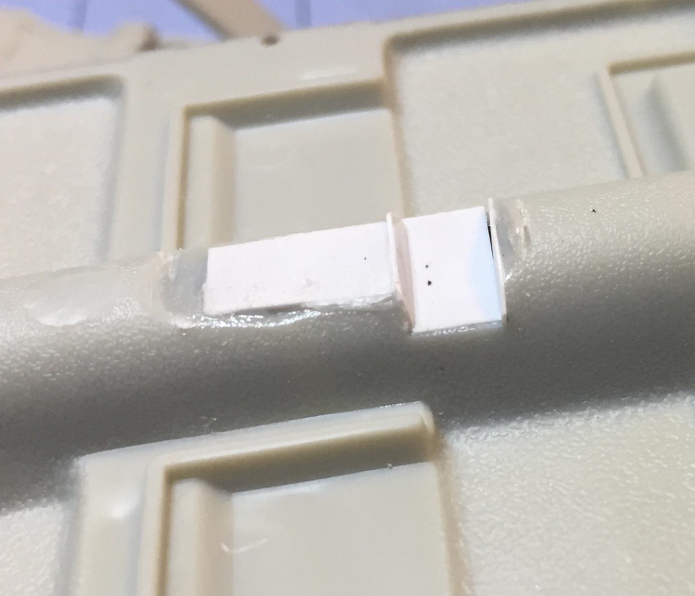

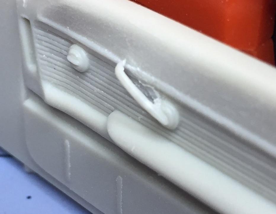

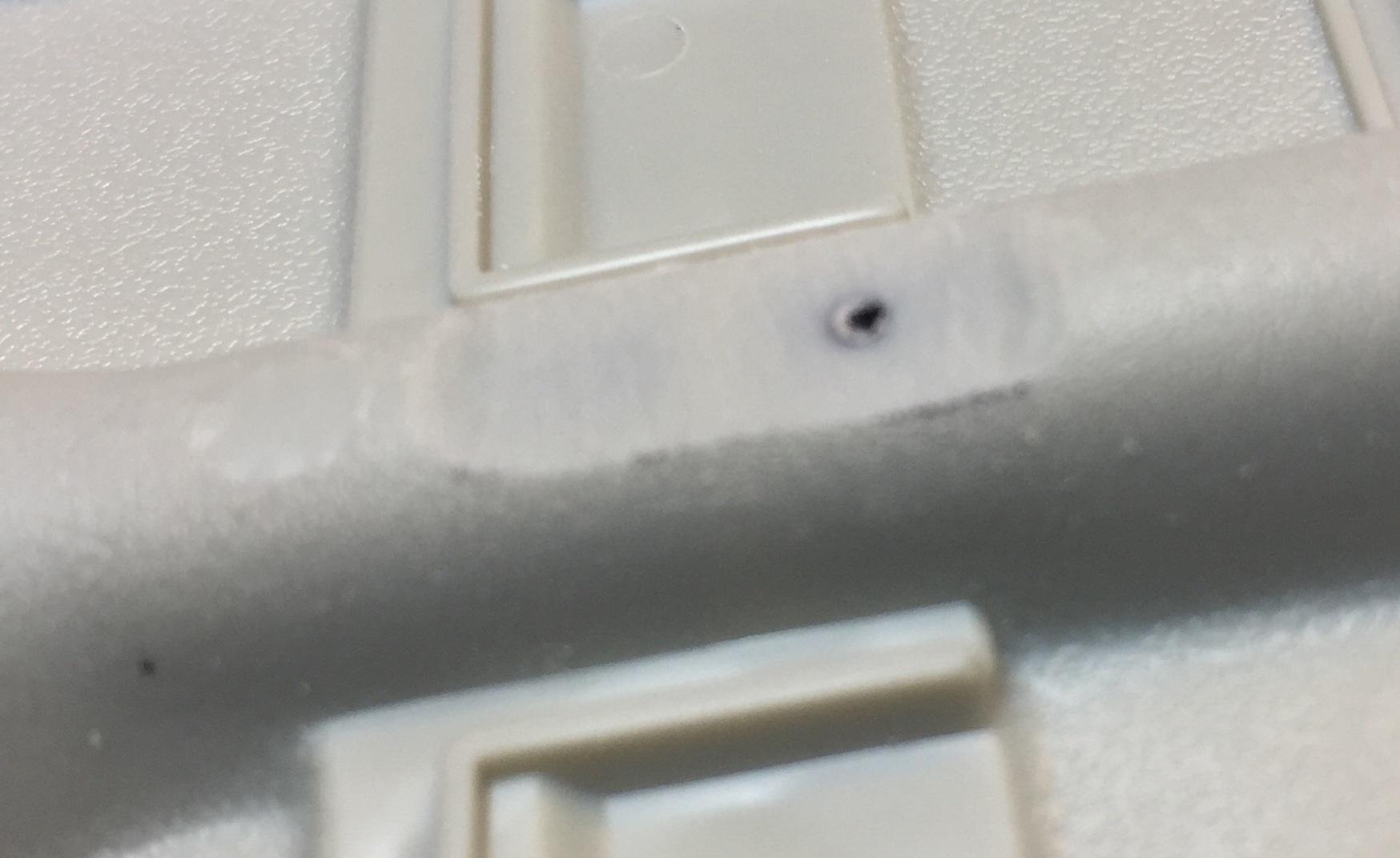

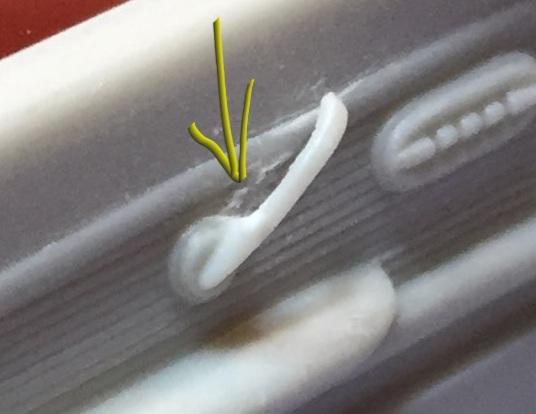

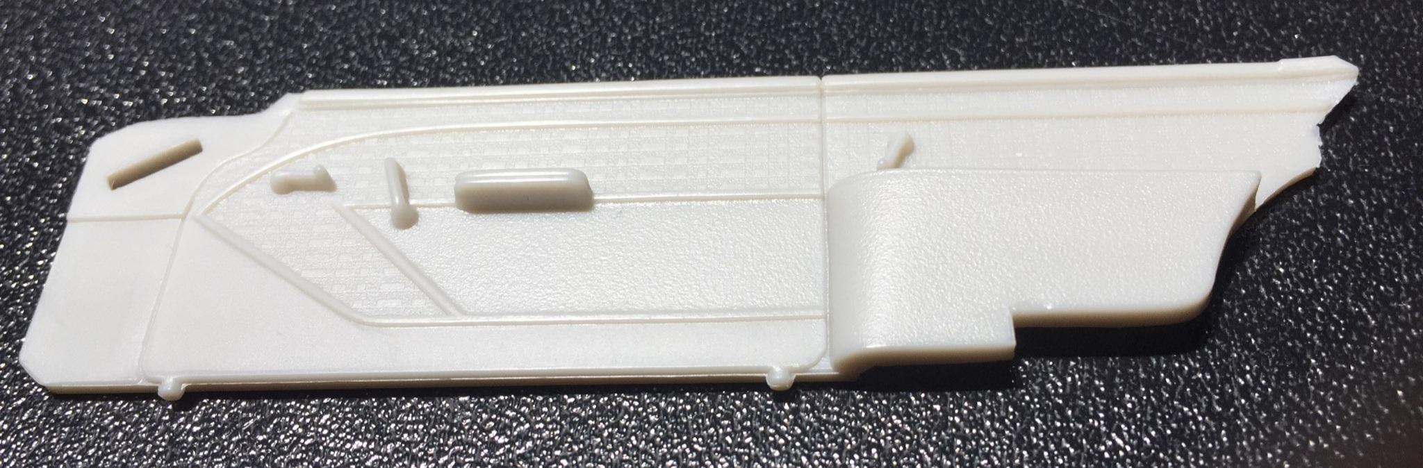

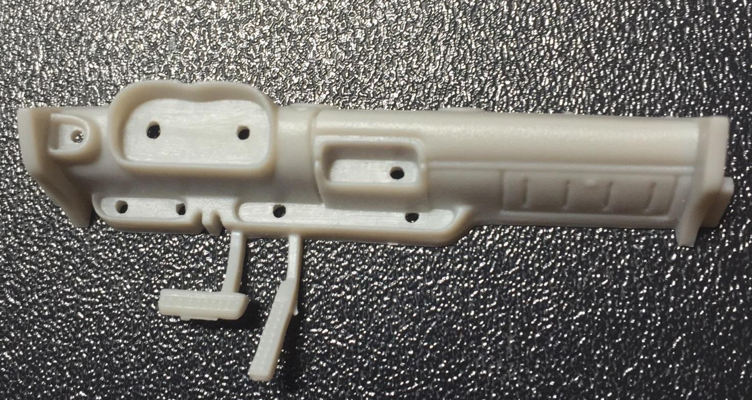

Greg did a really nice detailing job on his interior and I was at the point of just painting the damned thing and getting on with it. But I then felt shamed ?. Okay, so even though I had a coat of primer on it I thought I should make an attempt to at least make some cranks and handles. I started by drilling in the centers of the hardly visible escutcheon and then discovered I could center-drill a piece of .100 evergreen rod and slice off thin pieces with my PE saw blade. I could then insert an .020 brass wire through the door panel and slide the new escutcheon down the wire and hit it with a tiny drop of solvent to bond it. then I found I could center-drill a piece of evergreen 1/16 rod and bend a piece of .020 brass wire into a crank shape and CA glue the wire into the rod. I then sliced off the 1/16" rod leaving a knob on the new crank. I finished off the knob with a drop of CA. The handles are just more .020 wire bent to shape. Simple. Not great, but adequate. Better than nothing. You can probably cast some handles and cranks but for me it's just not worth all that. After the interior is painted, I will add the new hardware and paint appropriately with Molotow and some ivory enamel. Easy. ?

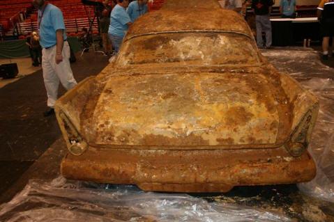

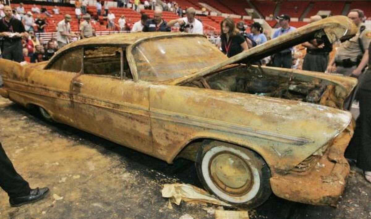

Nice job detailing the exhaust, etc. Not easy for some of us (me). Maybe a bit of rust on the resonators and tail pipes would be appropriate. Here's how I recall the '57 Ford back home in Southern New England: ?...sorry, had to.

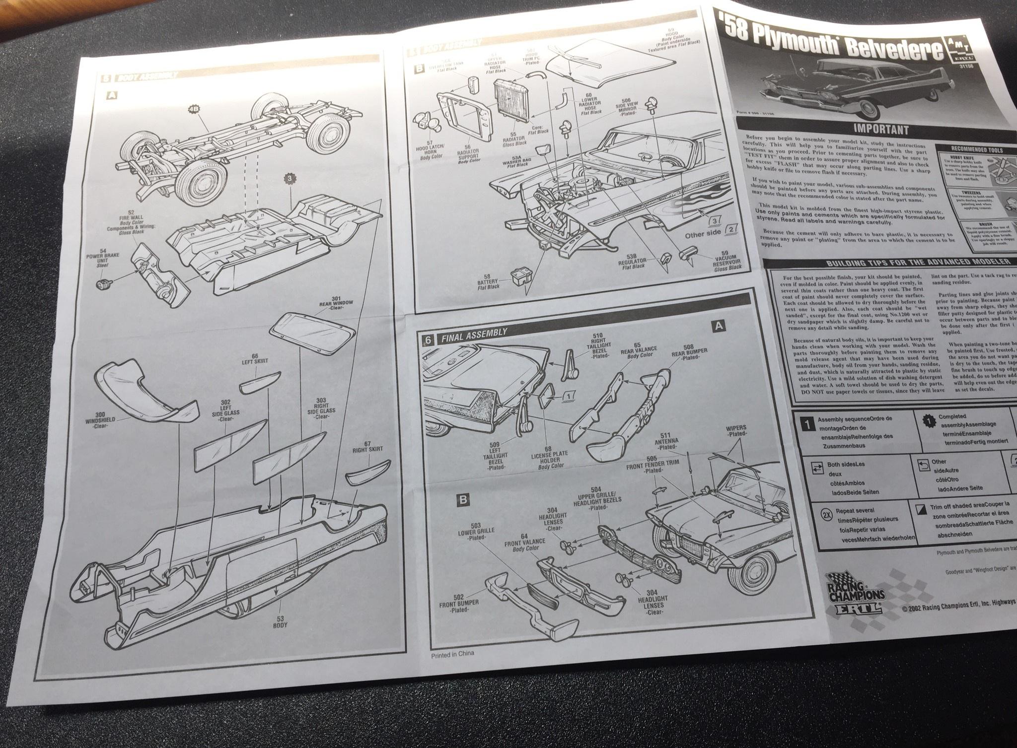

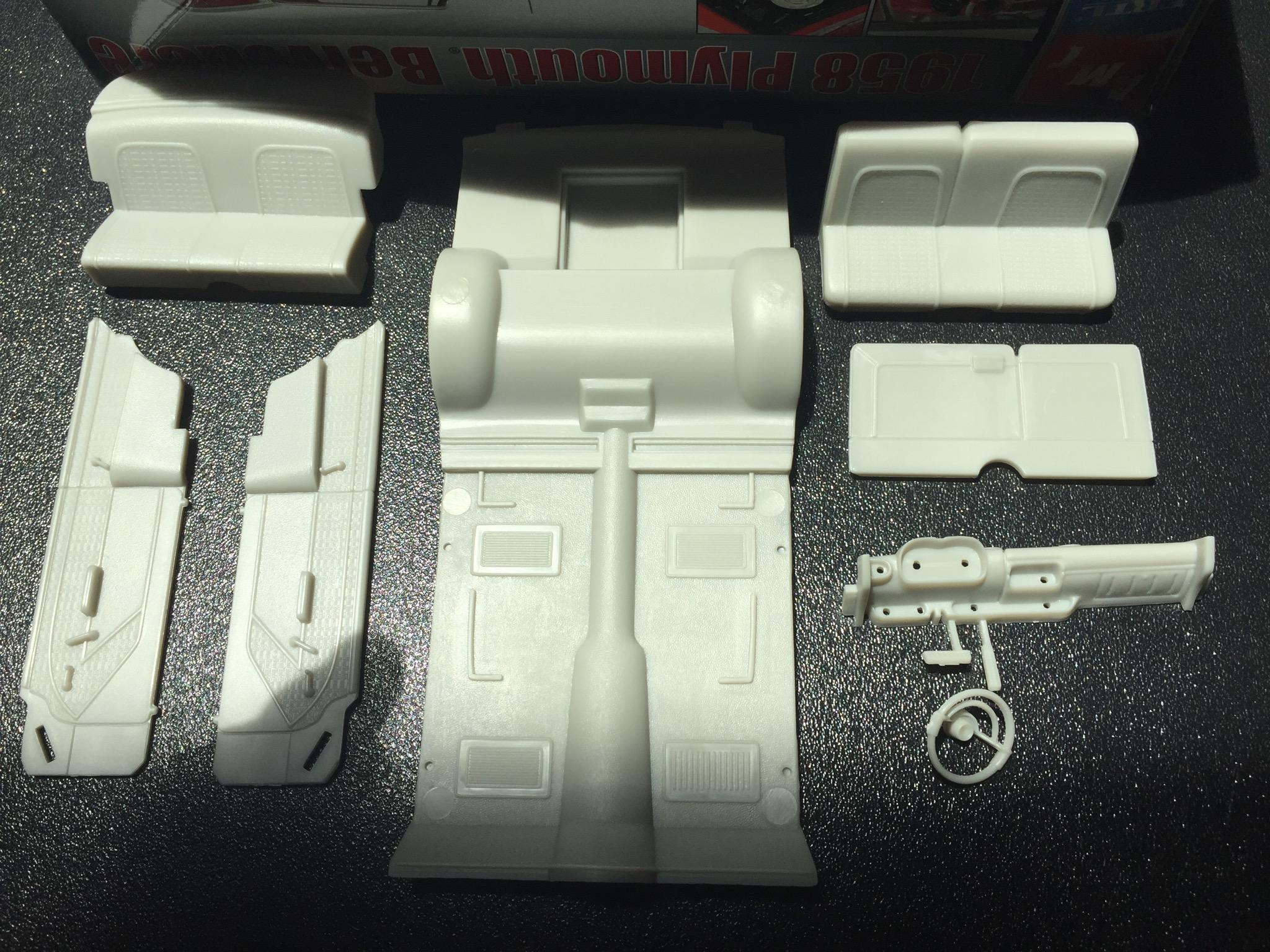

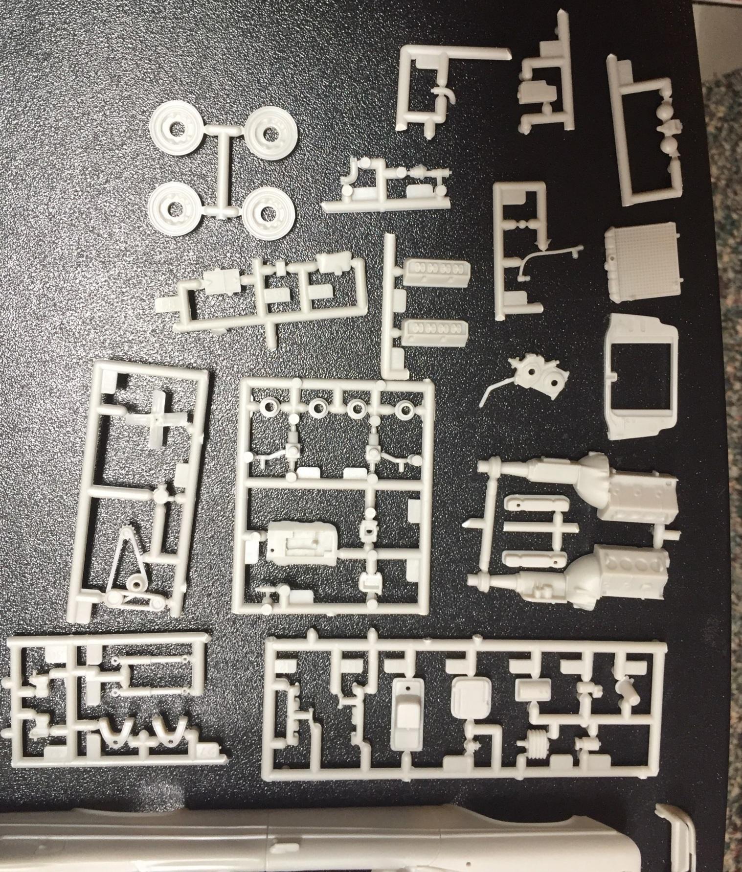

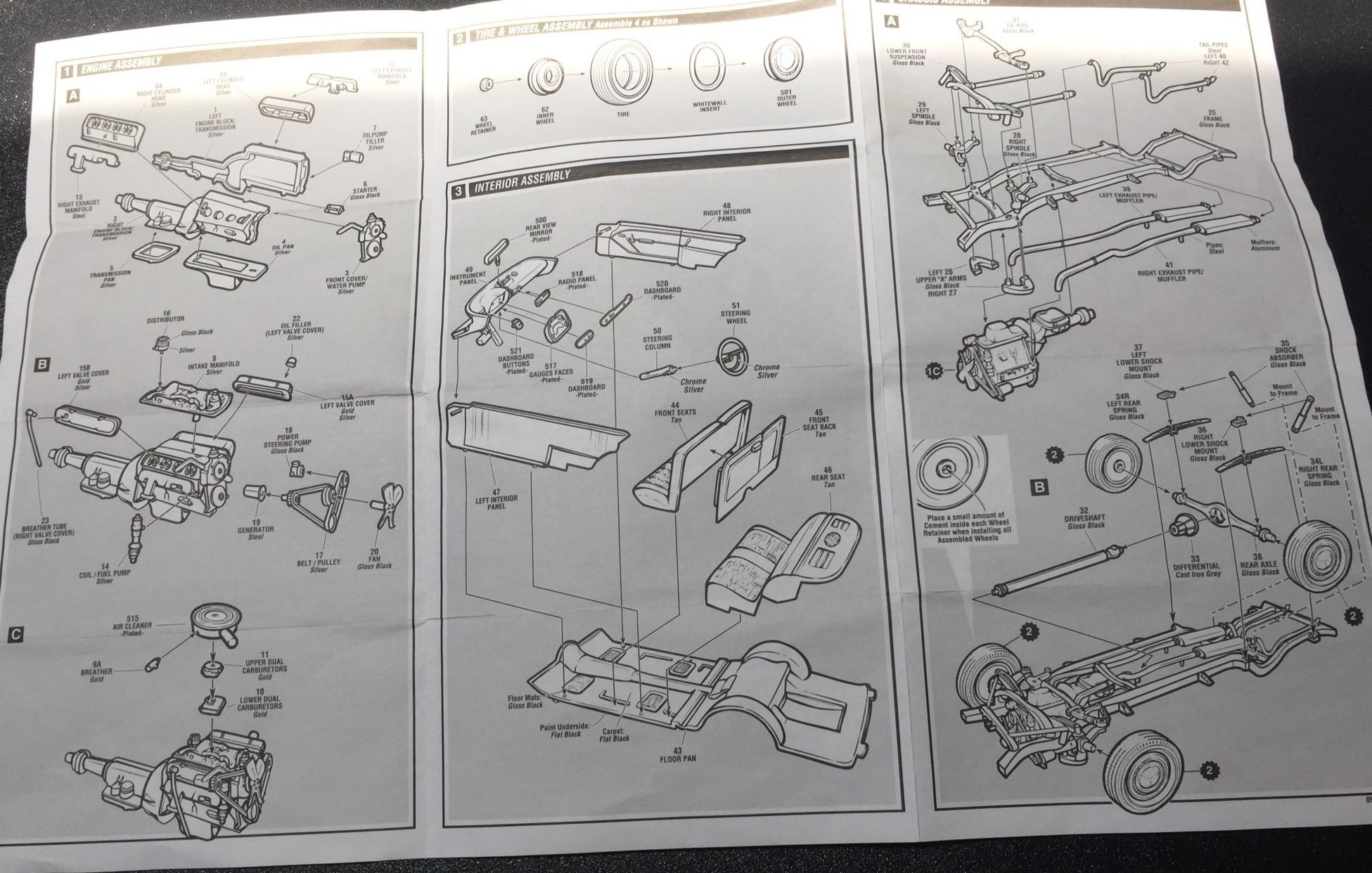

Hey, David, I have the same '02 kit. How's your hood? On the outer surface, there is some "sinking" that can be felt. Block sanding will be needed. I'm not seeing any flash, it seems fairly crisp. I am scratching my head, however, over what was plated and what was not. ?
