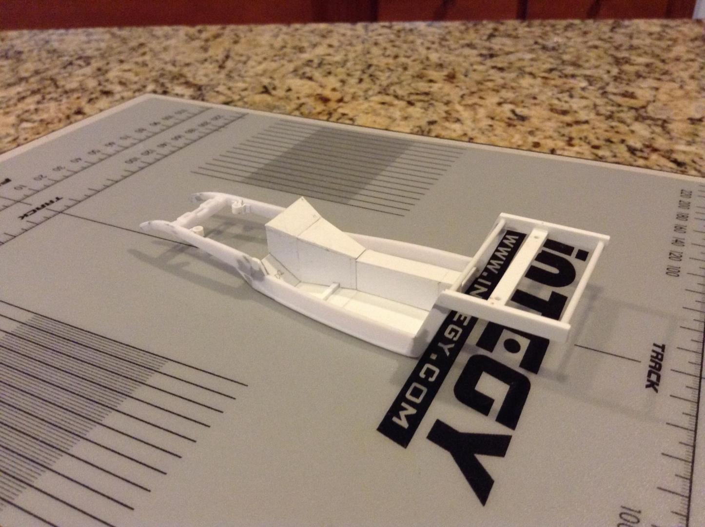

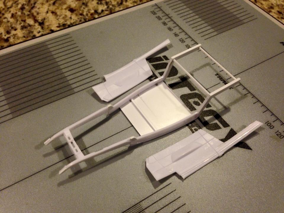

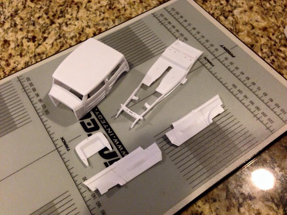

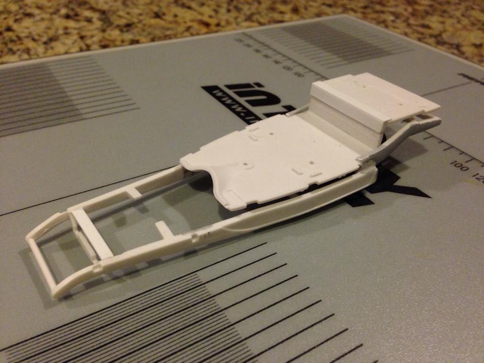

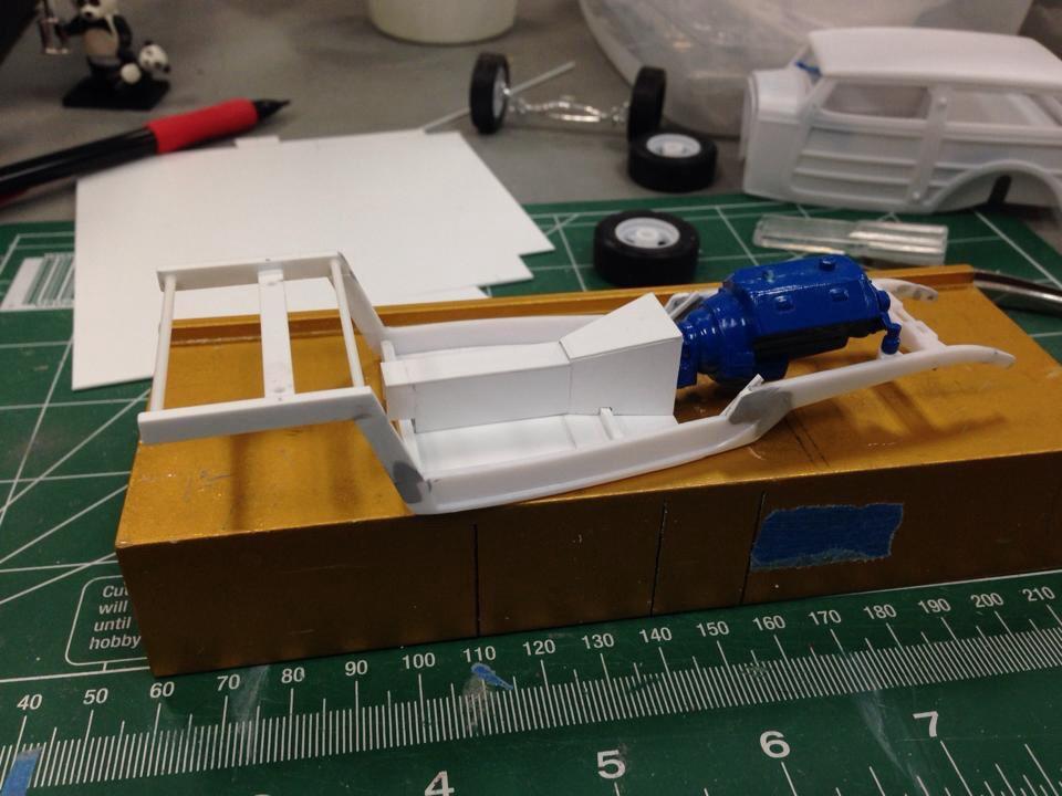

James, the trans tunnel is outlined on the floor. I then take measurements and draw the pieces on index card. I cut out the pieces from the index card and see how they fit on the model. Once any adjustments are made, I then transfer those measurements to the sheet styrene and cut it out. And further adjustments are handled, and the pieces are glued together.
2/3s of the trans hump roughed in. The front 1/3 will be the foot wells, and where it blends into the firewall.

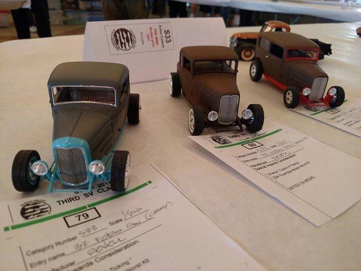

You won't get any arguments from me on that Michael. These are three of my other finished Deuces from Saturday.

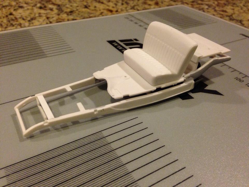

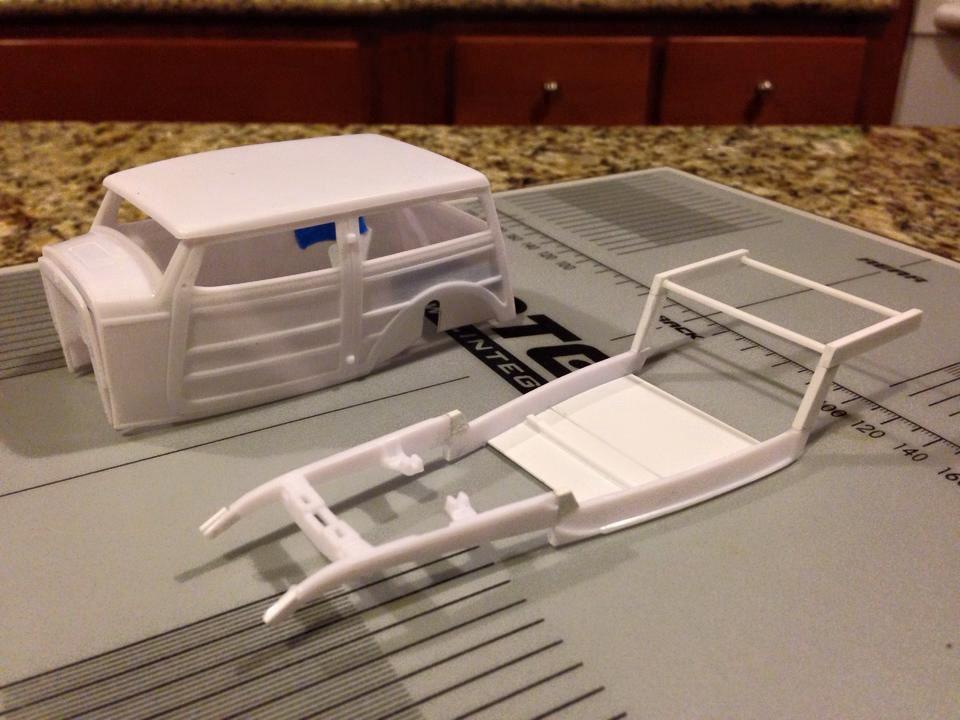

Thanks for the kind words everyone! I tend to build my models as if they were something I would drive 1:1. Thus, some of the mods I do are referenced from magazines. If you look at the new scratch built motor mounts, you'll notice they're for a flathead. im not super detailed like a lot of the others here on this forum, so I usually won't include brake lines, fuel lines, throttle linkage, etc........building w/ that much attention to detail is hard enough 1:1, I just build car models to relax. Rob, I have over 24 car models in various stages of construction, in various boxes, I will no doubt find them one day. But in the meantime, I'll mess w/ this one.
To me rat rodding is more than a faded paint job, and being slammed to the ground. It's a mix of unlike materials combined together w/ "flow", and it all works out together. This project is just going to be lowered hot rod someone built. If if I was going to rat rod it, I would have used screening for the floor board, sheets styrene for the side panels, and well worn bucket seats.

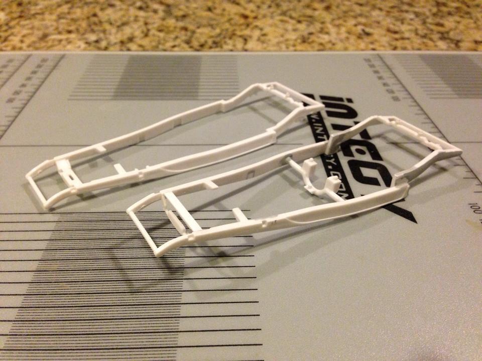

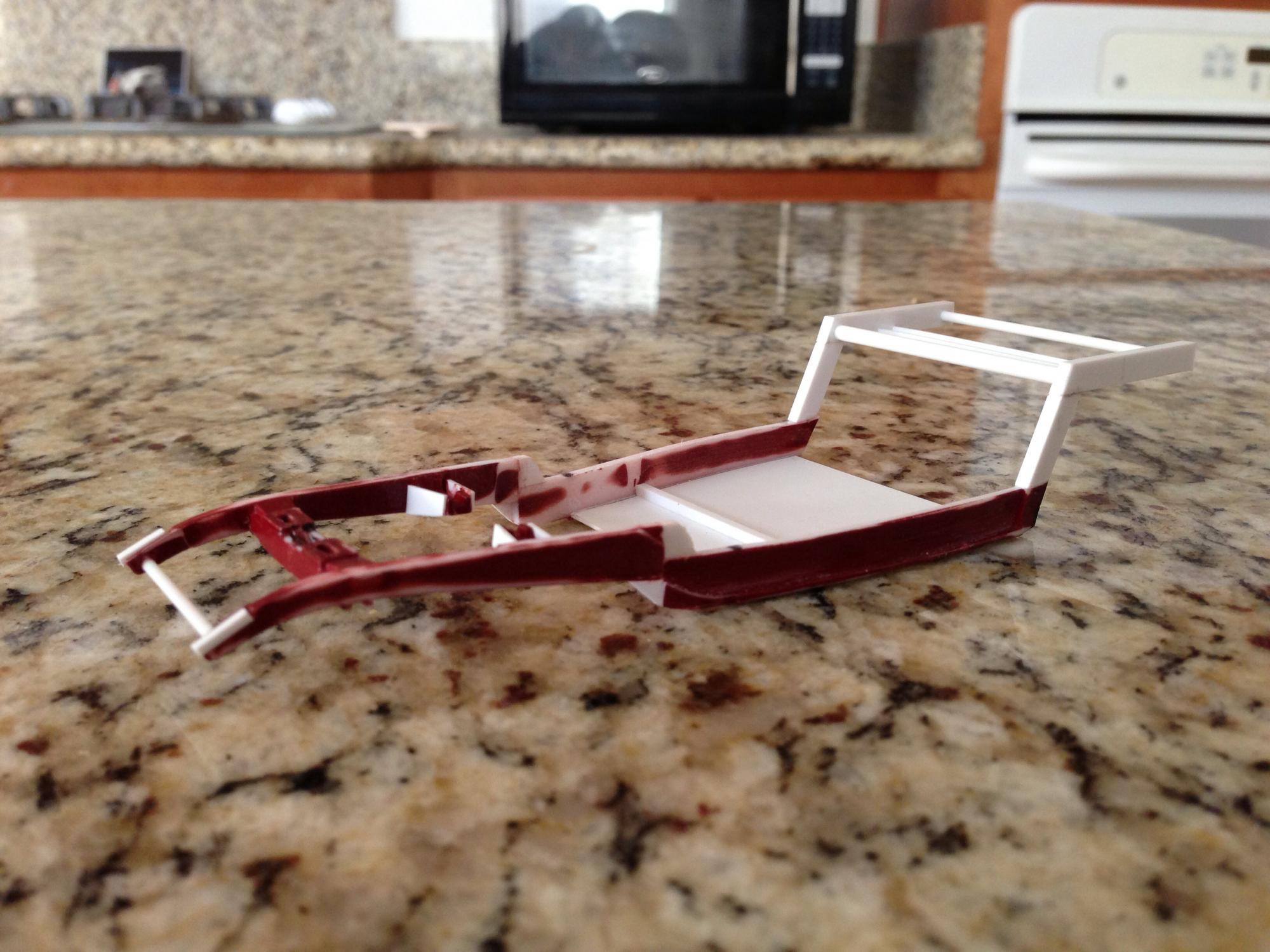

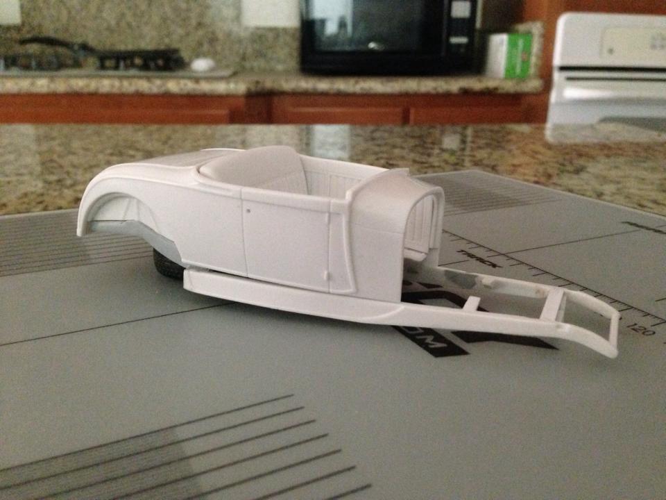

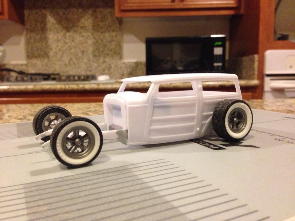

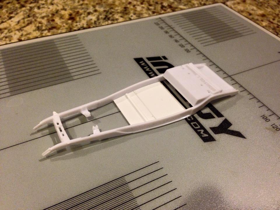

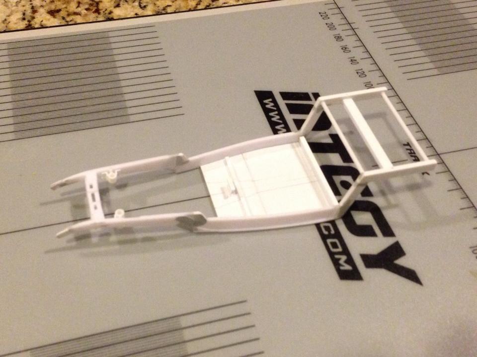

I was sitting in traffic, when I got this idea. So I went home, cut the back half off of the front crossmember, and glue in a piece of styrene to lower the front suspension. Then I Z'd the rear suspension and modified the floor pan. I'm going to have to modify the radiator to get it to fit, and notch the underside of the frame rail to get the spring to clear.
