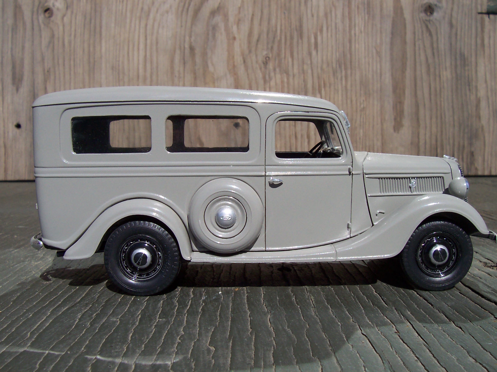

f1ford48 replied to f1ford48's topic in Model Trucks: Pickups, Vans, SUVs, Light Commercial
Thanks ,it was a curbside- no real engine detail and the interior only minimal. the vehicle actually existed and was converted from the panel by the Proctor/Keefe company . I got the photos to do it correct from James K. Wagners' book ''Ford trucks since 1905'' -

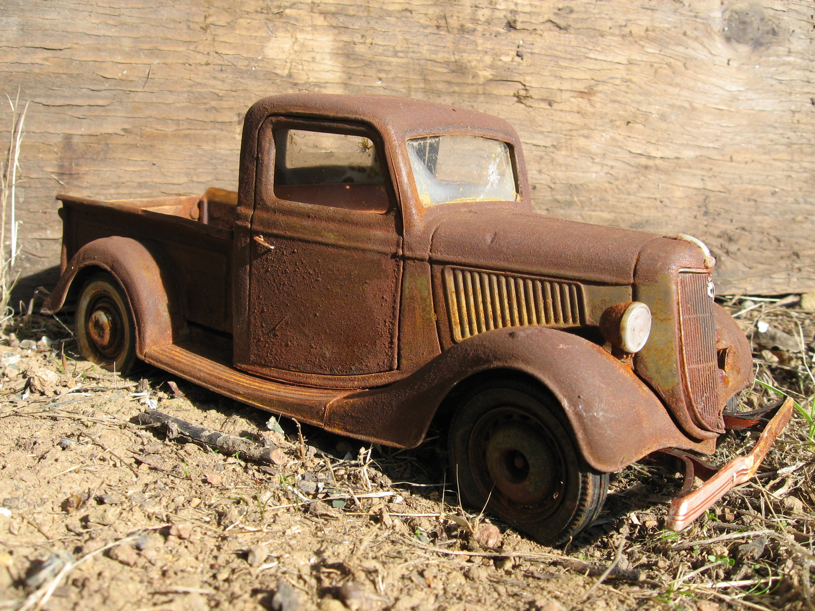

thanks guys and welcome..this IS going to be stock-or as close as I can get it. I like period and nostalgia Hot Rods- but that's about it. - if you've seen my other builds I tend to steer towards ''drivers'' -they look more real -I like a little rust with my dust. my goal is to take a photo of the finished model and have the viewer think its the real thing...like this A pickup I did long ago. -
