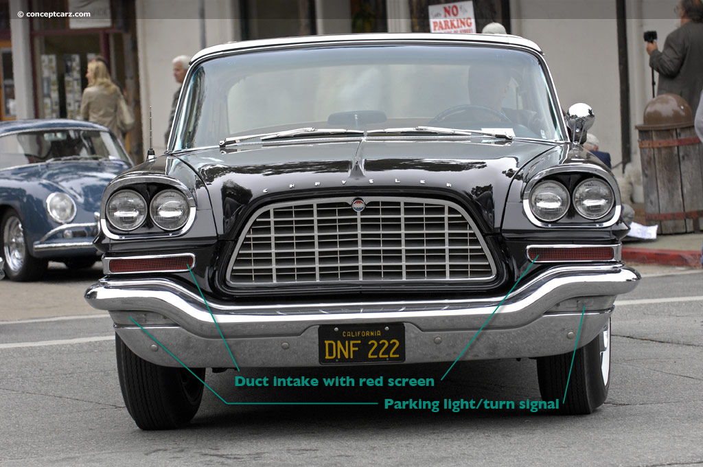

  5. Beautiful build, Peter! Great job overcoming the fit problems and getting it to sit right. Just one final detail if it's not too late... the red "blinkers" on the kit are actually intakes for duct work that have a red-painted screen over them. The parking light/signal lenses on the real car are clear plastic set into the corners of the bumper, like all the '57 Chryslers (though not well-defined on this kit.)
