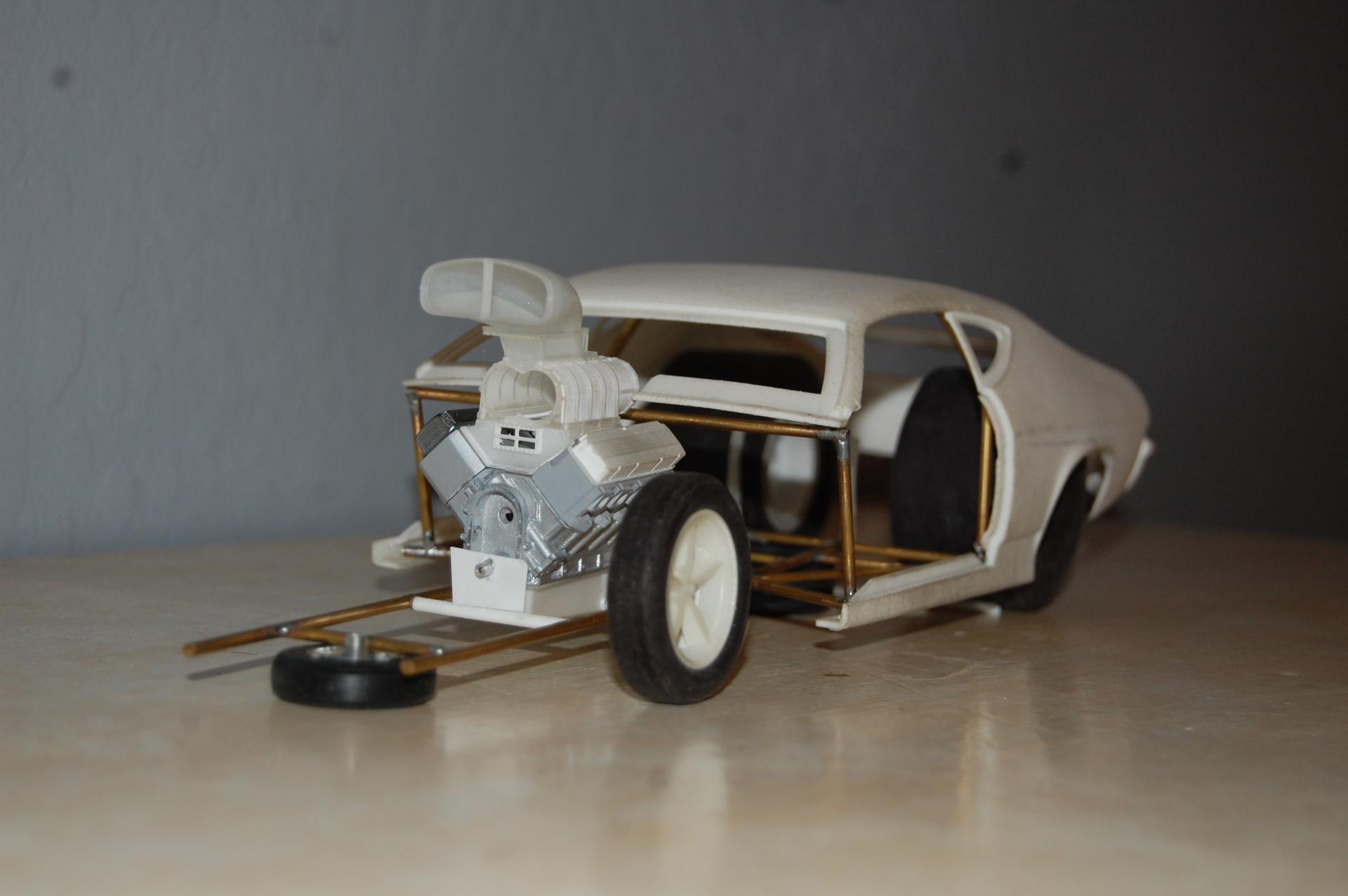

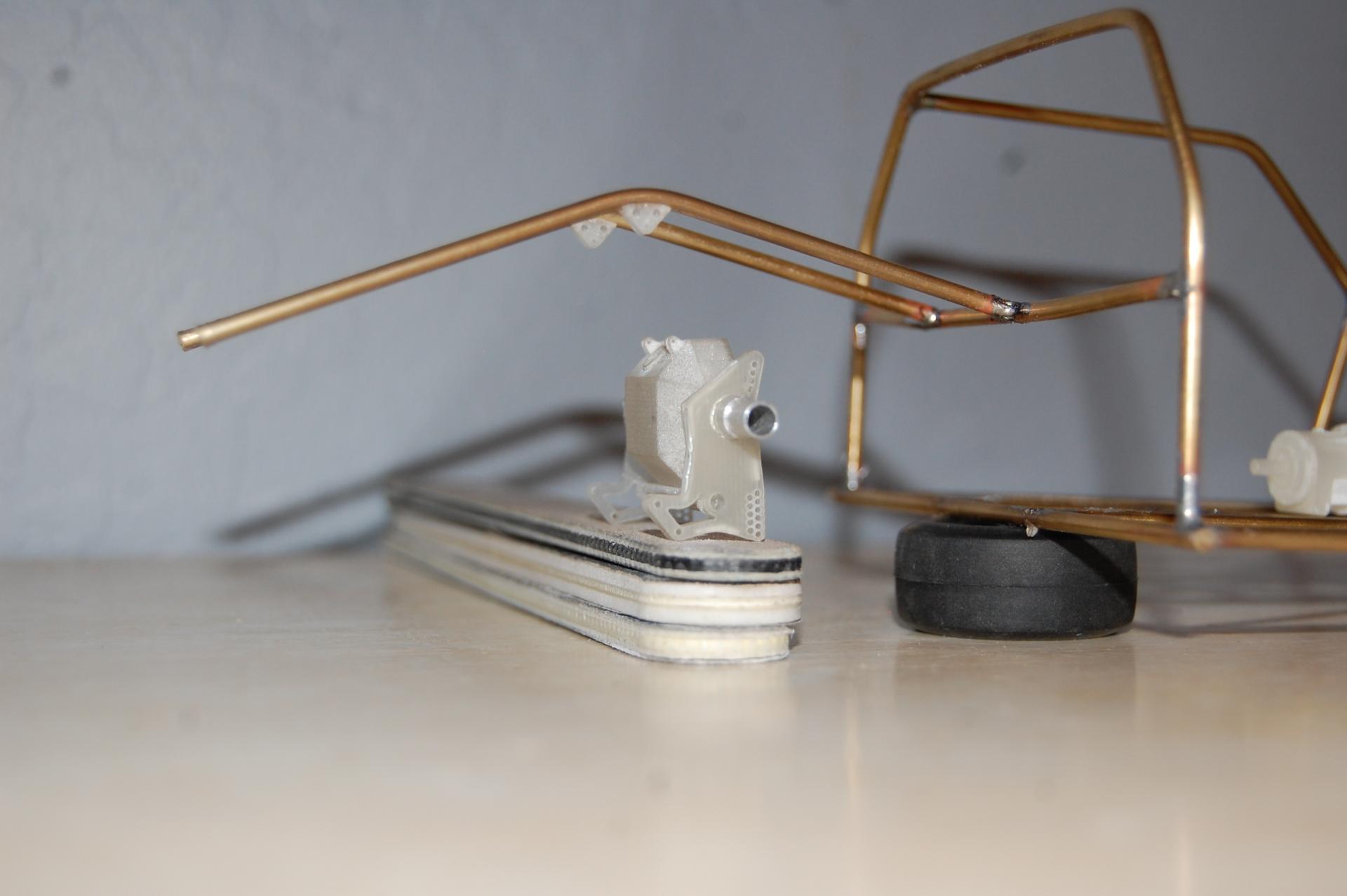

Thank you guys. Got in there again tonight but progress is slow up till now as I needed to draw up bottom rails for the back half to get the bend right and in scale to dimensions I have for a chassis and it's shock mounting points. The back half is smaller tube than the main rails so I used 3/32 K&S tube. (which is correctly scaled) The issue with K&S is that it is hardened. I discovered with a bit of experimenting that if you anneal the tube slightly it will be malleable enough to bend without breaking or kinking and yet retain much of it's strength. By using a round belt pulley that I have laying around that I am going to use to update the Unimat lathe I was able to bend the tube fairly easily! -

So, the house is no longer ours and we are officially homeless... lol I did order the scoop and spacer and added the 4 link brackets to the order as I had to replace the ones that got broke in the trip from GSL when the chassis got smashed. I still need the oil pump and have a good start on it at this point but it's not ready for printing yet. I am also going to change the engine over to a dry sump style setup which requires a new pan and different pump that what I have started on. (sort of, the basic pump is the same if I am copying an RCD style pump but it is longer for obvious reasons.) With the scoop here I had to mock it up in the chassis with the rear body section in place to see how it looks. It's hard to tell in the photos but the thing is seriously bad a$$. Off to chop up some brass since I have the place to myself for the week! Paul -

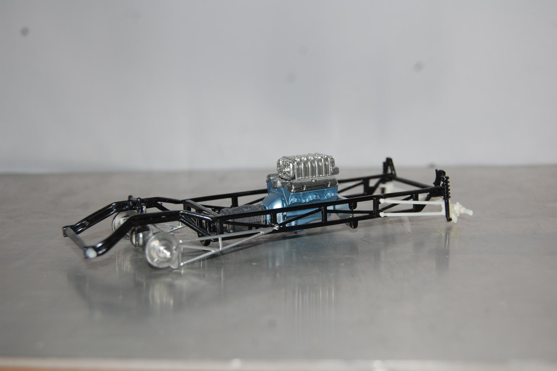

Here's the chassis that's under the GTO. I also have a mint Charlie Allen F/C that when I can I will post pics of that chassis. May be a while though lol. -
