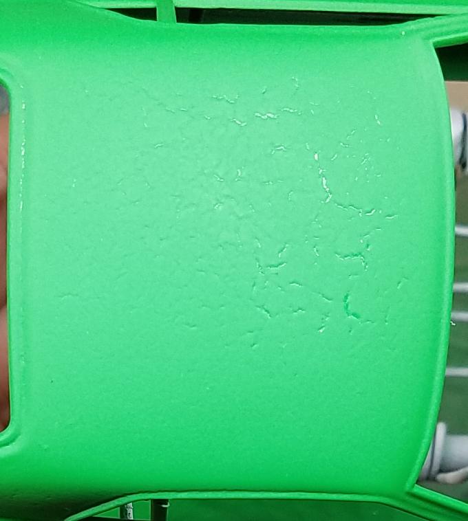

Why the orange peel disaster?
Sidney Schwartz replied to Sidney Schwartz's topic in Model Building Questions and Answers
Couple of days, at least. So are the Tamiya TS-35 and others in that line considered high gloss paints? -
Tamiya TS-35 and TS-80, both synthetic laquers, so that shouldn't be the problem. Maybe I did spray it on too thick. Looks like I may be able to sand down the clear rather than having to strip everything off. -
Sidney Schwartz posted a topic in Model Building Questions and Answers
This one was coming along so nicely, and almost finished. Body color is Tamiya Park Green, which looked great. I decided on a matte finish, so I sprayed on Tamiya flat clear. I sprayed just until it started to settle. Looks awful. I've not had this problem with their glossy clear. I've also used the flat clear on smaller bits without any problems. Any ideas on what caused this? It's so bad I'm going to have to strip it completely and start over. -

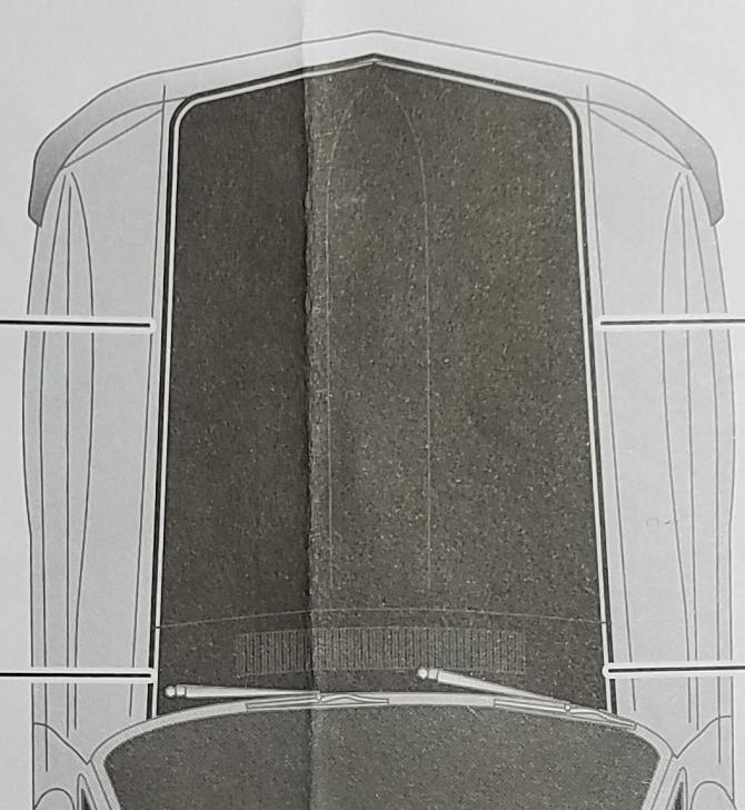

I'm going to need suggestions on the best way to go about doing the hood on this Revell '69 Mustang. The center area of the hood is supposed to be black with a pinstripe edging. Decals are provided for the pinstripe and a portion of the outer edge of the black area (decals 1 and 3 in the pic)... The end result... So I've got to have body color, and over that a masked section of black, and bording that the decals. I'm guessing the body color gets sprayed first, but what's the best way to approach the masking and decals? The decals have to be in a very specific position, and I don't see how I'm going to mask accurately until those are on. I'm also guessing that putting masking tape over decals is a bad idea. So, spray body color, apply decals, clear coat over all, then mask and spray black? Or something else?

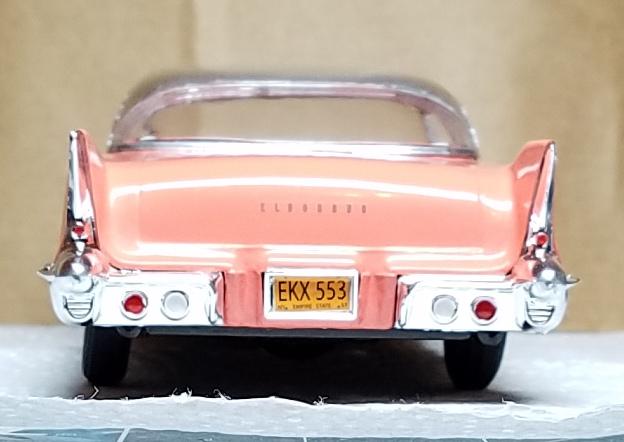

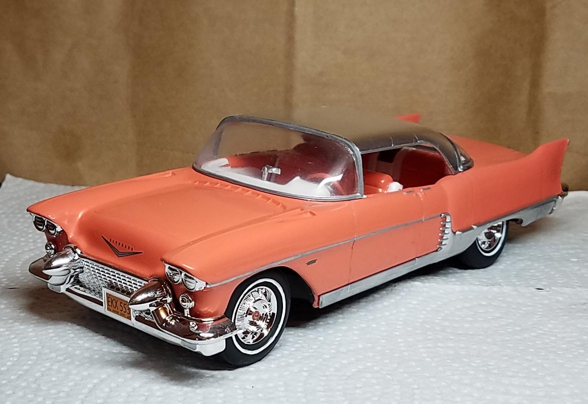

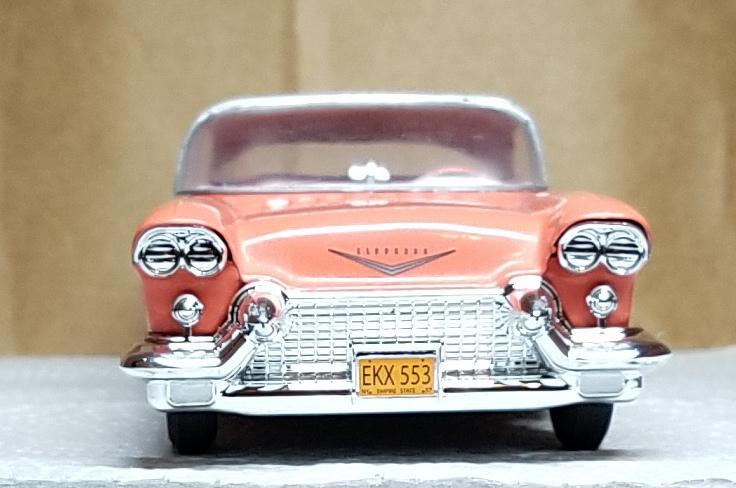

Revell 1957 Cadillac Eldorado Brougham
Sidney Schwartz replied to Sidney Schwartz's topic in Model Cars
Don't beat around the bush. If you don't like it, just say so. ? Thanks, all. This was one of my first after getting back into the hobby after a long absence. The results are encouraging. -
Thanks, all! ?

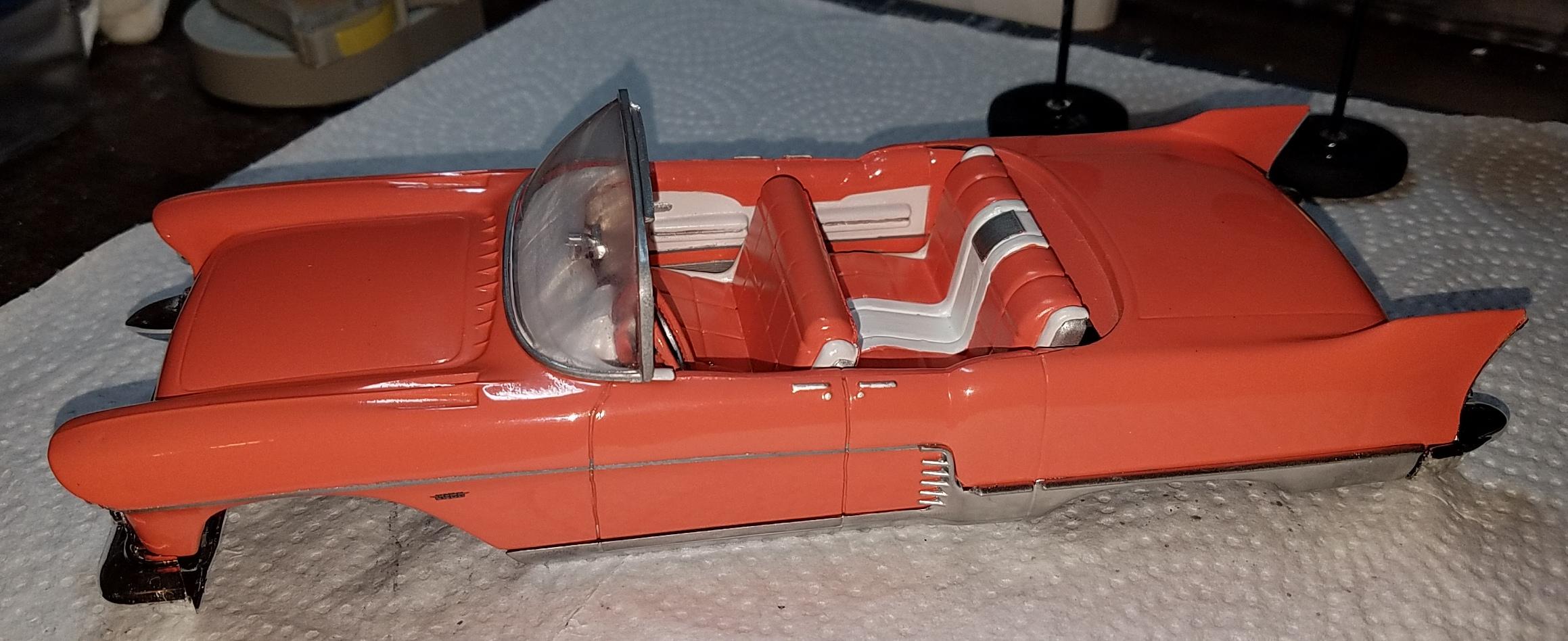

I'm even worse at taking pics than I am at building models. Several people have commented that this isn't a very good kit, and I have to agree, mostly because of poor parts fit. Also the dash looks very little like the real thing. Despite that, I like it and have ordered another one. Now that I'm familiar with it I can do a better job of fixing what's wrong. Paint is DecoArt craft paint and Tamiya clear, and didn't come out half bad, I think. Chrome is Kryon, sprayed on the large side piece and brushed on the smaller bits. Top is BMF aluminum, which I could not manage to buff very well. Thanks for looking.

How am I doing so far? ? I've already decided to get another one of these. Now that I'm familiar with it I can do a better job of fixing the inherent problems. And it's impossible not to like the car itself. -

Forgot to mention that the paint is Tamiya Mica Red. Very nice. I painted the chrome headlights white. Was that an improvement, or should I have left them alone? I'm undecided myself.
