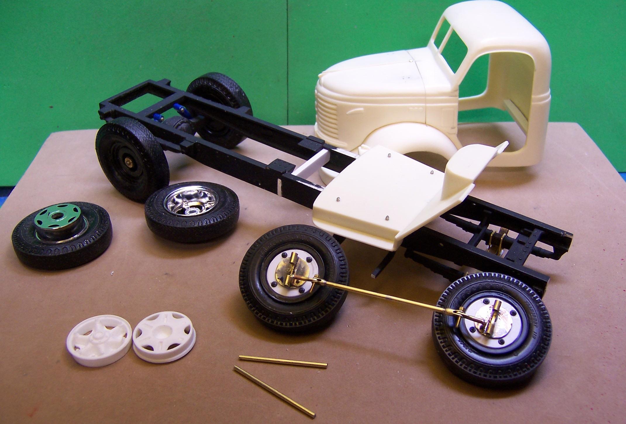

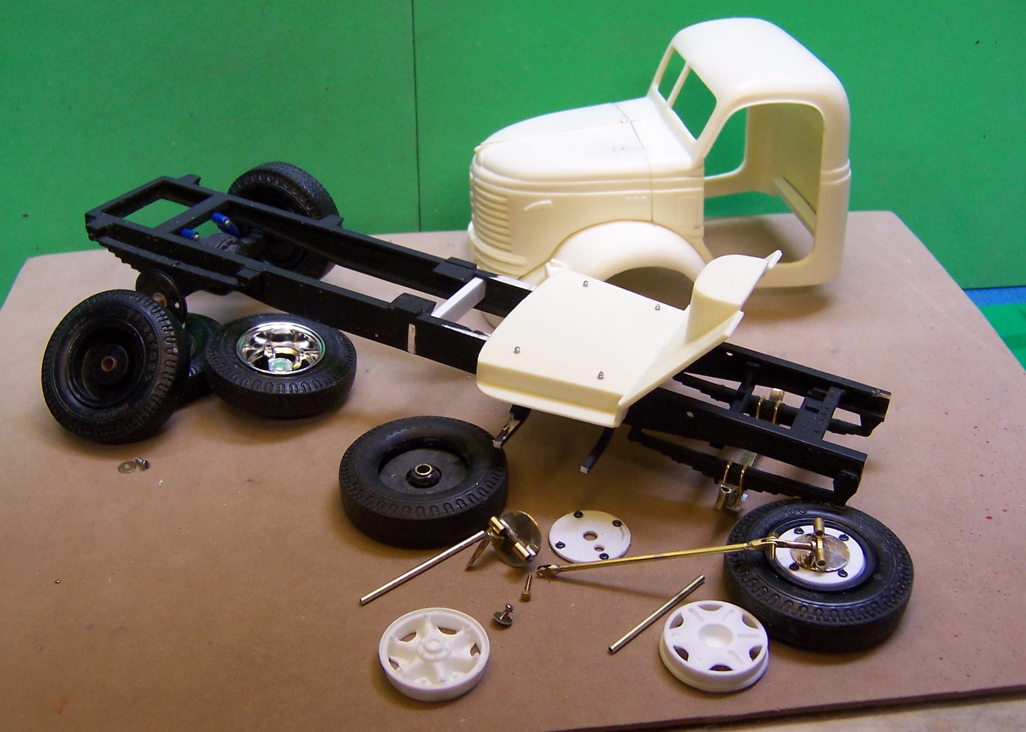

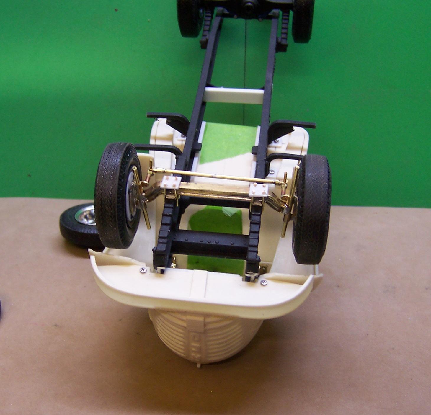

In the past few days I've concentrated on getting some work done on the Port Vue rig. I started out by making a new front axle out of brass and quickly found that the one I made was too long. I cut it in half and tried soldering it back together after taking out a section in the middle.. It did not work well so I made a second one. In addition some work was done on the axle ends where the wheels will mount. An upside down view to show the axle and the u-bolts. Axle ends are all soldered brass as well and including the tie rod. If you look close at the frame you can see where the floorboard of the cab has been bolted in place. It's the only way I know to really secure everything in place for alignment of the various parts. Resin parts as a rule don't have nice locating pins or places to insert them so it's important to hold things in place as the build continues. I did the same for the bumper. The wheel backs have tubing that fits over and under the tubing on the axle end. The brass pins in the photo keep things all together. Eventually they will be cut off with ends to keep them from slipping out. The wheel backs have a section of tubing that runs through the brass bushing in the wheel. a small screw and washer fit into the axle once it is in place to hold the wheel on the axle. Same thing for the rear wheels. The tie rod is held in place by a small bolt. The bolt will be cut off once it is ready for final assembly. The cab, fenders and hood are joined but are really separate pieces. The bumper is bolted to the front of the fenders. The hood is hinged so that it will open to reveal the engine (eventually). I made up some hinges for the hood but there was an issue with keeping the hood flush with the firewall. I thought of using springs on the hinges but getting the right size and tension was more than I wanted to handle. So I mounted a piece of tubing to the center of the firewall and then drilled out the back of the hood for the next size of tubing that would fit into the one on the firewall. The firewall tubing will be disguised as a coil with a wire coming out of the bottom. The radiator is from the ALF kit. The resin wheels on the front will simply be glued to the wheel portion in back once final assembly is ready. All wheels will be painted blue like on the real rig. -

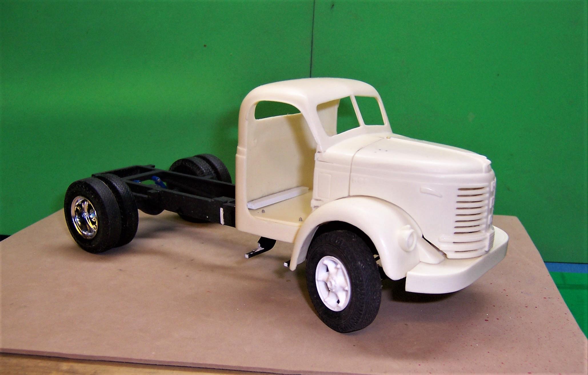

A little bit on the work so far. I have a thing for poseable front wheels so I began by making a new front axle based on the plastic one that came with the ALF kit. Drilling out the pivot point doesn't leave much in the way of strength so making the new one from brass was the way I chose. The axle is made of 5 pieces, a center web, two flanges, one on top, one on the bottom and the two sections of tubing that act as the pivot point. The angle for the tubing was drawn out on paper first and then long sections of tubing were used to get the correct angle. Using long pieces cuts way down on the error of trying to maintain the angle. The frame is a previously used ALF frame. I drilled out the rear axle and inserted a piece of brass tubing for strength and for a clean bearing surface. Other sections of tubing were used in the wheel hubs along with a small screw and washer that holds the inner wheel in place. The outer wheel will be glued to the inner one eventually. Rear wheels came from a 1/25 scale Volvo kit. Both the front and rears are 6 spoke design on this rig. The resin pieces are the castings that came from AITM for the Reo. -

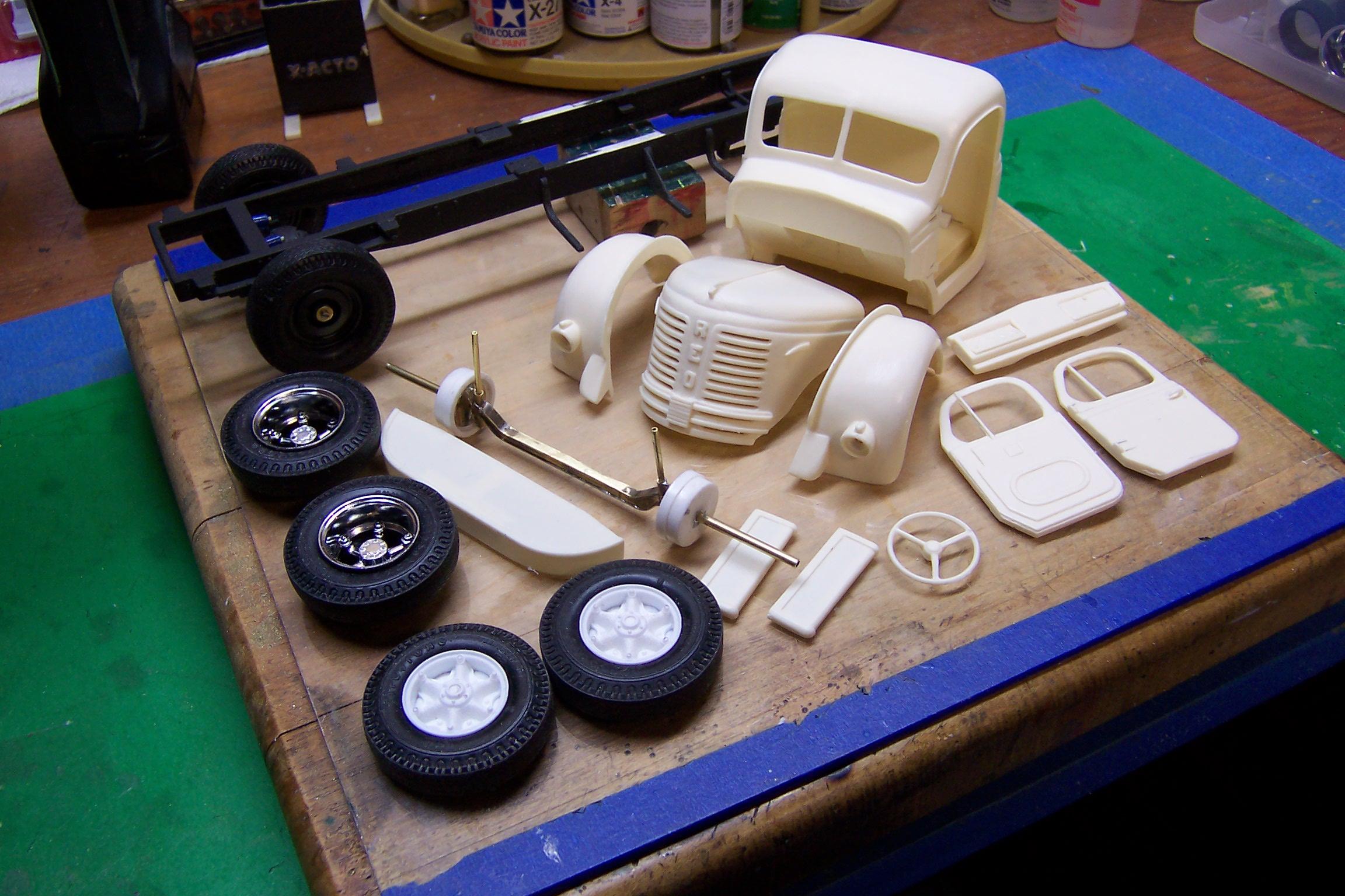

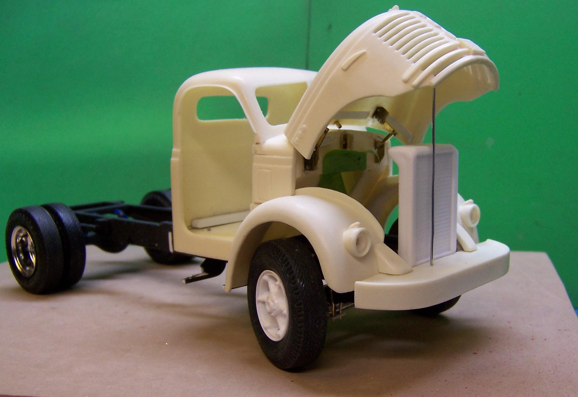

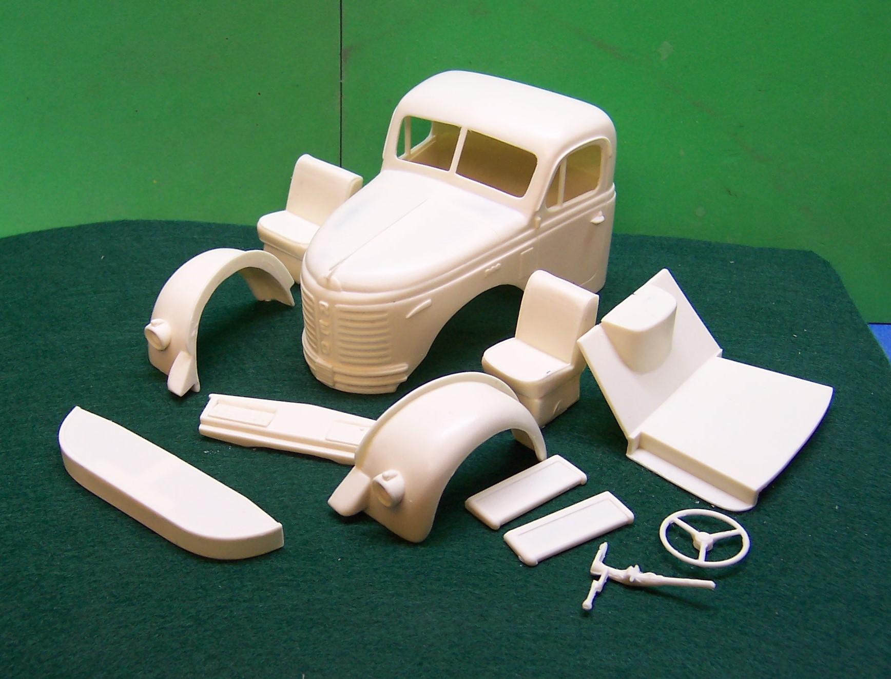

Now that the Pierce Enforcer is done I'm going back to the Reo project. It was set aside after an initial build of the Reo cab and now I'm ready to tackle this one. The doors and hood of the cab have already been separated and will be ready for hinges. Here are the cab and other parts that are from AITM. The hood separated easily with a straight cut across the cow. The cowl section stayed intact so that it still meets up with the floorboards. The doors were scribed open with an Xacto knife. Small brass hinges will be used for the doors. Thinking about the type of hinge to use on the hood that will make a reasonable replication of the real ones. The grill is easily opened as well. There is only a skim coat of resin on the inside of the nose that can be removed with a knife and smoothed up with small files.
