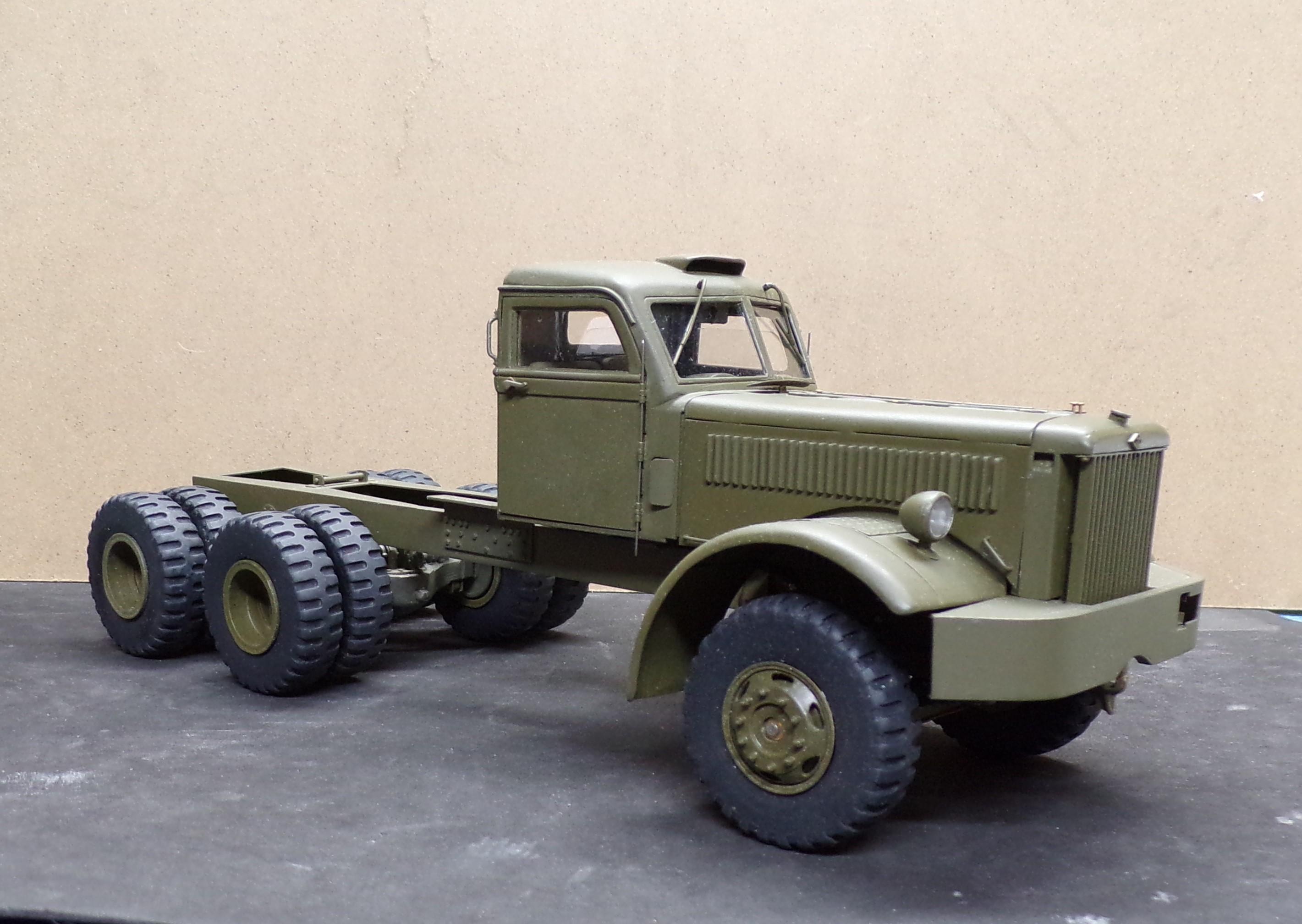

It wasn't quite finished in those pics above. But here is what it looks line now. Am working on some tools to put in the compartments in the body. -

Close to being done. Just a few small details here and there and it is finished except for some dusting and light dirt under the fenders and along the sides. Can't be too clean! -

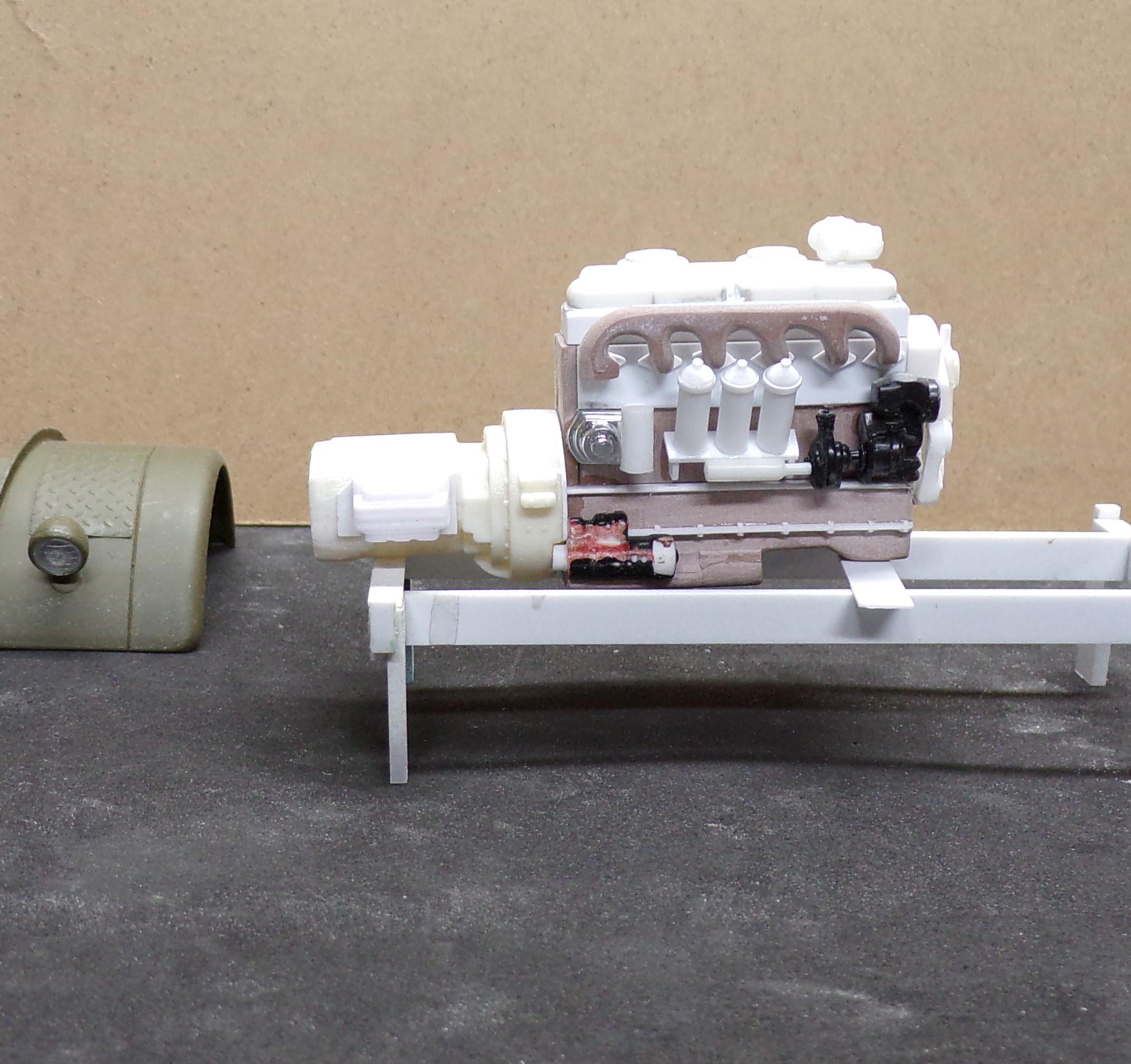

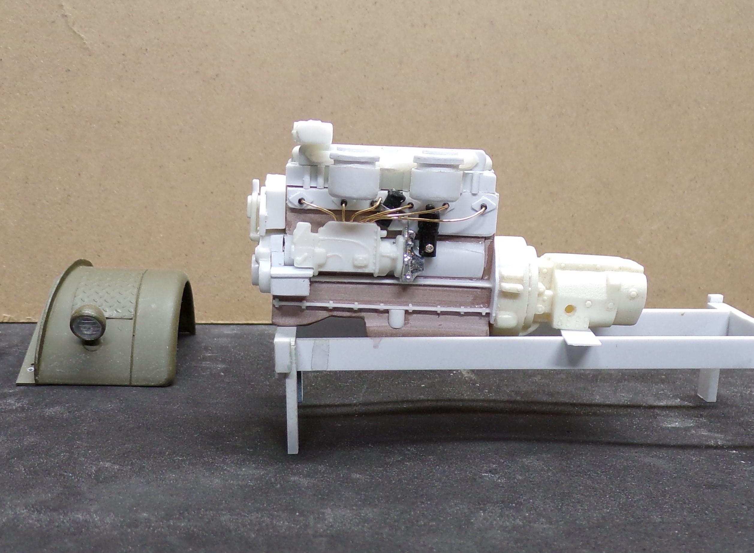

Couple of pix to show progress in the Hercules DXFE diesel. M-20 publication has some good photographic detail to use as reference. It's no where near the perfection of a 3D printed engine that is posted elsewhere on the board but a lot of it will be hidden behind the long hood of the M-20. Still has a fair amount of work to be done. -
