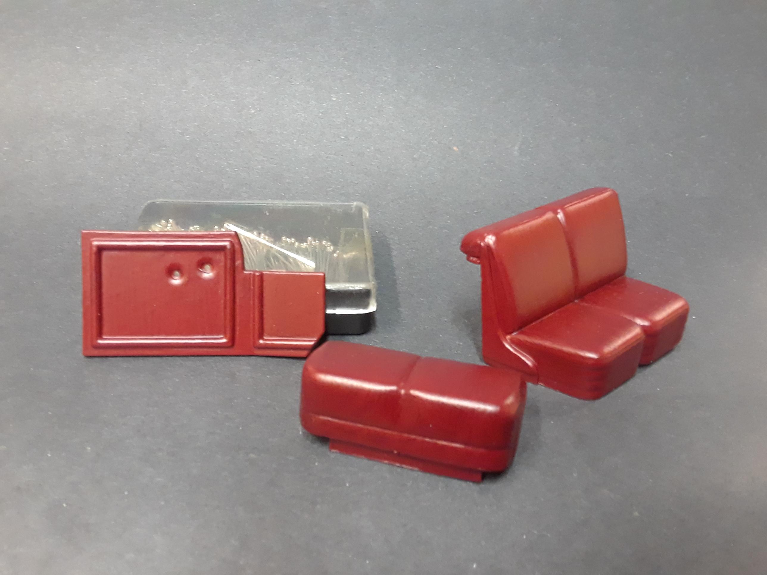

Interior The seats were cast in a slightly different color from the door panels; a little too pink. I painted them with Tamiya Desert Yellow and redid the silver painted seat frames with Molotow. They’re chrome on the full size Bugatti.

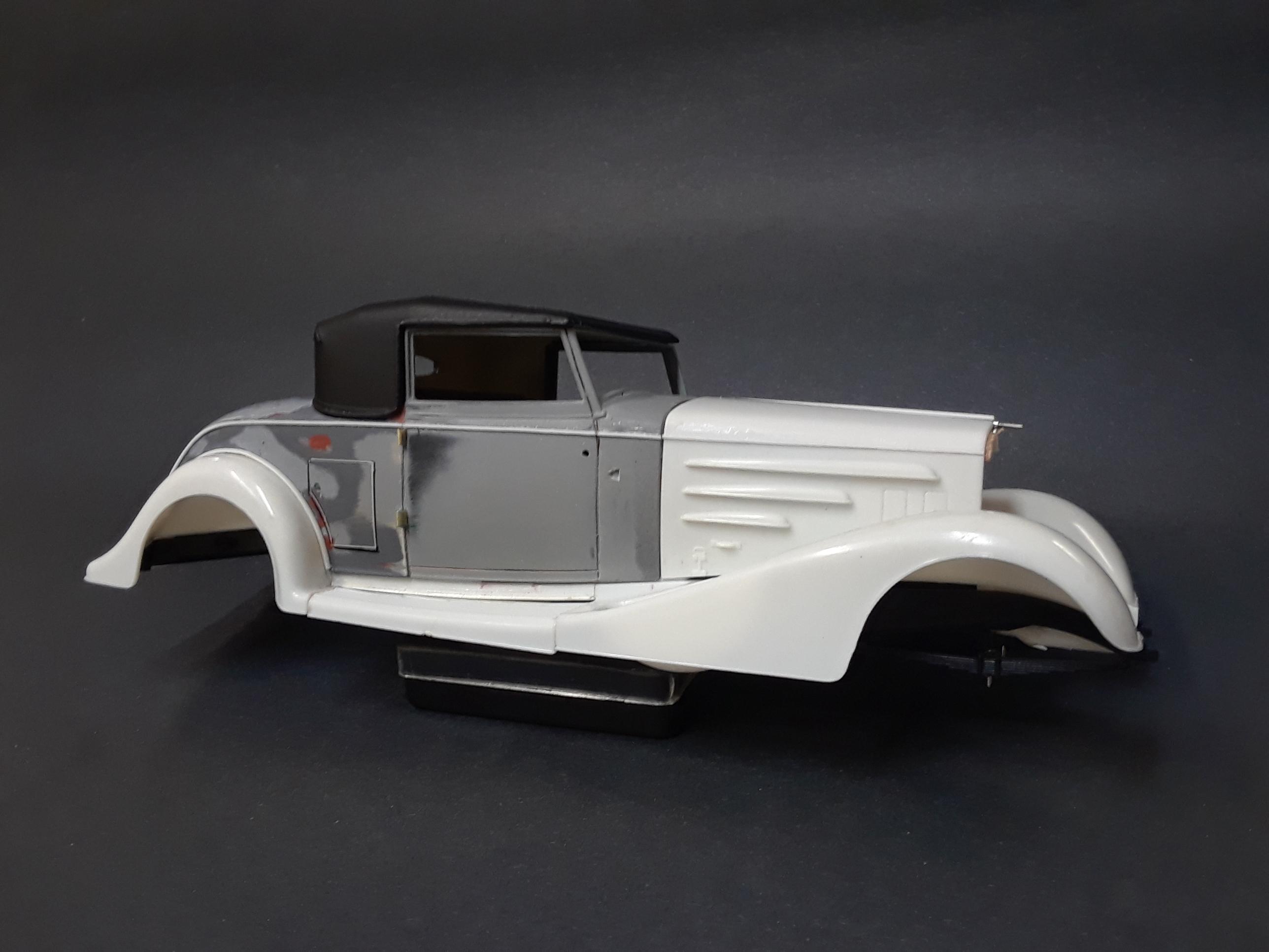

The chassis is Italeri, shortened from a scale 149" to 143", matching the car I'm replicating. The front axle is from a Franklin Mint '32 Cadillac. The engine is the Italeri V-16, with some modifications. The valve covers are from the Monogram '32 Cadillac. I used the intake and exhaust manifolds and carburetors as well. They're slightly larger than the Italeri pieces and look more authentic. I made the distributor from several sizes of aluminum tubing, and yes, there are sixteen individual plug wires in the bundle. The two stray wires go to the twin ignition coils that are mounted in the top of the radiator. Next set of pictures are full size '33 Cadillac for reference.
Jay, David, Sonny~ Thank you for your interest and nice comments. I wanted to post an update over the weekend, but I ran into a plumbing issue in the house and had to work on that instead. ? I have made some progress on the chassis for the Cadillac. I'll try to post photos later this week.

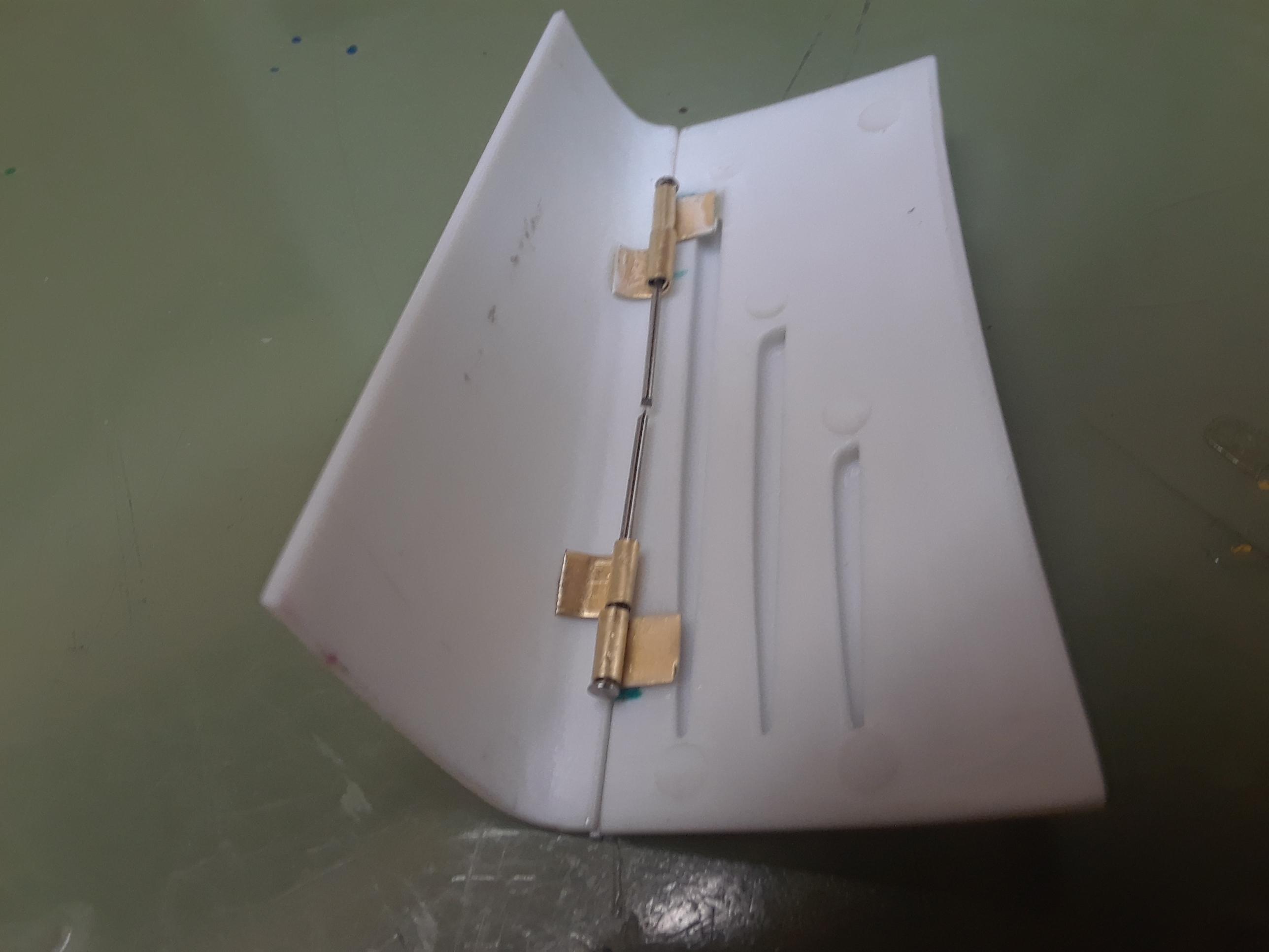

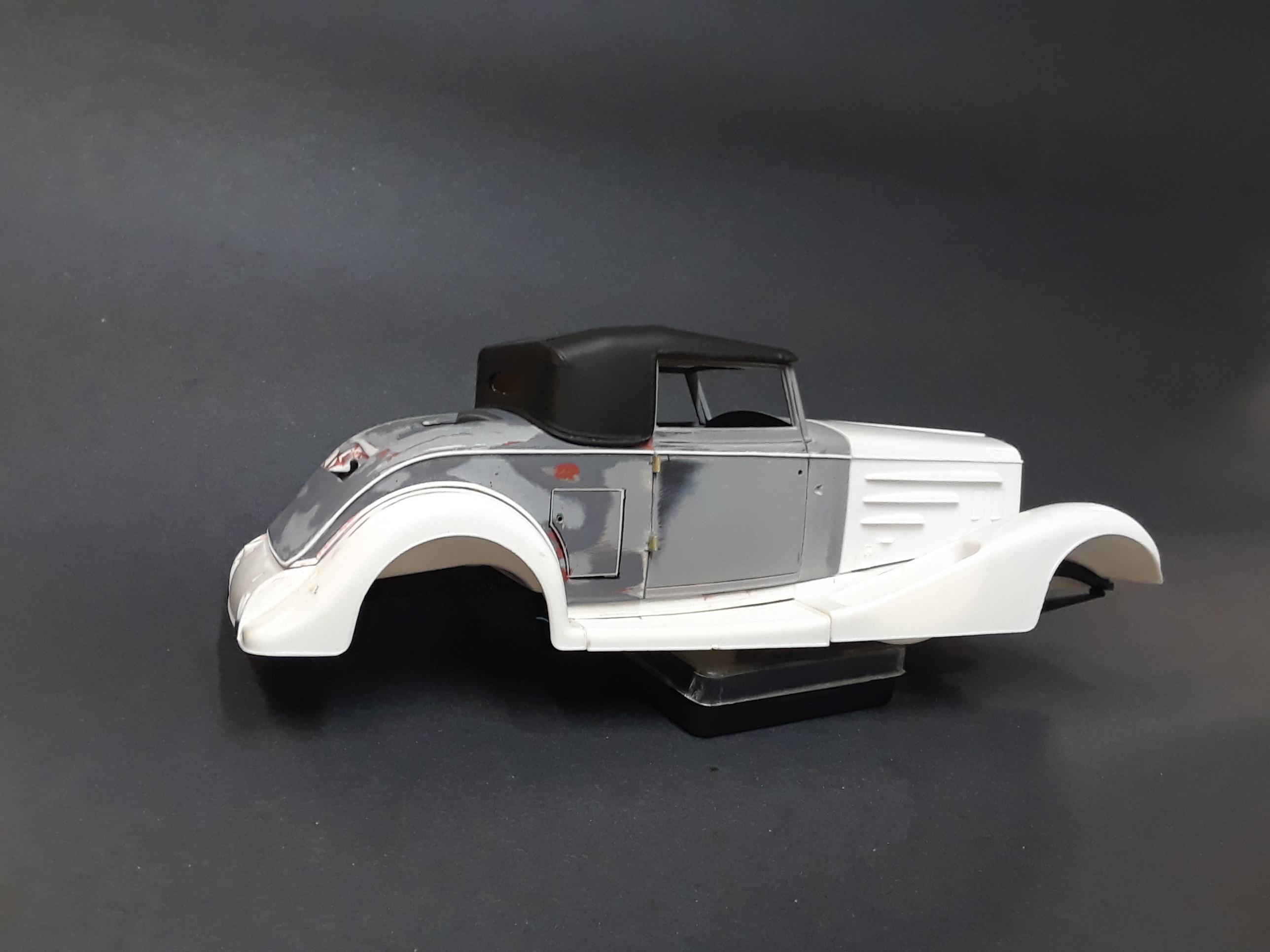

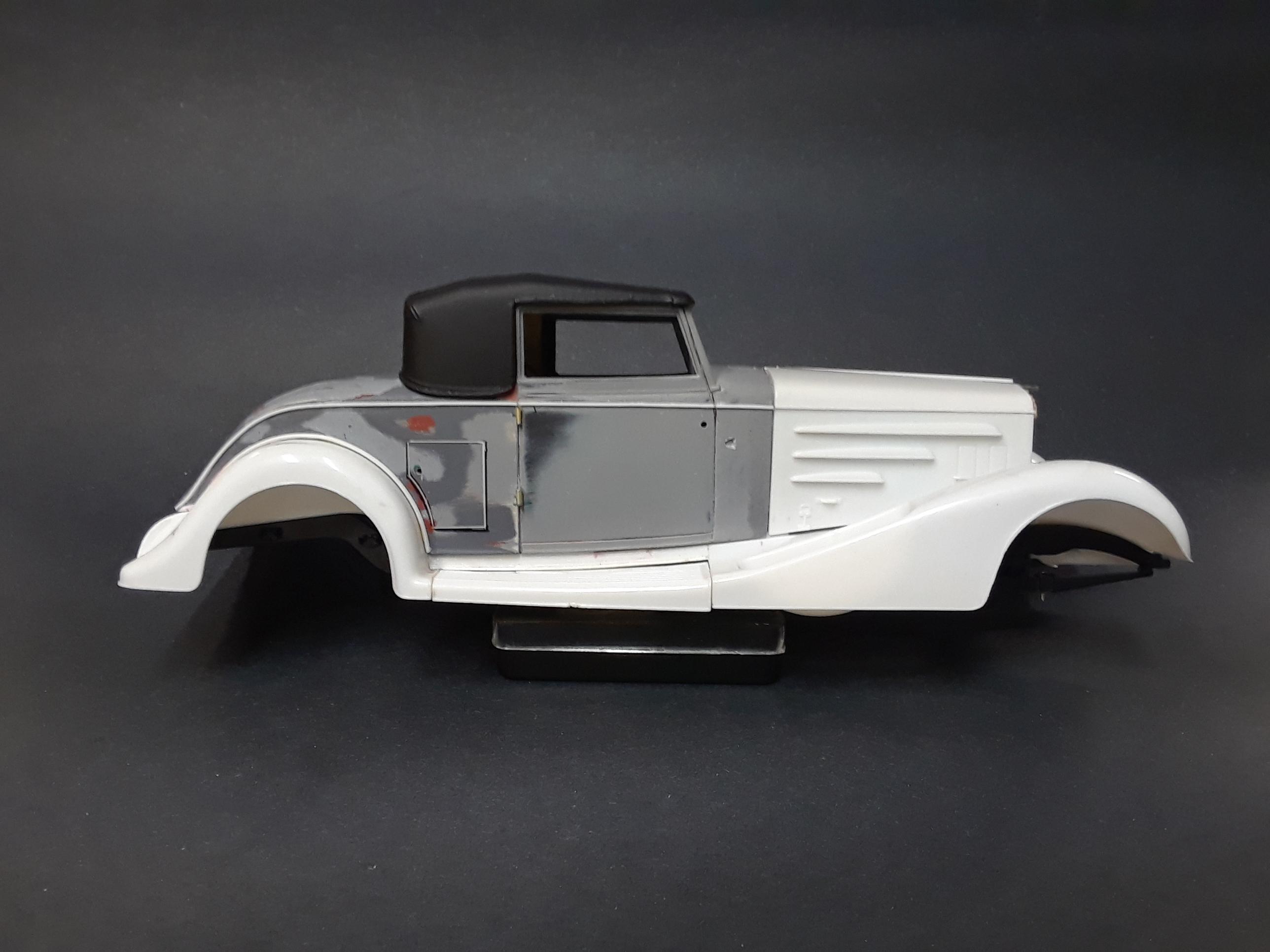

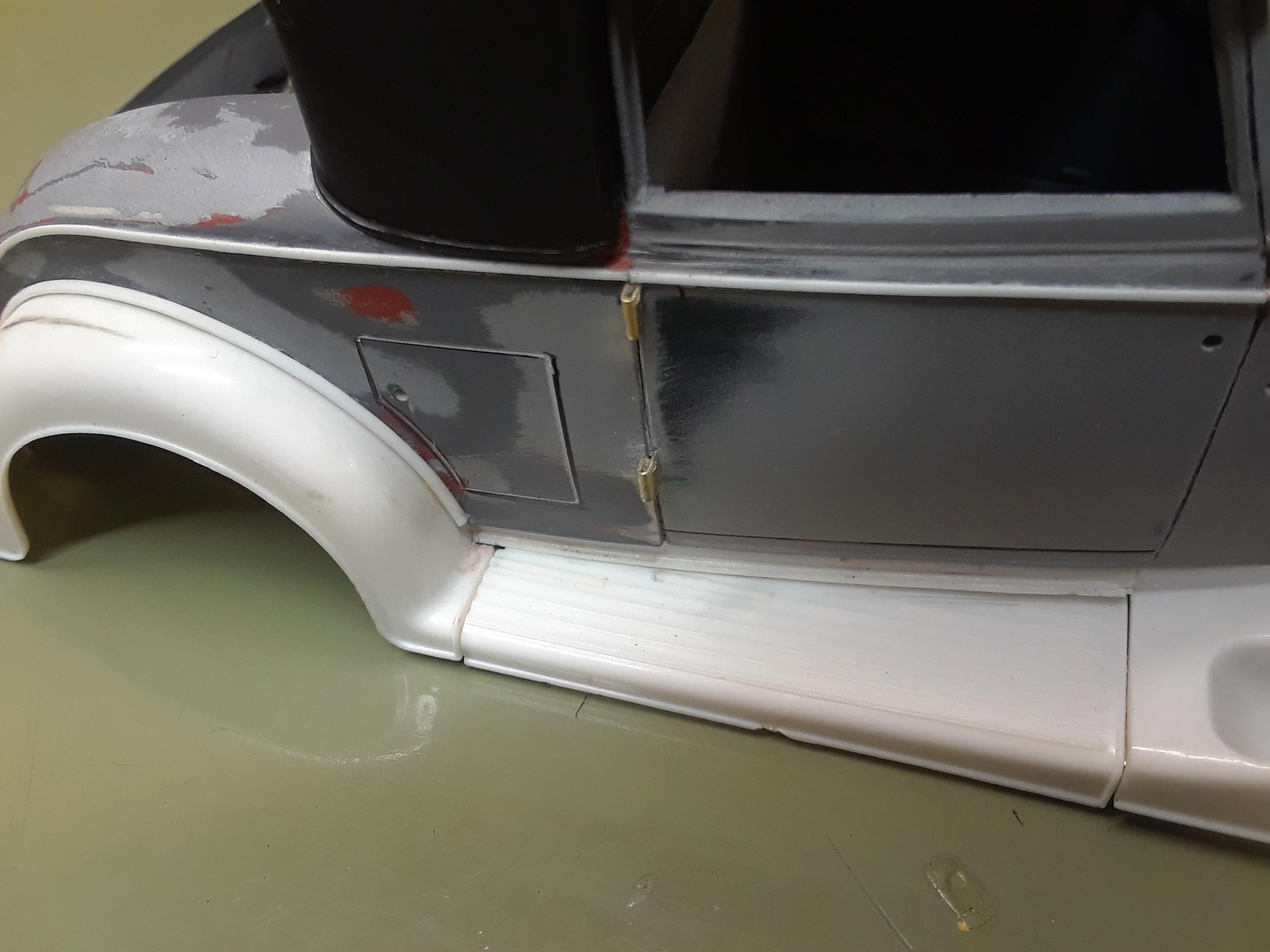

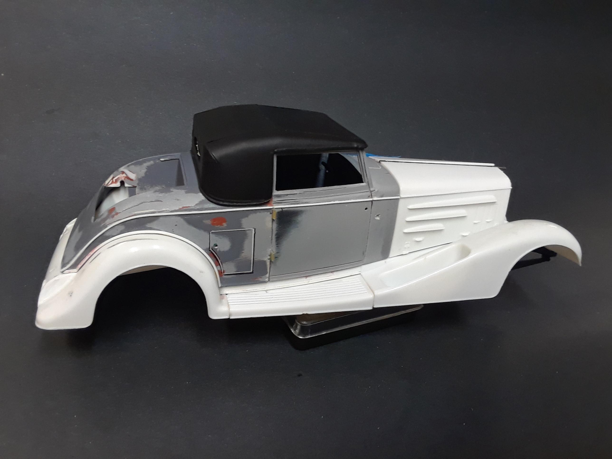

Today I made up some hinges to tie together the hood top panels to the side panels. The original Italeri hood is just one piece. Mine is cut into four pieces, using a Franklin Mint piano hinge for the top. For the sides, I wrapped strips of brass around stick pins. This worked out fine. I'll shorten the pins a bit. With this design I can remove them while I finish and paint the hood panels, then slide the hinge pins back in and it's good to go.
