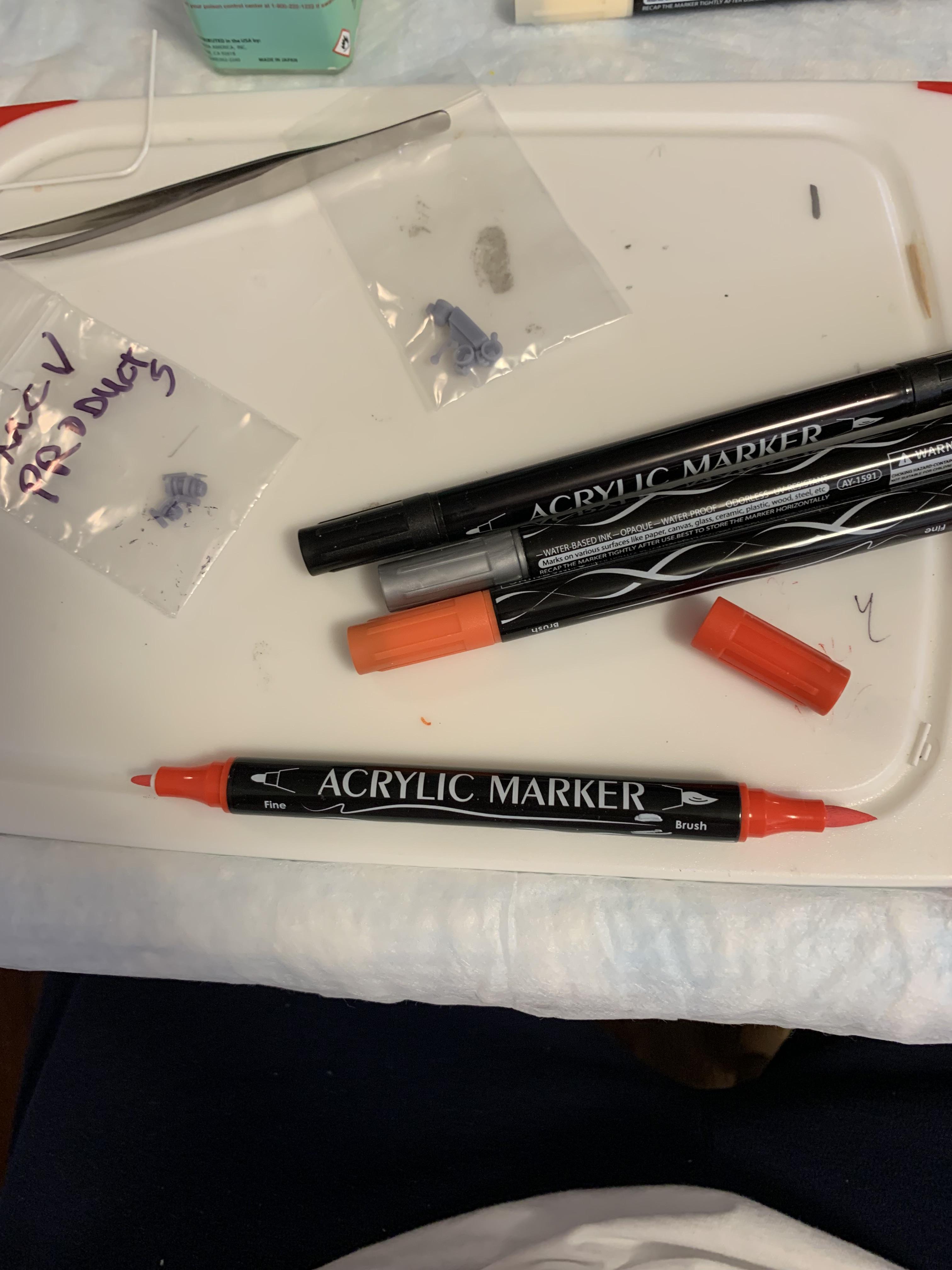

Did some detail painting with my new acrylic markers. The dash is gonna take 2 coats , as do most parts for good coverage.

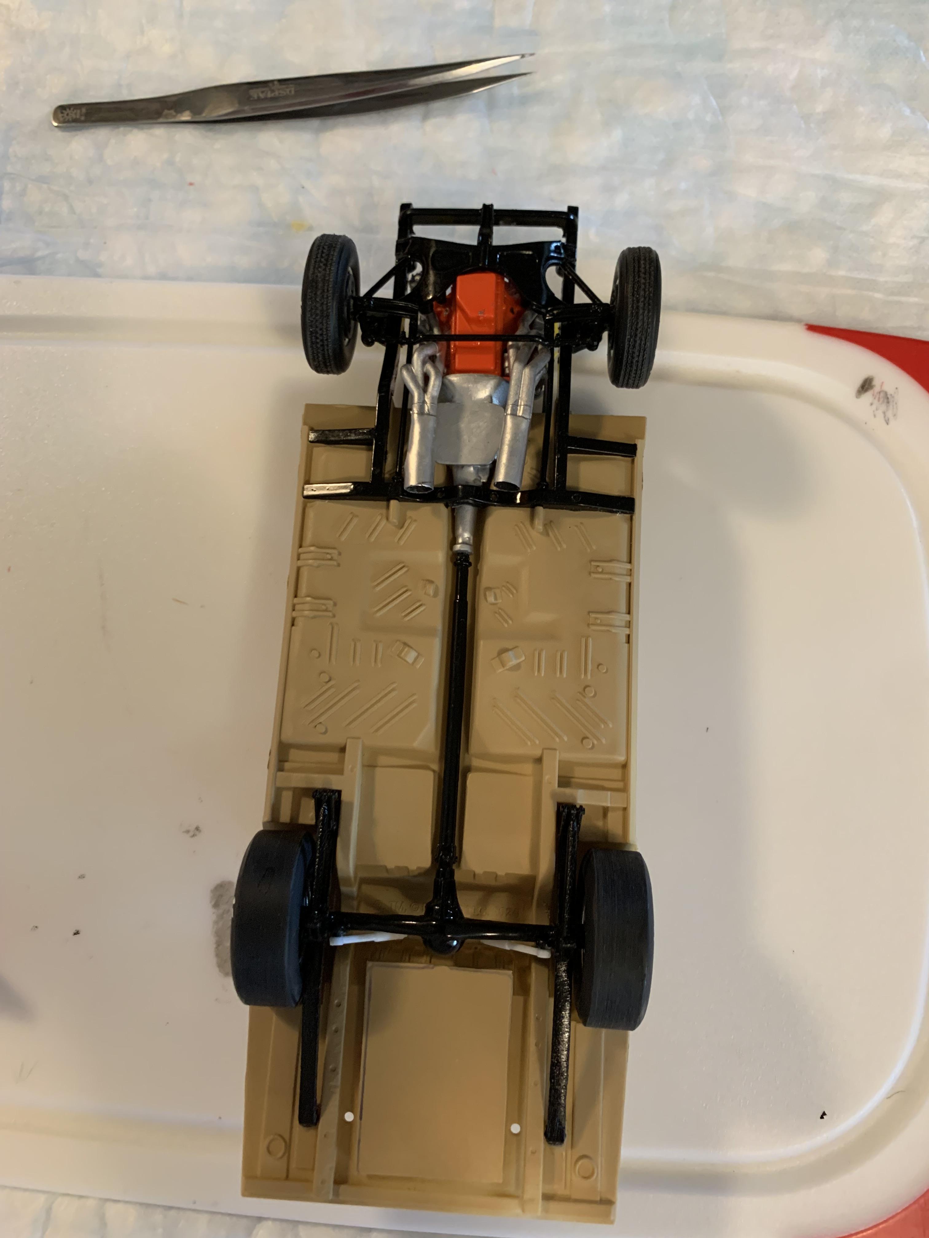

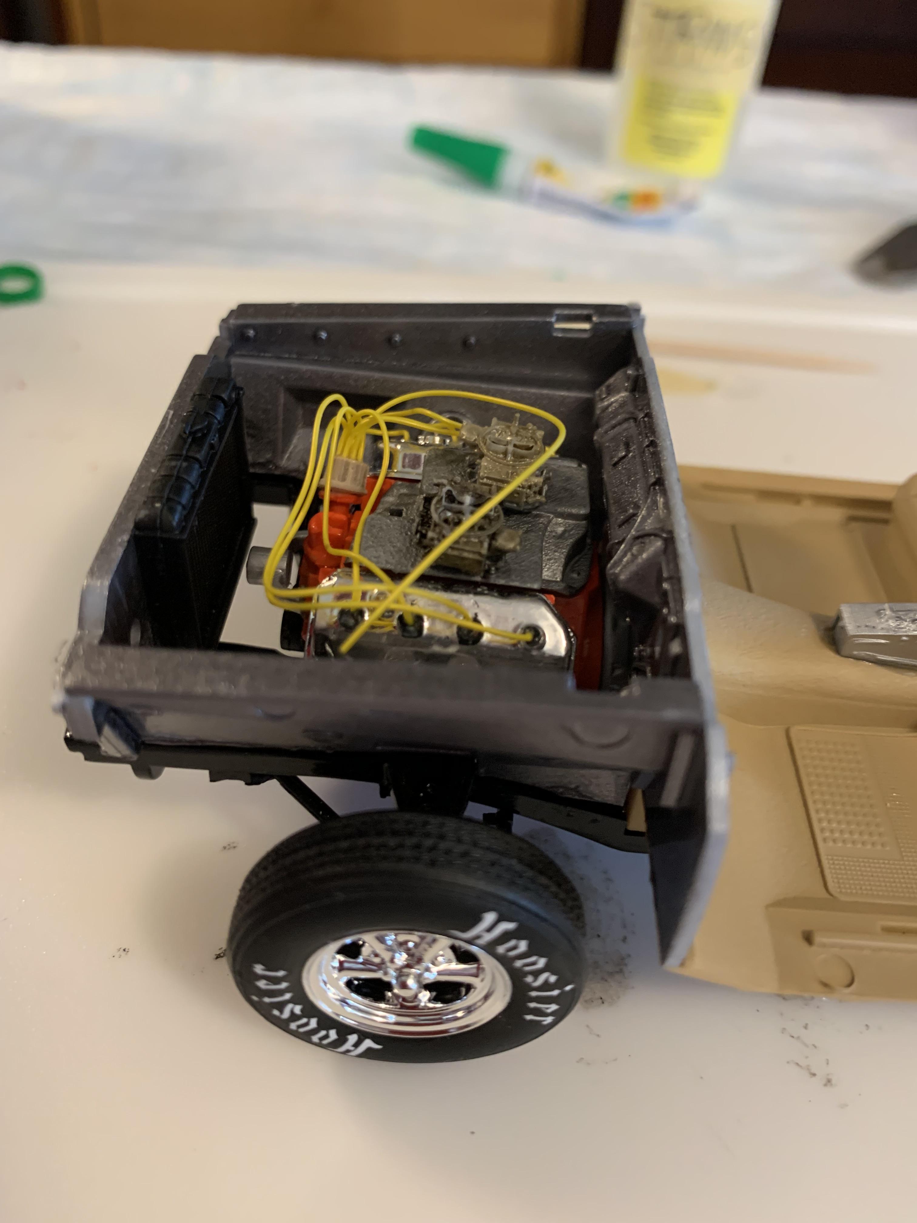

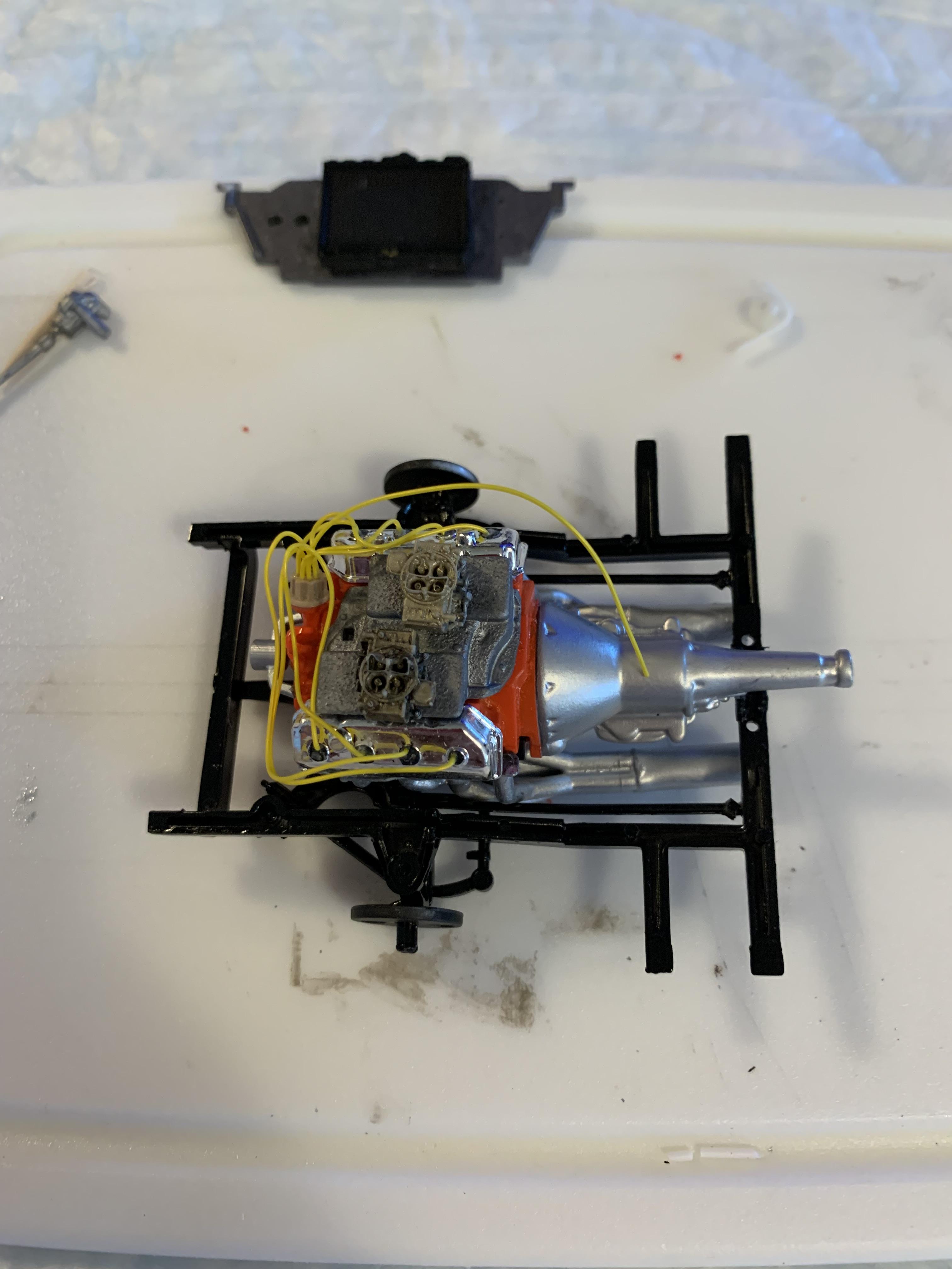

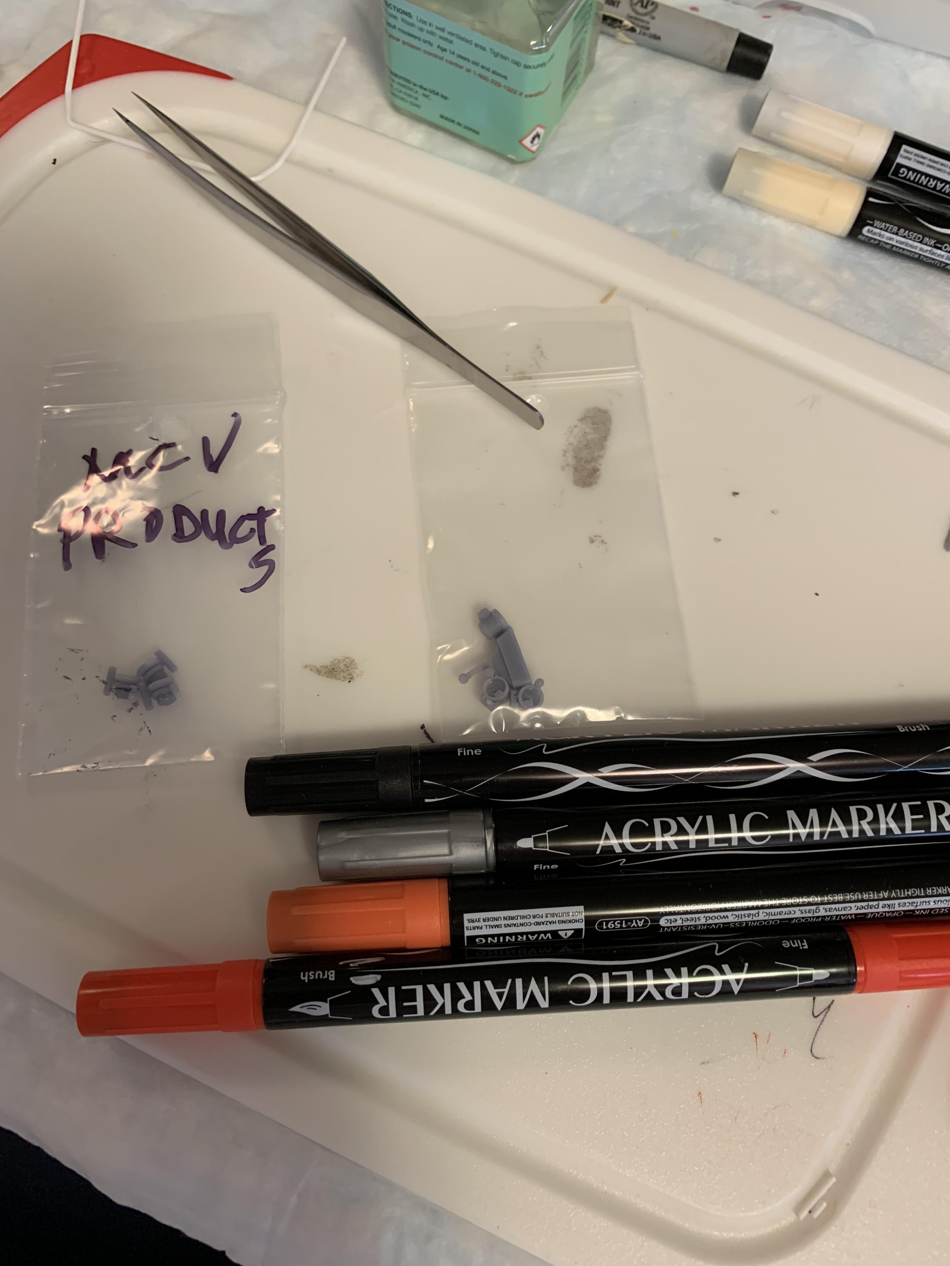

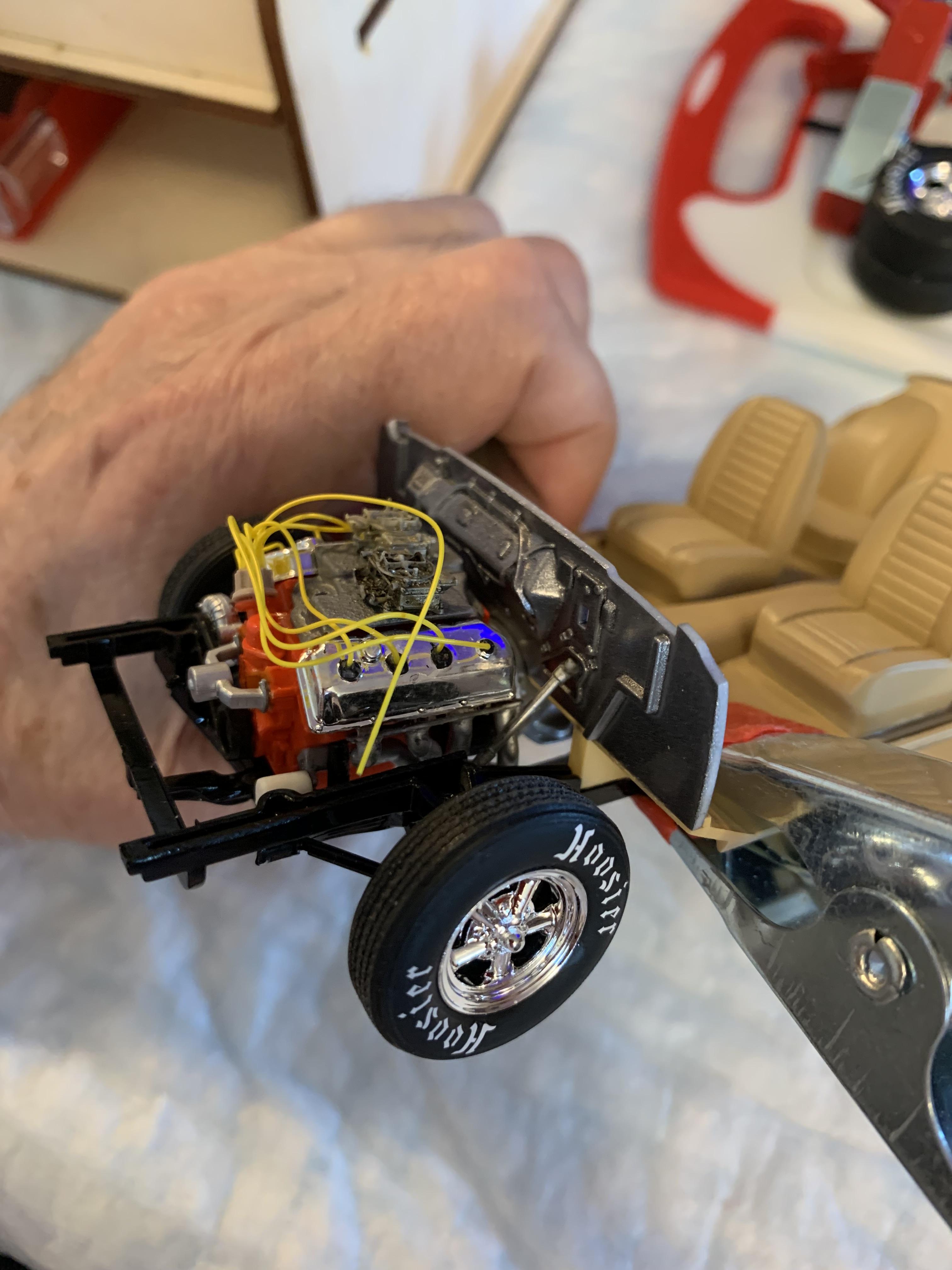

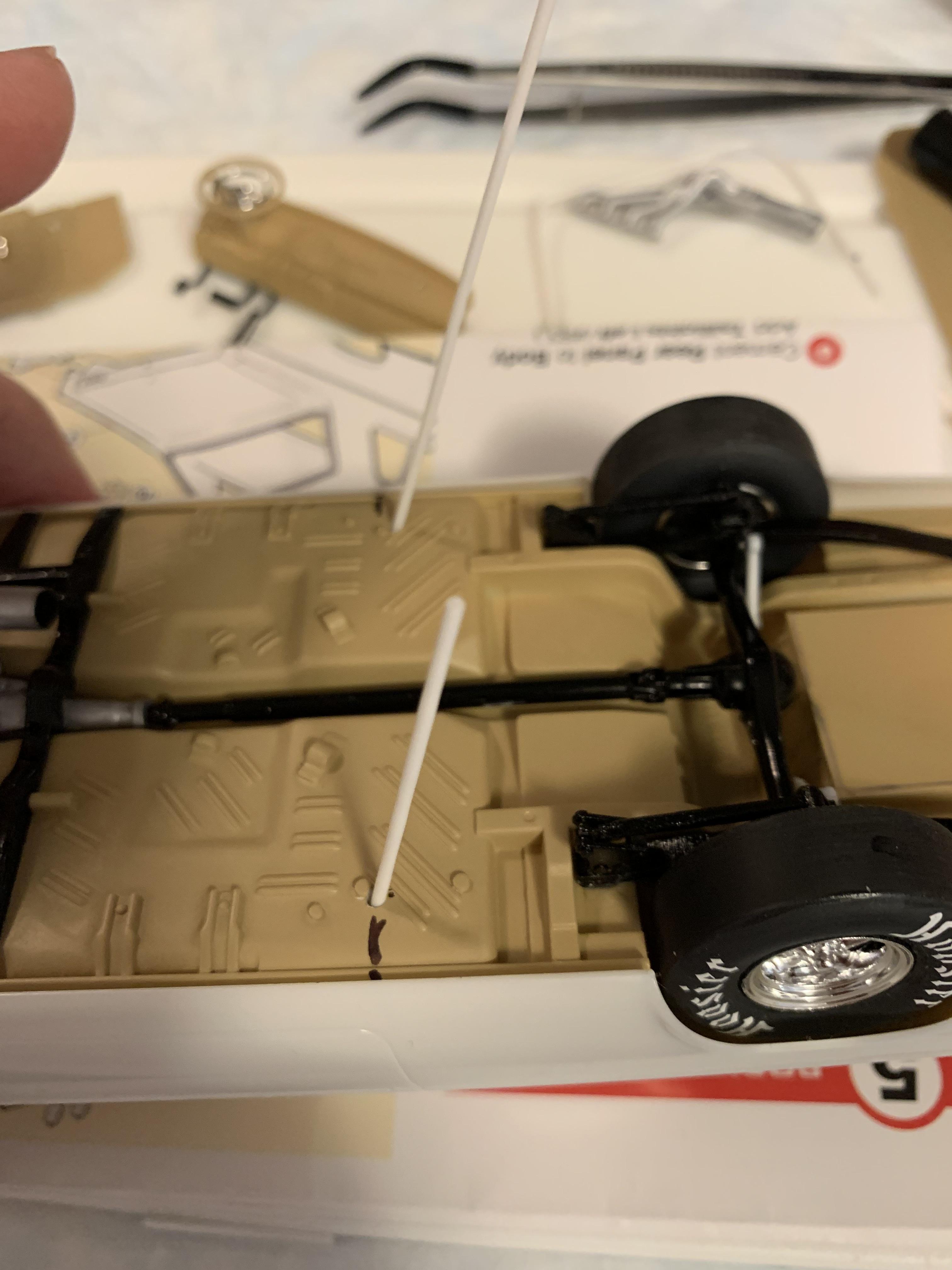

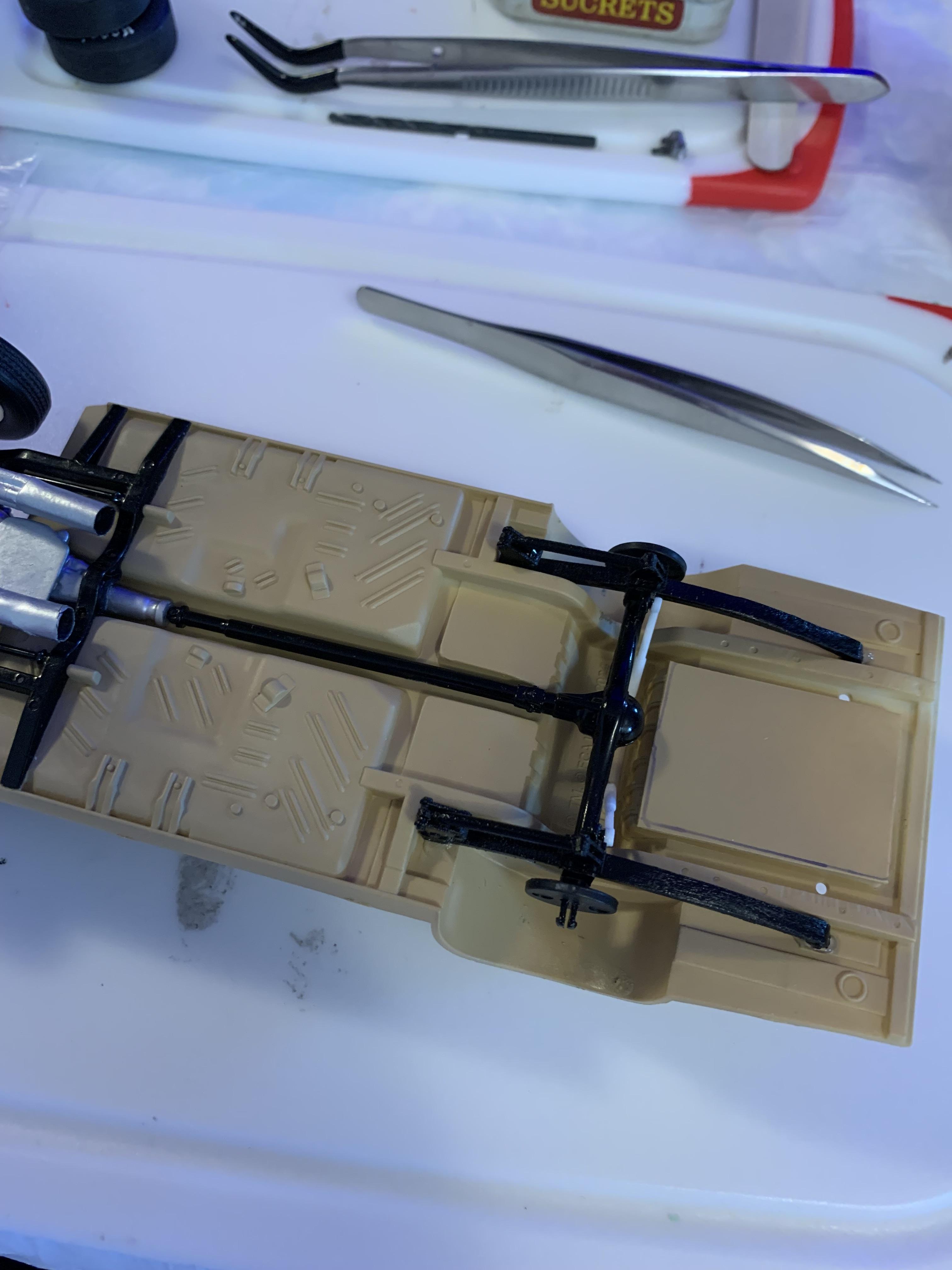

After painting some more parts, I decided to try to show some of the details in this above average kit. The rear end actually has a visible brake line molded in, the generator has a bracket, the rear springs don’t have any arch to them, it has a road draft tube. I used my acrylic marker (brush end) to paint some of the smaller pieces.

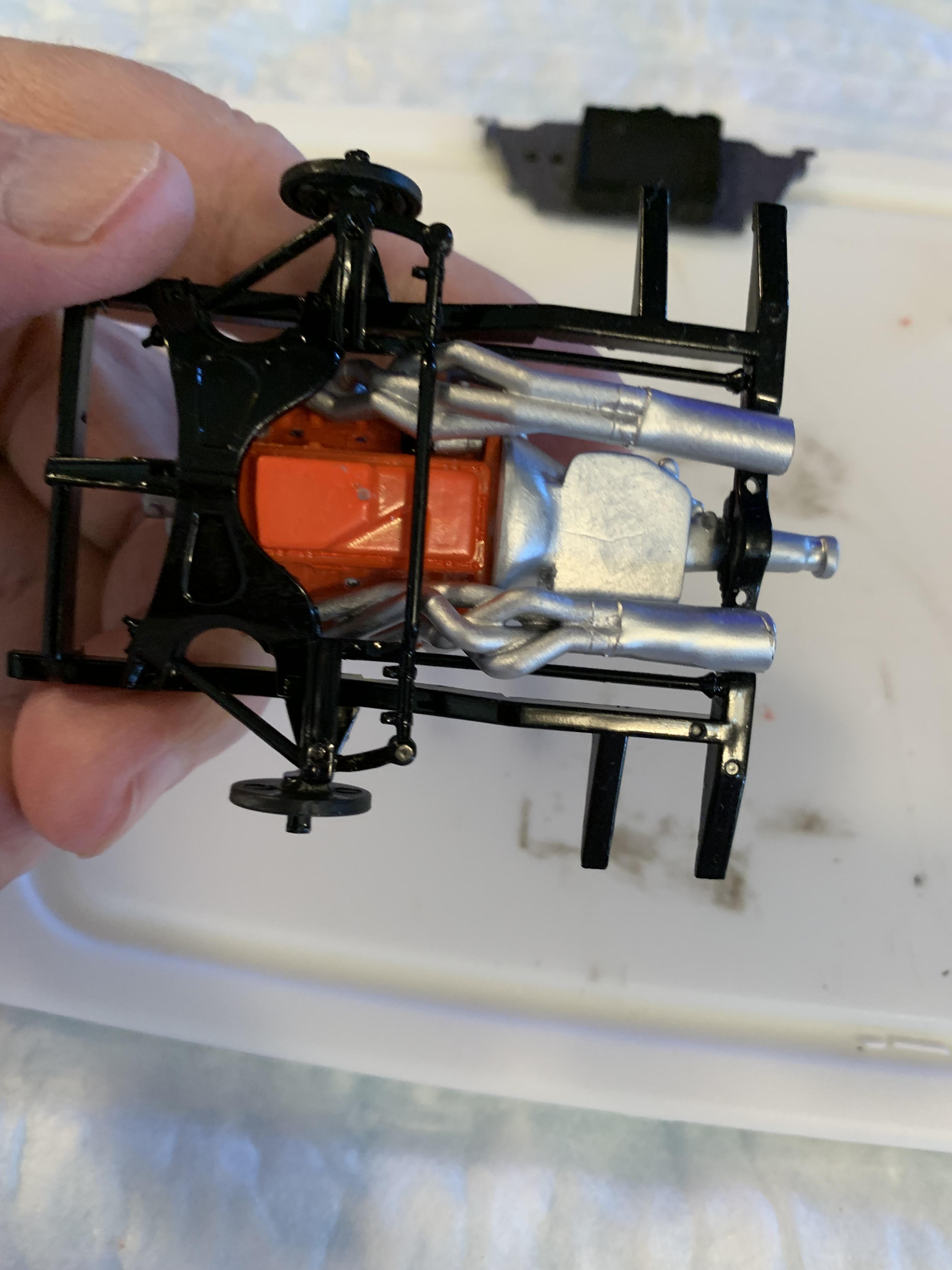

Above average, Elliot. Crispy, as opposed to leafy. It’s what I deserve for trying to use up some old paint that I didn’t like before. Insanity: doing the same thing over and expecting different results. Glued the tires/wheels together and painted a bunch of small parts (that’s what you get with a highly detailed engine/chassis/interior).

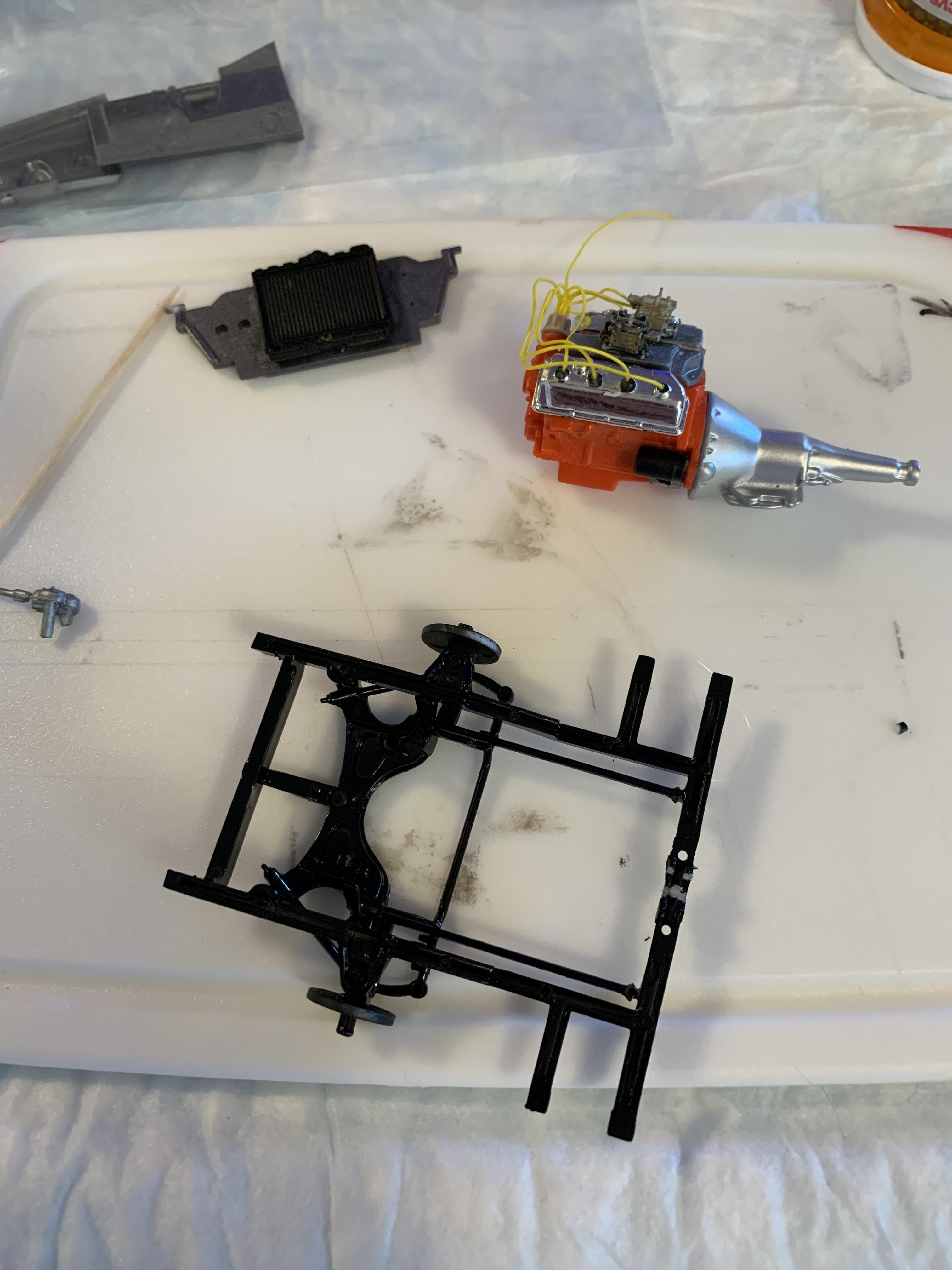

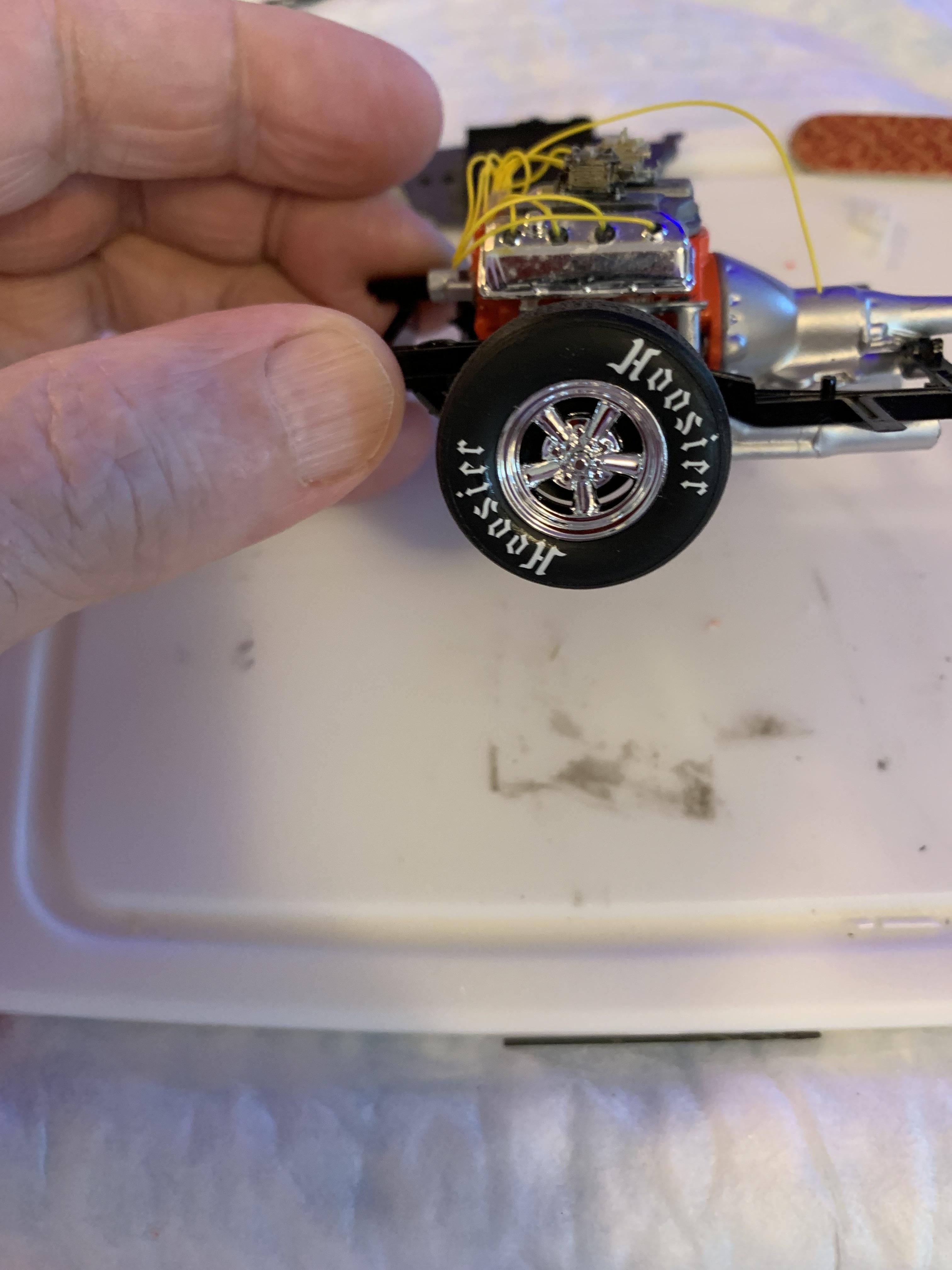

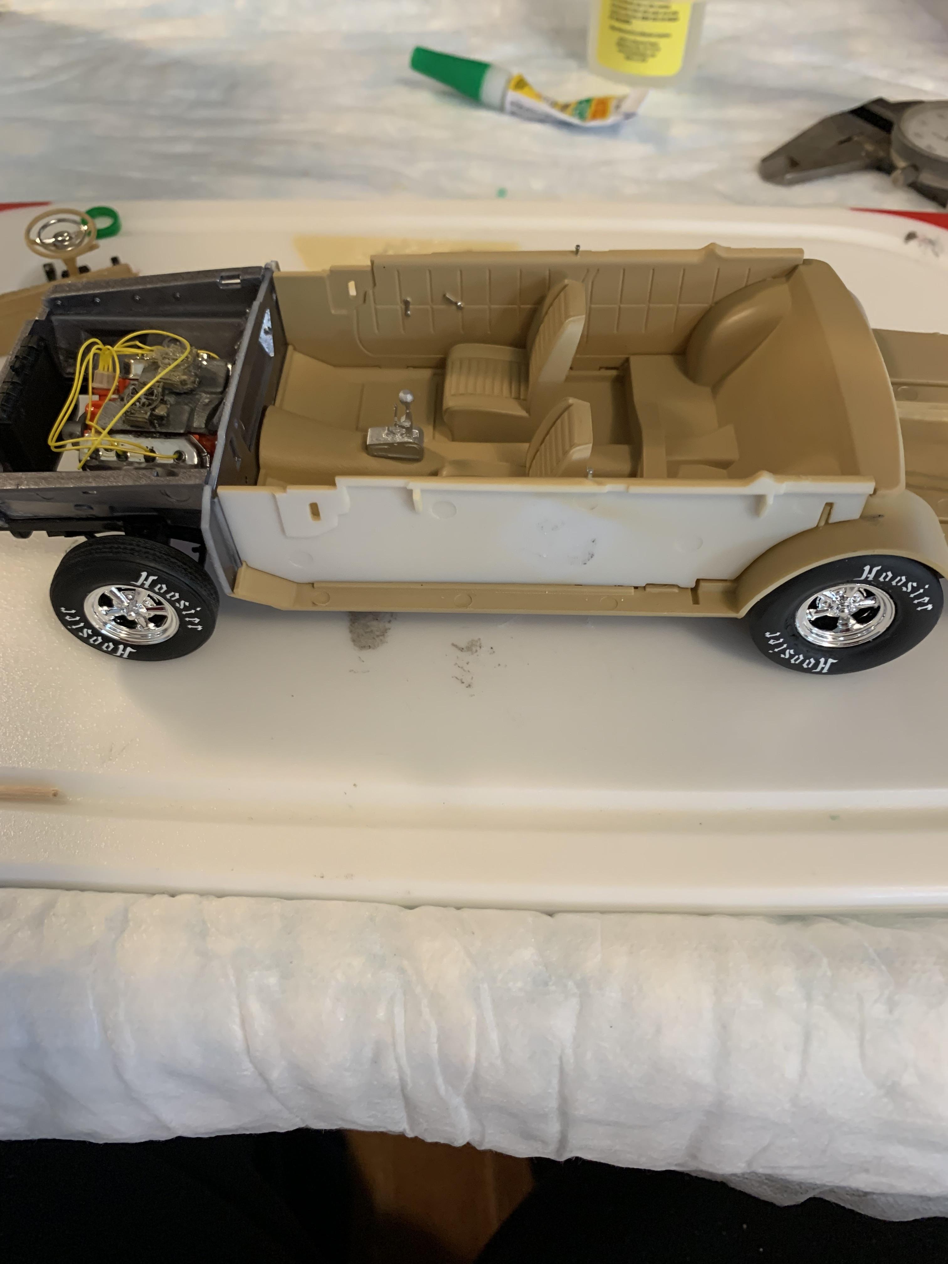

Decided to trial fit the wheels and tires while eating supper. Also trimmed up the frame. Then sanded the backs of the wheels (just had to try out my new dspiae sander/grinder). Put some dull cote on the tires to take some of the sheen away.

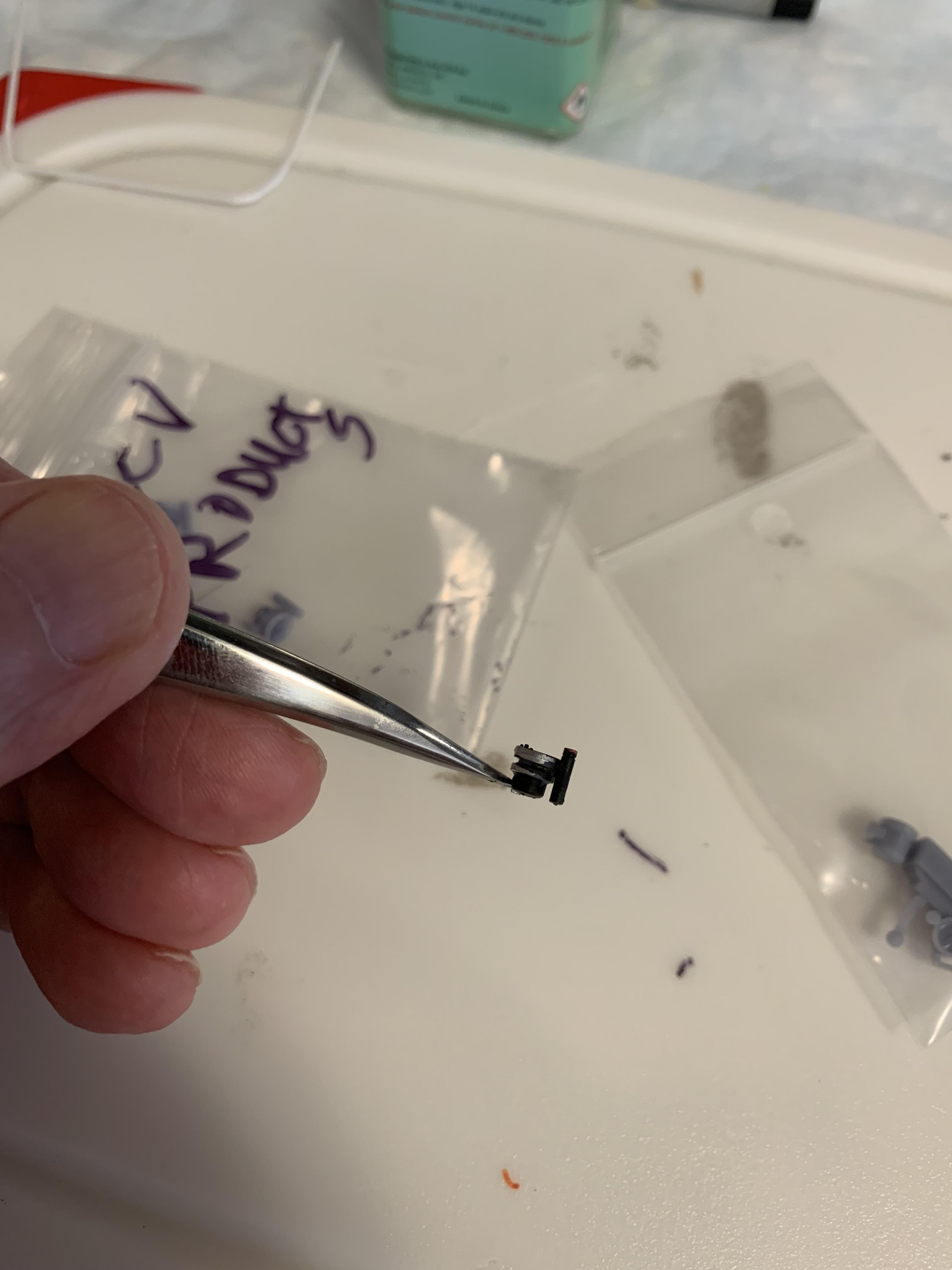

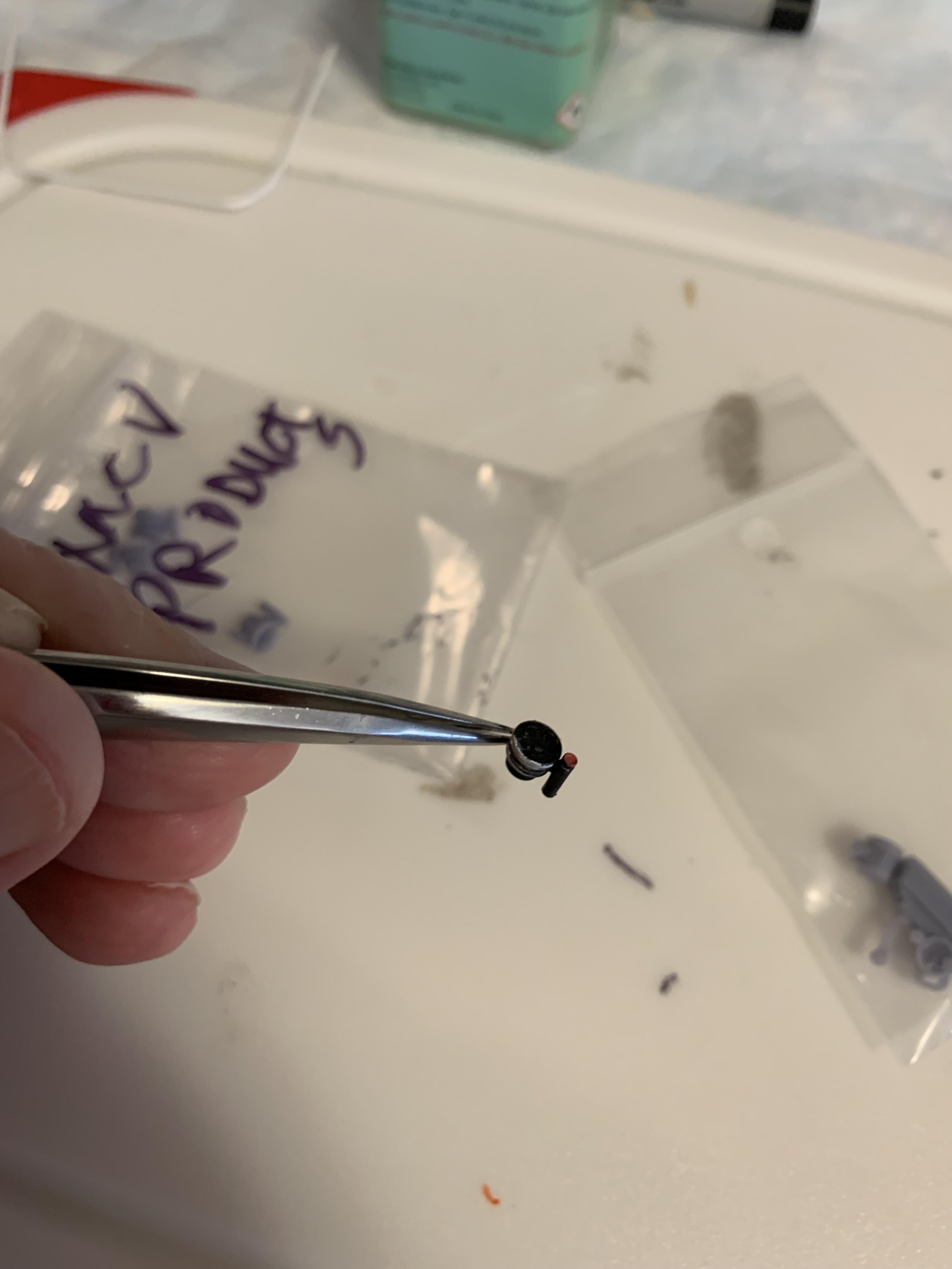

More than happy to answer. They are adhesive stick double backed dots I am trying instead of tape or fun tac. They were helpful in this instance because they are about 1/16” thick and the air cleaner base could be more fully painted. Thank you for all the tips you have posted on this forum, Greg.

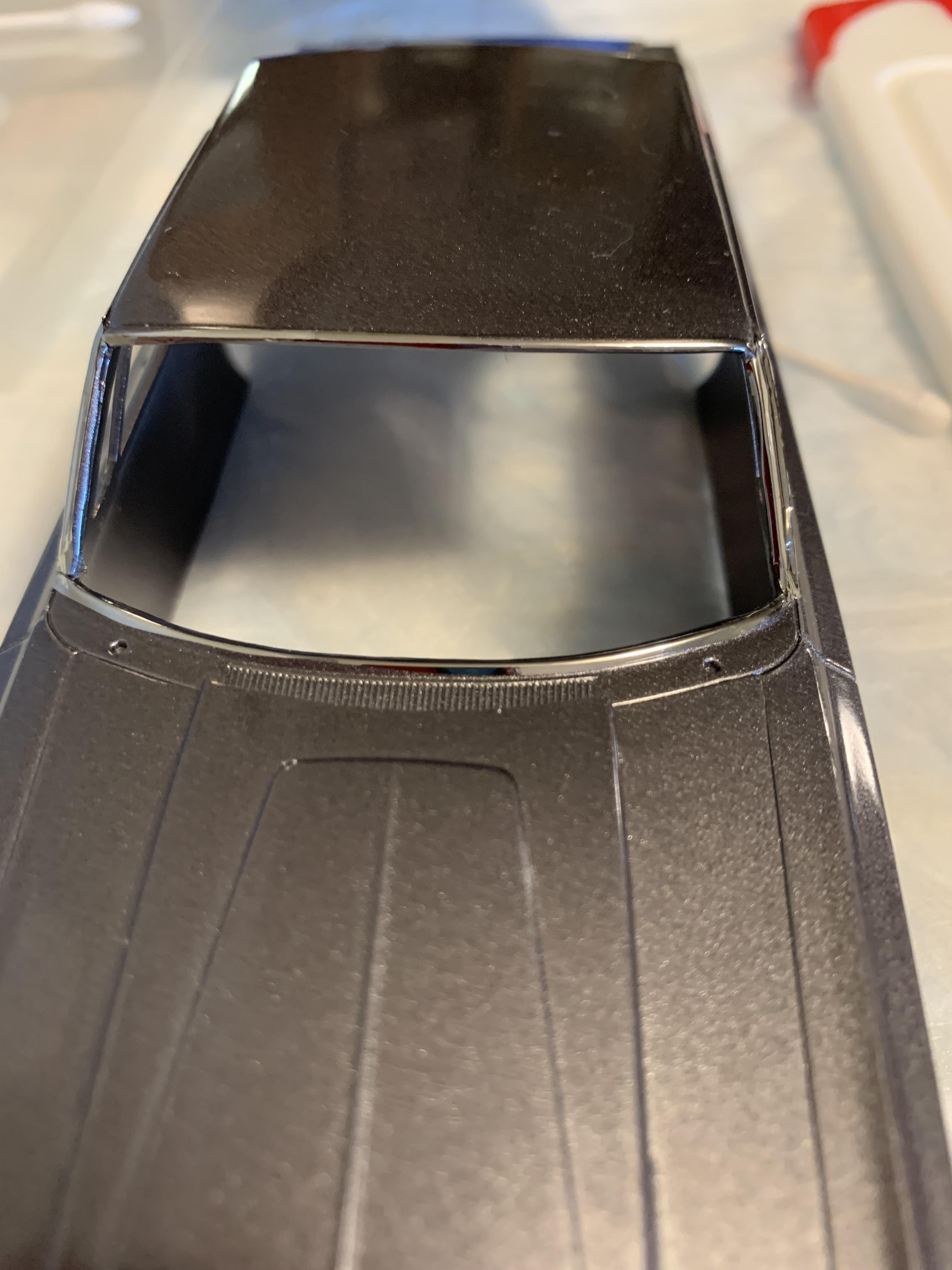

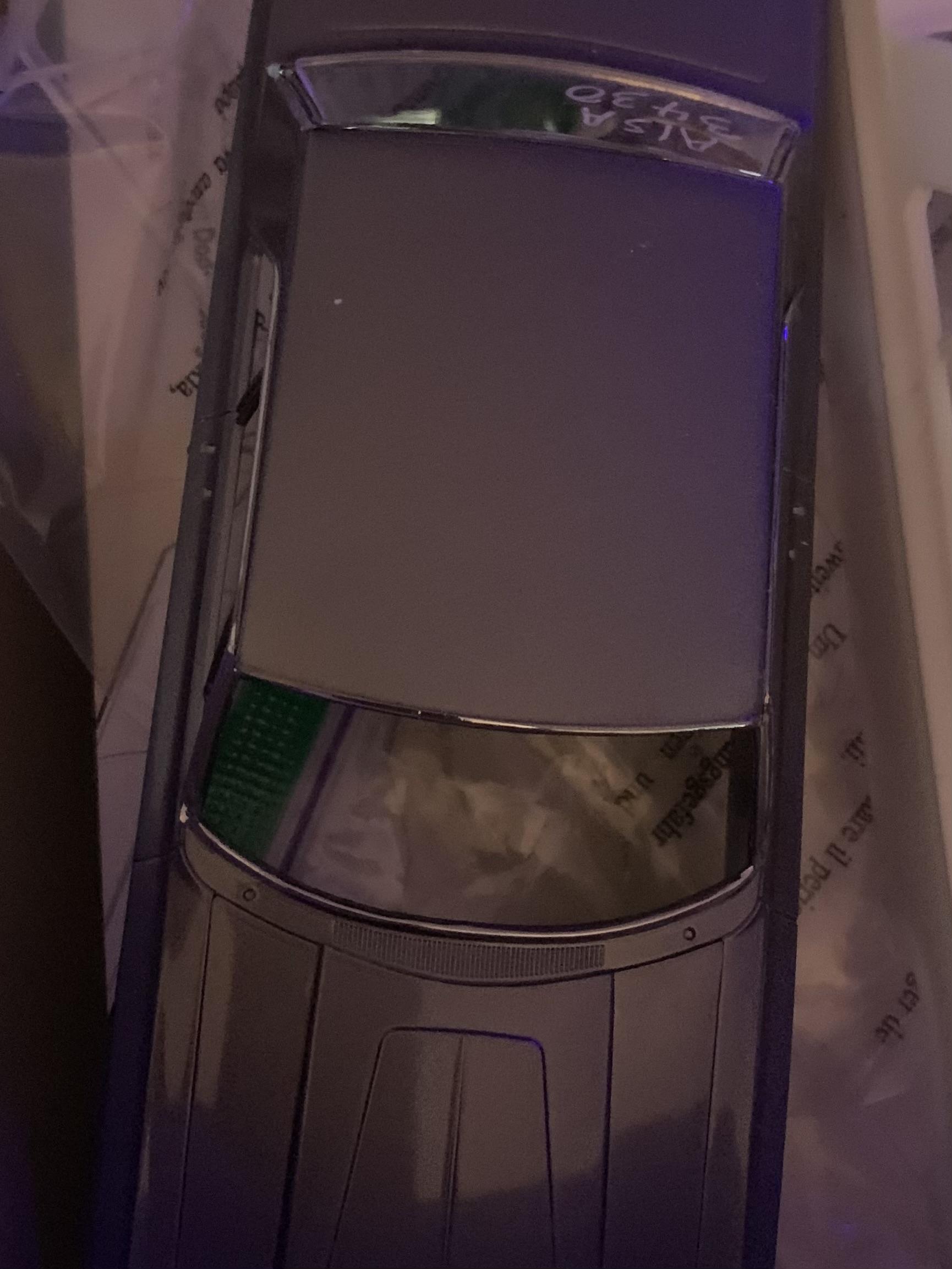

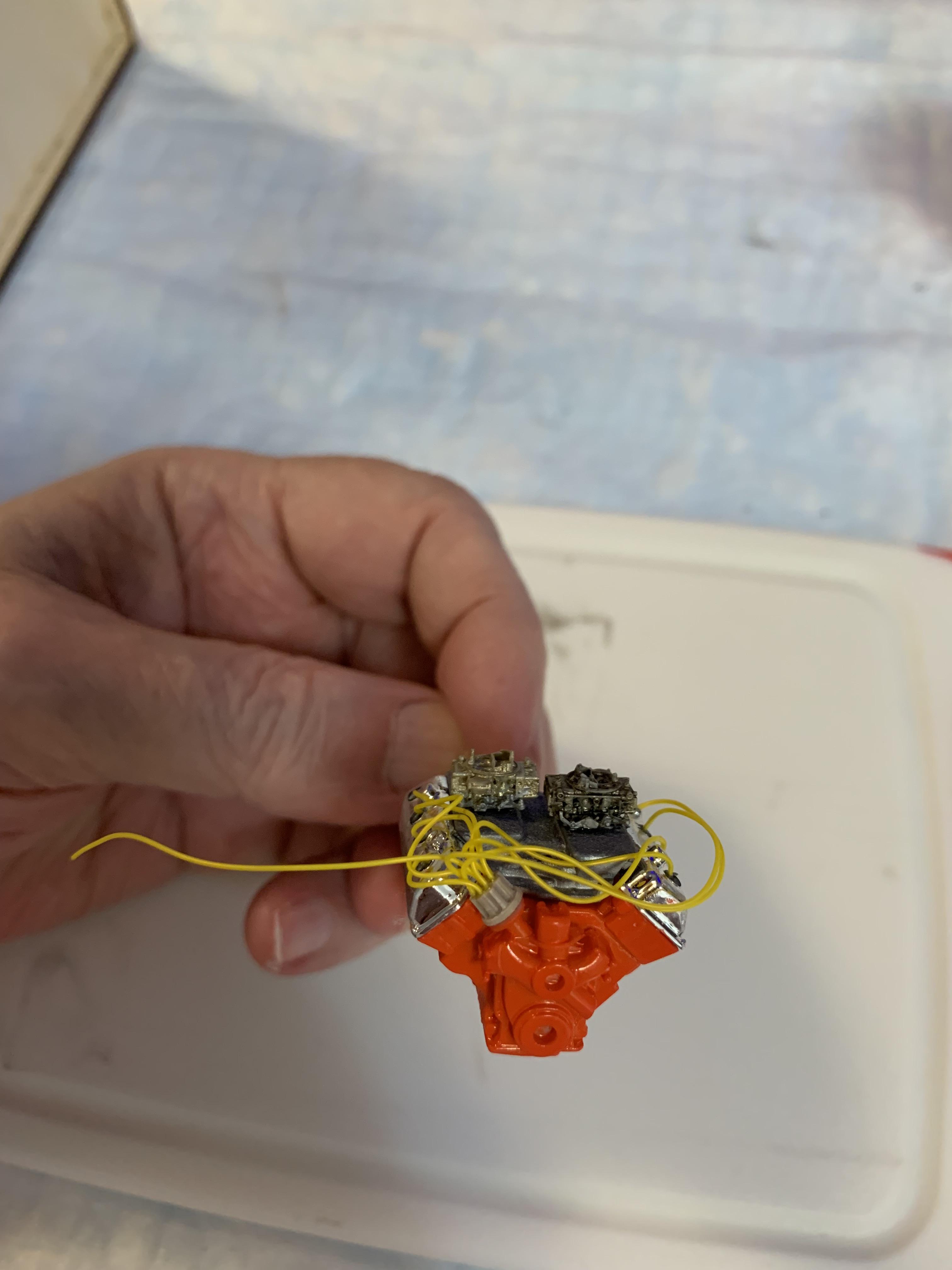

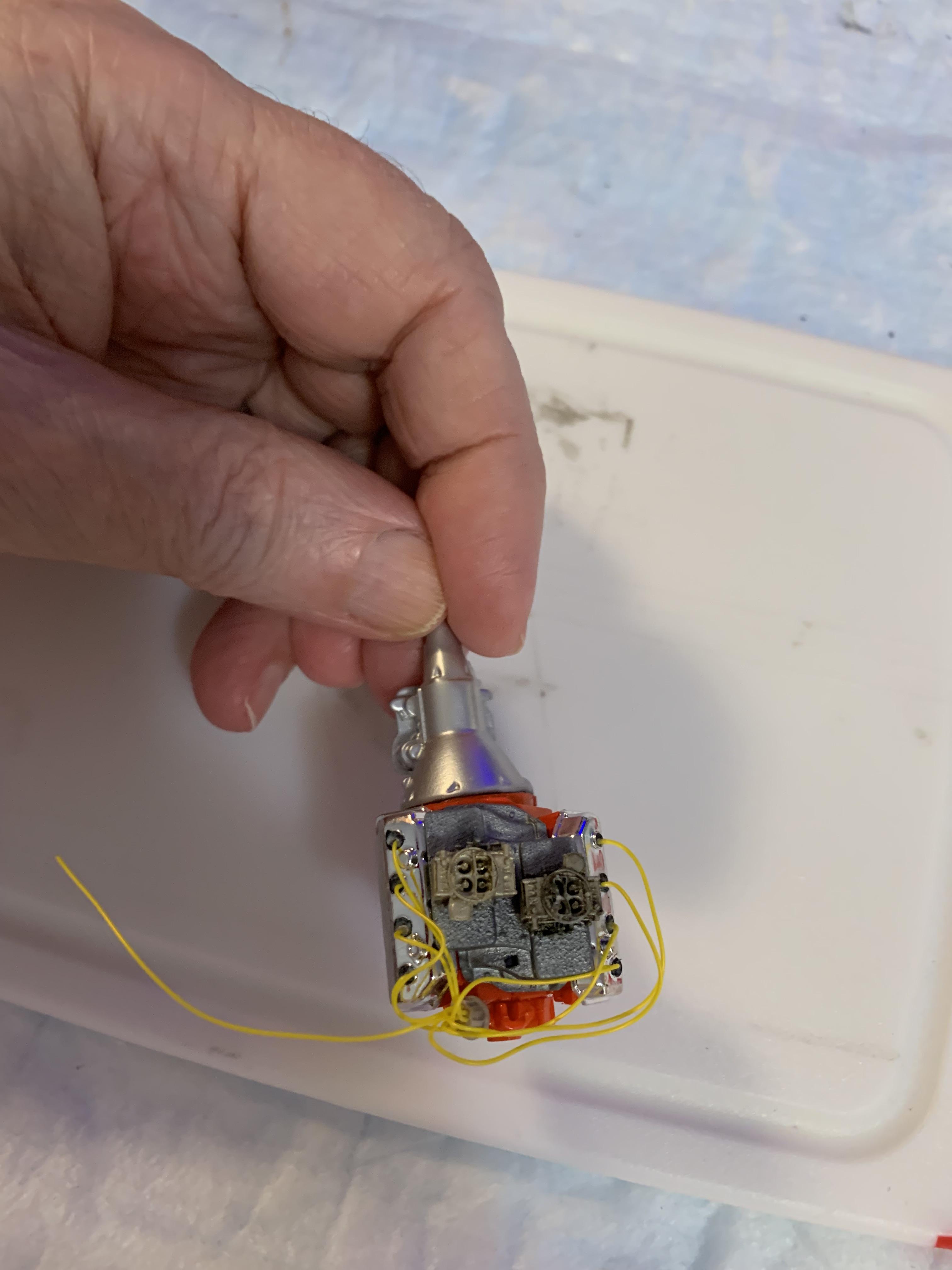

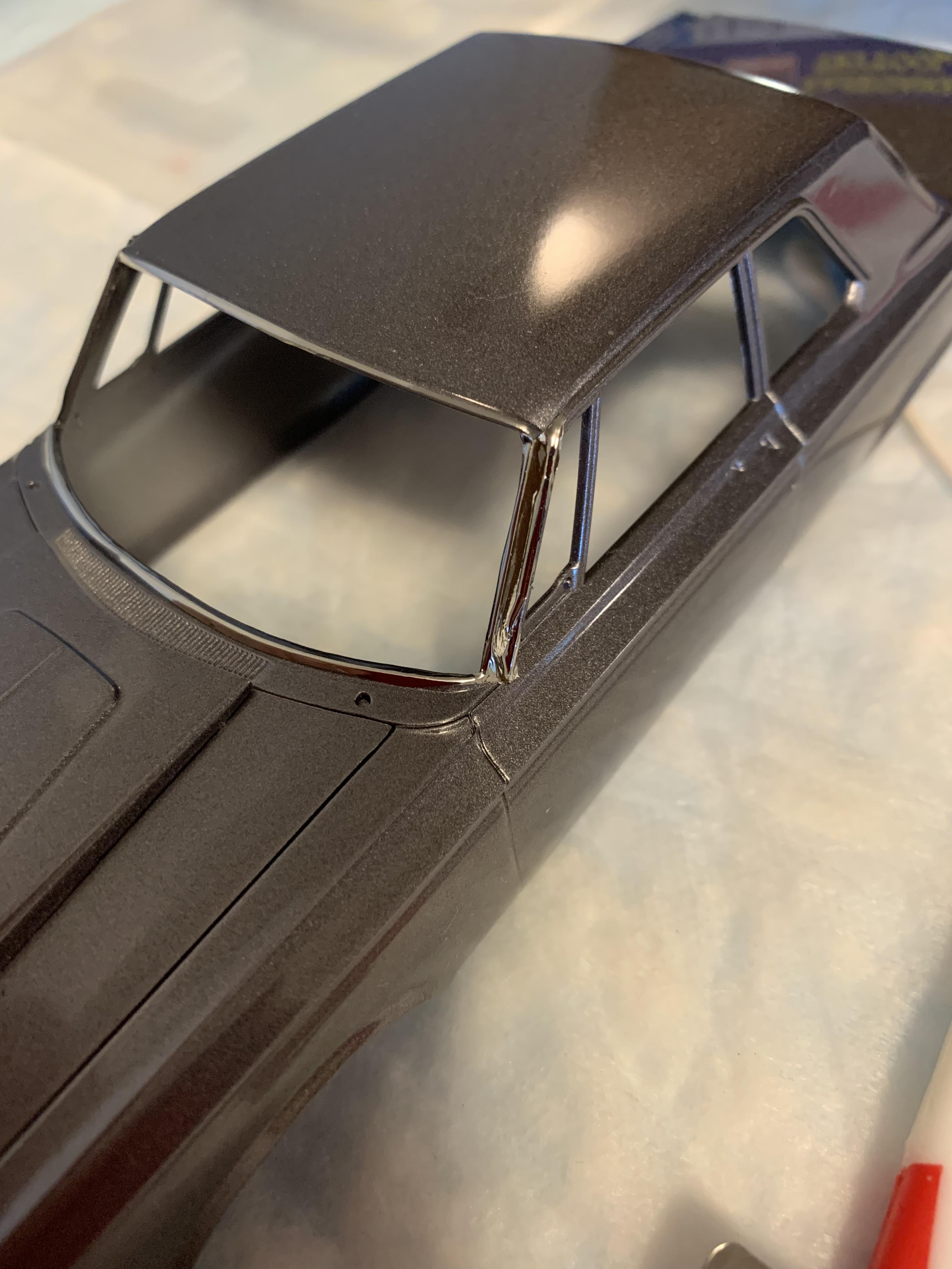

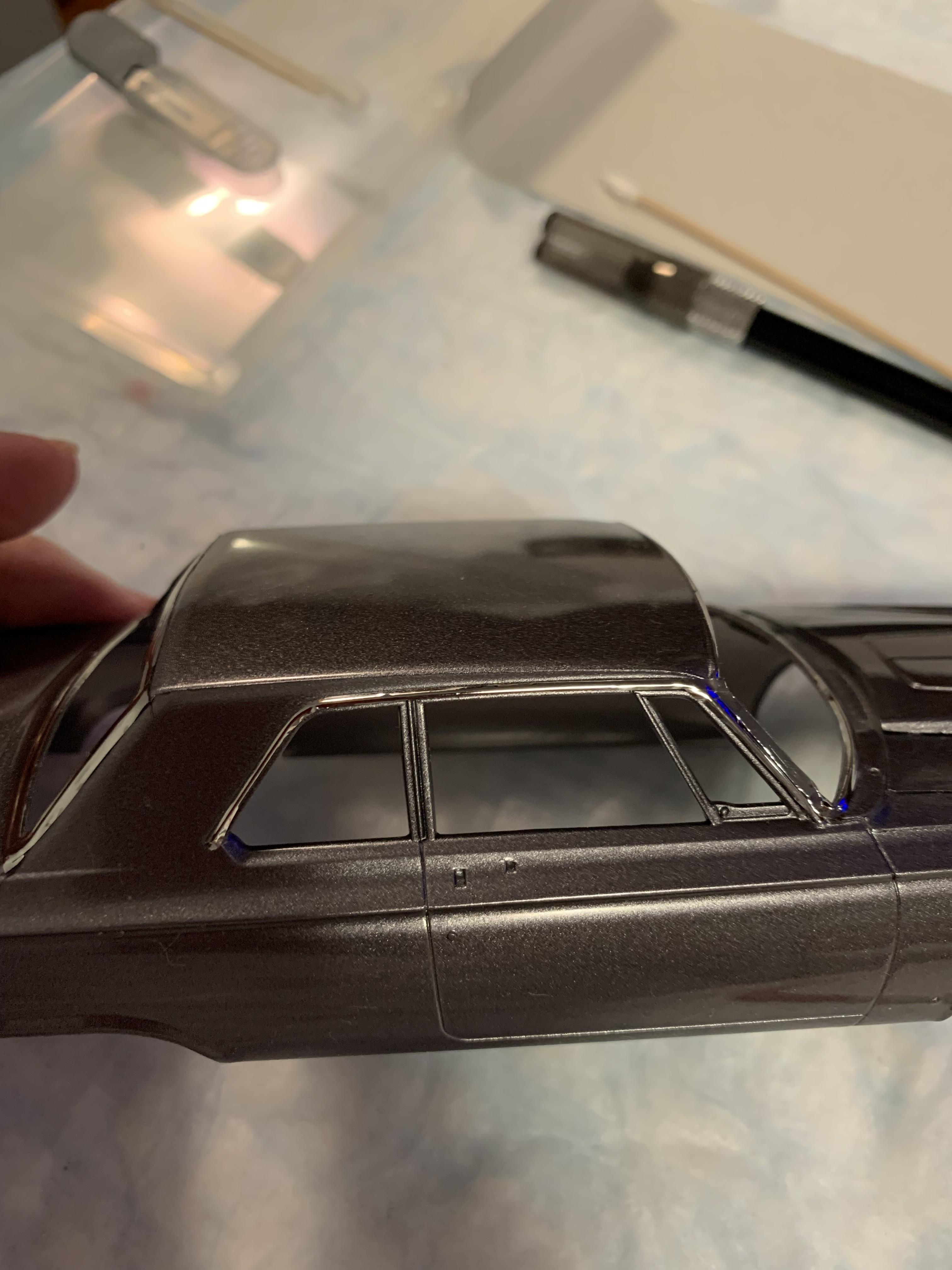

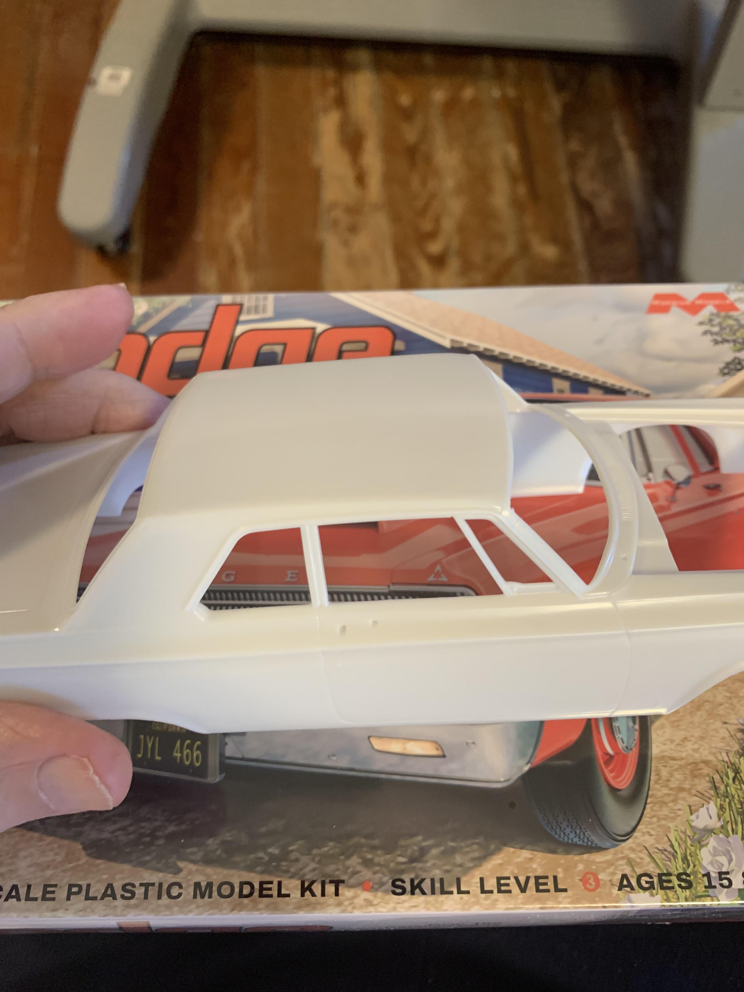

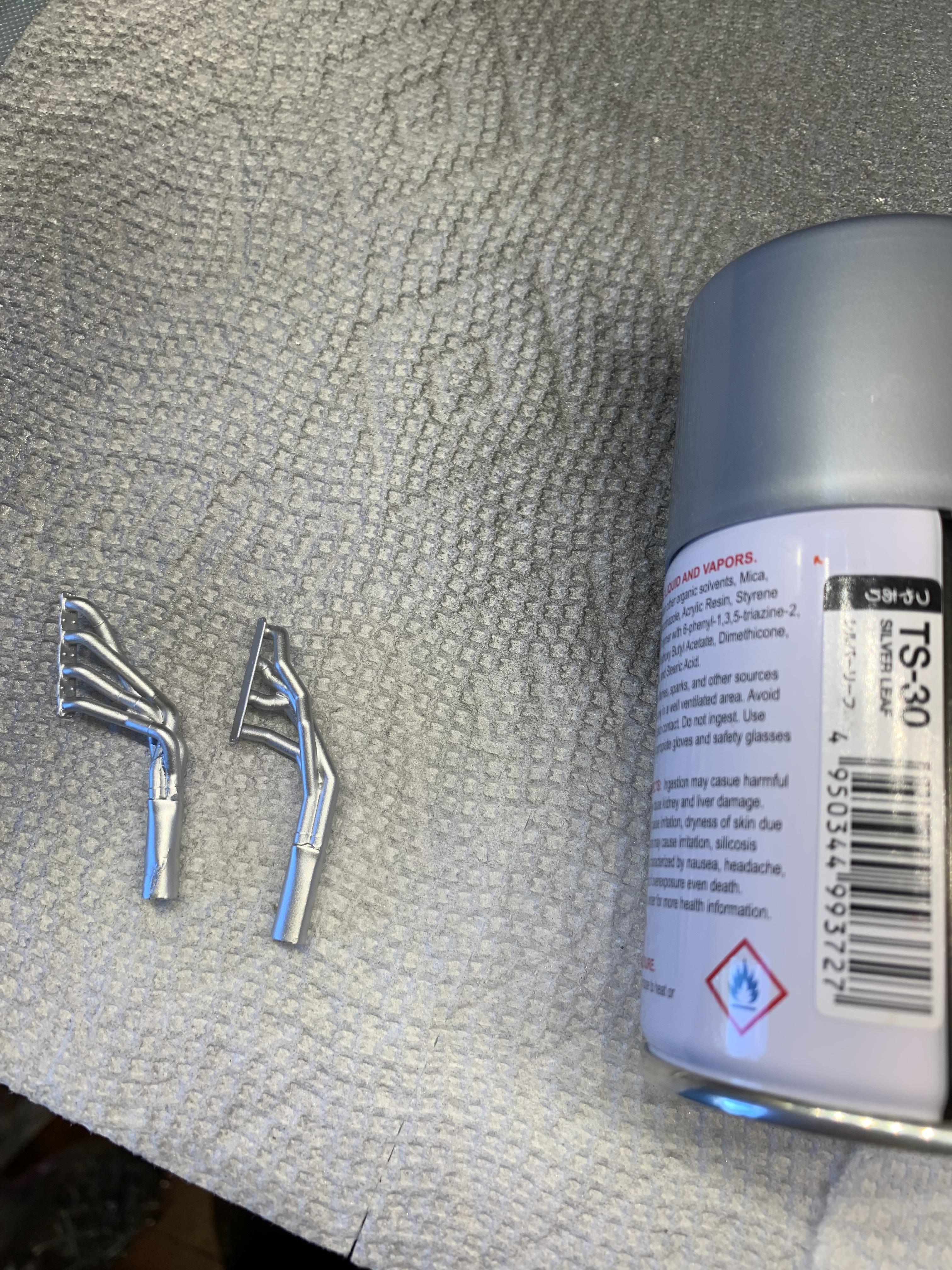

An in between drag cars (waiting for parts) stock build. Love the engine detail. Removed the seam line on front fenders. No primer, no other sanding of the body. Had some old Testors metallic gold spray enamel that I decided to use (probably regret it). Looks awful after the initial spray, but after drying a few minutes, it levels out. The finish is flat with no gloss. Put some Tamiya silver plate on the engine.

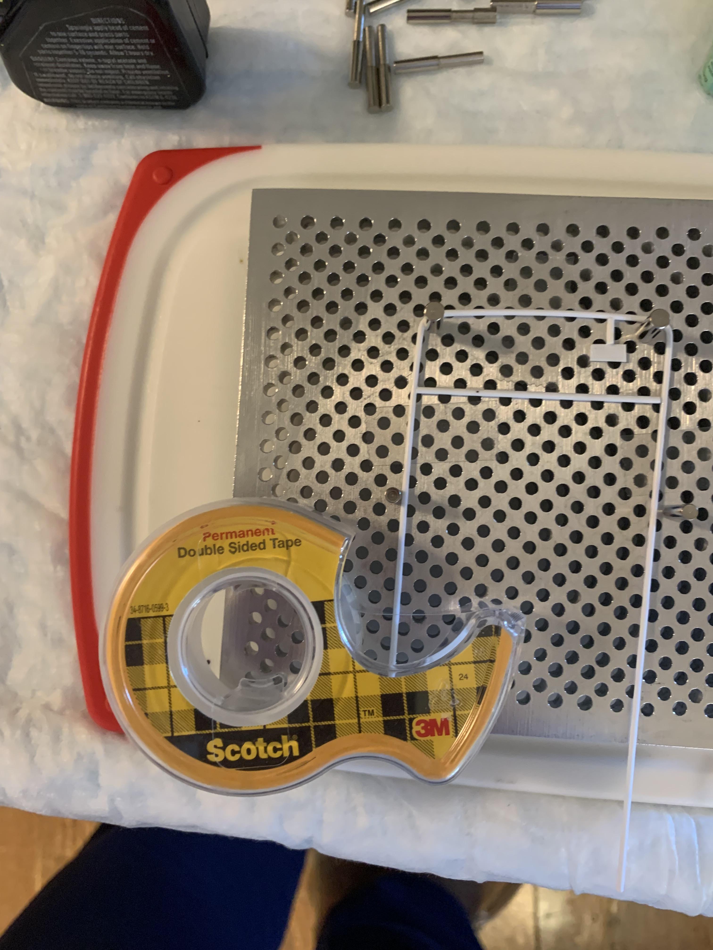

A toothpick with bluetac works pretty good. I am currently experimenting with this. So far, so good.

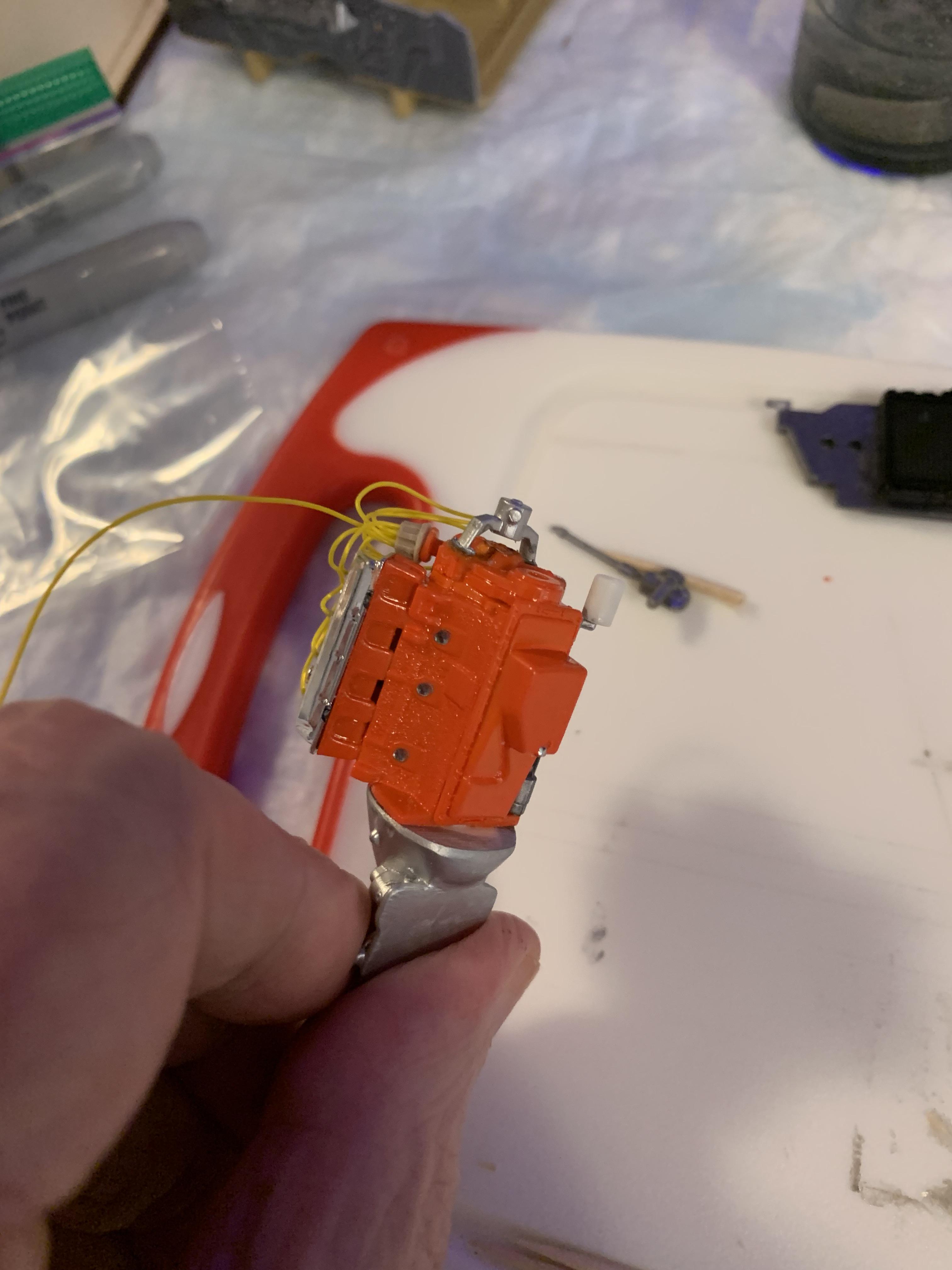

Thanks for the suggestion. I don’t normally do shading or weathering, but you are right. That engine sure looks too orange.

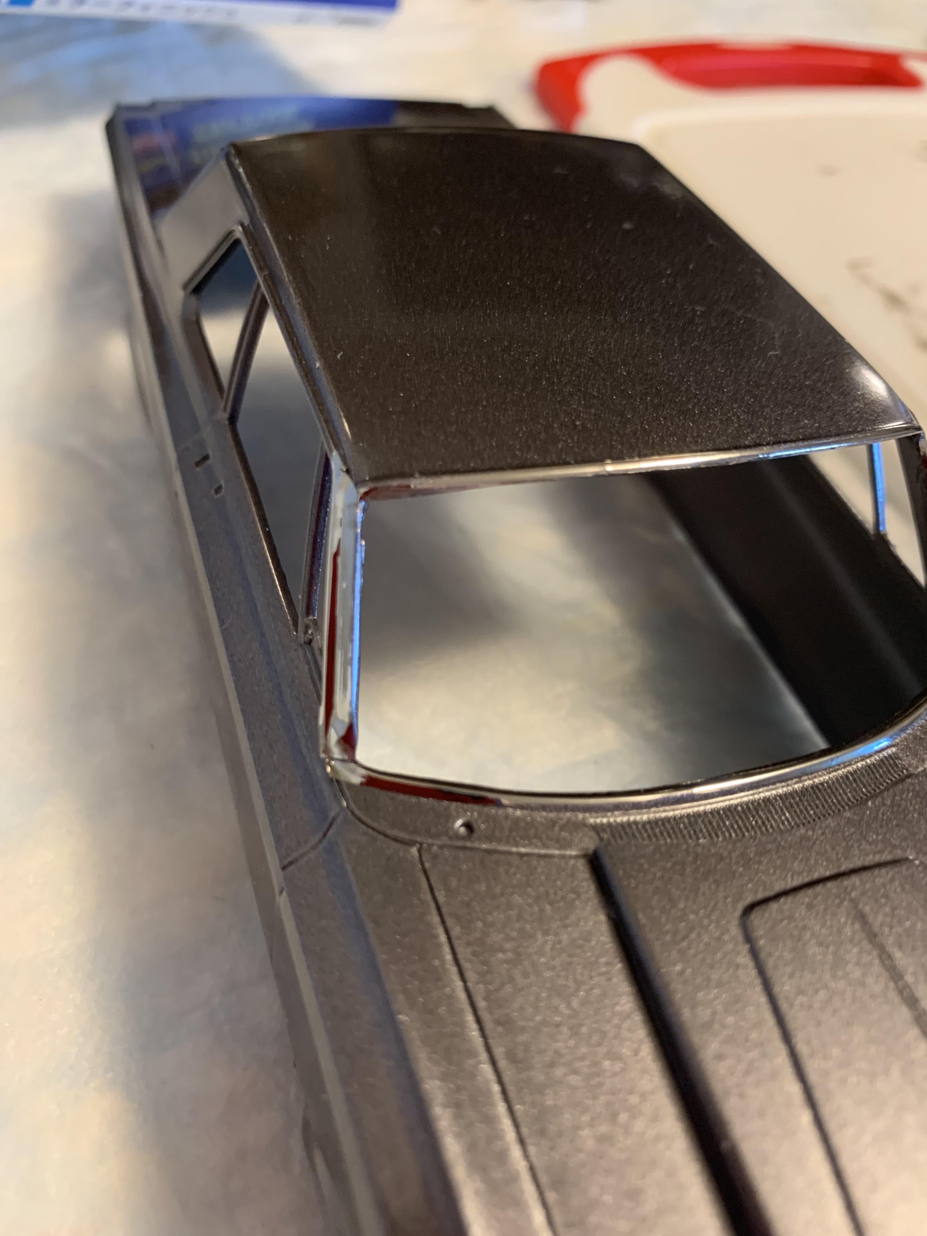

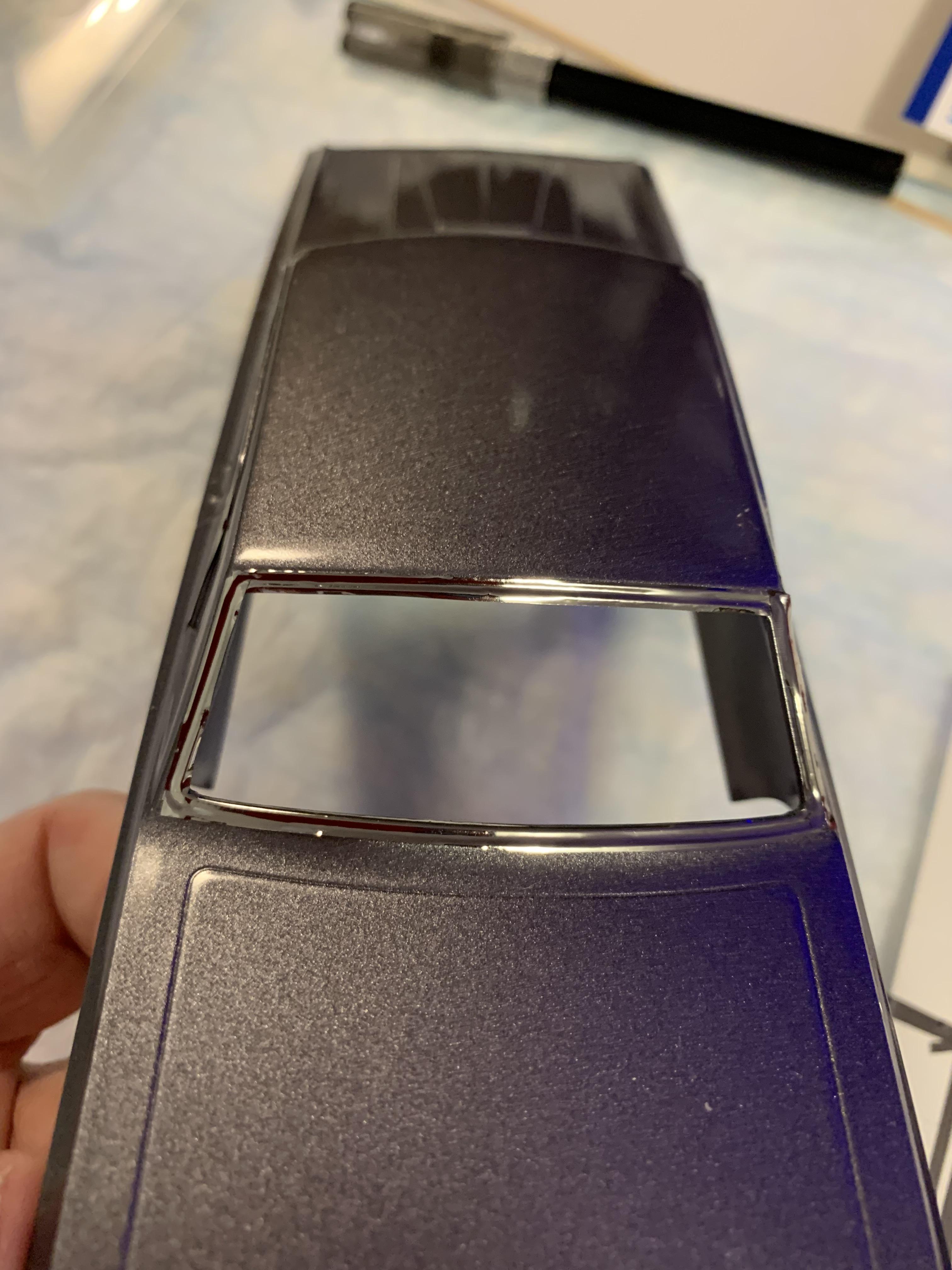

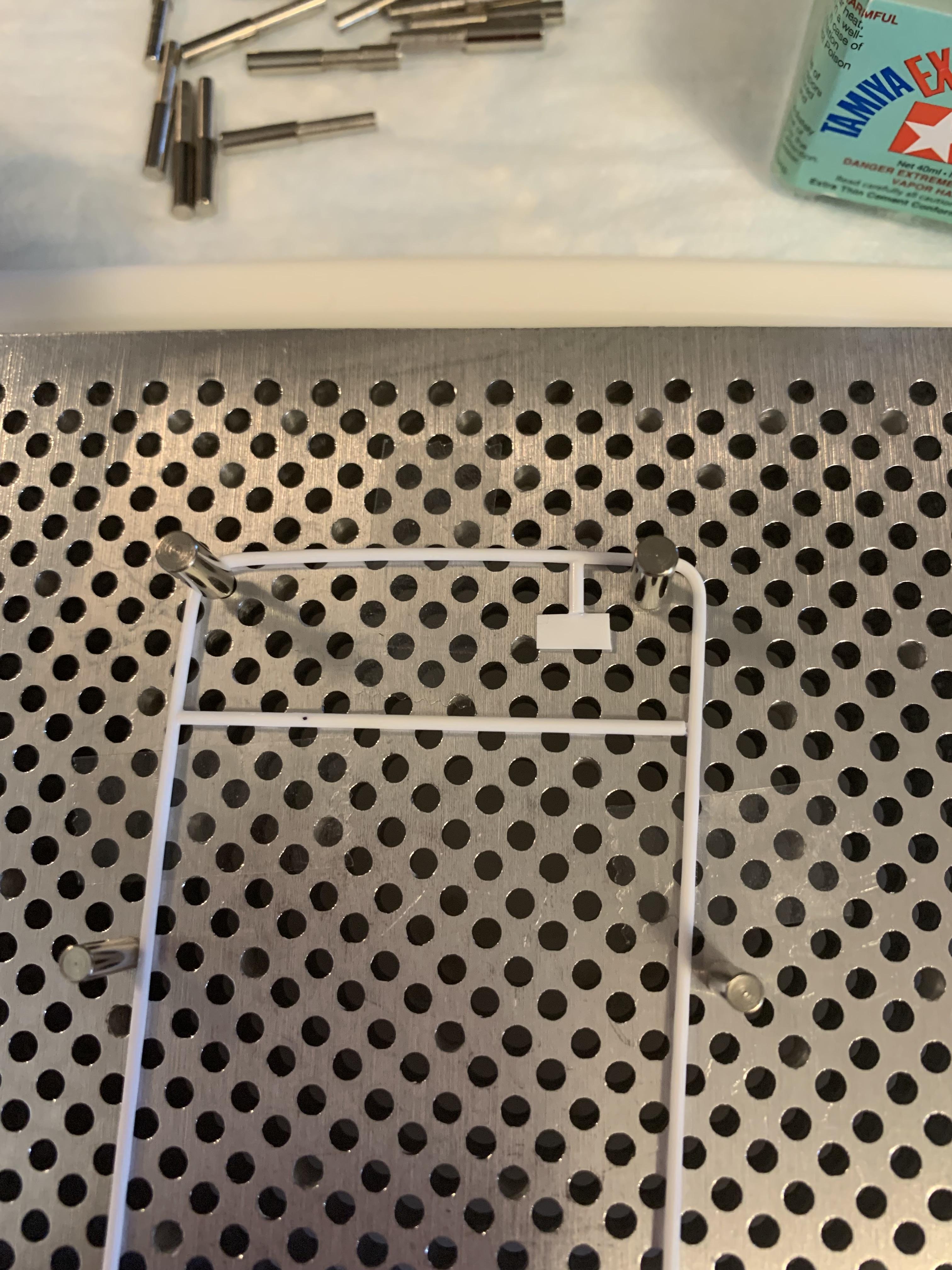

Saturday was a full day with timeouts in between painting. Primed with 1 light coat, then 1 medium, base gold the same way, then clear red (1 light, then 2 medium), clear (1 light then 1 medium). This was all done in 1 day. I usually waited 5-10 minutes between coats, then, an hour or so between different colors. Finished about 2 o’clock this morning. It looks good, so, moving on. -
