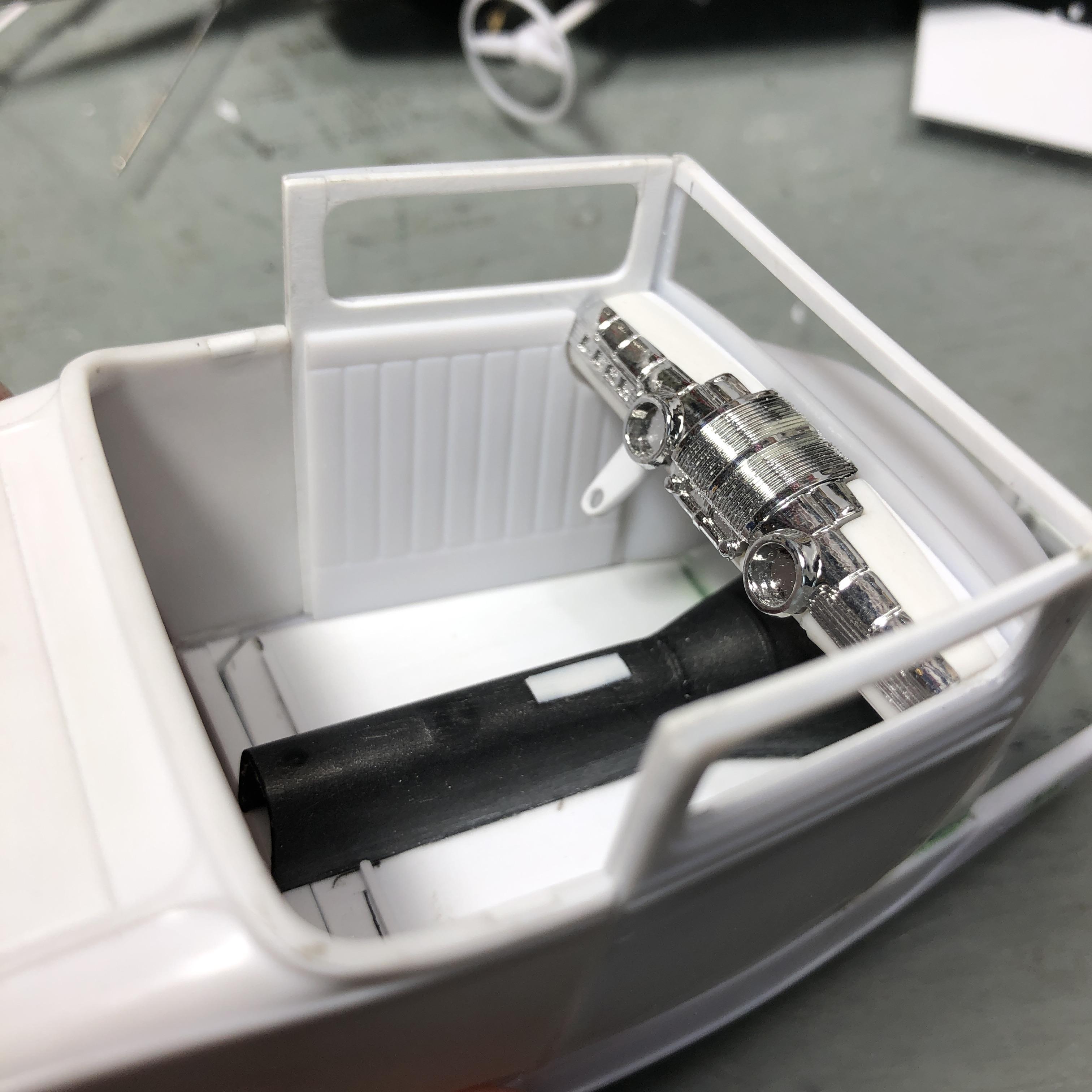

Thanks, I thought the '48 dash looked a bit overwhelming, but it's growing on me.... -RRR -

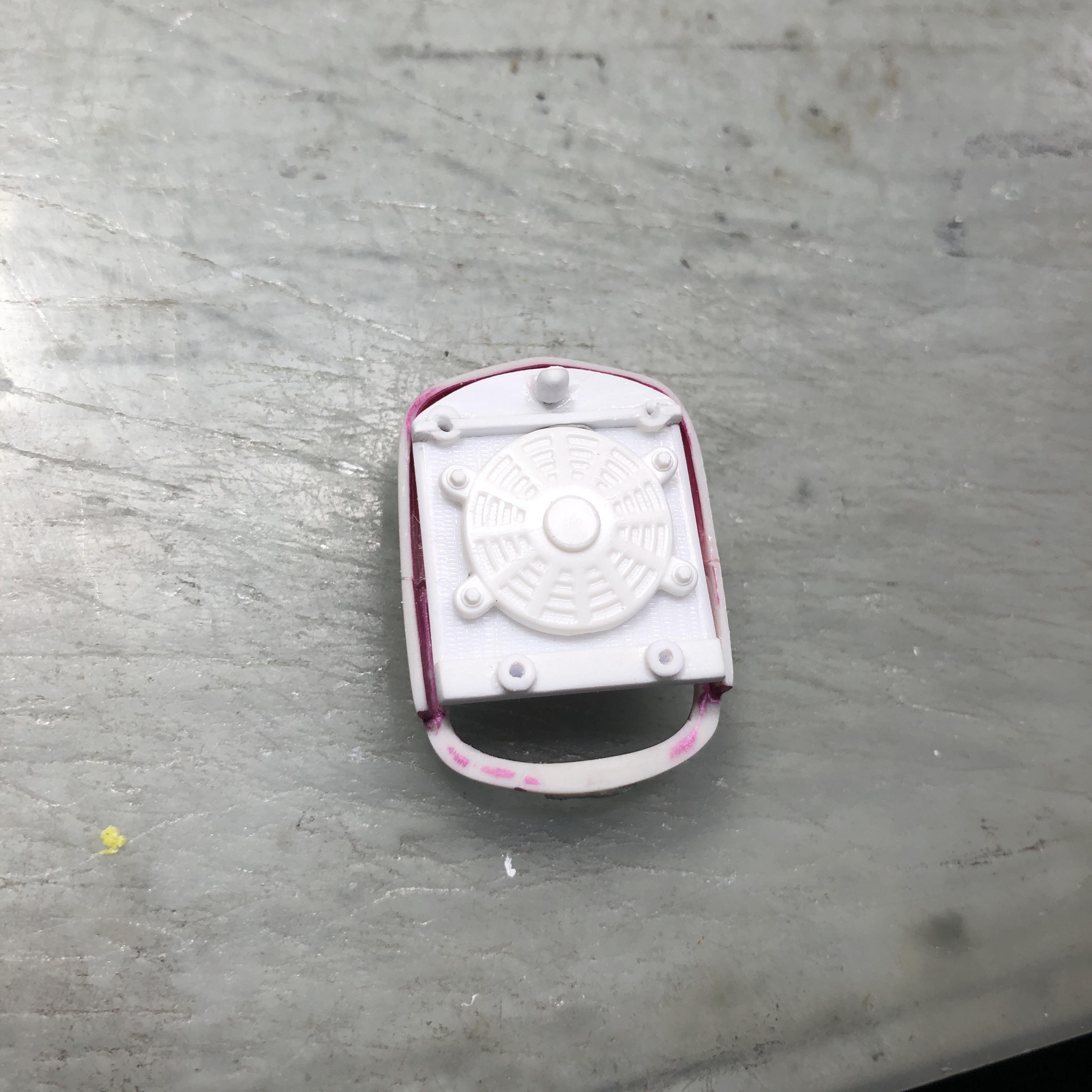

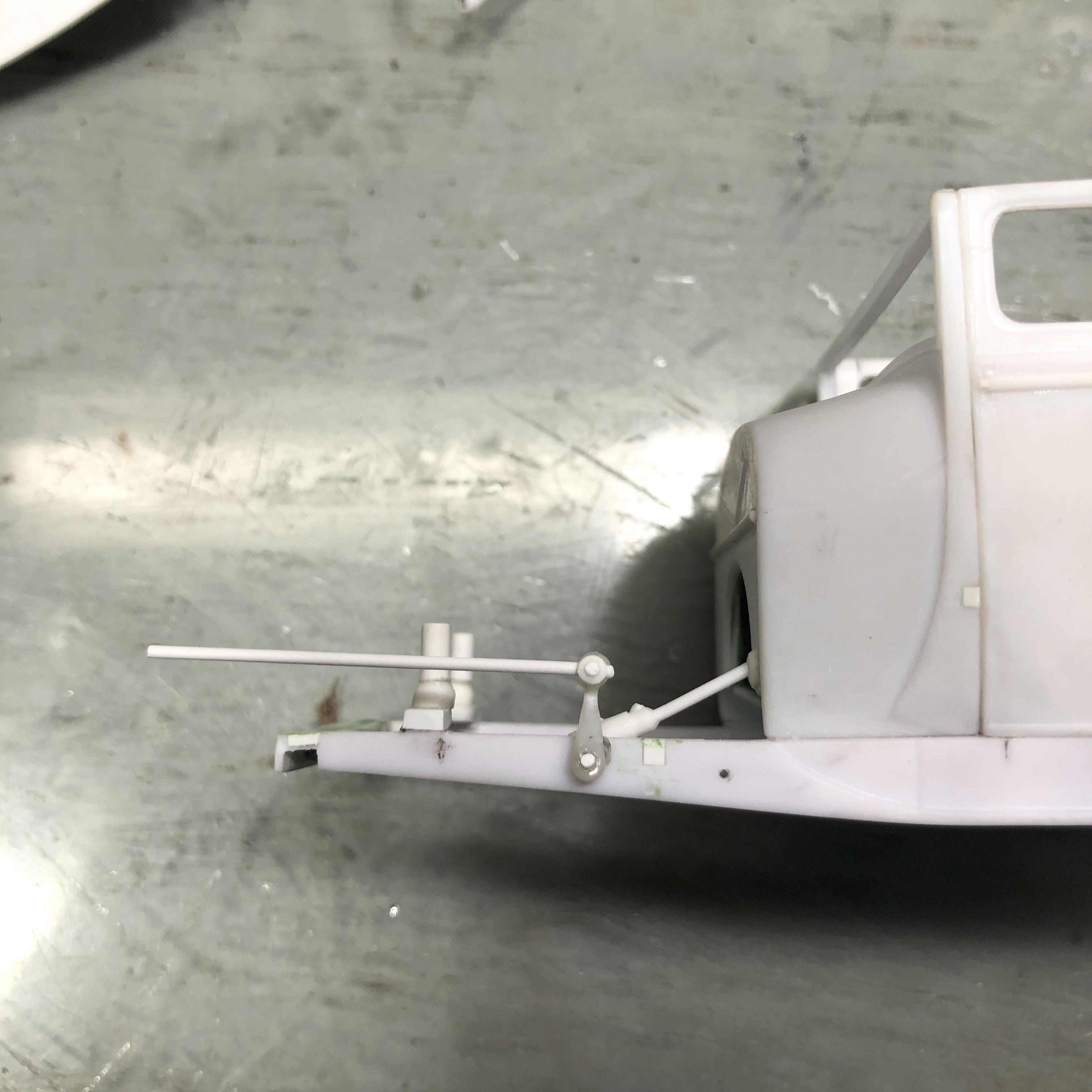

UPDATE 10/18/20 I got a lot done yesterday so I figured I throw up another update today... Radiator built (obviously for a flathead) with a cut down '32 shell from the AMT Phantom Vickie [sic]... I fabricated the exhaust system, grabbed from the old Testors (not Tim) Boyd's Smoothster, cut it up and put it back as needed, parts were originally chrome plated...once pinned together it fits nicely. I worked on the interior. Door panels are from the Revell '32 sedan. The parts do line up, they look a bit wonky mocked up... Front suspension... Steering... rear panhard bar.... I'm getting pretty close getting this done. I'm in the process of making a gas tank that will be located on the back side of the seat, a few other odds and ends still to be done...thanks for looking... -RRR -

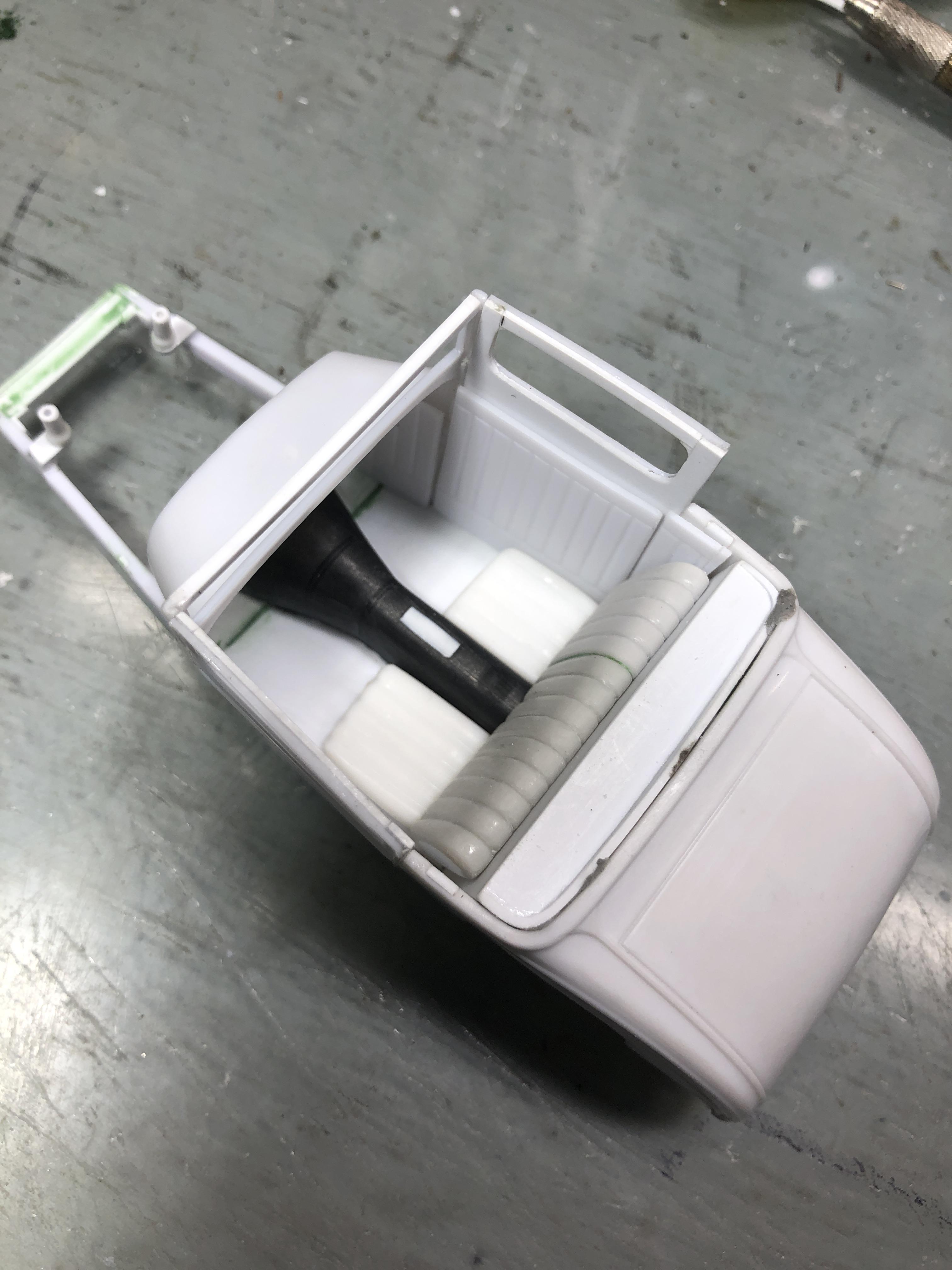

Time for another update... working on the interior and the rear suspension. Fabbed up the package tray and back wall of the interior. The seat is made from two pieces of the venerable AMT 'T' bucket tub, split between the transmission tunnel. The rear suspension is going to a separate piece that will be attached during final assembly. The main part is from the same frame as the rest of the build, is the '32 frame from the Revell 'A' kits. To build this I attached the frame to the body (with axle and springs to get ride height set) with white glue (that can then be soaked off afterwards, taking it apart) and built the two pieces that will attach to the floor pan assembly. I'm not sure how clear this is.... The next pic shows the two frame pieces glued to the rear frame with a brace super-glued to those two pieces (I was concerned about the frame coming apart once I soaked apart the pieces temporarily held on with the white glue). The brace will be taken off after the frame is separated from the body. -

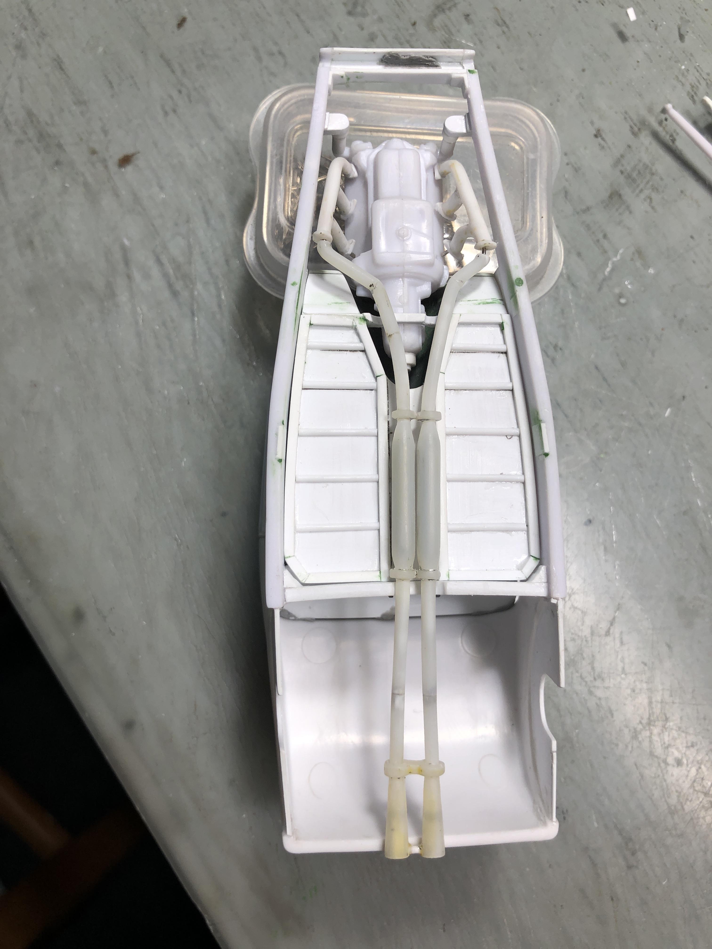

More work on the sport coupe.... The idea for this making a unibody is from a post of a 1:1 car on H.A.M.B. Part of that means that the body is attached directly to the frame and that the floor pan is a structural part of the car. To that end, I braced the floor pan like this... The car will sit very low with the engine sitting up high so as not to hit the ground. The trans/driveshaft tunnel is from an old pro street kit. The exhaust will run down the center of the floor pan.... Thanks for looking. -RRR -
