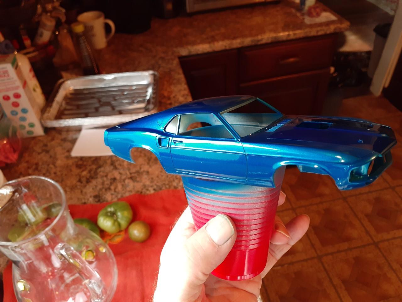

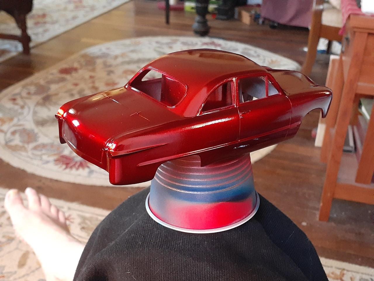

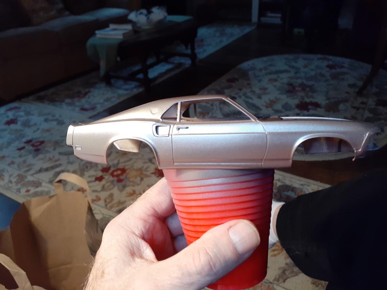

Clear red over silver vs over gold has two distinct looks. Back in my days of entering contests I used Testors transparent red over either one. I think the silver gave more the traditional candy red look but much depends on how many coats of red you put down. The gold brought the candy up towards more of a burgundy. Both looked great. More recently I did this with Tamiya clear red, added a touch of clear blue and shot it over metallic rose gold ( rose gold depending on the angle can't quite decide if it a light goldish red/pink or silver red/ pink. But the clear red looks awesome over it, or the blue for that matter. I've done candy green too. In either case I never found the need for clear coating. The translucent colors have enough clear already IMO. It's really not tricky at all to do, just get a nice even coat of base color first, don't go nuts with a million coats of silver or gold just make sure it's even. And the clear/translucent color, don't make sag or run but put it on pretty wet and you're home golden.
