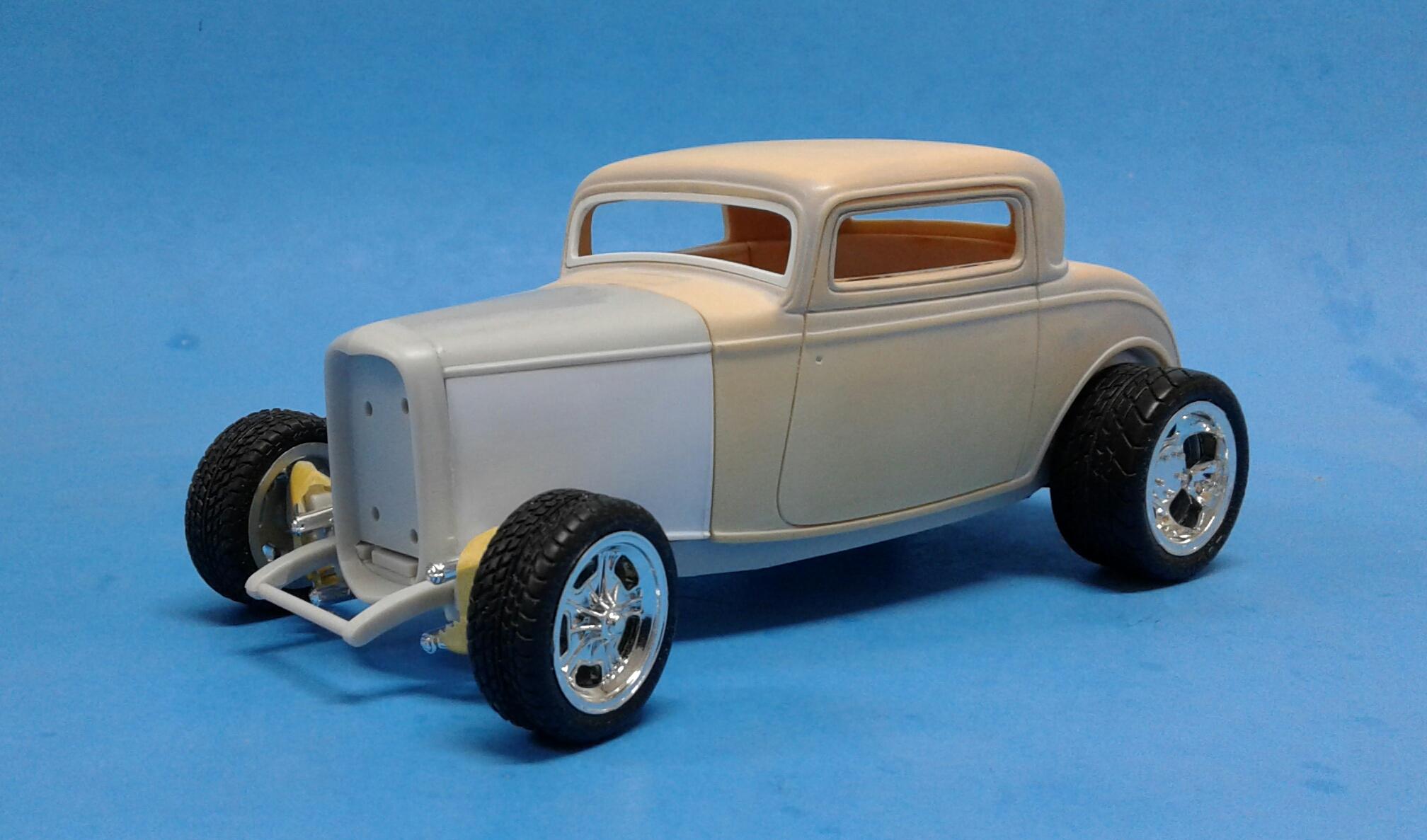

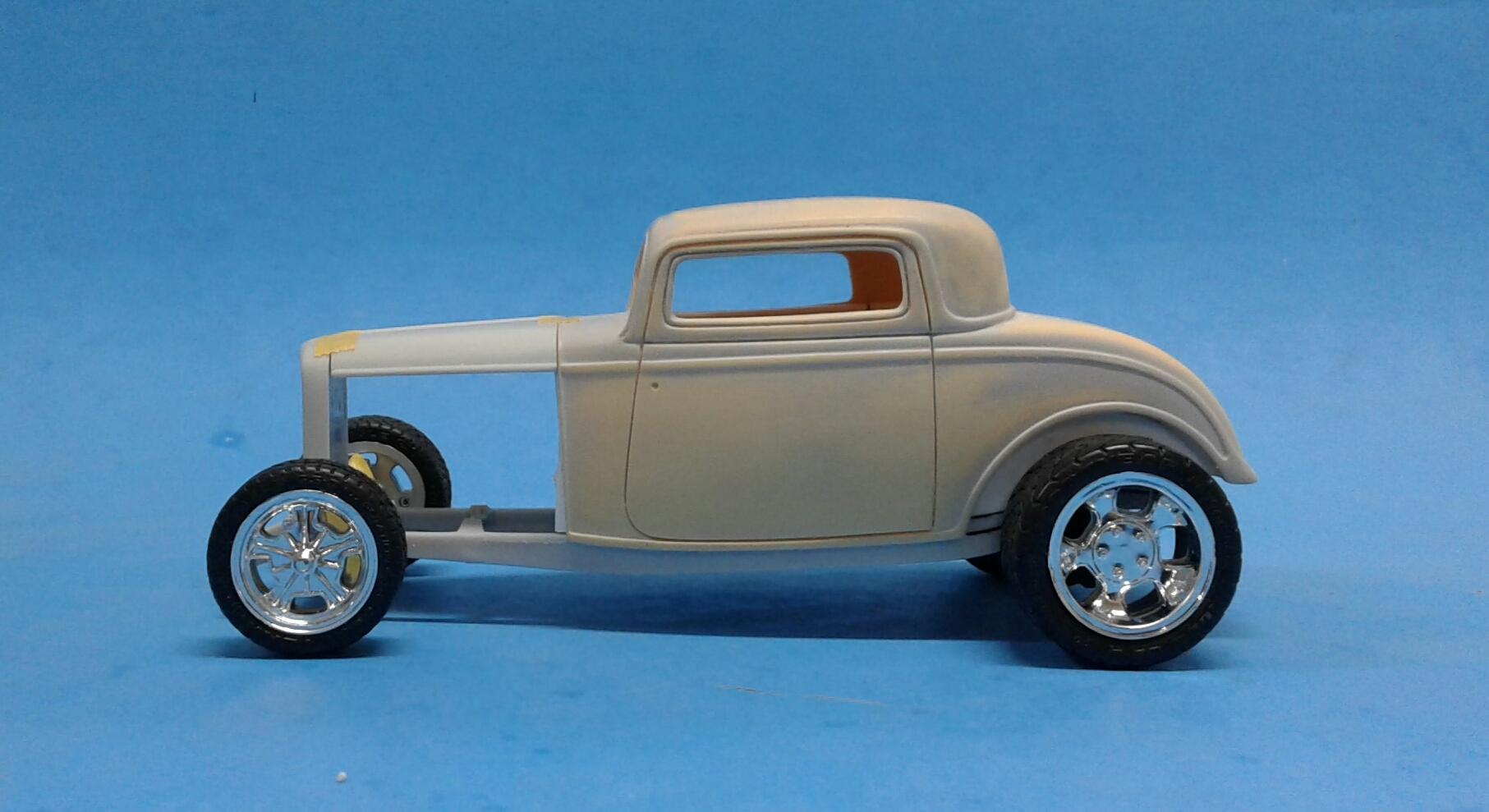

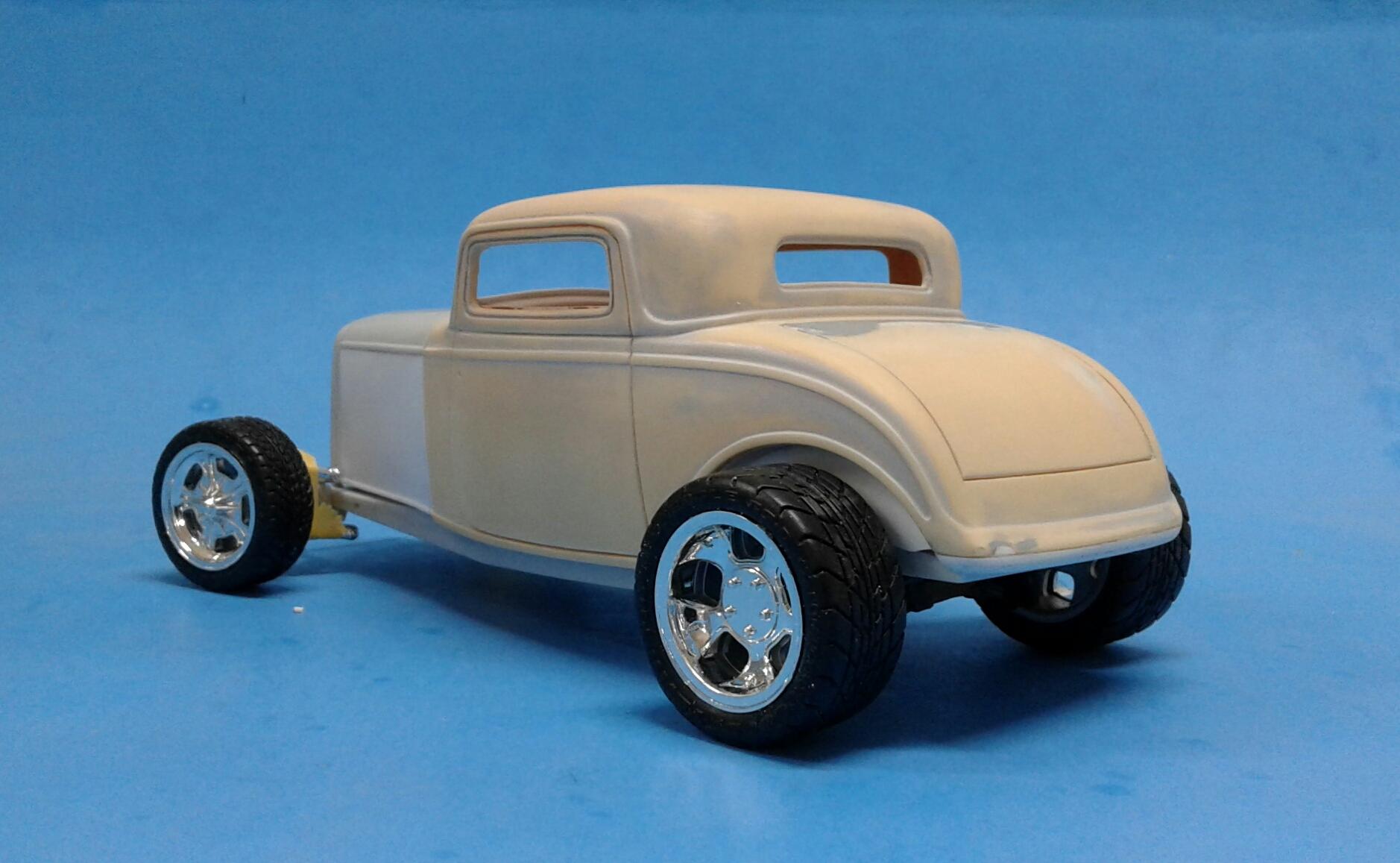

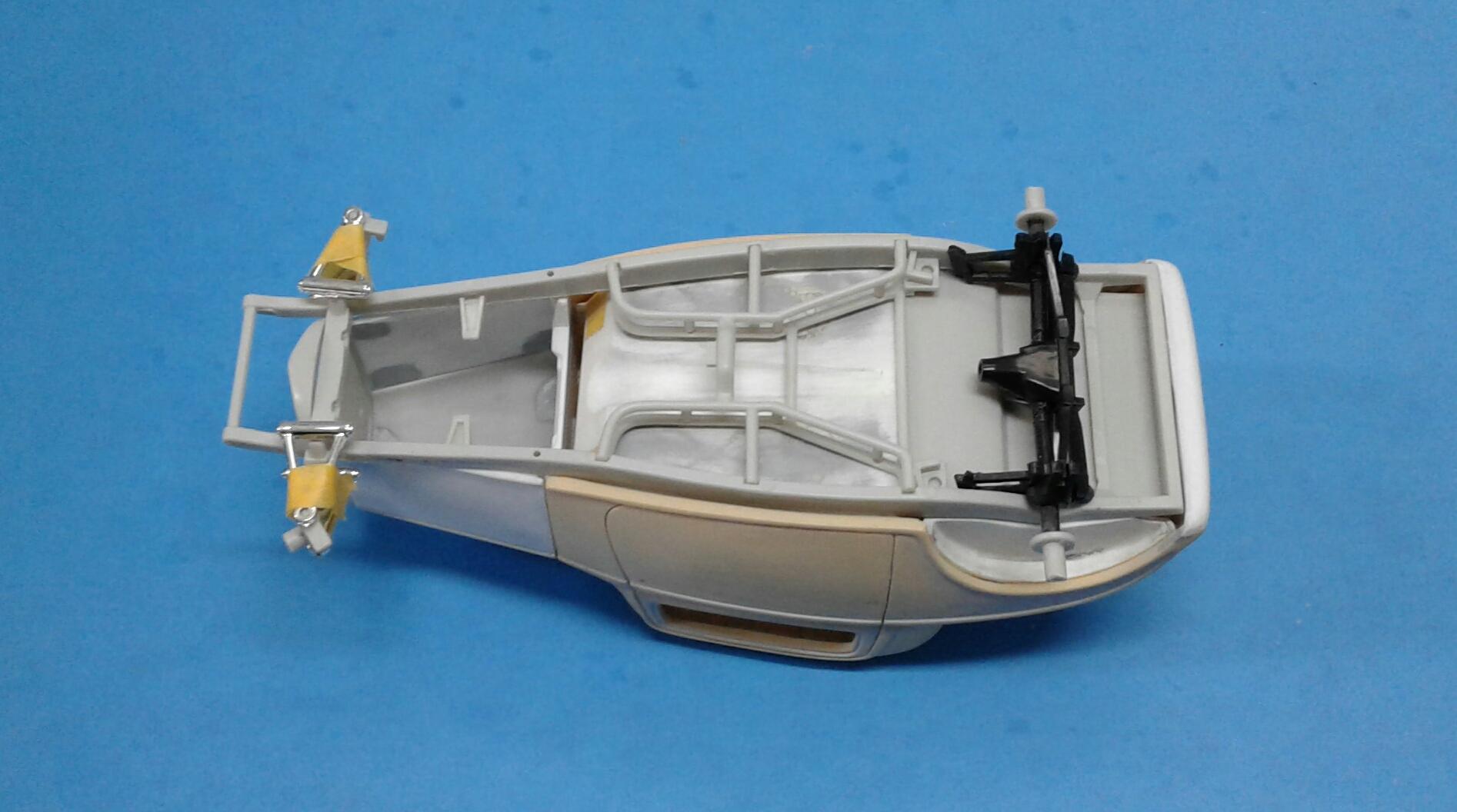

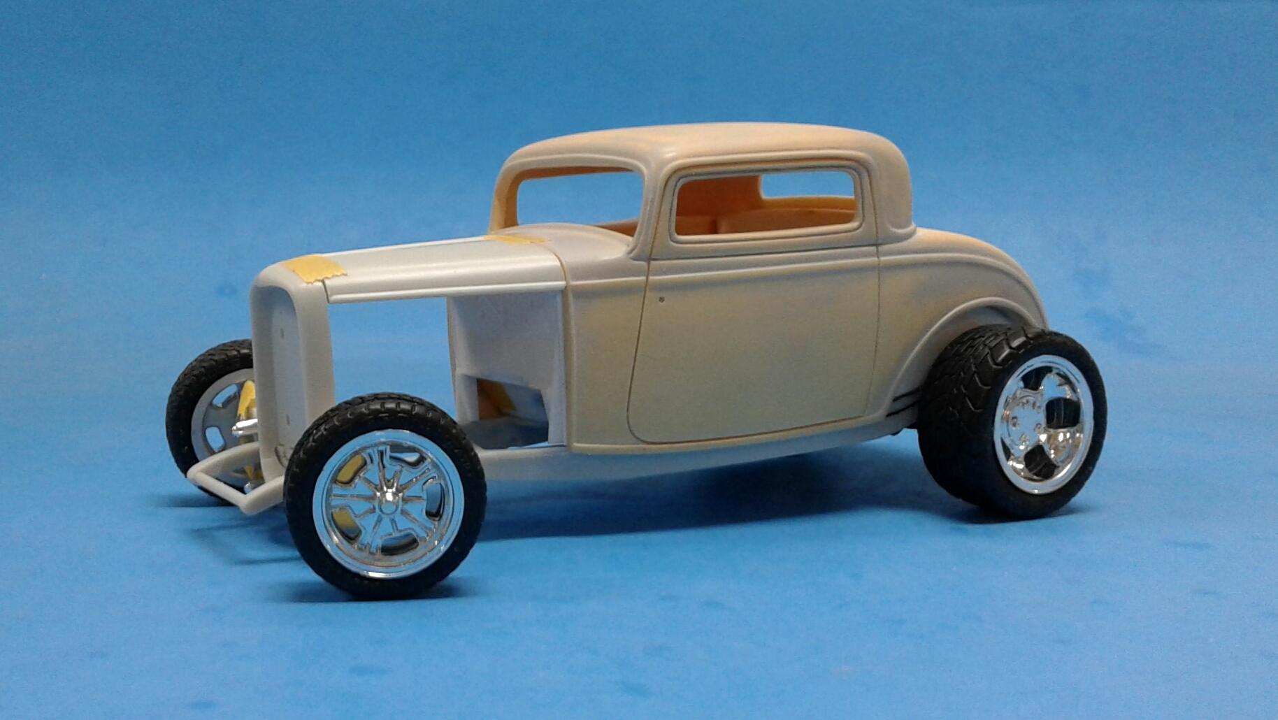

I've done quite a bit of work on this thing the past few days even though it doesn’t show a great deal. Mostly tweaks and changes. I got the body to set a little lower on the frame. It was enough that a two scale inch rolled pan almost hid the frame. I can live with this. Where I've spent most of my time has been the front straightened out. When I did a mockup with the hood, sides and grille together, I was 1.5 mms short. Plus, I had dropped the front of the body to make the floorpan rest completely on the frame. This caused lots of problems! My fix for the hood being too short was simple. Kind of. I slid the frame back and the rearend forward. That caused some clearance issues with the rearend. With the gap closed on the hood, I still had an issue with the sides not being quite square. I had to do a little fill work to get a nice line between the sides and body. I temp glued the hood and sides to the grille and noticed the grille has a peak to it. So, I puttied the hood at the front and faded it out to the rear. I also got rid of the lip on the body at the front to make it more smooth looking. I made a new windshield frame from .040 styrene. The kit piece wouldn't come close to flush. I think I may need to thin it down a bit more. I've decided to go with the Rat Roaster engine as a backup just in case the hood somehow doesn't pan out in the end: paint doesn't match or it doesn’t fit right. Plus, a real hot rod should look cool with the hood on or off. The chassis still in the works. I used the rear half of the Phantom Vickie's floor pan to fill in the rear. Still some hacking and stuff to do.

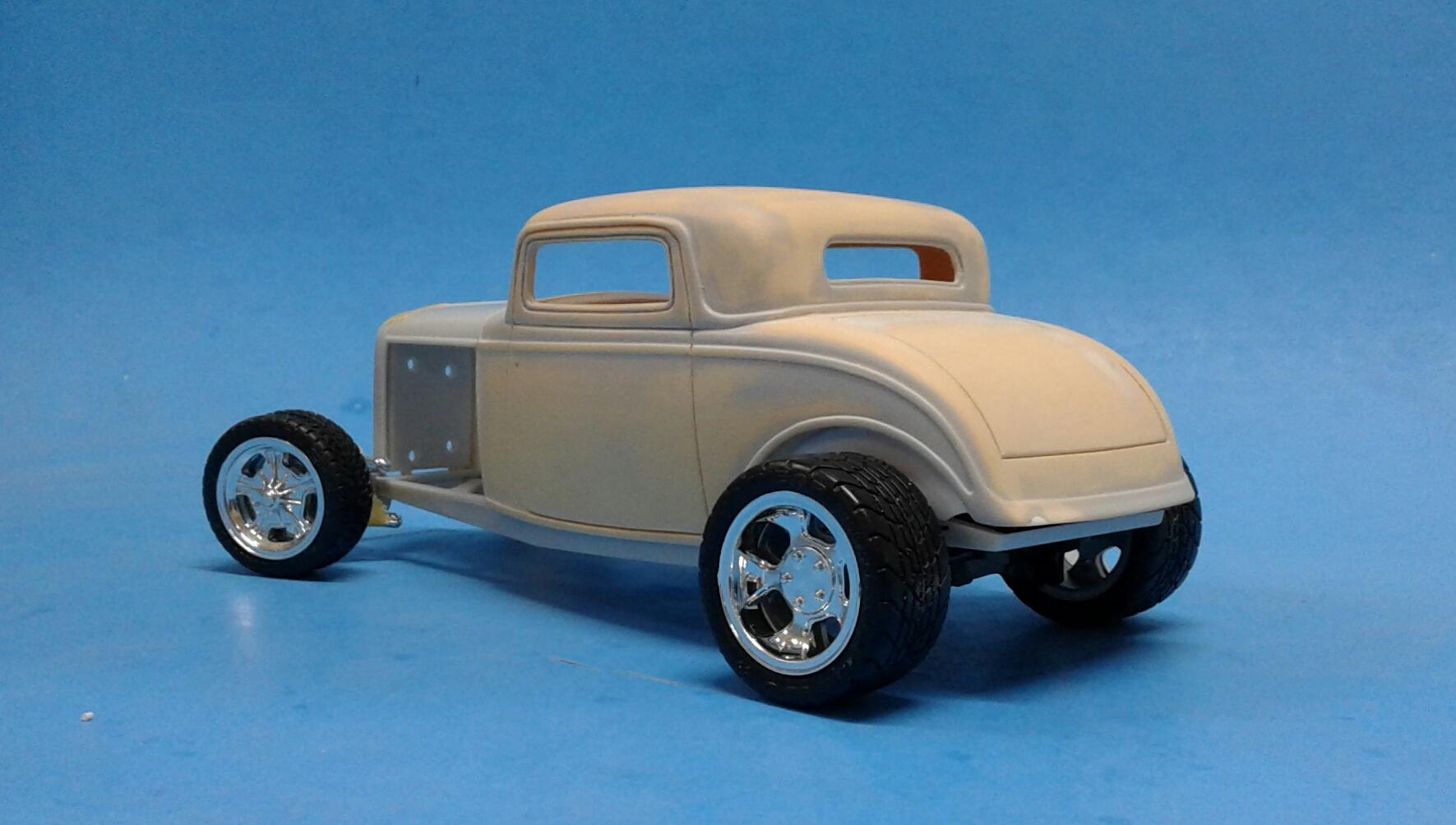

I'm going to try to notch it at the top, push the rails up until the notch is closed and glue it. If that doesn't get it where I want, then I'll give it a Z section.
The frame hangs down a good 6 or 7 mms. A rolled pan that big wouldn't work I don't think.
I think you guys are right. The only thing that's really bugging me as-is is the frame hanging down at the rear. I can can cut it behind the suspension and raise it up so that it tucks under the body. I'm leaning more towards the smooth hood and LS engine idea and I want to see what the TT2'S look like on it.
Since I'm still waiting for some of the paint to come off of my '49 Mercury project, I figured I would work on this project for a minute. I've had this resin body for several years. Don't remember how I ended up with or who the caster is. It's a pretty nice casting whoever did it. I stuck a firewall from the Rat Roaster to it. This model will mostly come from my parts box. The frame, front suspension, grille, hood, tires and wheels are from an AMT Phantom Vickie. The wheels and tires may or may not stay. I also have a set of Pegasus TT2'S in 19 and 23 inch that I may use. Holding up the rear is an IRS from an MPC '84 Corvette. Right now, I'm just kinda spit balling. I have a couple different ideas. One is to go with no hood and the engine from a Rat Roaster. The other is to go with a smooth hood/sides and an LS engine from a '98 Corvette. The color is already nailed down. It will be Tamiya Bright Red over Mica Silver. Looking at it now, I'm thinking the body needs to go over the frame. It'll help cover the frame on the sides (since they're missing the reveal) and rear. Plus, it'll lower it down and place the rear wheels a little better. However, I don't look forward to having to section the interior.

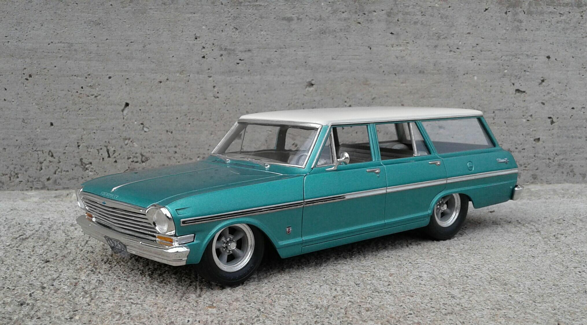

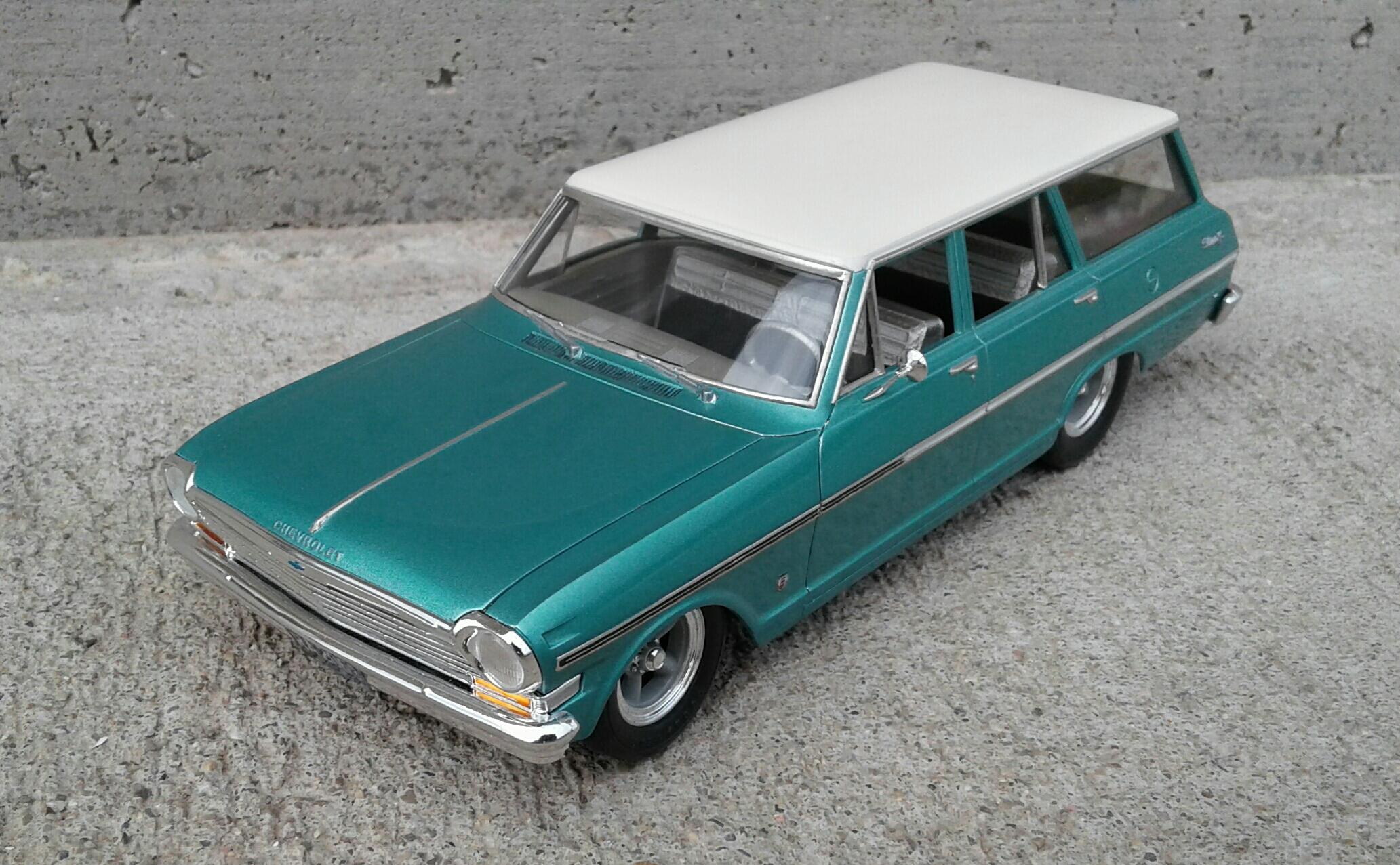

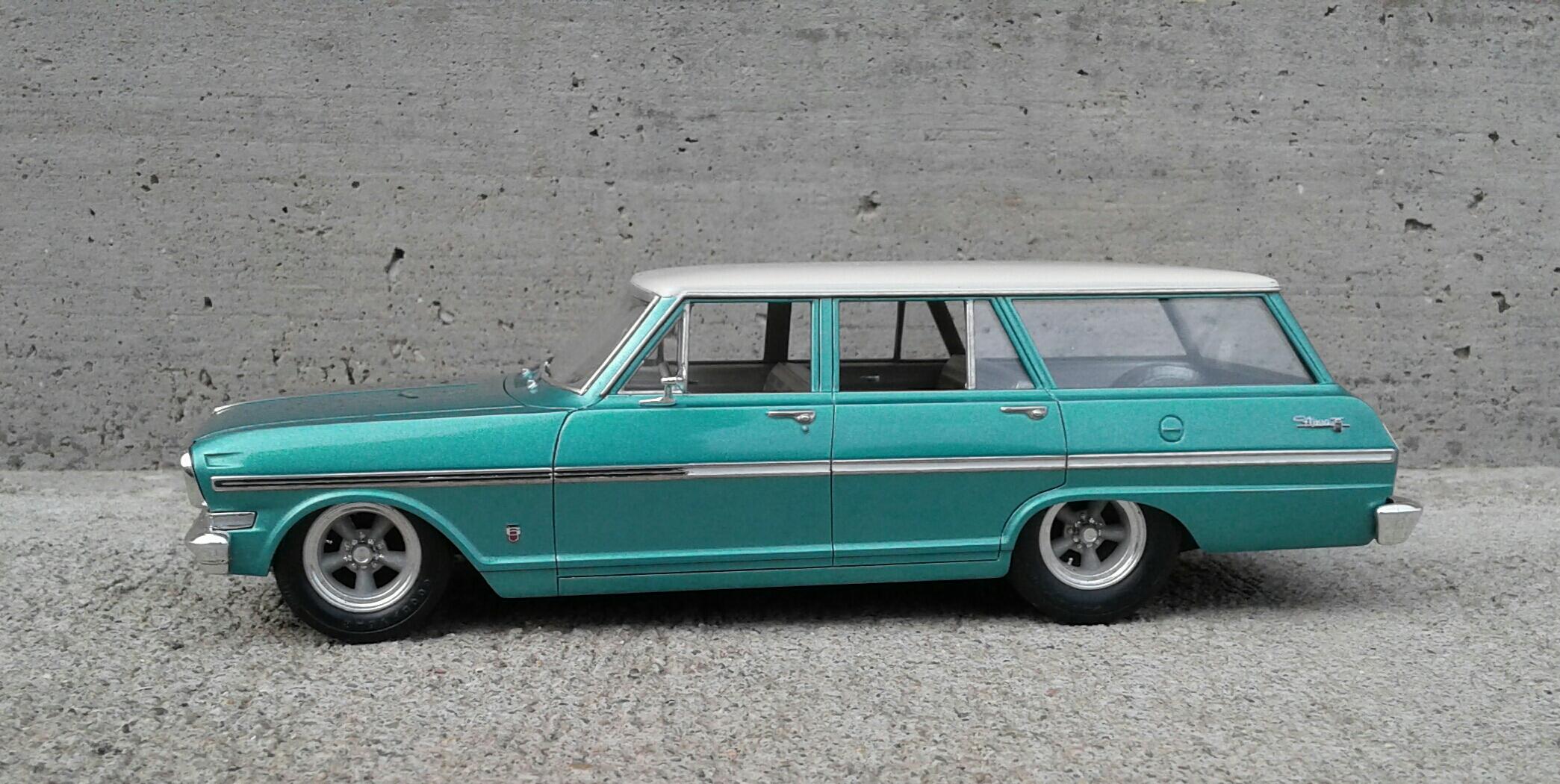

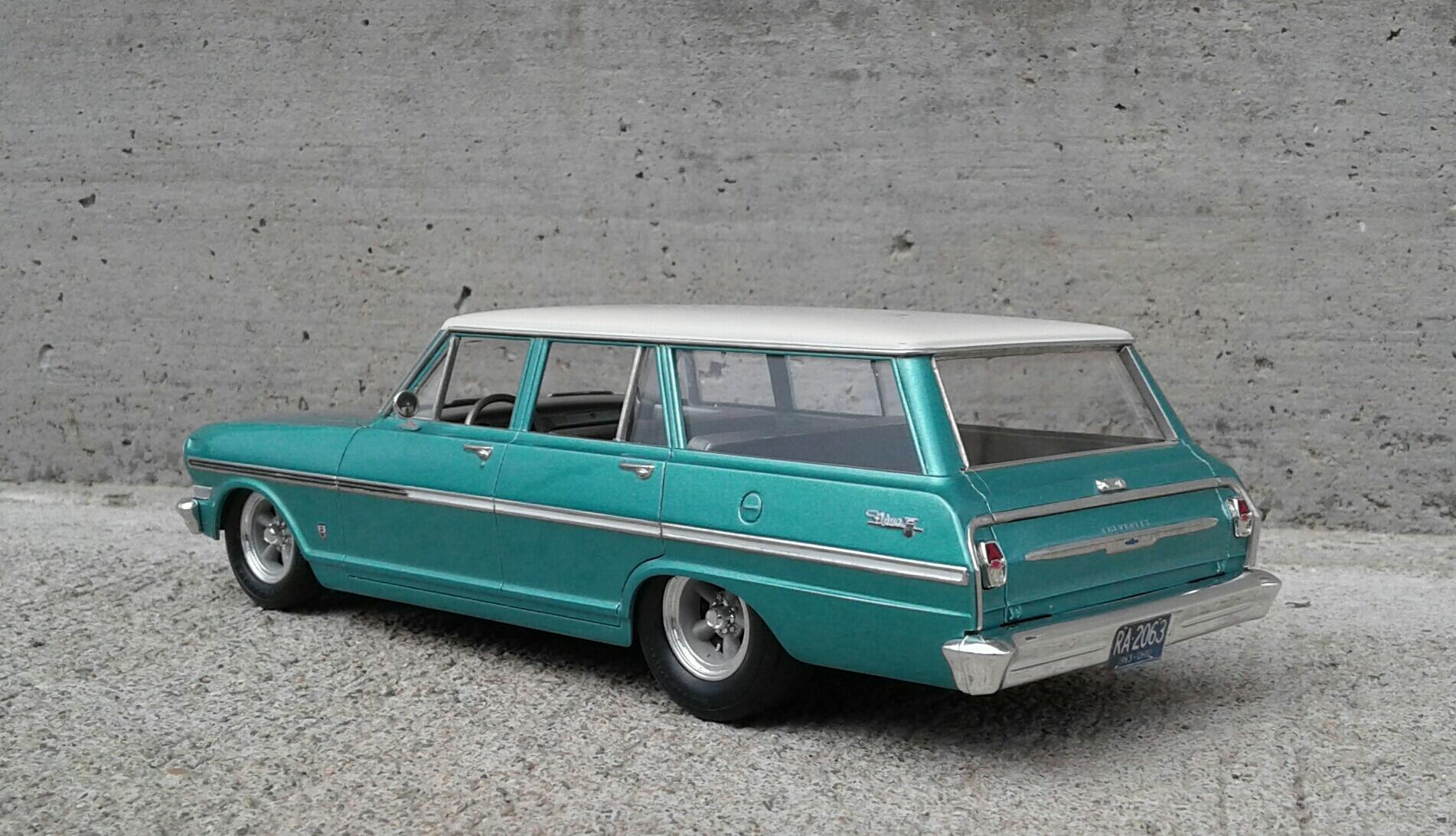

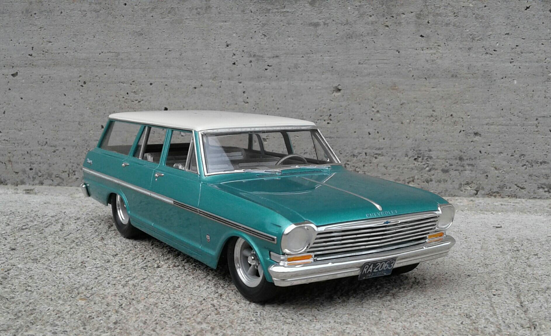

Just finished this one up. It's the newly issued kit from AMT/Round2. I didn’t do much extras on it. I got rid of the rocker trim and rounded them at the bottom to make them a little more accurate. I also rounded off the bottom of the rear quarters. I added the missing panel lines between the cowl and fenders and deepened the rest. I opened the grille. Paint is Model Masters Artesian Turquoise with a Tamiya Racing White roof. Interior is Tamiya Champagne Gold and flat black. Wheels and tires are from a Revell '32 Ford. Thanx for checking it out!
