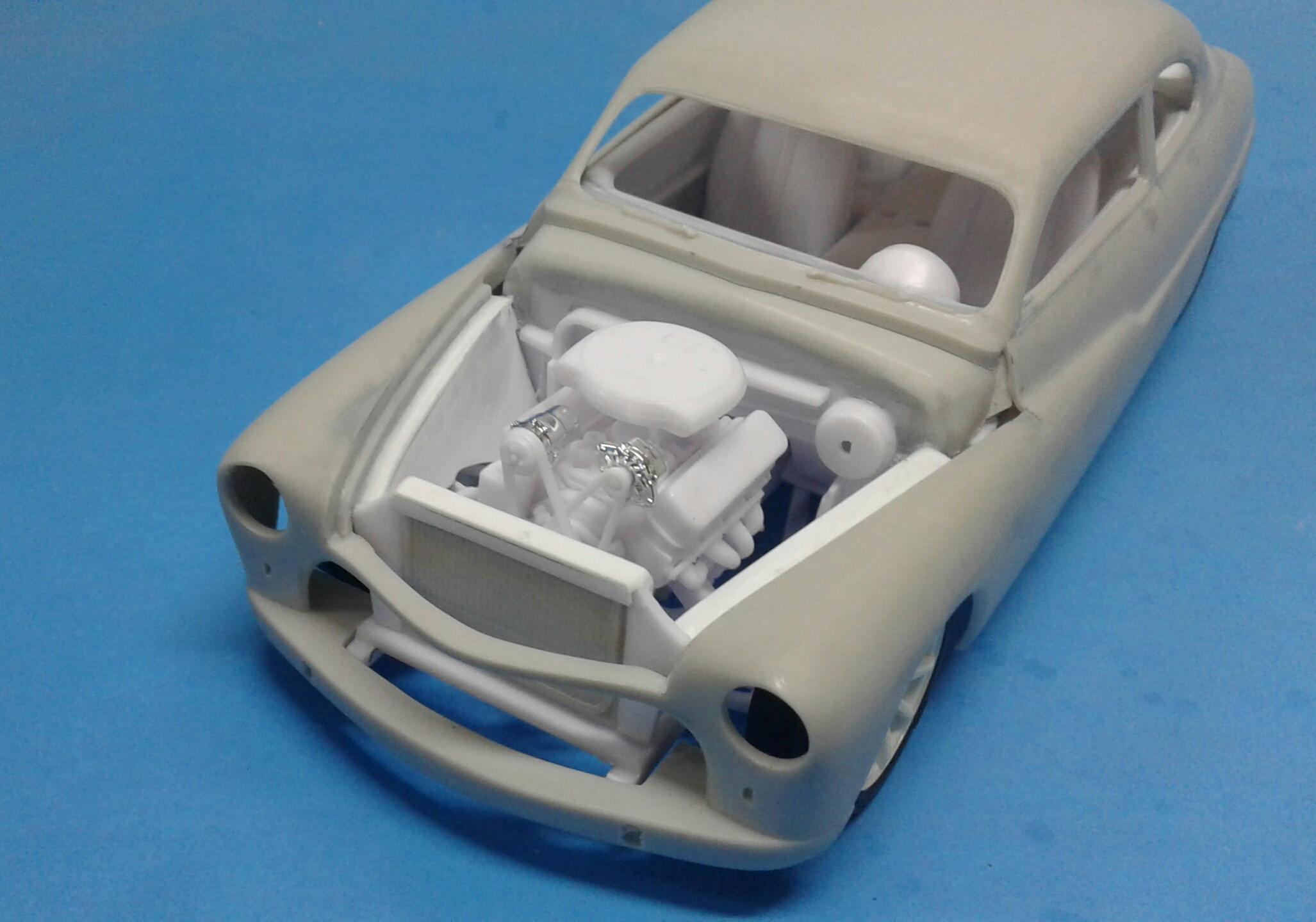

Thanx guys! Before I got too carried away, I figured that I better check all of the clearances on the engine. So, I installed everything with Elmer's glue and set it back in the frame. That thing really fills up the engine bay! Everything was good except for the alternator. I twisted it over and got the clearance. But, I don't like how it looks and it will be a PIA to make brackets for it. I'm either going to have to rework this setup or find a different belt and pulley setup. I may just lower the engine a little. I have plenty of clearance at the front. One thing that is bugging me about this model more and more is the relation of the wheels to the wheel openings. When I did the section on the body, the wheel openings got raised the same amount. I think that was a mistake. The wheels aren't tucked up like I would like them to be. Even though it sets fairly low, it doesn’t look low. I think I'll lower the wheel openings a couple of mms and see if that helps. If I don't like it, I can simply cut them back out. But, I think it will visually lower it without actually lowering it. We'll see.

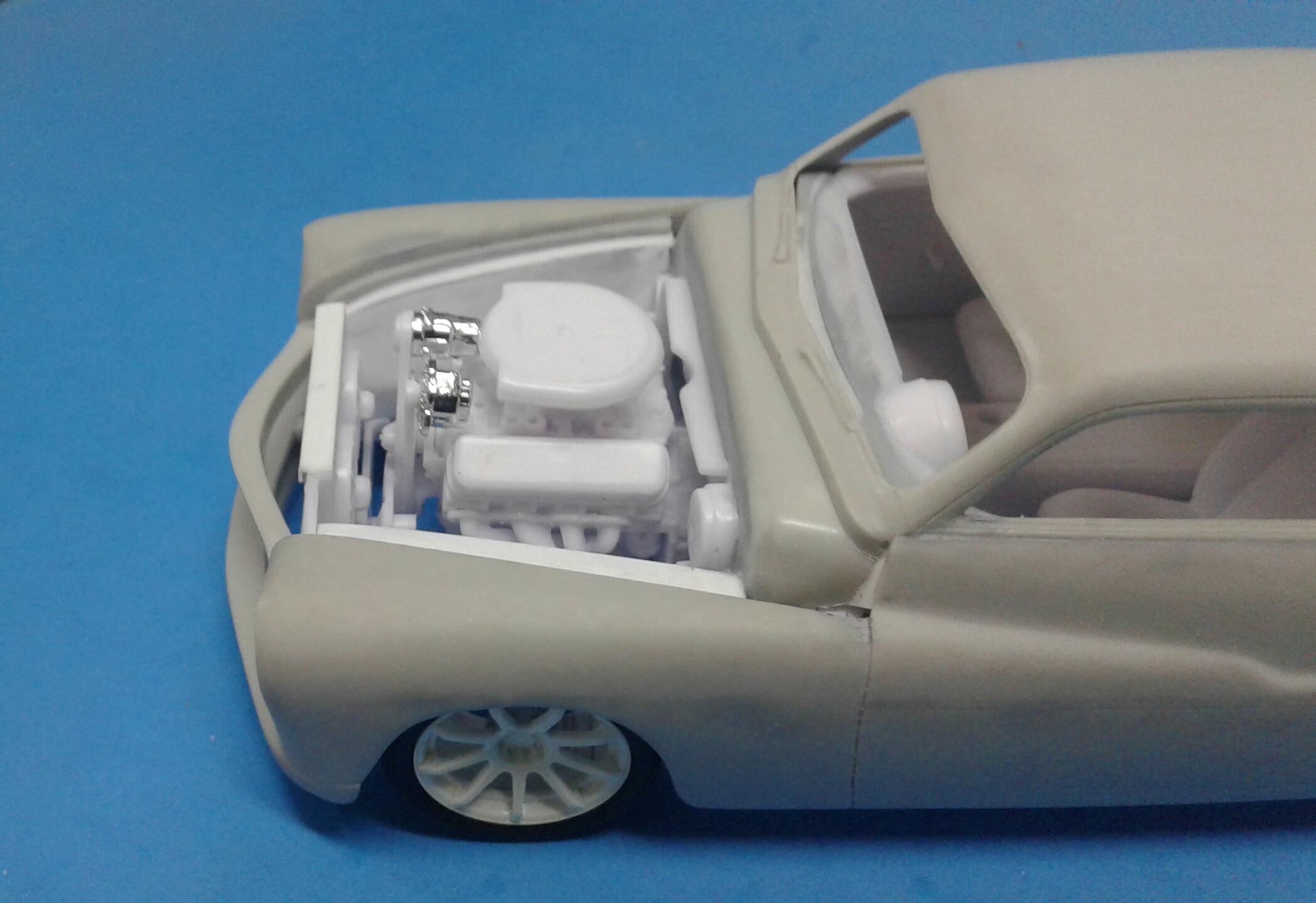

Thanx for the feedback guys! Right now, I'm leaning more towards leaving the bumper guards. I lowered the front bumper down by simply drilling new locating holes in the splash pan. Now, the guards aren't as intrusive as before and the bumper hides the splash pan at the bottom. I want to see it in paint before I decide to omit the guards. The grille is all wonky in this photo. Here's a better photo with the grille placed better. As you can see, the grille is now opened. This took a good while to accomplish! Around five minutes per slot and there's 46 or 48 of them! The radiator and support are from the Caddy. I had to add the radiator detail to the front using the one from the Mercury. The floor pan and frame are completely fitted. I'm real happy with how they now fit. It just falls together! Dash is fitted and inner fenderwells added. I still need to add some strengthening ribs to them. I added the firewall detail from the Caddy. I'm going to whittle down that huge flange. Engine is finally fitted. Still have to check for headers clearance. I figured there would be an issue with the breather. But, no problem! I may still lower it down a bit as it looks too high IMO. The package tray is now added to the interior. The interior is now completely fitted and ready for primer. I still have to make the hinges for the trunk and get a final fitment on it. I got enough of the rearend put together so that I can see exactly how the stance is going to be. I like it! It has just a touch of rake. Almost unnoticeable. The frame barely peeks below the rockers. I wish it didn’t show at all. But, I can live with it. I should have the hard stuff done. I'm ready for the fun stuff!

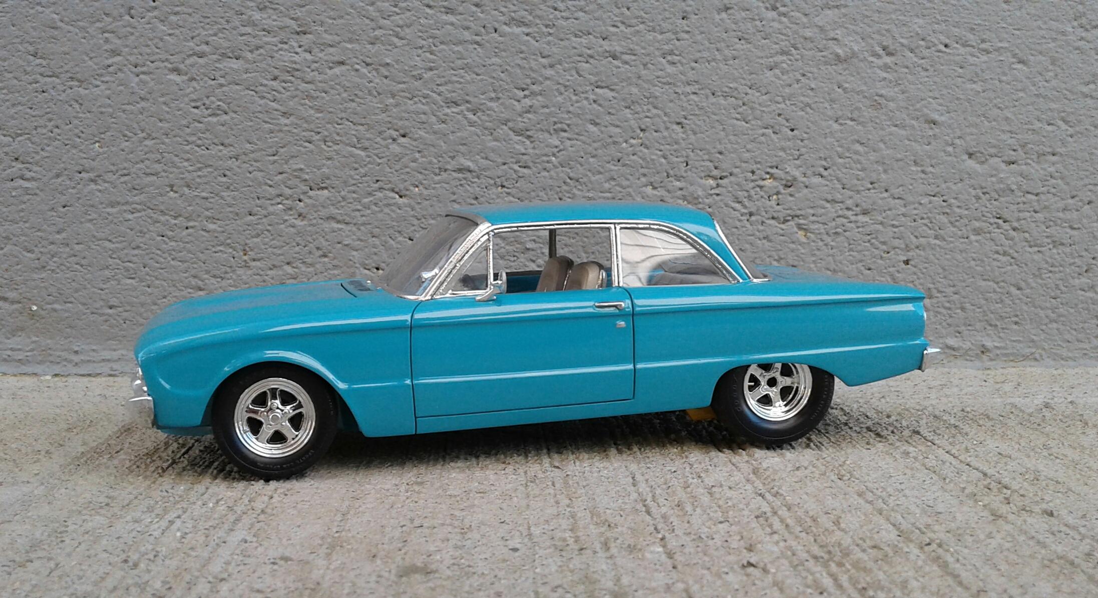

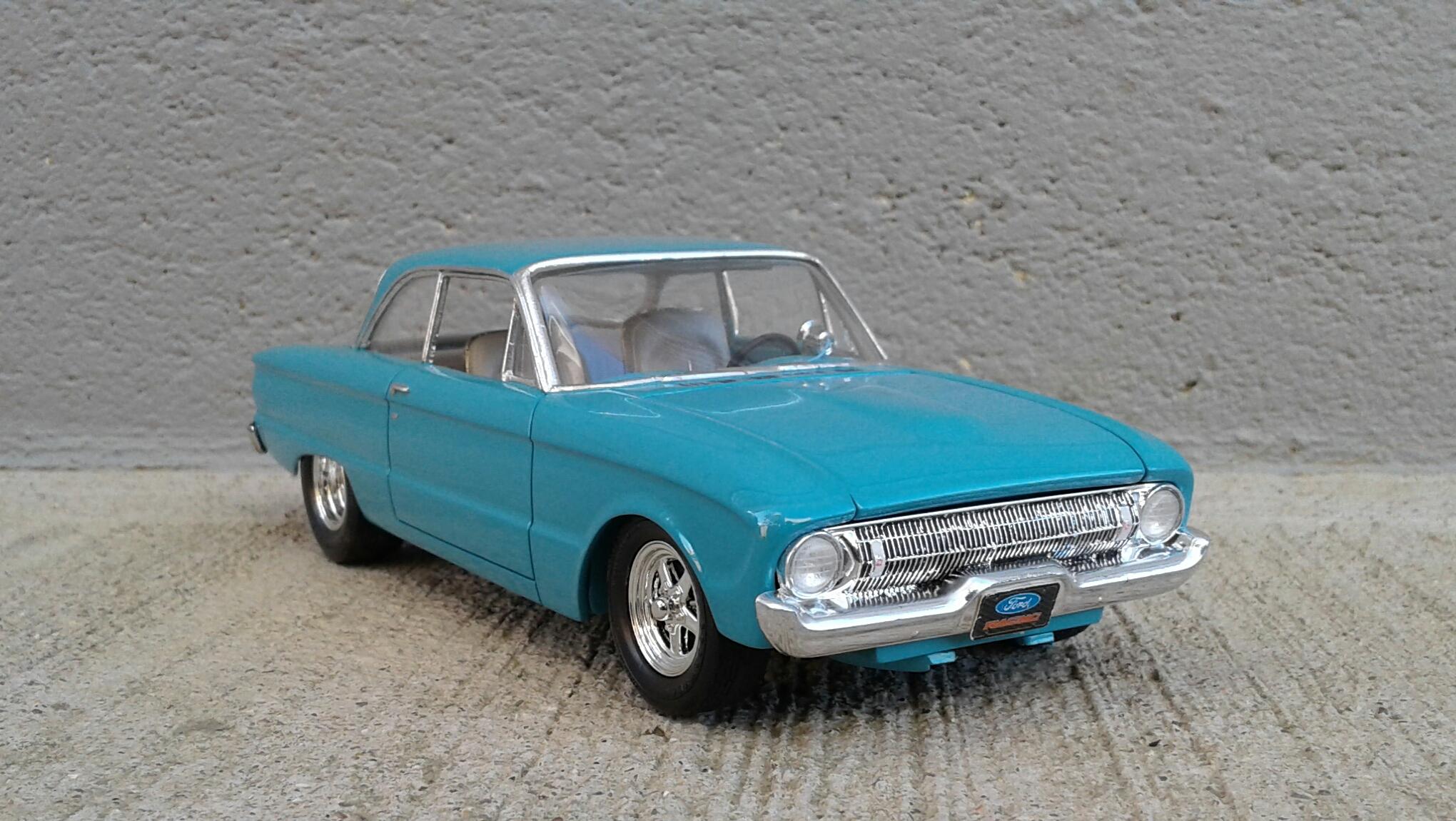

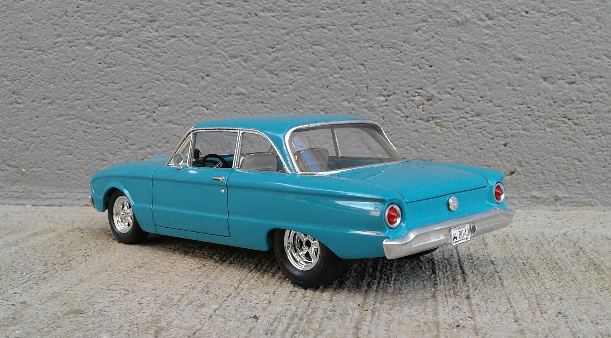

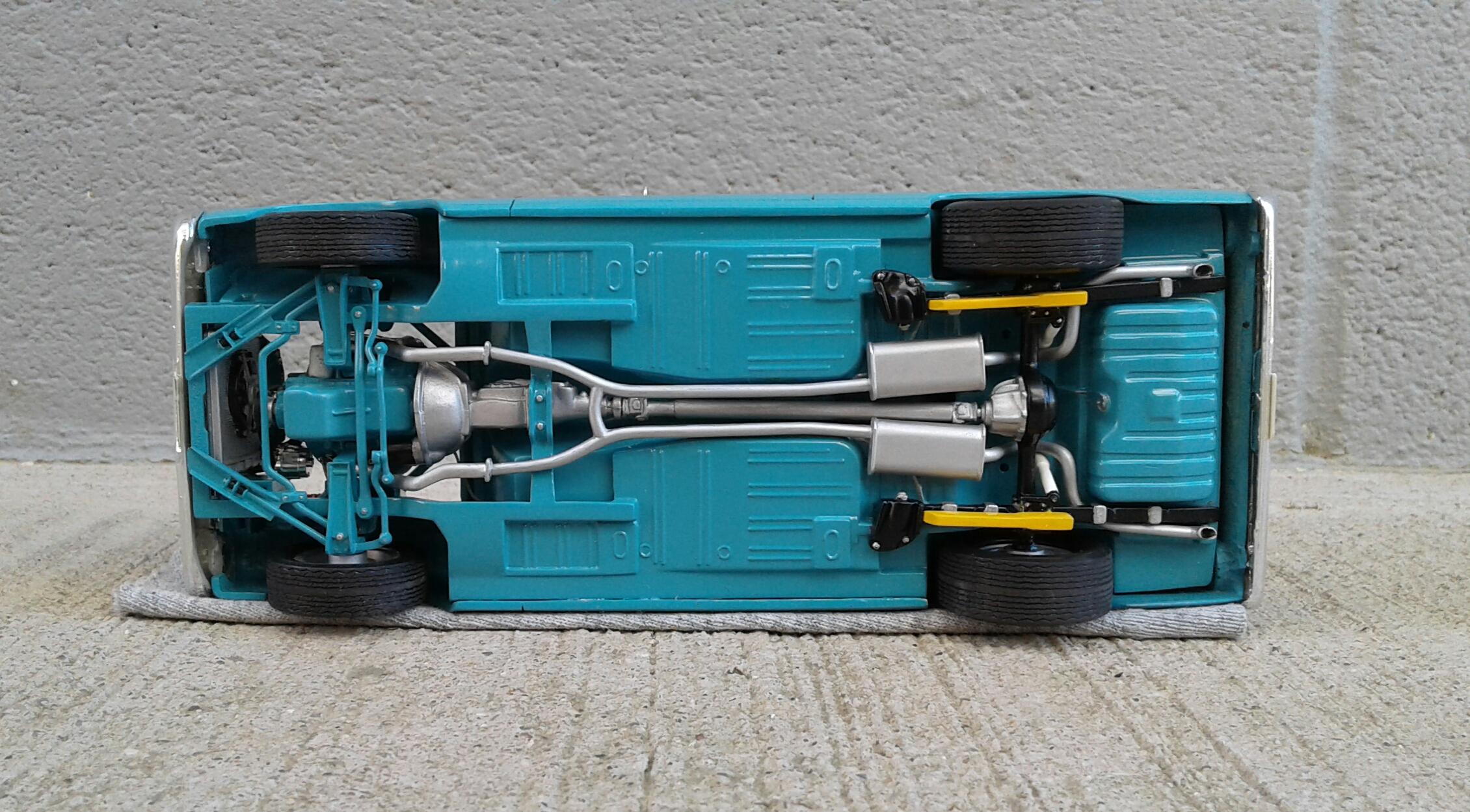

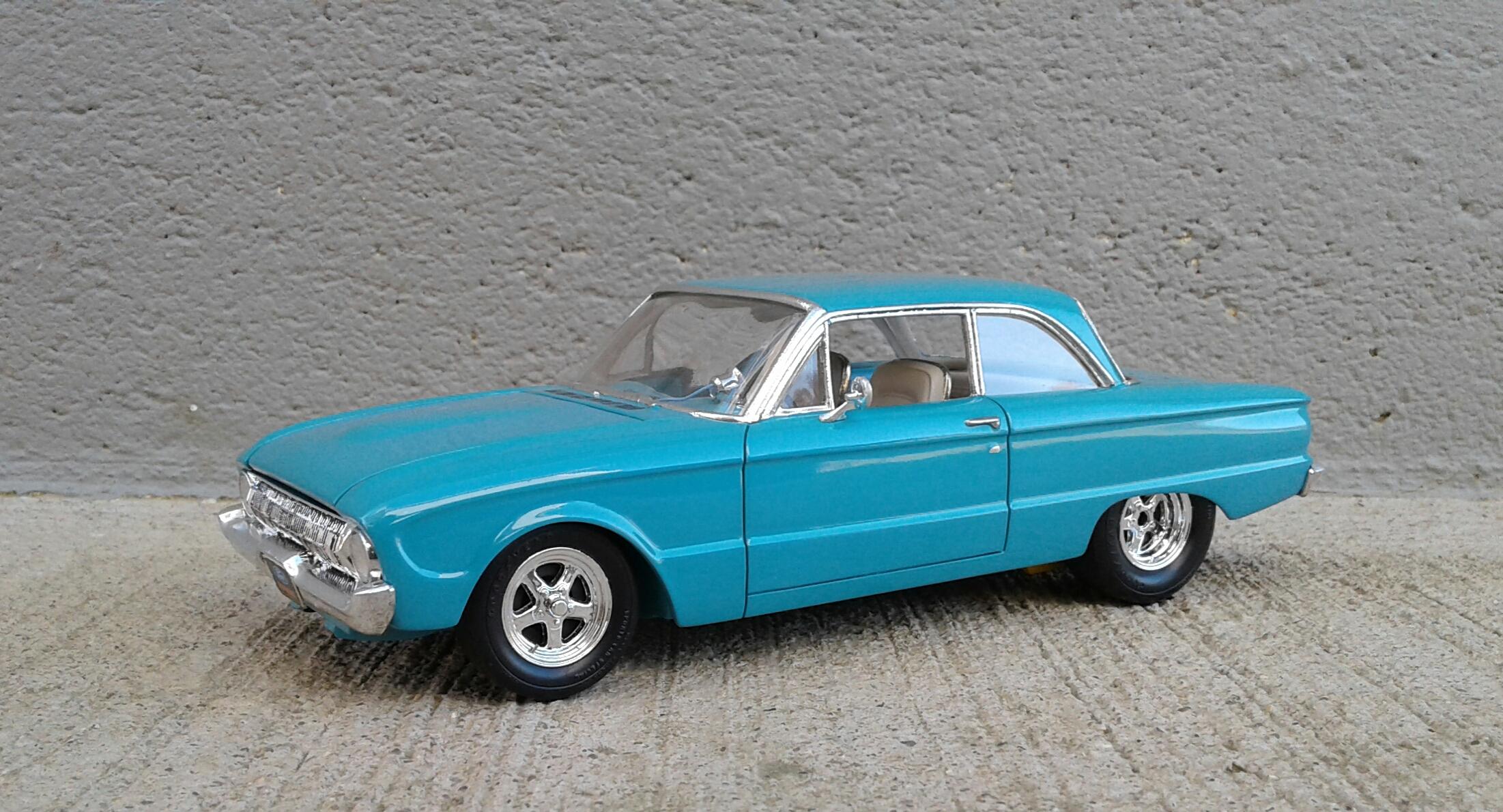

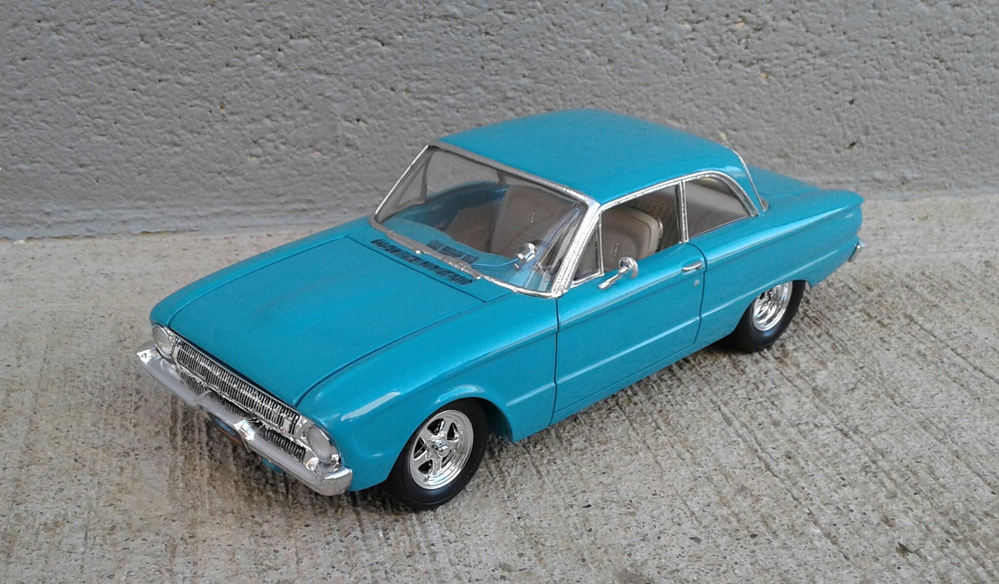

The recent "Post Your Falcons" thread reminded me that I didn't have any current photos of this old build. It started as a poor resin body and interior that I got on ebay. The body and interior were full of pinholes and voids. Tons of filling and sanding! I bashed it with a Monogram '66 Mustang. It donated the chassis, engine/transmission, core support and bucket seats. The rearend is from a T-Bolt. Wheels from an AMT '57 Corvette. Paint is Testors Boyd's Pacific Blue. Thanx for checking it out!
