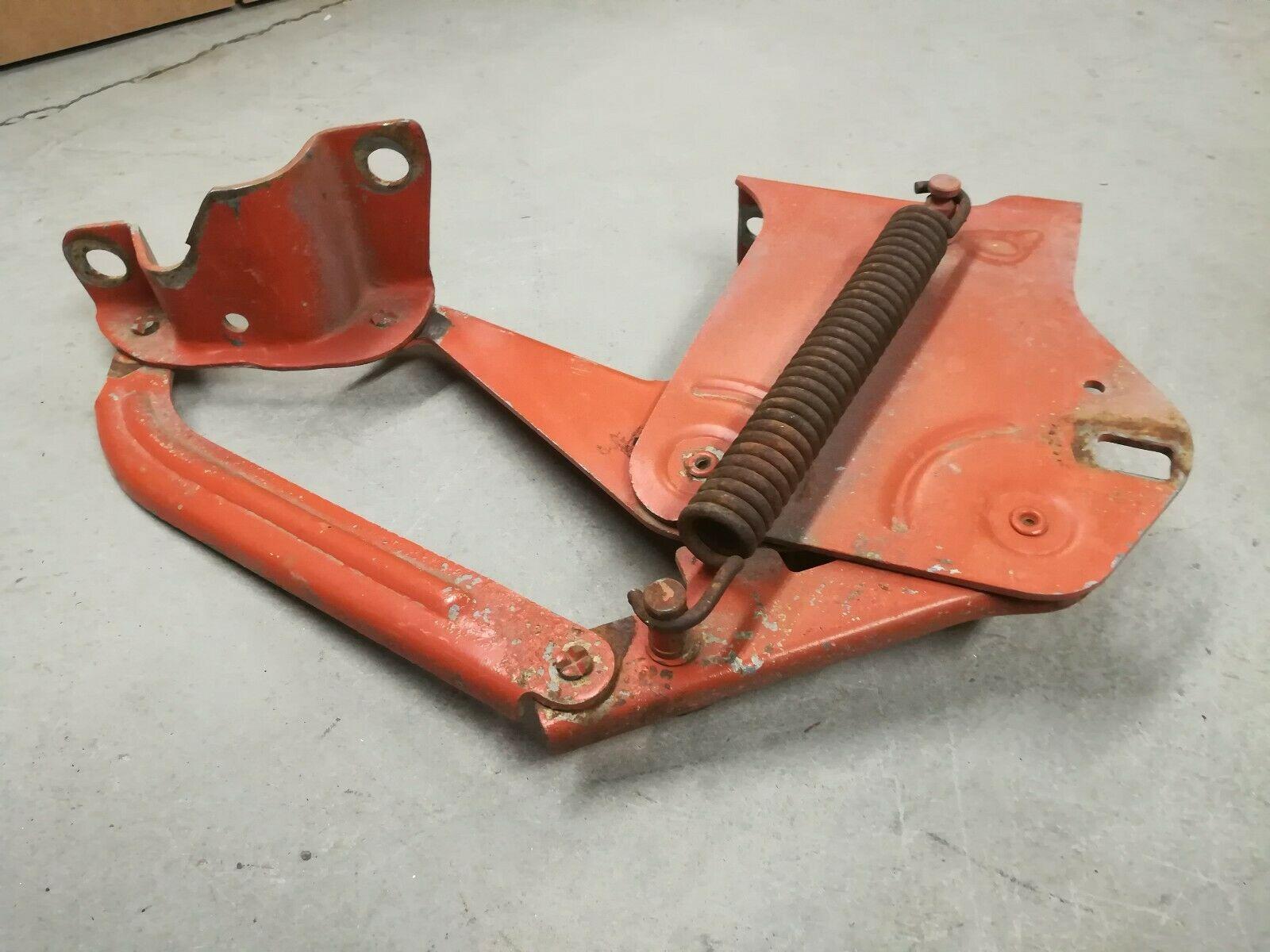

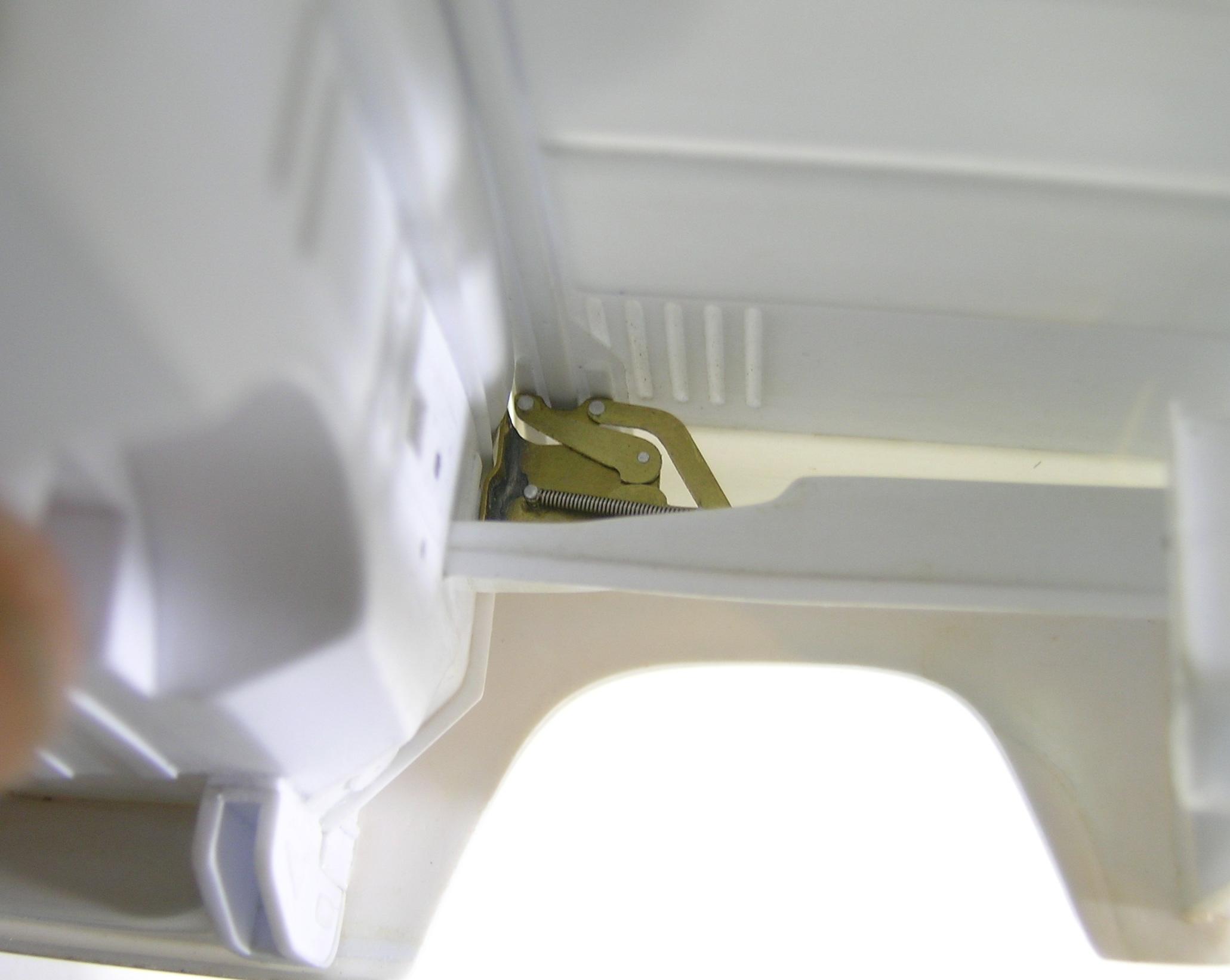

Hi Tim, and thanks for the kind words, but I'm a little taller than three inches but a little under 6 feet, that gives you an idea of how tall I am...LOL. As for the material used for the hinges, I was forced to take a little thicker than desired in order to have sufficient rigidity so that it does not deform when unfolding (or retracting). I used 0.010" thick brass instead of the thinnest one I have (0.005") which would have been more to scale but way too fragile for functional parts. Everything was done by hand, I traced the shapes onto the brass, cut and filed by hand, making the two similar pieces together to make sure they were as identical as possible. I drilled the holes first on the milling and used aluminum pins to keep the parts together during the fabrication. I don't have a CNC and don't intend to invest in this kind of upgrade, I think good hands (and fertile imagination) will always be needed to overcome this kind of situation, it's actually tinkering and the good old methods will always be the basis of this hobby... I hope! Please feel free to send me a PM if you need more information, I am always happy to help when I can... Francis -
