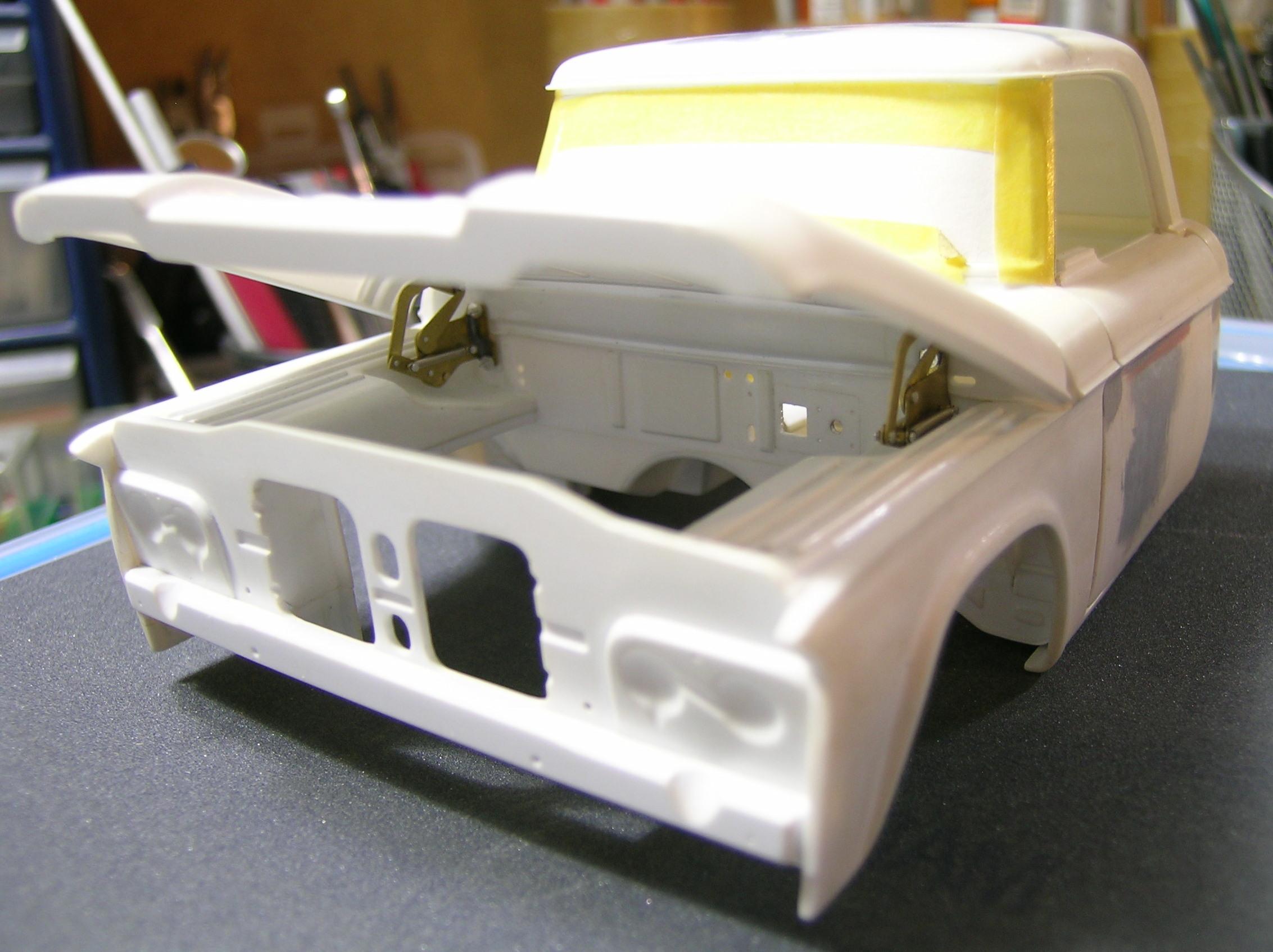

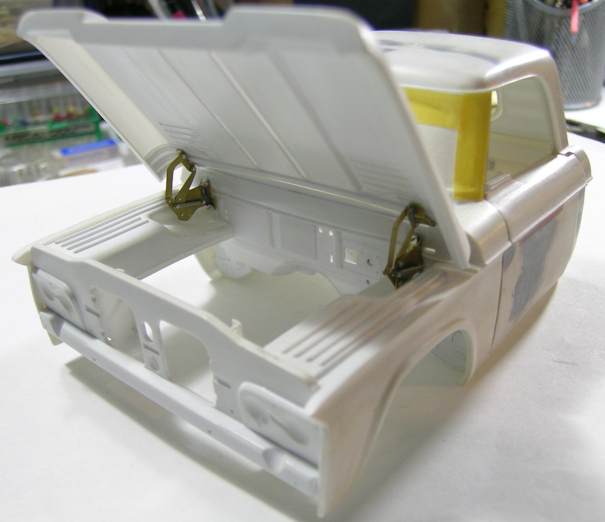

  3. Thanks Claude! I'm quite proud of the result but don't worry, the little springs have just the right amount of resistance and the hood is raised or lowered with just the tip of my finger. I could even have shortened the springs of a coil and it would still have worked. I myself am surprised (and so happy) to see that it works so well! ? Francis

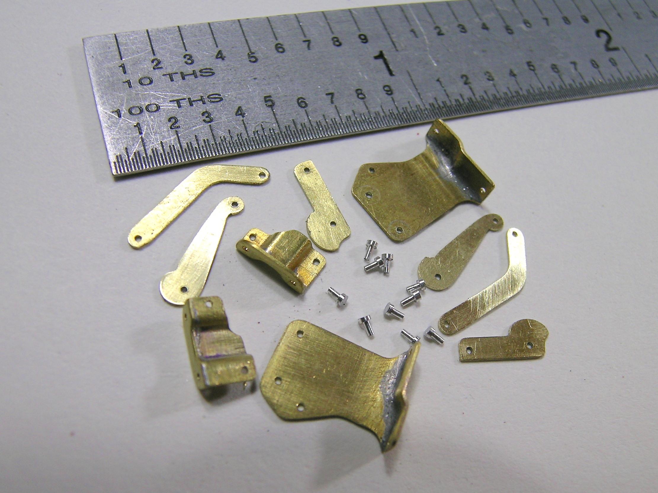

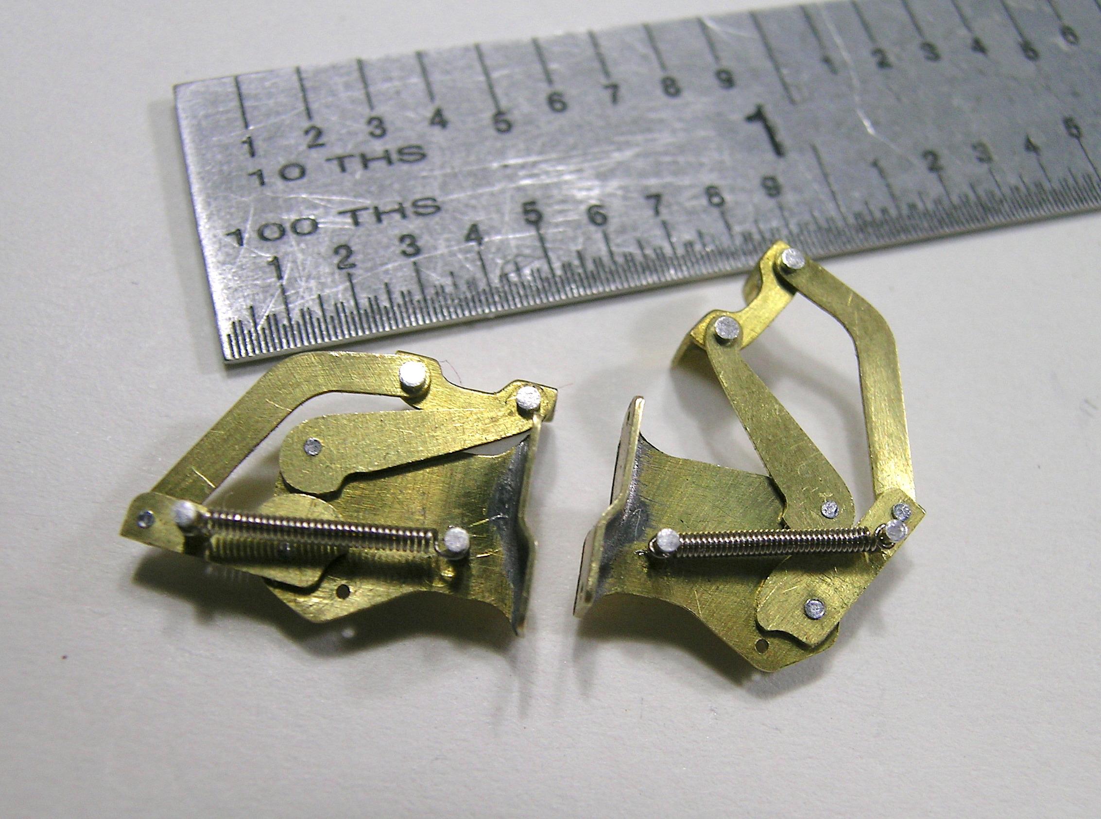

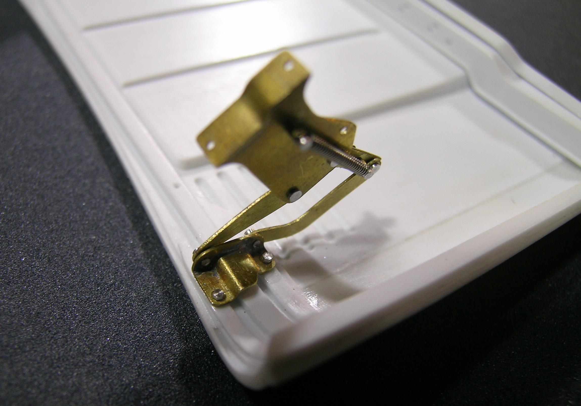

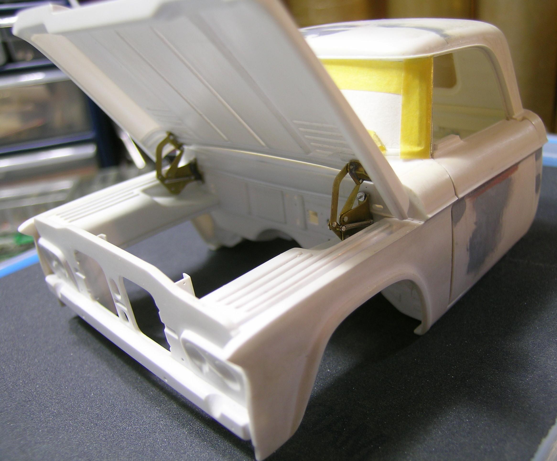

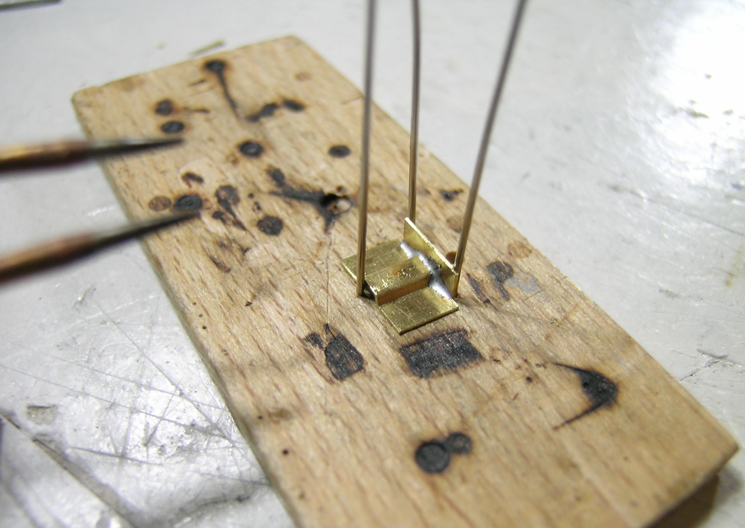

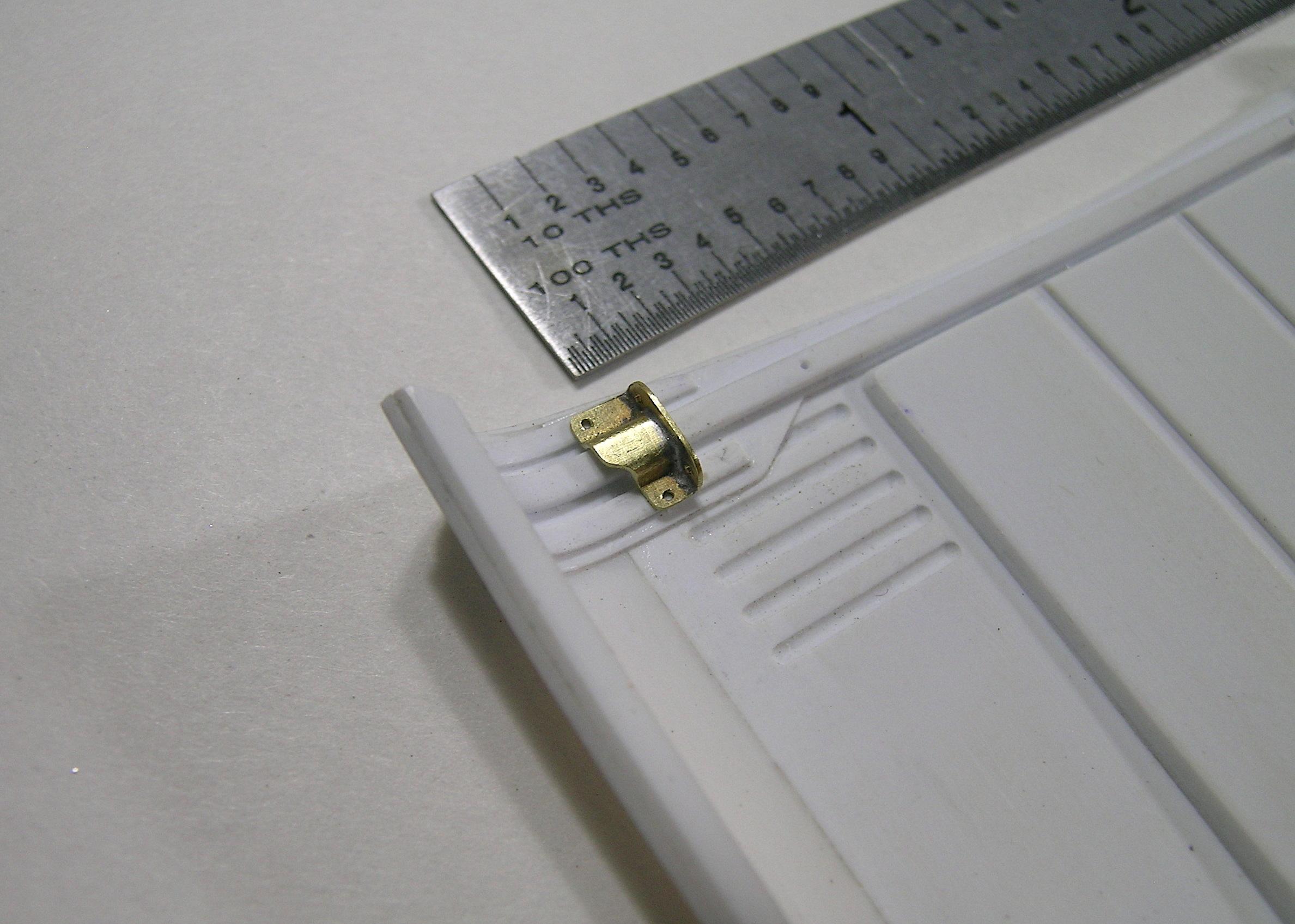

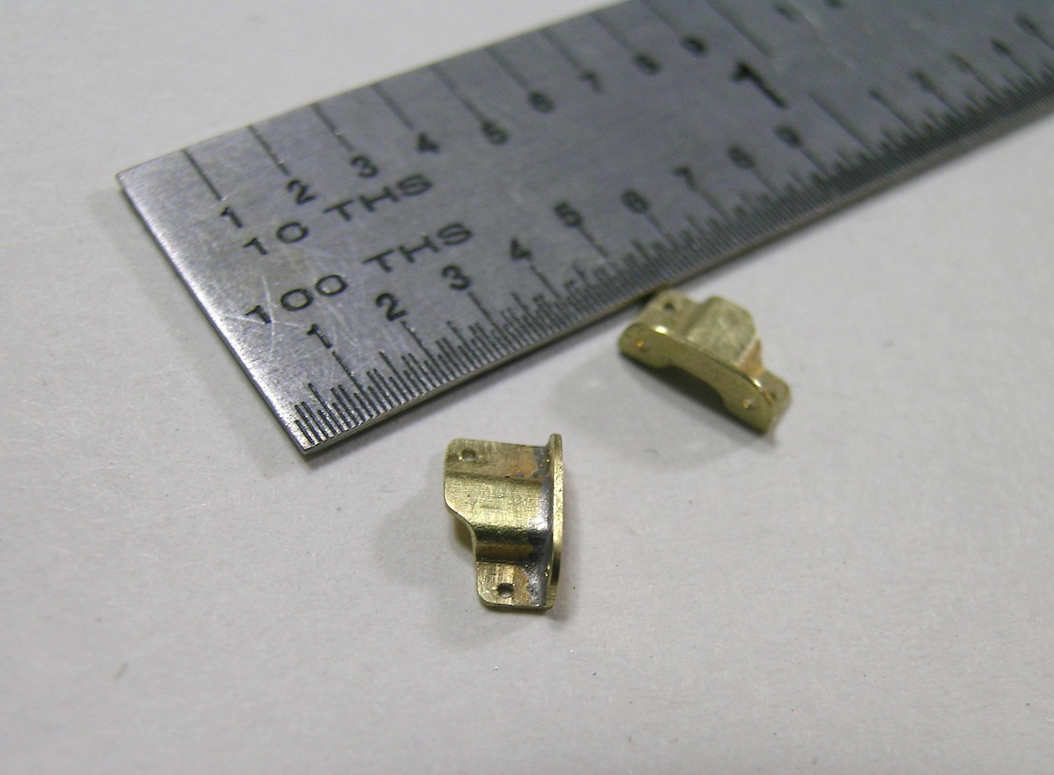

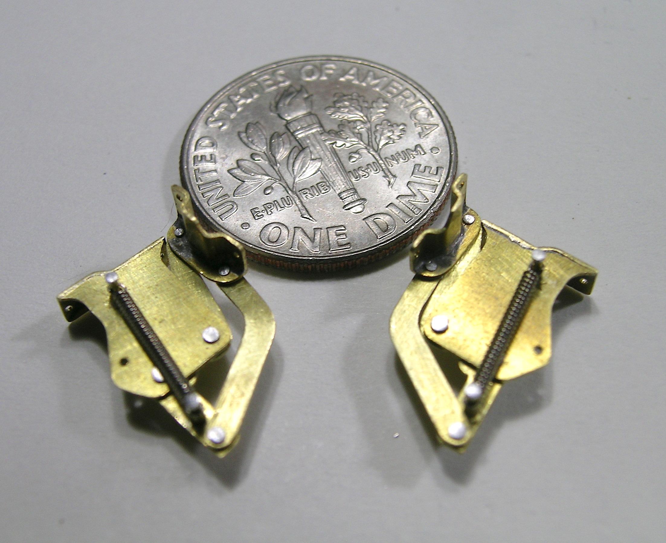

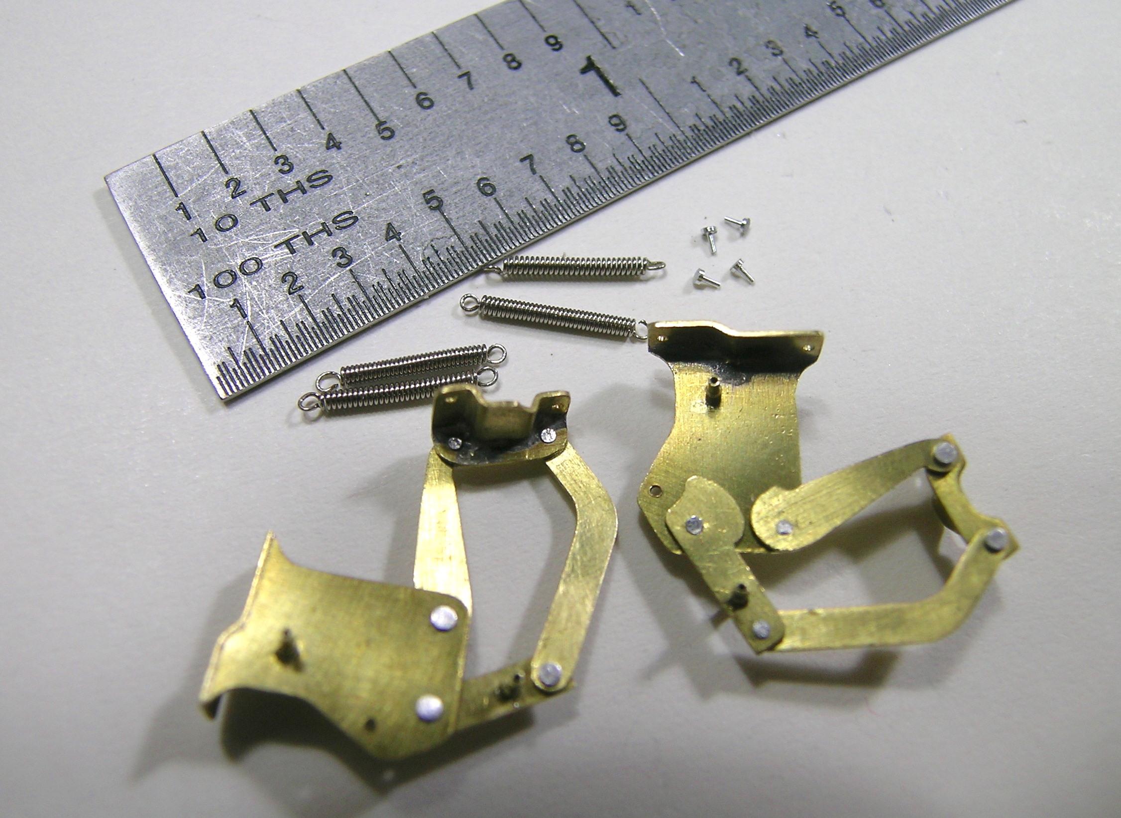

  6. Hello everyone, Today's update is an important one for rather small parts... It's been a long time since the idea of making functional hood hinges has been in my head and after having collected several photos from different angles of the real parts I decided to embark on the adventure. I must admit that the work on this point by some talented modelers has forced my hand a bit but I am very happy to have taken the leap and I hope you will like the result, in any case, I am good happy with the final product. I had already made holes in the engine compartment at the start of construction to receive a static or decorative hinge shape so I used this as a starting point. Lots of photos are uploaded but feel free to ask if you have any questions. Comments are welcome as usual! Take care, Francis First part are the clamp that are "bolted" under the hood. Second part of the clamp which is one piece on the real one but I can't make them in one piece so it's 2 parts welded together. Both side shaped and completed. A quick test under the hood. The other side. The main parts of the hinghes with machined aluminum rivets. Assembled hinghes, the return springs are functional and made using the larger guitar strings. Final parts. Different view. With the bid dime... Glued and "bolted" in place. Different view. Test fit... success! Different view. The hood stays at any position with just the right friction. Hood closed and perfectly aligned. ?
