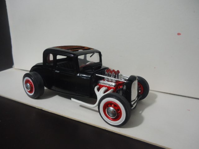

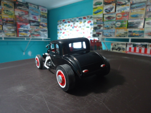

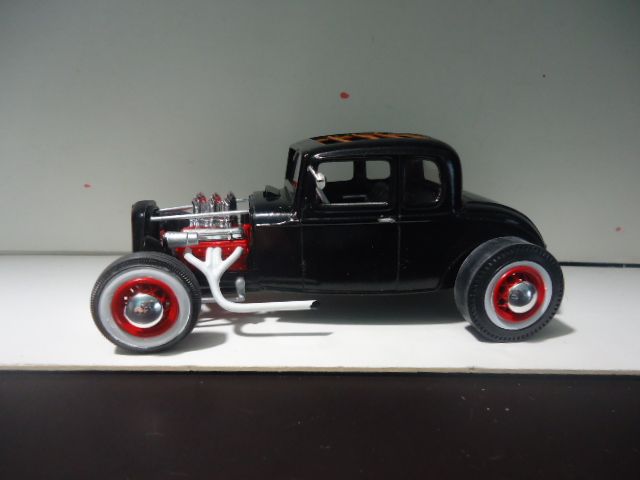

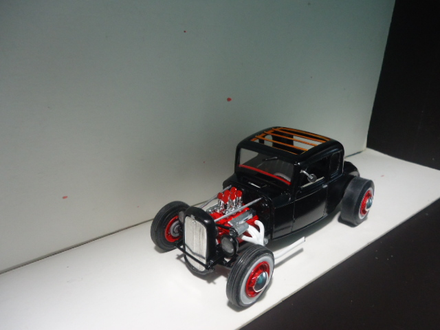

Got this one done but had to make a new interior because the kit interior really didnt have any detail at all , all I used was the seat. Door panels made from Evergreen plastic and P/E handles.Glass was made from clear .007. Rear tires are from the AMT slicks set.Front tires are kit tires painted with Tamiya acrylic flat white. Dropped body and radiator shell down lower, parts box Showrod front axle. Rest of the kit was built right from the box.

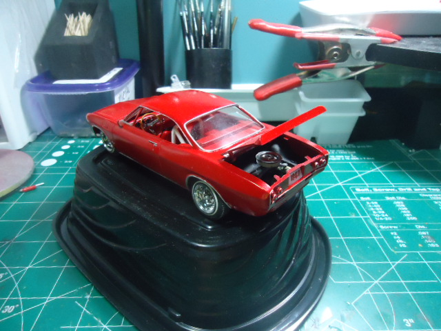

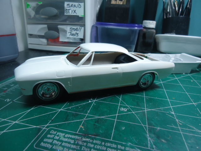

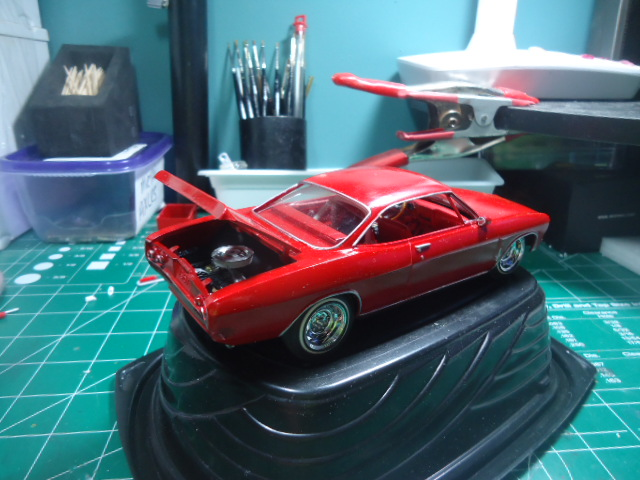

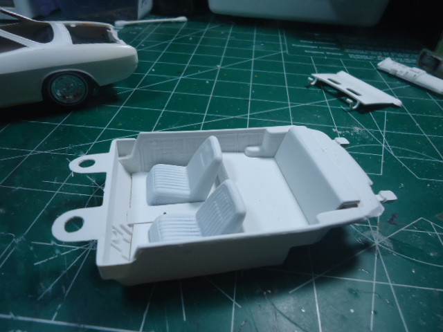

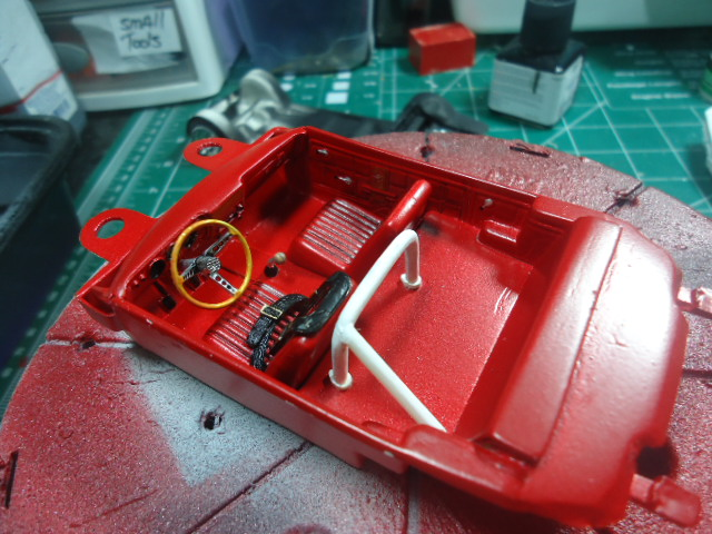

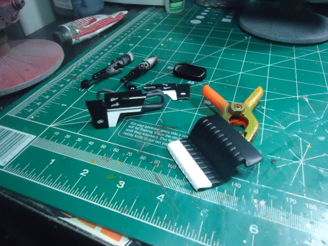

This was an original but partial build kit when I got it. It was painted red and the original builder used fuzzy fur on the seats and floor. He used the seat delete cover on the rear and fuzzied it up also.The body came out perfectly clean with only light residue on the rockers and interior side of the roof. The interior had glue marks so I had to make a new rear seat delete cover and floor with console, original builder used a heavy hand on the glue tube to make that material stick . Making some longer tail lights ,I did not like the custom ones and the stock ones had glue marks.the rest of the kit was unbuilt so no glue spots. I have some nice looking wheel/tire combo Ive been trying to use on something and they are just the perfect size for this car.

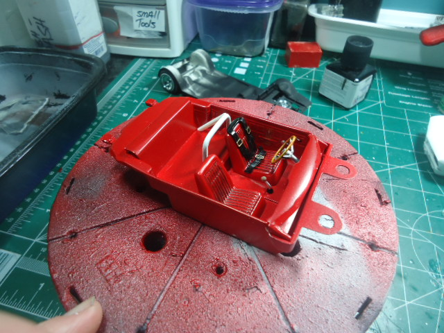

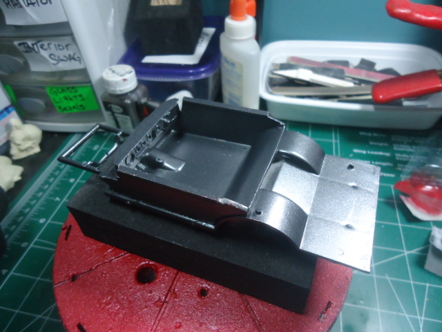

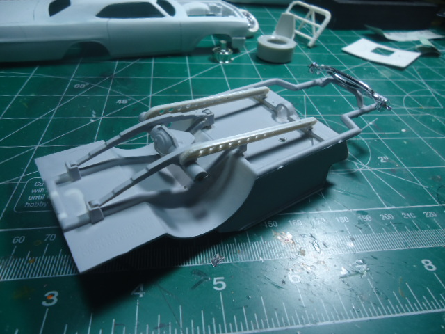

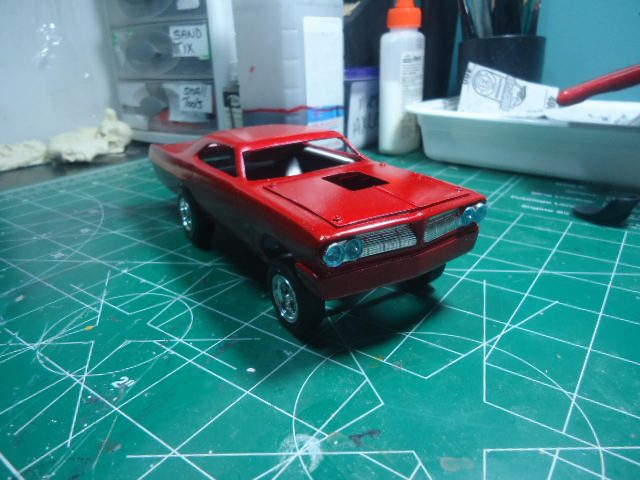

With the chassis almost done I another test fit with tires on, also went with a set of narrower slicks. Hole punched 4 light blue head lights same color as glass will be. Interior is half done, engine is just started, I need to get the engine done before I finish the front axle to make sure the headers have enough clearance

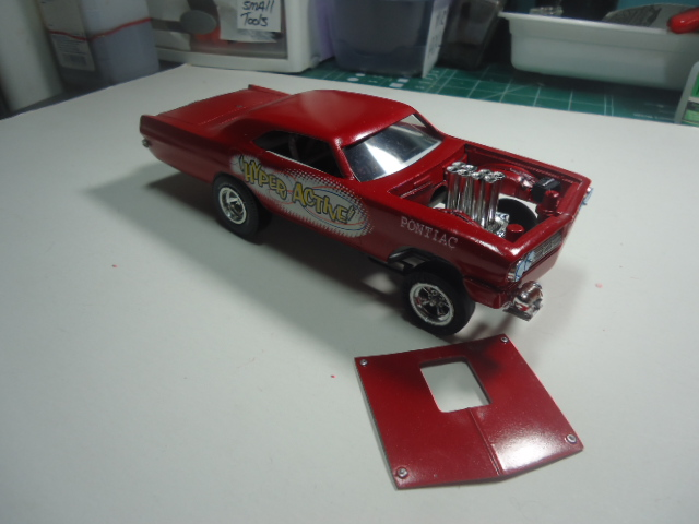

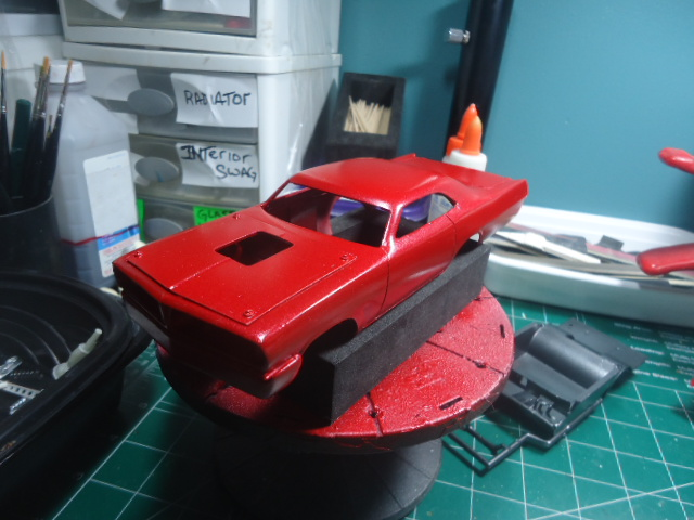

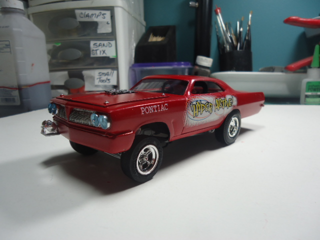

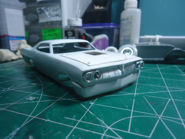

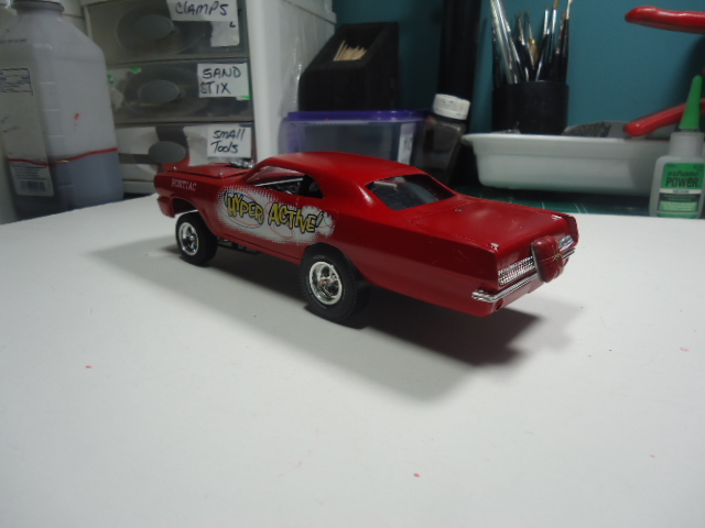

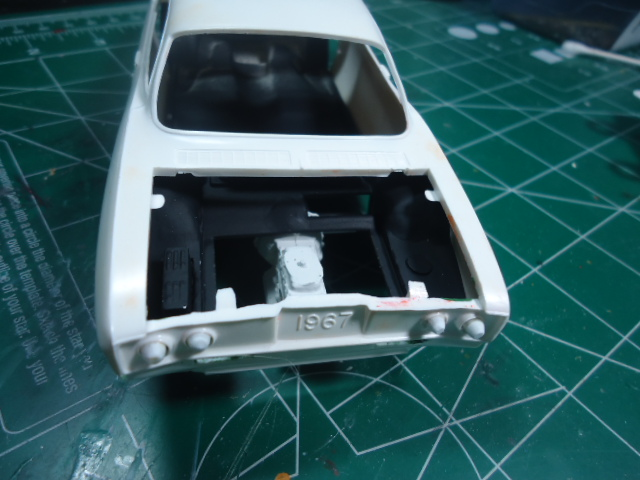

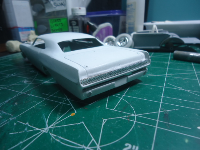

I had a body with the roof cut off and a chassis some custom parts that fit [front and rear chrome from original 63 Tempest AMT kit] I grafted a 69 Firebird roof on and traded with vintagedragcrazy for some various other AWB parts. I got the body where I need it to be , the dash is made from a shortened Nascar dash and I need to make a top for it ,parts box roll bar Engine is what would have came with the kit.
