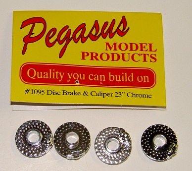

That could work too didn’t think of that -
Foose 65 Chevy impala custom wheels?
Dpate replied to Dpate's topic in Model Building Questions and Answers
Sweet! thank you gentlemen for helping. -

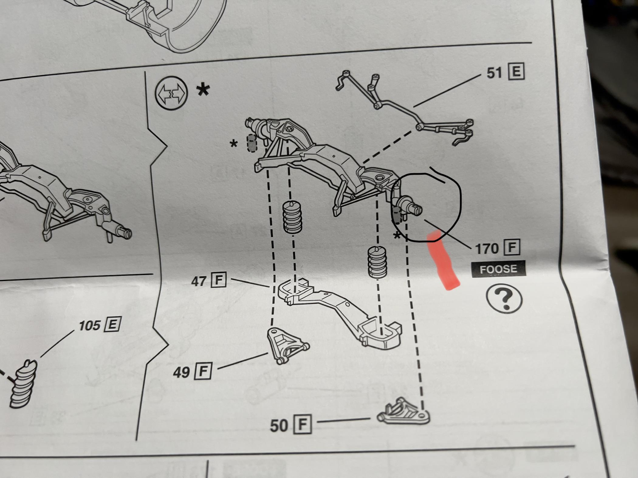

Sounds reasonable, but how would I attach it to this part in the pic? Drill hole same size at the back of the rod or cut off the wheel back attachment part, and just glue it on? -

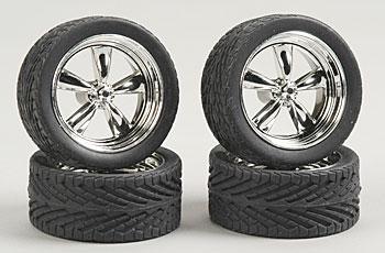

I’ll be doing the Foose 65 Chevy impala for a friend eventually, and she wants aftermarket rims instead of the Foose versions. These are the rims & tires and specs. Not sure how big the rims and tires are that came with the Foose kit as my caliper broke. These Pegasus wheels use the metal bar as an insert and the Foose version isn’t set up for that. So how would I use the custom inner wheel part from the kit with the Pegasus wheels? First time doing something like this. I think the Pegasus set would fit with no clearance issues, just not sure how to install them. Should I get these as well to go with them? The rims are T23’s Inner Diameter: 18mm Outer Diameter: 26mm Width: 11mm
