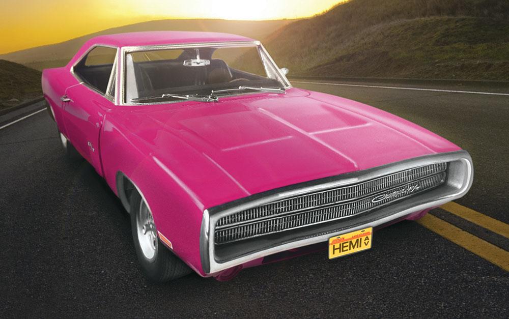

Got this at ollies. WOW it has so many amazing vehicles and nice detailed pictures and information on them. Pretty good for small references, and of course i took a pic of my fav car Looks alot nicer in person - nice glossy pages with over 1000 images.
