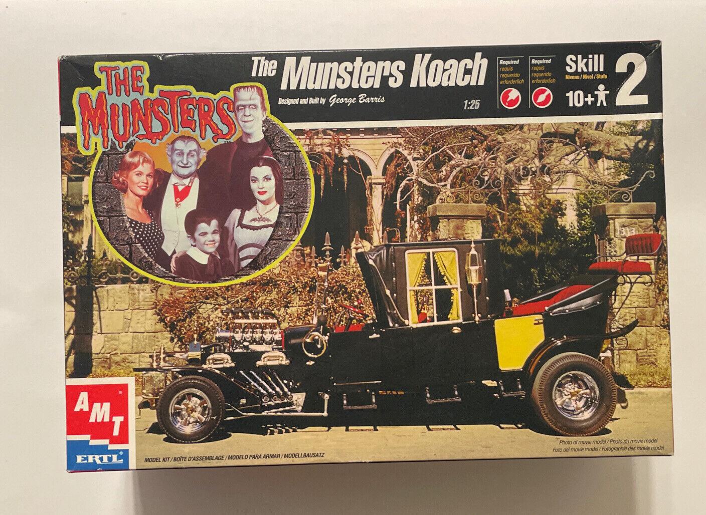

First pic is bat mobile. Got that kit in my stash. -

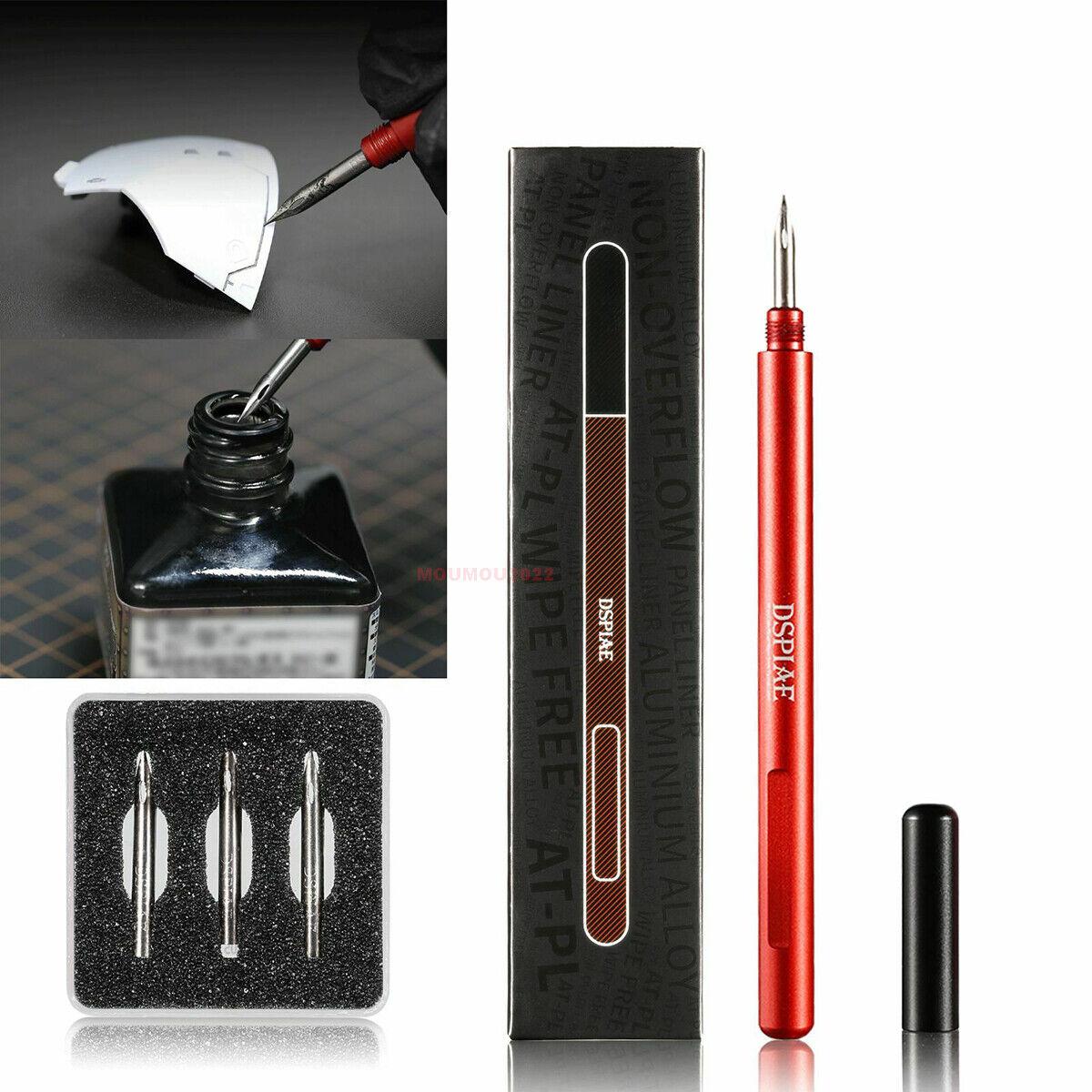

Thanks! Pricey but i may have to get one of these one day.
