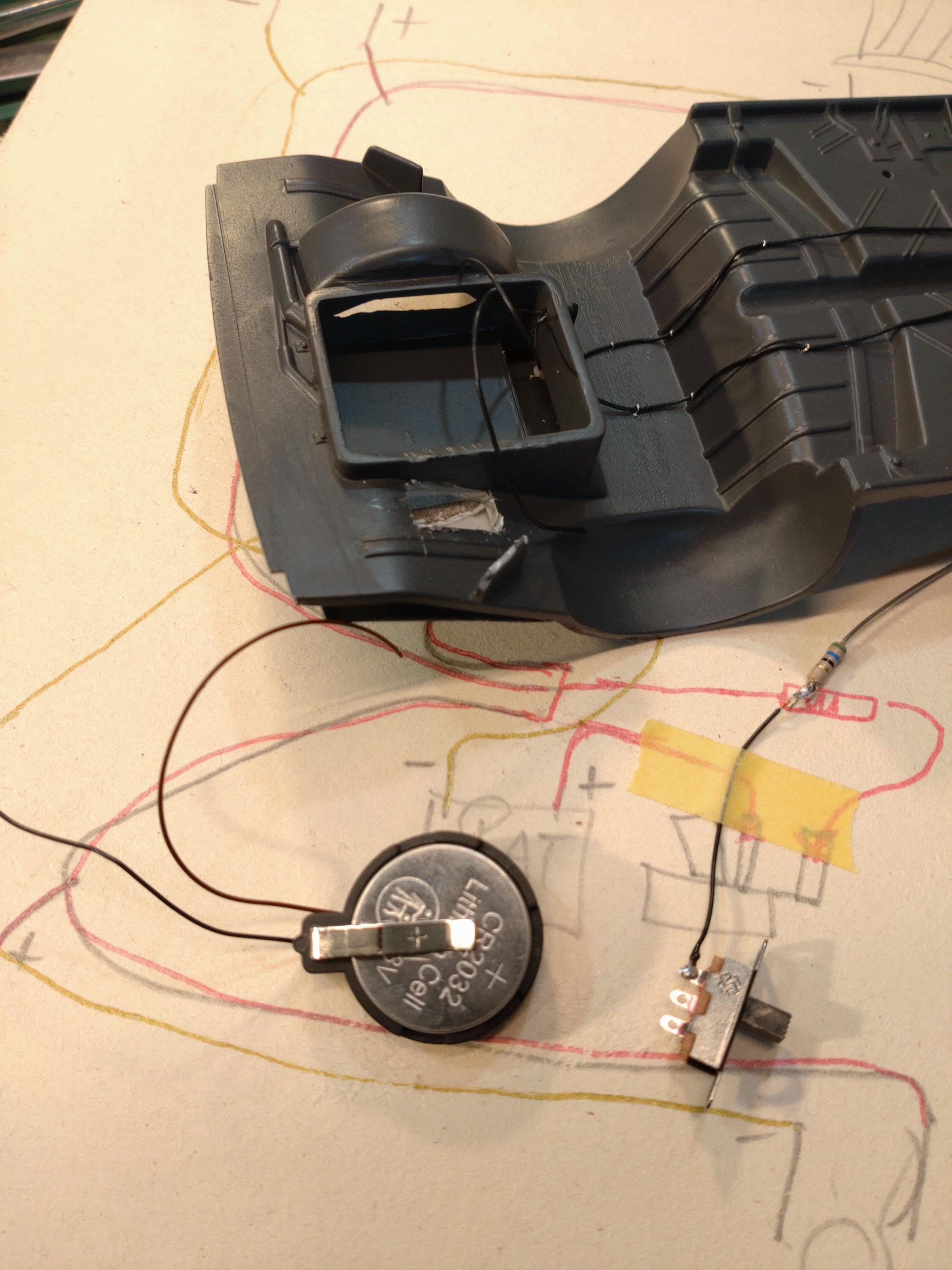

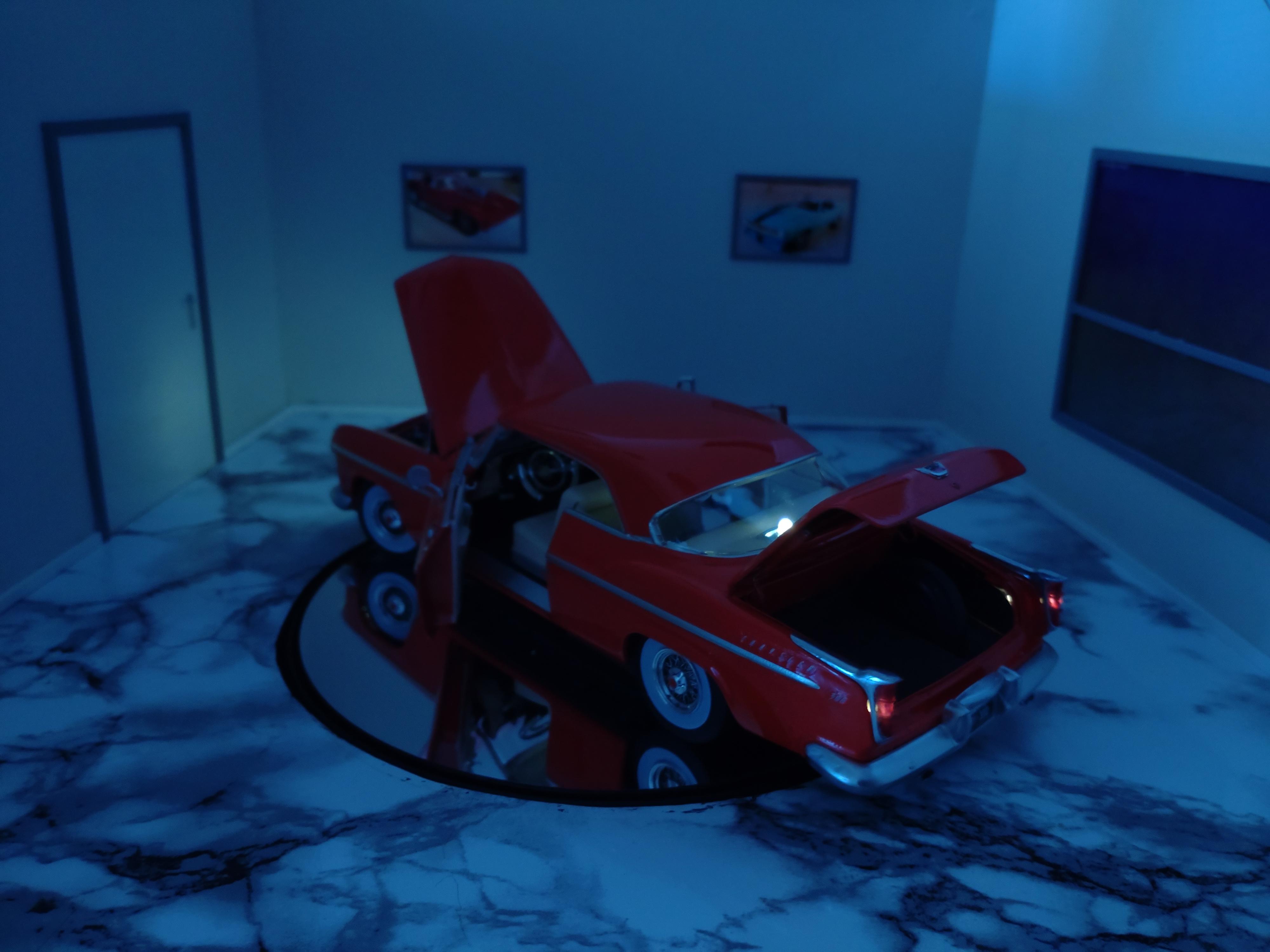

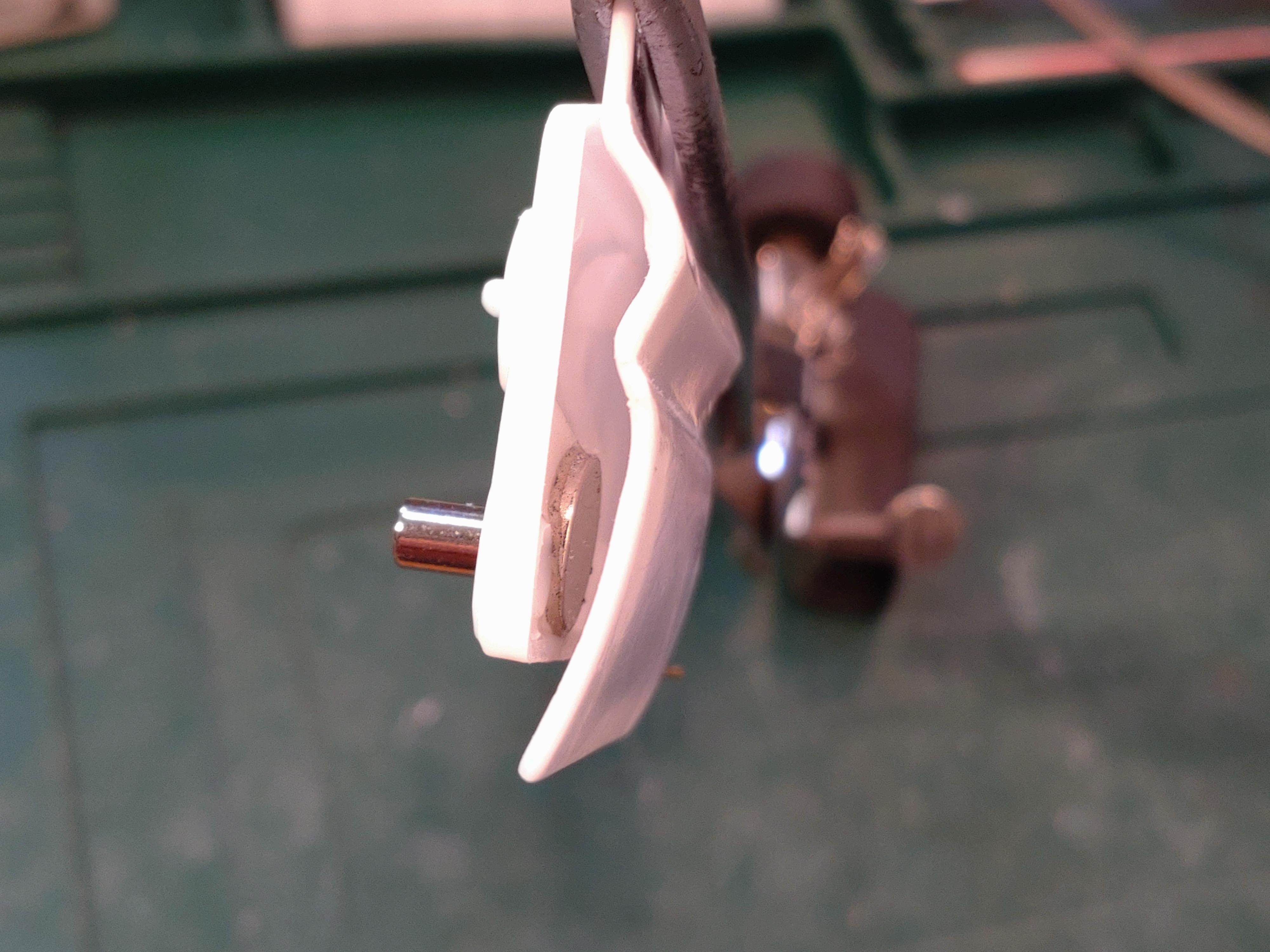

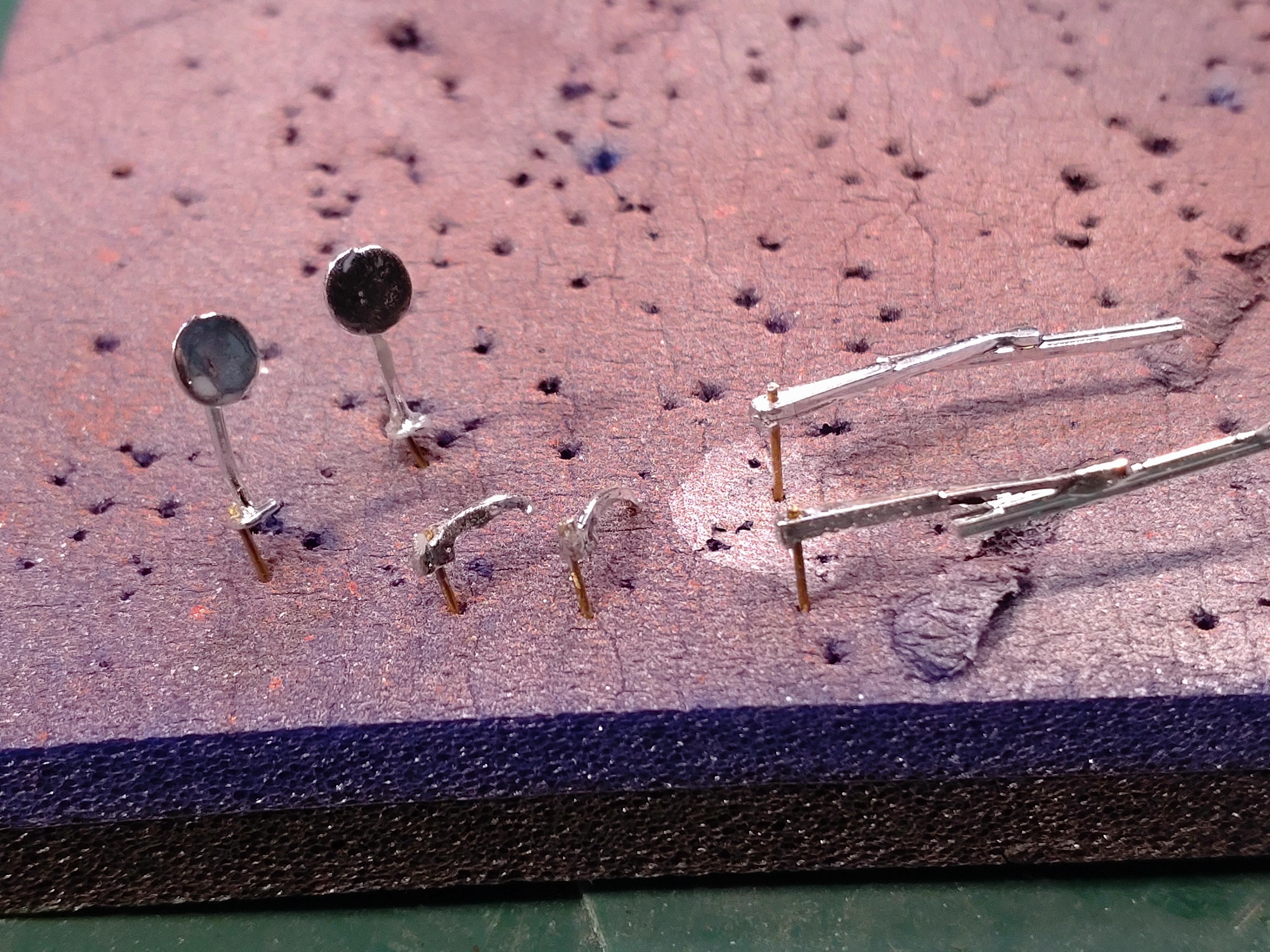

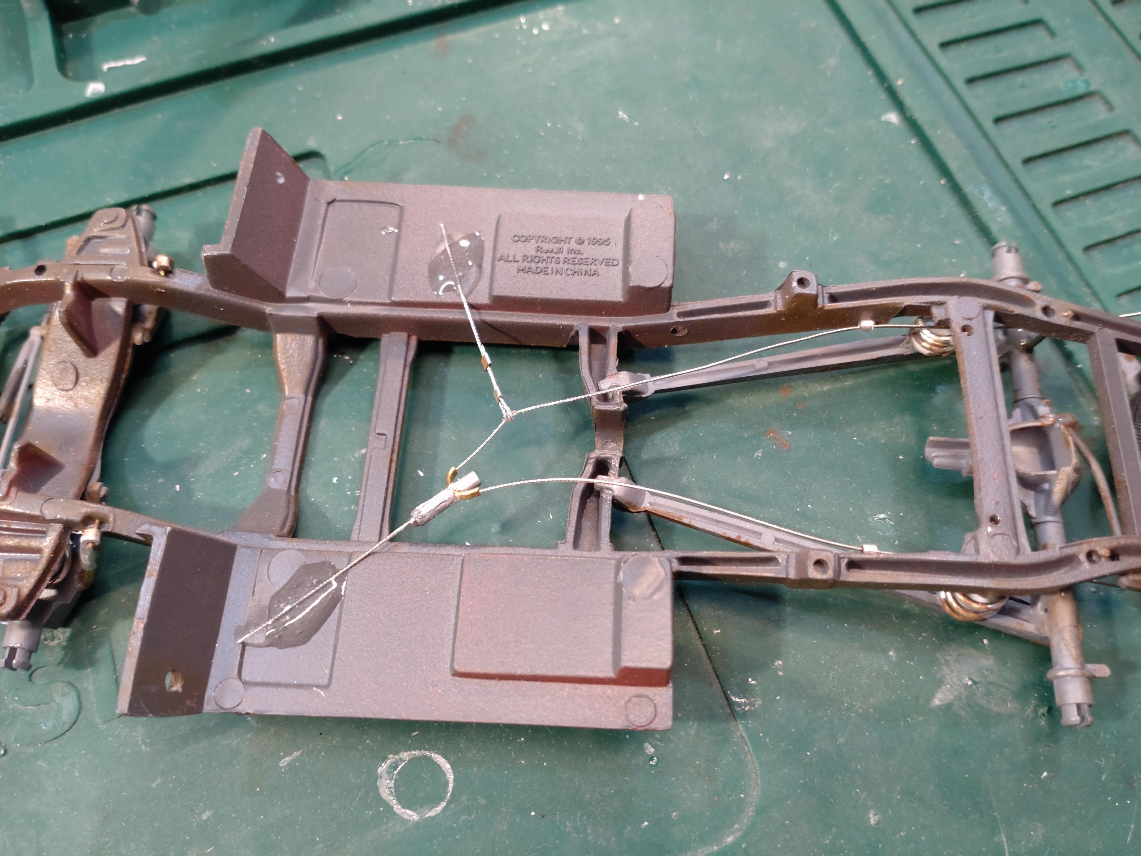

  1. Last time I mentioned the problems/challenges we stumble upon as soon as we leave the path of the building instructions. I am actually finished with this build, but then again, not quite yet. You will see why at the end of this post😄. Before marrying the body and the chassis I added the parking brake cables. Then I took care of finishing all of the wiring. 14 LEDs means 28 thin wires, 4 resistors and the battery holder getting soldered together and tucked neatly into the compartment under the gas tank. I did a good share of testing on the way because I couldn´t have taken something NOT lighting after the whole mess was complete. This is shortly before being finished: And this with the tank slipped in place and held with the magnets. Wipe my sweat and take a deep breath🤗 The gap on the rockers are covered with thin sheet styrene with matte BMF. You can slightly see the wires hidden in the rocker. The engine was the usual fun. The printed carb and the fabricated air filter really make a difference. I deconstructed the belt and pulley part and worked the pulley wheels to hold thin rubber belts. These I cut from a 1mm place mat. The pulley wheels are connected to the block with .8mm brass rods. The finished engine looks like this: For the front steering and suspension part I fabricated springs and shock absorbers. Now comes the problem part I started with: Being so happy about the cool carb/filter combination, I didn´t think about if it might not fit under the closed hood.... Well, it DID NOT! Aaarrrrgh! Also, since the wiring forced me to work in an unconventional order, I had to spar the engine to the end. So, it didn´t fit into the bay either. What to do? I sliced the gear off the engine again and that solved that inconvenience. No big thing gluing them together again. Dropping the engine about 10mm to make it fit under the closed hood forced me into open heart surgery. First I cut and grinded a much as possible off the engine mount with my micro tool. Then I worked the engine pan to an extreme to lower it over the mount. After sanding and filling the gaps with epoxy and touching up with paint, you can hardly notice anything. I could have kept this step to myself, but I wanted to disclose the drama!🥺😖😂 The hood fits now and engine bay itself is finished too. Now comes a last bit of trouble. I cut out the roof for a targa convertible. Until far into the building process the windshield frame and the roof fit perfect. And after connecting the windshield to the frame I didn´t bother checking the fit any more. Under normal circumstances the "glass" would pop into the frame and the roof would take it´s tension. But the windshield frame is only about 2mm thick now and so the frame adapted the shape of the frame. Meaning, the convertible roof doesn´t fit now! Gaps at the back, twisted and a fat gap over the windshield. Dang.... I could just discard the roof and leave everything as it is. But that wasn´t what I wanted at the start. I am now working the roof, adding plastic and after sanding, putty and painting it will be fine. And I am so happy I decided to make the roof grey! I would never get the paint to match good again. This is my last post on this WIP thread. After I get the build finished I will introduce it on "Under Glass". Thanks for watching and your friendly replies and support!

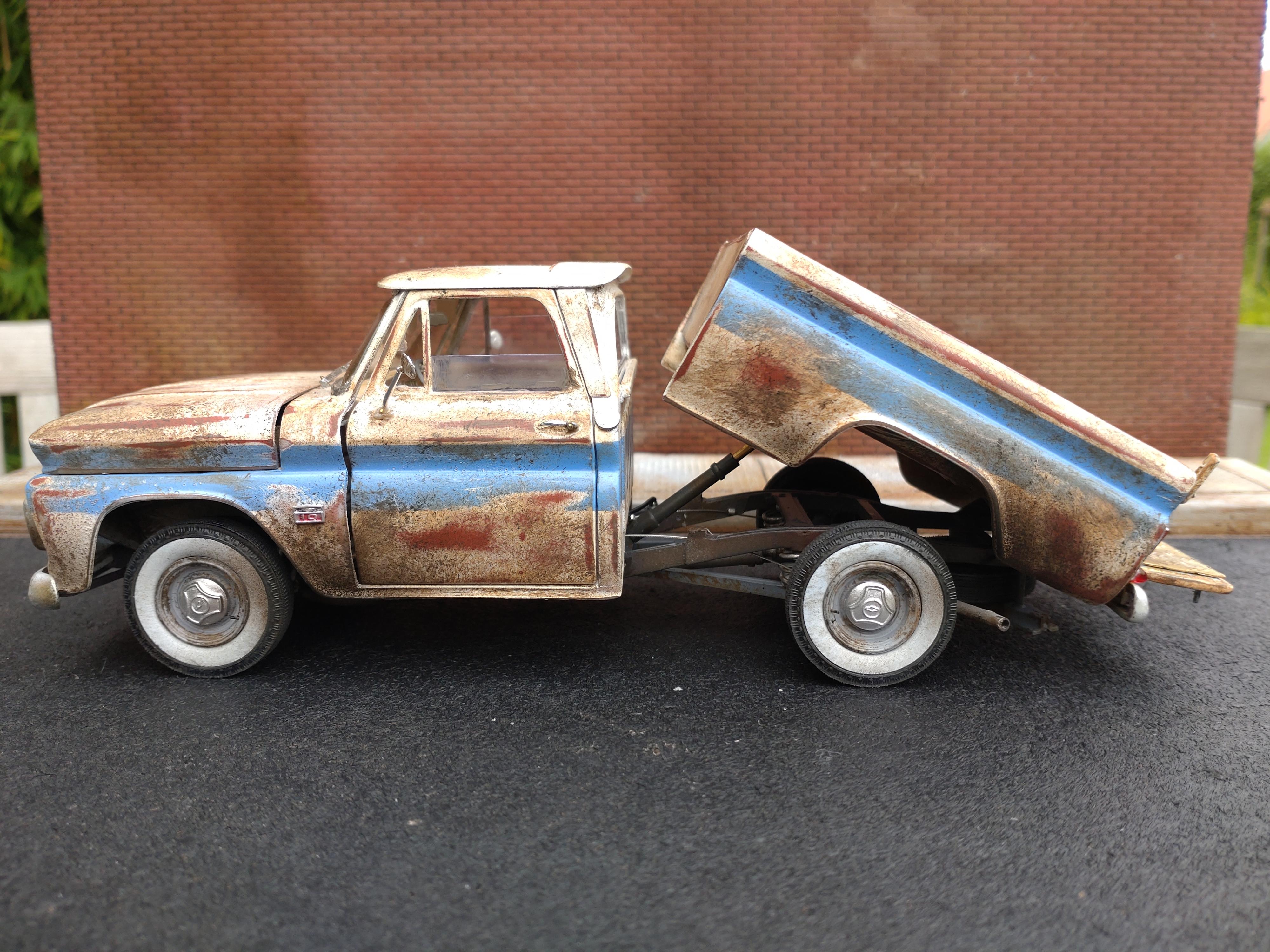

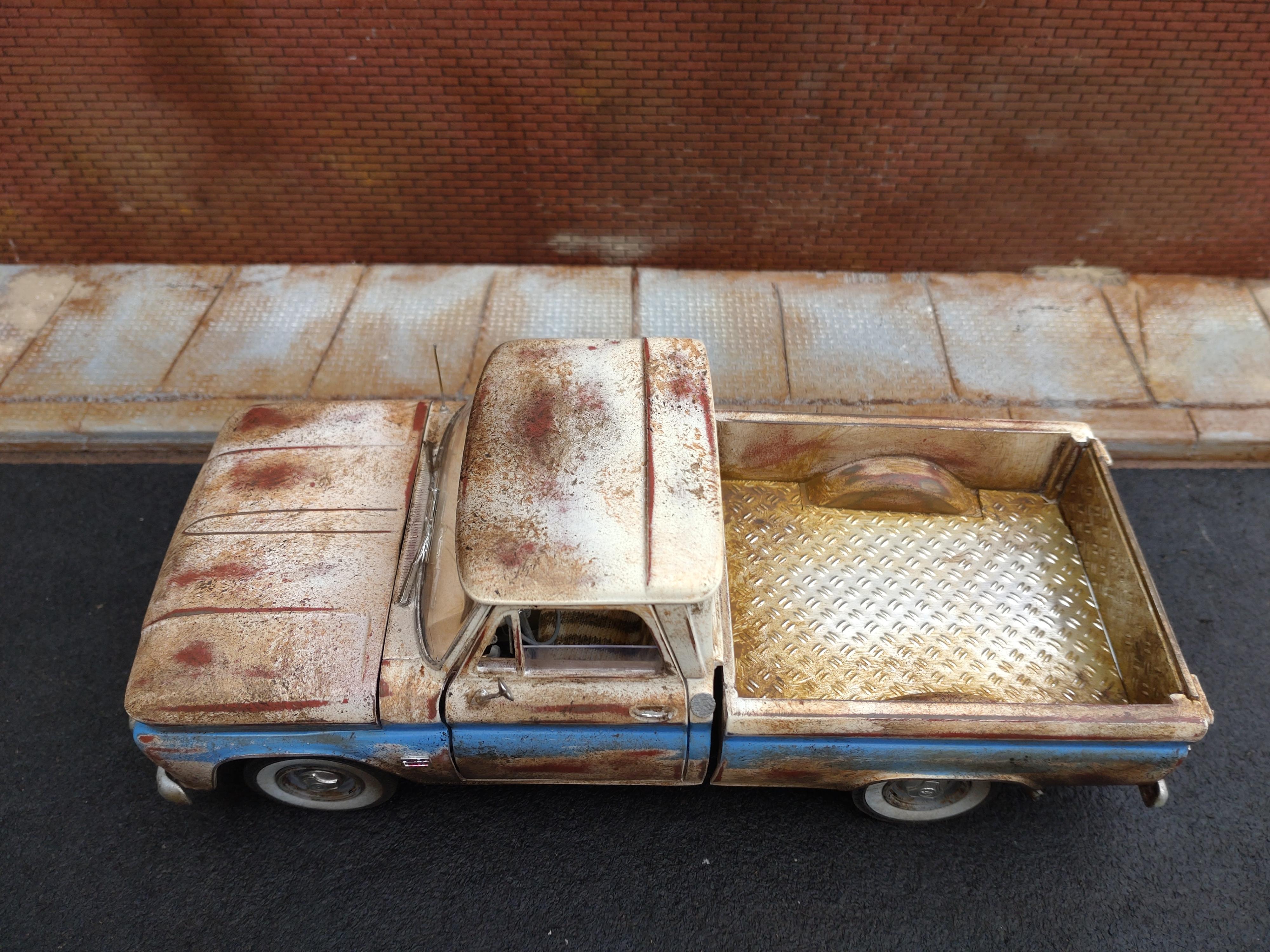

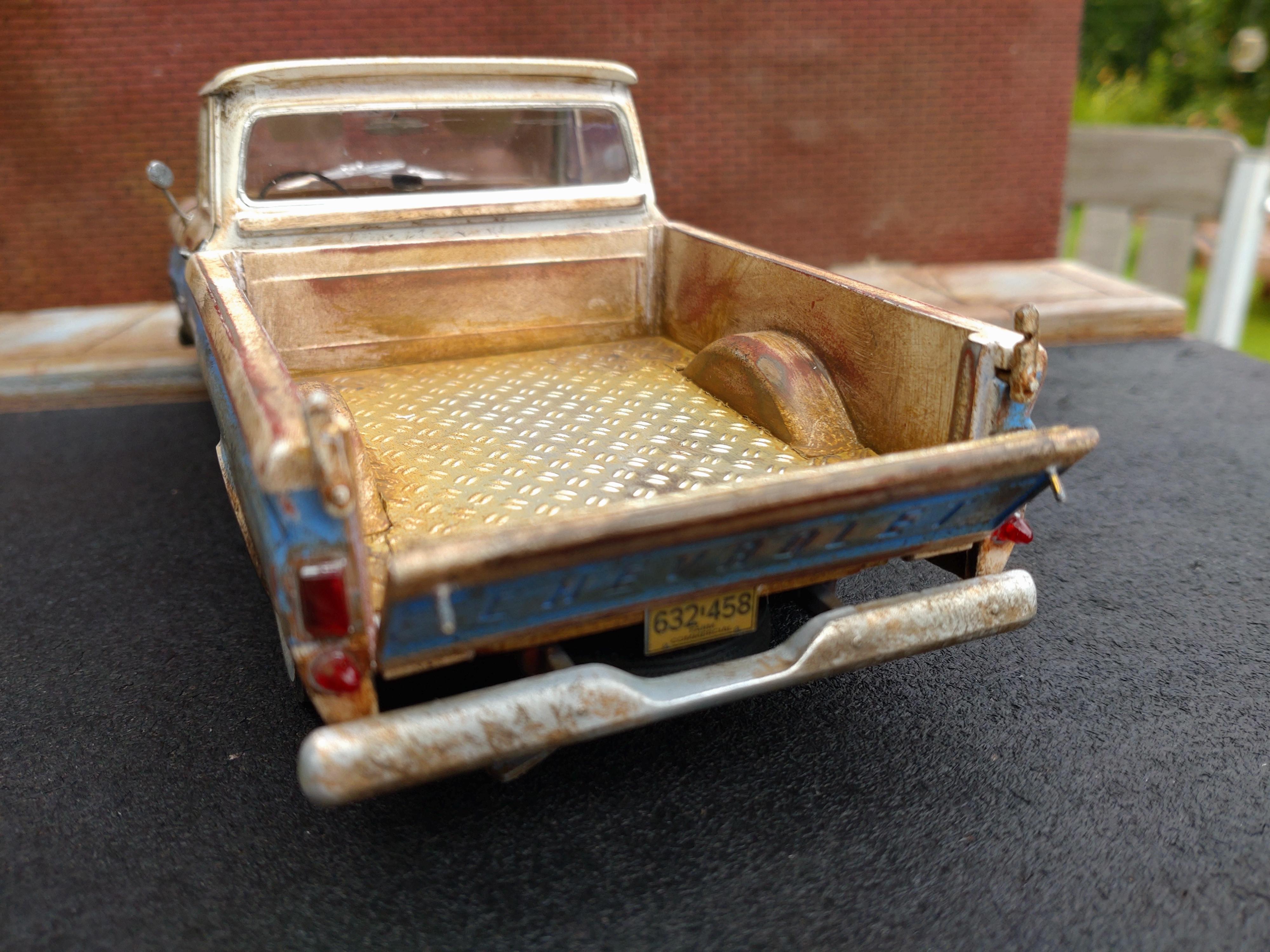

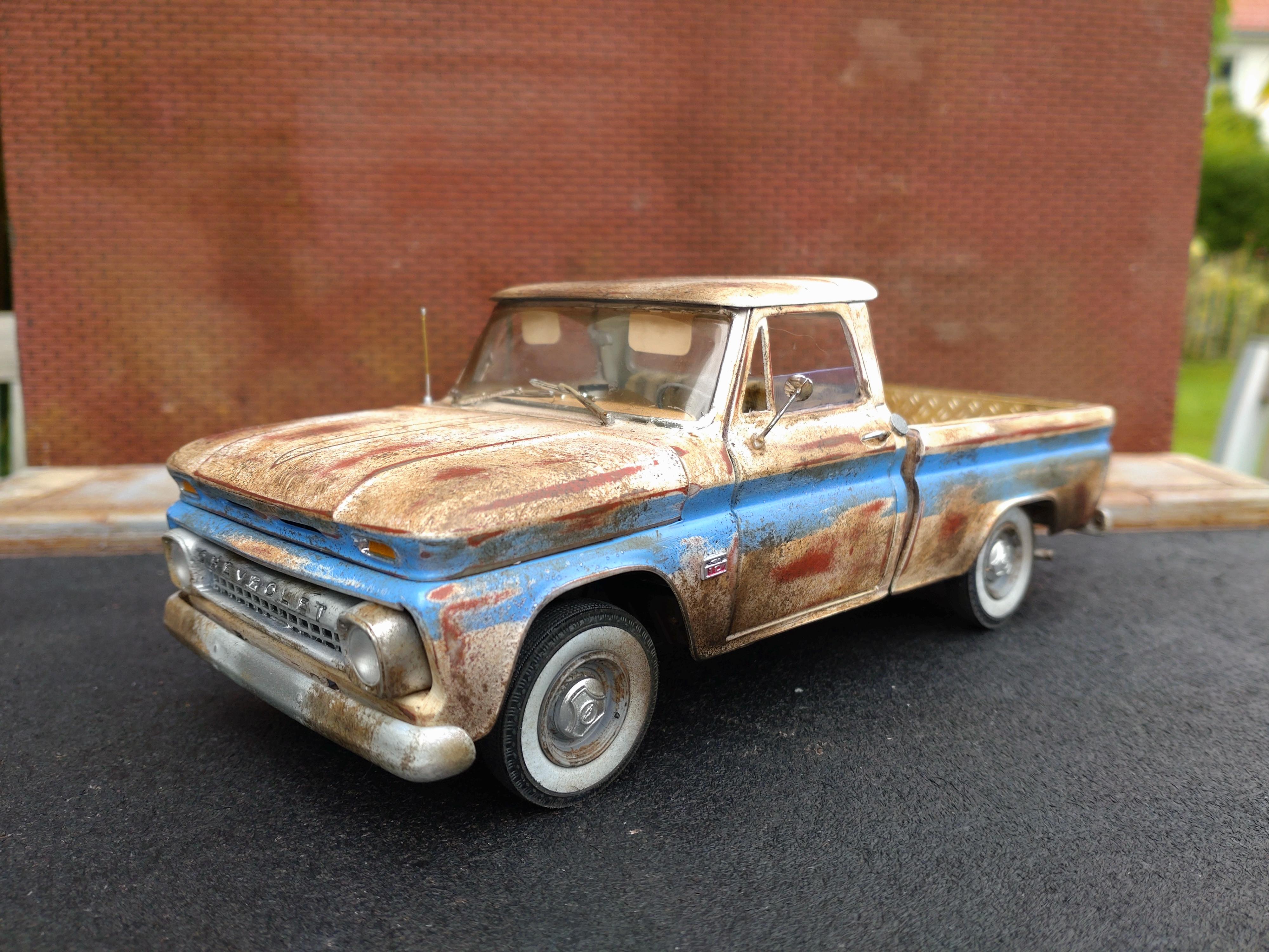

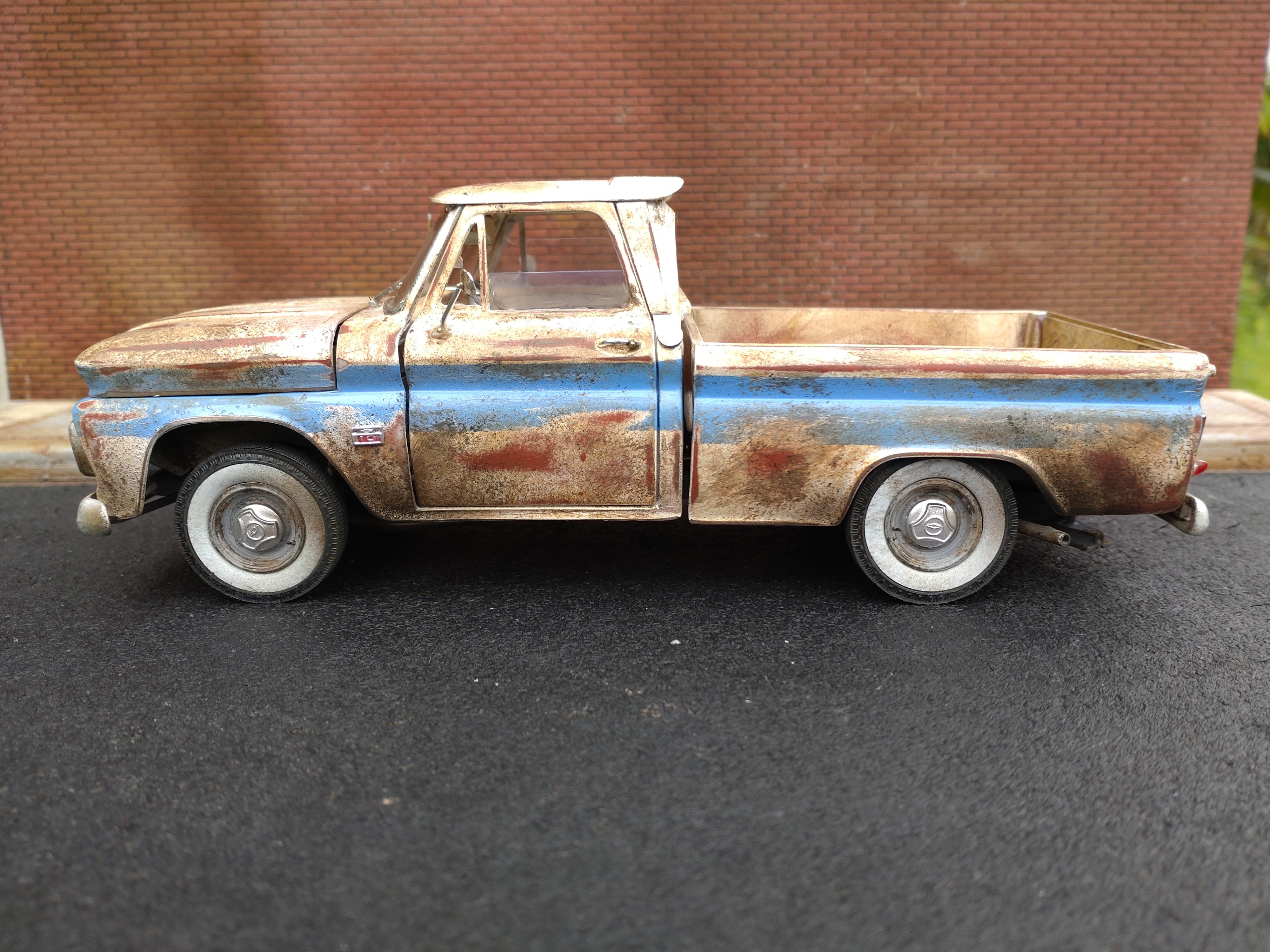

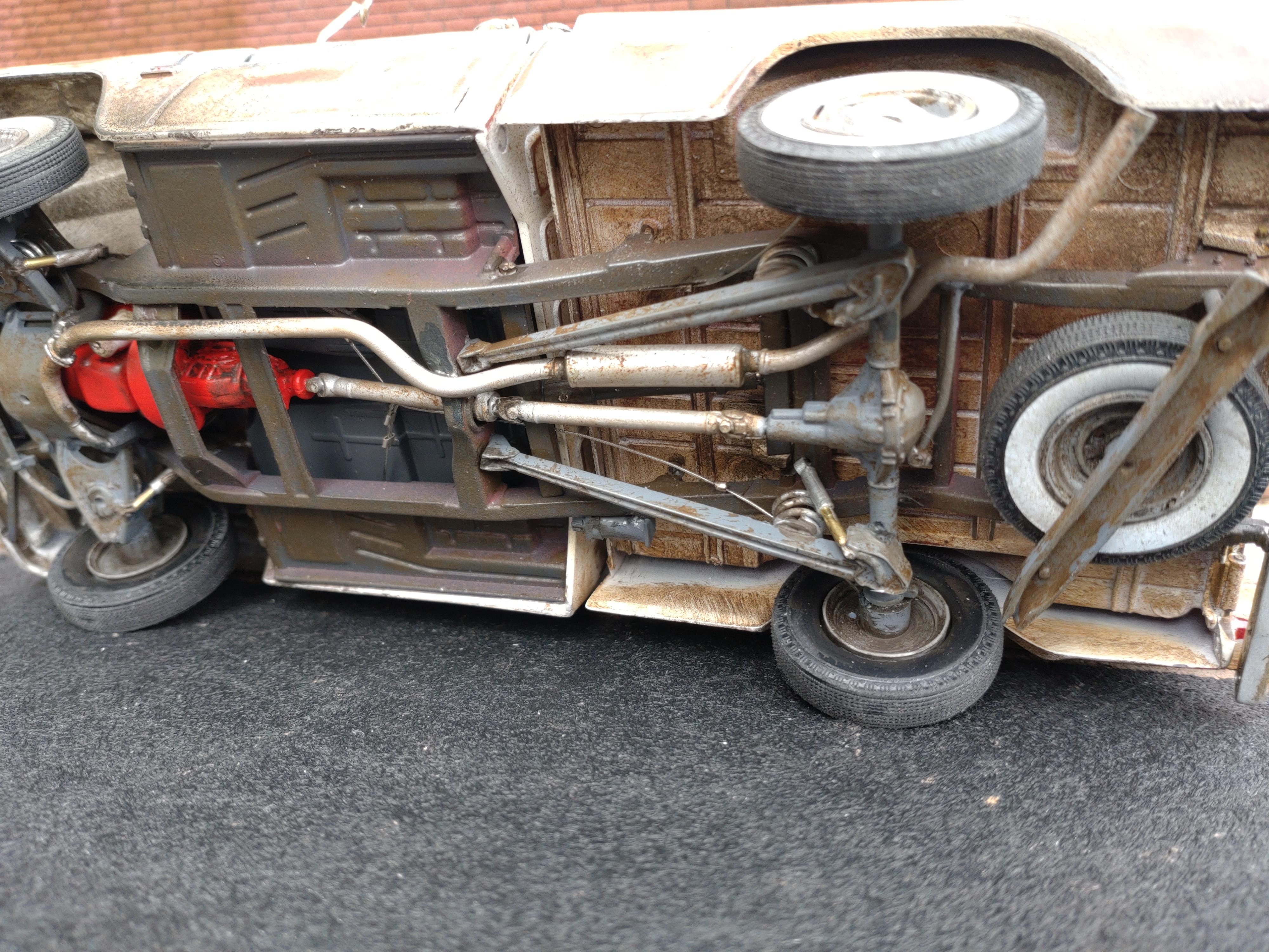

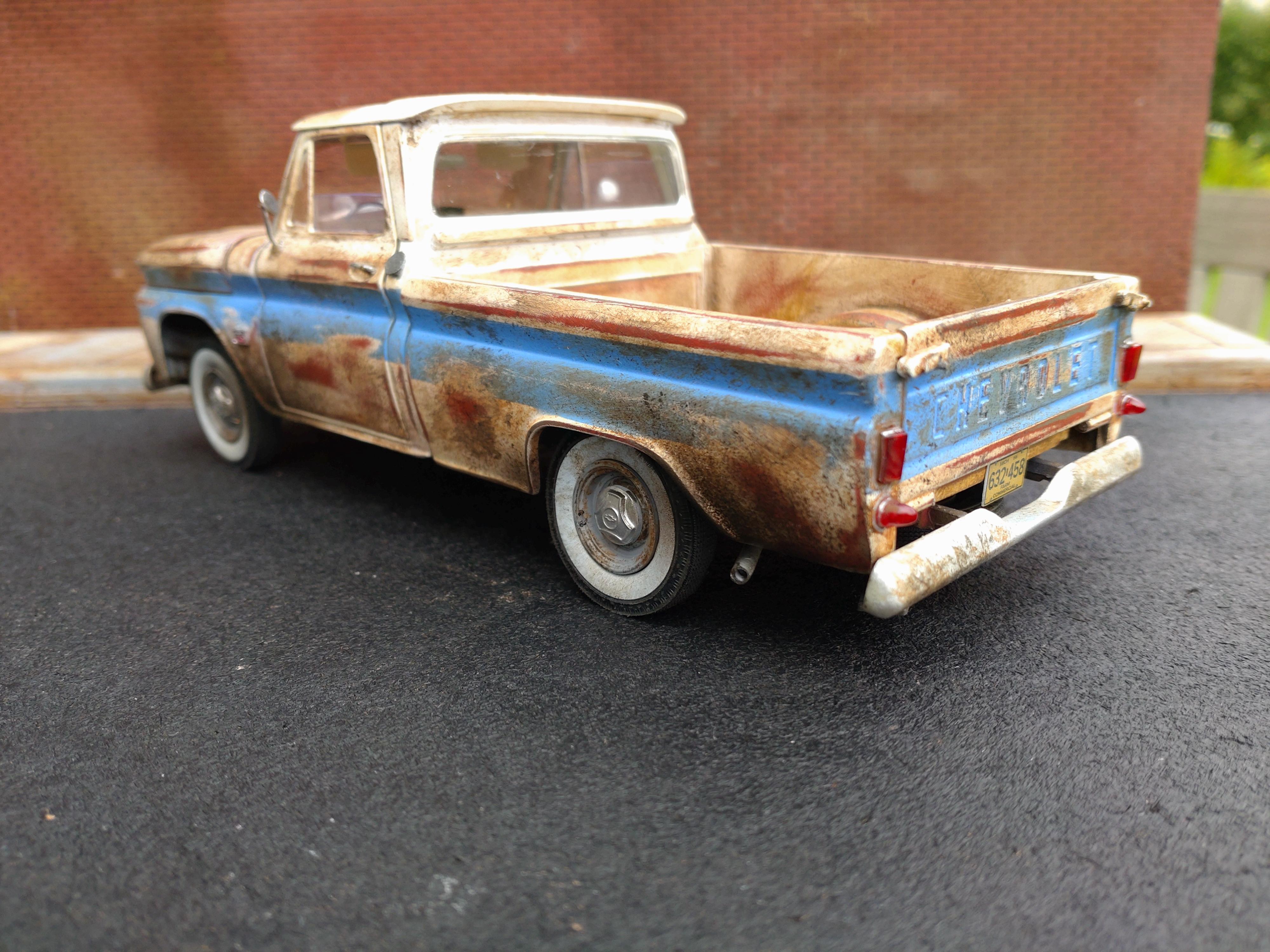

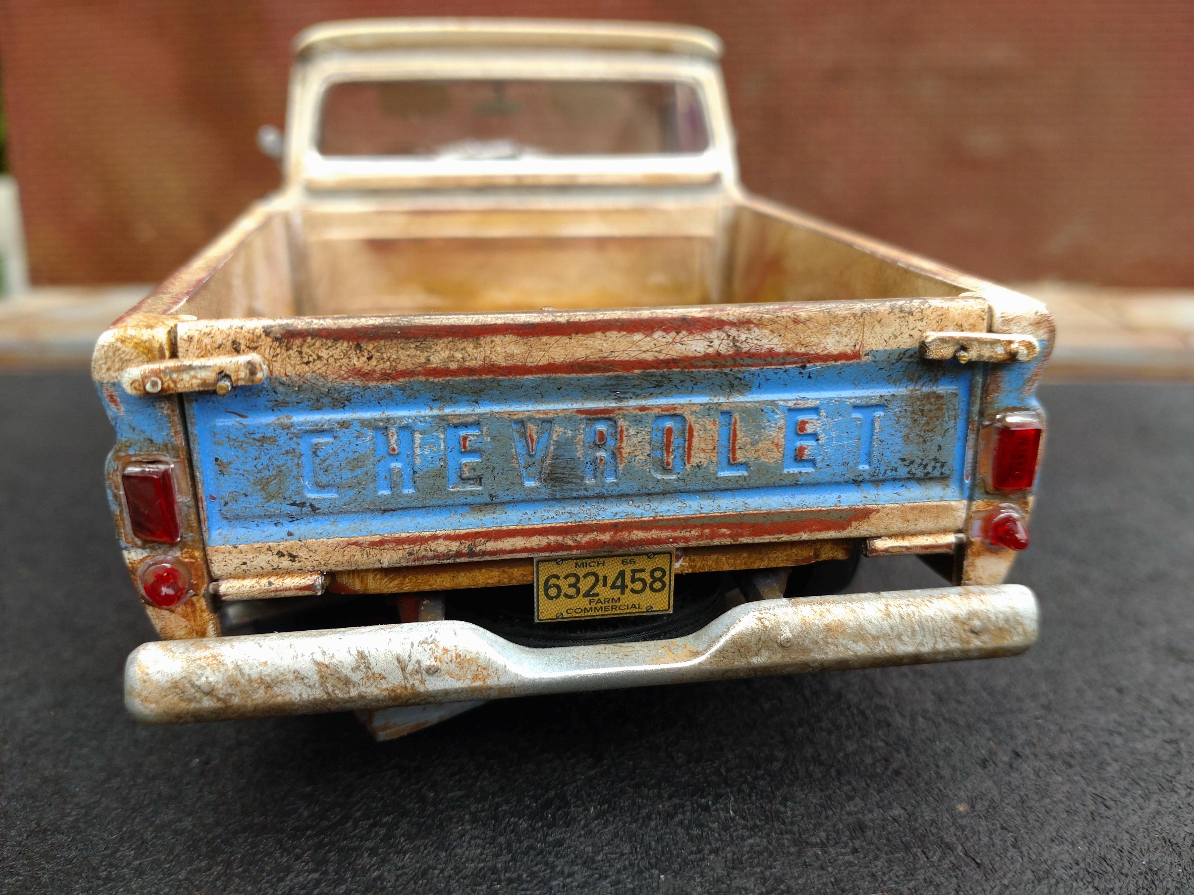

  13. After building a few shiny stock and custom cars, I was longing to try something real dirty again. So, car wise 😂. This Revell pickup was at hand and I am not the first to build one with a rough patina body. Thinking about how to give it my own spin I came up with a dump bed. I knew this would not be a simple chore, but I had ideas about the engineering and in the end it all worked out fine. For some details you might want to check the WIP thread I had during the building process. The paint job was a lot of fun. Not having to worry about dust or messy spots. But the work does add up. On this body I started with a grey primer, then a rust colored layer, the top coat in off-white plus the blue stripe (all Molotow rattle cans). After several stages of sanding and salt treatment, I then built up the detailed rust effects with different AK rust, smudge and weathering colors, applied with a rough sponge. Makes about 12 steps. Just about everything on this build is box kit. I did add many details though on the interior and engine and bay. The lifting mechanics of the bed and carved and cut from styrene rods and sheet, plus a few brass rods of different diameter. I opened the doors and the bed door and made the hinges from 1mm brass rods. The closed cabin doors are held in place with super magnets hidden in the door panel and the bench. For the bed I was happy to find a scale matching checker plate in aluminum. Building the interior was fun too. I had this idea of the imagined owner, probably a gardener, still driving dad´s or grandpa´s old truck. Still running, but over the top due to hard work and nobody caring about the looks. The bench is wrecked, the holes covered with an old blanket. Extra details all over the dash, including a big coffee thermos mug. of course, the interior is a mess too, including an old pizza box. The engine received a decent amount of detailing. Lines, cables, hoses, and the pulley wheels are all connected with a rubber belt. Everything adequately smudged and rusted. The undercarriage has some extra detailing with the lifting mechanics and the cables for the parking brakes. The kit shocks for the front and back were replaced with home made absorbers (styrene tubes and brass rods), and I wrapped real looking springs from 1mm aluminum wire. I hope you like the finished build. Thanks for all the cool reactions during the WIP process and thanks for giving this post your attention! If you would like to see the pickup in "action", I would be pleased if you watched the video: https://youtu.be/40tImz2U_do

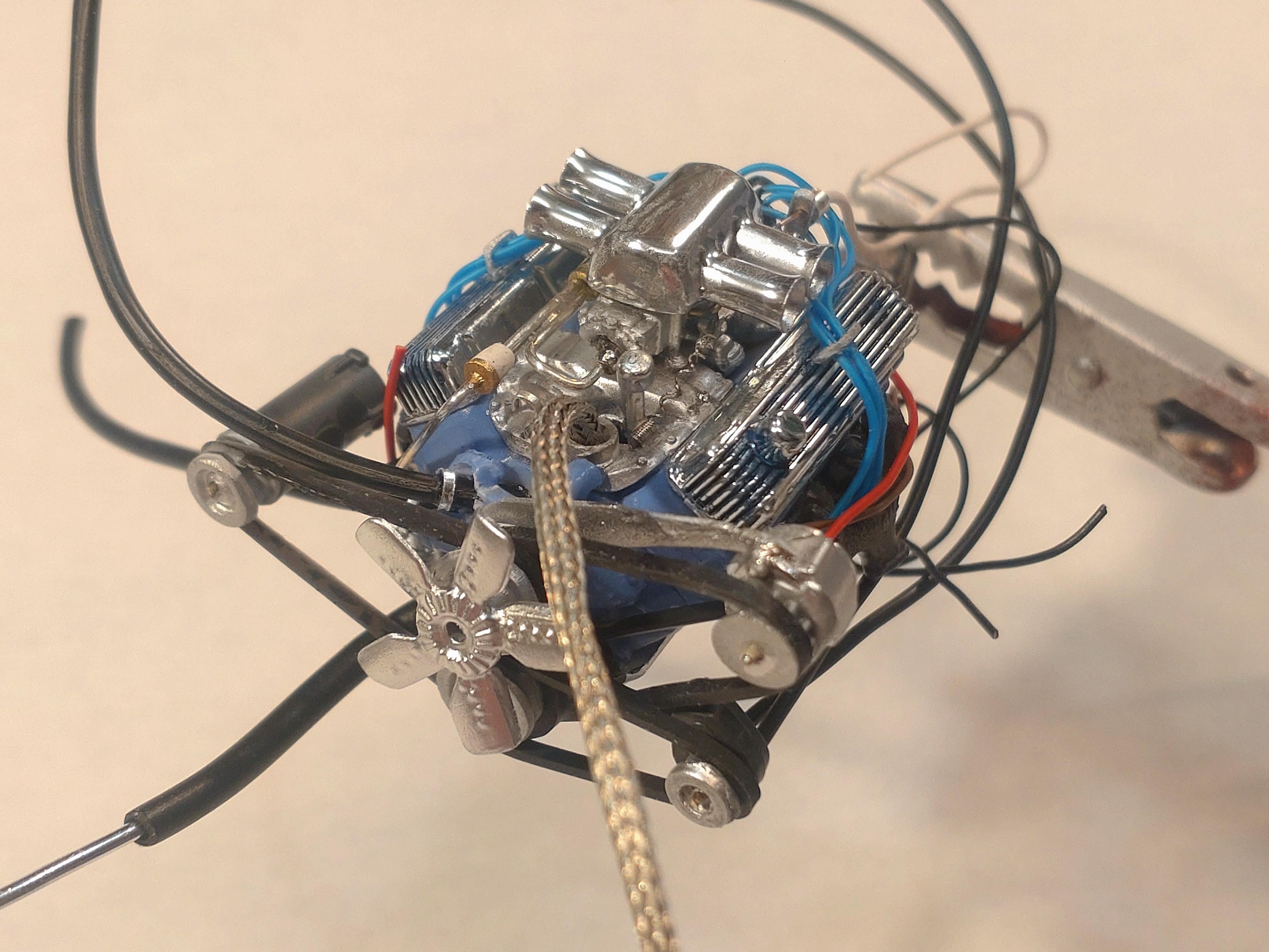

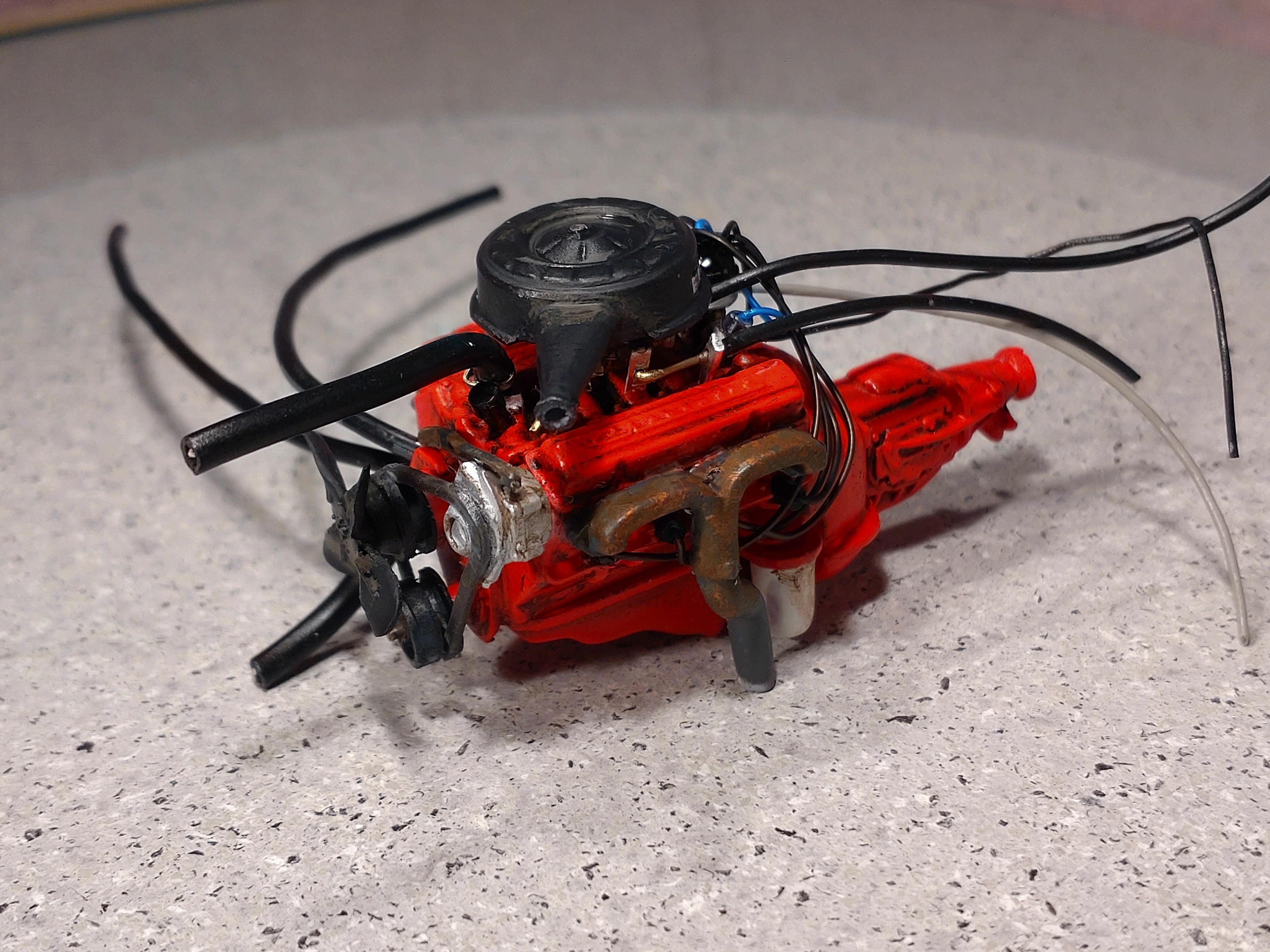

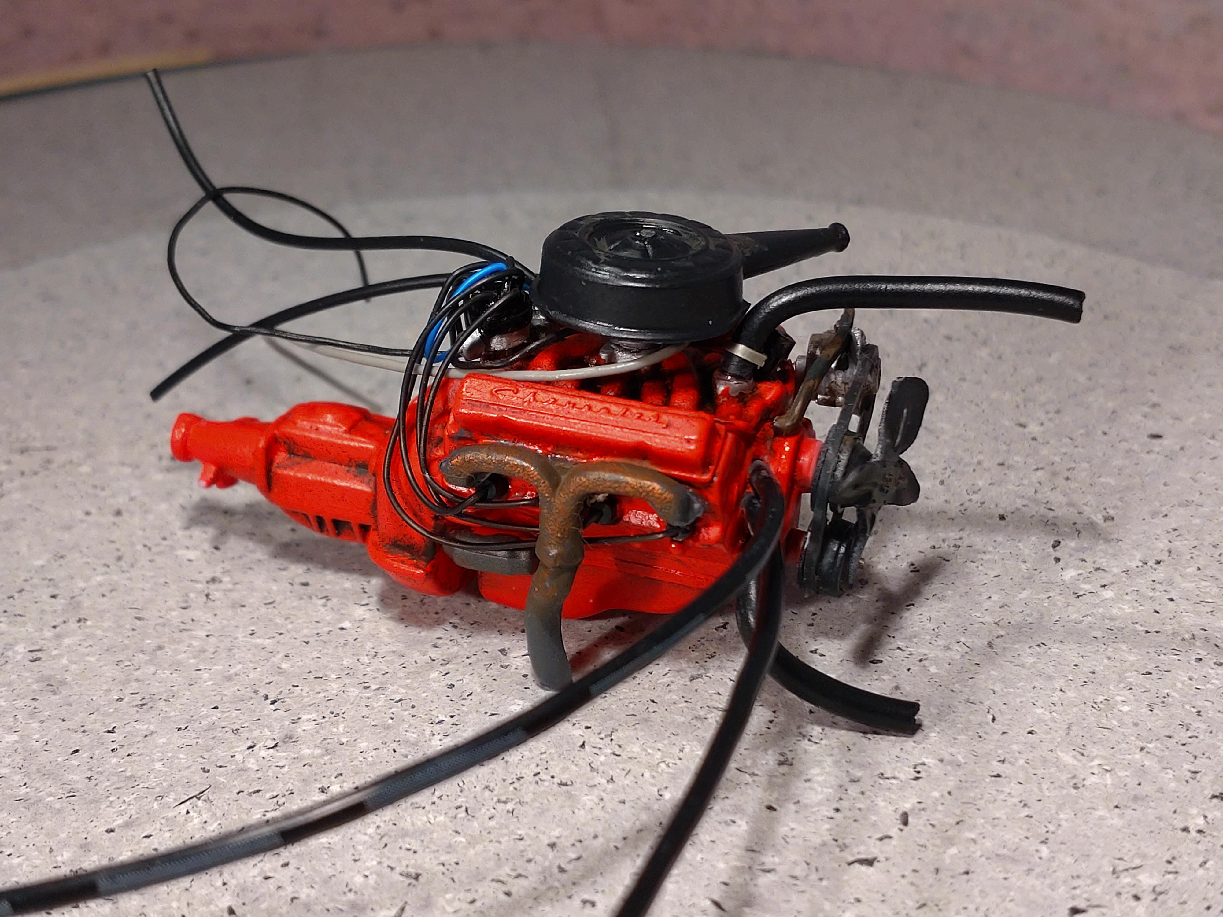

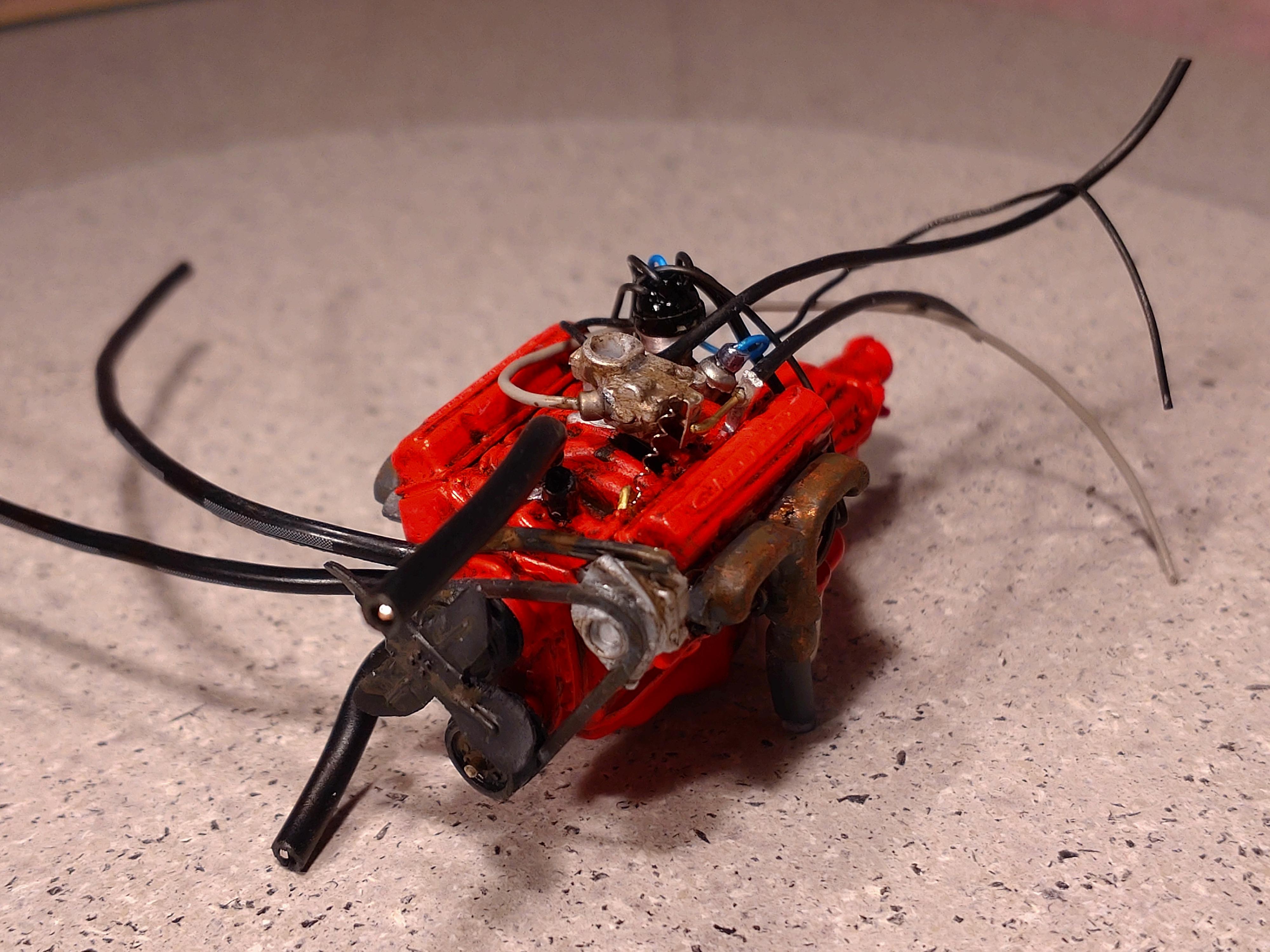

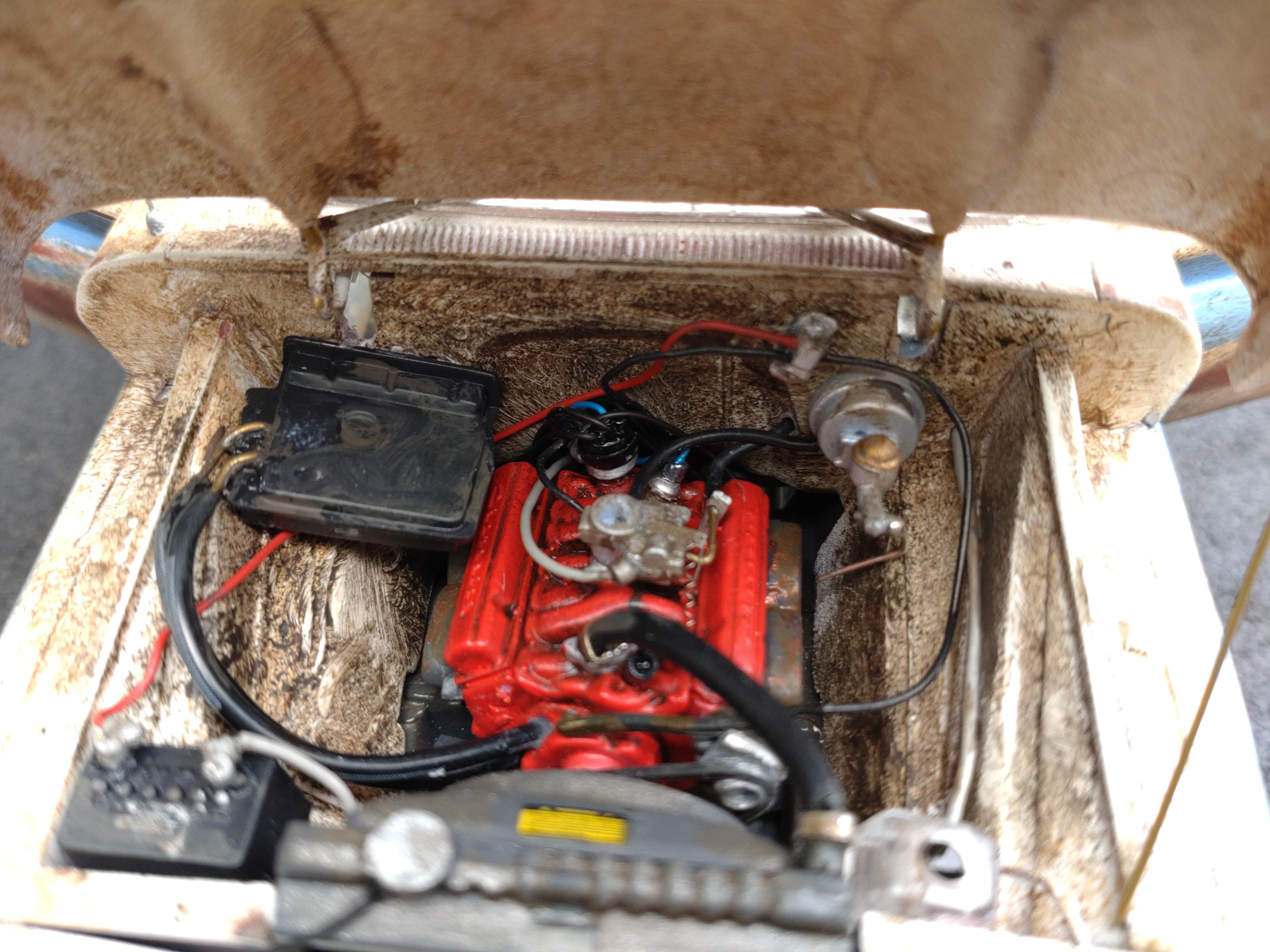

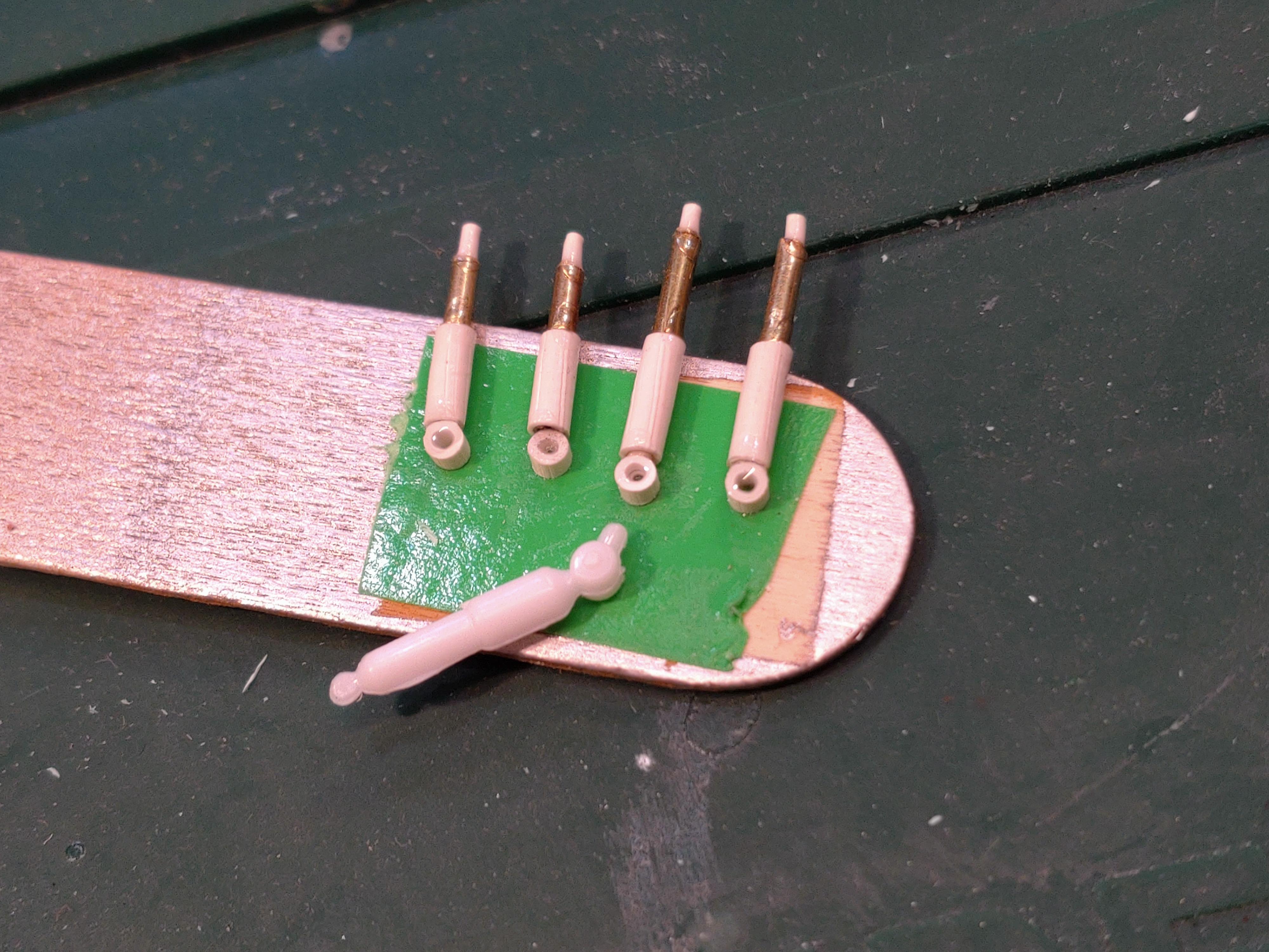

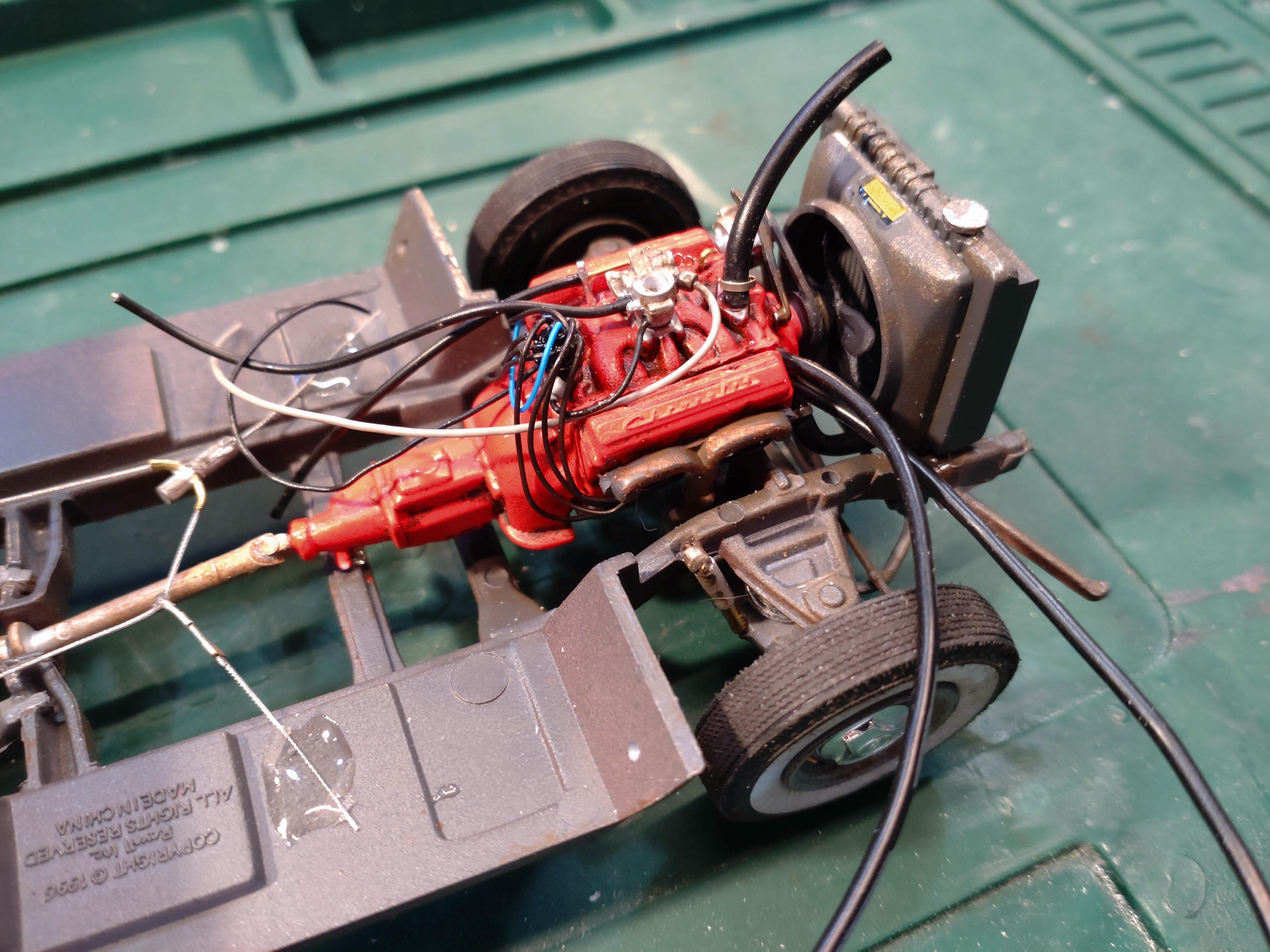

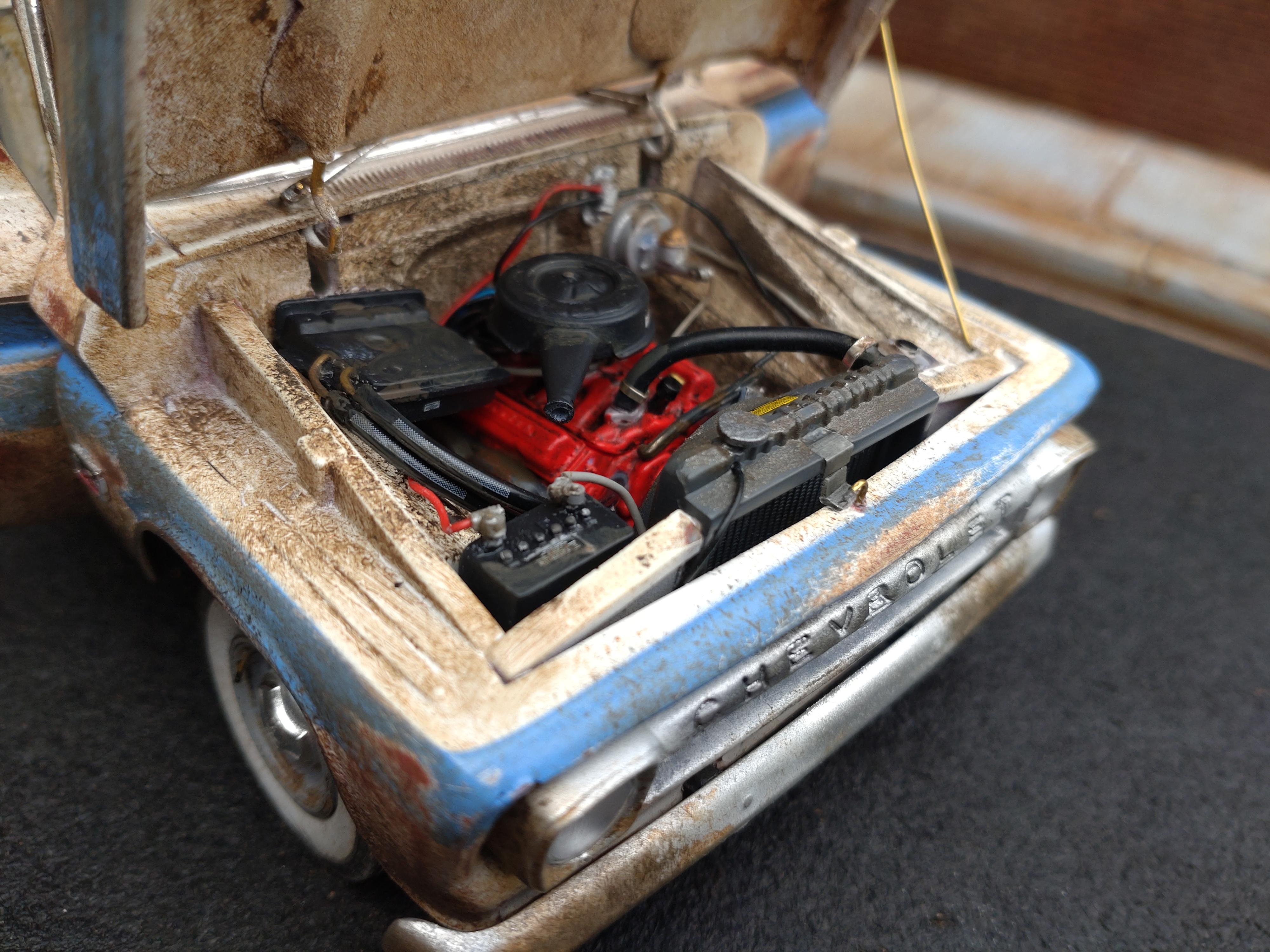

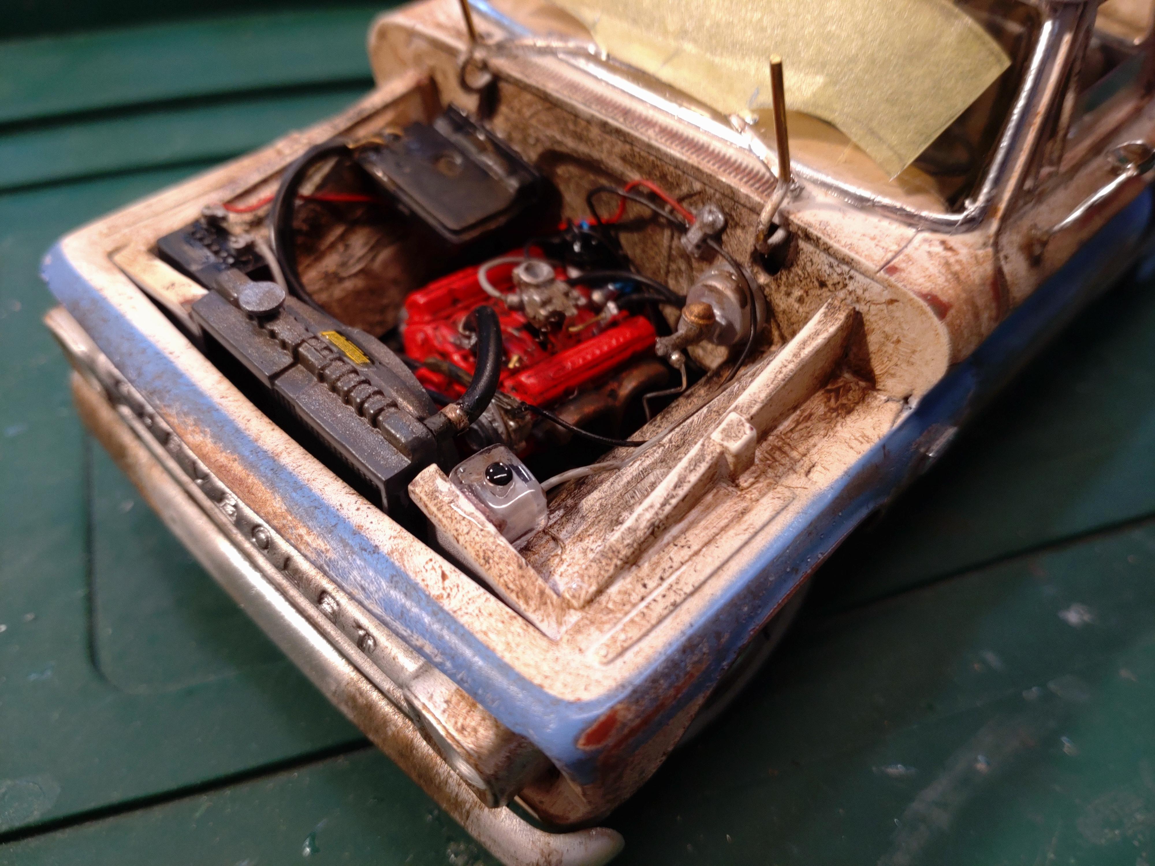

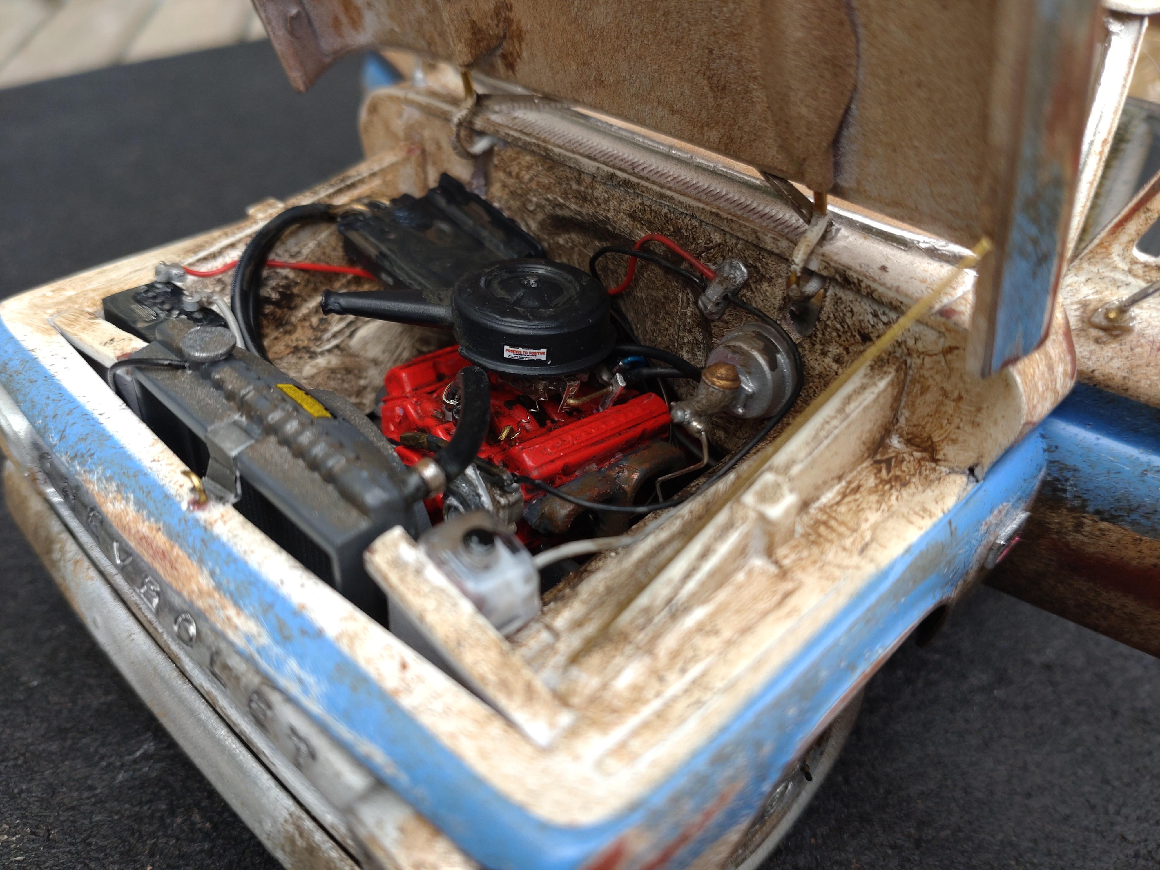

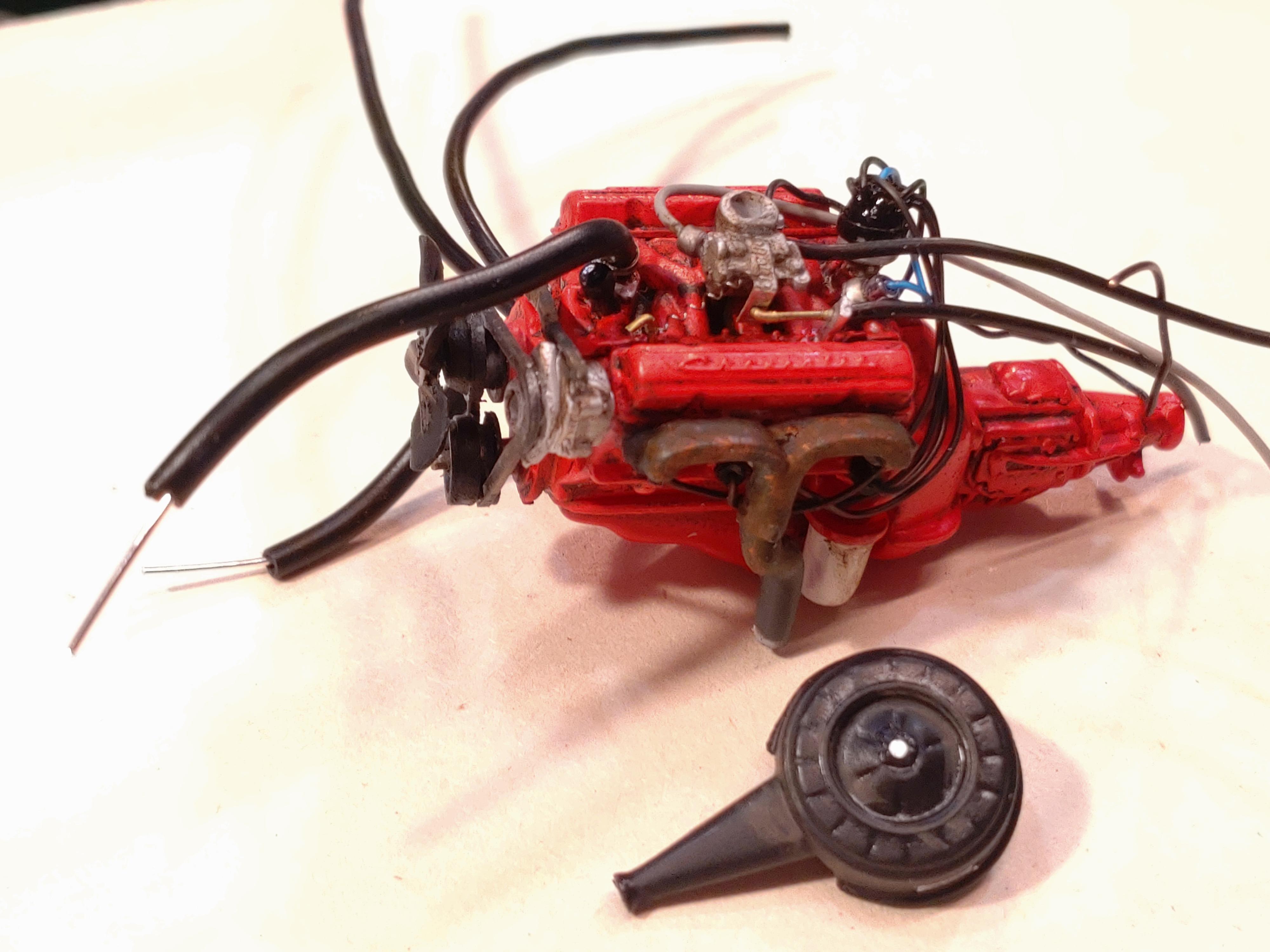

  15. I´m turning into the finishing straight and have only a few things left to do! The engine has received a decent amount of grime to match the body. I added some details and am quite satisfied with the looks. After it´s dropped into the engine bay though, only half of the details will be visible...😕 The distributor is home made from aluminum tube and brass rod, the lines fit into the thin gap between them. Further added: throttle with spring, fuel line, pulley wheels with a rubber "v-belt". I deconstruct the kit part and remake the wheels to match the belt. Everything was treated with AK rust streaks and engine grime. I also added radiator hoses and hoses for the air conditioner. I strip the copper filament out of the vinyl and fill it with wire. The wire I can stick and glue into holes in the block, so I can bend them into any direction without fear of tearing them off again. . Attached to the chassis, all those lines and wires look a mess. The radiator is glued in place and will fit smug into the bay. This looks very neat now. The lines are all in place. I enhanced the bay with extra details: The brake booster received it´s brake line, the battery has better contacts with wires, a relay connects the main lines. The dump bed is working fine! There is only a little bit left to do now. Soon, I will show the finished build on an "under glass" thread. Thanks to everyone that took a look and for your friendly support!

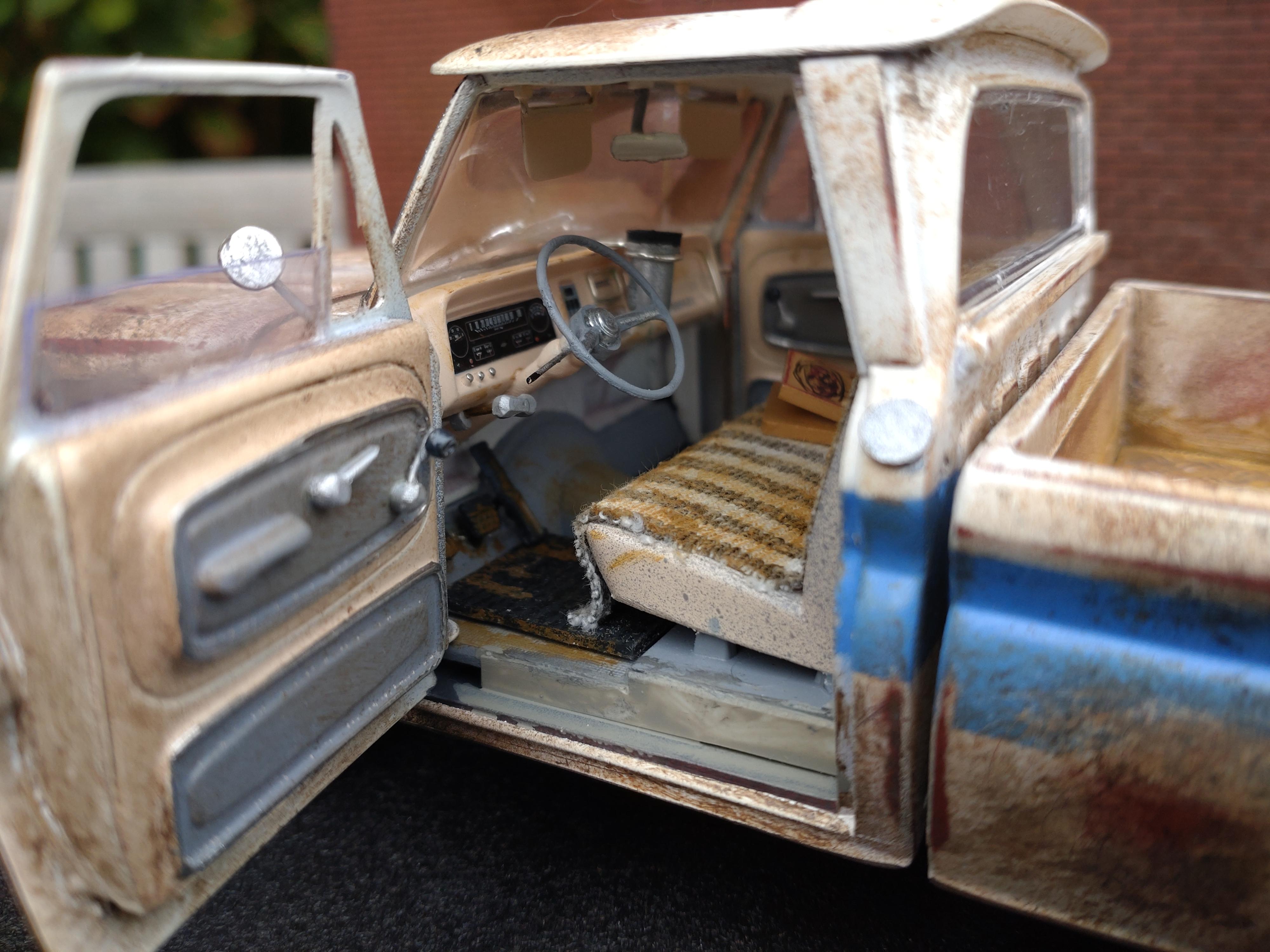

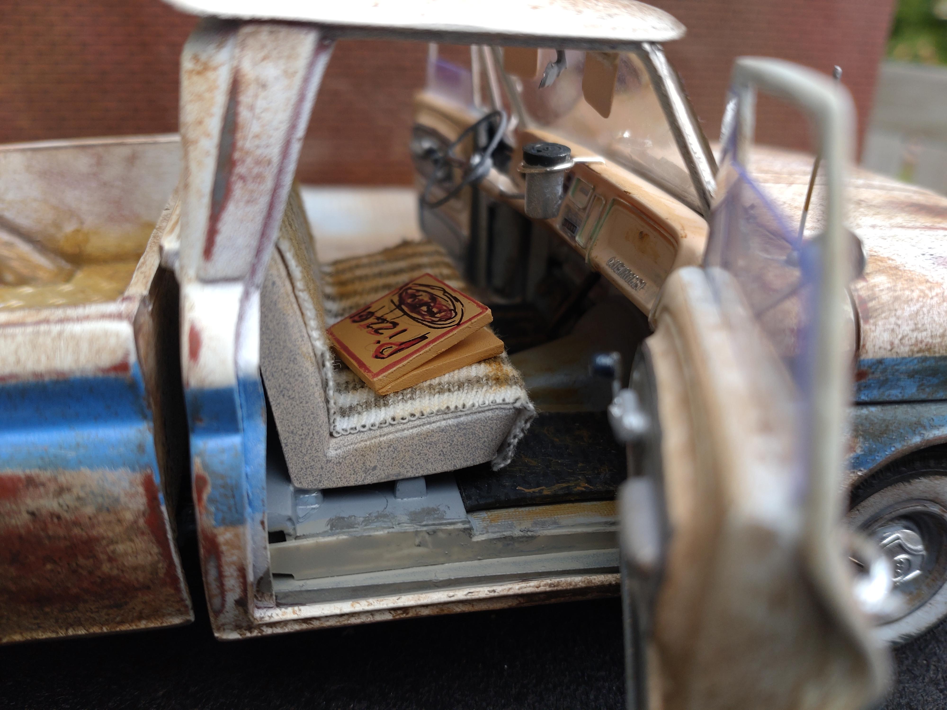

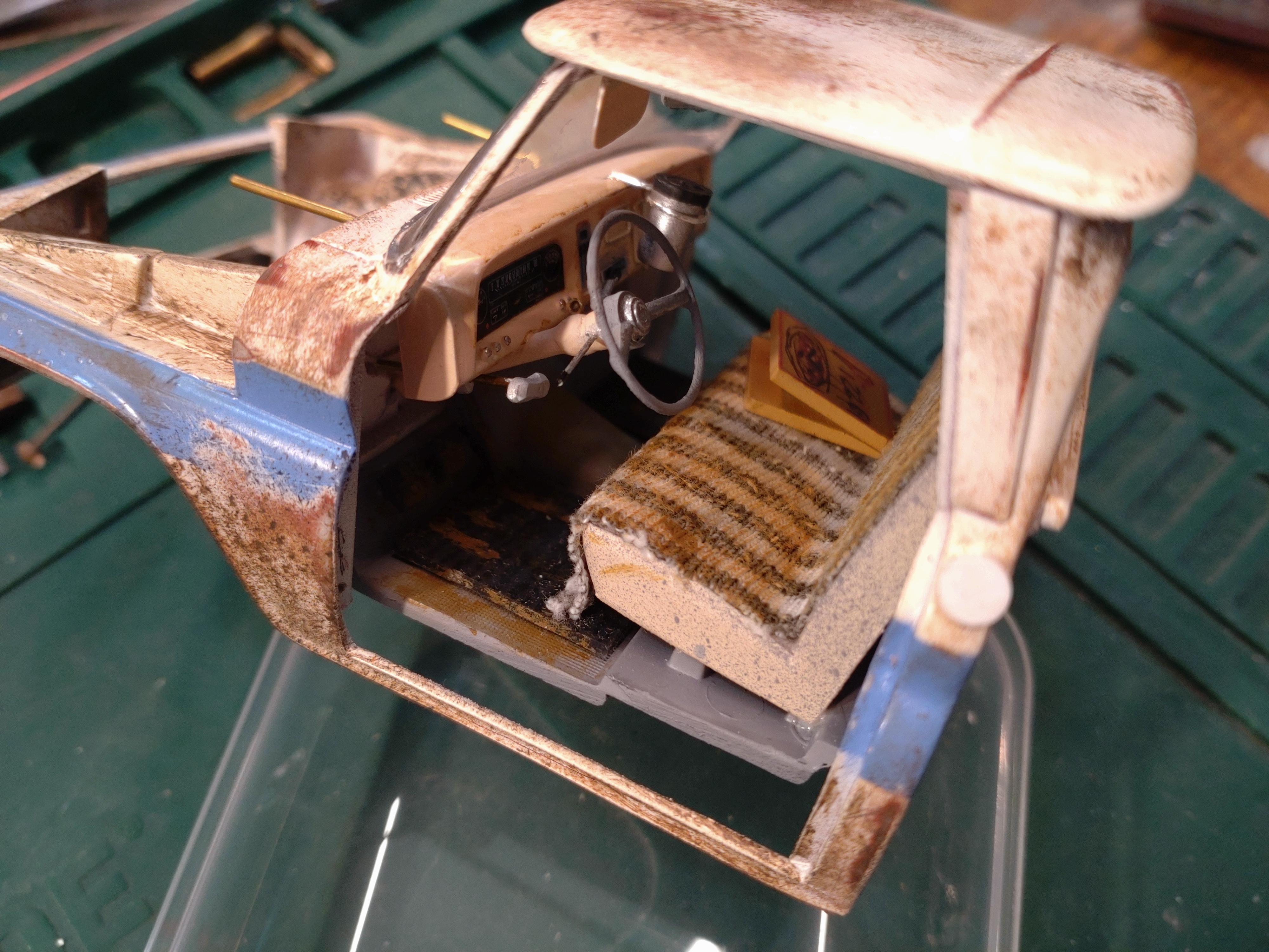

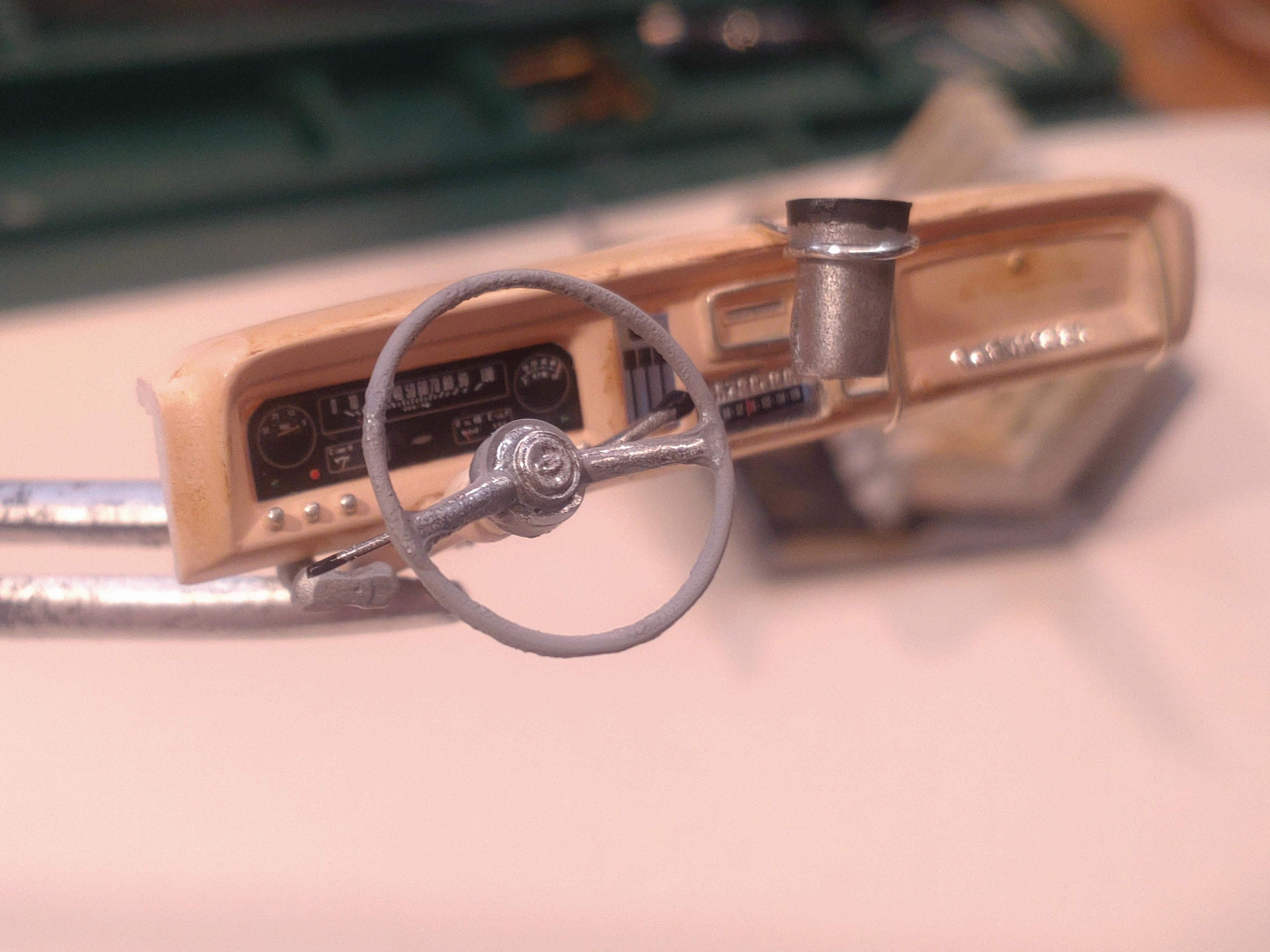

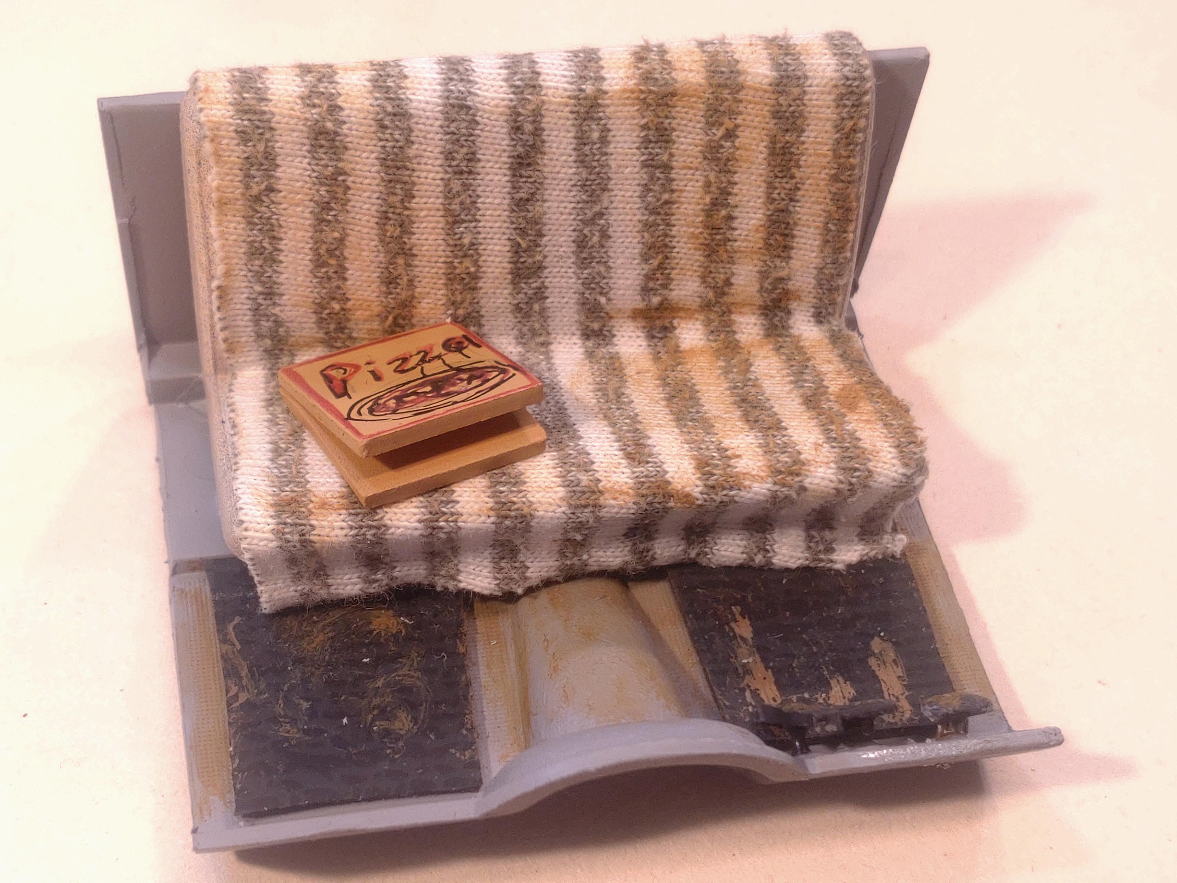

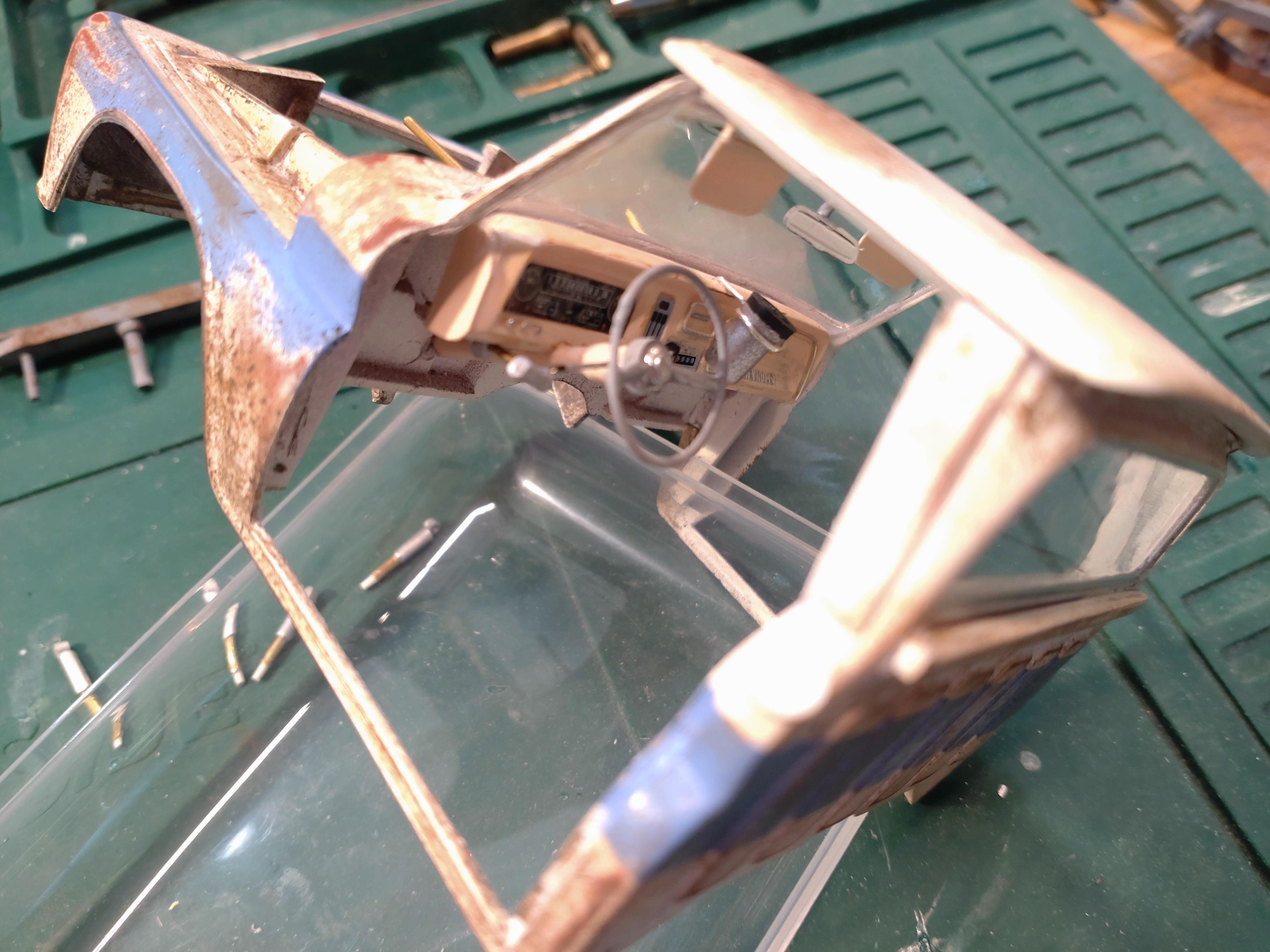

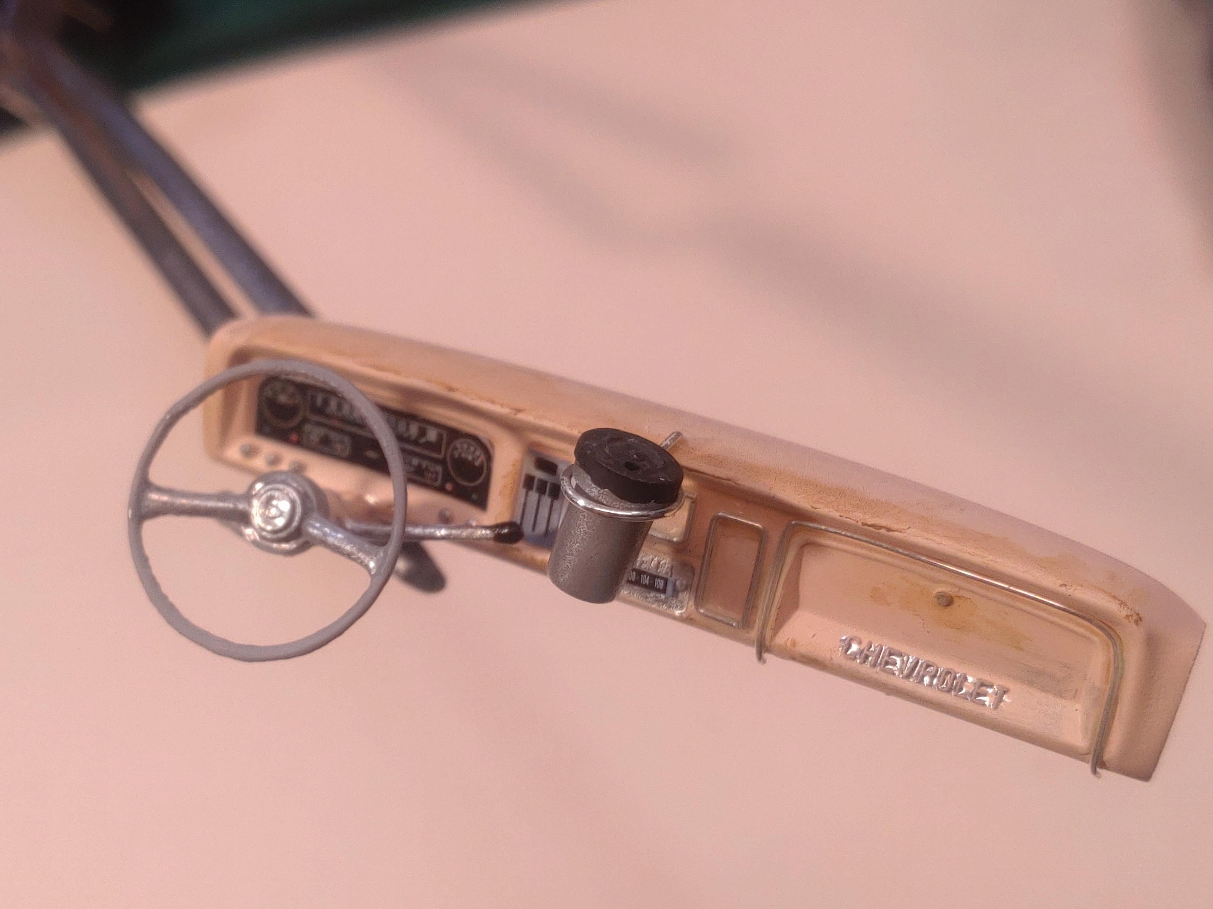

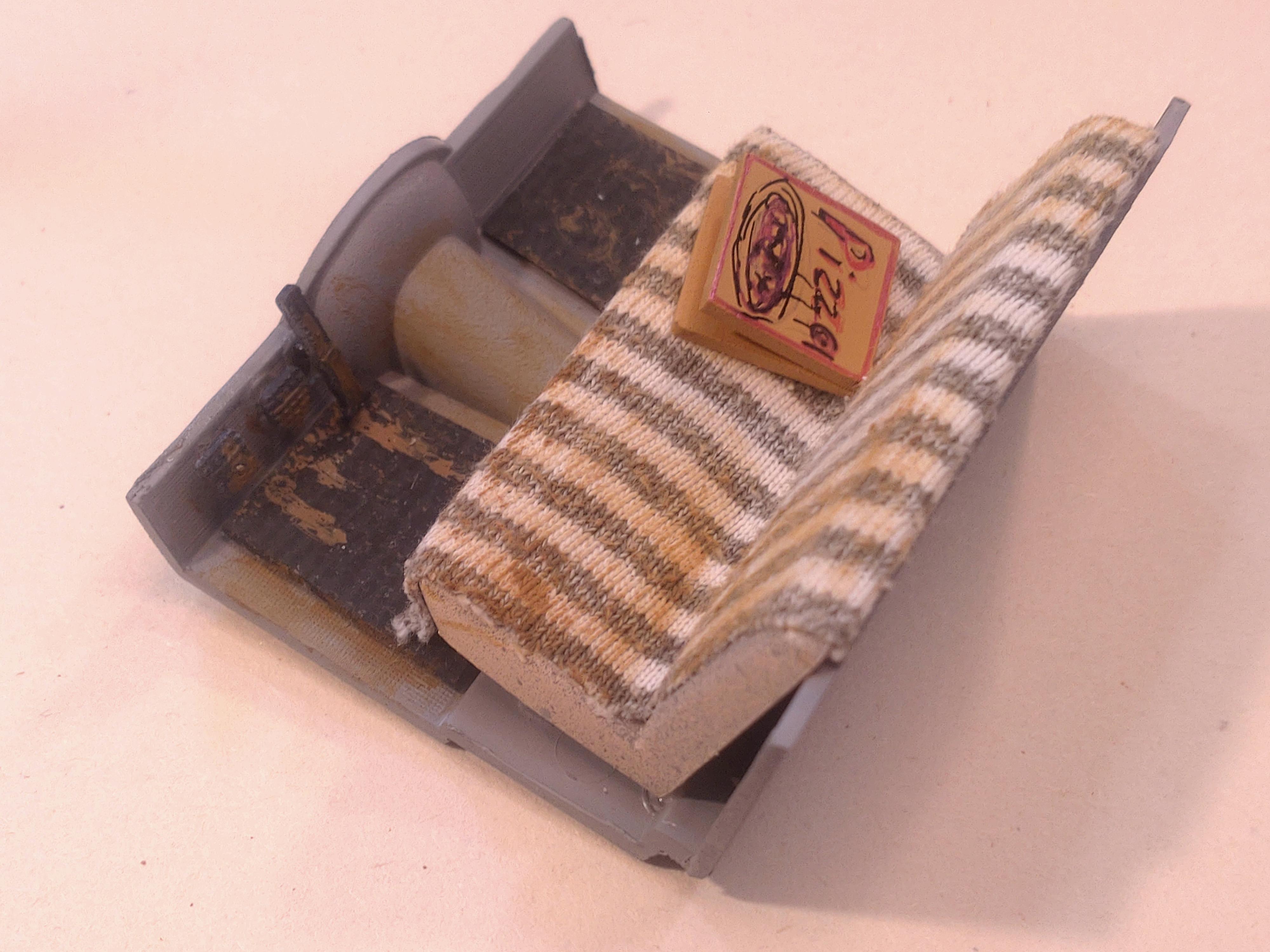

  16. With some builds I like to imagine a story or setting to match my build in real life. Especially if the 1:1 car could have a "story". In this case the owner is a gardener or farmer. His old pick up was handed down by his father or ever grandpa. He keeps everything running and in good shape, but would not spend a dollar on the looks. Neither on the outside or the inside. Of course the interior is in a messy condition. On the dashboard I added some trim around the glove compartment and a parking brake lever. That gardener is a coffee addict so he needs a big thermos can close at hand. The bench is all run down. Covering the holes with an old blanket must do and that has gotten quite dirty itself. From his last lunch on the job a old pizza carton is still left. The floor is covered with rubber mats I cut from a thin place mat. The door panels are enhanced with fabricated handles. Everything has received its fair amount of patina. The dash and the floor with the bench are attached and the gap at the rocker will be filled in the end after connecting the body with the chassis. I´m not so happy with the detailing of the suspension with this kit. The springs are non existent and the shock absorbers look too crummy. I made my own shocks with styrene tubing and brass rods. The springs are wrapped from 1mm aluminum wire, easy to bend and move into the right shape. The rear drive axle is connected to the chassis with brass rods. Painted flat black, they hardly show afterwards, but keep the axle in the correct place and will hold the weight well. The shocks have received some patina and the spare wheel is mounted. The parking brake lines are made of thin jewelry cable I found at a crafts store. The pulling part is crafted from 1mm brass tube and styrene rod. I connect certain small parts with wire pins. I was one day tired of messing my models while gluing the door handles and mirrors. Things go wrong so easily. Now I drill the parts 0.5mm and stick them on brass wires. I can now determine the exact point to which I want to attach them and then glue with white glue. No more slipping or running. Here are those parts attached. You can also see the half open windows on the door. The wheels have their share of patina and rust. And valves also made of 0.5mm brass rod. The bed door is connected and working well. I´m working on the engine now and hope to get done completely during the next 2 weeks. I will show up again! Best wishes, Andy

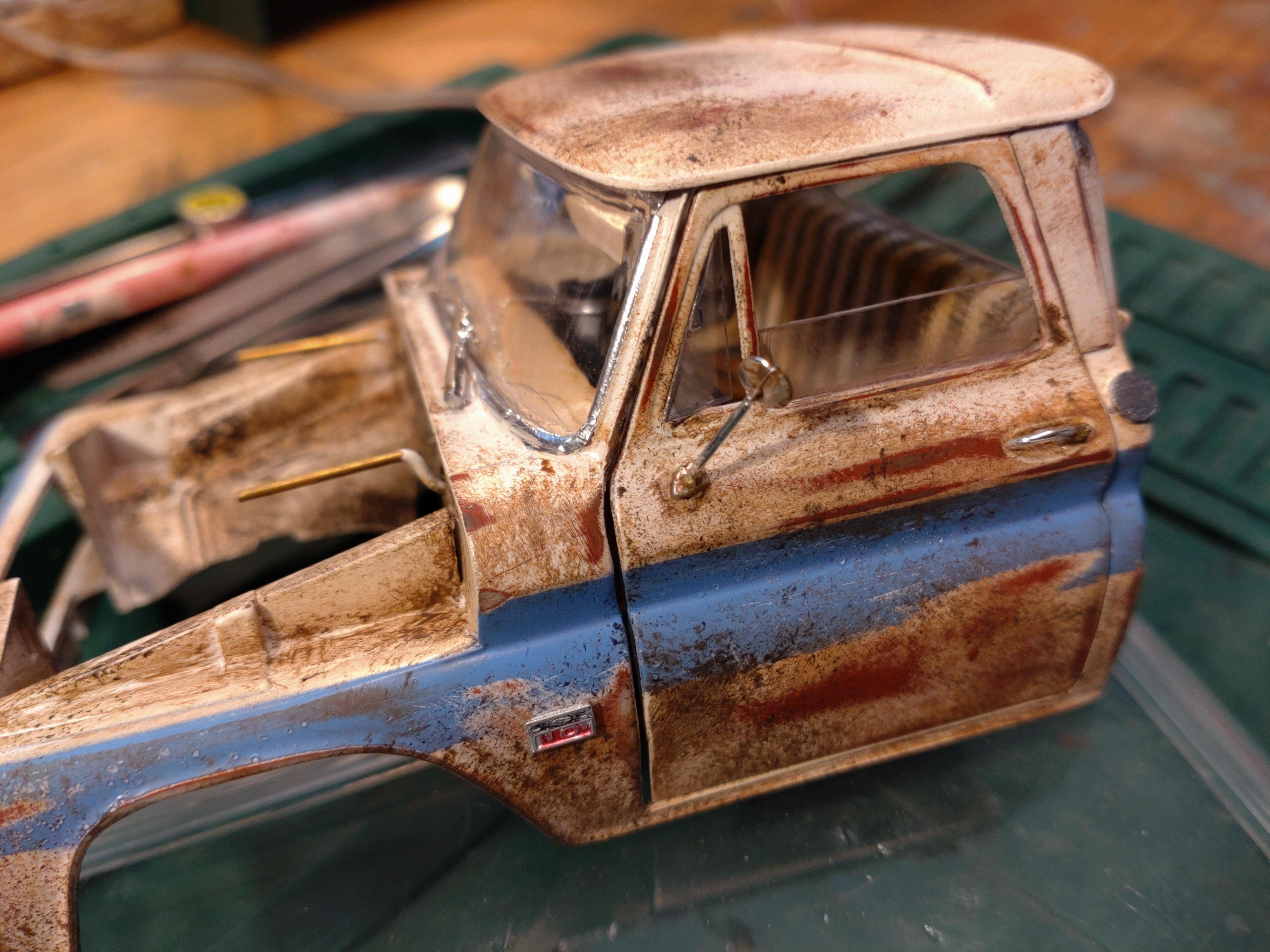

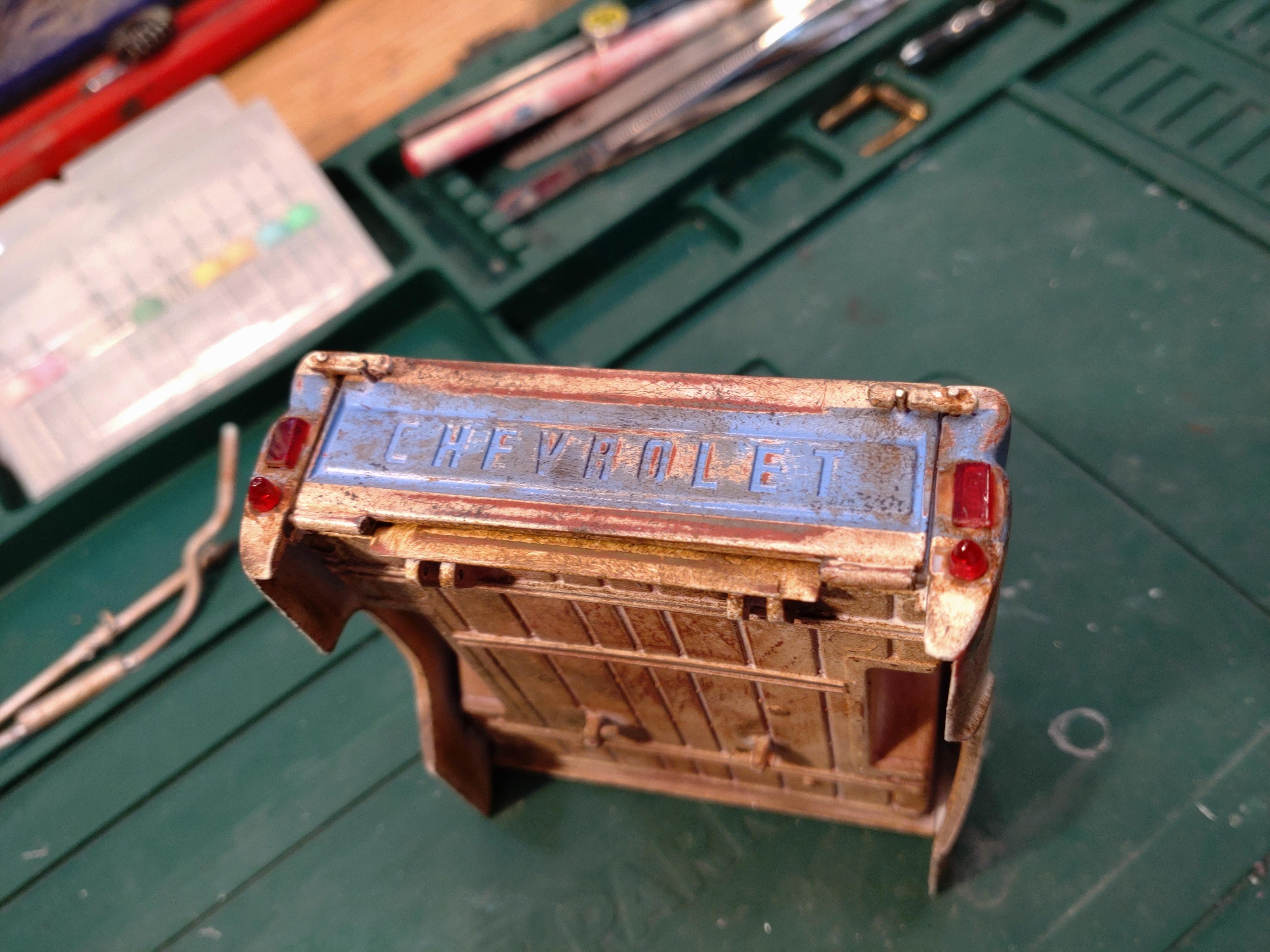

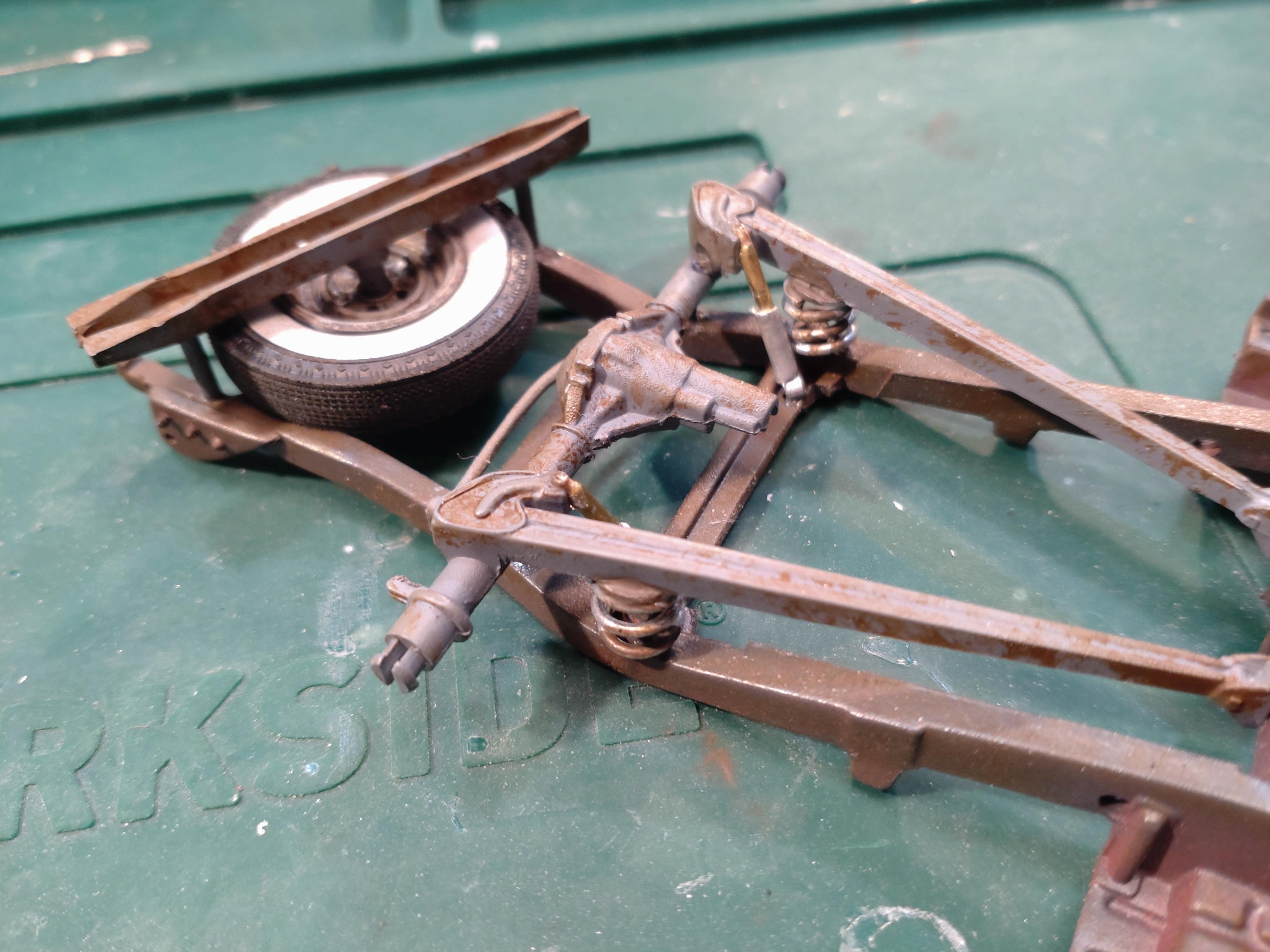

  17. It was about time to follow up on this build. Thanks for your patience. The mechanics were all done and I was looking forward to the paint work. Since this is going to be a rust bucket it always is exiting what the final looks will be. After fine sanding the body parts I sprayed a base coat of gray to check any flaws in my work, a bit of putty was necessary. Then a layer of rust brown to be covered by the off-white of the "original" car. Now it looked almost like the unpainted model parts again. To give the body a little bit of class I added a stripe of light blue to run around the the whole build. Now comes the messy part of sanding and finishing the body to get that rusty, dirty look. After sanding with 400 and 800 grit the body looked like this. Not so bad, and if one was in a hurry you could leave it like that. But it does look quite one dimensional. To treat the parts with rust and grime I use a piece of ripped off foam from an old cushion. You can tear it into shape to match your needs. I put small drops of the effect paints on a saucer and take up only a minimal amount with the sponge. I start with the rust and move on to the darker paints. if I apply too much, I can wipe it off. The rougher the foam, the better the effect. After several steps of dabbing the parts look like this. Topher wanted some more input about the doors. The trouble with doors is that they tend to hook up at the the hinged gap. Straight sides are easier to open, but folded contours like on this C10 make it worse. On all doors I sand the edges as thin as possible and also on the body line where the doors are hinged. Thin meaning almost blade thin. This is risky, because you don´t want to widen the gab by mistake or having to add sheet styrene to repair. But this will reduce that grind exceptionally. You might just need to pull the doors out a tiny bit. The bed floor is covered with a checker plate sheet aluminum. I found this at a model fair and knew that is was perfect for my C10. It took a while to make it fit well. And because this is a commercial dump truck it received a decent amount of dirt residue to reduce that shine. Next time I will show the progress on the interior and chassis. Thanks for watching!

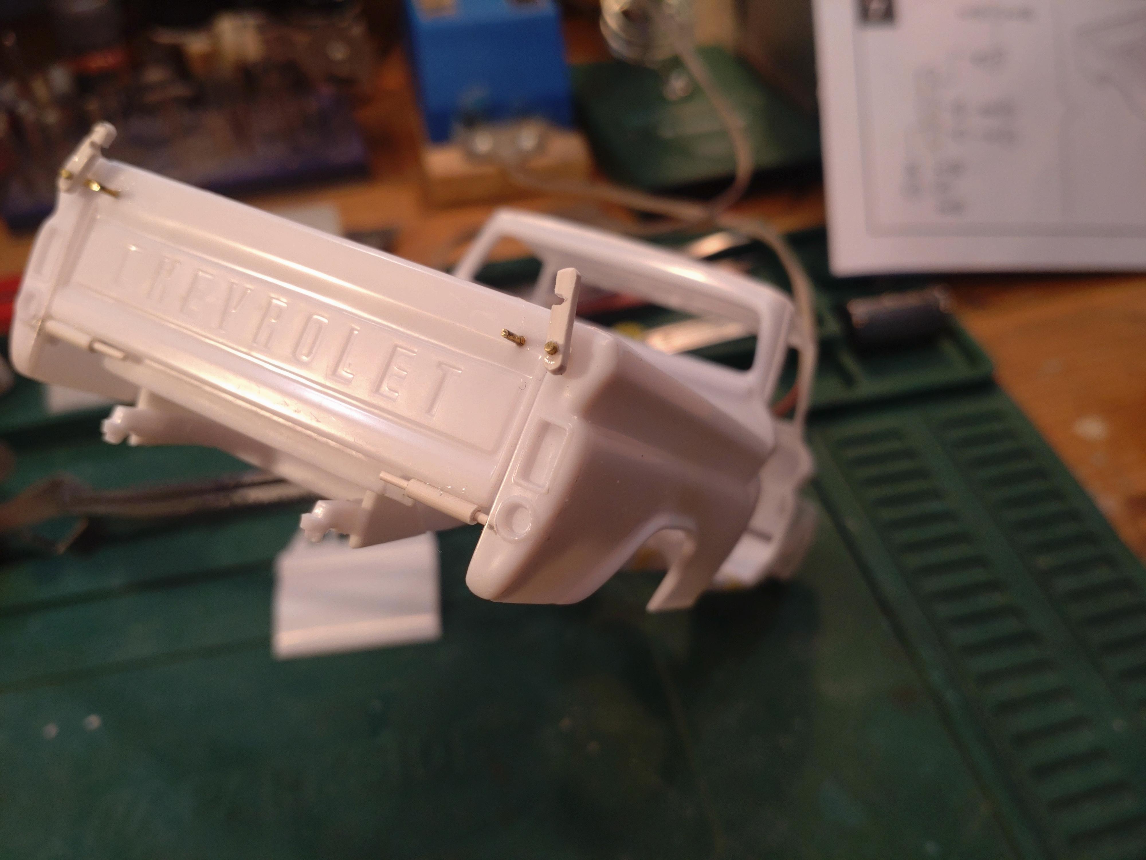

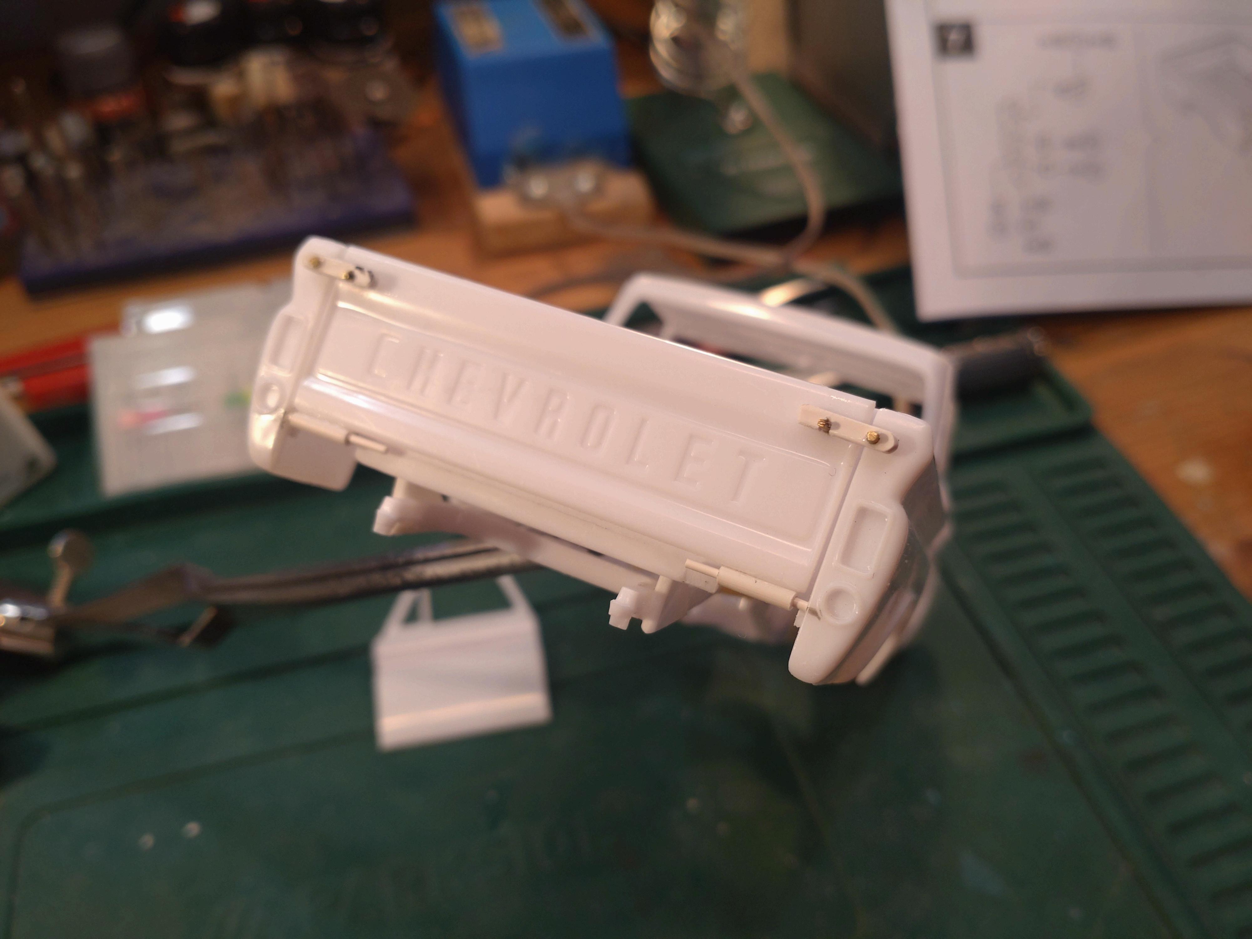

  19. Hi David, thanks for the response are your knowledge! Seems I am on the right track. Actually I used all the impressions that I have picked up in my life from constructions vehicles and such. Not that I have anything to do with that business wise, I am just a curious guy that gets impressed by BIG things. The tailgate, well, I just thought it would flap down and let the earth slide off. I don´t know if chains or such would be necessary to hold it.

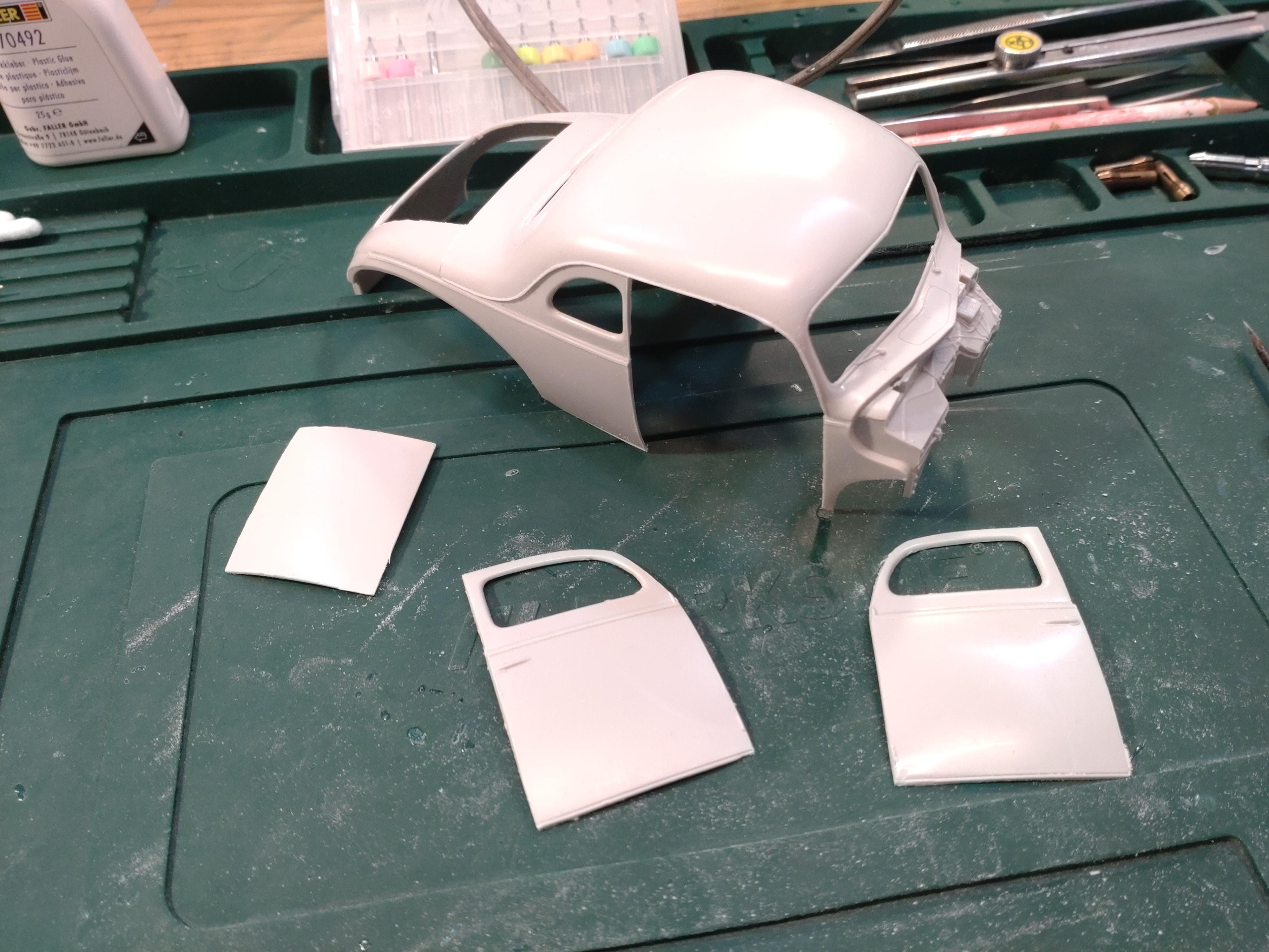

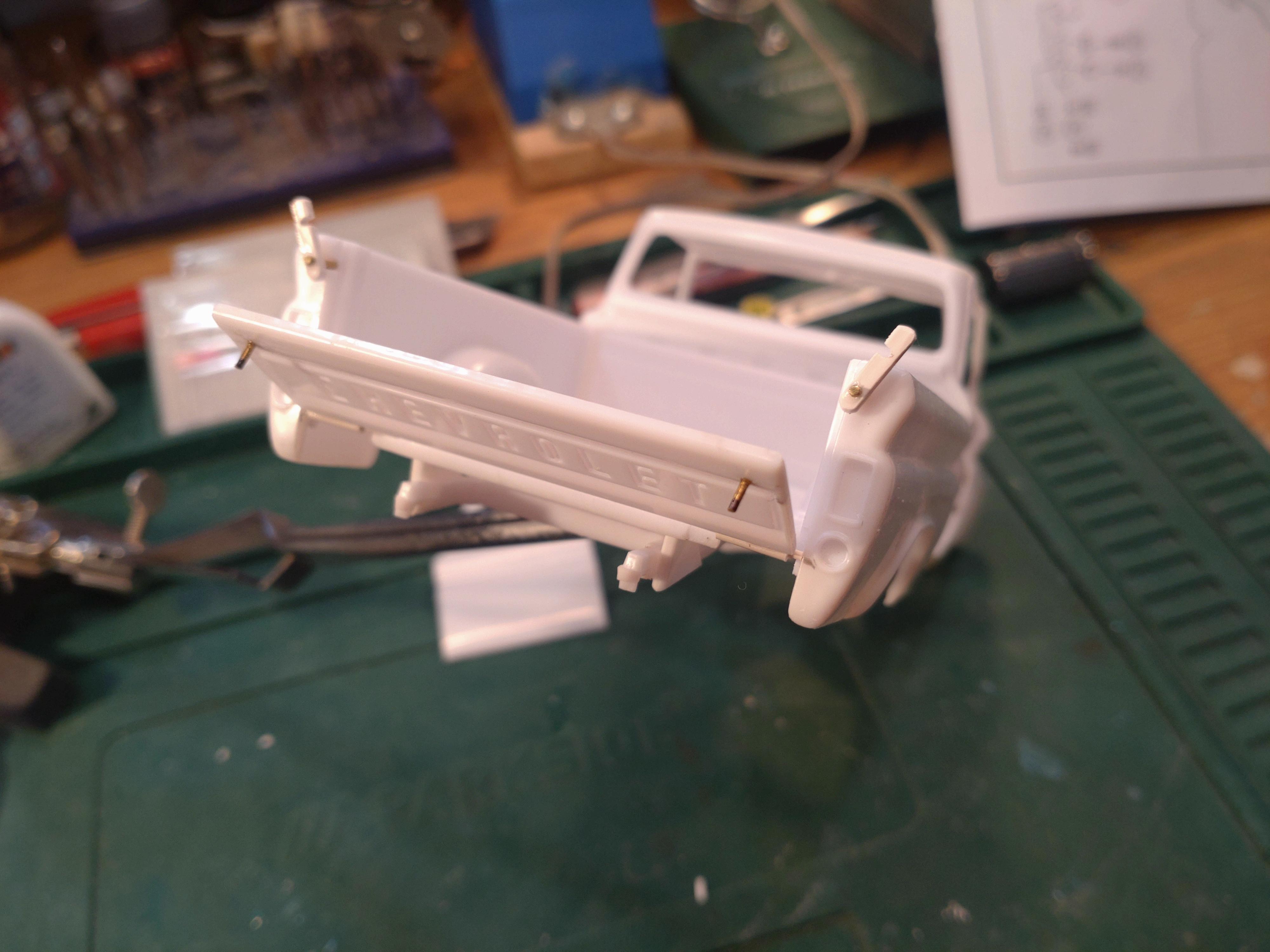

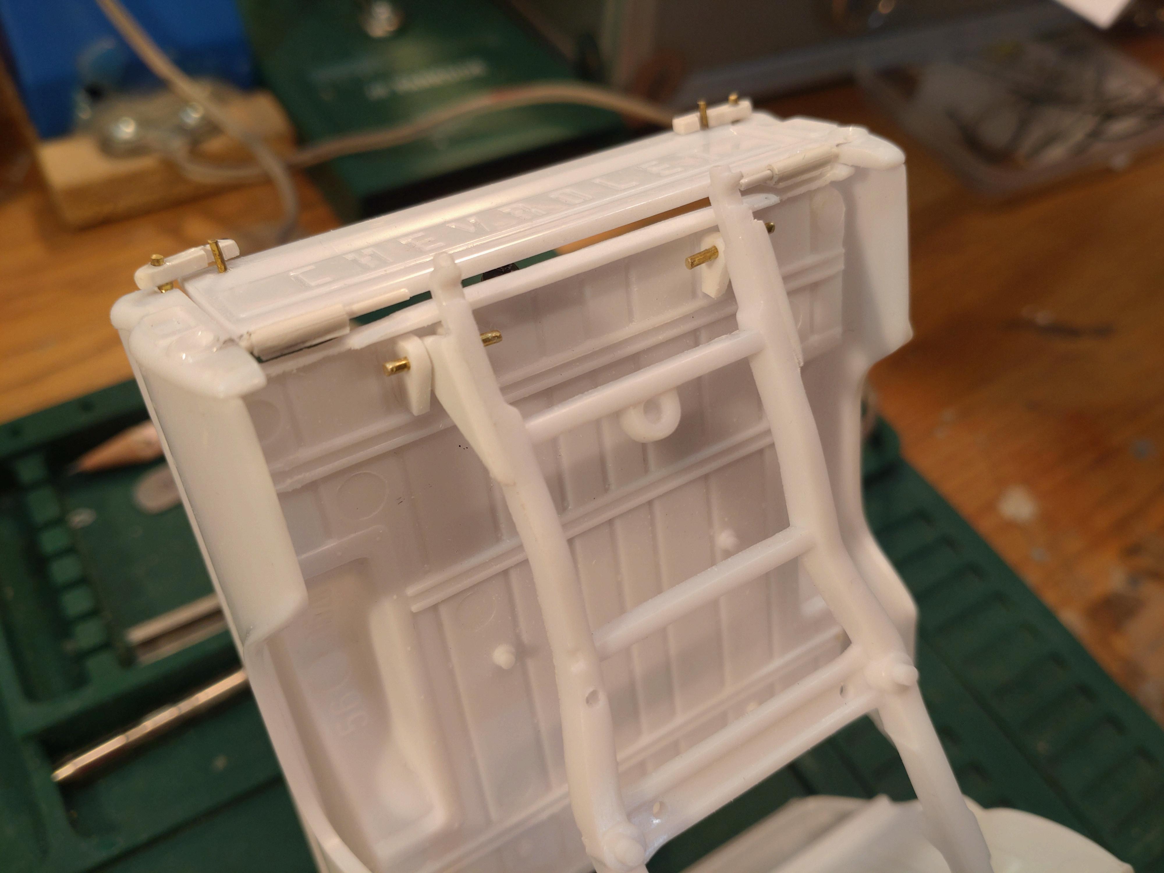

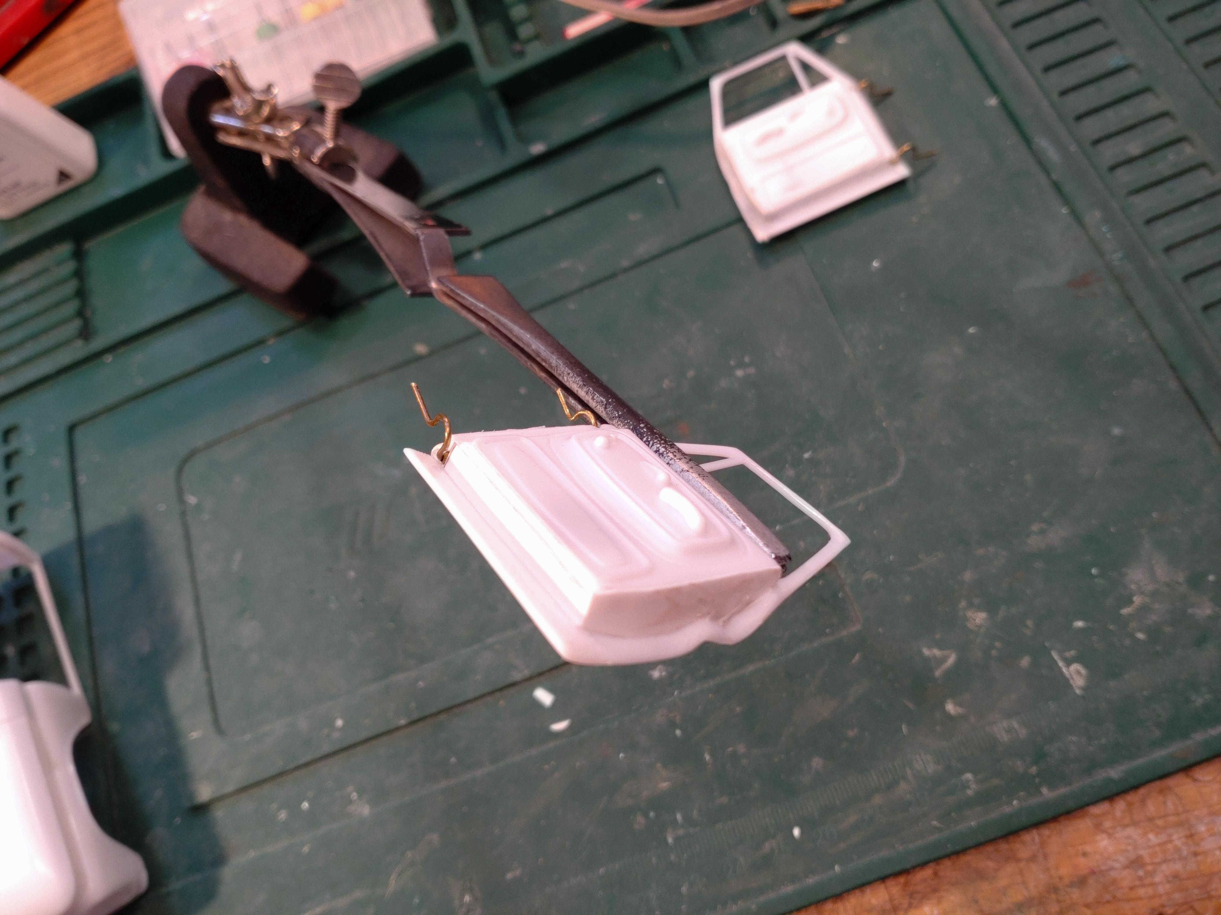

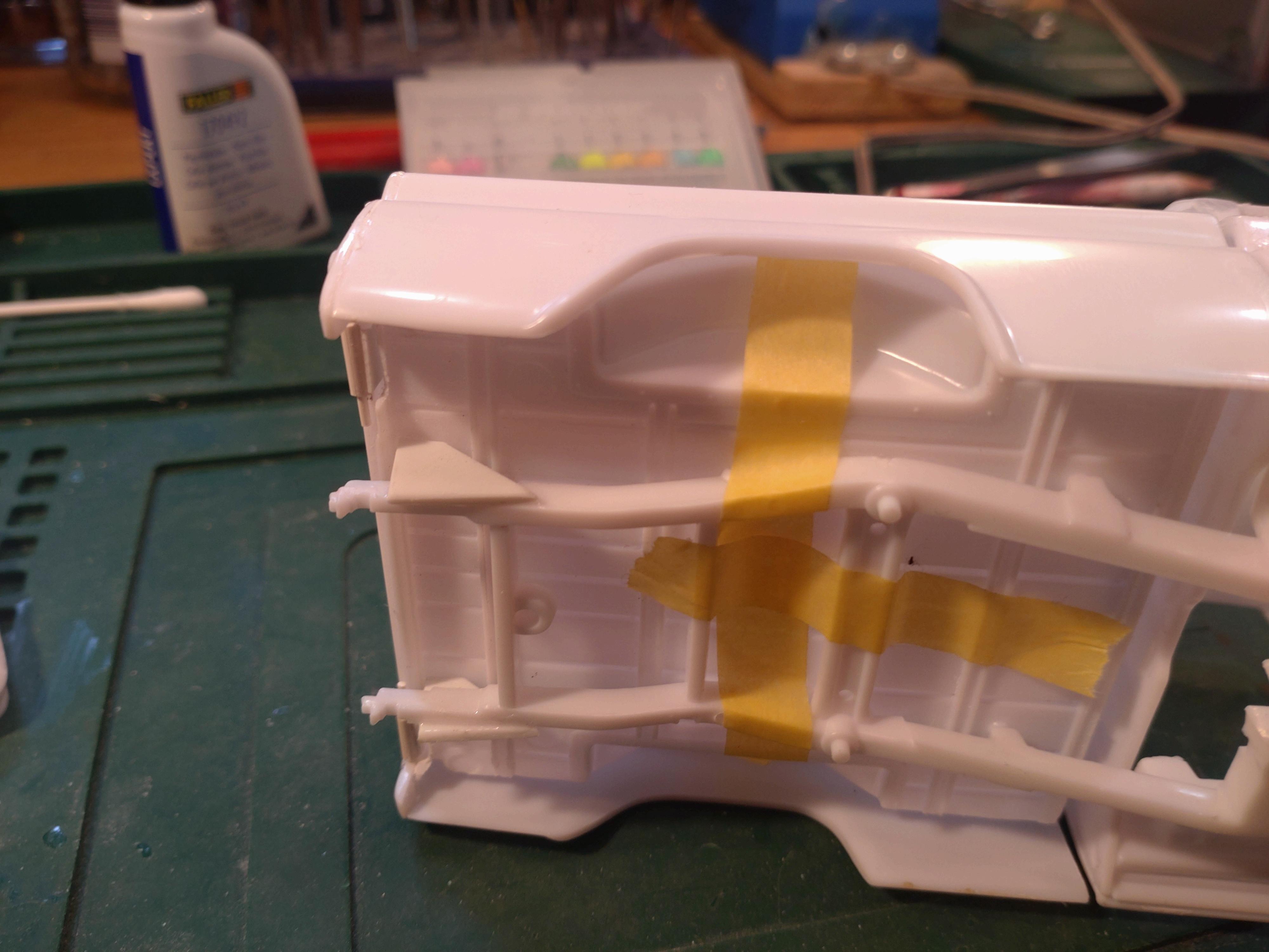

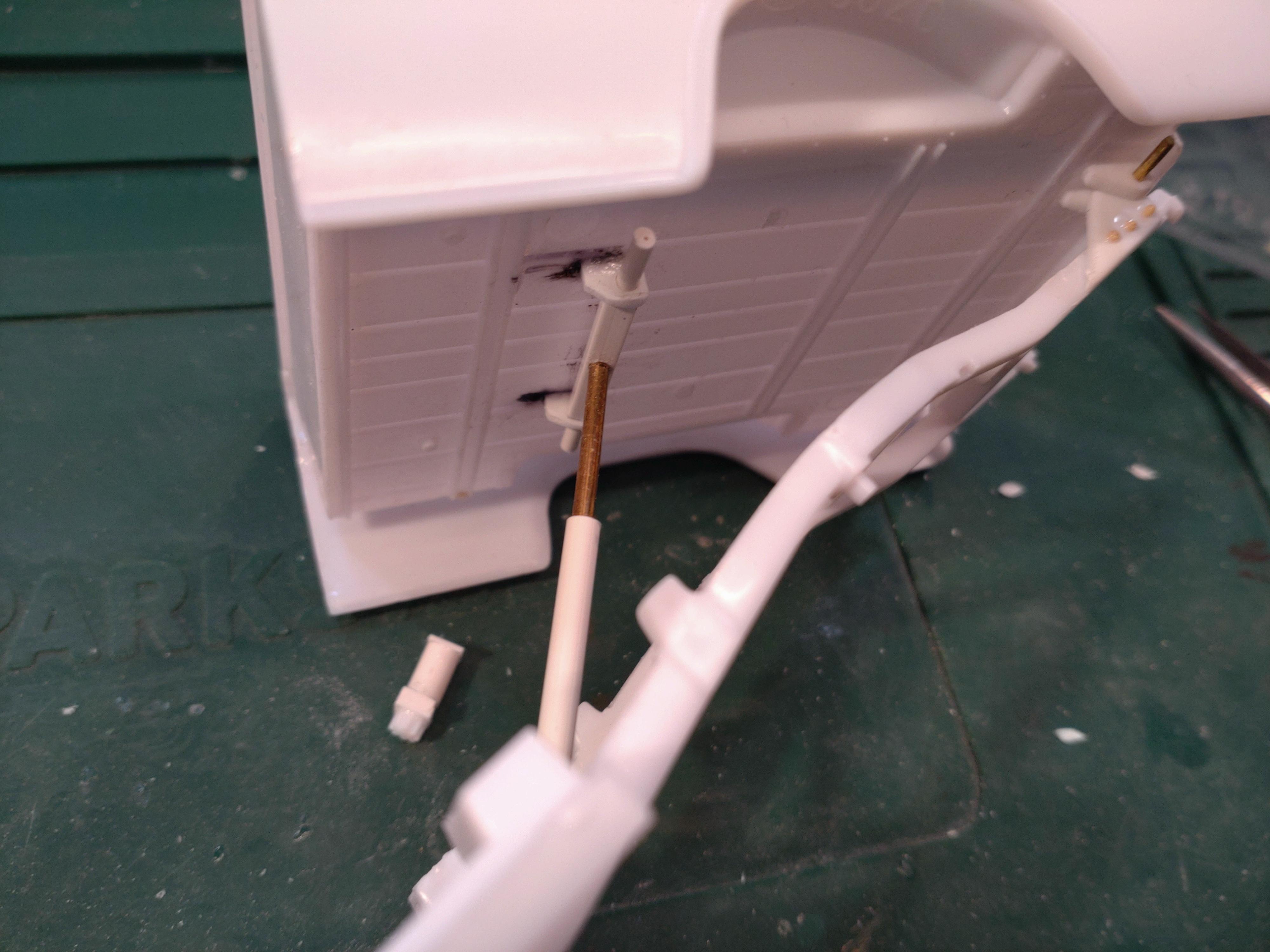

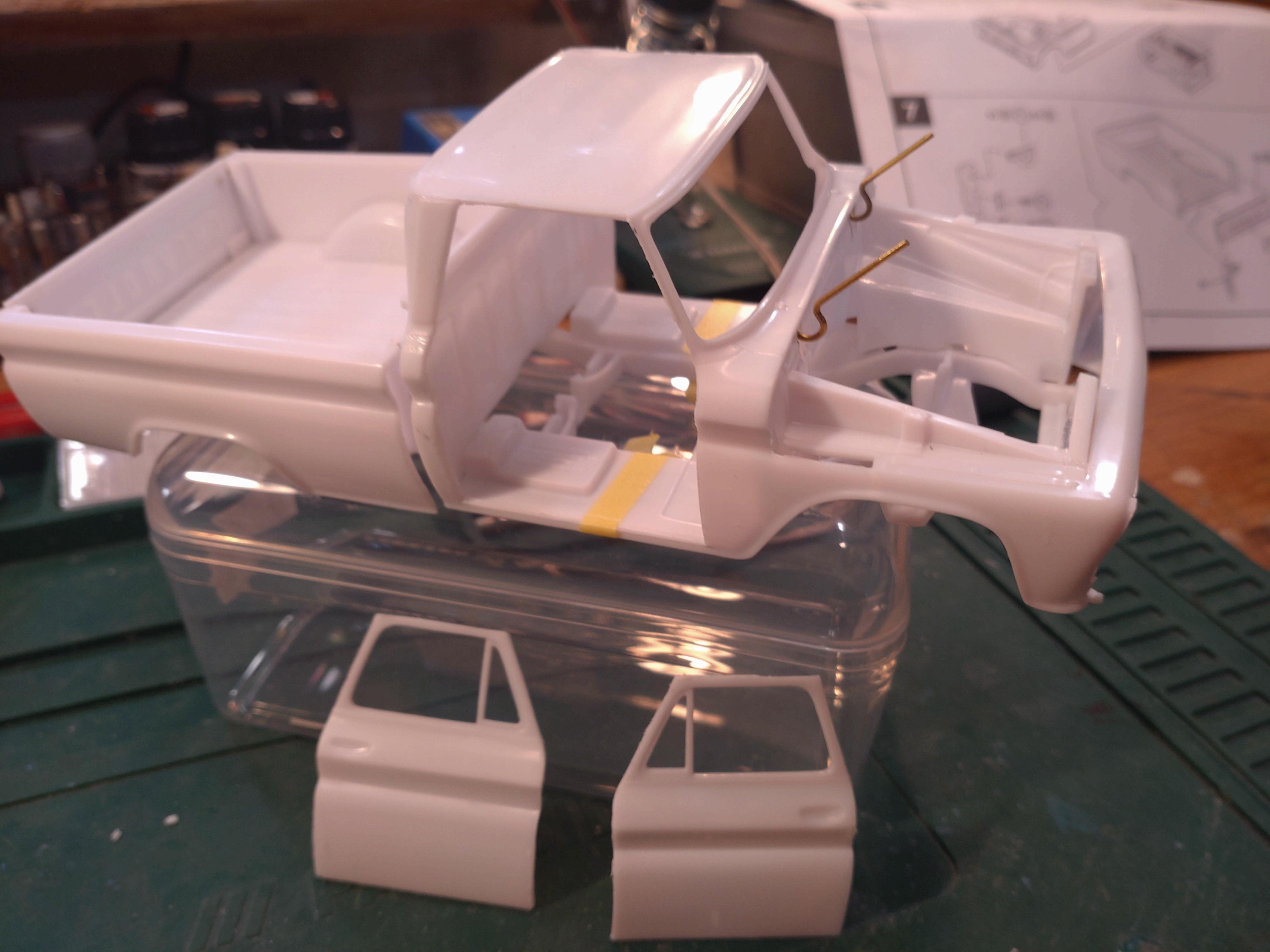

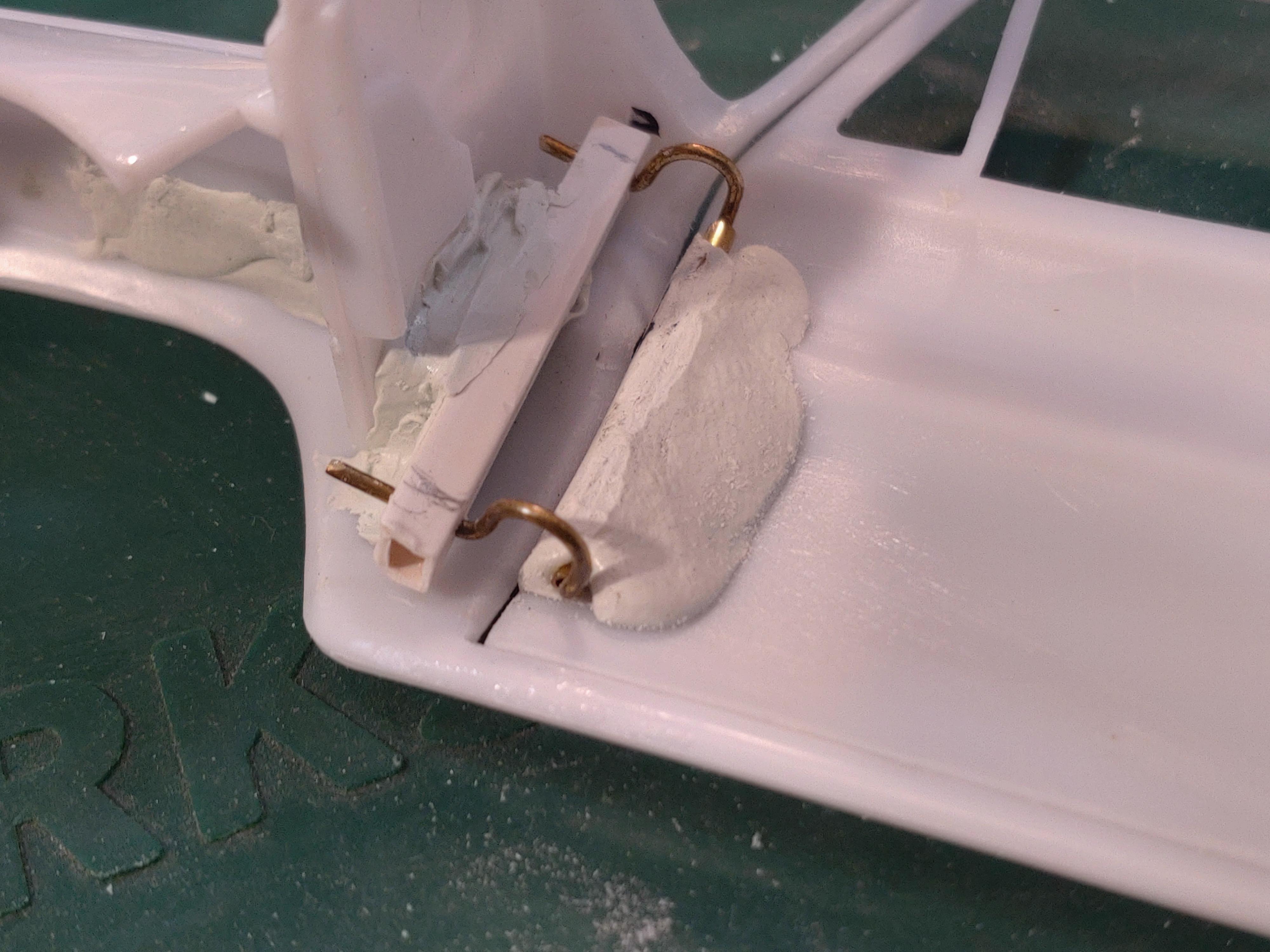

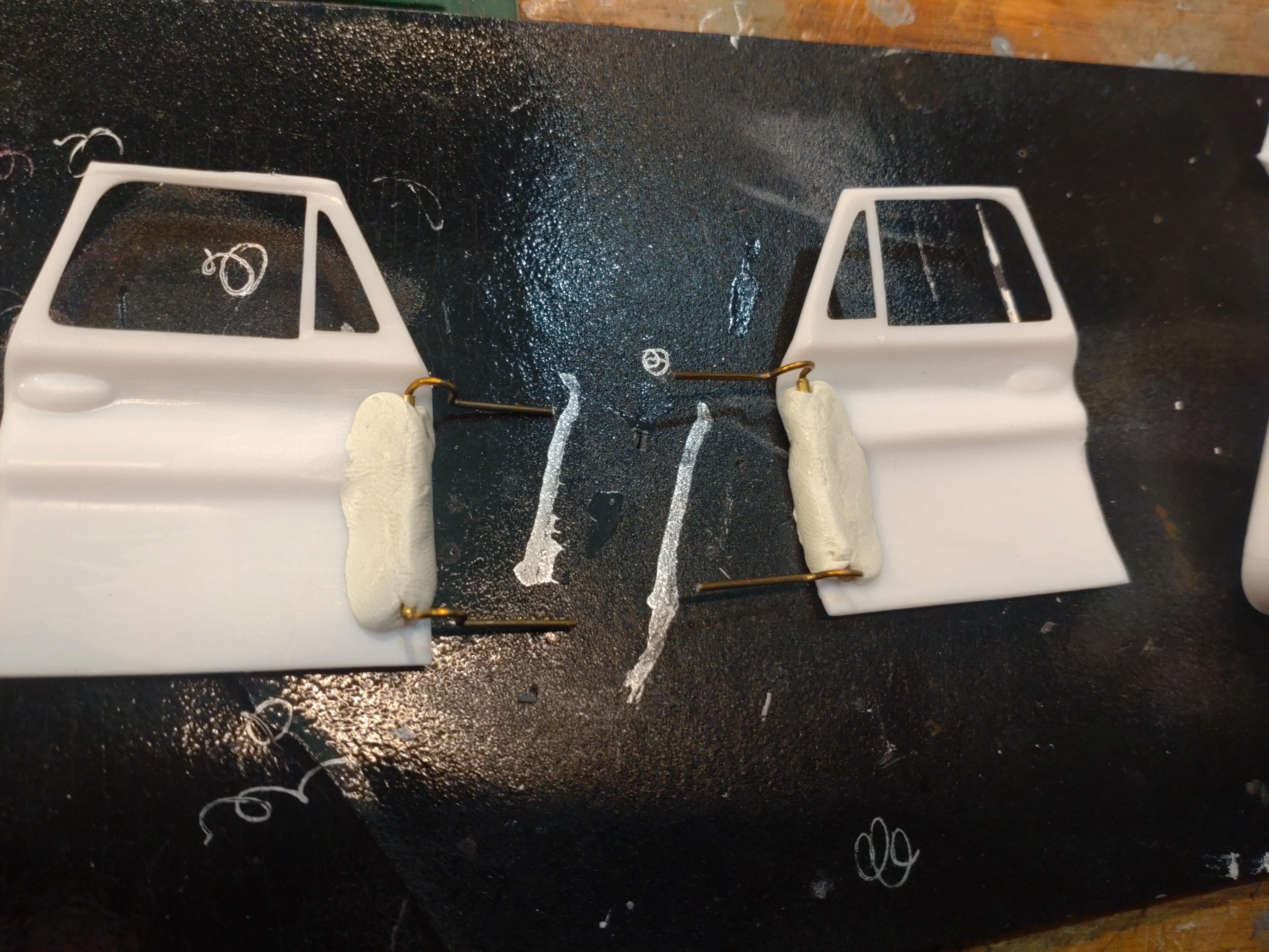

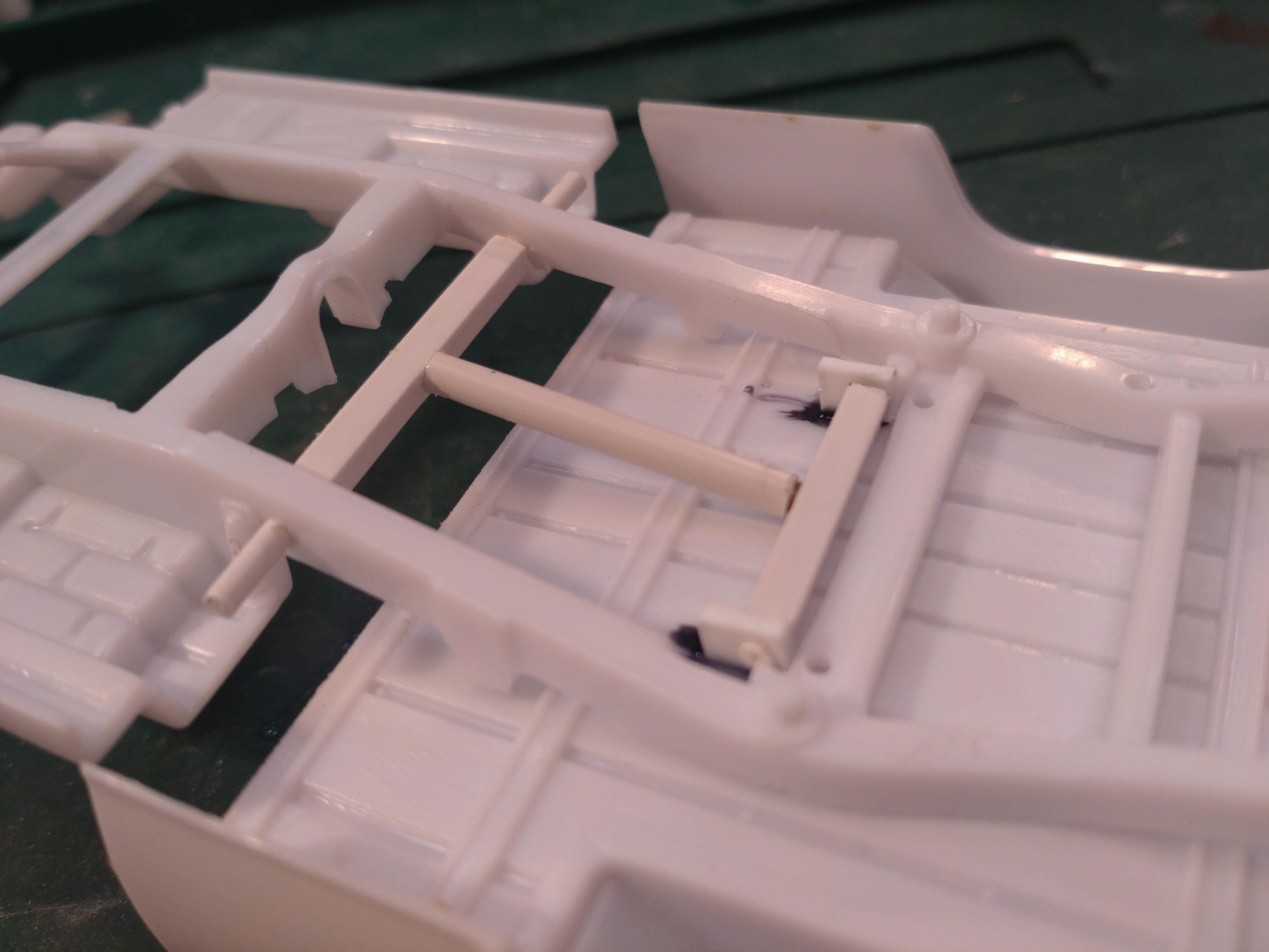

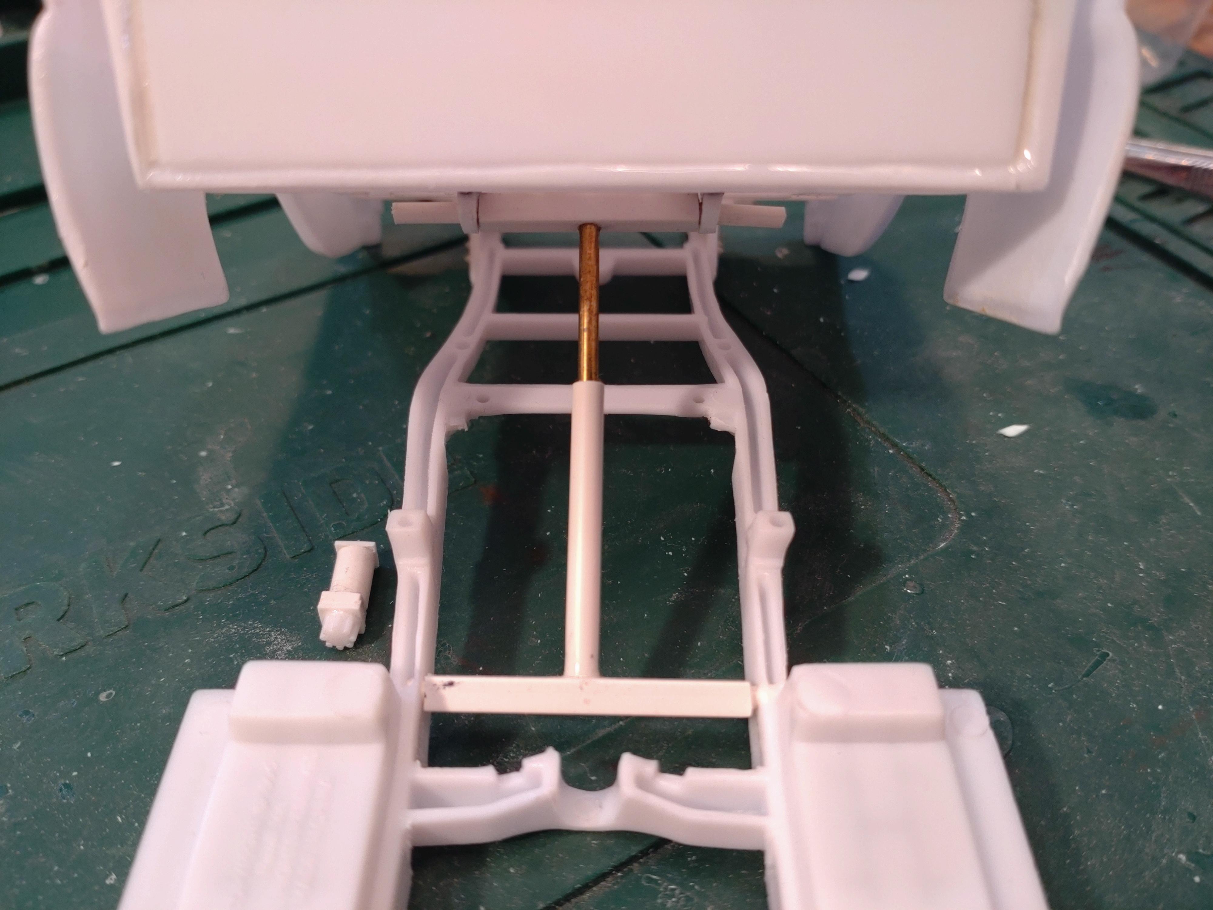

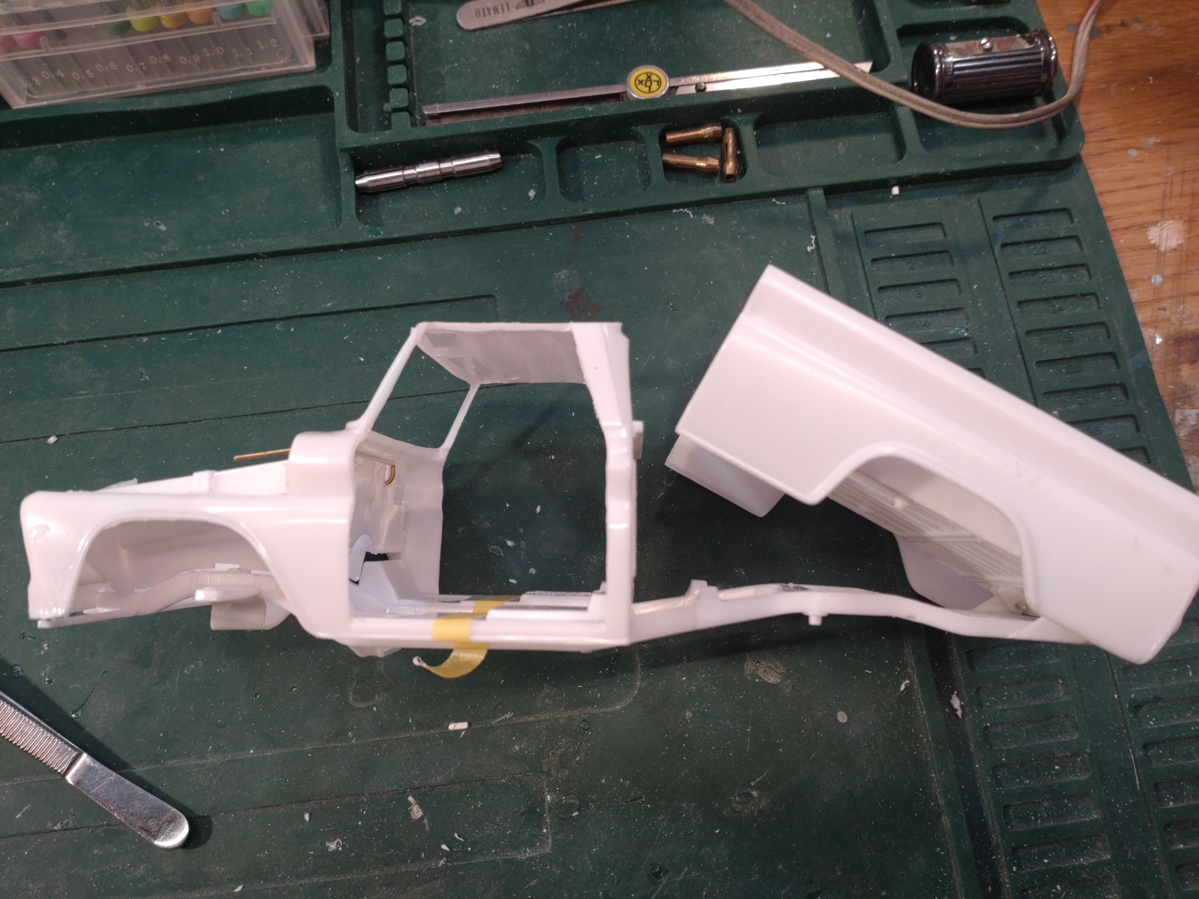

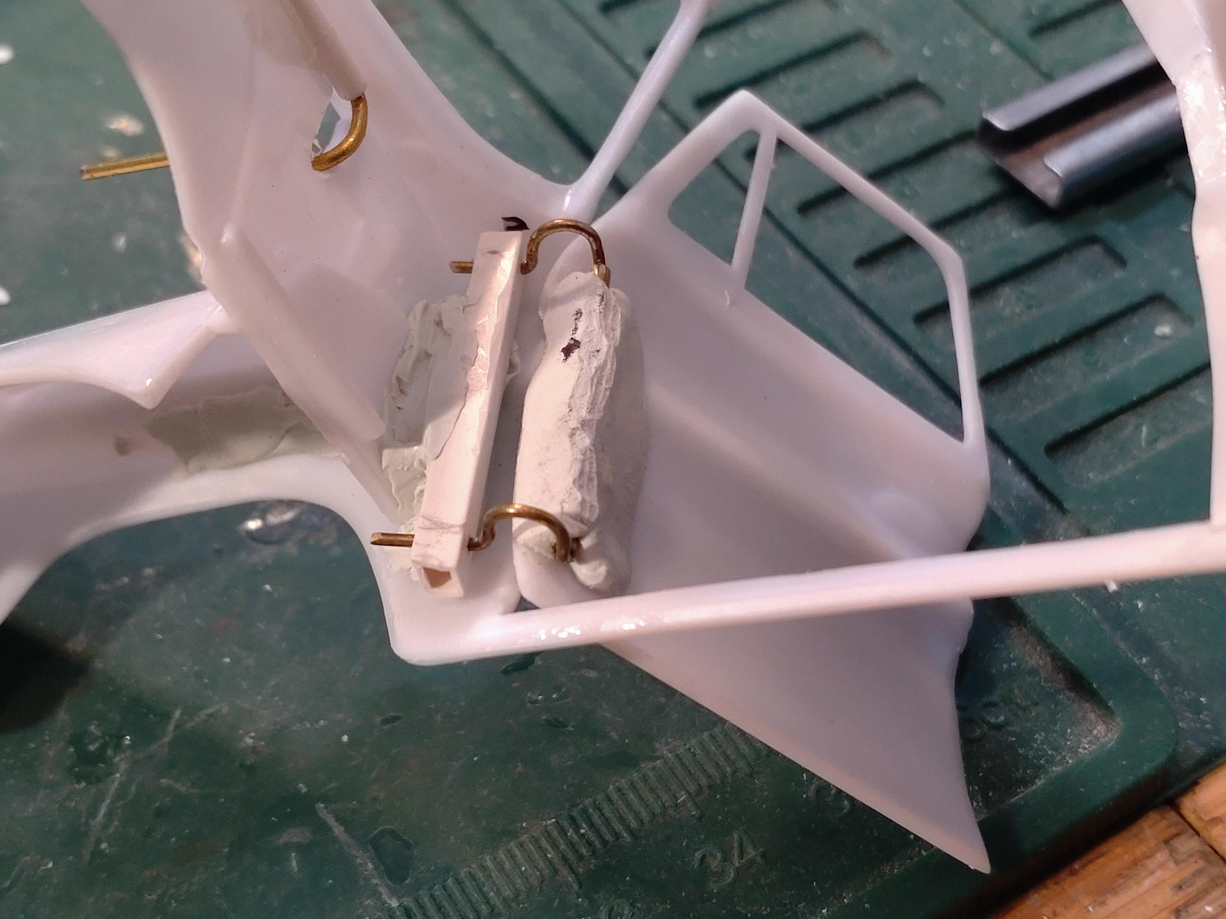

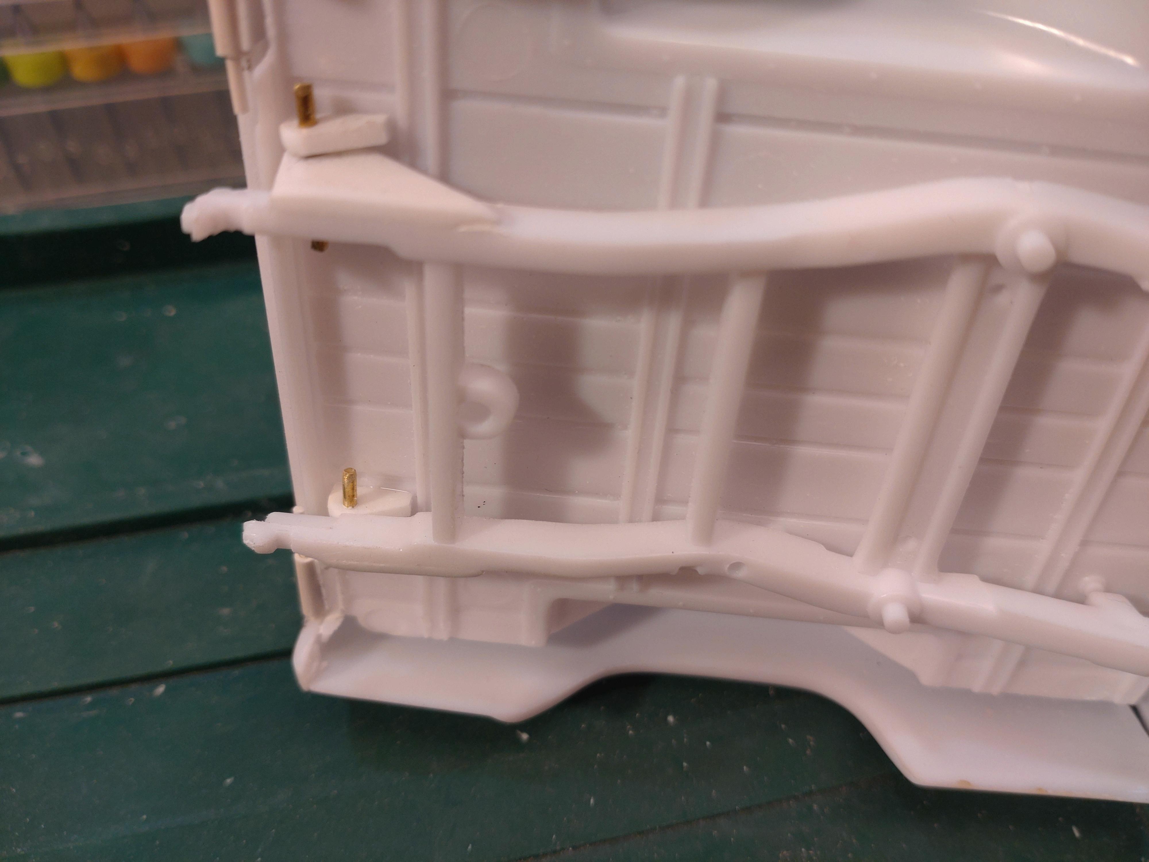

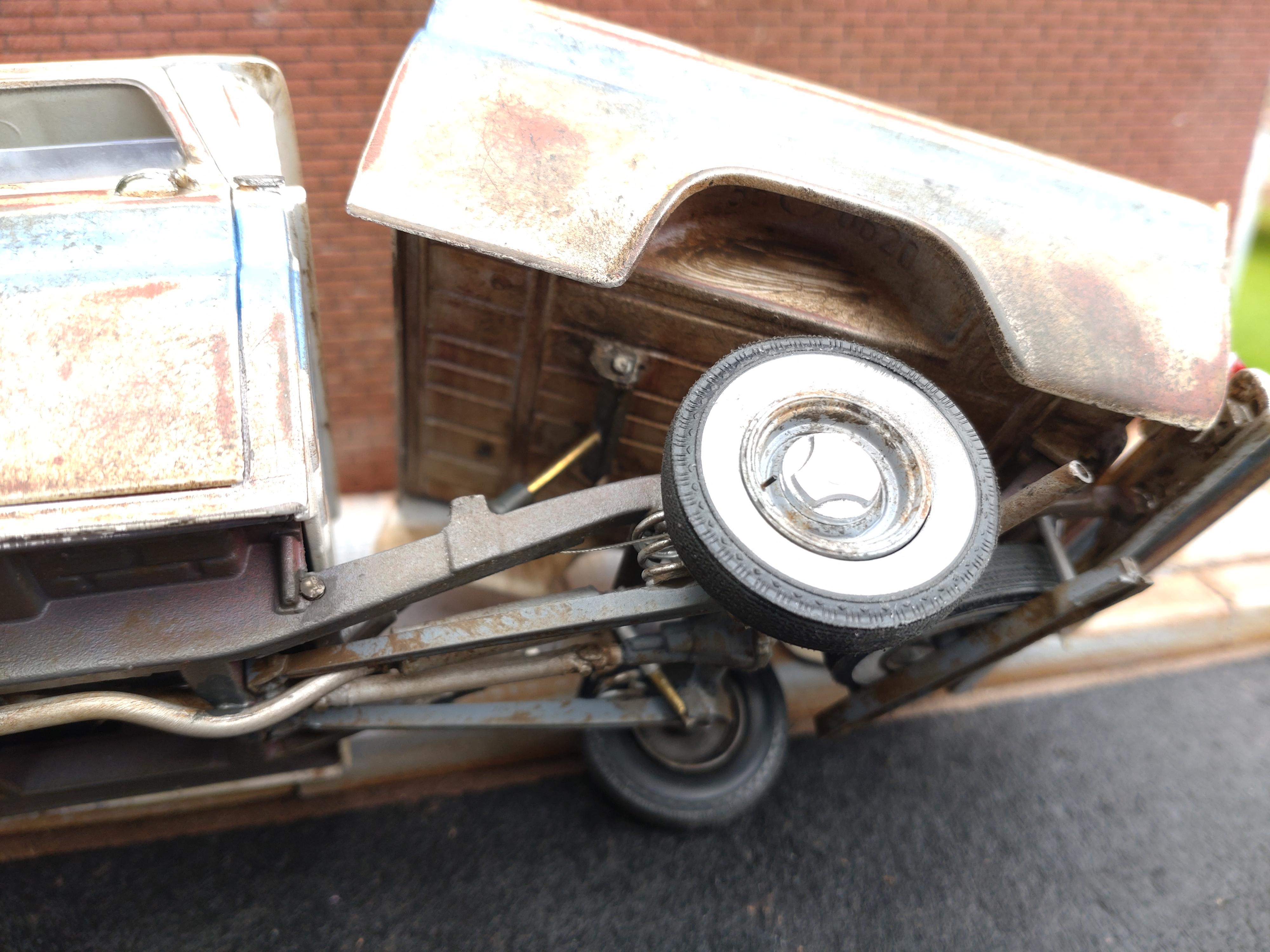

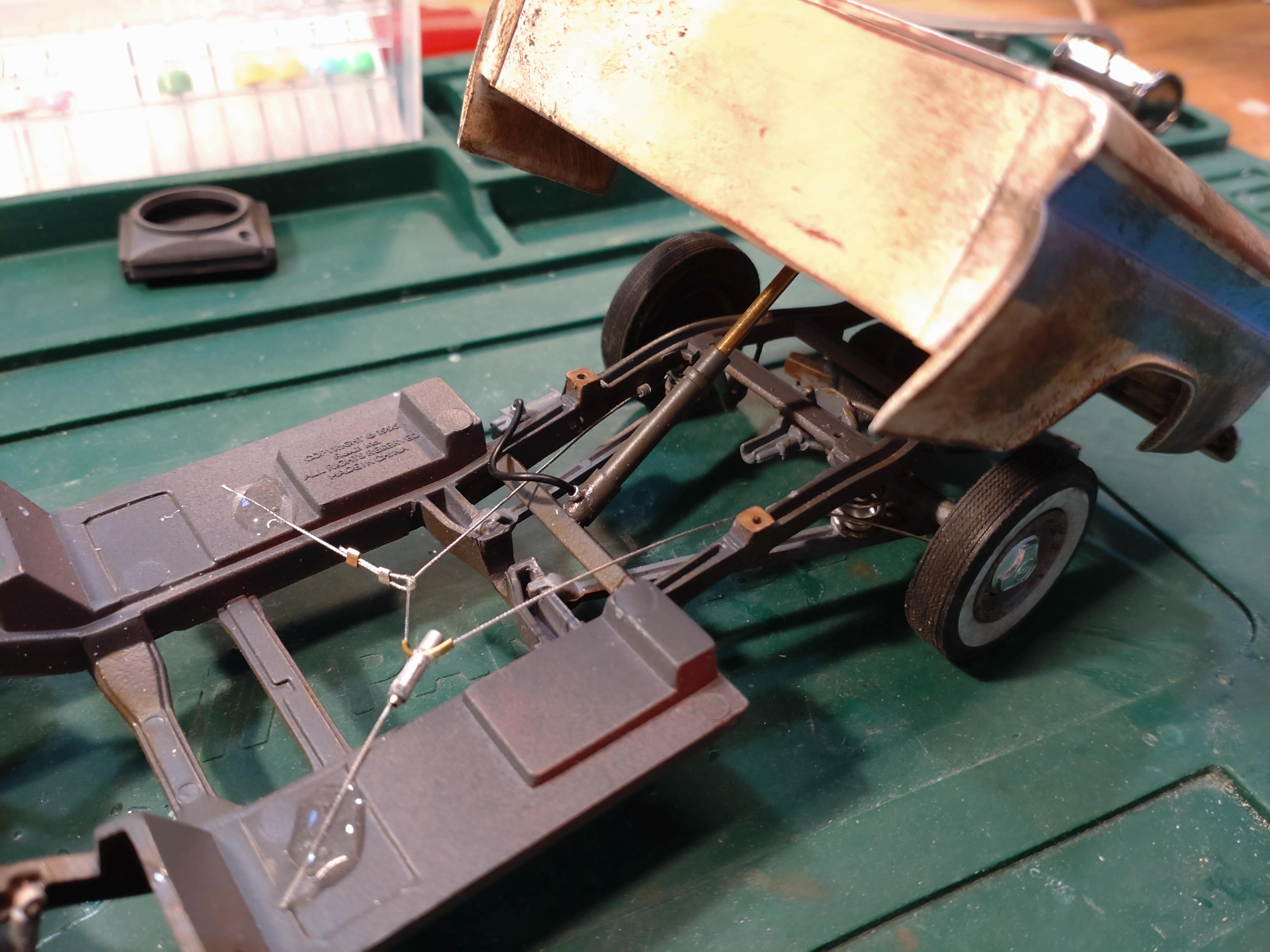

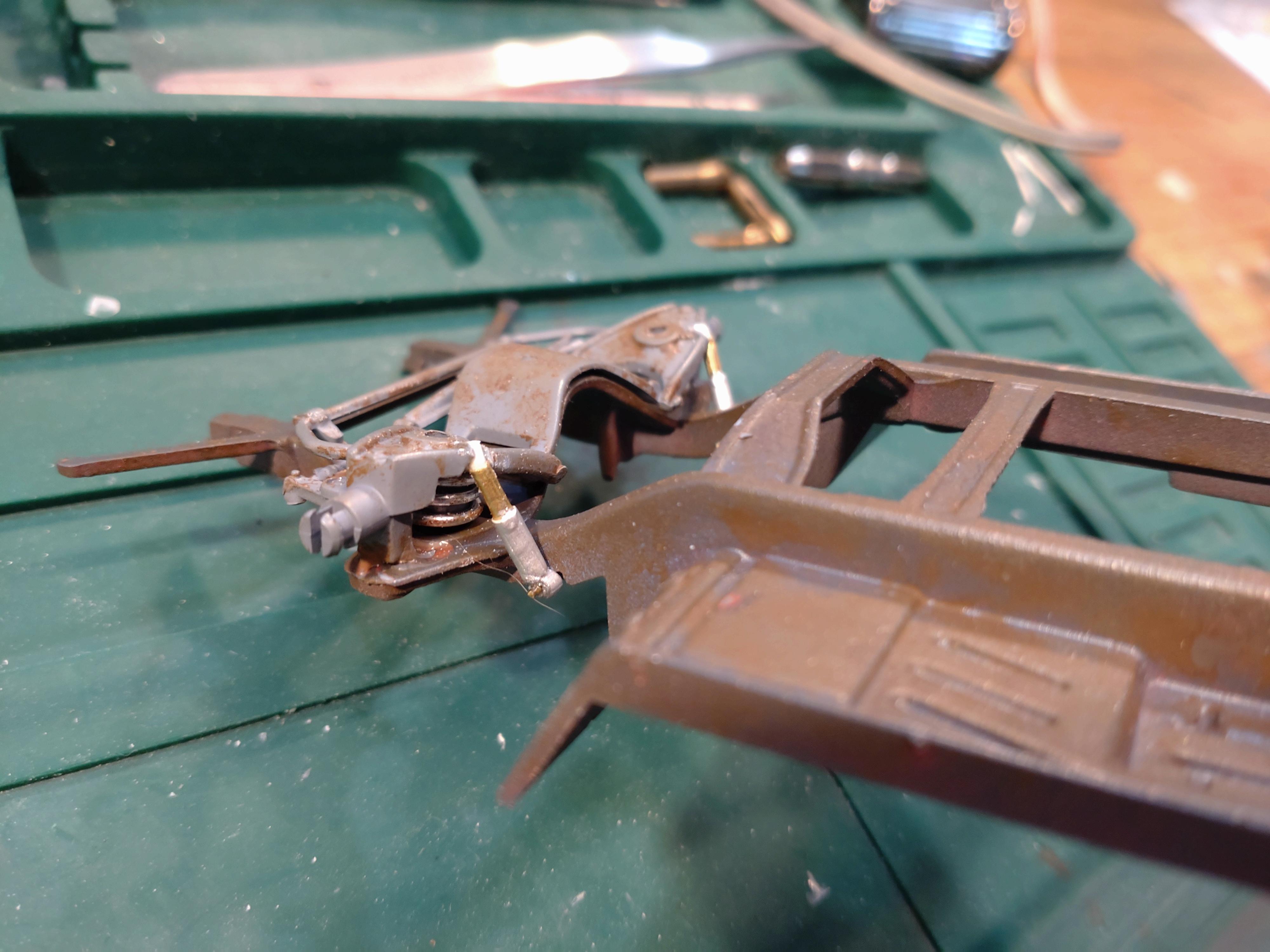

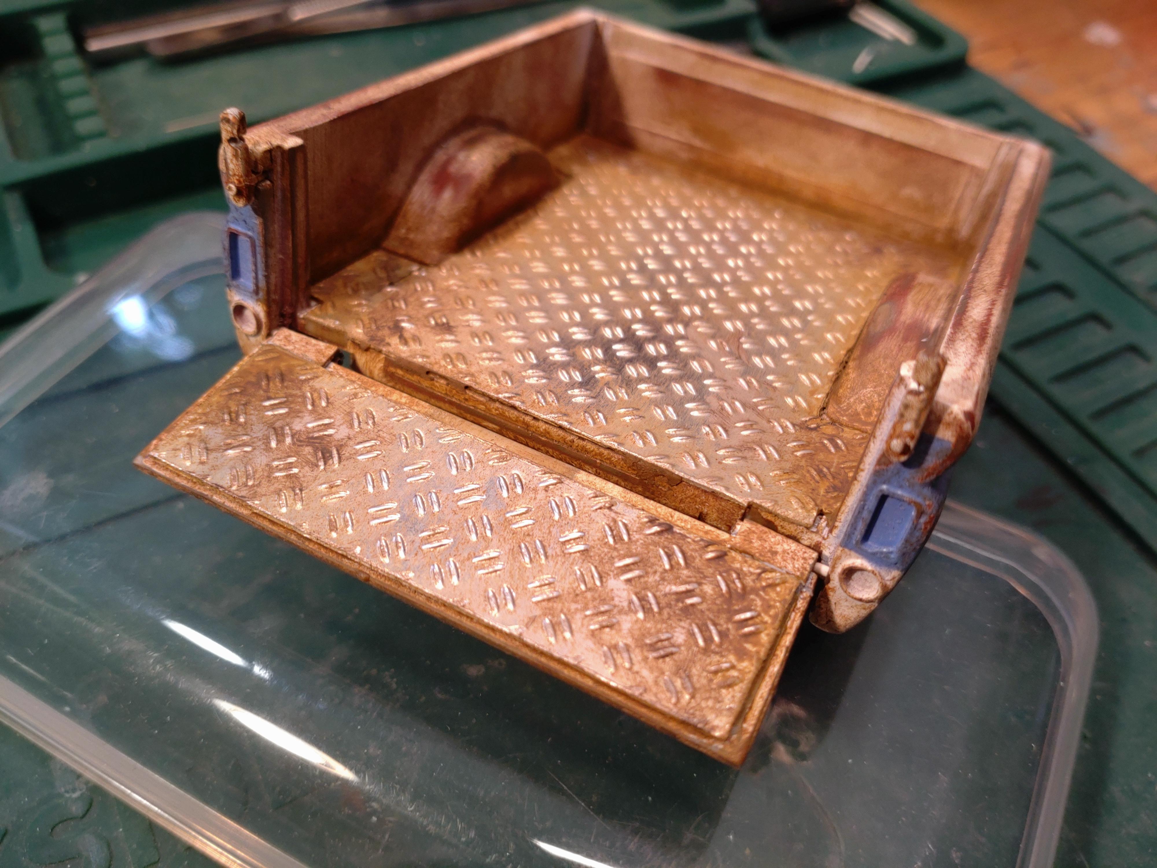

  20. After building some glossy stock models and show cars I was in the mood to create something "dirty" again. No, nothing X-rated; a pickup with a visible rust attack and heavy patina. This old AMT kit comes quite fine for that, because the molding isn´t very clean and I am not going into a shiny low rider paint job. I do want to spend some time on some special details though. Hinged doors and hood have become a standard for me. But my best idea was to get the bed engineered to rise and tip the gravel, earth, junk or whatever onto its determined area. I have refined a special technique to open spaces on a model body. I used to cut with blades, micro saw or a tiny electric circular saw. It did the job, but it always left a lot of extra work to clean the cuts. Cutting with a scalpel or cutter knife also meant risking my finger tips. By chance I have a small awl which I sanded VERY sharp and with this tool I scratch out my doors, trunk etc. It works quite fast and the result is great. The gaps all have the same width and running down the imprinted gaps on the bodies is easy. The tailgate should drop down like in real but also keep in place like a real one. The gate itself is connected to the bed with 1mm styrene rods in 2mm tubes. Making the latches turned out easy, but I did have to get the parts drilled and connected to the precise spot. The hood hinges had to be attached to the firewall in a early step. There is no way to get that done if you want the paint job to look good and let the hood really close exactly. Now it´s time to find the sweet spot for the bed hinging. Since I had no images to copy I had to think about how this could look like in real life. The bed has to lift up without scraping the cabin or knocking the bumper (which I could sacrifice, if necessary...). All the hinge parts are fabricated from sheet styrene and tubes in different thickness and diameter. I hope you can understand the steps I took to get the hinge working. At this step, all the pegs are still extra long and the engineering is still in the rough. Sanding will be done before I go on to painting. Just getting the bed to tip didn´t satisfy my ambitions, because I wanted a "real" look to the model. My pickup needed a lifting hydraulic system (well, a fake one). Now I had to build that system from scrap styrene and brass and find the right position to make it work. Here again I hope that the images explain how I did it. It would take too many words. The "lifting" setup is connected to the chassis frame, the "lifted" part with the brass rod is hinged to the bottom of the bed. That small part on the side will be the hydraulic pump, to be attached to the frame. This is my second build on which I have connected the door hinges with Tamiya epoxy putty. It will fill gaps due to curved bodies, you have plenty of time to fit to parts to the exact place and they will not slip anymore, and no epoxy glue will run and mess your build or jam the hinges. Just remember to rough sand the surfaces before gluing. Drying time is a whole day, but I have enough to do to bridge that time. After the putty is hard you can work it in any way. The doors will stay closed with the help of super magnets inside the panels and under the bench seat. Here you can see the flat magnet already glued under the panel, with the counter magnet to check on the other side. Double and triple check those magnet ends. I once had to rip a falsely glued one out of a seat and it fortunately went OK. The door sides are all closed and now the sanding and painting can start. But first I have to end my holiday trip. Can´t wait to get home and in my model "cave" again! Best wishes, Andy!
