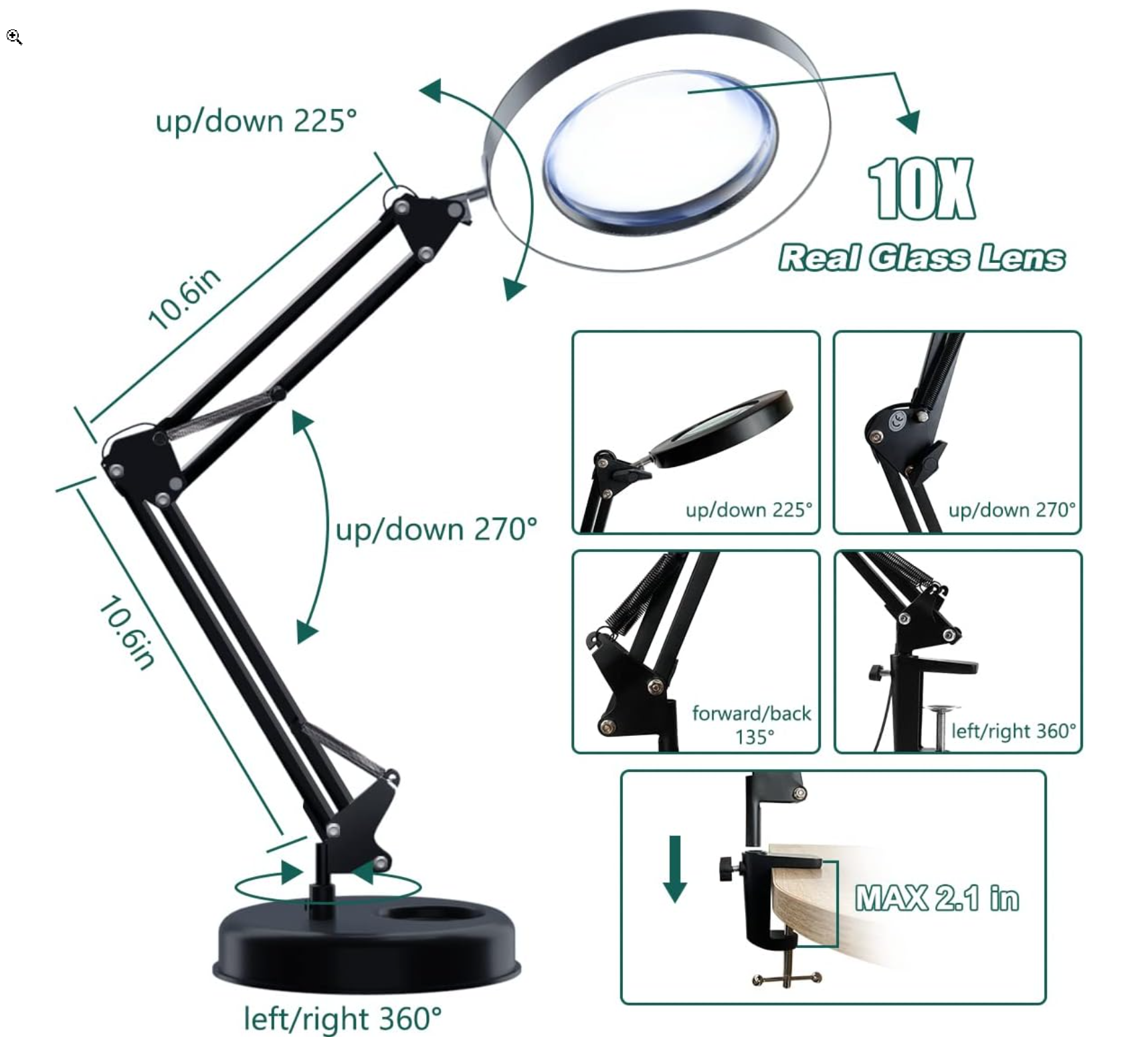

Thank you! Thank you! I tried a lighted glasses with magnifying lenses, just so cumbersome and was only clear at a certain distance.
Thanks, the tiny little rivets are a lot of work. This thing I think was my best purchase ever for scale model building. Just saying... I couldn't do it without a big magnifying glass.
