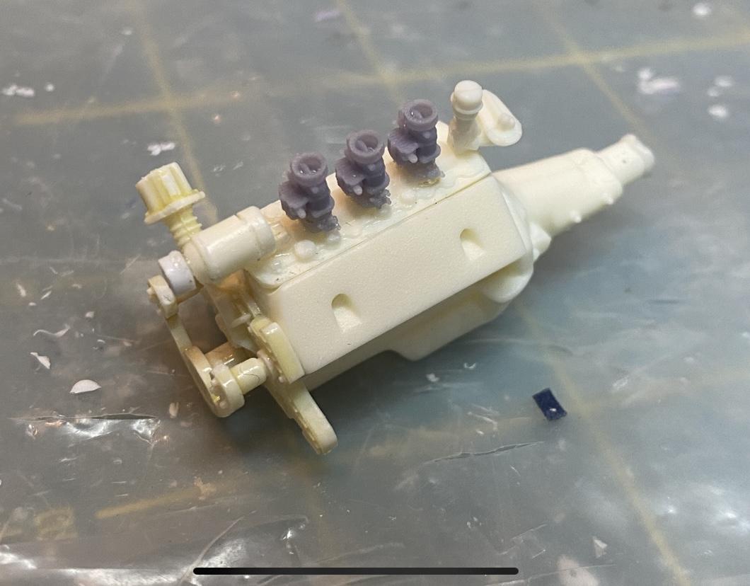

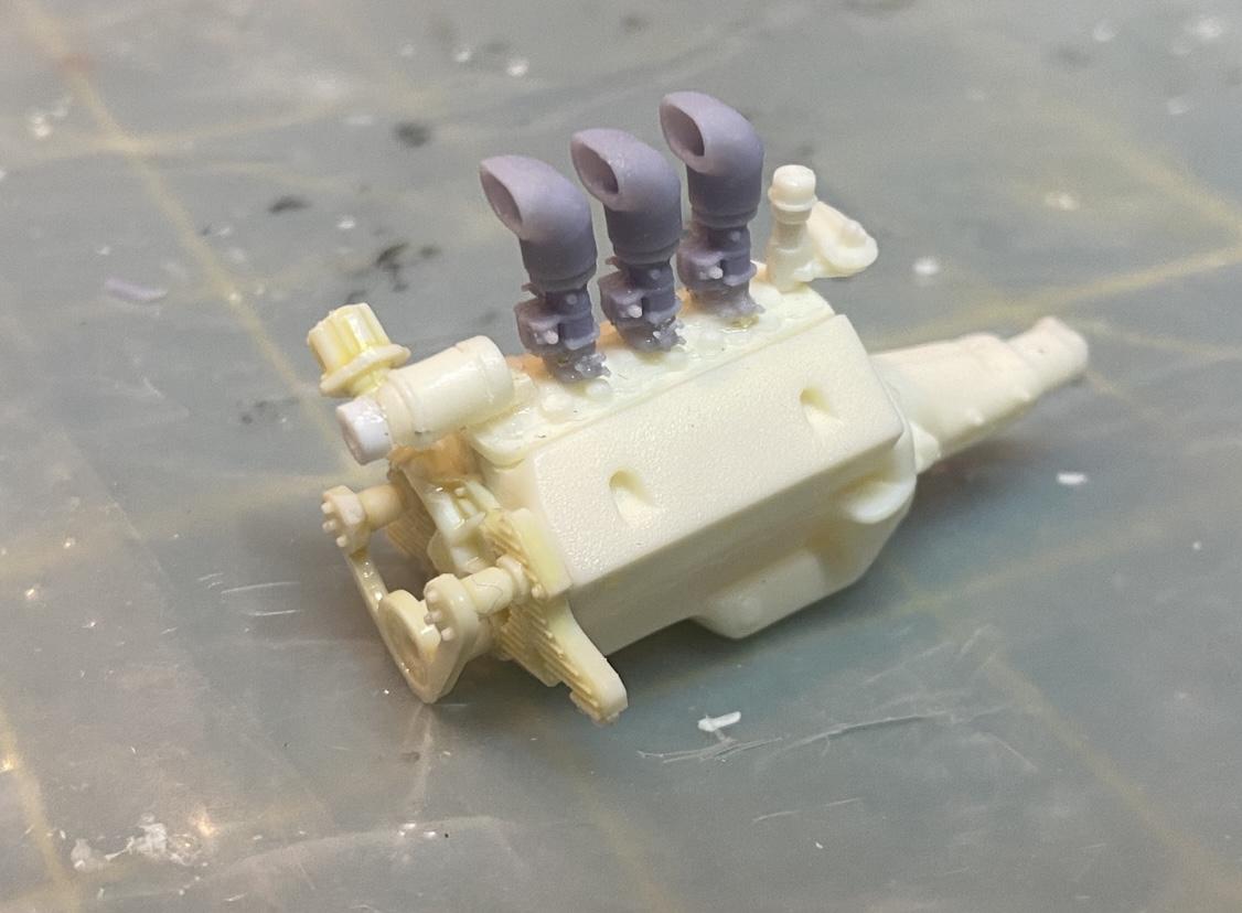

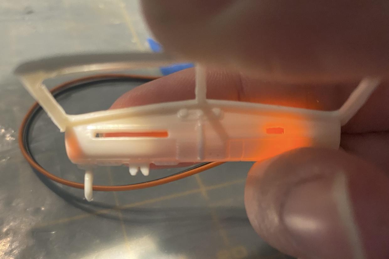

Just a tiny bit more today. Made a simple mold for the door handles before I remove them. I didn’t see 3d ones available that looked right. I cut out the clock and gauges for LEDs, created side glow fiber LED. Will be backed by foil so will glow better in the end. I do not like the fuel injection intake so I got a 3 set of strombergs from Iceman.

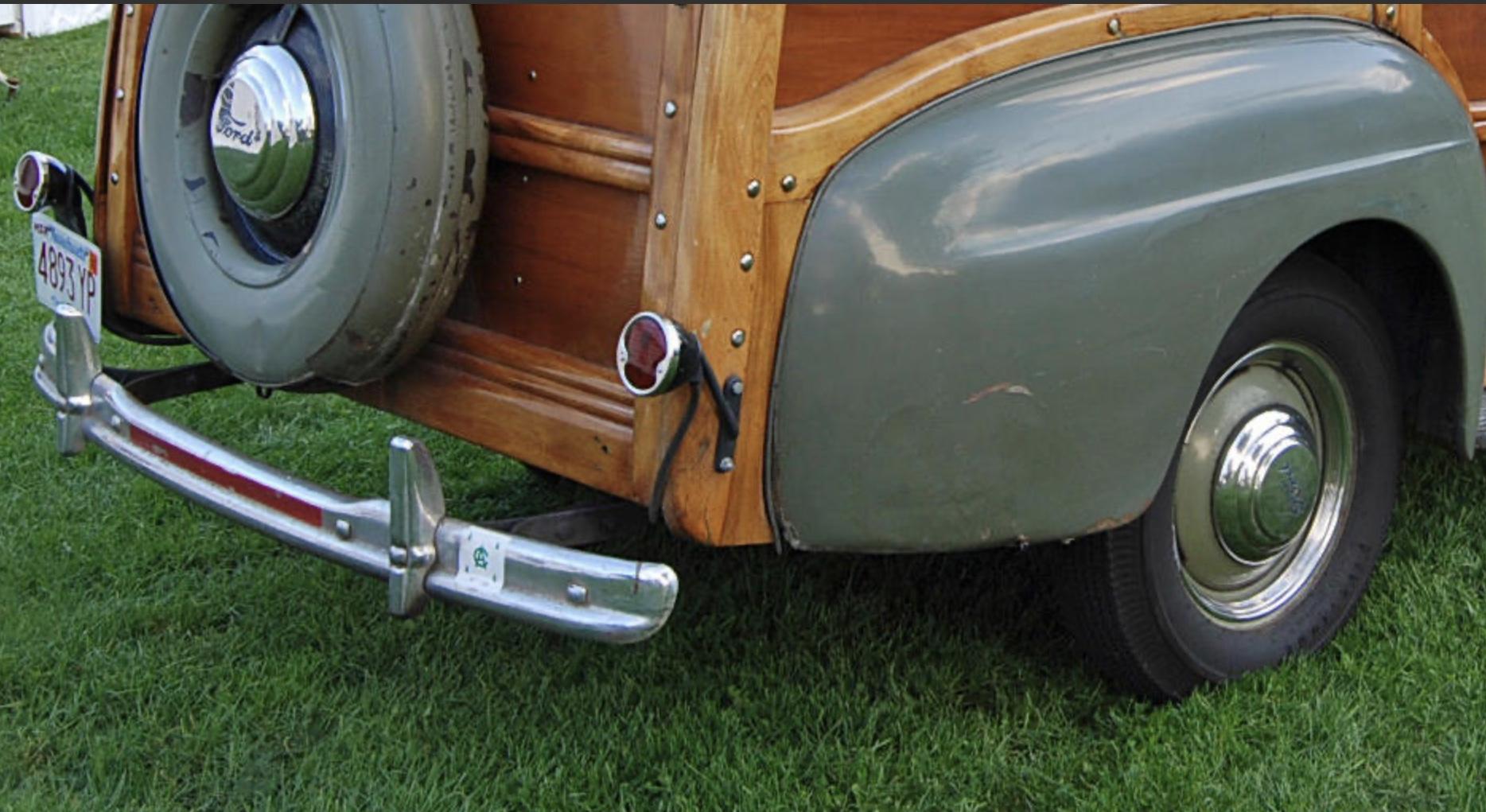

My thumb is starting to get better but still have to take it easy. I did get the taillights created. I smashed some brass rod and drilled for the mounting and soldered rod to It. I drilled out the kit taillights for pico LEDs and wiring. I also drilled for the brackets. Then installed the pico LEDs and added clear UV resin lenses and painted Tamiya clear red. Added the wire covering and tested. this is the look I am going for.

I picked up this kit at a show some time ago. I prefer factory original but I am going to step out of my comfort zone a bit. I am going to go with more period correct Southern California surfer wagon. I am going with a soldier return home from WWII and customizing a woody wagon much like many soldier built hot rods after returning home. Something set in the late 40s early 50s. Lowered stance, surfer stickers, period updated Flathead with dual strombergs, etc. I couldn’t stand the look of the fuel injected Flathead so going to be likely making some modifications with 3d printed carbs and parts, or a completely new printed engine. stripped chrome parts, why… just why. I didn’t like the quad ends for the dual exhaust som cut down to one and drilled ends. assembled the frame and suspension. I cut the exhaust where it fits into the frame to make it easier to install later so I could assemble the frame that would have been a paint assemble one painted. I cast some steelies and trim rings from the 1950 Chevy pickup and hub caps from the spare. Pad printed wide whites to round off the period look. OMG the stance out of the box is terrible! Corrected with a bit of a “California Rake” look to give it the period correct stance. assembled components and bagged per section. This kit had so much flash and heavy spruce connections.
