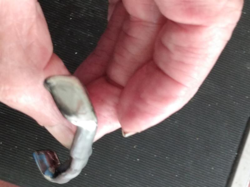

The glass base gel although cured hard, is what adheres it. I used Duplicolor standard black for the base. It's difficult to photo as the light reflection blurs it. Here's a couple more with the blinds closed. There's still some reflection, but there are some areas that can be seen well.The whole part looks like these areas. That's me in the background of the second picture. I was not totally sold by the video either. My main question was how would it would take handling. I did't just handle it, I repeatedly rubbed it with my fingers and gave it a real test. It didn't even phase it. -

I decided to try the chrome nail powder. It works exactly as shown in the video that was on here a short while back. It does take practice to get it right. Here's a front bumper for my 59 Plymouth that I did. It's so shiny that my cell phone camera can't get past the glare. I've rubbed my fingers all over it and done everything to see if it held it's quality. Nothing phased it. It'still like it was when I applied it.

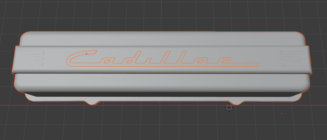

One of the Members here requested a set of Cadillac valve covers. Since I'm creating a 53 Eldorodo, I drew up a set to hopefully accommodate him. I've worked on the water pump sporadically and this is engines present condition. My present focus has been on the building of the 35 LaSalle. I'm making great progress and will post pic;s soon.
