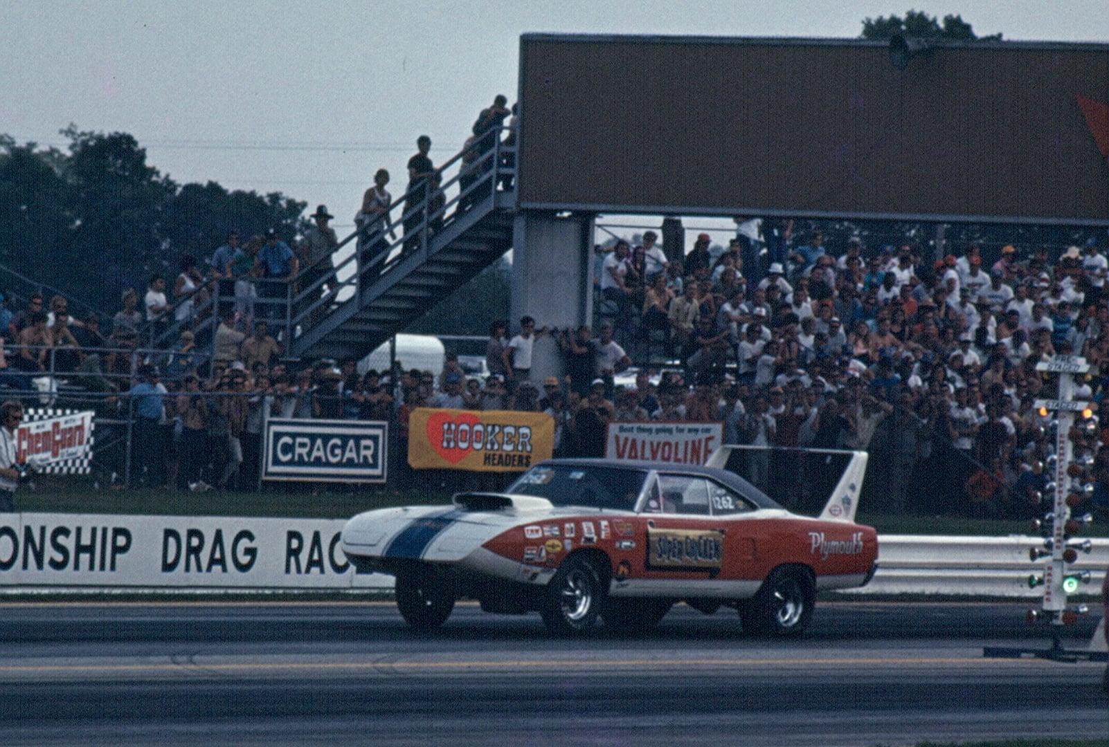

One thing that make me doubtful that it's the same car is the time factor, they did the first race with the SS/E car in April and I know they supposed to have raced it at Indy in the SS/E configuration, they rebuilt the car and put on the vinyl top and raced it in C/MP for a number of races, and finally sold the car at the end of the season according to the Sox & Martin book and built the 1971 Road Runner for B/MP. So they couldn't have used the Superbird much in either SS/E or C/MP configuration. The book doesn't mention the C/MP car, just the SS/E car.

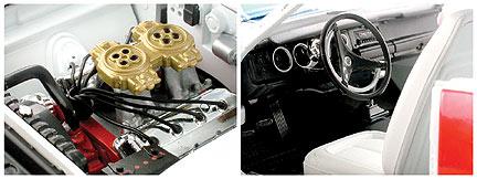

Here is an under hood picture of the C/MP ERTL Supercar Collectibles 1/18 die cast car, I don't know how accurate it is tho' as I haven't found any picture of the engine in the real C/MP car. The C/MP car was appearently sold after the 1970 season and ended up as the "Super Chicken" and this picture is from Indy 1971, the first race with the SS/E car was according to the Sox & Martin book in the beginning of April 1970 so if the SS/E and C/MP cars are the same car they must have rebuilt it quite soon to the C/MP configuration..and why they put on the black vinyl top is confusing as the SS/E car didn't have it. I also read somewhere that the Superbird was lost to a fire, but that an be a rumour, but it has gone throught my head.
The C/MP car appearently had a tunnel ram style pretty much like the 1970 'Cuda, at least from the pictures I have seen...but they could have tested several intakes on the car, MP stands for Modified Production and had looser rules. I don't know if there has been confirmed that the SS/E and C/MP car was the same car, it could be but I'm not sure as I have not seen any confirmation of that...and why would they put on a black vinyl top on the car when it didn't have it when it was ran in Super Stock...so it's confusing but it doesn't matter tho'. They only ran the SS/E car (and SS/EA car for Werst) for a short while as it wasn't really Super Stock legal and had lots of unapproved modifications to it, and the goal was to beat Ray Allen's Chevelle Convertible and then redlight or something in the next run so they wouldn't be checked after the race...that's the story I've read.

I'm not sure the SS/E car and the C/MP car was the same car. The SS/E car has a blue metallic painted roof and the body was most likely intended for NASCAR as the filler panel for the smaller rear window was smoothed out and the NASCAR Superbirds did not have vinyl tops nor side markers. The C/MP car had a black vinyl top like all the Superbirds you could buy from the dealer and the vinyl top was there to hide the filler panel for the rear window. The SS/E car was built specially for the SS/E class and was not entirely legal and there were only two built for the class, one for Sox & Martin and one for Jack Werst, the rear axle was moved forward, the whole wing was weighted down, one front wheel was moved forward slightly and the engine was moved back...all this wasn't allowed in the Super Stock class. They might be the same car but as I said, I'm not sure...and there are two Superbirds in the shop picture.
