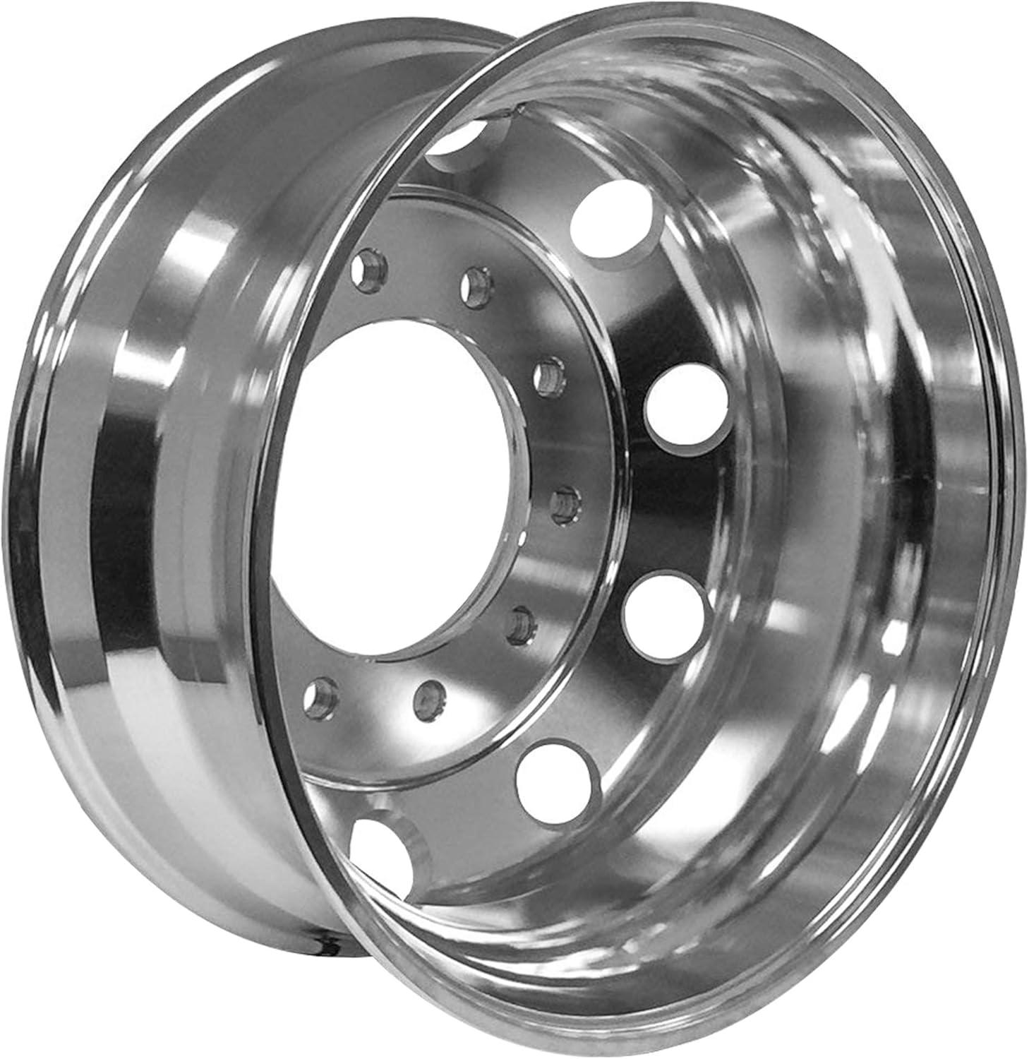

  13. When it comes to AMT I'm intrigued that they used 20 inch wheels and tires on most of their truck kits when lots and lots of real trucks used the larger 22 inch wheels wich were very popular back in the day, it's just a few kits like the White Freightliner, the White Road Boss, the Diamond-REO and the Autocar kits that have the larger 22 inch wheels and I believe it's only the White Freightliner kits that have 10-hole drive wheels. The AMT Kenworth K100 Aerodyne kits use the same 22 inch tires as the kits I listed above but the rims are one piece tubeless style although the rears doesn't look right as they have no "ditch" in the middle of the rim.

  20. Back in the day when most ran on bias ply inner tube tires the rim sizes was 20 or 22 inches for the wheels, and popular tire sizes were 10.00-20, 11.00-20 for the 20 inch rims and 10.00-22 or 11.00-22 for the 22 inch rims, these rims are two or three piece split ring/lock ring rims where you take off a separate lock ring and outside ring to mount the tire and the rim itself is flat from outside to inside. The more modern era wheels for tubeless tires are 22.5 and 24.5 inches and they are one piece rims with a "ditch" in the middle to mount the tires, today almost all highway trucks has 22.5 inch rims and earlier 24.5 inch rims were popular, but today almost all highway trucks have 22.5 inch rims. Examples of tire sizes are 11.00-22.5, 12.00-22.5, and the same for 24.5, but lately many truck tires comes in metric widths like 385 and so forth. Most of the US truck models available to us from AMT has split ring/lock ring wheels and the White-Freightliner and a few others like the Autocar, the Diamond REO and White Road Boss has 22 inch rims and the others like the Kenworth W925-K123, the Peterbilt 359-352, the GMC General and Chevy Bison, the GMC Astro and Chevy Titan 90 and the trailers has the smaller 20 inch rims, one exception was the Kenworth K100 Aerodyne wich have a kind of tubeless wheel but the rears has no ditch in the middle and it has the 11.00-22 inch tires. The Ertl truck and trailer kits had a slightly larger outside diameter tire than the AMT kits, their 11.00-20 had a larger outside diameter and was also slightly wider, these tires also found it's way into some AMT truck kits after the AMT/ERTL merge, among them the Kenworth T600A and a few others.
