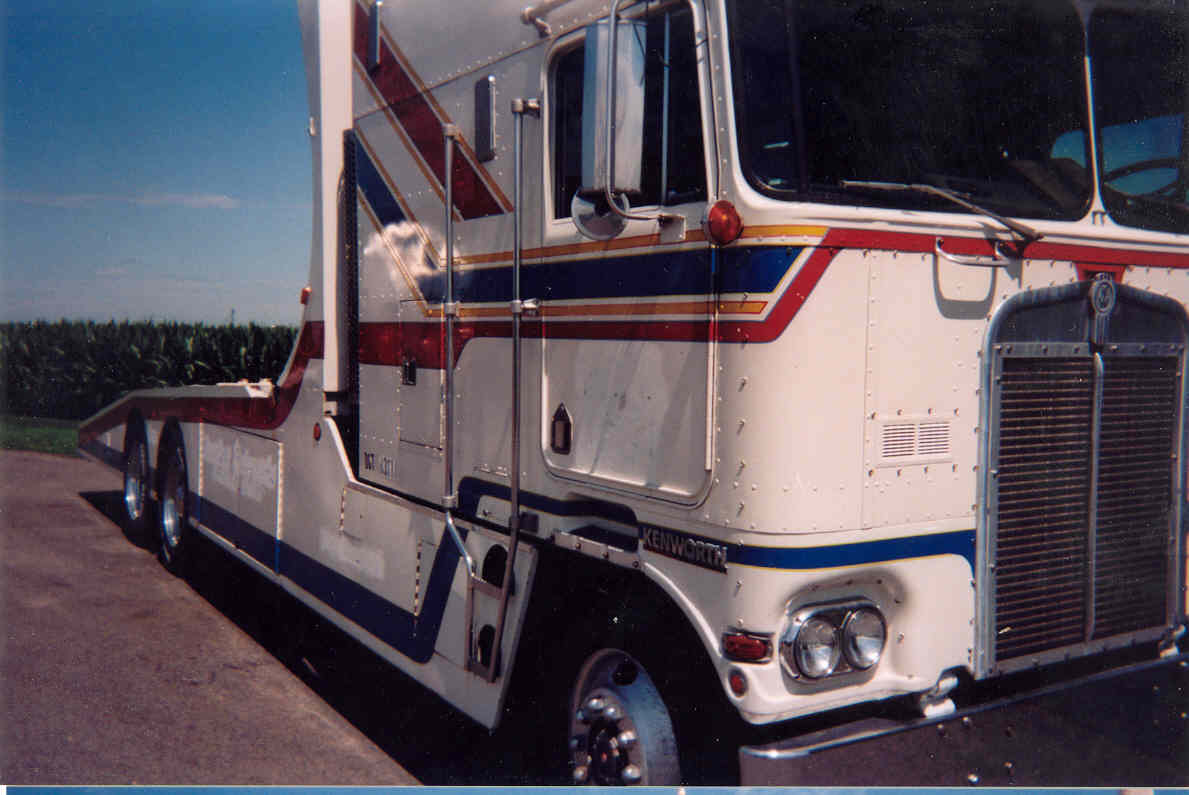

Yes it should be a louvered vent there. It seems like AMT missed that when they first made the tooling for the COE Aerodyne cab, the Revell K100 kits and the AMT K123 has the vent in place. Here is a picture of the Papa Truck when it was for sale after Malone's passing, Gary Reis has the truck now and has restored it.

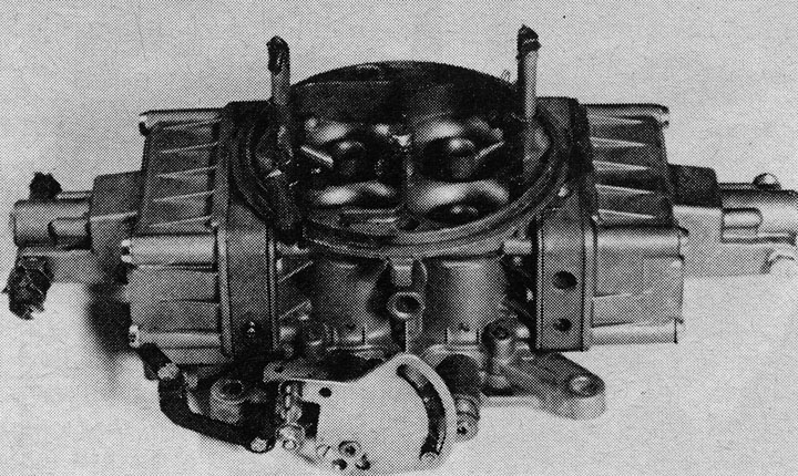

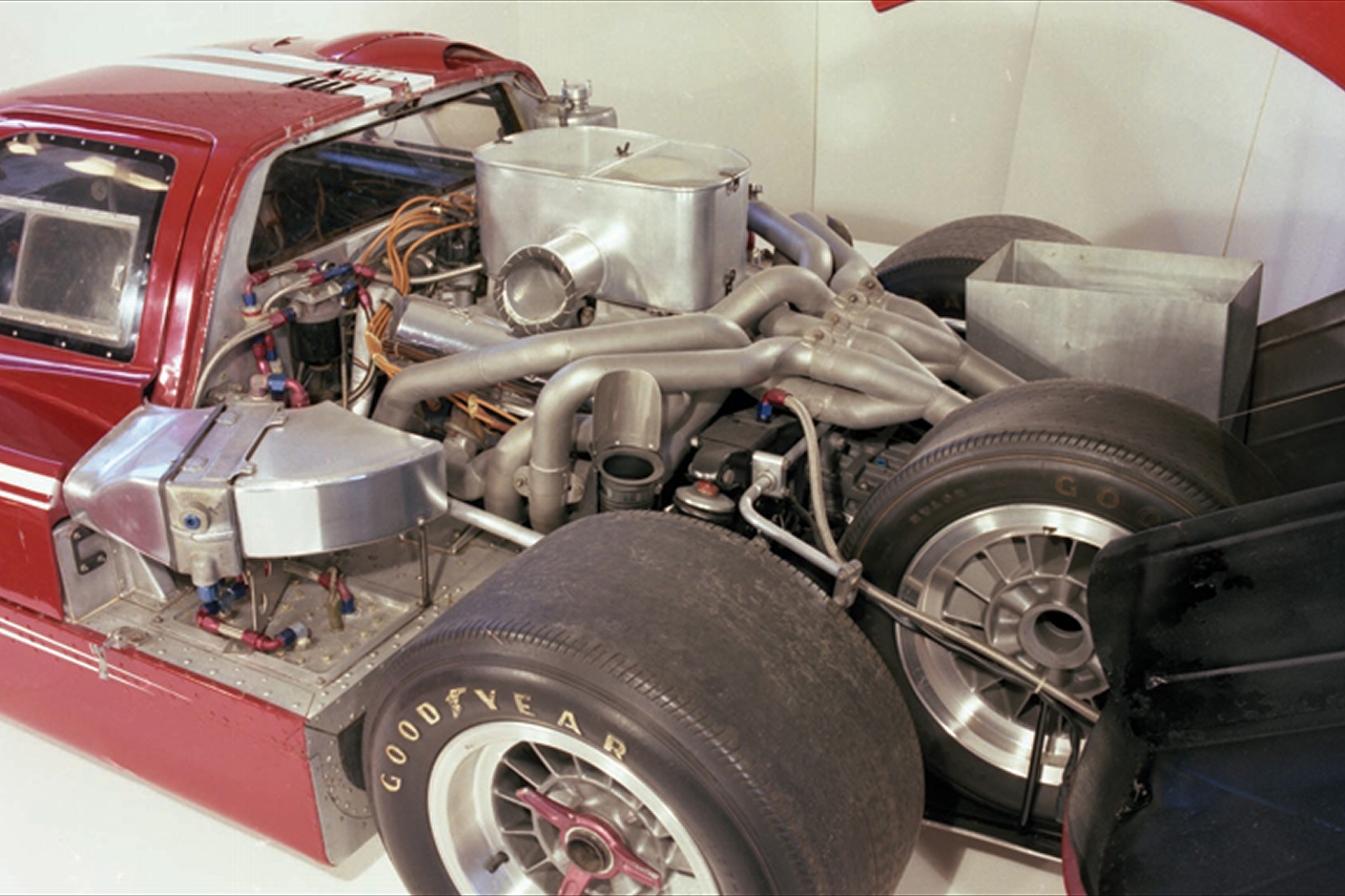

The Mk IV dual carburetor setup was a one year only and they didn't have that style air cleaner, if they had air cleaners it was small round ones, one on each carburetor. Ford used the Holley 4160 style carburetors mounted backwards, they will not fit otherwise as the float bowl will interfere with the distributor if mounted the other way, you have drawn in the 4150 style carburetors in this picture and they will not physically fit on a Ford FE dual carb intake manifold as they are too large, the 4160 is smaller and has only one metering block, the 4150 has two metering blocks and that and the upside down V shape where the fuel goes in makes them too long for this application. Here is the dual carb setup on the 1967 LeMans Winner, car No 1. The Mk IV had the carburetors mounted in air boxes and here are a couple of styles used, here is the No 4 car. Here is car No 2. Here is car No 1 again now with the air box mounted.
Sooo Nice!!! You have even put in the correct dry sump setup, this one I'm hopefully going to buy at least two of. The HRM engine is also a small block for Mk I so this will probably be the only FE conversion engine for the Mk II and it would work for the Mk IV too...the Mk IV had dual Holley 4160 carbs tho'.
