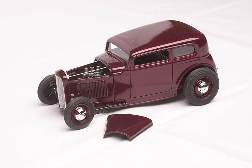

  3. Won't be able to hide this under a hood! Shinny distraction draws the eye to the chrome backed by an ample amount of Oval Blue!! Excellent presentation, Brother!!! -KK

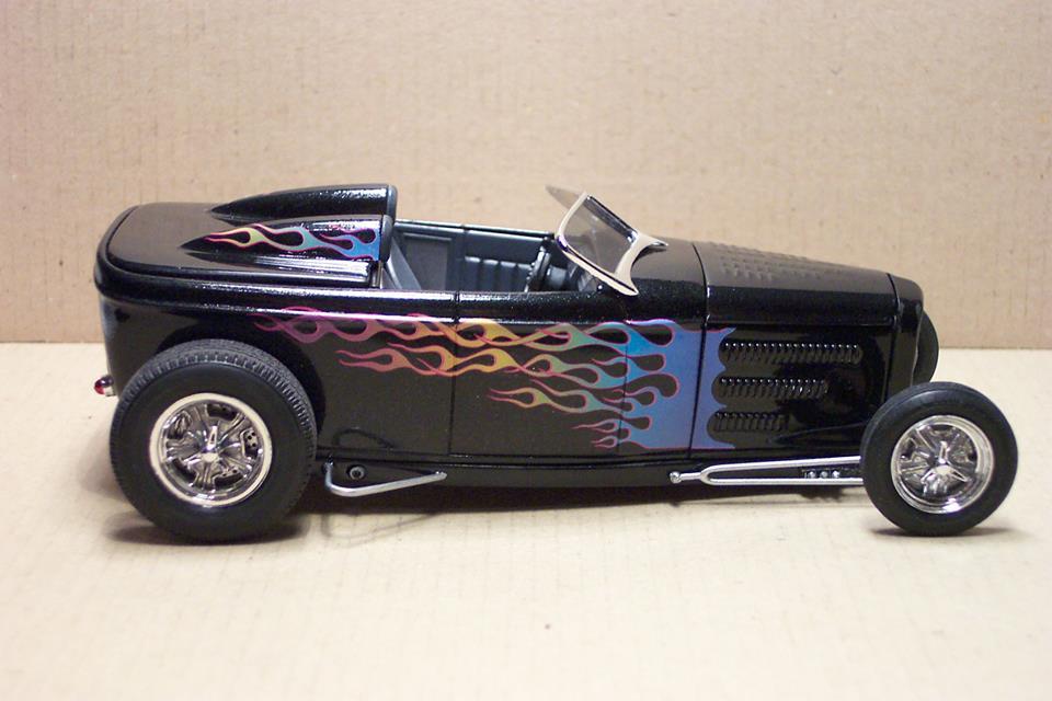

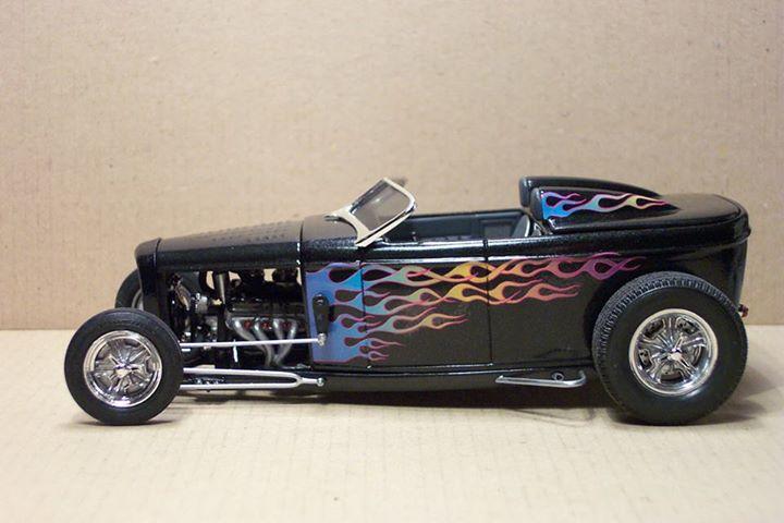

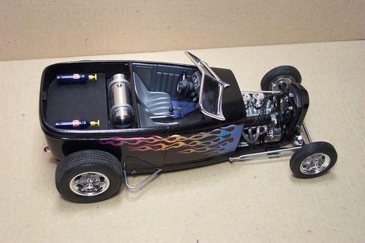

  6. '32 Roadster Interior and a bit of work... and, scratch tuck-n-roll is a challenge, too! -KK B-32 Tubster http://public.fotki.com/jferren/kit-karsons-32-tubster/

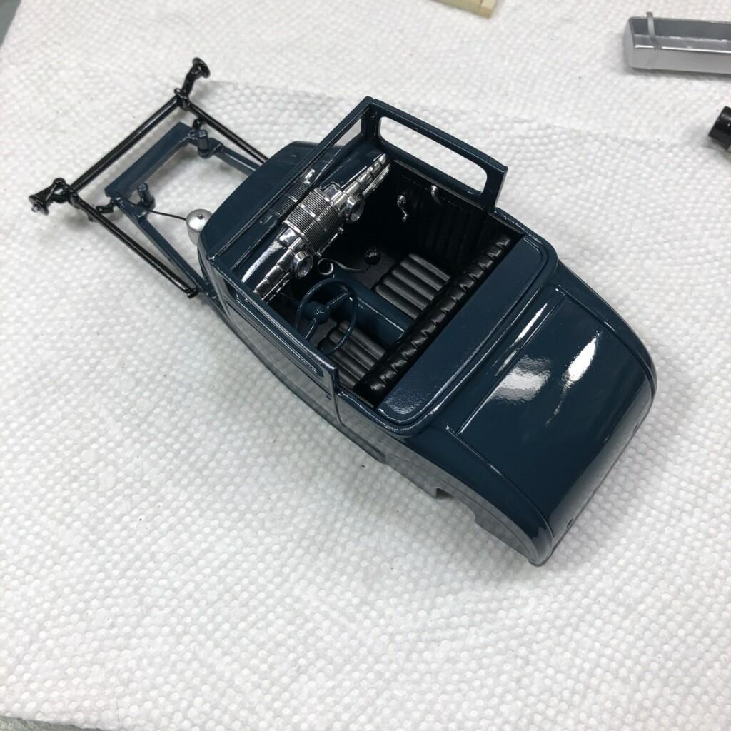

  7. This is coming together wonderfully! Creating the right interior for a roadster is tough, right @tim boyd? I modified the interior so that it would wrap around the tub body in my Oldster: https://public.fotki.com/jferren/kit-karsons-oldster/

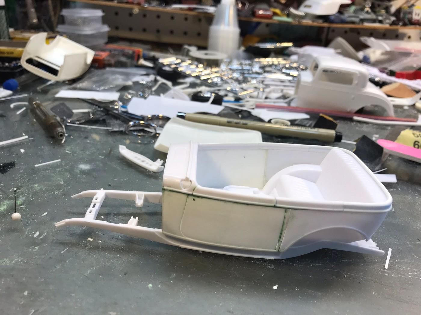

  11. @Bullybeef; @tim boyd; @Dennis Lacy; @Rocking Rodney Rat Here's where we tie everything together... The new roadster is going to contribute it's floorboard and firewall to our "29A Closed Cab Pickup build! We'll remove the top part of the '29A PU's Firewall; notch out the corner's of the '29 Roadster's Firewall while attached to the '29 Roadster Floorboard with scotch tape. Dragging the #11 blade chisels a fine line removing material about as wide as a fine marker ink line. Until the upper portion is removed... Had to add back a little material to make the roadster firewall fit... Now to add a little material to the '29 roadster firewall so that it'll fit the '29 PU body... after filing the notches on both sides of the '29 roadster's firewall. Had to clamp the material while the CA glue sets up... Once the cab & roadster firewall fit; it's on to the ''29 roadster's floorboard. and, how they fit together... Remember when I mentioned that this build was going to be different than @Dennis Lacy's build, in that it will not have hinged opening doors. To that end, the roadster floorboard will be installed inside the '29A's cab. With the perfection, as if the parts somehow were meant to go together! From all angles, the fit of the '29 roadster firewall and the '29A cab is everything needed to proceed to the next step! Remember, the difference in the depth of the floor and the bottom of the cab will not be seen, once the doors are fit to the cab! Next up we pull parts for the engine: You'll be surprised where the '80's/'90's powerplant will come from! Here's where I'm going to dig into a couple of older Revell kits for the engine and transmission parts. Stay tuned boys and girls! -KK

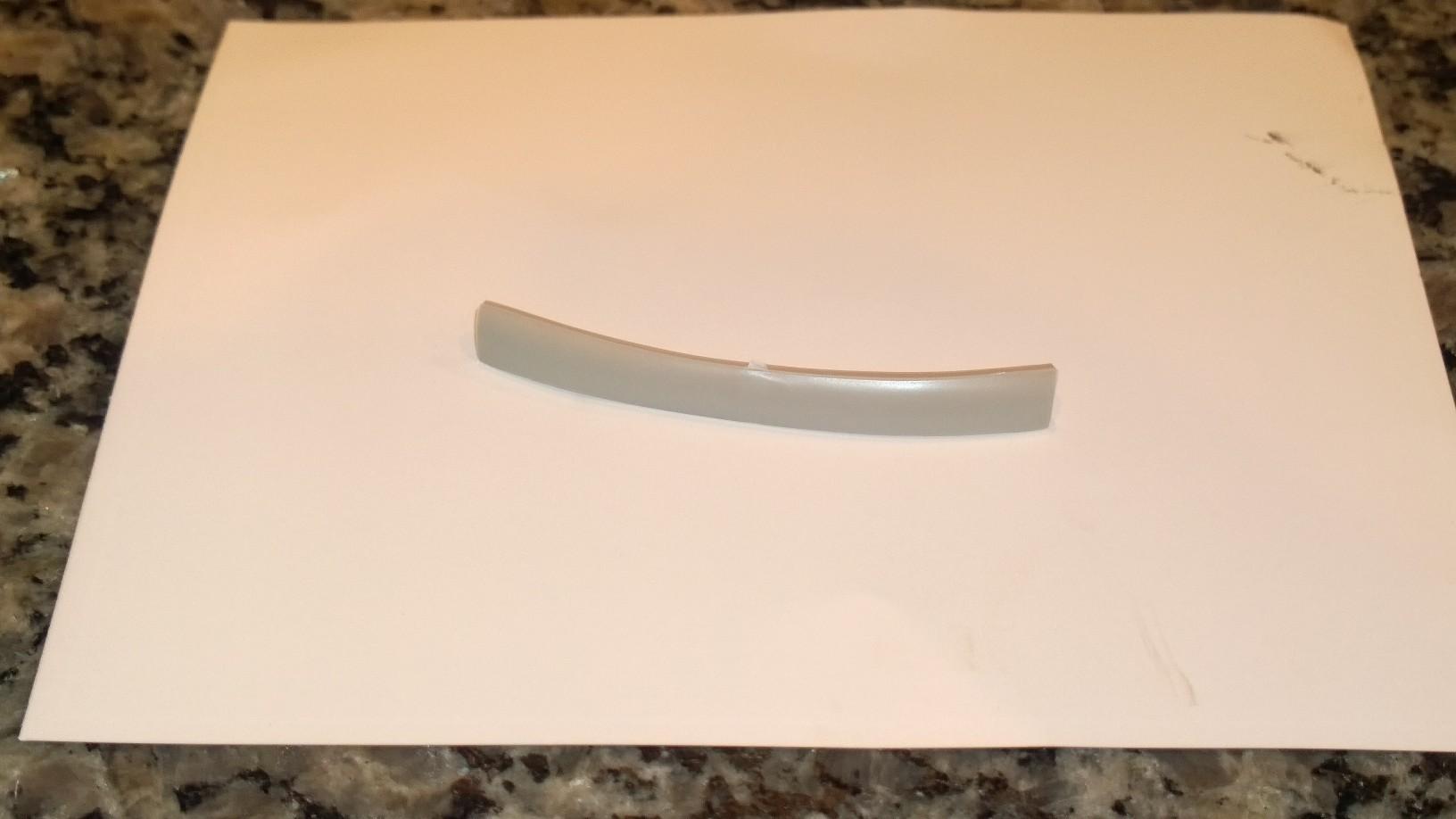

  13. Here's an easy fix, the bar on the bottom of Revell '29 PU part# 53 Pickup Bed is a tad bit too wide. That little BLACK MARK has to go! Same amount on both ends! Here we "TAKE" the line! Both directions. Notches cut! Needs a little filing... Now it fits! Moving on, there are a couple of assumptions that I will be working under: Doors will be fixed (NOT a big fan of the hinges on the swinging doors) Although, I did get them to work on the '29 PU V-12 Midnight Auto Salvage K&R Kustoms+Rods Parts Truck And, the next step will take a little extra modifications to make the parts fit together. So far the mods have been pretty straight forward. -KK
