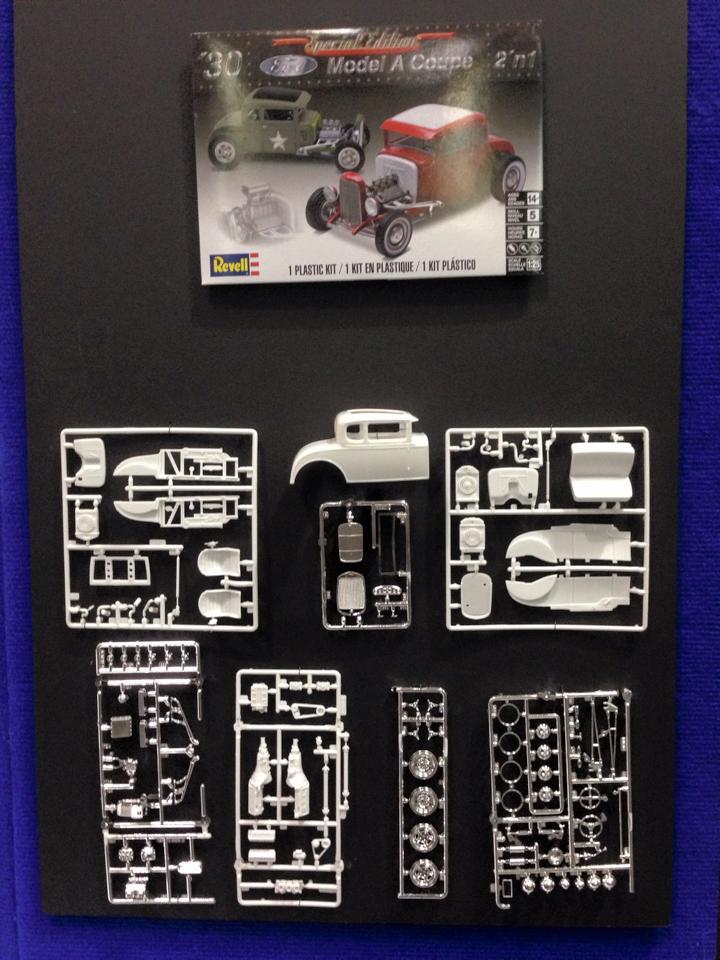

Sorting out parts and came across a couple of very special parts trees that @Rocking Rodney Rat & I came across three decades ago! Yup, we had contacted AMT & requested kits that we could provide a small group of kids as a presentation we wanted to do for them as an introduction to model building as a hobby. AMT came through with a bunch of boxes of model kits and a few boxes of parts! In the parts were a couple of trees from the '33/'34 Sedan/Coupe kit. Not something you come across very often! These were not trees that are chromed in the original kit releases. Here's the original parts tree: Here's the same tree that was chromed but never offered in any kit: Might have to go with the extra chrome parts under this '80s/'90s show rod! Here how the parts came in the out of the box of parts we got from AMT 30 years ago: Notice how the tree is only partially chromed... Now all I have to do is get it in and make it look like it belongs there! -KK

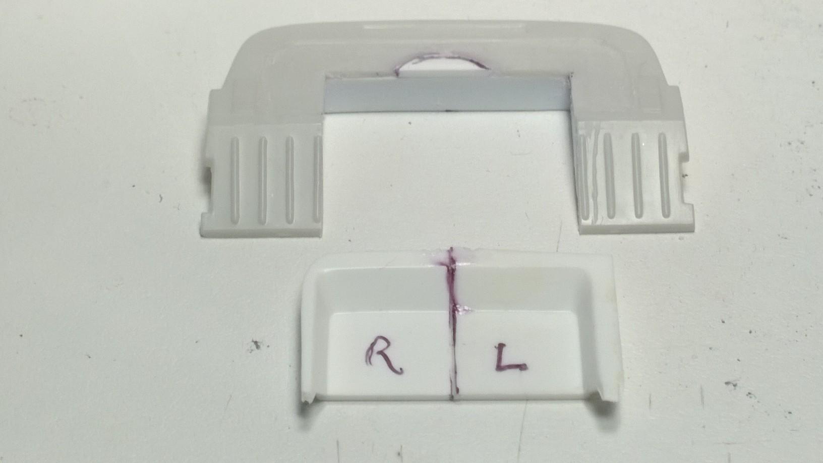

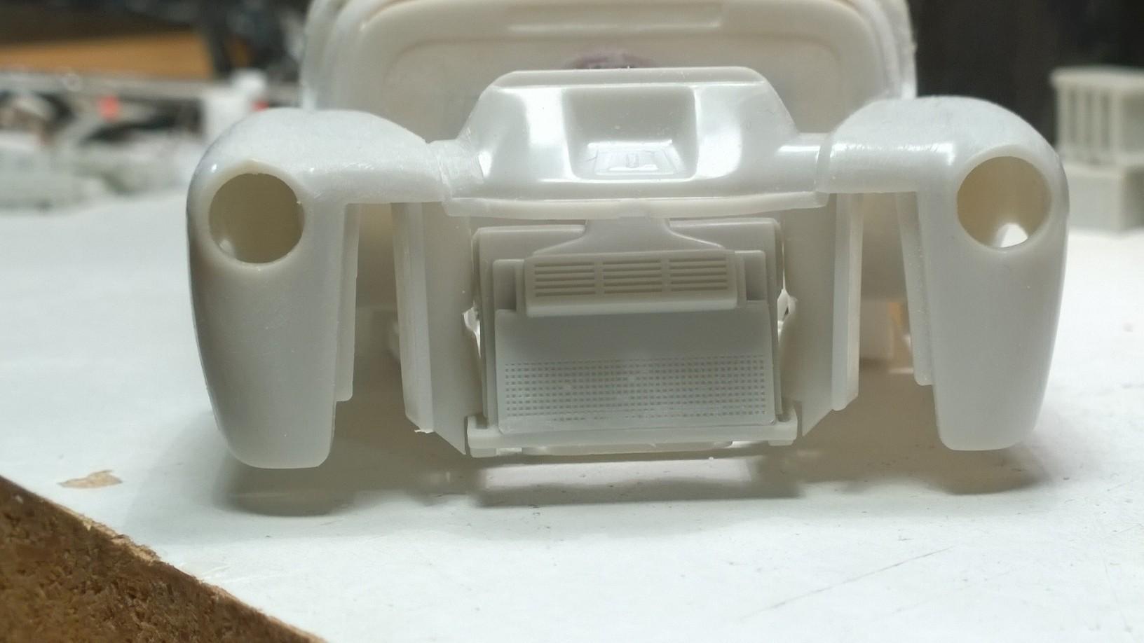

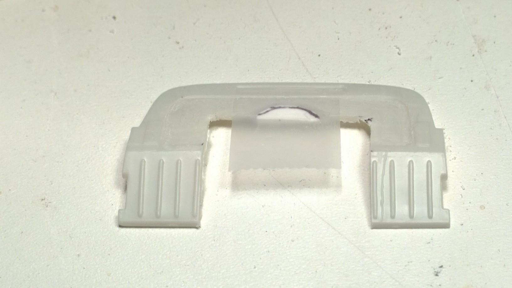

The Hard Shell Tonneau Cover was somewhat scratch built. Starting with a pair of sprint car fuel cell covers: Glued them together to be able to create two exact duplicate pods: Sanded them down to the down: Cut headrests to fit: Completed Dual Headrest Hard Shell Tonneau Cover You can see the entire build at link: http://public.fotki.com/jferren/kit-karsons-32-tubster/

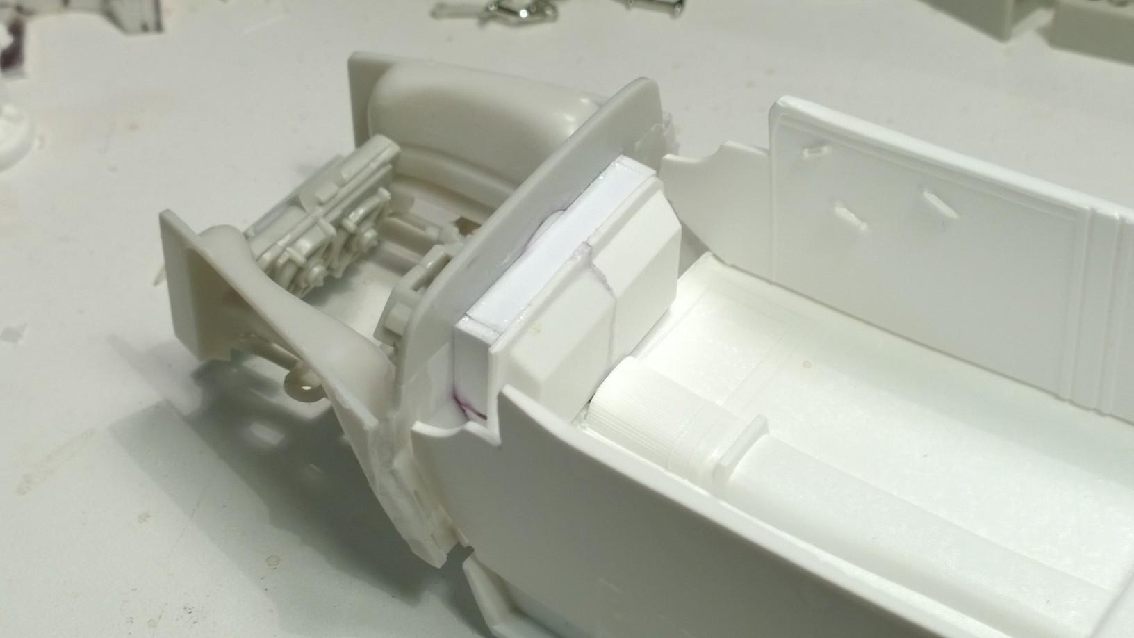

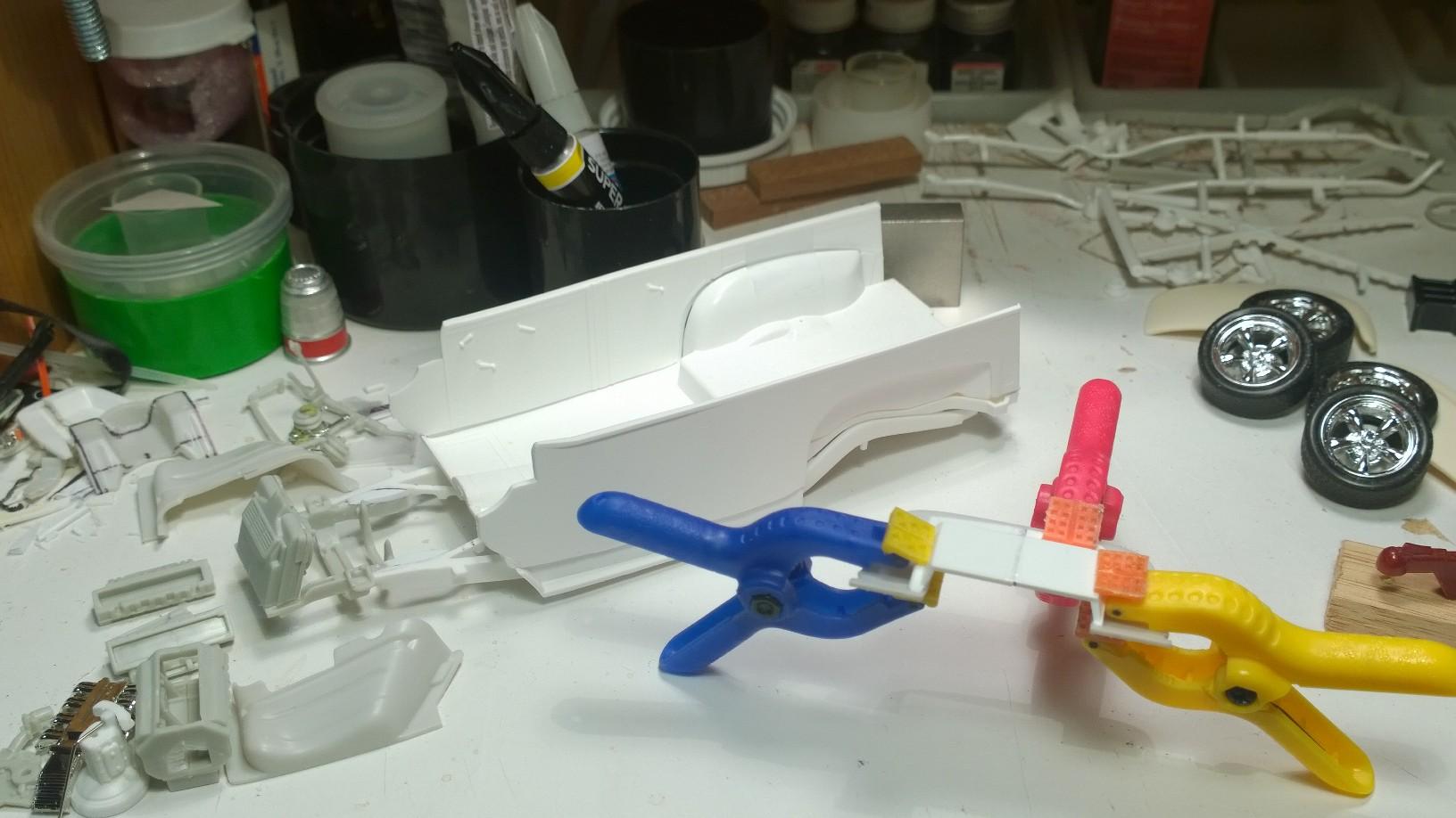

The only other consideration is the width of the 2-door Phaeton door. The Phaeton originally came with 4-doors and both were a bit narrower than the Roadster's doors. I decided to go with the Roadster door opening on my Tubster: Grafted the AMT '32 Phaeton and Revell Deuce Roadster bodies together

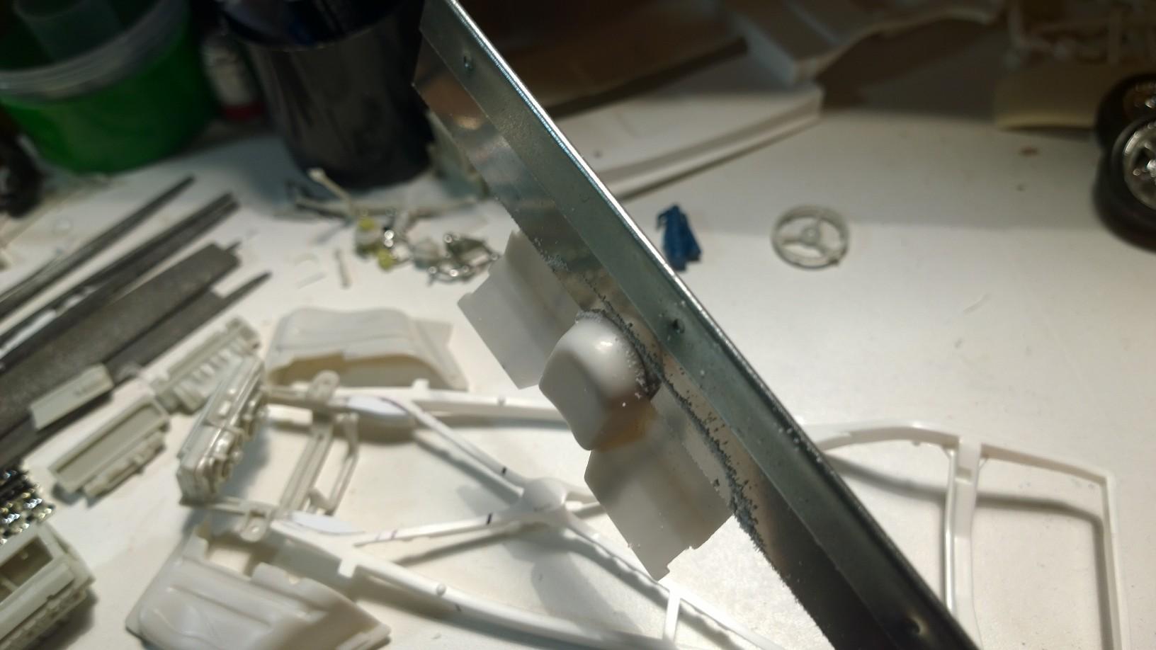

K&R Kustom+Rods '32 5ive Window Rolling Bones Chopped Coupe Here's a great illustration/picture of a true chopped 5ive window coupe: Rolling Bones Chopped '32 5W Body Off What we're going for is this chopped REVELL 1932 Five Window Coupe: '32 5W Chop Job Right Side '32 5W Chop Job Left Side '32 5W Chop Job Right Rear '32 Chopped 5 Window Cut & Paste - printed out a picture of the un-chopped body to get an idea of how deep the chop could be... '32 Chopped 5 Window Back Lite Cuts #1 '32 Chopped 5 Window Back Lite Cuts #2 Second Cut the A Pillar Third Cut the C Pillar to the Back Lite but not all the way through until the other side has been cut to the same point Third Cut the C Pillar to the Back Lite Continued Third Cut the C Pillar to the Back Lite Continued First Cut the B Pillar Finish the Back Cuts Blacken the C Pillar Cuts for Sanding to Create a Flat Even Surface Check your progress to make sure you do not remove too much material Sand the Surfaces to Make Them Flat Even Slowly Sand Down the C Pillar Test Fitting again took out one more inch... '32 5W Chop Job - Step Cut the A Pillars Right & Left '32 5W Chop Job - Step Cut the A Pillars '32 5W Chop Job - Step Seven Set Alignment Blocks to the inside of the Pillars '32 5W Chop Job - Step Seven Back Lite Opening '32 5W Chop Job - Step Seven Windshield Opening '32 5W Chop Job - Step Seven Left Inside after the all of the seams have been glued with CA, the Alignment Blocks can be removed. '32 5W Chop Job - Step Seven Right Side '32 5W Chop Job - Step Seven Left Side K&R Kustom+Rods '32 5ive Window Rolling Bones Chopped Coupe K&R Kustom+Rods '32 5ive Window Rolling Bones Chopped Coupe K&R Kustom+Rods '32 5ive Window Rolling Bones Chopped Coupe Check our the entire build at link: https://public.fotki.com/jferren/rolling-bones-style/
